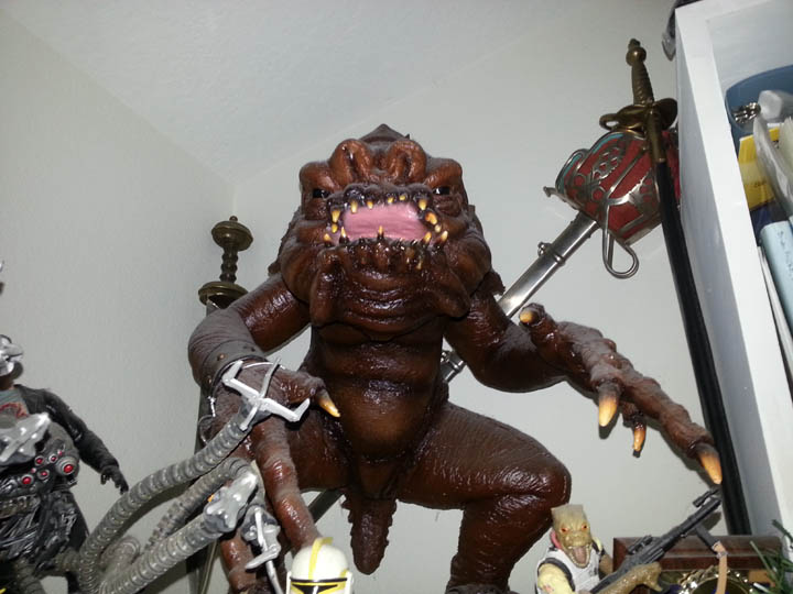

Re: RANCOR Sculpt
Loving the sculpt!! Makes me want to pull out my big Rancor and put him on a proper pedestal!
And yes, that's a terrible layer of dust... I'm terrible about dusting.:p
