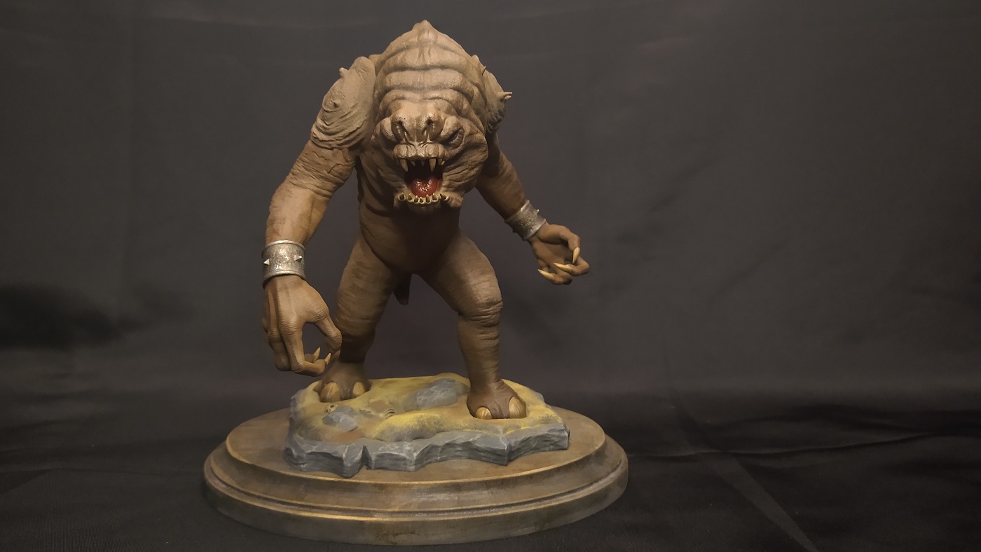

Before I start on a much larger project involving my vinyl kit of this same creature, I have been looking for a smaller version I can print out and test my painting skills on. I spend most of my time painting hard-edge models but I really enjoy painting figures and this Rancor is an excellent sculpt! It's getting way too cold to be outside here so I spent a good part of Saturday painting this and making a small base for it. He was printed on my Jupiter with Siratech Sculpt which is one of my go-to resins for figures like this.
Here he is all primed up. Recently I have switched to using mostly air-brushed primer. I really, really like the Tamiya primers and for props and larger projects I will still go what route, but it's not cheap (and needs to be used outdoors). Also, when it comes to anything this small with a lot of detail, it's easy to overdo it with the rattle cans. My current go-to primers are the Acrylic/Urethane from Veljjo or if I need something a bit stronger I use the primers from Alcald. The Urethane based primer does not sand very well and truly takes 24 hours to properly cure. So far I have not had any issues with it and it seems to hold up pretty well.
This is how you know you are nearing the end of a project

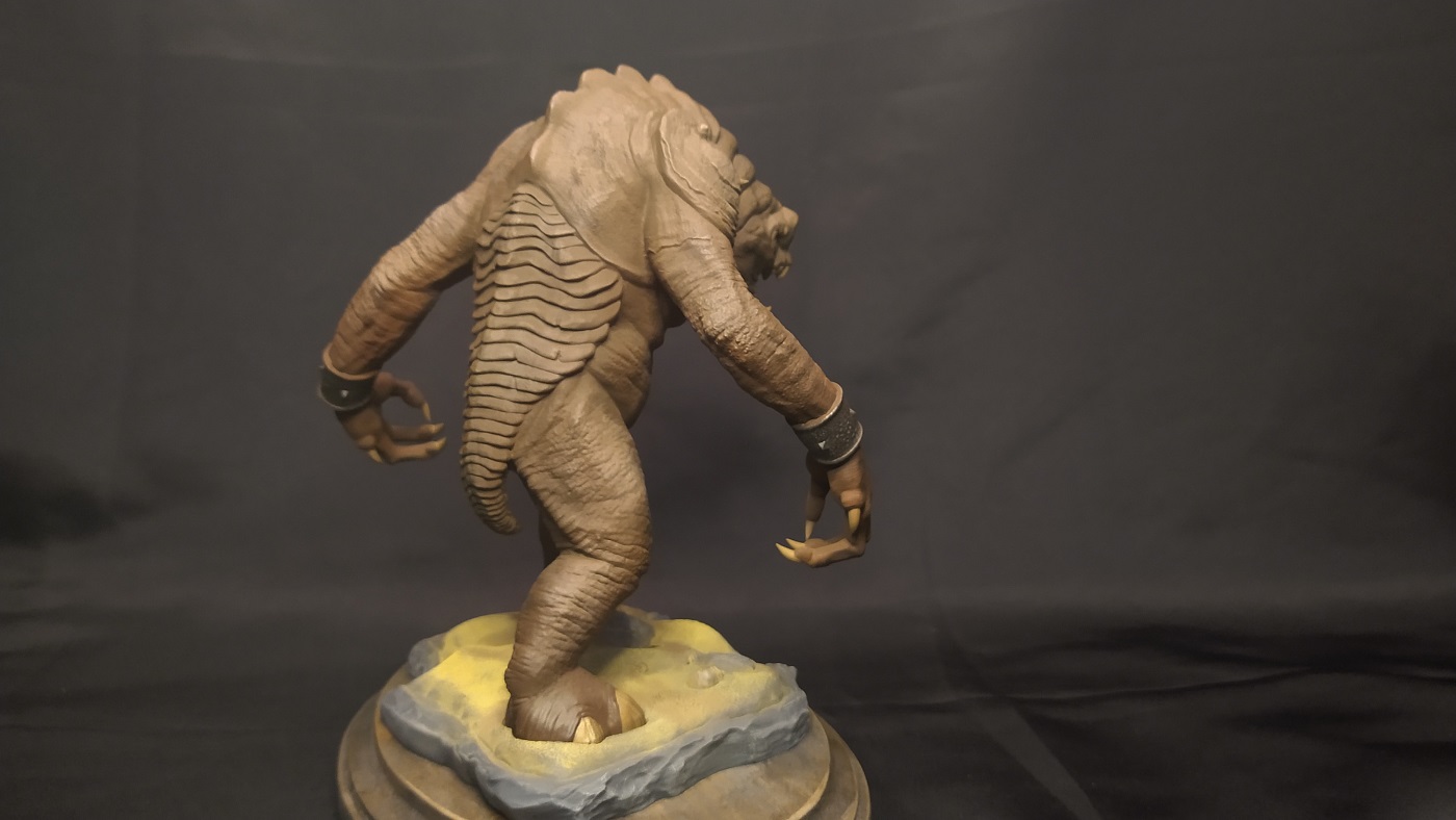

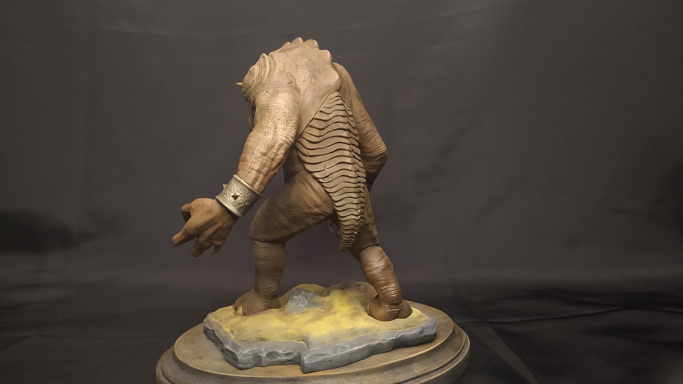

As usual, no matter what I did, the camera lost a lot of the variation in colors. I really tried to make this as 'organic' as I could. I started with Tamiya paints followed by Archive-X for some color variation and dry brushing and then pretty much broke out everything else I have to weather with and finished with a bit of oil and pigments.
