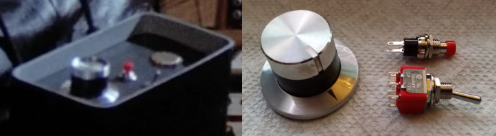

Now let's look at the controls. In the middle we have a standard red push switch and a silver toggle switch. Those I already have. On the left is the big knob. I may not be able to match it exactly but should be able to come close enough. What is that thing on the right supposed to be? A microphone?
Ok, so I now have FOUR voice changers on order. I will report back which one works best. I am also experimenting with repurposing an old smartphone and using an app, though there is a slight delay in the translation. The only app I have found so far that can work live through the headphone jack is RoboVox (Android). Everything else I have tried works either via record/playback or via the telephone. RoboVox isn't perfect, but the "Imperial" and "Shiver" voices are the closest. Saturday I go scrounging for a knob and an enclosure. The LED kit I mentioned above arrives this week. Still not sure what to do about that mysterious 4th object on the right, but I may just imitate it with a proper size grille.
I haven't looked at the costume yet. They switched back and forth between two capes in the film - black/silver and red with odd black collar, though the action figure has the black/silver cape. I might use a black/red cape I already have. The goal is to wear this to the Horror Ball in Portland on June 20. The voicebox is key!
I am still trying to find a suitable enclosure, but I have 3 of the 4 items from the top of the voicebox ready. The knob is not an exact match, but it will do. I still have no clue what that flat thing on the right side of the box is. Anybody?

"The round flat mesh was merely some screen covered with an interesting "washer". Inside were batteries hooked to lights made to flash when he talked. A microphone under the mesh picked up the sound and activated the colored lights."
Look familiar?
It's the same model enclosure used in the film! The company has been making electronic enclosures since the 40s and this one is still available direct from the manufacturer. It's model C03 in gray. Some black spray paint and I'm in business!
LMB Heeger : Product Category Page : CO Series
Now the final key is the voice changer. I have the HyTechToyz deluxe Cyclon voice changer on order. I am hoping I can make that work because all of the under $30 voice changers have sucked royally.
