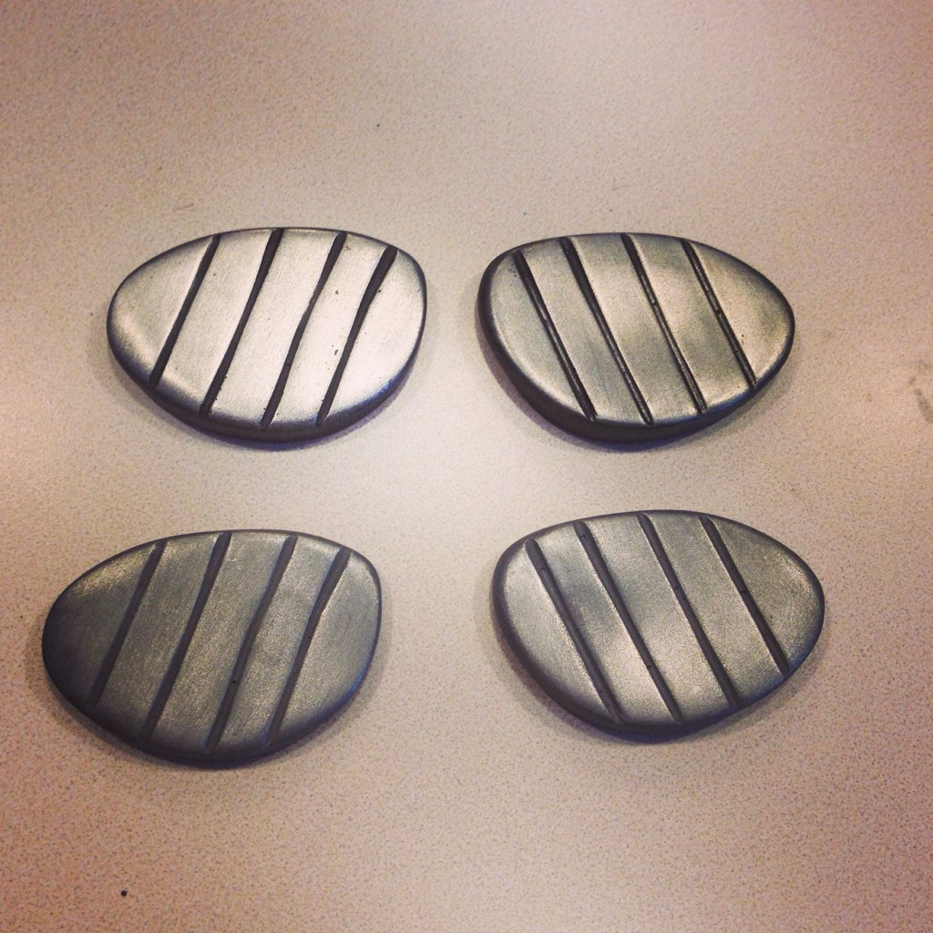

I did a second run of the badges with a different resin. They definitely look like brushed aluminum so that makes me happy. Still not as chrome colored as I would like, but it's a really nice look.
The top ones were done with a black resin and the bottom with an amber colored resin. The top ones are more pewter colored with the bottom ones like a true aluminum.
If nothing else I'm ecstatic to have them 100% correct in size and shape to the BMA bike.

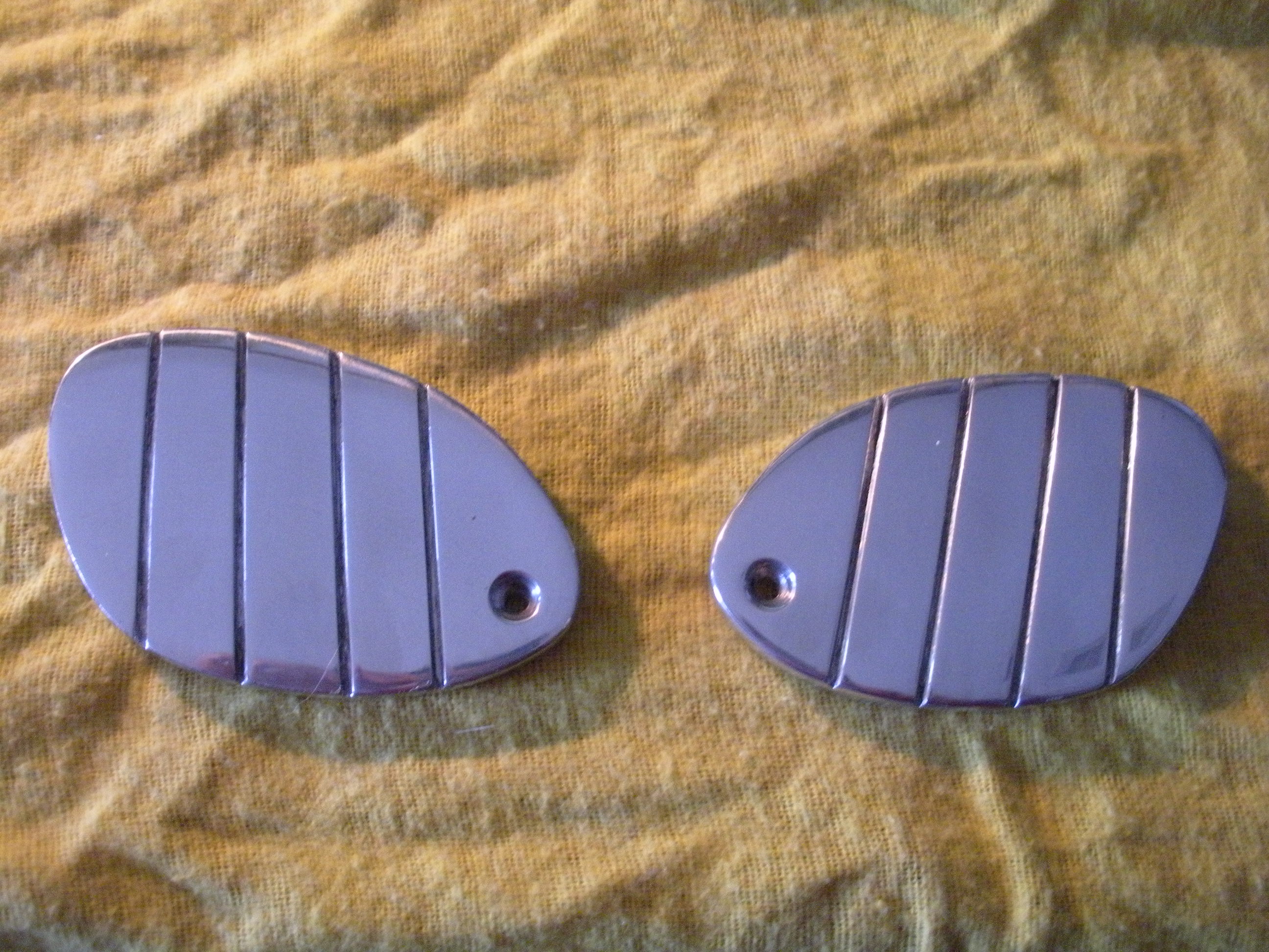

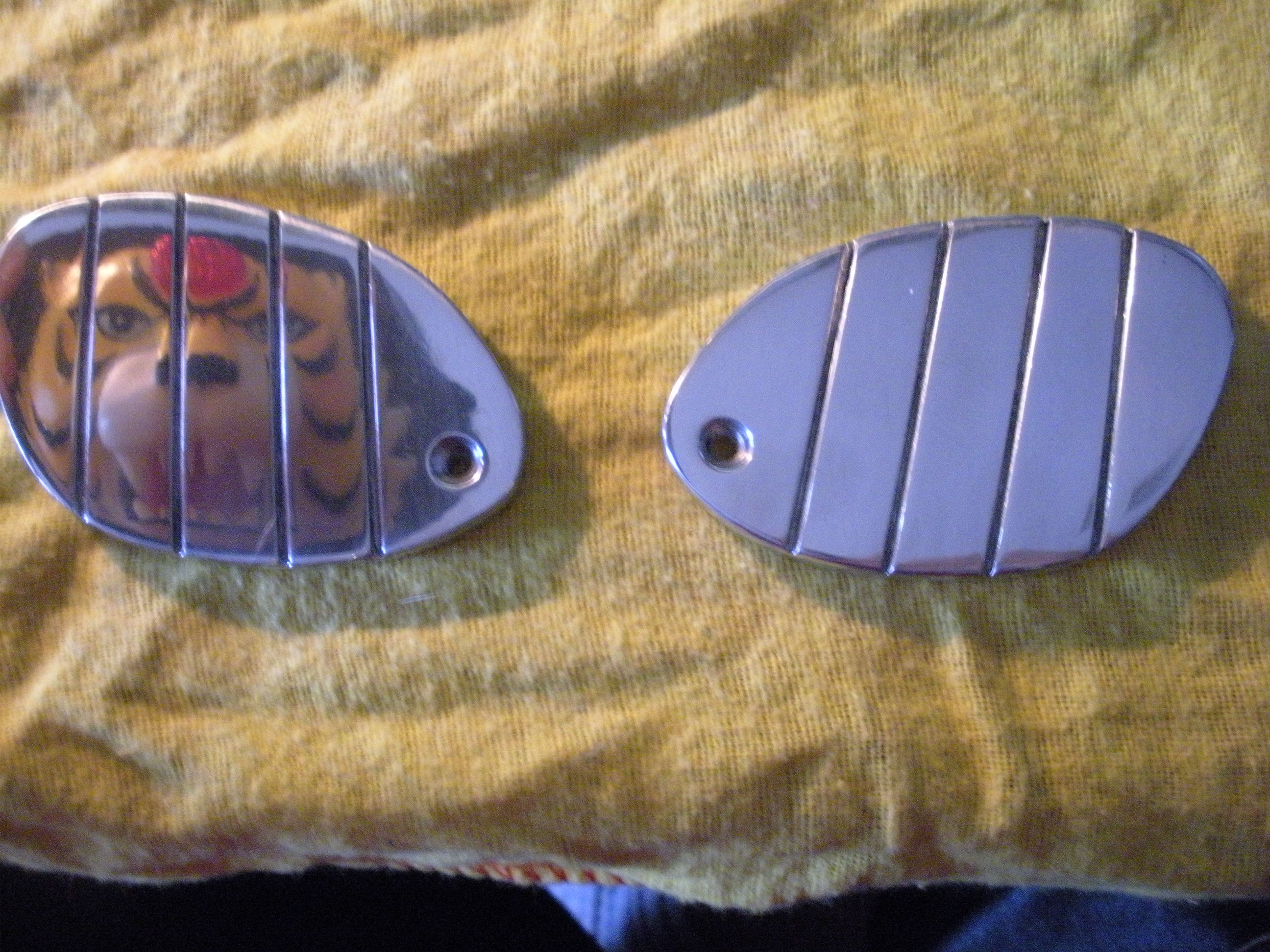

Nice job on the cold casting droidboy, they look good, I done mine the hard way, I cut them out of 3/16" aluminum plate, sawed the grooves with a hack saw and then sanded them and polished the hell out of them on the buffing wheel, then I molded them to my tank and chrome painted the edges for an even match, mine are also traced from the BMA bicycle, and I drilled and countersunk them to utilize the tank screw, just like the museum bike.144.JPGtank badges 001.JPGtank badges 002.JPG

Nice badges Billy. I had to make multiple sets anyhow so I just went ahead and made molds to do them out of resin, otherwise I might have gone your route.

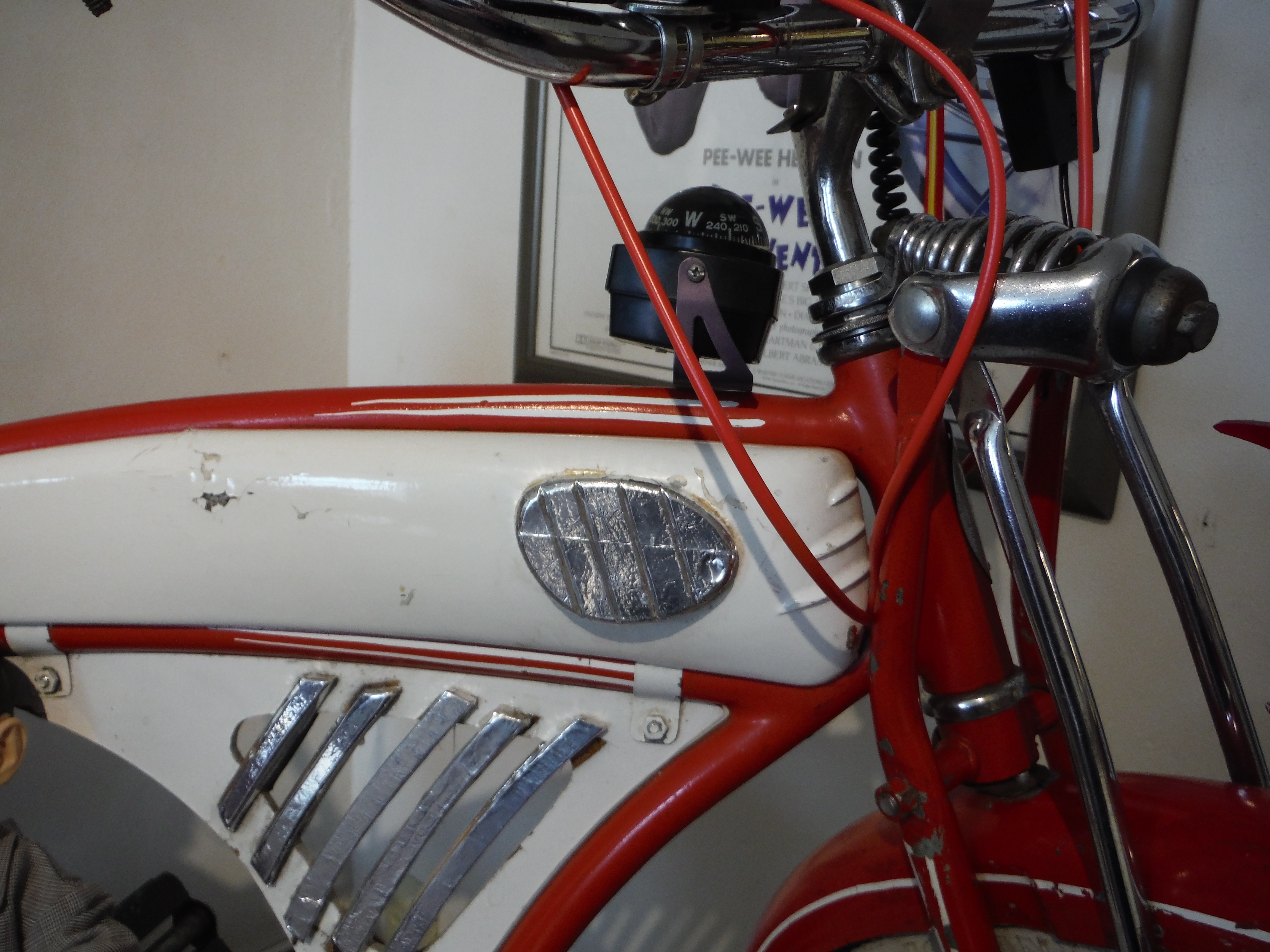

Billy.....I just realized that your picture of the bike was taken after I restored it for the museum. Nice. I need to get over there and visit the old girl again.
Hey Droidboy, yes, I threw that pic in for comparison, I'm in Indiana, so I made the pilgrimage to see the the BMA bike, because I'll probably never make it to California, so I went and documented the Ohio bike for myself, to see it in person and see how it was put together, and being able to get the information without guessing and looking at screen caps was well worth the price of admission, Becky and everyone who work there was great, they let me do whatever I wanted except take it out for a spin, I'm glad you were able to make it "whole" again and restore some of it's former glory, so everyone can enjoy it for what it is really suppose to be, instead of just a beat up old prop with half the parts missing.
