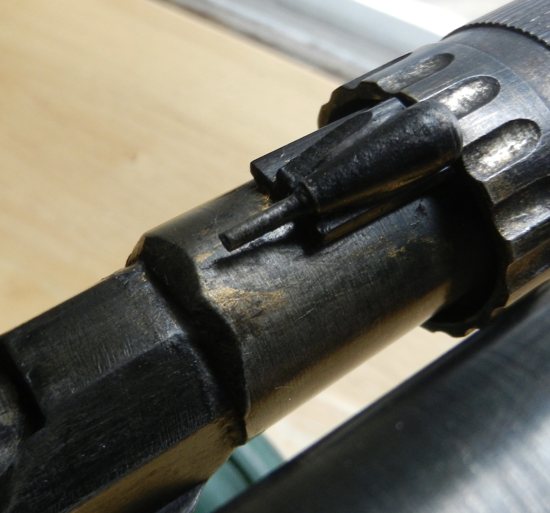

Also stuck on the sight greeblie/t-track. I simply cannot decide what it should look like! I feel like K-Pax came closest, but his is a little weird looking and arbitrary. It seems to "match" what few reference we have, but also doesn't look like something the prop team would actually have done, since it's so cut down. Alternately I could just do the simple bevel like Scottjua and many other folks do.
So, I'm soliciting suggestions and references. What did you do with your t-track? Are there any pictures I haven't found that might help? (not likely hahah!) I feel like most of the base of the track is there, in some of the studio promo pics you appear to be able to see it sticking out a bit when looking at the blaster pointing up from the underside. What to do???

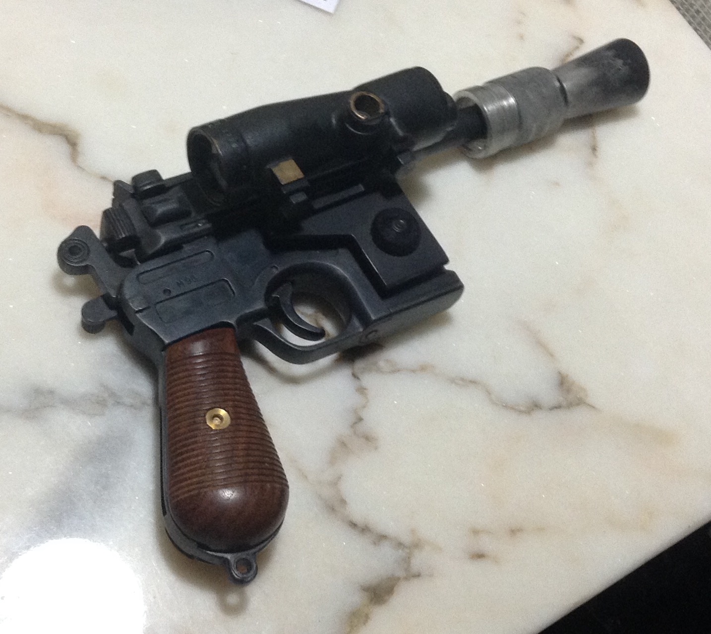

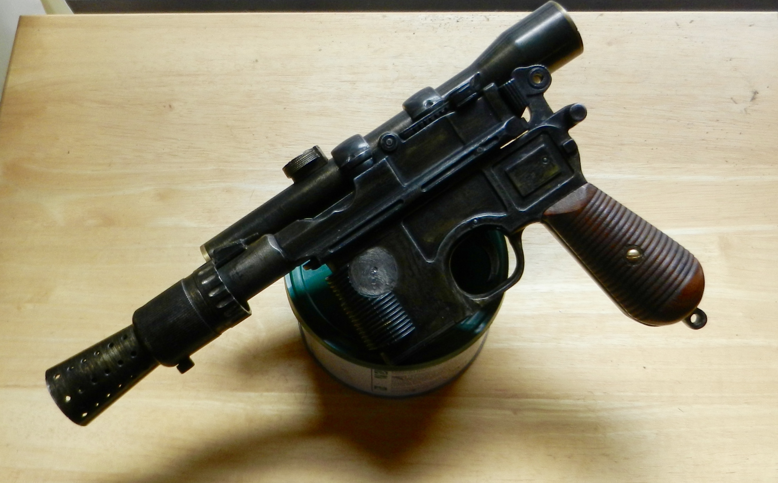

Also my Han ANH blaster, with weird grips from india. Greeblies too
I have recently painted my ANH blaster with black rattle can over the blueing.
Also, the left grip fits better than the right on my ESB blaster, but they're walnut and beautiful!

What you did with your sight greeblie is on of the options I'm pondering. I can't decide if I want to go that way, I till feel like there may be something else going on with that sight...

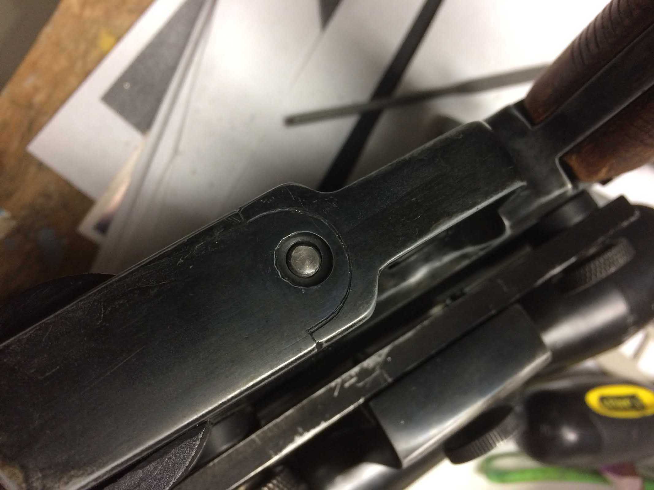

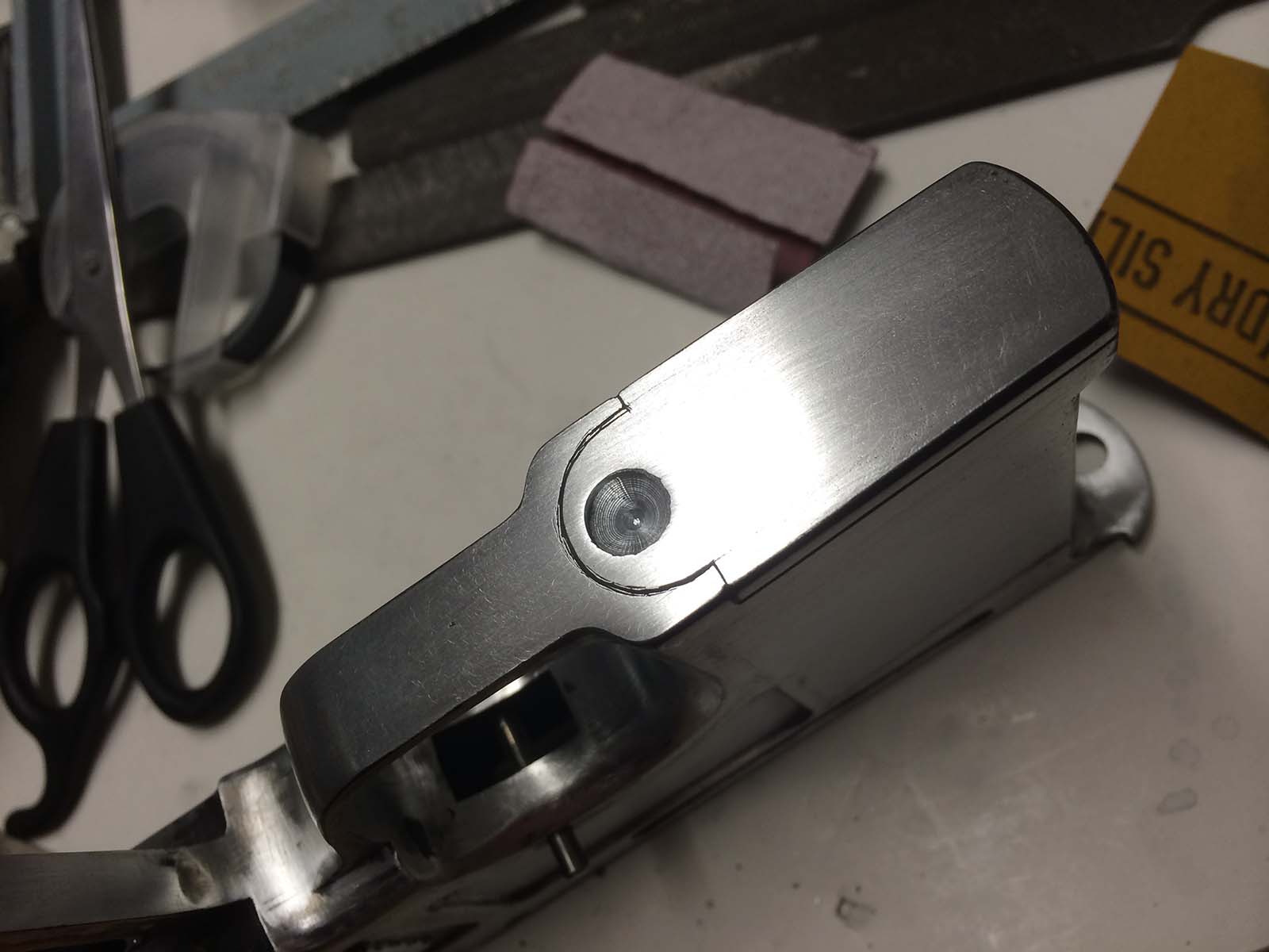

Finally getting back to this thing, having spent too much time and money on lightsabers recently! I've finished up the release button on the bottom of the mag well. I chucked a bolt I had laying around in my hand drill and ghetto lathed the threads off with a coarse flat file, then flattened the tip. Sawed off about 4mm of this and drilled a hole in the Denix to match. A light treatment of Aluminum Black to darken it a bit and we have our button. Don't know why I was stuck on this piece for so long!
Incidentally, I bought a cover plate from a real C96 on ebay for $6 for grins, thinking maybe I can fit it to the Denix. I may not bother trying, the real plate is a near perfect match for what I have, both in color and shape, minus the missing alignment thingie at the front. Maybe one day I'll brave cutting up the Denix, but for now I'll call this part good.

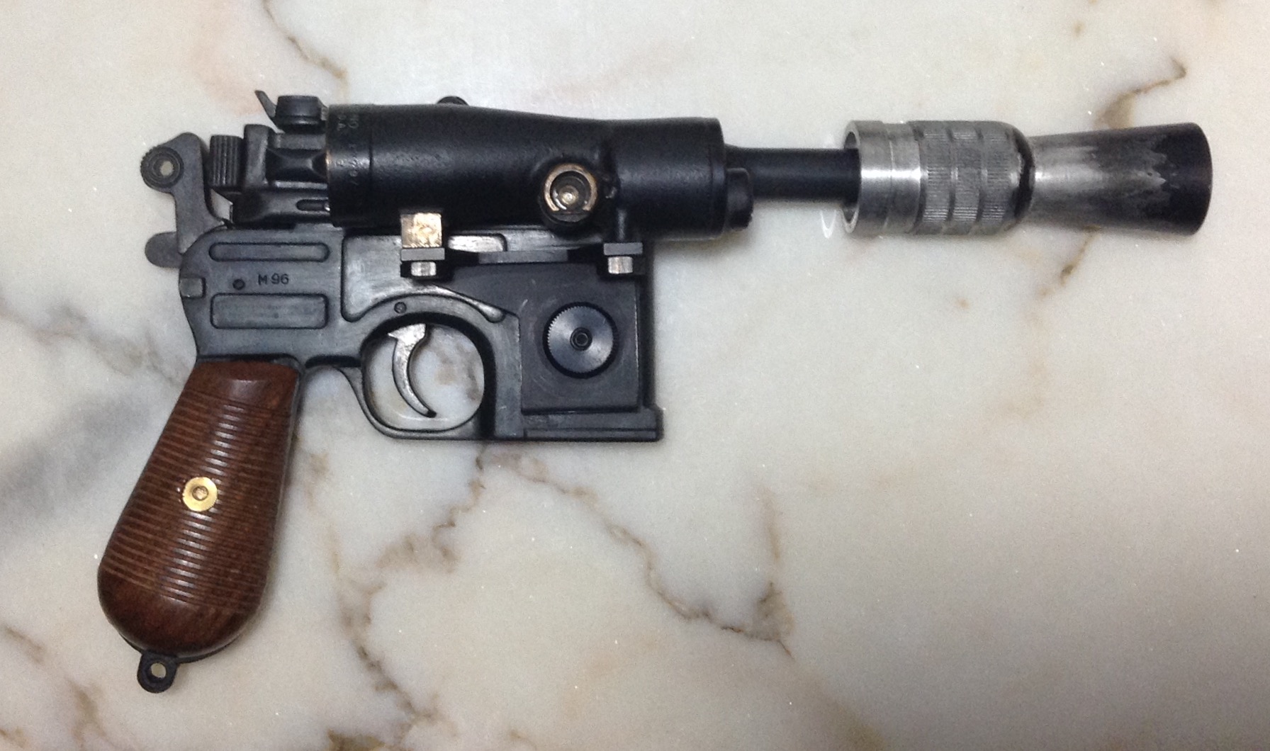

I'm also fiddling with the front sight greeblies, pondering the possibility that the t-track may be beveled at the front not the back! I posted about this in the DL-44 mega thread, feel free to post your thoughts there. For now I'm going to go with the standard Master Replicas style rear bevel, but here's a pic of a hastily mocked up reverse bevel for fun. This greeblie will be attached with double sided tape in hopes that a decent photo of the real thing will surface some day.
The last big hurdle is coming up with some decent grips. Here's a grip I got from Numrich compared to the Denix wood grip. These are a no go and have been returned. I really want accurate grips with the correct number of lines! I'll keep digging and stick with the Denix grips until I find something.

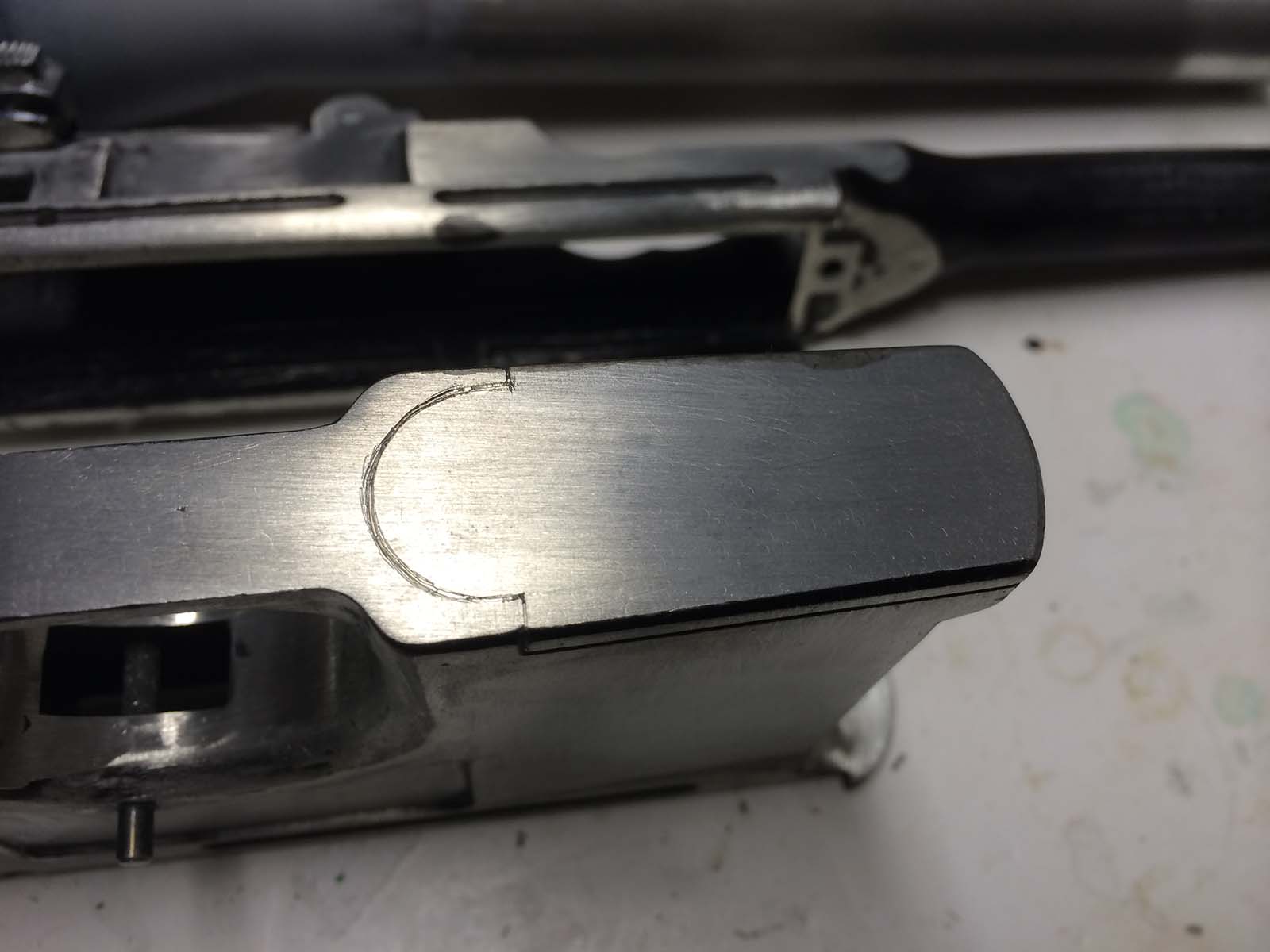

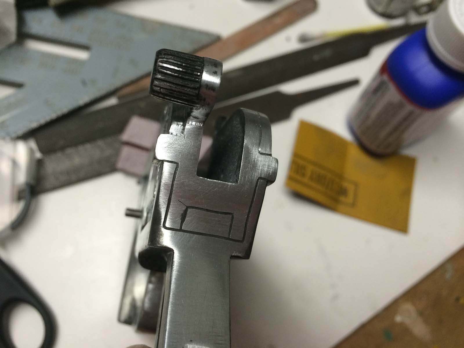

The Denix is also missing the magazine cover detail. I scribed this in and drilled a countersink for the button. Scribing this stuff is a bitch! I started with a very sharp scribing point and enlarged the lines with my trusty Tamiya scriber. The rear end of the upper is missing a bunch of detail where the real gun would come apart. I wasn't brave enough to do what Lukesfather did on this amazing build, but instead scribed a simplified version of the parting lines. Did I mention scribing pot metal sucks? I have 1 nasty miss that was too deep to remove but I think it came out ok.

First off, great build. It's been great reading through your thread.
Regarding your scribes, did you use a template or was it all freehand? You did a really nice job there.
Thanks! No freehand work here, I'm too old. ;) I used a bit of a d-ring holder temporarily glued to the blaster for the mag plate guide. The lines on the back were guided by label tape, which is my goto straight edge for scribing. And I STILL haven't finished this thing! The grips are the holdup, I just want something better. And I missed a nice set of real ones on eBay this am, argh!
