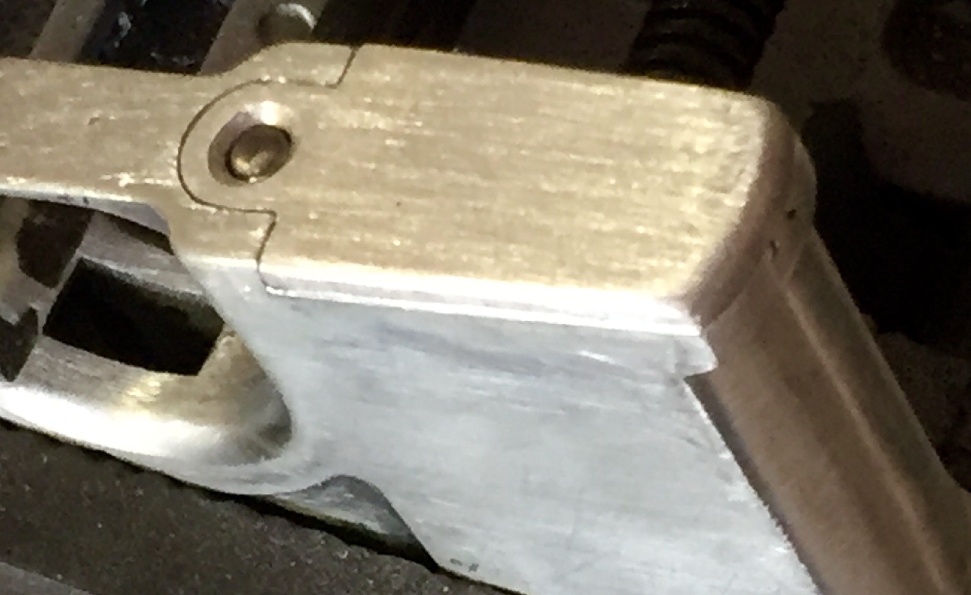

I had already started to sharpen the details on my Denix , and i figured it should be possible to add some detail to the backend also.
Enter the hacksaw !! I cut out the whole rear , filed off the fake tabs on the side and cut notches for the new real tabs .
The new part i cut roughly from a block of aluminium , and shaped with files and a Dremmel tool .
This is about as far as i got this morning , its still a lot of filing and sanding left , but even at this stage im more happy with it than it was before.
Next i'll shape a new safety knob , and maybe make it so that it can move.
The hammer is also a question for later , keep and reshape or just start from scratch ?

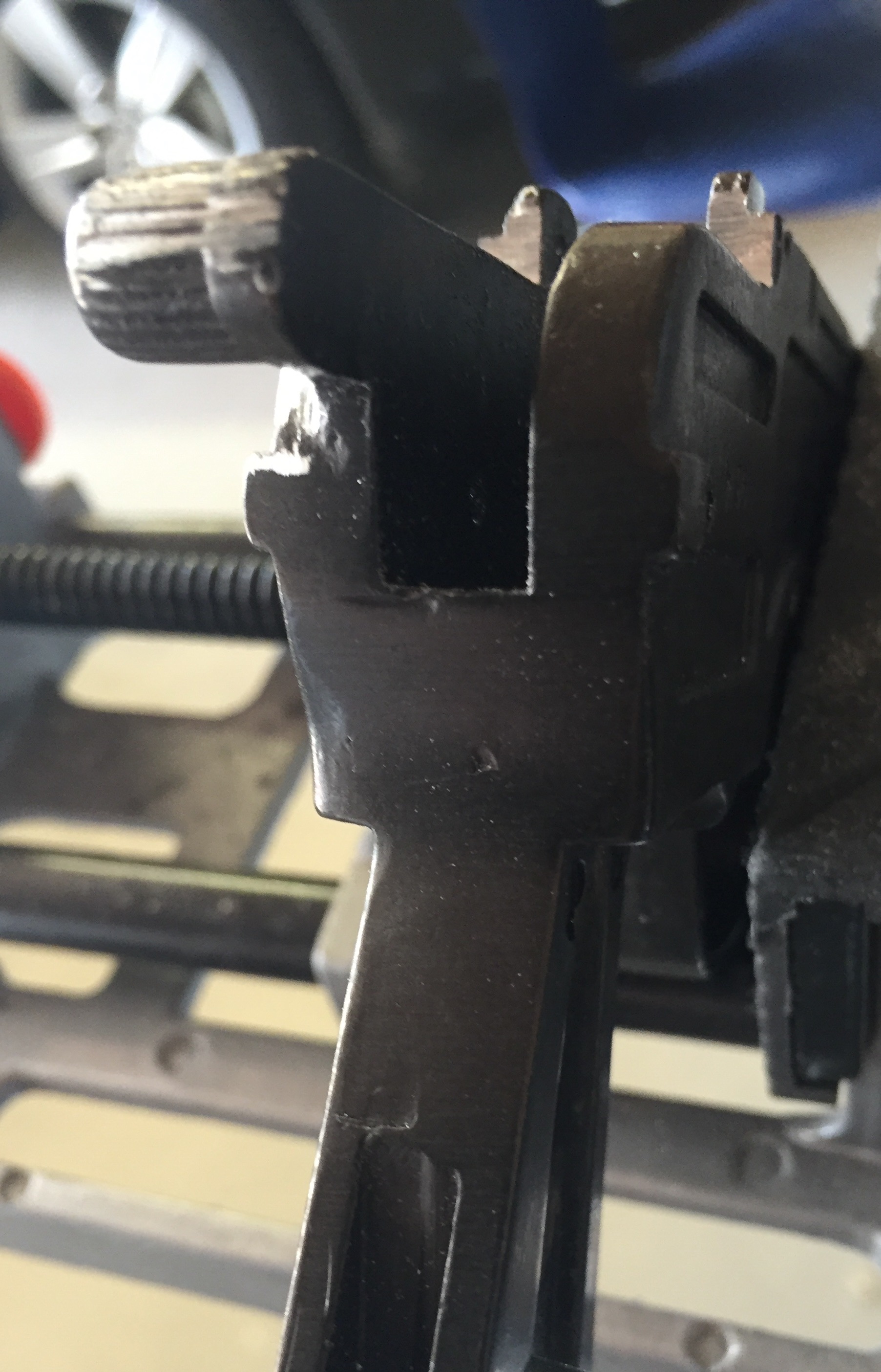

started shaping the hammer , its to low ,but has anyone tried to move the pin a few millimeters higer ?
will that affect the function of the mechanism ?
Re: Denix getting a nicer booty
It is difficult to drill a hole straight that is not completely outside the original hole. And the original hole would have to be filled.
Yes, you would have to alter the mechanism. The latch slides on the bottom. Either elevate that bottom or make the latch thicker.

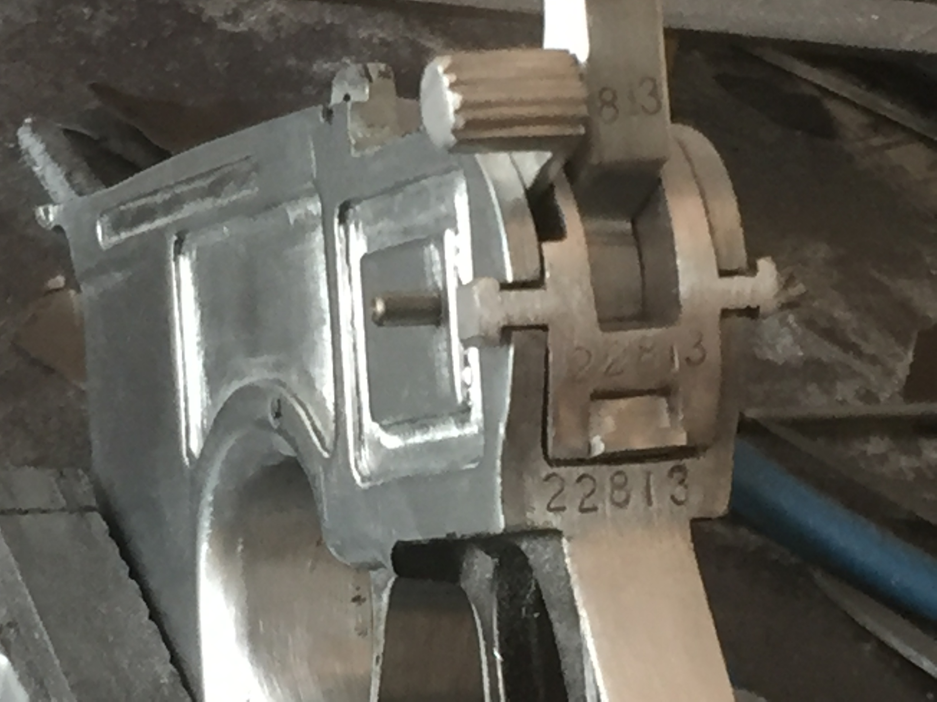

image.jpegSo i got a tiny bit done today also , made a new safety knob and cut a slot for it , now it can move
it does nothing , but at least its not molded to the body of the gun :)

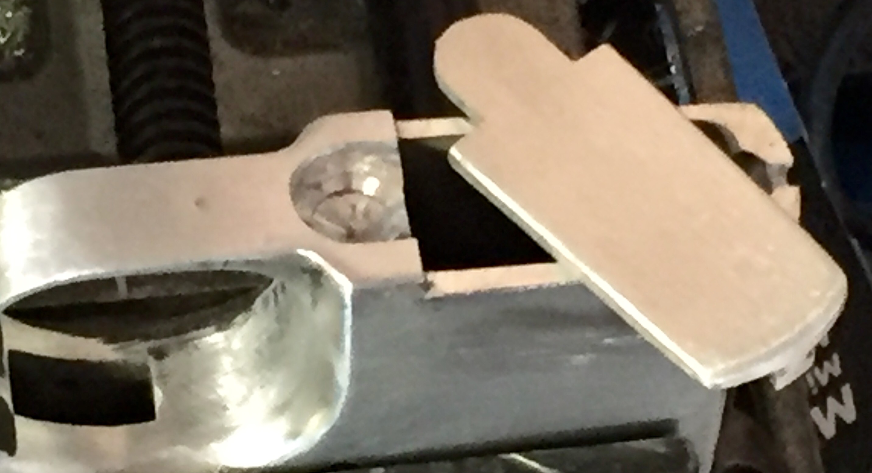

Then it was time for the bolt . This one lacks a lot of detail , first thing was to machine a slot for the tab on the top ( dont know the term for this piece )
looking at a lot of pictures of c96s i noticed its quite a few different versions around , so i went for a average solution .
it comprised basically of radies and straight lines . So i marked up the center of all five curves an drilled them out with a 4,5mm bit , then i cut the lines with a cutting wheel on the dremmel , a little inside the lines .
Then changed to a router bit , put the bolt in a vise vith a hard metal ruler alligned with the lines i wanted an used the router to grind down to an exactish line , not gunsmith finish , but not to bad either.
made the tab from a piece of aluminium , and fit it to the slot i cut .

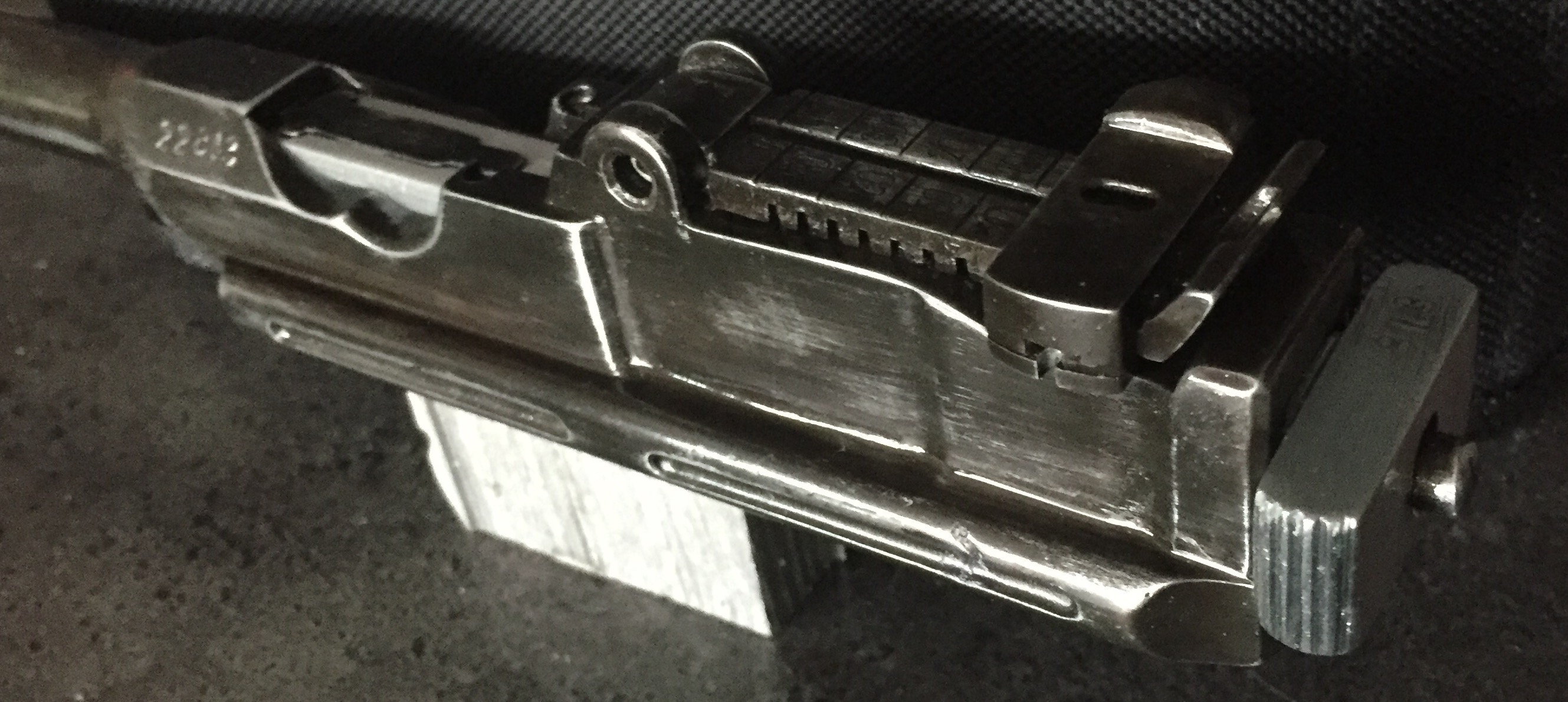

First try with aluminium black , that stuff is just magic , brushed on with a spunge it turned the parts black in a second , encuraged i had to try it on the whole upper , that is now basically finished , and here are the results ::

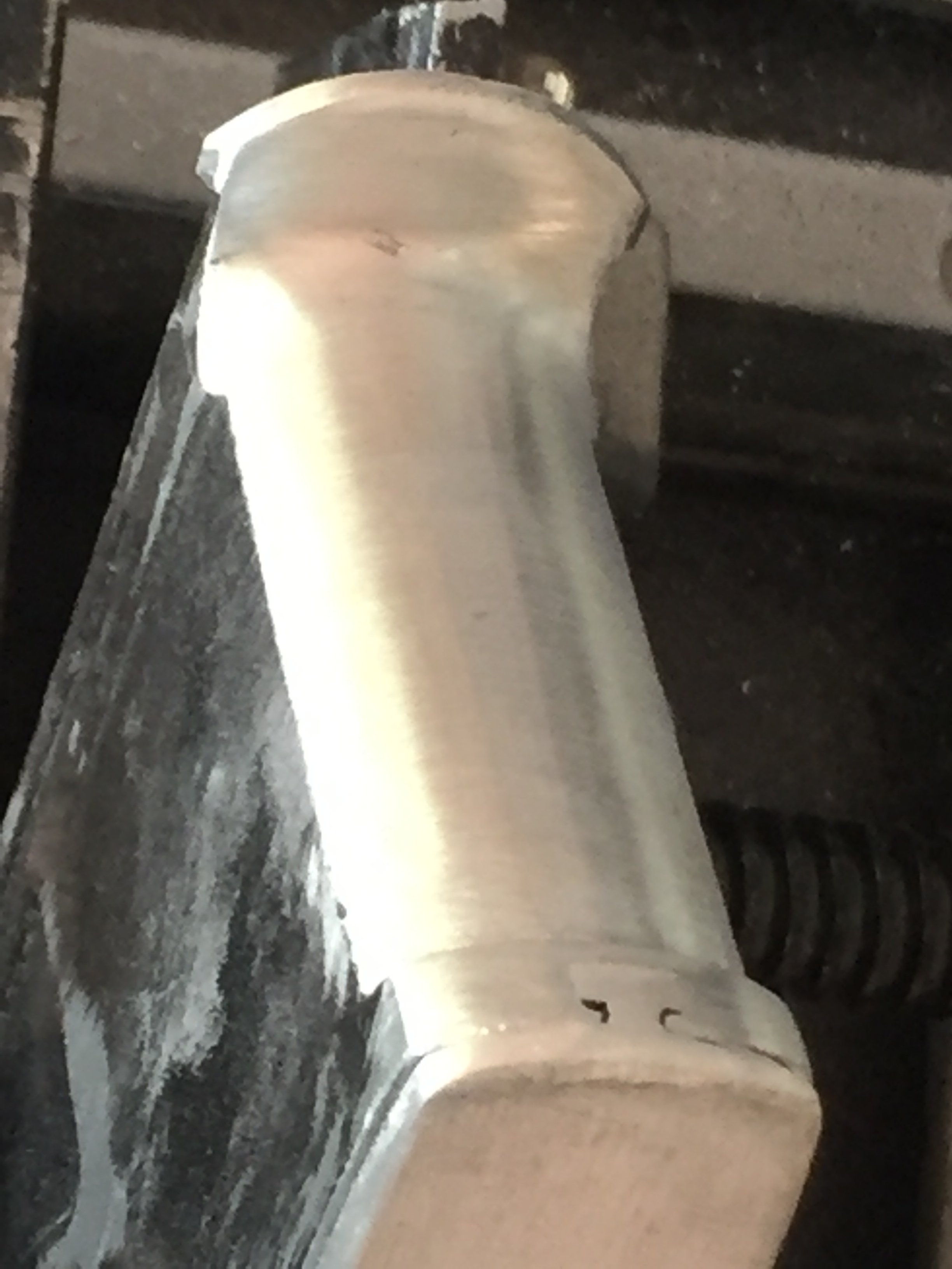

time for the mag bottom plate , figured i might as well make one , so i drilled out the profile of the curve of the new plate first , then cut away the fixed bottom plate , and filed it even , cut a slot in the front for the tab holding it in place .
the new plate was made from a 3mm sheet of aluminium , just filed to shape , after the fit was pretty good i folded the front up 90 degrees and formed the tab to fit the slot i cut in the gun body .
then i drilled the hole for the locking tab with a 5,5 mm drillbit , and widened the hole with a 8mm drillbit just by turning it with the fingers to make the slanted edge around the release tab
the tab itself is just a 6mm screw that i rounded with my dremmel and epoxied in place .
pretty happy with the result , still som finishing up with 400 grit sandpaper but its shaping up now .
