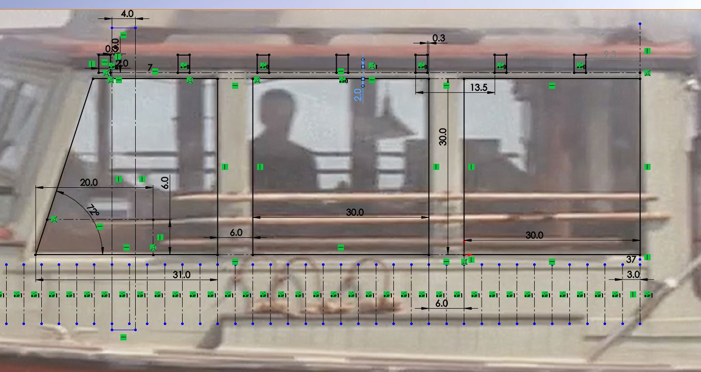

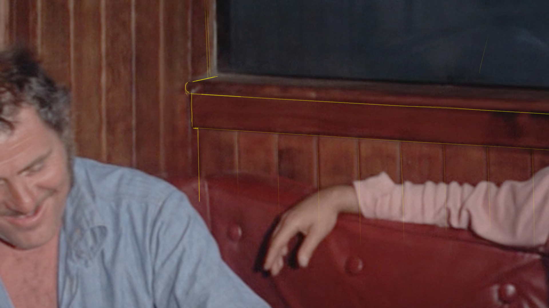

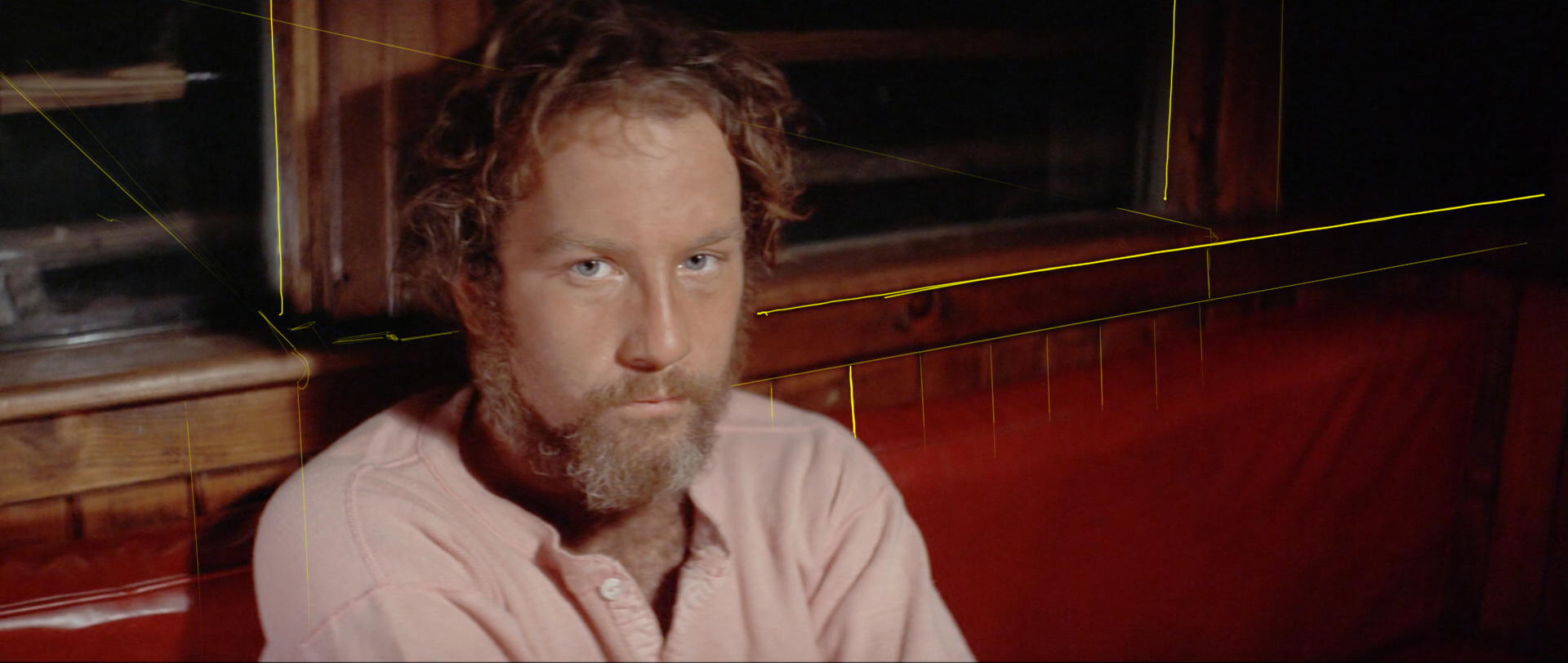

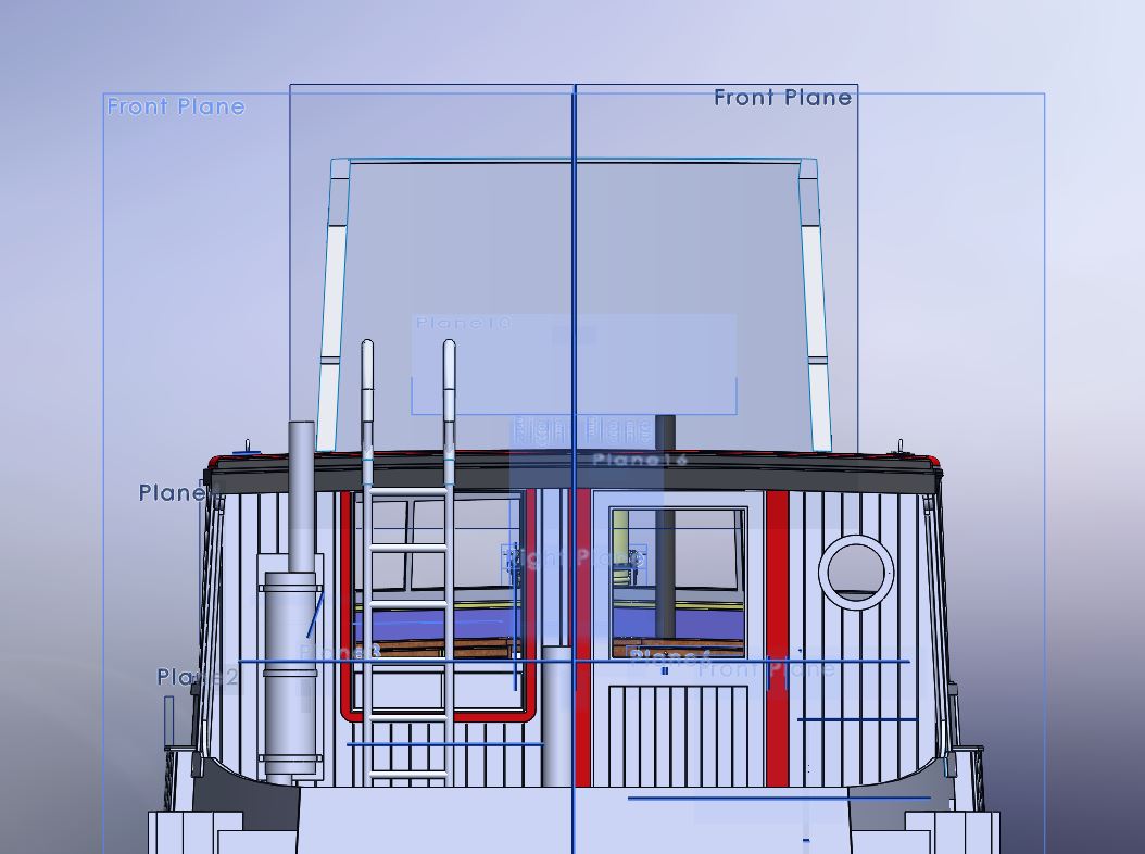

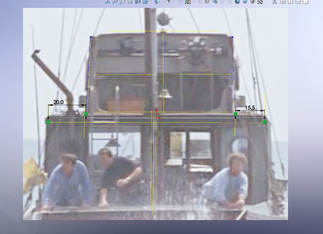

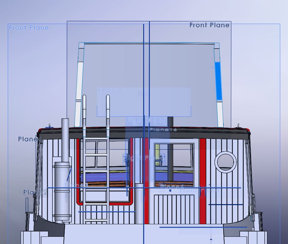

it been kicking my ass going back and forth getting the bridge to fit my original bridge was almost right just a little to high but if the planks are 3 inch's everything else is OK. fitting it on my cabin model though doesn't line up until I thought perhaps its not line up on the center line.
why would they do that but I found a screen grab with a long lens ( low perspective ) just to test my theory.

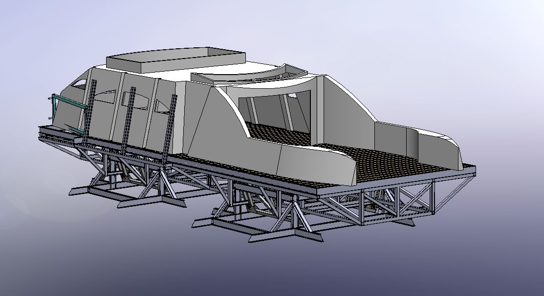

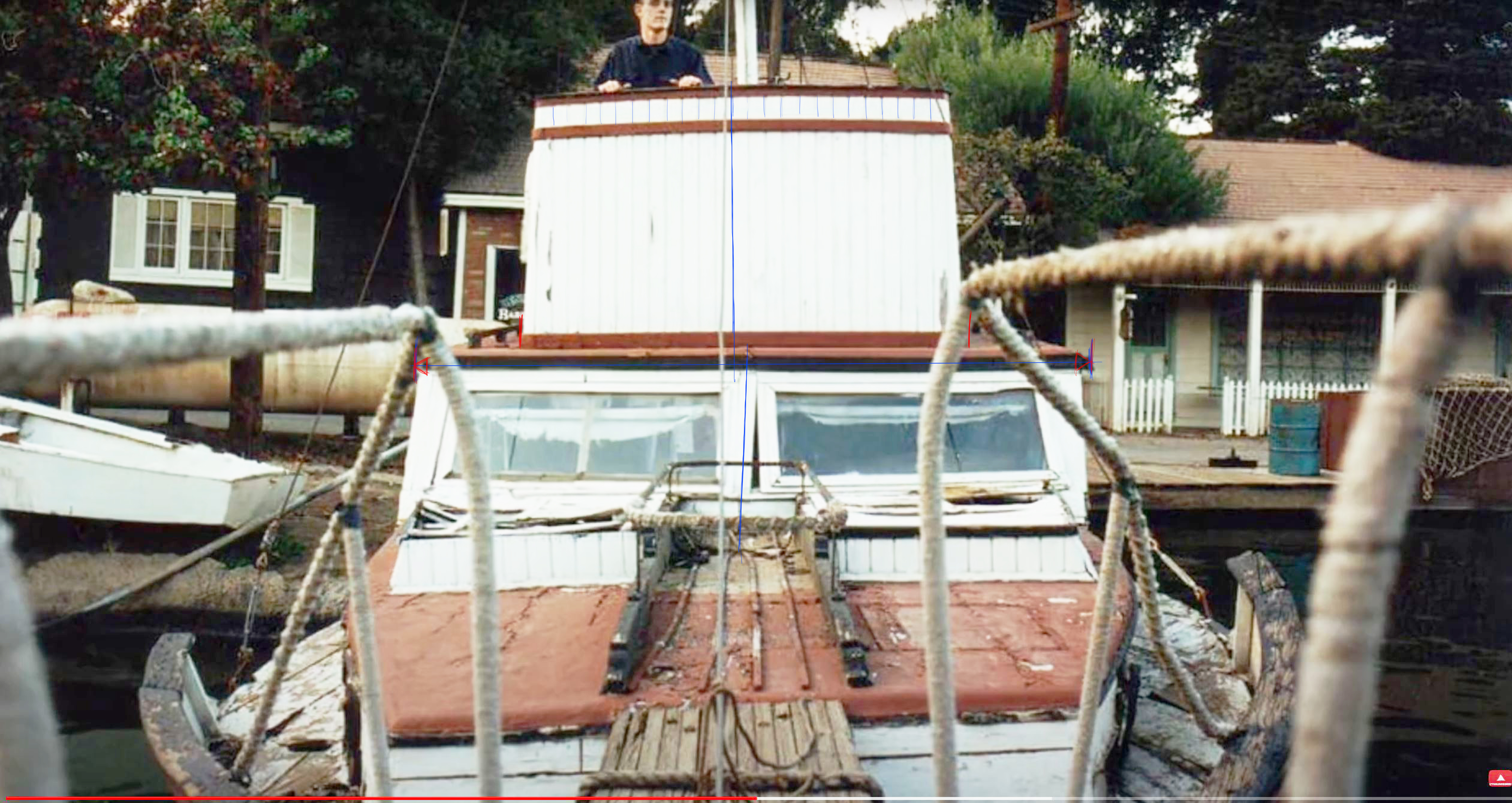

now I've notice the fly bridge not being in the middle I can stop noticing it, it defiantly is off to one side and explains why on my first build the roof looked so wide as I was only taking dimension form one side.
look at the distance near Hopper foot.
now look at the amount of space there is for all the poles. and the black cercal is paints to one side. It might have been a practical thing to counter weight the mast being off centre on the other side.

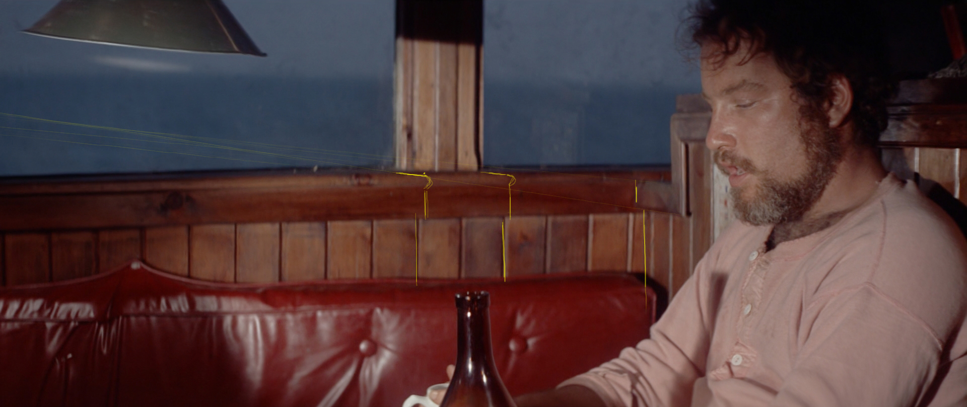

Indianpolis speech scene -
Re-watching the scene tonight, I don't think they used a mockup of the cabin. There's too much detail. It looks too cramped (like they couldn't remove any walls). You can see parts of the boat showing outside through the windows. If that's a mockup set then they went to a lot more trouble than necessary.
I was flipping through the photo gallery on the DVD. There's a single B/W photo that's hard to make out, but I wonder if it was during the filming of the Indy speech scene. Or at least during the prep work for it.
It looks like the Orca (#1) secured at a dock, with some of the left-side windows blocked off somehow (tinted darker?) . There's a big sheet of glass sitting vertical in the rear deck (helping to block light/wind into the cabin?)
I suspect they probably filmed the Indy scene during the daytime and darkened the windows. It would be more convenient than trying to stay up several nights to shoot the scene. And when the cast/crew comment about Robert Shaw's drunkenness during that scene, they seem to refer to "the first day" or "the second day".
A daytime shoot was probably the only way to keep the outside (ocean) horizon visible through the windows. If they had really filmed it at night then the interior lighting would have blown out the light levels and made the world outside just look black.
During the scene, when the shark starts ramming the boat, there's a shot where Dreyfuss is hanging onto the steering wheel and Scheider falls back through the swinging doors into the front hold. The front window looks much darker than the starboard side windows. Possibly more evidence of tinting/blocking off the window light.
