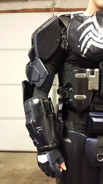

To attach the shoulder bells, I marked off two spots on each shoulder and punched in some large snaps. Since the undersuit material is very fine and stretchy, I had to put some extra fabric underneath the snaps to prevent tearing down the line.
Those snaps attach to a removable layer of faux leather. The underside of that material is pretty ugly looking.
Into that material, I had to sew in two t-nuts. The particular ones I found had holes around the border which were perfect for sewing into the doubled up material.
There is one on each side, two per shoulder. They hold the bell to the leather. On each side of the nut I used a rubber washer. Those allow me to screw into the bell without scratching it.
Here is what it looks like attached to my shoulder. Pretty hard angle to photograph by myself, but it'll do haha
The weight is supported evenly and feels secure when I move around.

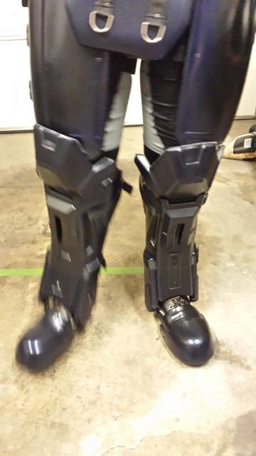

The shins and thighs. Thighs sit lower than I like, but that is due to poor planning on my part. I've padded the knees a bit to keep them from klonking into the thighs too much.
Mid section. The crotch plate has a tendency to catch on the thighs from time to time, but that's because I'm not very wide. A 30 inch waist doesn't leave much room!
Some upper details

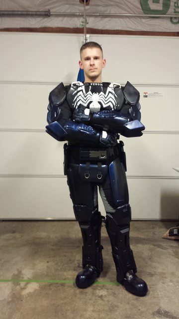

This shot is just everything fitted to me, minus the rucksack. I'm very pleased with the look of the armor under the lighting.

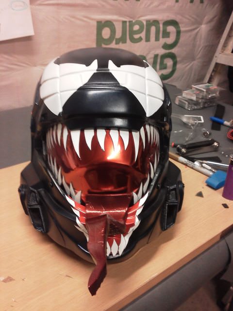

Helmet
Helmet is done as well. I settled on cutting my own deals for the teeth. Vision on the visor is not impacted at all honestly. I debated pretty long and hard about painting on a small thin pink gumline with some green spit\slime but decided against it- this looks cleaner.
Wait, there's more!

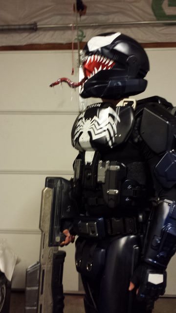

Venom is really known for his super long tongue. It occurred to me that I might be able to make that work on this build if I could make it detachable. So I cut out a section of EVA foam and bent it into shape with my heat gun, then plasti-diped it and painted it to match the visor color.
There is a small gap in between the visor and helemt, and by attaching two small strips of webbing to the tongue, I was able to insert it into that gap and the tongue is held in by friction. Here is how it looks.
I think it's pretty neat! I don't have a pic, but I took it a step further and added some hot glue to the tongue in such a fashion that it looks like drool- it's pretty creepy ;)

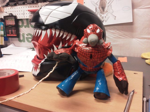

Feeling great by this point, and on a roll creatively speaking so I made a little spider man out fit for my grunt plushie!
I plan to zip tie him to the backpack during dragoncon :)

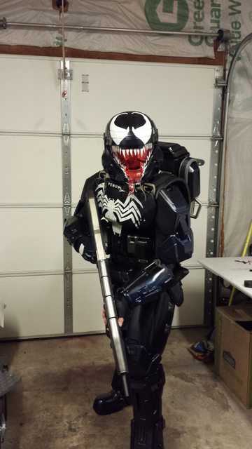

I put everything on and did a lap around the block- everything seems pretty good. Here are some images of everything on.
I love this look. My Fiance says its scary looking. Yay!
Here is a good one of the tongue with drool. I have two tongues- one with and one without. The teeth also *almost* look 3d here.
Not sure if I like the Magnum or AR more.
Here's one with the backpack visible.
WE SHALL BE LIKE POISON TO THE COVENANT.
WE ARE...VENOM
