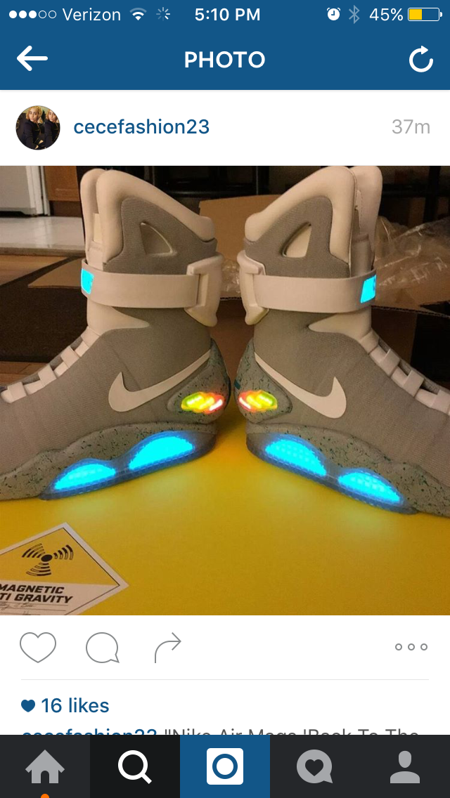

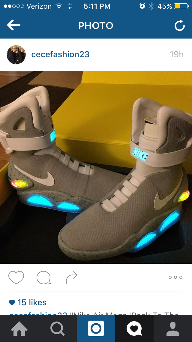

Can anyone verify if I these are legit ? I found this on Instagram ready to sell and have been negotiating for an hr and she said she'll

Yeah that sounds like a scam.....and a bad one at that. Why would she not want to send pictures when she already posted them all over her Instagram? Lol makes no sense.
Definitely a scam. C'mon man. Ask yourself, why would ANYONE sell these shoes for less than the going market value. Either they are worn and broken OR it's a scam....THINK McFly....THINK!
Sorry Biff I guess I wasn't thinking right. Guessing she better make like a tree and get out of here!

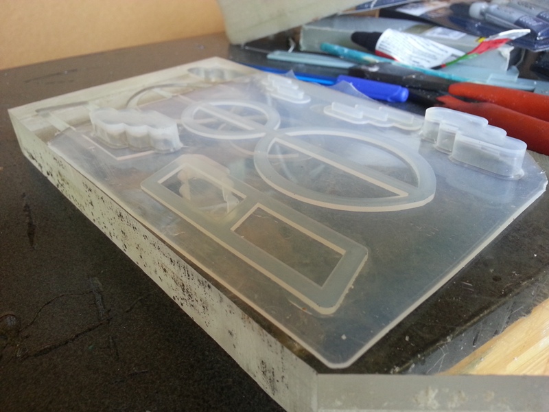

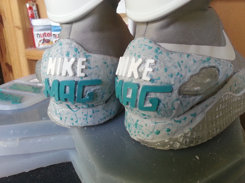

I posted this video a few days back showing how I was making the letters.
Here is an update on my decals and how I think I will be doing them from now on.
These were de-molded a touch early but are ready now.
