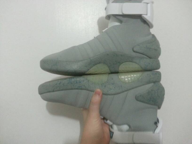

Jedifyfe, could I get you to post the length (or a photo) of your display against your wear pair (sole against sole) please?
I am just curious to know by how much (if any) the US10s are larger than the US9.5s.
If Jedifyfe doesnt get back to you let me know dude as mine are 9.5 and 10.

The bottom pair are an unmodified US size 10 vs my modified US 9.5's on the top.
Although there is not a great deal of difference in look there is a huge difference on how they feel on your feet.
