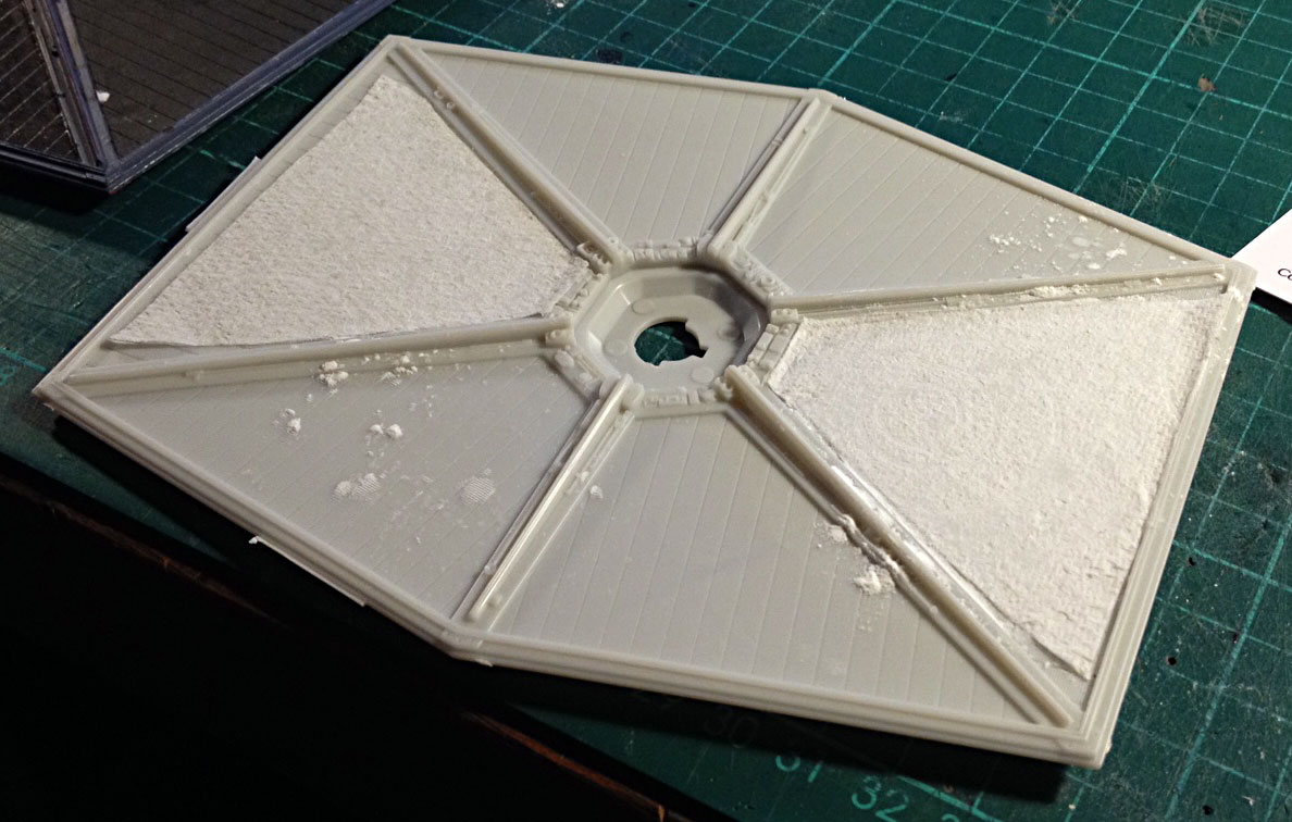

I was having trouble with the glue pulling away the paint on the spare tie wings that I had but then I remembered in my loft I had an unmade ertl tie kit that i never got around to building (Lets hear it for procrastination yay).
and I tried the process on one of those with no release agent.
I decided to paint the pva on to the wing first and then smooth it out with a ruler before painting it onto the strong tissue kitchen towel and smoothed that out with a ruler also.
Then I placed it on top of the wing being careful to push from the centre out to get rid of most of the bubbles.
I found it easier to put a little talc on top and smooth out with a clean ruler to make sure it was all flat. It dried on a radiator in about 20 minutes but you could leave much longer and it wont matter.
When I pulled it away it left nothing at all on the wing so no damage to the unmade kit. Like before, a quick coat of primer or it can't be seen really.
The top one was made before I realised that it was better to paint the pva onto the wing first but it looks quite distressed, it depends what you want really.

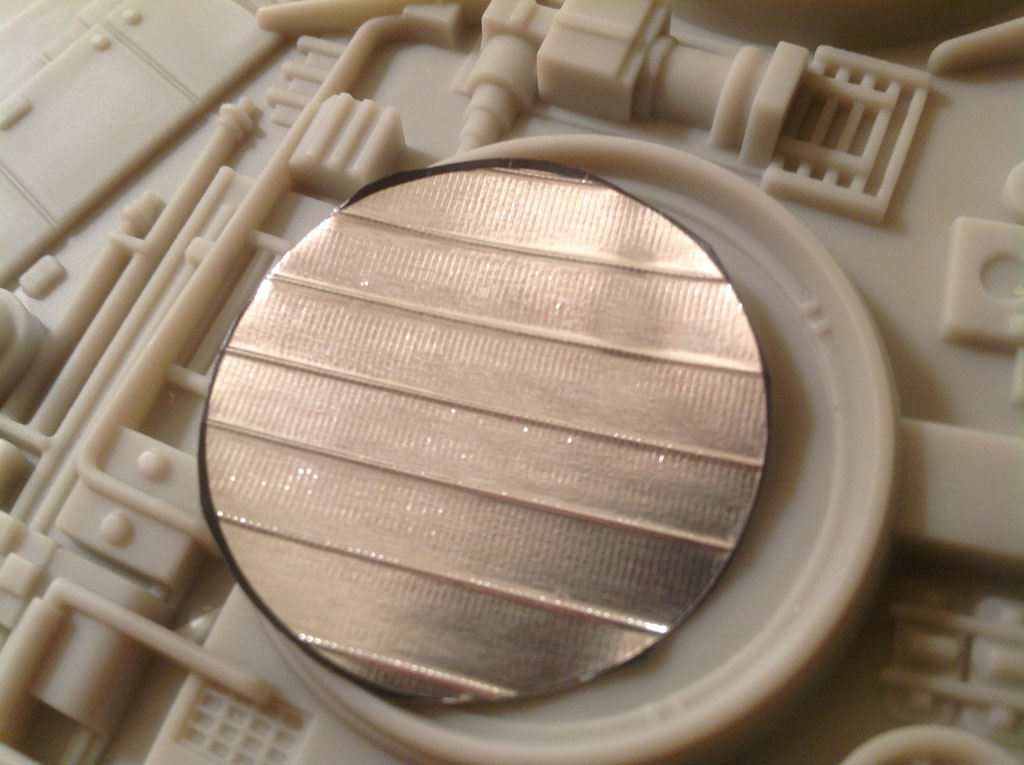

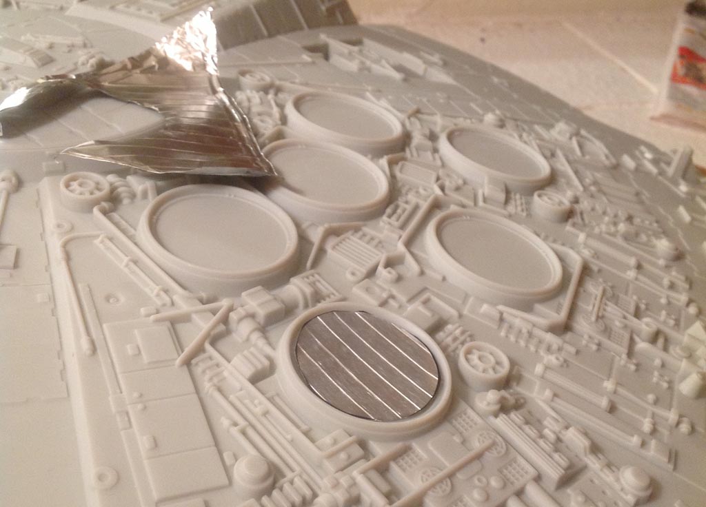

What I've messed with was Tinfoil. If you take the tie fighter model wing..then put some clean tinfoil on it, you can transfer a good amount of detail to it using a Qtip. My thought was...either some glue, or a thin layer of resin on the back side... that would do it...? Not sure...but tinfoil is pretty damn thin so its a good start. Since I have no resin handy..can't test that part just yet.
Update:
This is not glued in place..so its not in there snug yet..also there is a bit more details than comes across in the image(There are horizontal lines too -you can't see here)... Did a press test on it after putting white glue behind it...it did not cave in...kept its shape....
Anyhow..thats tinfoil engine vents :p

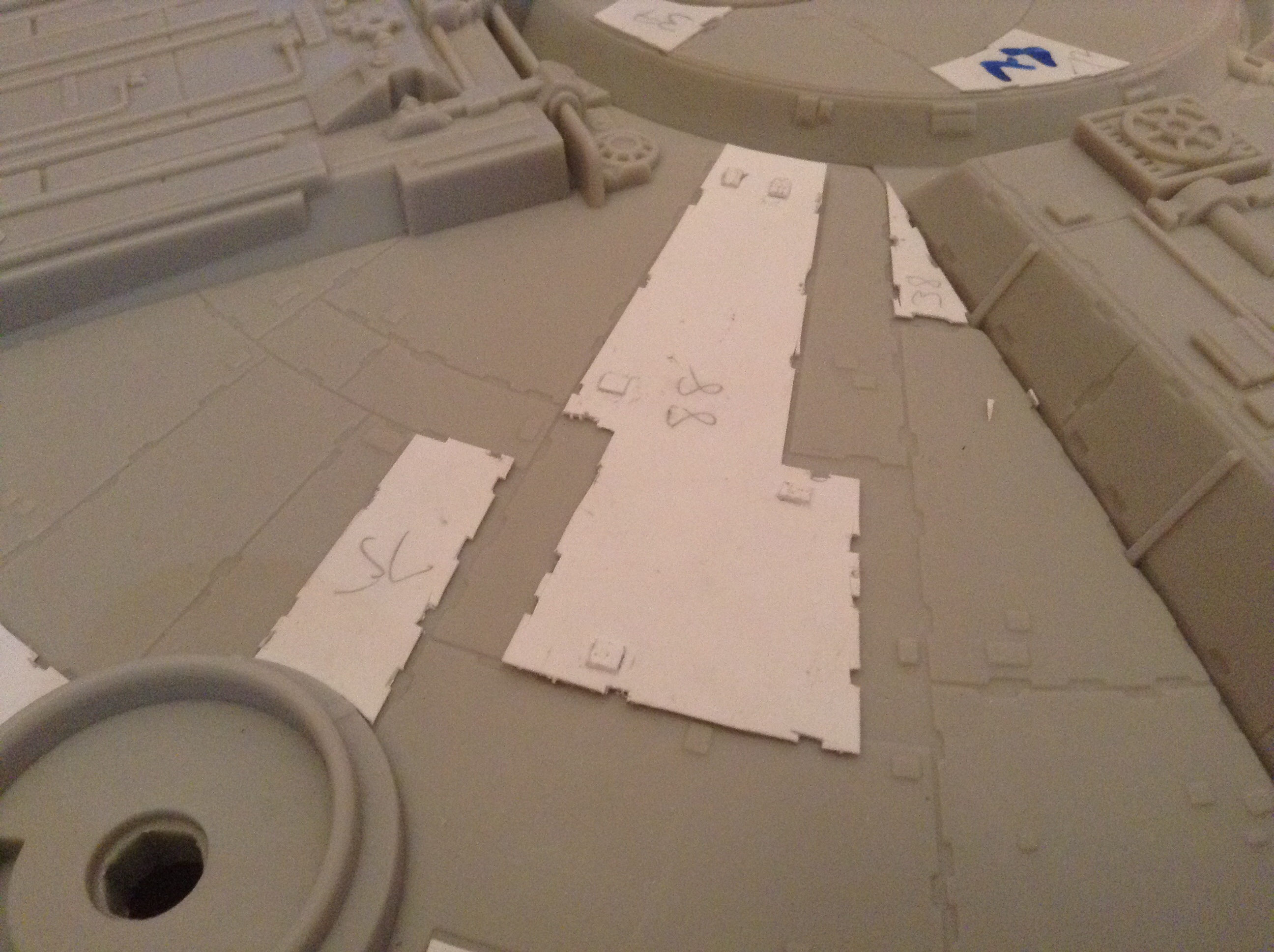

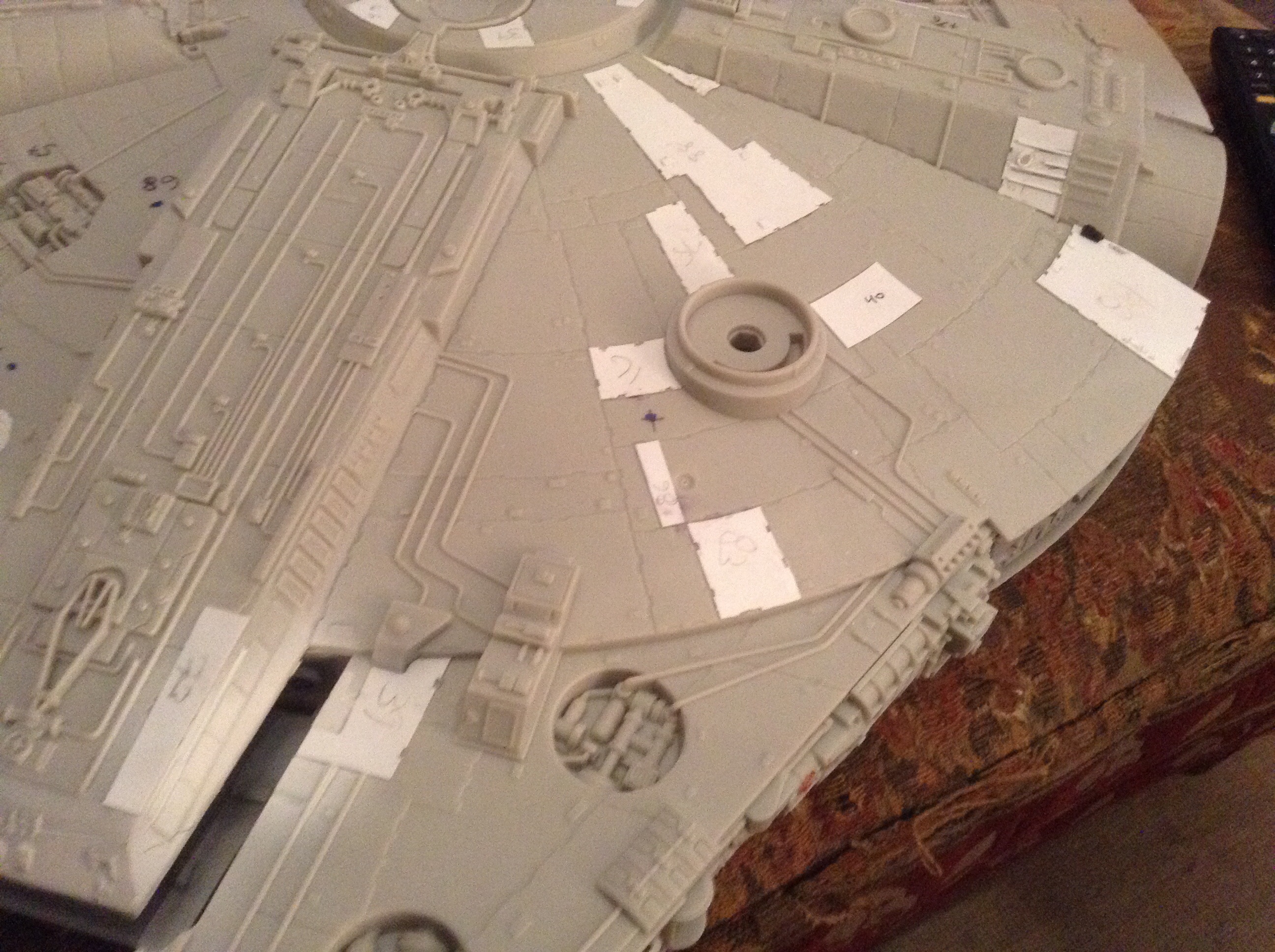

REMINDER - I have surface panel stencils
It's been buried in the thread several pages back so i thought I'd repost. I have a file that contains stencils of all the missing panels. They are printed in reverse. So you print them out on label paper and peel-n-press them onto .15 sheet plastic. Cut and past on the BMF. The results worked flawlessly for me. See pics
