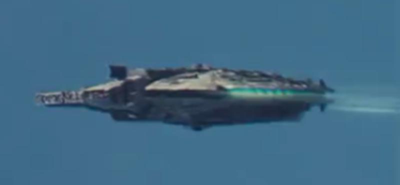

Its great that they've used both versions of the Falcon for Ep 7,......cant wait to see what she looks like from the front,.....whether she has the 5 foot F1 boxes or the 32' boxes
That will make an impact on mods for the Hasbro

So are we saying that this Hasbro toy could be the Episode VII Falcon just with a round dish?
No, sadly not...... the four ( & four on the underside) triangler vertical pieces on the actuator flaps on the engine deck are spaced as of the 32" on the Ep7 & Hasbro...., but the greeblies on the engine deck & the 6 engine coolers & vent grilles are of the 5 footer,...but the Hasbro are from the 32'....(there is a very small amount of the 5 footer greeblies in the Hasbro also, they are there to fill a bare space which is also bare on the 32")

Just saw the new clip! The New Falcon scene got my heart skipping a beat:) I do hope they complement it with physical Falcon scale model scenes and not just CGI all throughout. There is no mistaking that crabshell 5-footer basic shape and narrow sidewalls, though. Not a 32" hockey puck at all.

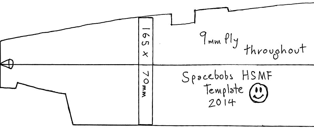

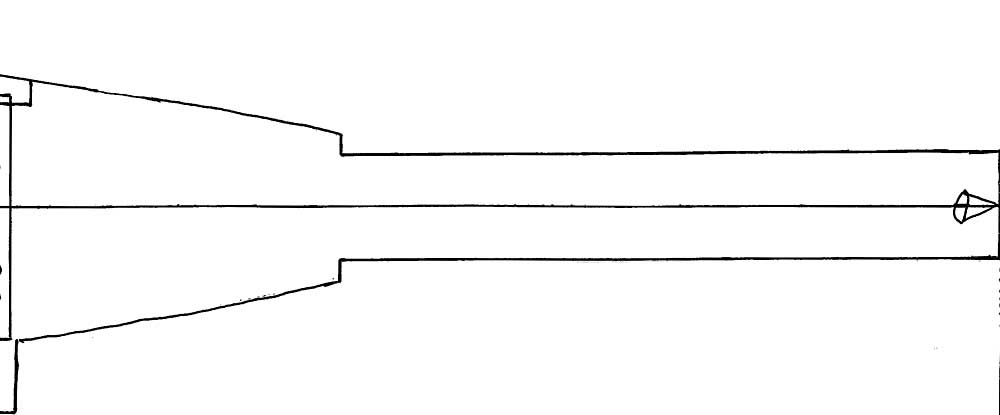

Ok here I have split the support template into three pics so they are easily printed on A4 paper,
you need to set the length of each image at 203.33mm in photoshop and print from there.
Sorry but I don’t know how else to do it as just printing them in windows only wants to fill the page.
Cut the middle one to the lines and then glue them together making sure the line in the centre is straight and the total length should then be 610mm.

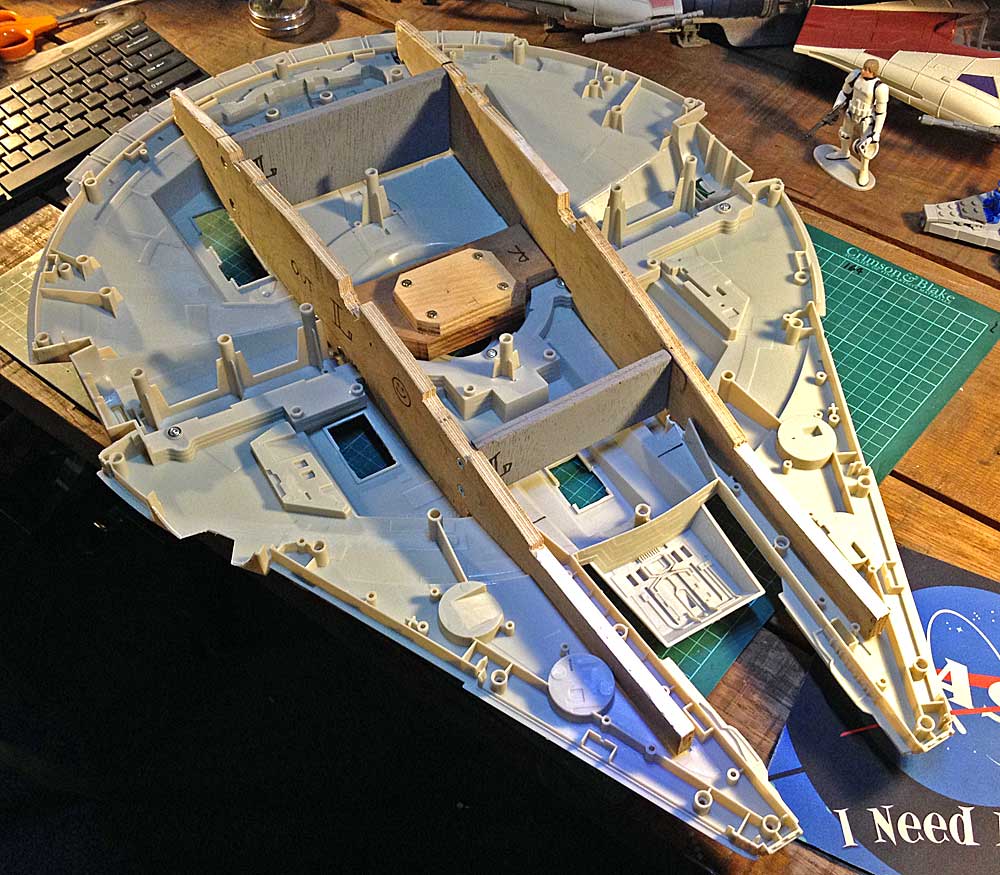

The plywood should be 9mm thick and decent hardwood “engineered” type, usually with 7 layers.
Fitting the cut pieces together will need two more bits of ply 50x135x9mm and 165x70x9mm fixed where shown on the template.
A few bits of plastic will have to be removed to fit the support inside like so.
If you are not going to cut the mandibles from the hull like this...
and will just be using the support for fitting to a stand, then you may be able to do away with the long straight bit at the front of the ply support and also leave the plastic strengtheners at the front by the mandibles on the bottom, changing the ply to fit there accordingly.
View attachment 410328 Thats a bingo :)

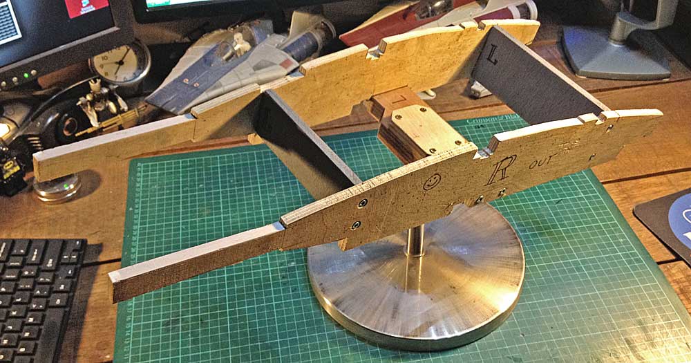

You are awesome. Thanks so much.
No if you want to make some money offer these with a stand in the JY :)
Thanks Jameth
I forgot to mention, I used a small band saw to cut this out but if you don't have one and have to use a jigsaw or even a hand coping saw and aren't to sure of you wood skills, cutting a mil or two inside the line, and putting a bead of silicone sealant on the edge before final fitting will work just fine. Better that than it being too big :)
