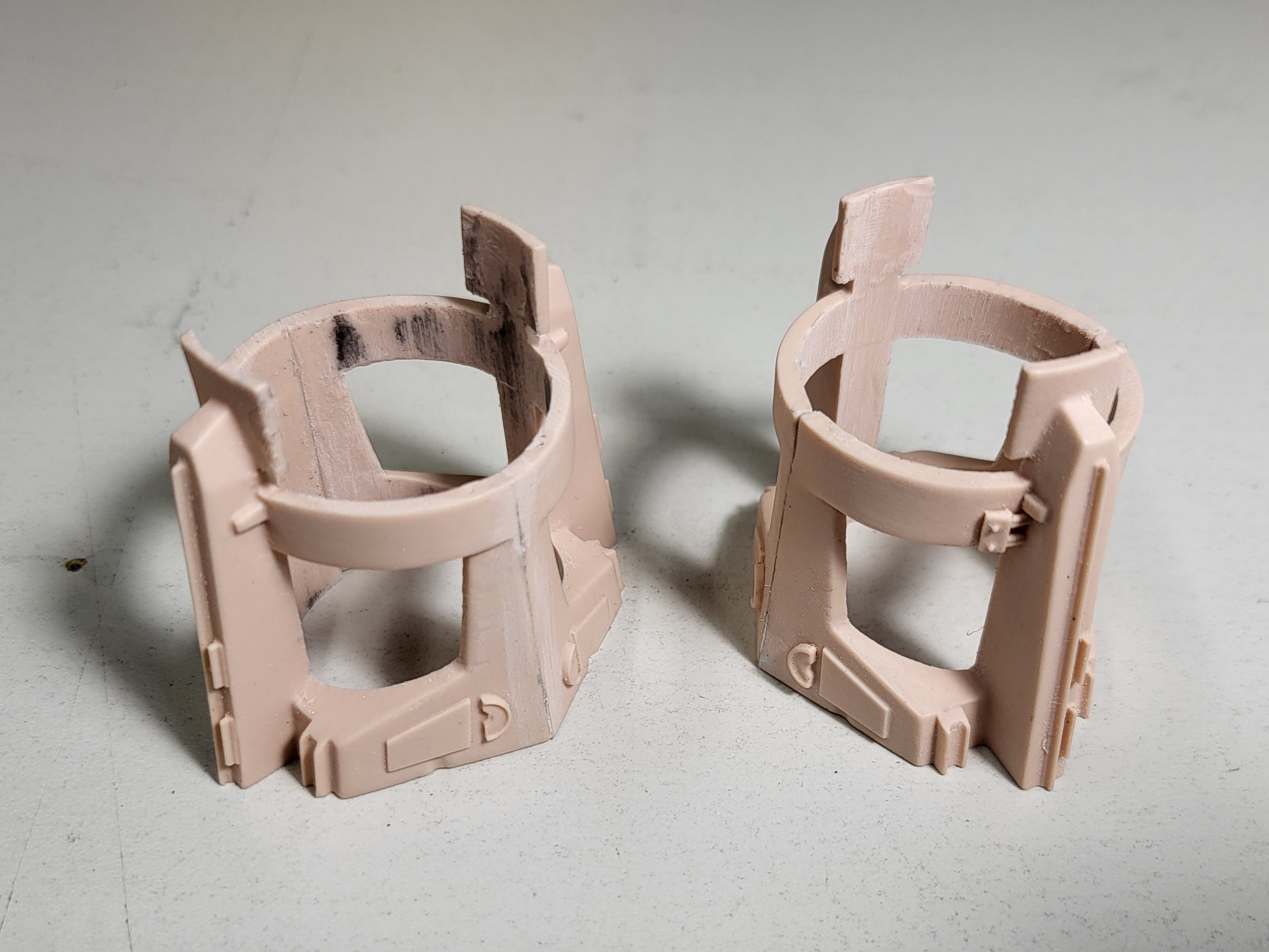

With a bit of irony, I cast my last parts for my TIE fighter. They happen to be the new version of the very first parts I made for my TIE many years ago.

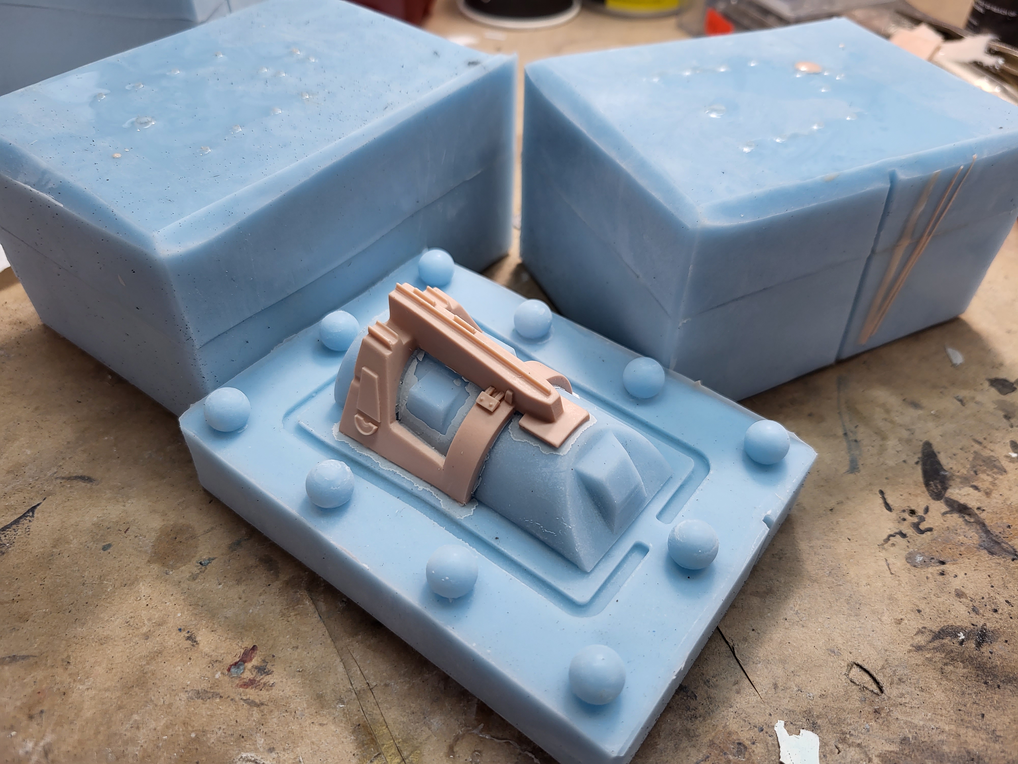

Beautiful mold once again :cool: :cool: :cool::notworthy::notworthy: I've noticed that your keys are almost completely round...no trouble "snapping" them into place?
Thank you!

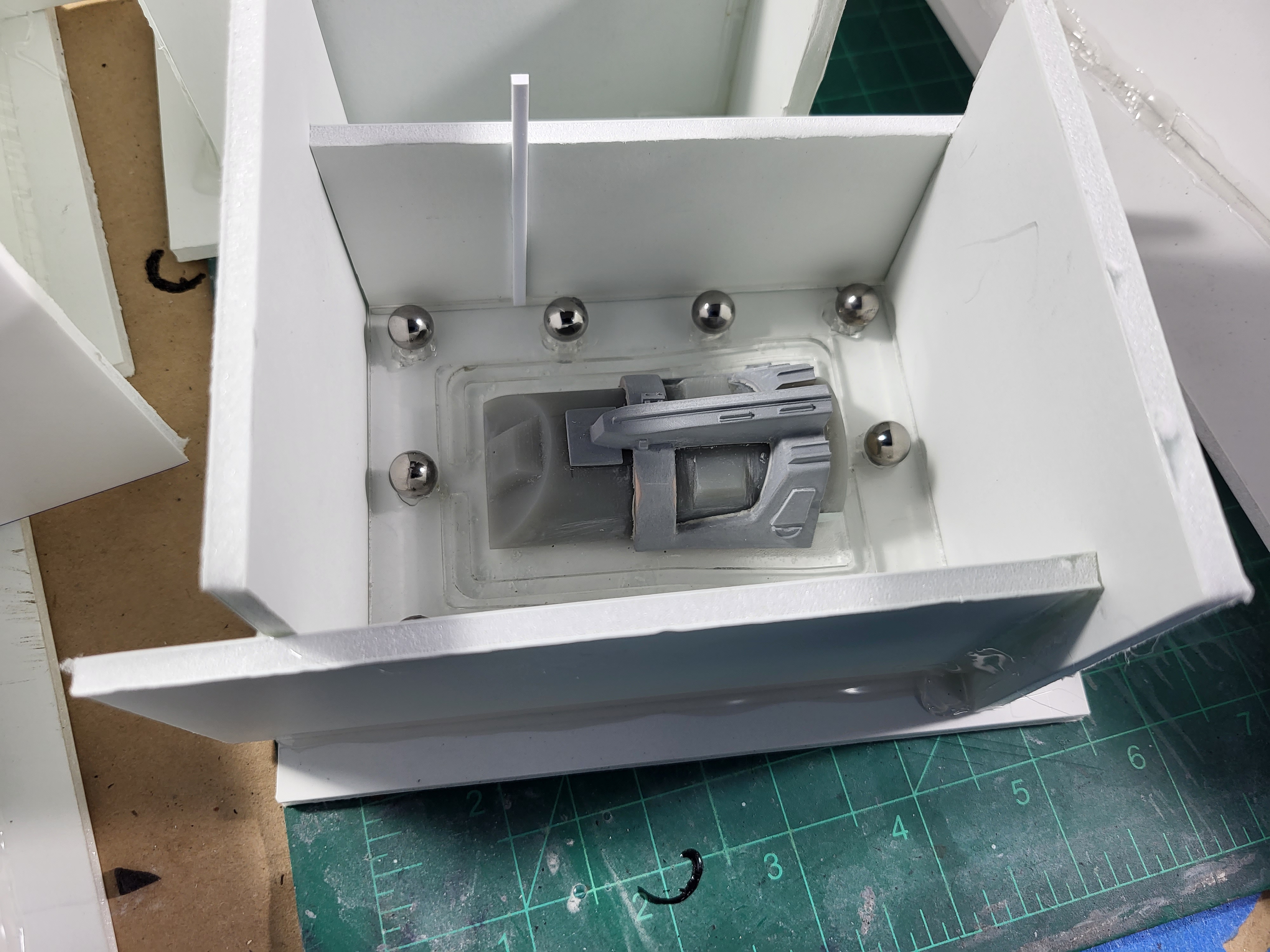

They are in fact round. they are (or were) 3/8" ball bearings. I glue them into a 1/4" hole so that most of the ball bearing is above the surface and then pour the rubber over them, creating a locking key. Since the rubber is pretty soft they just push right into the receptacle on the other side.

How are you situating your wingstars? Is it just one mold? If so how do you rotate them? 180 on the x or z axis?
Yes, one mold. I'm rotating them vertically? You'd think for someone who does 3D work and works on a mill I'd know Z and X axes better. Haha!
I'm rotating them so that the bottom is the same on the inside and outside.

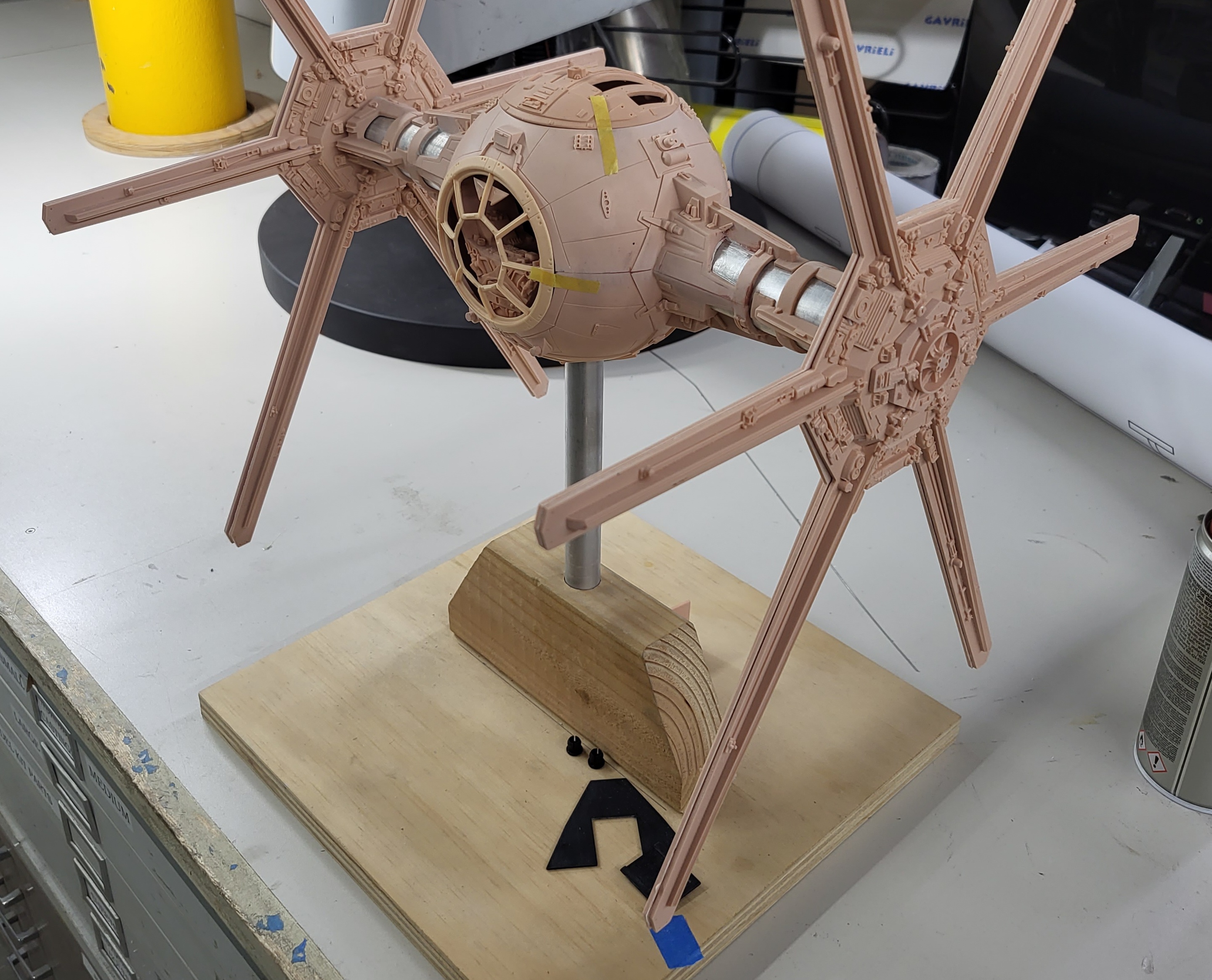

So I was assembling a wing yesterday, and as I got 5 of the 6 I beams on the edge of the wing I flipped it over to look at something and realized...I am now flipping the wingstars horizontally, D'oh! Oh well not a big deal. Looking at my references pictures they did it both ways.
I totally see why they switched the wing construction method for Empire, what a pain in the a**!! Cutting all the I beams around the wingstars sucks!

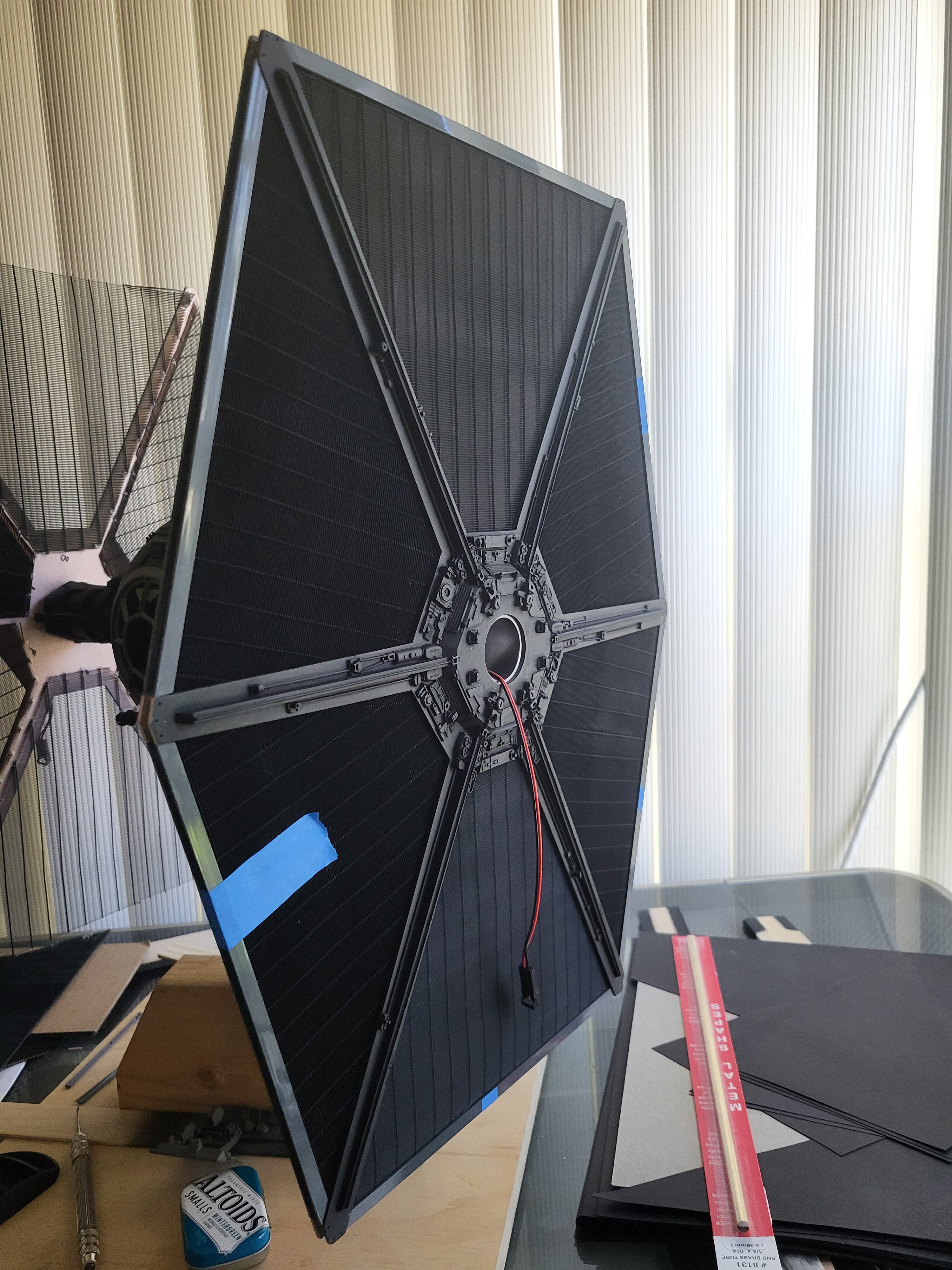

Here's where I am at. The T strip will go on later today.
