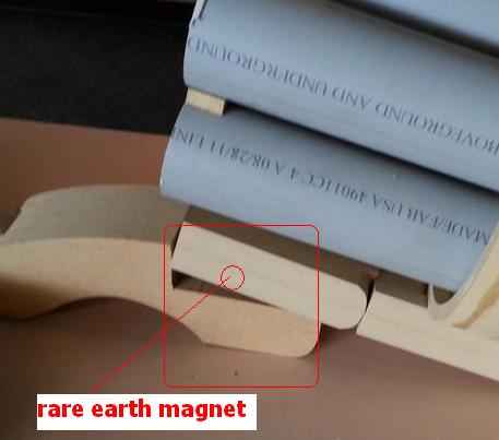

rare earth magnet? hidden inside here someplace?
Funny you mention that, I've ordered some from Amazon. Was planning on putting them in that piece of MDF you see hiding between the pipes and then match them up to a bunch in the piece that it buts up against, just not sure they are strong enough...
The part you highlited will be glued and screwed down, the issue will be on the hinge and making the gun stay closed...
Guess I could try and default back to glue if they don't work.
Thanks for having the same brain I do, if 2 of us think that, maybe it'll work =)

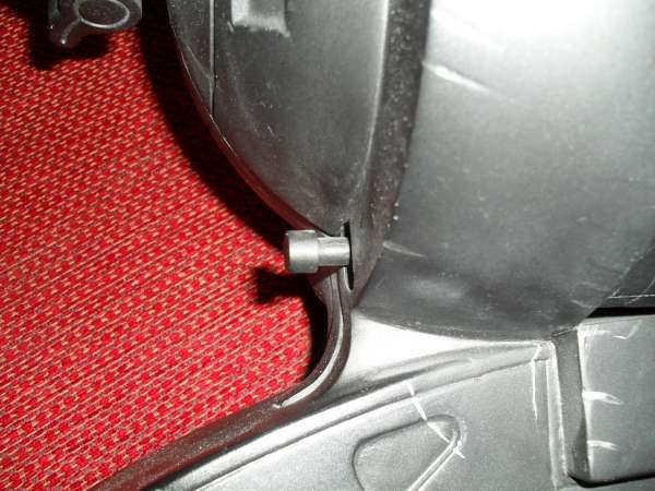

Thanks man, you've been a lot of help. How does the prop keep the gun closed?

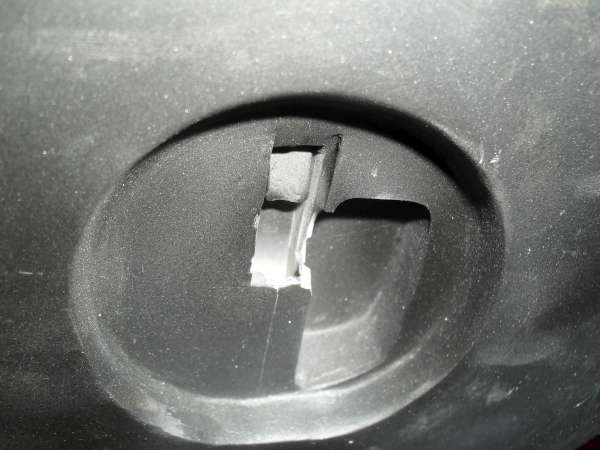

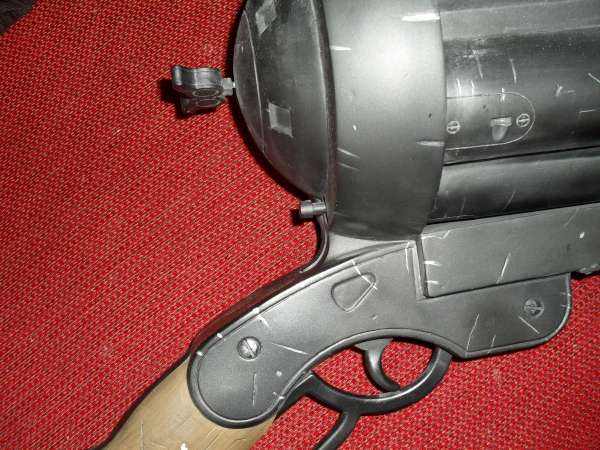

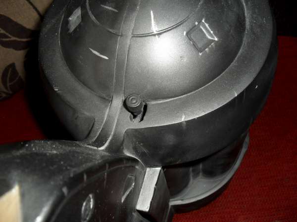

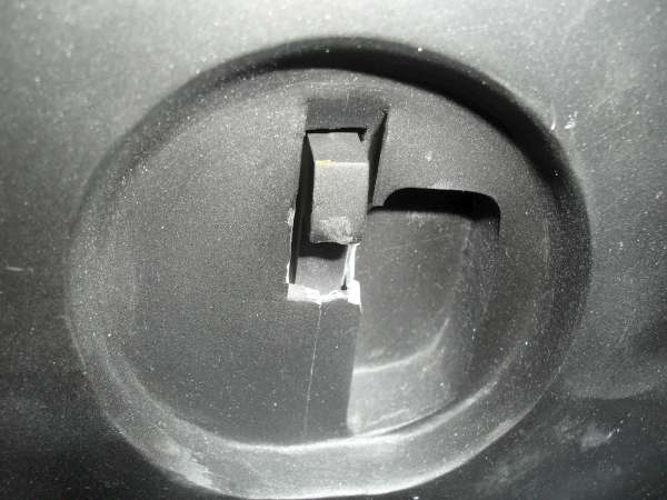

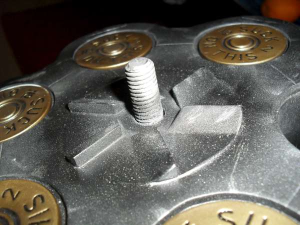

there is a button you press in on the back I think. I will double check in the morning and get you some pictures of the mechanism.
Ok I was right, there is a little button that you press on the back. It moves a hook mounted inside the back part of the chamber housing backwards so it releases its grip on the threaded bar that is embedded into the middle of the chambers. The pictures below show it all:
If you werent going to have the musical parts and you wanted an easier way to fasten the chamber shut you could make the key part spring loaded (like a pinball machine shooter rod) so you have to pull it out to drop the barrels.
Thanks so much for the awesome pics, have sure helped
