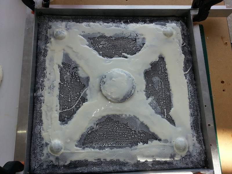

Image 1 is the pulled test part. It came out good, though I did not have enough product on hand to make it full depth.
Image 2 is layering up of the plastic and cloth to make the jacket. I used pet mesh because it is fibreglass reinforced mesh. The resin filled in the hoiles and this makes the resin very strong. You can also use fibre glass cloth for this. The jacket needs to be as thick as required to be self supporting. D65 resin is about $40/KG here and so is fibreglass. The difference is, there is no itch from D65 resin and why I used it.

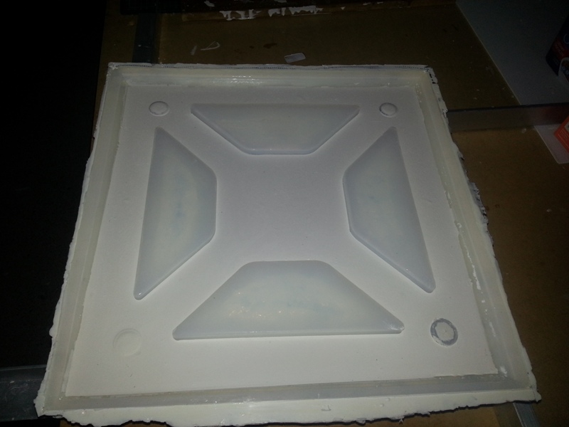

Image 3 is the inside the glove. So this is 1.2KG instead of 4.5KG that I would have needed in a box.
$65 x 1.2 = $78 Vs $65 x 4.5 = 292.50 Big difference. And I used a bit of over a KG of resin. Say another $60 to make the jacket

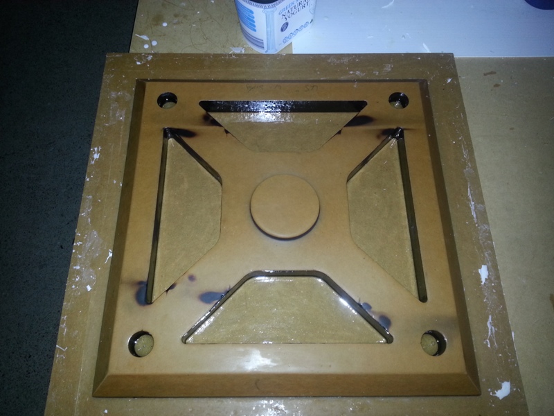

Image 4 is the master part. because this was made originally from laser cut MDF, I used epoxy resin to seal the MDF and then sanded it to 800 grit to ensure a smooth surface with a matt finish.

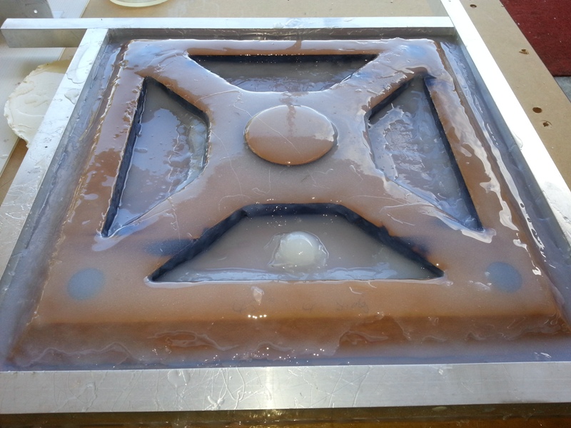

Image 5 is the layering of silicone onto the master part. Even though this part was symmetrical and had hollows to act as as registration points, I still added a silicone dome (you can see one in the picture) to ensure I knew which way was the front.
You might think open pouring like this is wasteful, and yes some does flow off the edges. The point being, this first bit is only for the "print coat". It has to be poured in one layer and it has to be completely covering the part. Once that has gelled, you can go around your piece and scoop up and overflow and tip that back on top. I also mixed a filler called Cansosol into the silicone to help it layer up better and stick to the vertical walls of the cutouts. You just keep adding until you have a desired thickness.
In the end, the glove in this case is only 3mm or 1/8th of an inch thick. It is supported in the jacket and when set up, does not warp.
