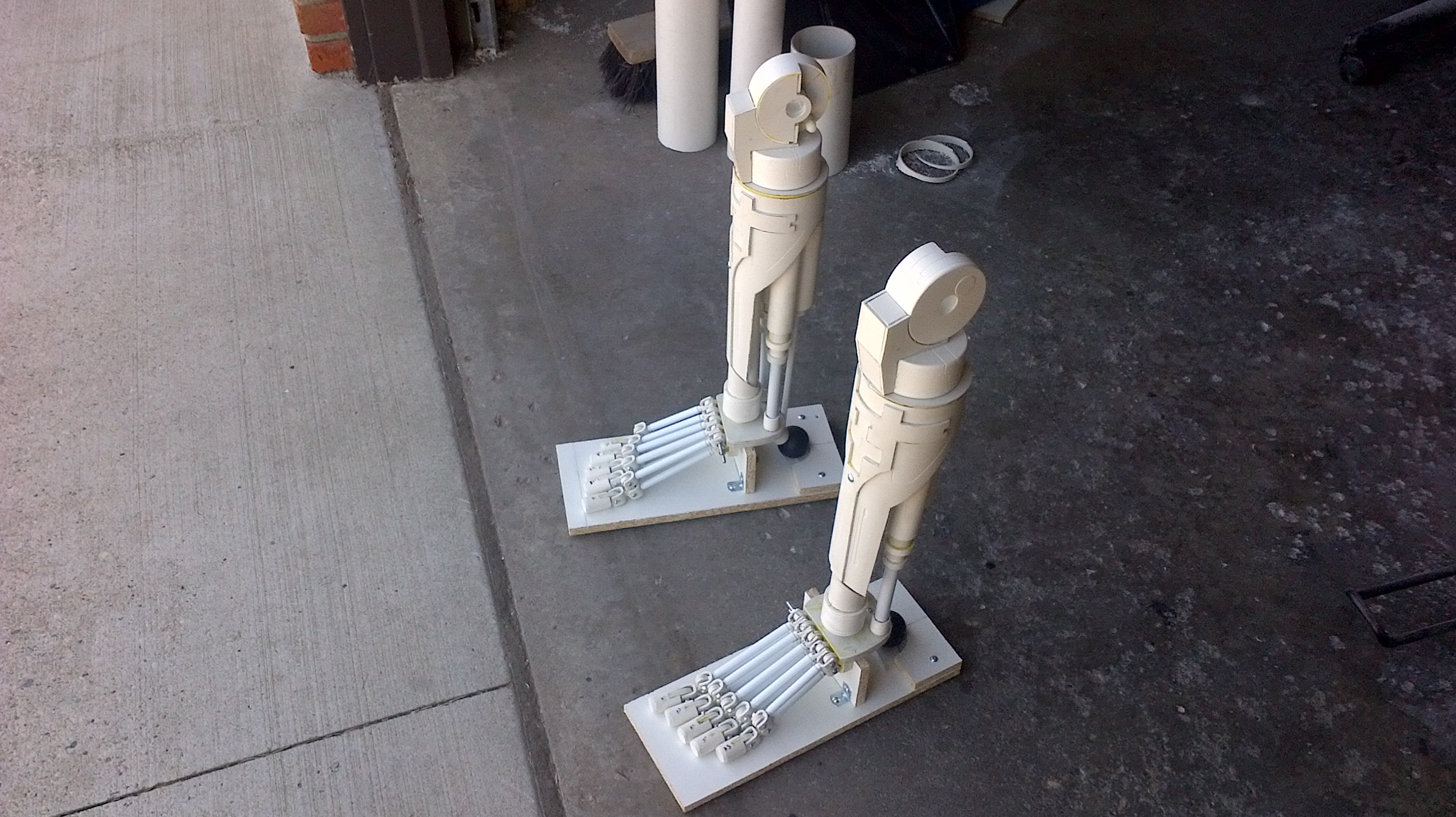

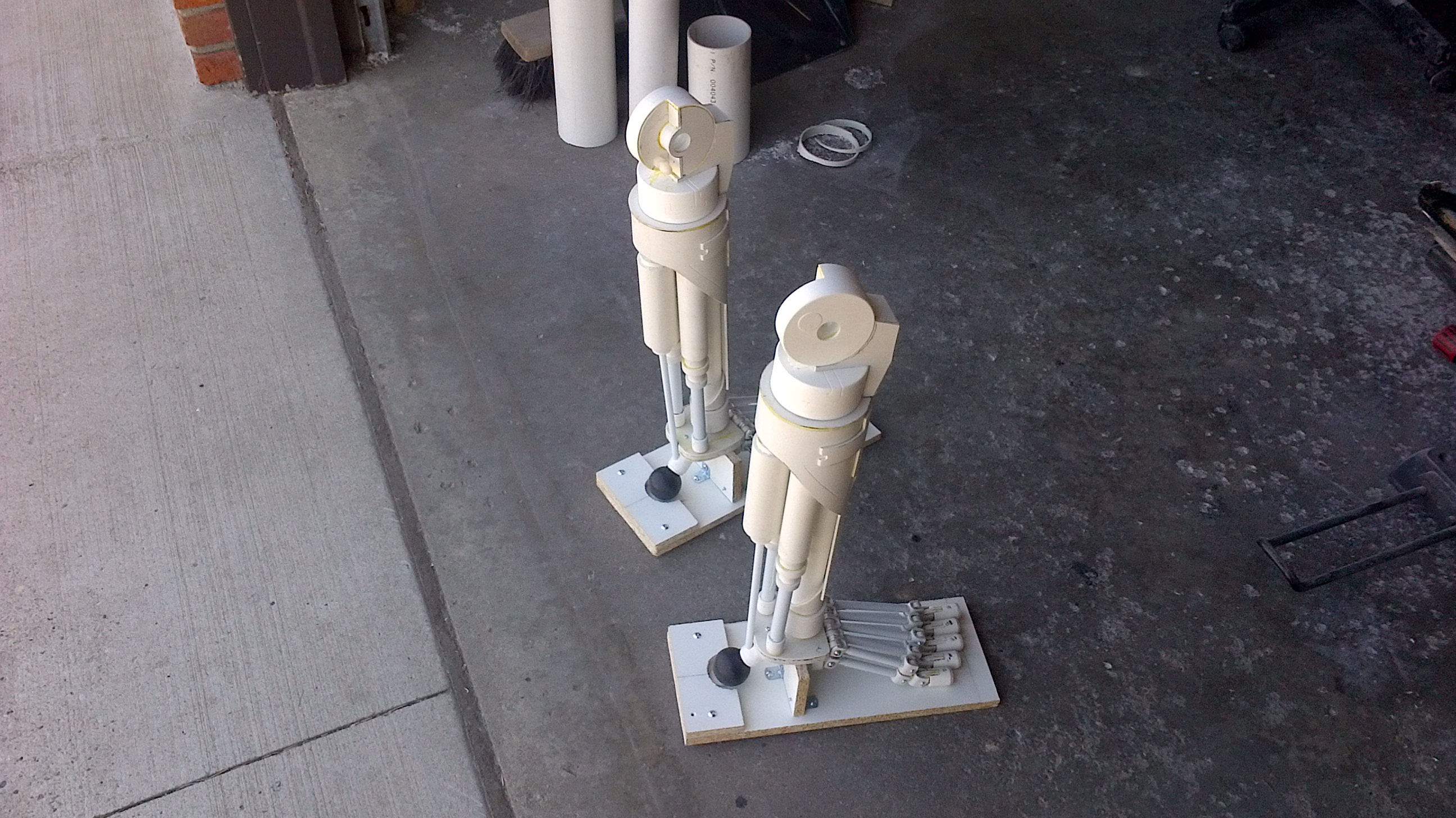

Kneecaps/joints finally complete - just a little cleaning up to do. IMG_00001175.jpgIMG_00001181.jpg
Re: Lifesize Terminator T-800 Build - WIP
Gee that is looking awesome. Such nice clean lines. Well done.
Thanks. I use a sanding wheel on my Dremel to shape everything and I've learned to take things slowly. I've tried scroll saws and jigsaws and I've found the Dremel way gets the best results for me. I also use a number of small files to shape the areas that I can't do with the Dremel.

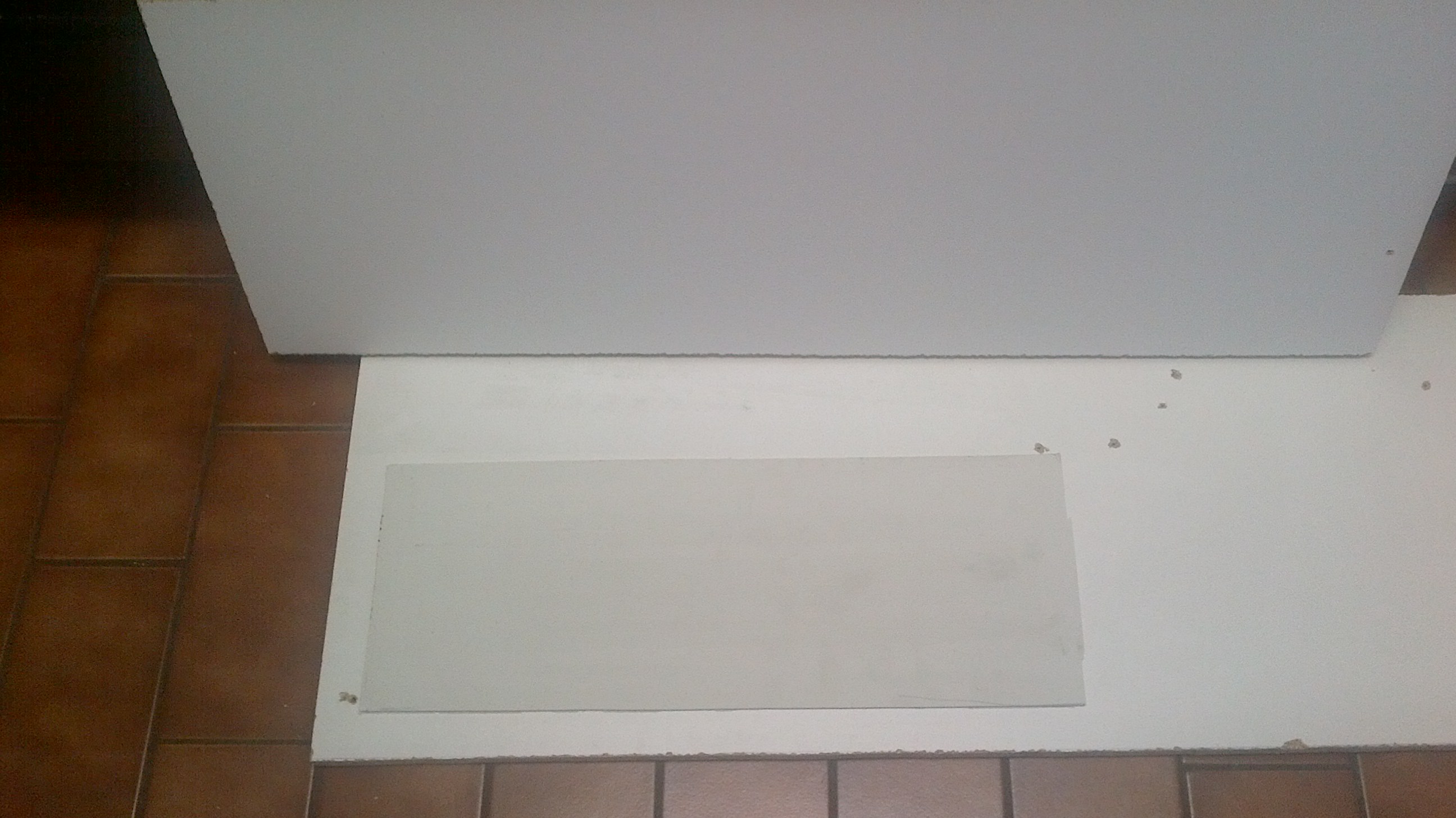

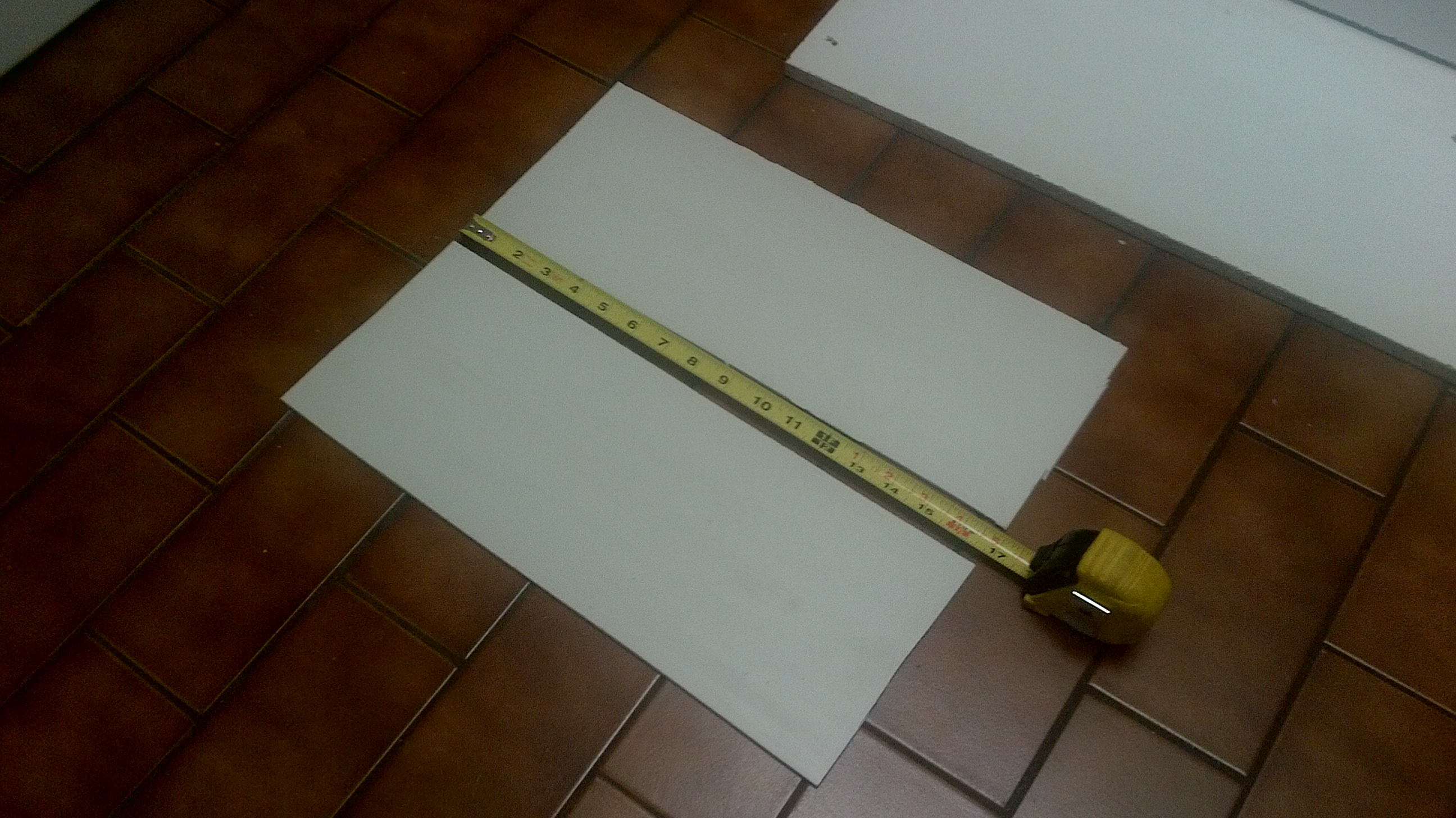

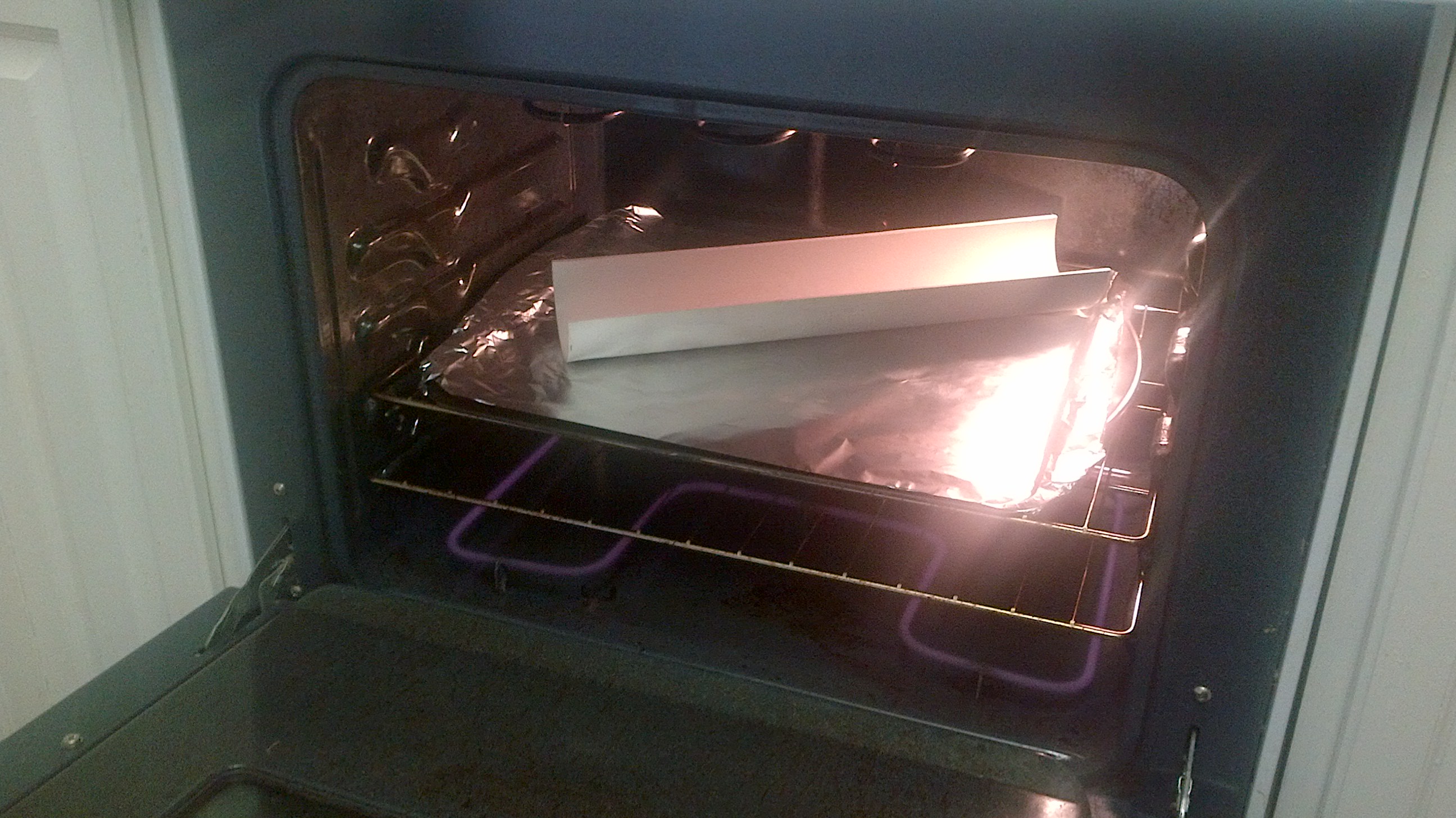

Flattening the pipe was a tricky venture at first, but here's how I get the best results: cut a piece of 4" pipe 17" long (17" is the width of the inside my oven). Make a straight cut down the length of the pipe. Sand rough edges. Heat oven to 300F. Cover a large baking tray with tinfoil. Lay pipe on tray and place in oven. Watch carefully - it takes between 5 and 6 minutes schedule 40 PVC pipe to be flexible enough for flattening. Remove from oven (wear suitable gloves) and place between 2 smooth boards (I use white melamine). Apply weight until the PVC has cooled ( I stand on the boards). As for safety - the oven is in my garage, so I open my doors to have lots of ventilation. That's it. In the attached photos, I split the pipe in half. IMG_00000100.jpgIMG_00000101.jpgIMG_00000102.jpgIMG_00000103.jpg
