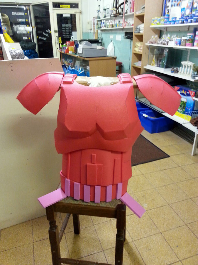

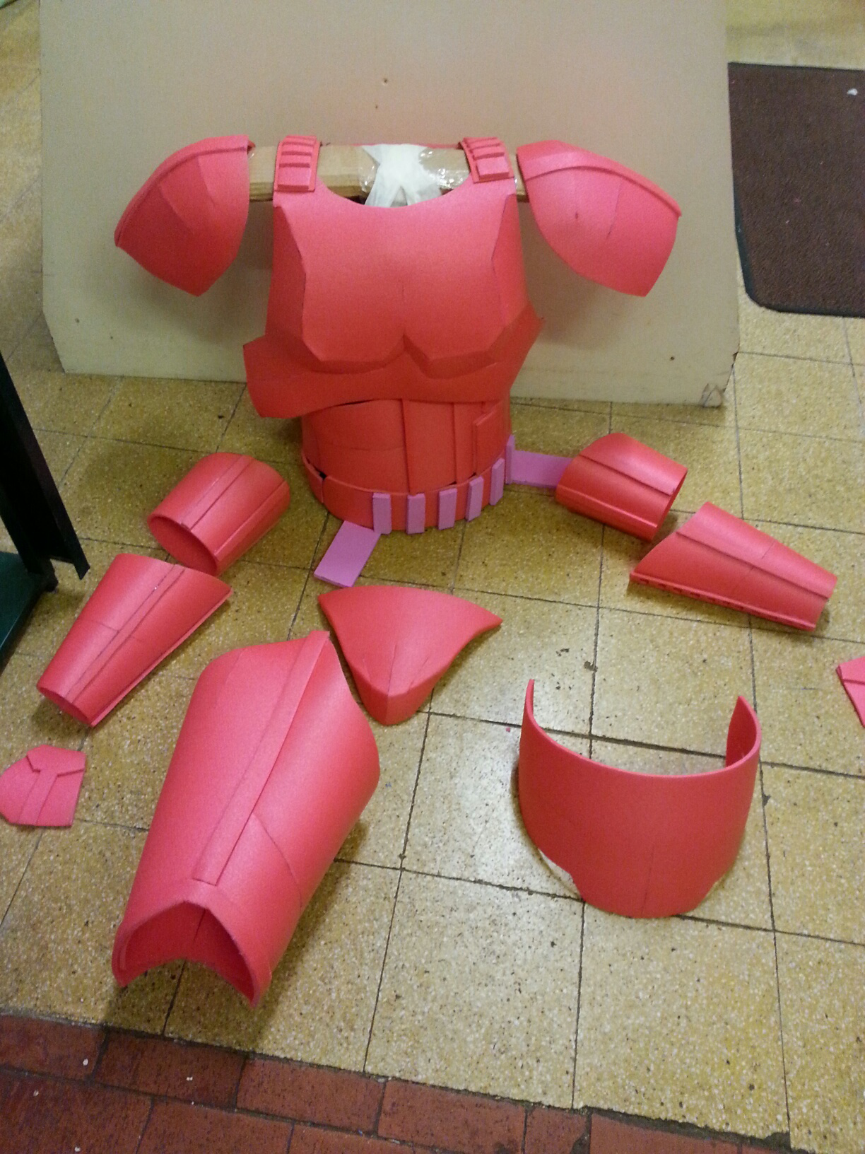

JF, these Stormtrooper files are great and make for a really simple and quick build!
I've decided to create a build thread for this one as I've not seen many Foam Stormtroopers done.
I've made a lot of progress in only one day of building (2days if you count cutting the templates)

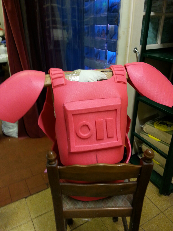

Should have all of JFs Stormtrooper armour built on Monday (I won't be doing anything tomorrow). Then it's on to sealing and painting.

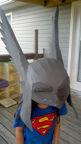

I wanted to do the Hawkman but really got off on the sizing. I thought my daughter still looked so cute in it though.:)
First attempt wasnt to bad, had alot of trouble around the eye area, plus alot of glue clean up to do.
Should I leave the size alone? I increased that build by 10%, hindsight I should have maybe stepped it down.
