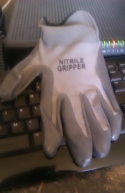

As for 7sinzz's question, my intent is to either make or find a pair of thin material (satin, silk, thin poly) gloves that will go at least 2"-3" past my wrist. I've viewed a few tutorials on YouTube about making gloves, but haven't had a chance to see what the material cost would be. Then, for the areas between the finger plates on the palm side, I am going to try out cutting 2mm thick foam into very thin strips to create the ribbed effect. I was initially going to use flexible wiring loom, but the plastic is too stiff and won't bend enough to my liking. I intend to glue the strips of 2mm foam directly to the exposed "under glove" area. Should give me the look I'm after and still maintain finger dexterity.
I actually have some "Nitrile Gripper" gloves that I got at Harbor Freight" for like $2.99 it's a cloth glove with a nitrile coating I guess(kinda rubbery).
here's a pic:
Depending on how much time and energy you wanted to put into the "tubing", you could get very thin foam sheets and build the effect onto a pair of cloth gloves. This would probably look best for the wrist but it could be done for the fingers too.
I bet if you cut along the valleys of the ribbed tubing, leaving the center 1/4th of it intact and gluing that to the fabric glove, I bet you could make a tighter fist.
