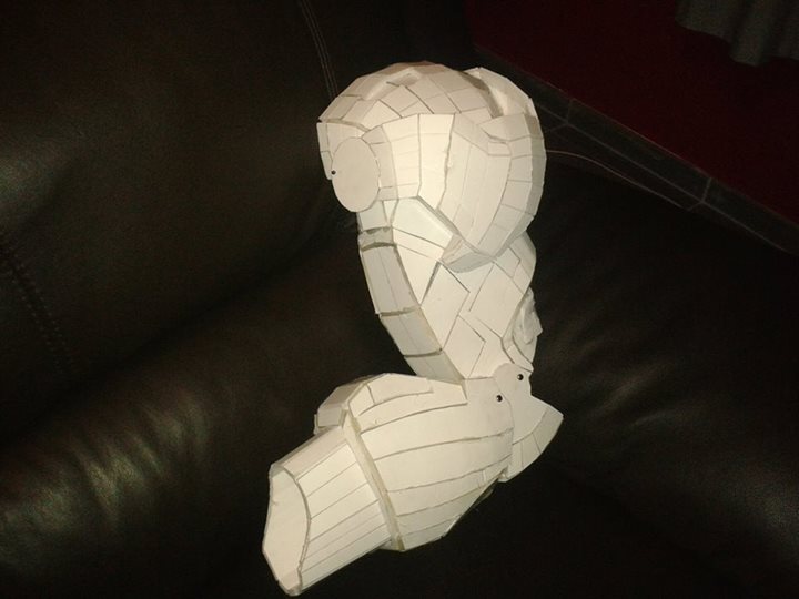

Hi Guys!
We recently used this coating method for our first time pep-builds. High density foam, pva and smooth cast 65D. Worked pretty well, rigid but with great flexibility. You can make whole body (wrap around) pieces that once hardened with plastic can be cut open again so you can get the pieces on! They hold their shape yet stay flexible enough for you to manipulate when putting it all on. Great method, thanks James you genius.
We also found (as others have) that applying multiple coats before the previous has dried is key. Also keep brushing the coat until it starts to bite the brush, this stopped the bubbles forming.... we found that out eventually. Hope you like our results!
