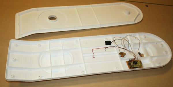

Has anyone thought about how they'll be adding the hole on their board??
The handlebar hole? This is how Mattel did it. Looks like it's just a cup piece molded or joined onto the top half.
On my Sintra board, I drilled a hole and enlarged it with a hole saw. I glued a section of PVC pipe to the underside of the top surface. Then after the board was painted and assembled, I placed the top graphic on top and trimmed out the hole with an Exacto blade. Painted the hole black inside.

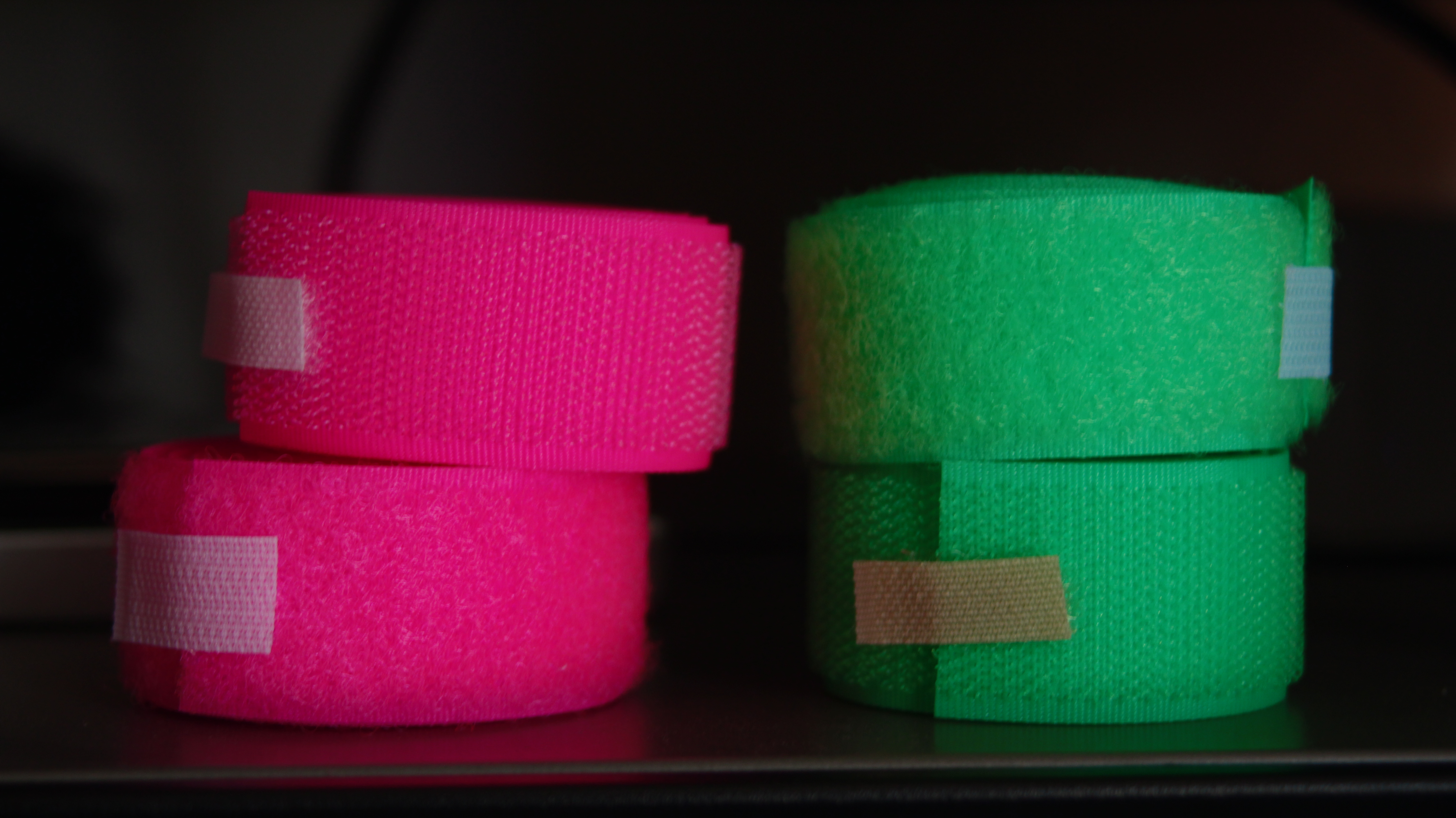

its very clear in the pics on the hc site that the board is a mattel board down to the recessed foot pad to the recessed Velcro but im not worried since im putting lenticular on my board so you wont be able to see the recess once i have everything laid down. I plan on buying the lenticular from sommers this weekend and i should have the board done a few days after it gets to me. all i need to buy now is the lenticular and the furry strap for the footpad. I plan on using small pink stickers ive matched to the boards pink to cover the bottom screws that are most likley hiding under the decals and once the lenticular is put down you shouldnt be able to see where they are. thats the plan anyways. i also bought some glossy white sticker sheets from ebay that are home printable for the mattel logos.
