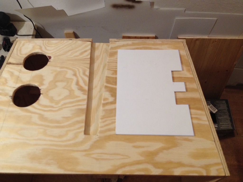

I made the side E:

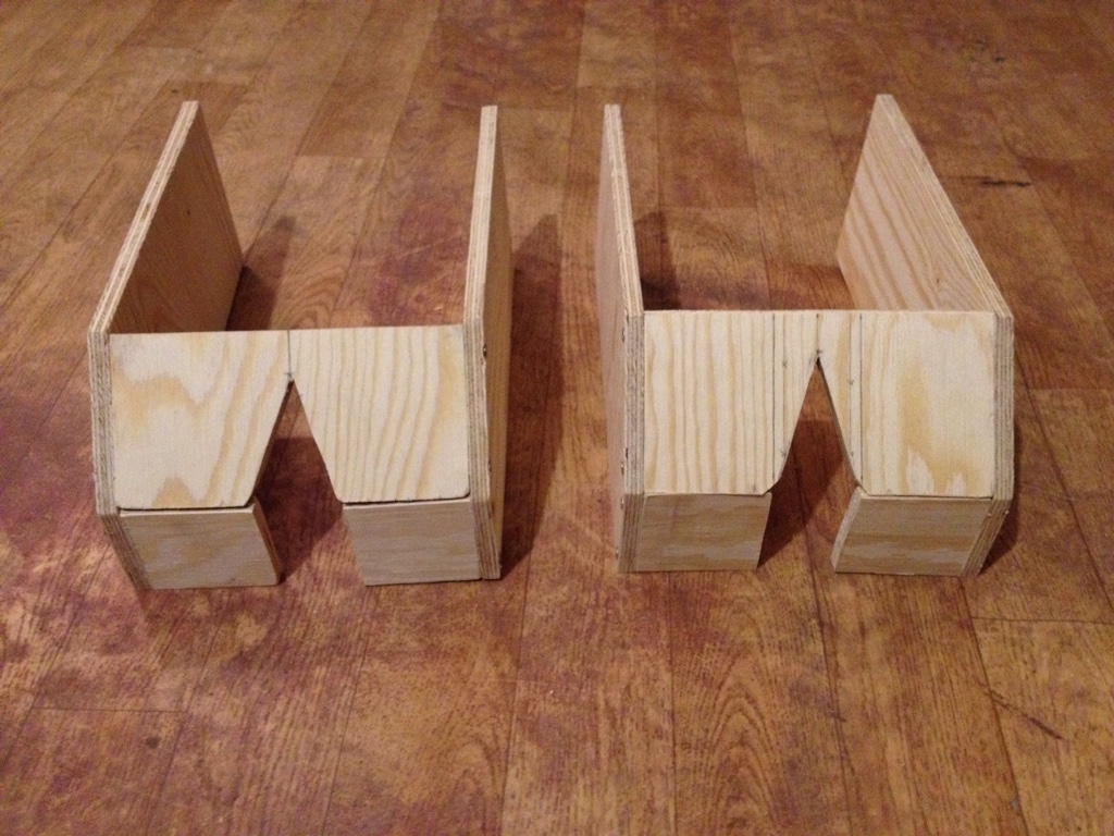

I spent a lot of time making the feet. First I was making the nibs as full parts (from glued pieces of wood), which turned out as a not so good plan. So, I started again...
But this time I just drilled single pieces of the feet together. Now it looks like this:
The nibs and the whole feet are hollow.
It needs some bondo, but it is much better than my first attempt [emoji4]
What do you think? [emoji4]
this is coming together great!! feet look awesome! do you plan on routering the edges of the box? i was just curious to how the GONK builders get the corners smooth. i dont know how you could make the intersections match with routing the corners... maybe I'm over thinking it
I think I will just take sandpaper on them. And I made the GONK splittable into two parts, so there shouldn't be any problem with matching the intersections with corners...
A router with the appropriate roundover bit can be used to round the corners yes, if you do this though you need to reinforce the inside in the corners.
On mine there are little triangles of batten glued in so the thing still holds together after routering had removed most of the strength.
Also one tip for the feet, as the legs seem to come down right in the centre of the body, having a little extra bit sticking out the back of the heel will help stability.
I did this on mine but I didn't put it on the plans I posted. It will also help if they are very heavy too :)
