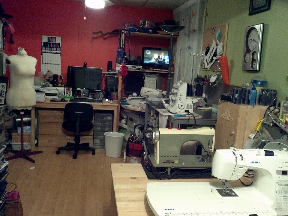

First up, digging out the costume room. Never fails that by the time DragonCon rolls around this room is a disaster. There's still a lot of work to do but at least I can now start to build again!
Lots of crap in there, but it's my happy place. Unfortunately, I have so much crap that it's oozed out of the costume room into a little of the rest of the basement. I have several rolls of fabric, leather, vinyl, Wonderflex and Worbla that are standing in a corner but by the end of these builds, those should be drastically reduced!
Feel free to ask me any questions about what you see. Not shown in the picture is one of my most important pieces of furniture - a waist high cutting table.

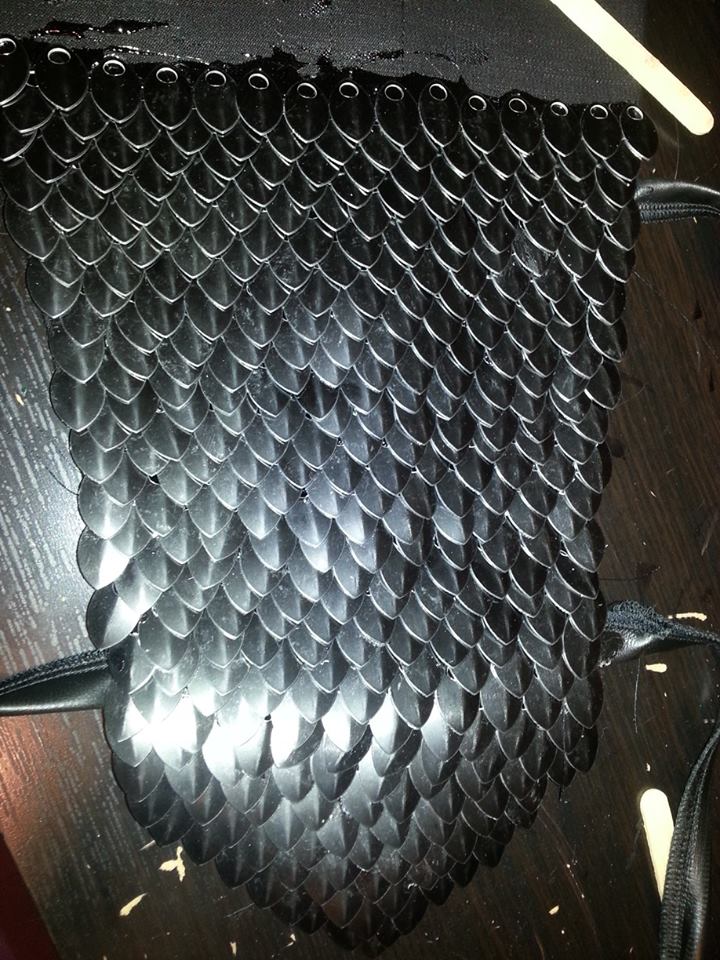

First costume for this year is one left from last year that I just couldn't bring together. I fell in love with the last costume Queen Ravenna wears in Snow White and the Huntsman.
I knew it would be a lot of work but WOW it was even more than I anticipated. I watched every video interview of Colleen Atwood (the designer) that I could find took screen caps from the blu-ray. I found the same source Atwood used for the scales (www.theringlord.com) and they were super helpful in terms of which ones were correct. And then I tired to the scale maile with the proper rings. I just couldn't get a feel for it. I tried and tried until my eyes wanted to cross. I even tried coloring the backs of some to keep the rows straight. I fully admit that scale maile has beaten me, at least for now.
My next attempt was at sewing them on a sturdy backing. That was easier but way slower and difficult to keep the spacing just right. As time got more and more tight, I resorted to glue. While I got it done, it was completely unusable. The glueing makes it far too stiff.
In the end it wouldn't have been up to my standards so I scrapped it in order to do a better job. I'm now trying the knitting version and that's going much better. It remains flexible and so long as I concentrate on my tension, everything stays evenly spaced. I'm happy so far.
I commissioned Firefek to do the pep files for me for the crown. I ended up also purchasing this ready made crown.
It is lovely, but it bothers me that the spires don't go all the way around. I understand why they do that as they aren't going to resize them for each order, however, I suspect that this will be the back up and I'll work on the pep file version instead.
I spent many, many hours and lots of blisters working on the leather for the collar and hips. The hip pieces actually extend all the way around and down to the floor in the back. What I initially thought were porcupine quills are actually thin pieces of twisted tooling leather. Once again I panicked a little and when the glue route, but I'm not entirely happy with the overall look so I might be changing that. I made a backing out of sturdy fabric and sewed velcro to the back before adding on the leather. I'm thinking now I'd like the backing to be narrower but otherwise, the twists look great. I'll get a picture of that up this weekend.
Thanks Chris! I LOVE my room. I just wish I didn't have so much crap in it. Never fails though, as soon as I get rid of anything I find a use for it.

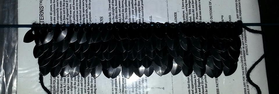

Here's the knitted version so far.
The scales have movement which they didn't with the glue, but it is more than it would if I were using the rings. I'm not sure if I love that or not but I'm going to keep going and get a section of the front skirt panels done and see what it looks like. Tension is difficult for me. I'm not at all a knitter. I had a friend help me out with the spacing between rows and between scales which helped immensely, but I have to concentrate a lot to keep my tension from getting too tight. I failed this portion of junior high home ec. Oy.

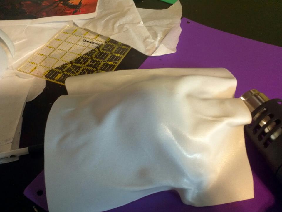

Speaking of new things, I plan on doing a few costumes heavily based on Worbla and/or Wonderflex. I've only started playing around with these materials to get a feel for it and I love it. But it isn't easy to make everything look nice and clean. So far I've managed to figure out the art of making rounded shapes and getting them smooth.
I watched several of Kamui's videos on her chest plate construction so how to do this is from her. How I managed to screw it up - that's all me.

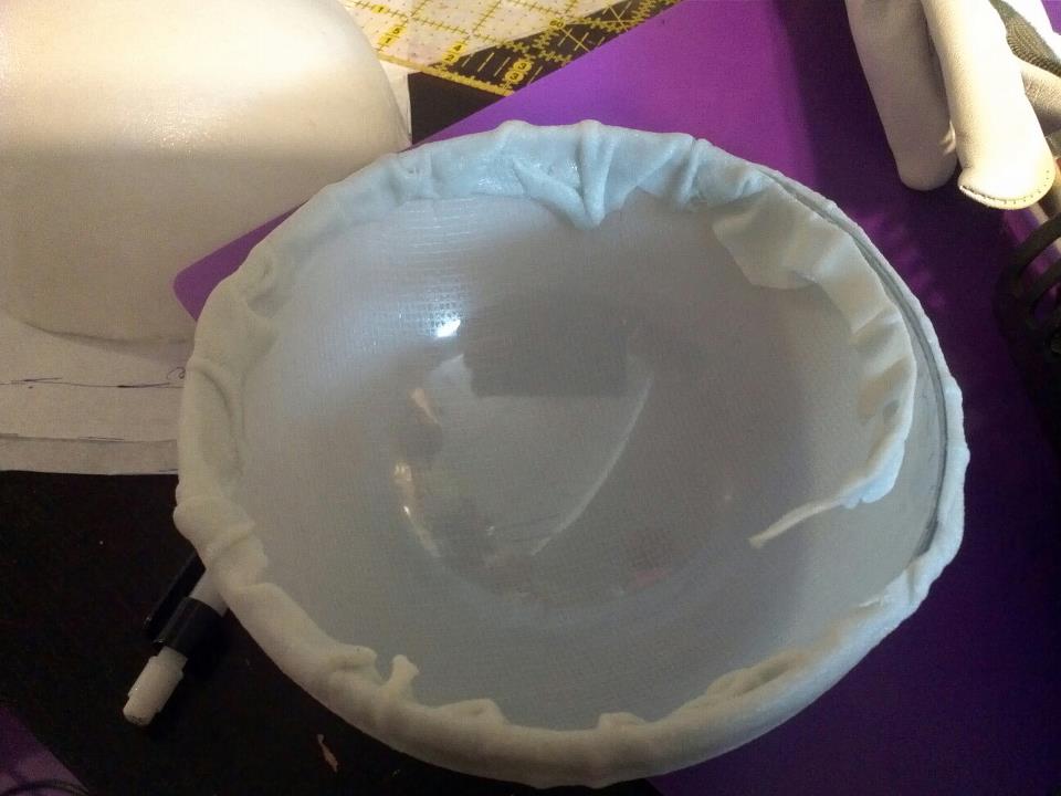

First you start off with a plastic half sphere roughly the same size as you need for the bra cup portion of the chest plate. Picture shopping in the dollar store and discretely "trying on" plastic bowls. In the end, I ordered some Christmas ornaments from Amazon.com that have two halves so you could put stuff inside the ornament. They come in a lot of different sizes. The most important thing is that they are smooth (reason why I couldn't use any bowls at the dollar store as they all had a hard edge on the bottoms). I'm going to put this here in case anyone ever uses this description to actually follow step by step - use a mold release on the plastic sphere.
Take your sheet of Wonderflex or Worbla cut slightly bigger than the size of the half sphere. Heat the Wonderflex/Worbla with your heat gun. Glue it to your work surfce. Swear. Detach it from your work surface. Swear again when you see part of it is still stuck and now the sheet is damaged and you can see the underlying mesh (particular to Wonderflex only as Worbla doesn't have a mesh). Scrape the bits off and then get smart enough to put something down on your work surface, like wax paper, or like I'm now using - silicon baking sheets. Try again. Keep smoothing out the Wonderflex/Worbla carefully so as not to pinch any of it to itself. It's difficult to get that un pinched when you do. Burn your fingers, lots. Read months later that Kamui suggests wetting your fingers.

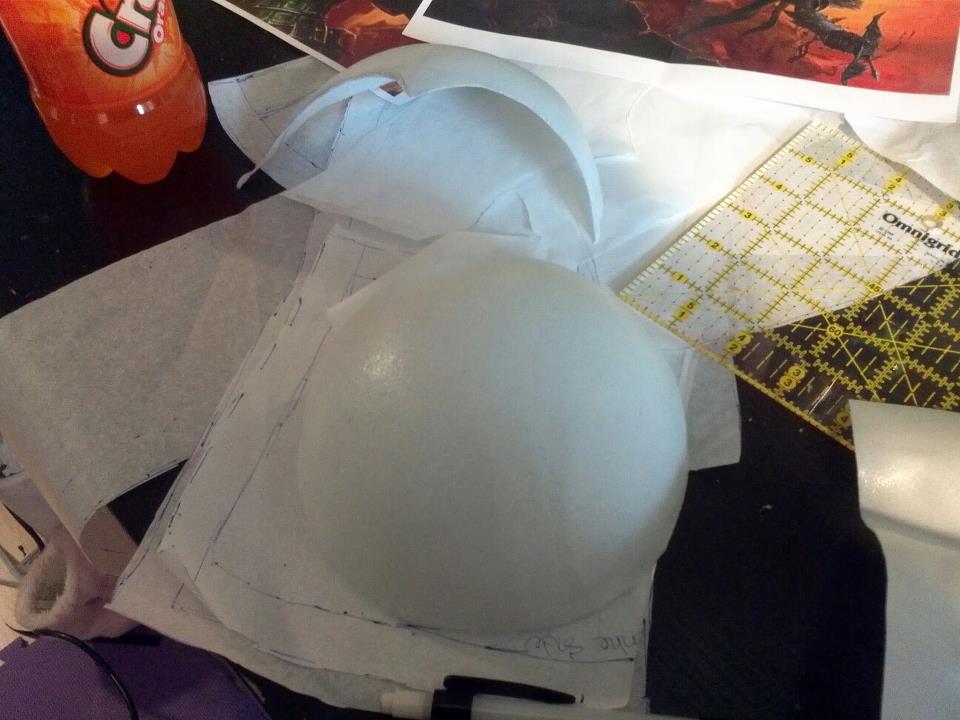

This piece ended up being too large, but it's better than too small. The Wonderflex and Worbla and be reheated and shaped over and over again so you can take your time getting it smoothed section by section. But keep in mind that you don't want to push too much material over as you smooth as eventually you're going to have to deal with that excess. It's best to try and deal with it in each section.
Eventually you get it all smoothed out. It will seem like it's not going to happen, but it will.

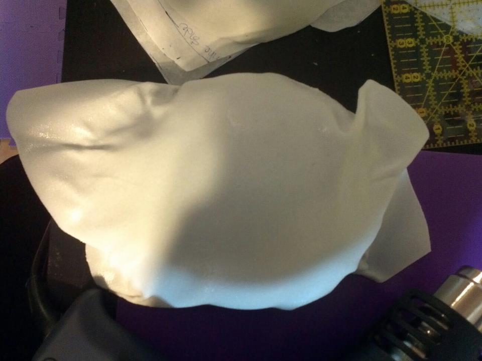

Now you want to trim and smooth out the edge. More mistakes to be made. First time I didn't use the mold release and then realized too late that the Wonderflex had pretty firmly attached itself to the plastic sphere. It was a royal pain to get it off. The spray mold release works like a charm. The other mistake I made was not spraying the inside edge with the mold release. I folded the ends over the end to get the entire sphere nice and smooth and then had a devil of a time trying to get that part unlocked.
I swear by these scissors for working with plastic:
I've cut out whole kits of armor (my Bo Katan - Bounty Hunter from Star Wars - and my Halo ODST kit). They look terribly useless when you first get them because they are so small but they work fantastically well. The curved ones worked best on the inside of these spheres to trim the excess. Search for Lexan Scissors on Amazon.com. They are only about $15-ish.
Once done you'll have this!
From there you can heat this up to shape it as need be as you likely won't want to it be perfectly round. You'll also likely cut away some. Kamui always covers the object in painters tape and then draws the pattern. If you're careful, you'll be able to use the pattern flipped over for the opposite side so that your cuts are even. In that case, it's handy to first cover the object in something like saran wrap so the tape has a single removeable surface to stick to.

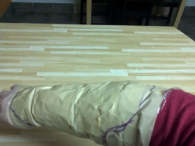

I've made my first pattern for the forearm armor. Sorry for the wonky picture....I had to push the button on my tablet with my nose....haha
It's still got some tweaking to do to it before I cut it out of paper for my pattern but it's basically there.
