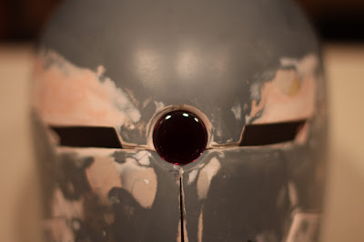

So, you have convinced me to cut the forehead.In pictures here's what's happened so far:

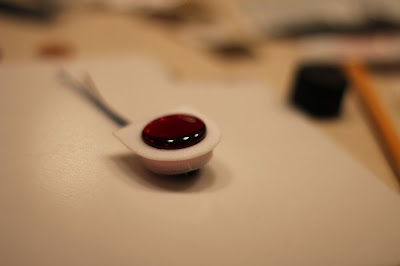

I added some nylon finishing washers
Sculpted the housing for the light and lens out of a sheet of styrene (I think it was styrene at least)
Glued said housing to the newly detached forehead piece
Filled the area around the washers:
Here's a detail of the back:
Took it to the paint shop:
And TADA!!
I have one more round of sanding/priming to do (I hope) and then I'll make my first mold. (fingers crossed)

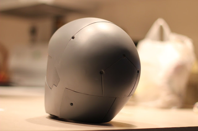

The second version is certainly interesting but if you're going for accuracy stick with the solid triangle. Other than that, looking great! I really like the profile of your helmet, especially the small protrusion just under the front sensor. Mine's pretty much flat going down but I think yours looks much more interesting.
Oh actually I do have one question - you have all three sensors on the back pentagon area at the vertices. In the line art from the art book the lower ones are not at the vertices but halfway down. Are you going by the game? I had a hard time telling the precise location in the game so I went with the line art version.
Re: Diegator's Grey Fox / Cyborg Ninja WIP
Yes, I'm going by the game version. Although when I was modelling the thing I looked at all the references at the same time and kinda came up with my own interpretation. For instance, the front 2 small sensors are slightly above the midpoint of the line, as shown in one of the artbook drawings above, yet that's the only place where they are shown so high.

OMG, this looks awesome. I'm beside myself :love Check it out:
Aaaand with light:
The camera really doesn't do the light justice... it comes out this really deep red.
And in this last one, I photoshopped the logo in to make it look cool :D
