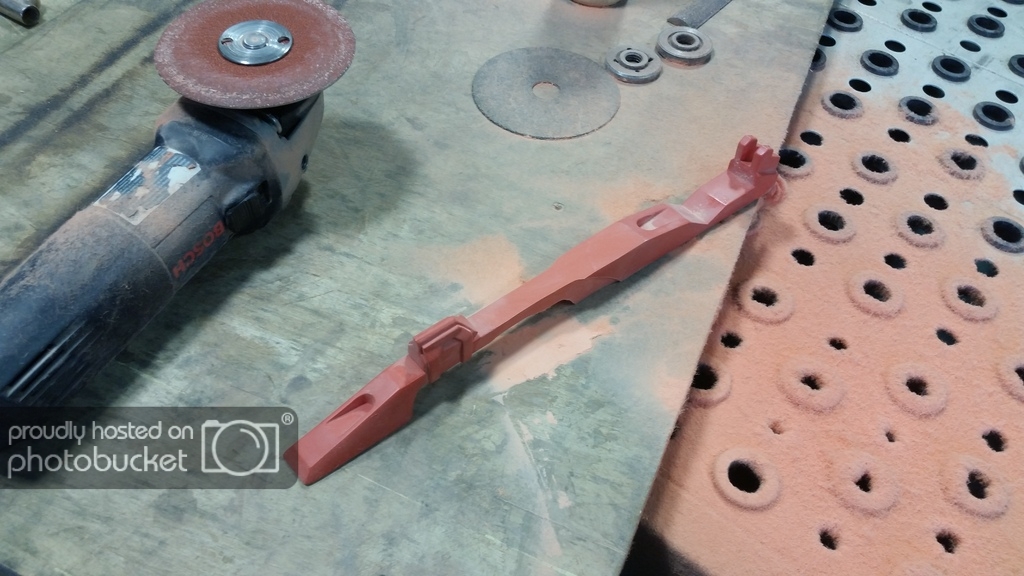

I took some time before checking out of the country for a couple weeks to mold the magazine and pull a hollow cast of it in shiny red! I also started with the final steps in detail I want to complete before molding the body. First being opening the thumb hole to make the prop more comfortable in your hand. Here is a quick pic of the original body sculpt with the pulls of all the currently cast parts slapped on.

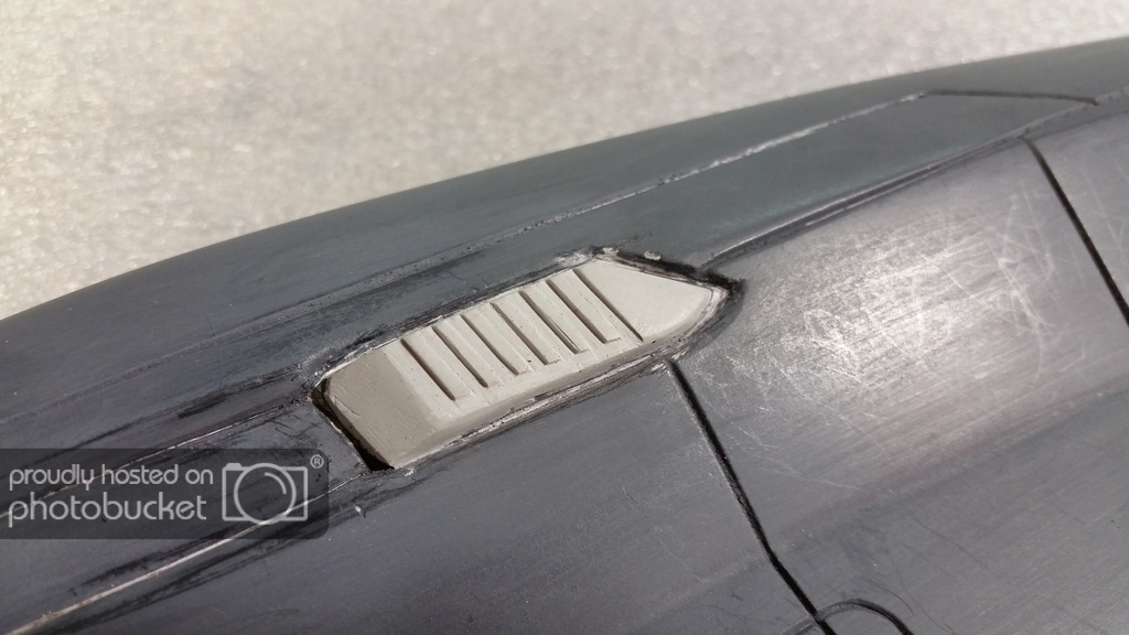

Next mod is the arming levers on either side of the gun. I sculpted rough with Apoxie Sculpt and carved the details in, like I normally do.
