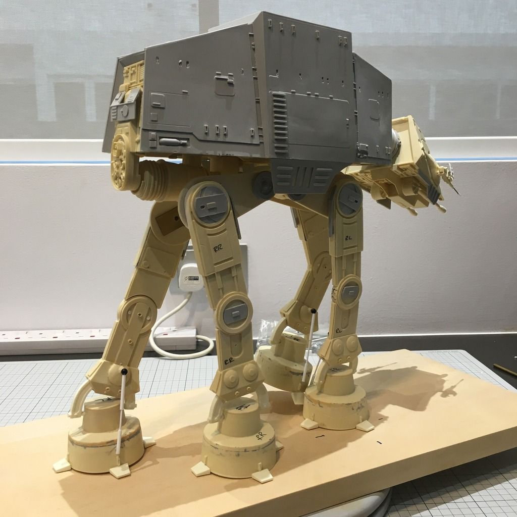

As for whether the resins will buckle, read my earlier posts on how I have tried to reinforce the stress points with brass rods and even brass plates. When the AT-AT did buckle (at the ankles due to the bad resin C-clamps), the rest of the legs held up pretty well. I'm keeping my fingers crossed that my reinforcements are sufficient. At any rate, I'm waiting for the toes to arrive, and I will be travelling again for work next week. So I'll be leaving it standing for a week to see if there are any issues with the strength of the legs.
As you said in your previous post, the dio will have to be adjusted to the leg not touching the base (easy). I think it'll be difficult to find a wire at the proper scale, but you shouldn't be too concerned; the final dio with rock!

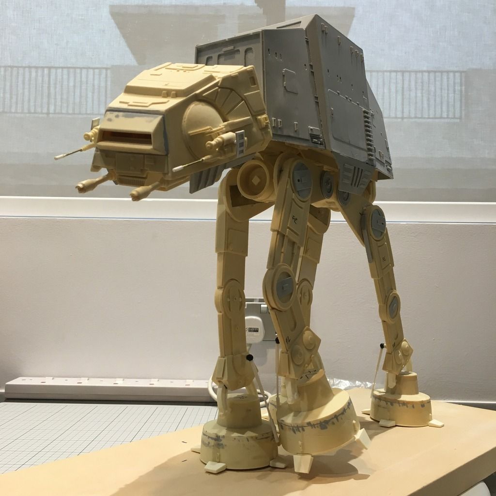

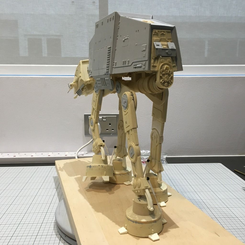

Well, after a 9-month house move, I've finally gotten my workshop set up, and I can come back to my builds! Had a few damages during the move, but I'll get to repair them when I do.

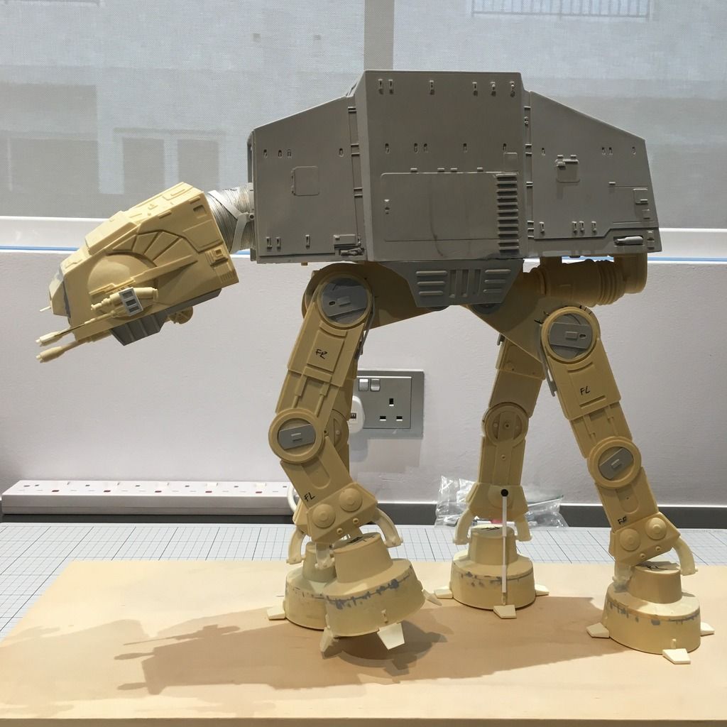

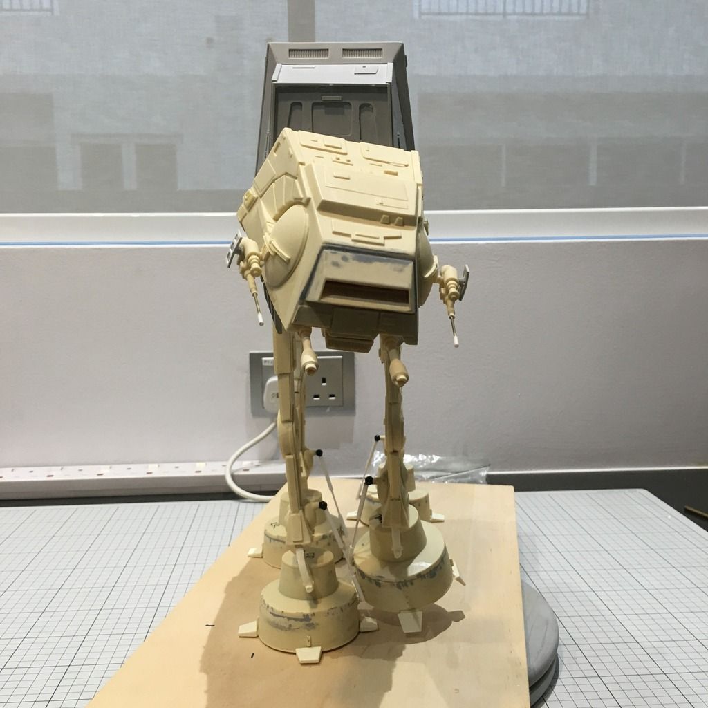

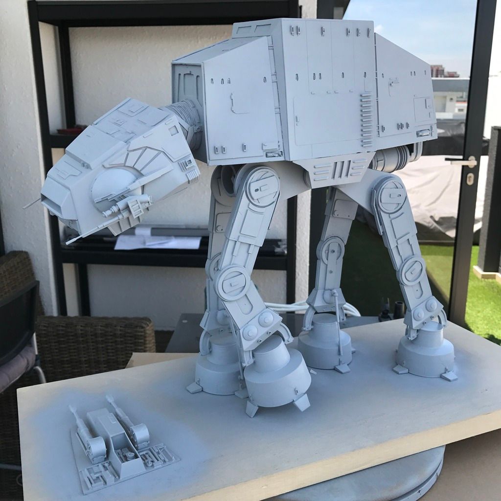

So to continue where I left off, my AT-AT was somewhat warped after a 9-month cold storage. Had to "straighten" a few joints, fixed up the leg actuators, installed the toes, re-adjusted the pose, and here we are, ready for priming!
Stay tuned! (So freakin' happy I'm back!)
Great to see this build back on track, the scale is great , but your pose is spot on ,
thrilled to see the progress ( you should video the painting if even for yourself , time lapse on this large model would be great )
thanks for sharing

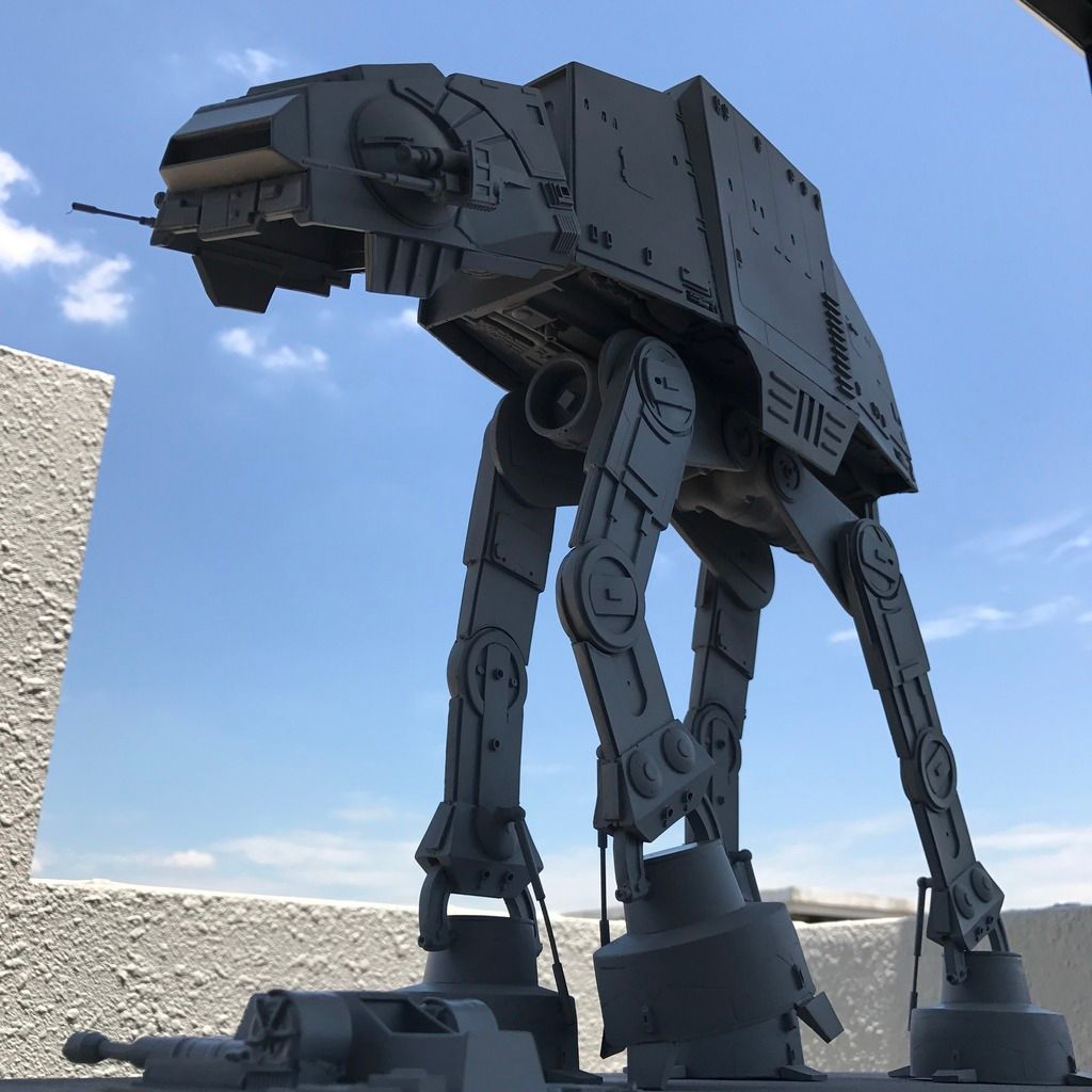

Glad to see that the project is still on! Love that pic with the blue sky as a background. Trick for you: by adding a white board (angled at the bottom of your model and off camera) you could see some of the underside details without making it "artificial" looking. Eager to see the next update!

Thanks. I understand the use of reflectors for dark areas, but that was essentially a quick shot since I had blue skies. When the project is completed, it will be shot in green screen, and the Hoth scene superimposed as a background. :)

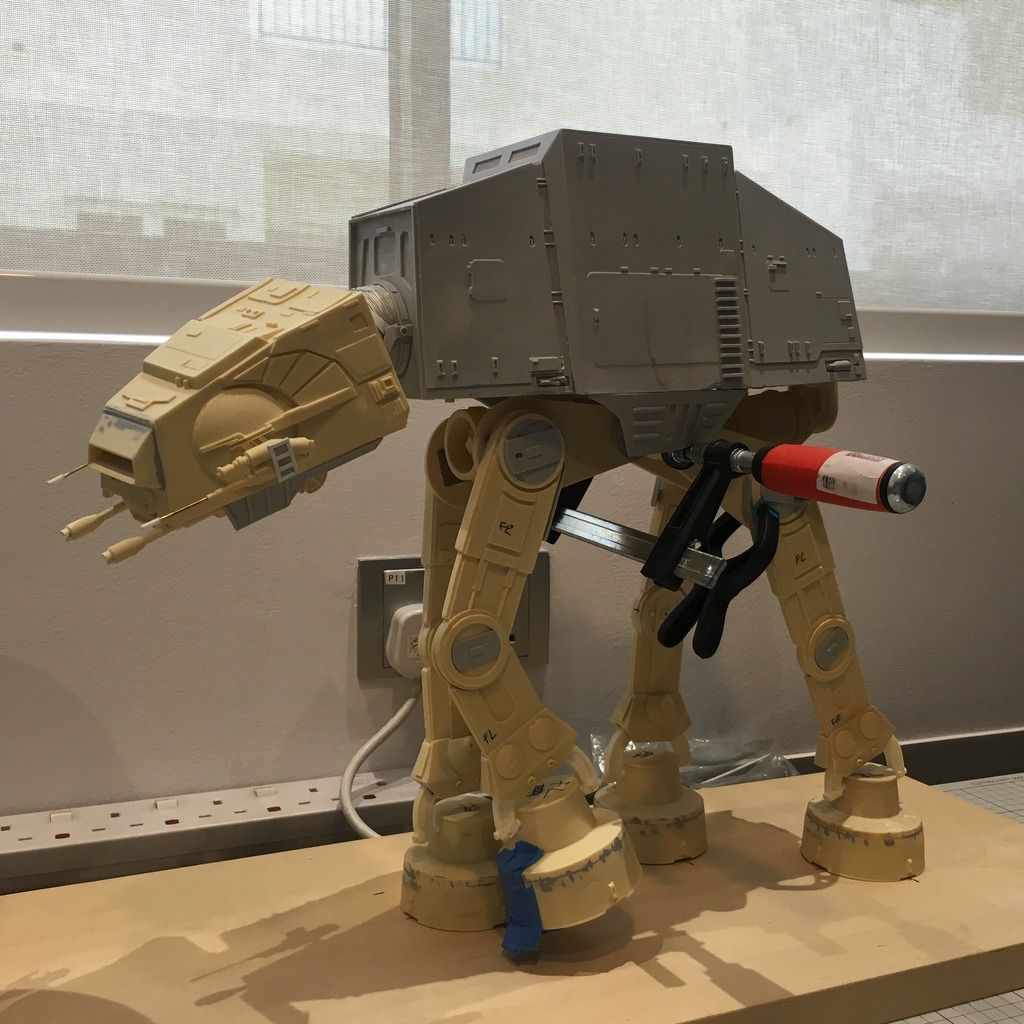

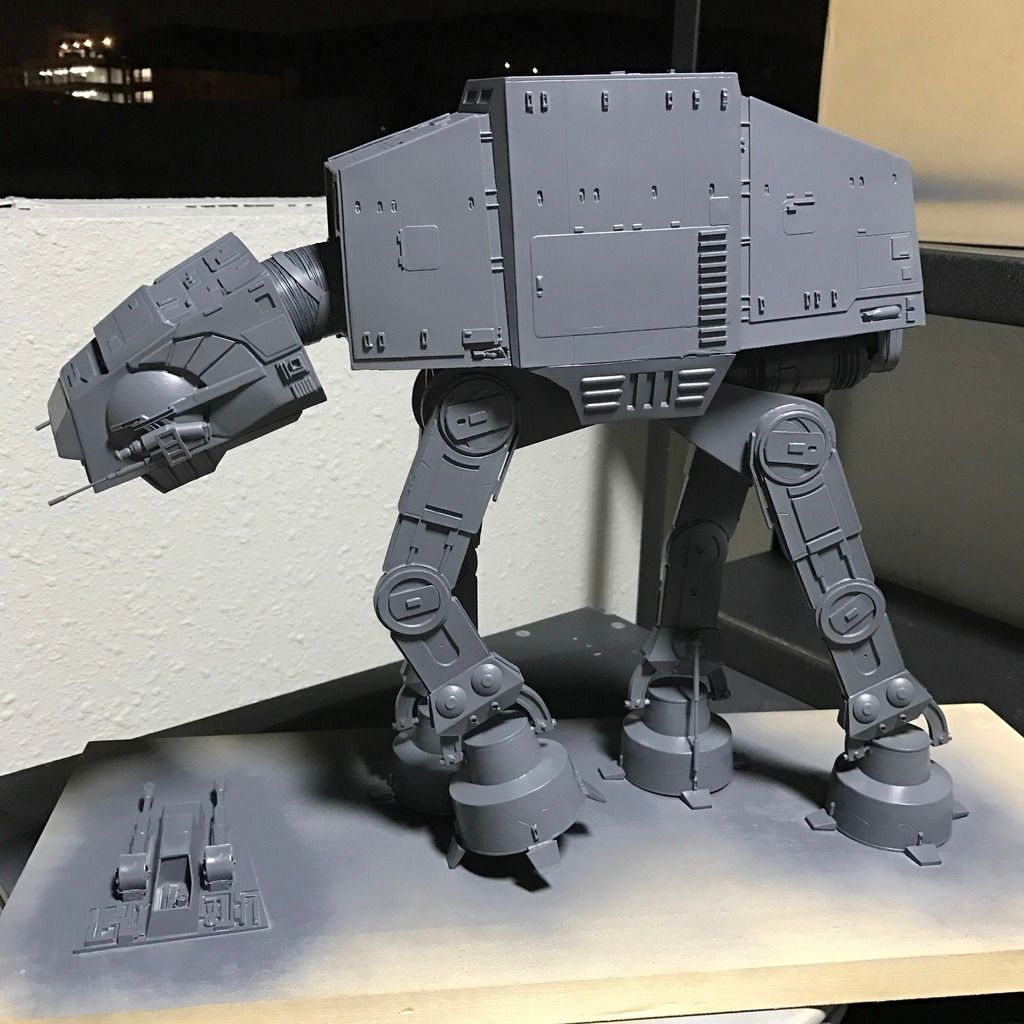

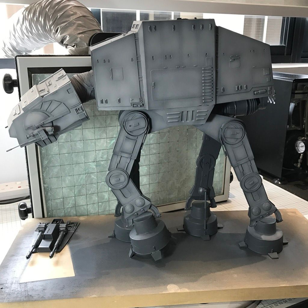

So I had about an hour after dinner, and decided to give it the base coat so that tomorrow I can start shading it to the correct tones.
I used Tamiya German Grey, and since it is such a huge beast, I decided to go the rattle can route instead of an airbrush. As a fellow builder of mine always says: "Airbrush is a sniper weapon. Use it when it matters."

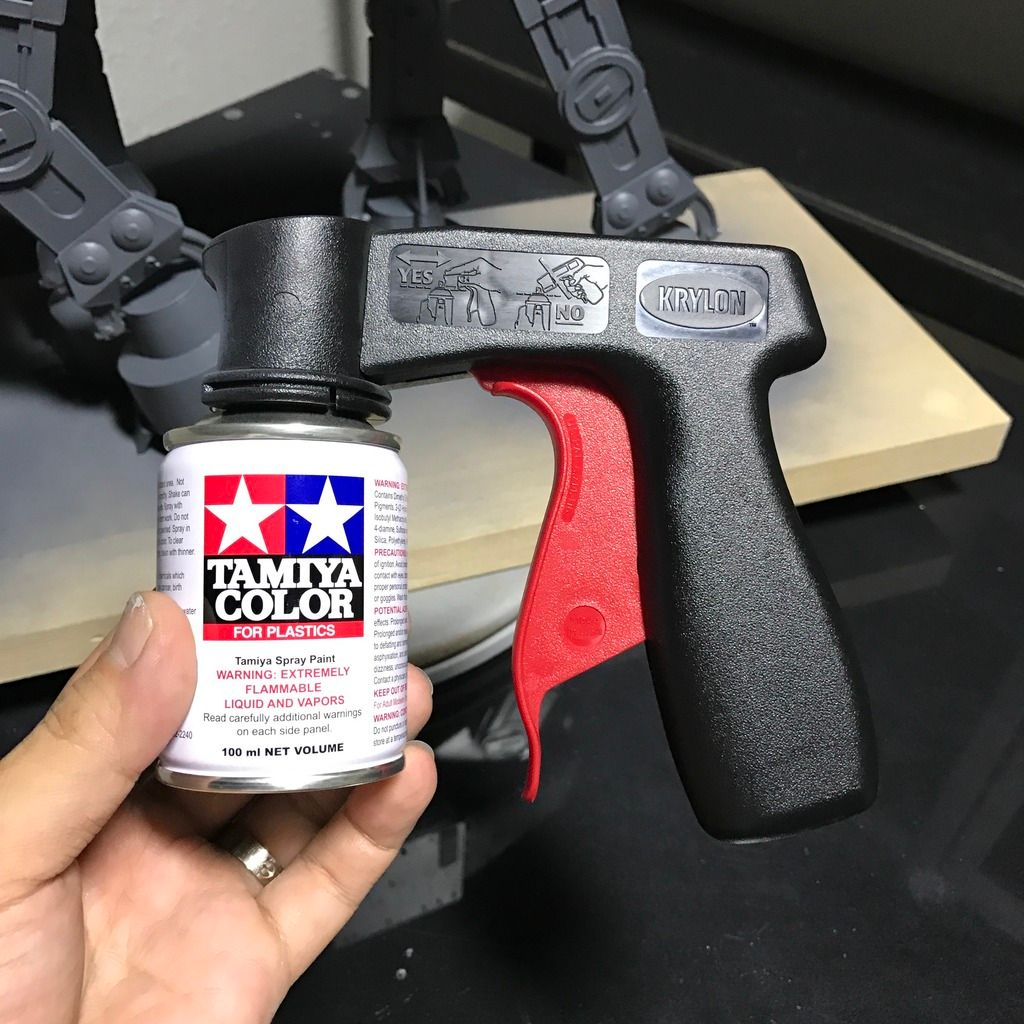

A good gadget I got is a rattle can adaptor from Krylon that allows you to spray rattle cans like a spray gun. Gives you much better control of paint flow, a better angle, and reduces finger fatigue. Here's a photo of it:
I strongly recommend getting that if you use rattle cans a lot.
So here's the beast base coated with German Grey. Stay tuned for shading tomorrow!
Looking forward to the finished model. Glad to see it's almost there
Thanks for the tip on the adaptor. I'll have to seek out on of those since I use rattle cans a lot

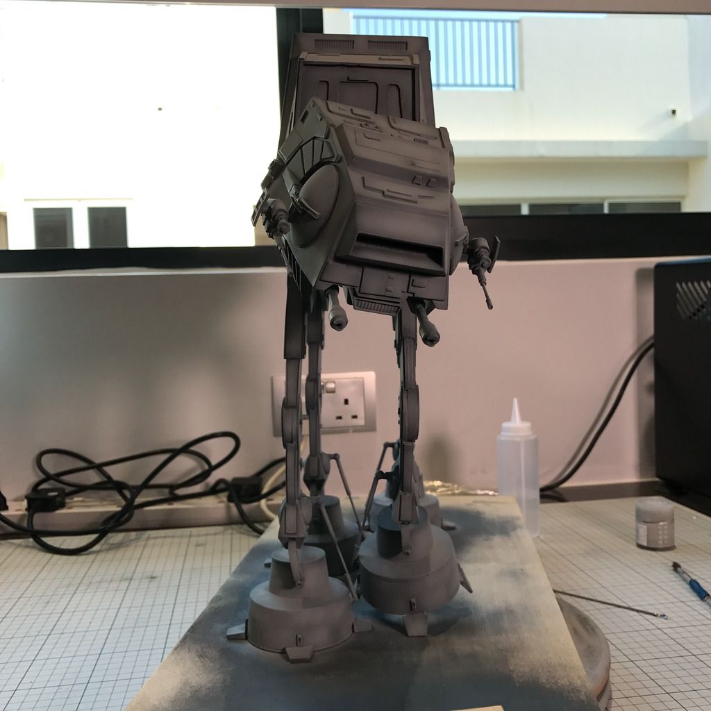

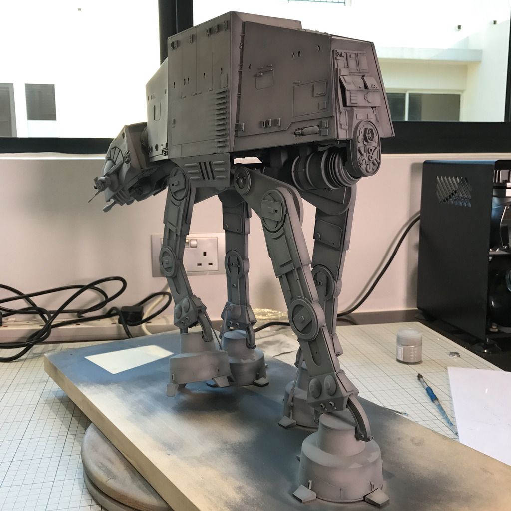

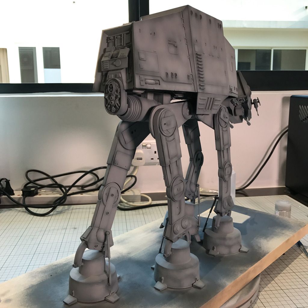

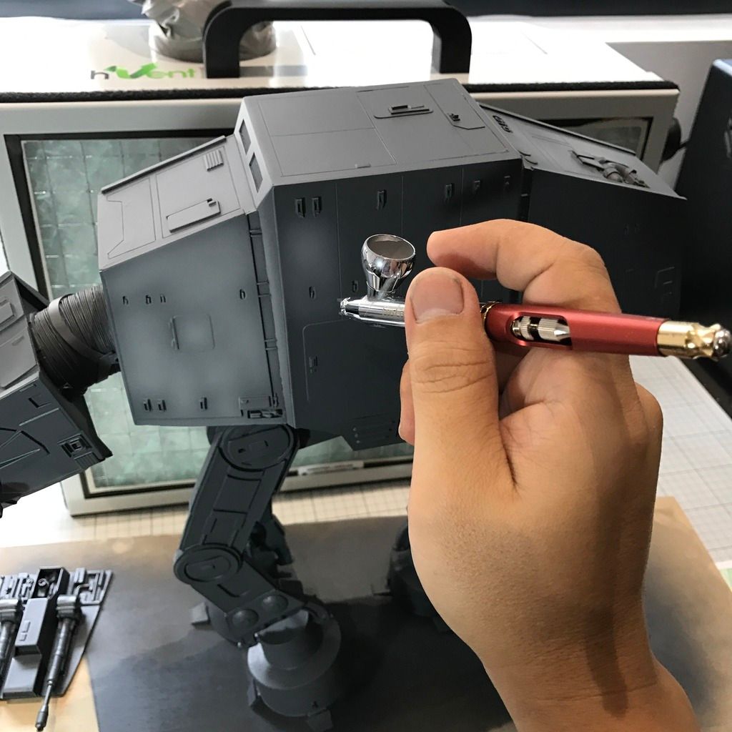

So here's a sneak peek at the post shading. Using Tamiya Sky Grey, I spray onto the wide areas, just barely misting near the edges and panels lines, so that the base coat still shows through it. Gives the model depth and character, much like how paint fades after prolonged exposure to the elements.
After the wide areas are done, then generally mist over the entire area to blend the colours together, so that the differences are not so stark.
Some people like to do pre-shading, which is to shade the edges and panel lines with a darker shade. I prefer post shading, as it is less likely to make a mistake. You are essentially spraying areas compared to spraying lines, which is more difficult to control.

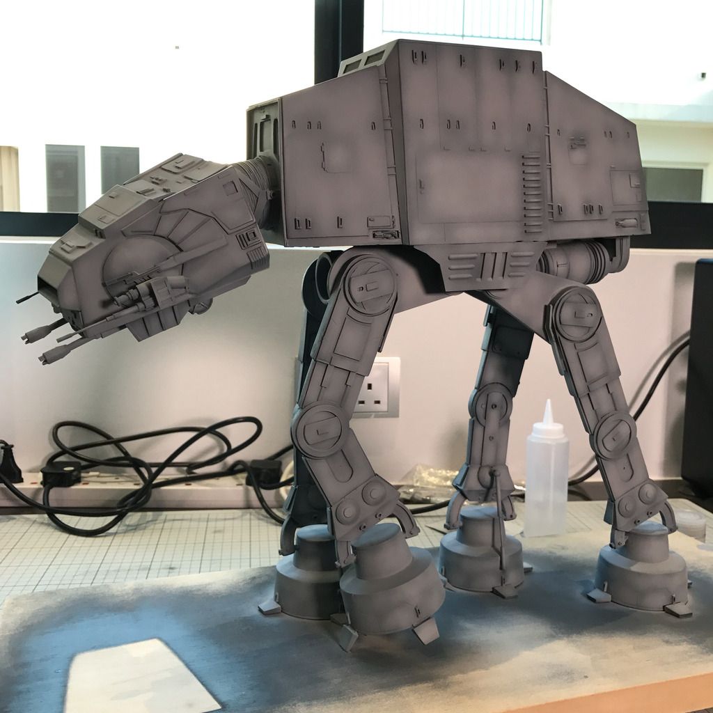

Here's a photo of roughly one side completed. Word of advice when shading large projects: Do it part by part. That way you will not miss sections after you've cleaned up your airbrush. ;)

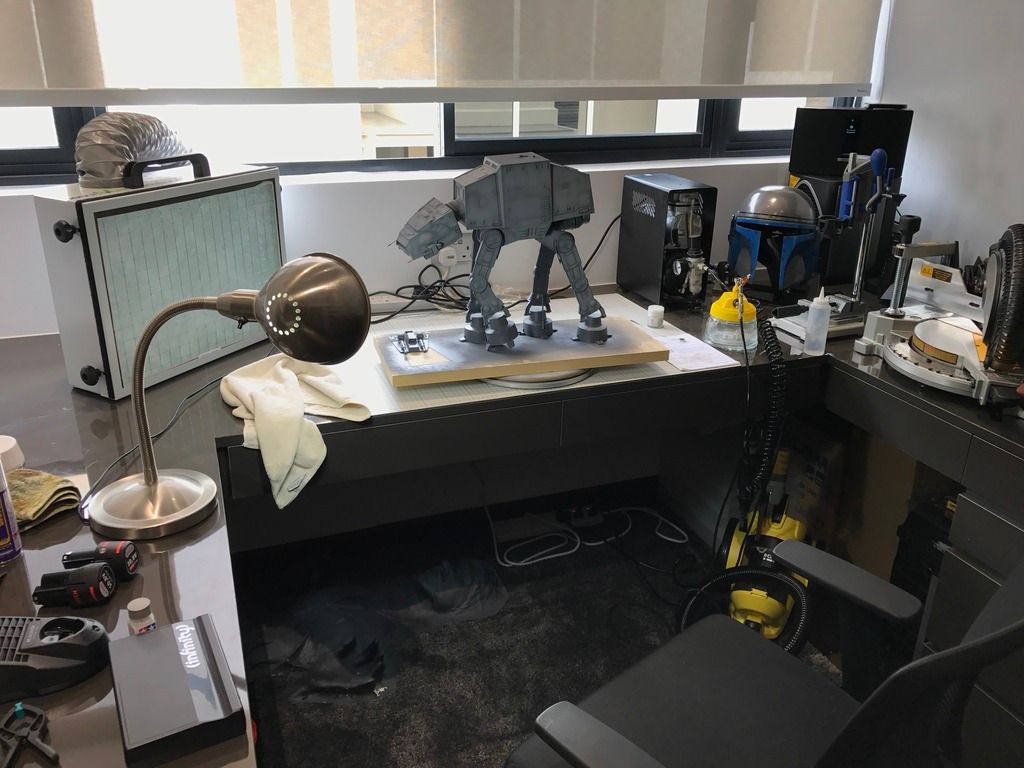

And here's a look at my new workshop. Loving my little corner in this world. Haha.

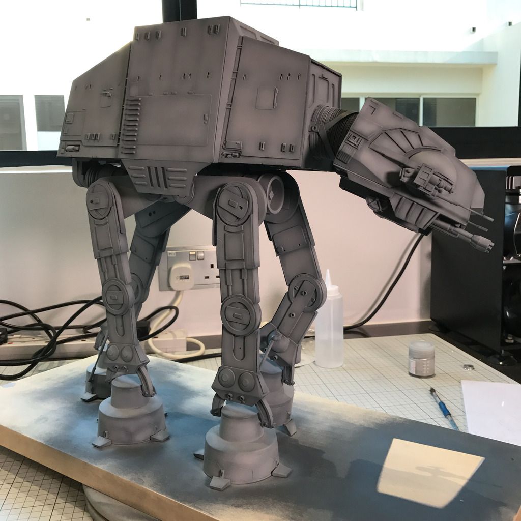

So, I managed to complete the post shading of the AT-AT. Here's how's its looking.
Next up will be the weathering process. But before that, the beast will be given a gloss coat to seal the shading colours in, and prevent the oil washes from destroying it.
