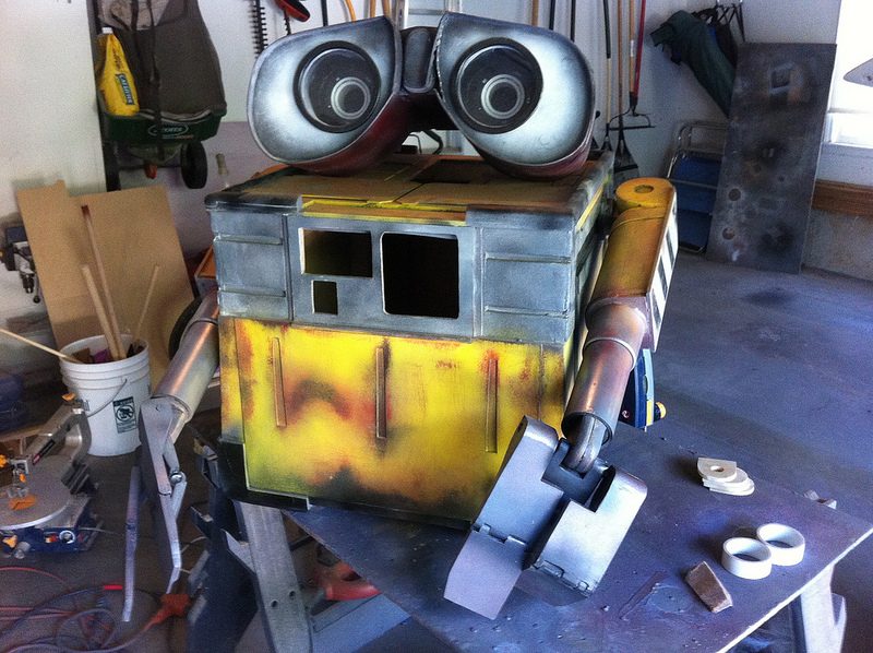

As promised, here's Wall-E with hands attached.
Some bad news... I've tried to stay away from using hot glue due to it's likelihood to fail over time, but, in some cases, it seems to be the best adhesive to use for certain parts (trust me, I've tried everything). Because we've had such a heat wave over the last week the hot glue failed on the eye trim. Looks like I'll need to re-engineer this piece today (as well as start working on the neck).
