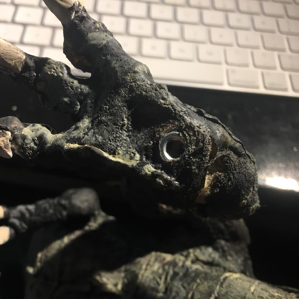

Here's a build I have recently finished, much in the style of the classic Willis O'Brien, Marcel Delgado, Ray Harryhausen style. (Step by step photos below)
Finished armature.
Padding out with urethane foam sheets.

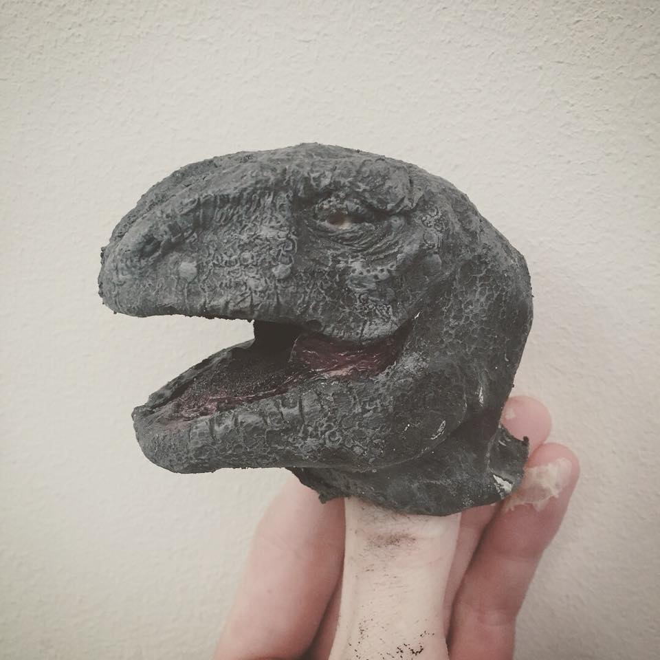

Head sculpted in Monster Clay.
Two-part plaster mould made of the head sculpt.
Wooden head skull (I attached wire to create the jaw articulation).
Latex casting with the armatured jaw inside.

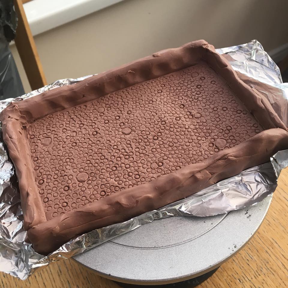

Monster Clay skin texture - this was moulded in plaster and then latex castings were made.
Skin applied. The claws and eyes were sculpted with Milliput and the teeth were from carved from toothpicks.
The feet were made up with wooden blocks with wire toes and a tie down nut embedded.
Some animation tests with the model.
