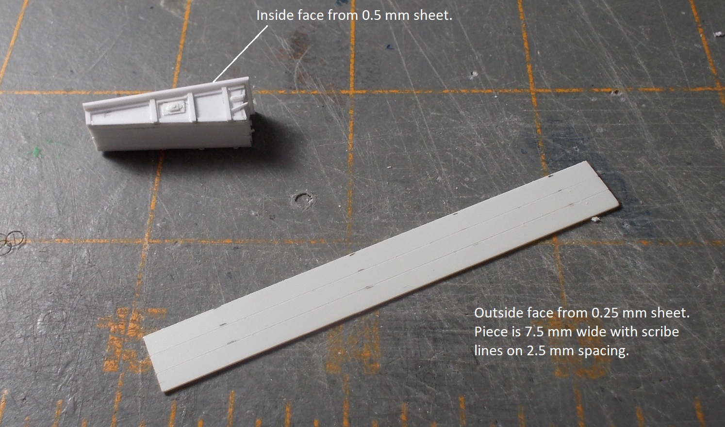

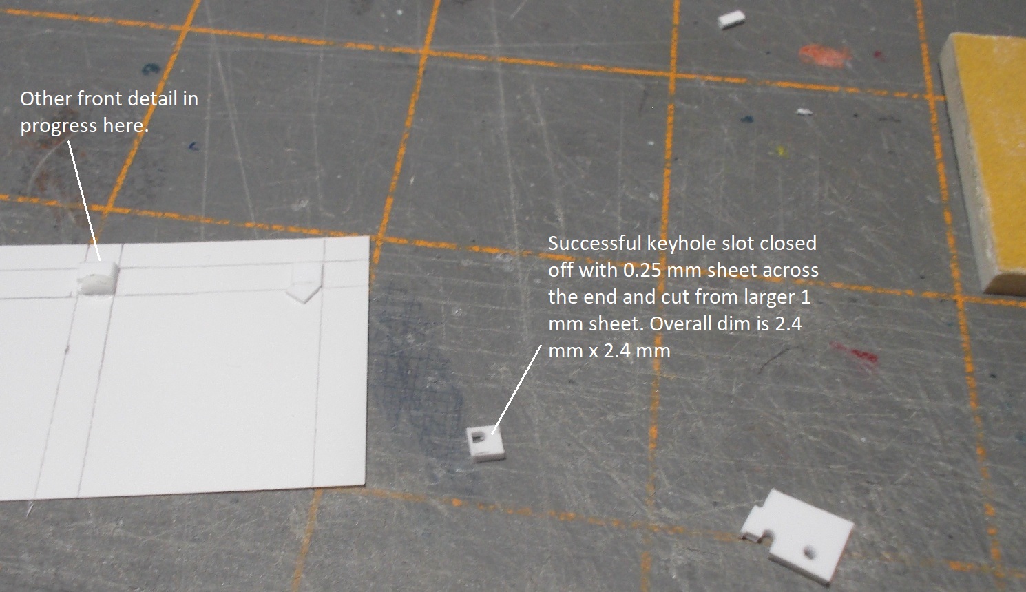

Small update to the above parts - the longer sections are now cut apart and detailing on them started. There is a small detail on the upper one that is absent from the lower one that I tried to document the creation of here. The whole detail is approx. 2 mm x 2.5 mm. I don't know why I bother - I can't look at my own models without glasses nowadays, but I like knowing the parts are all there.
Hopefully the pictures will make sense and not be too tedious.

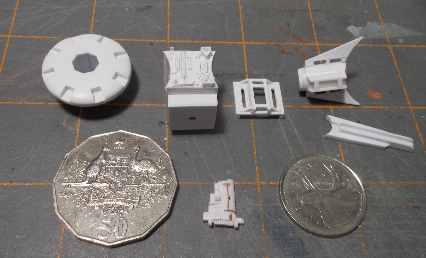

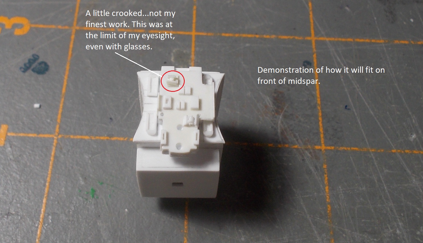

Back from vacation now and yes, feeling much better. I worked a bit in the evenings each night this week on the front detail of the mid spar. I started off taking lots of photos, and then I got lost in the zone and forgot to take a few. It's like a home renovation show when they break for an ad and come back afterwards to show the whole kitchen done. Anyway, more tiny bits. The mid spar part is almost an entire kit's worth of scratchbuilding on its own.
I have to admit, I'm not fully 100% happy with one detail here, but I can only really tell it's crooked on my monitor at many times life sized. Hopefully the paint and so on when I actually build this to a finished model won't make it too obvious.

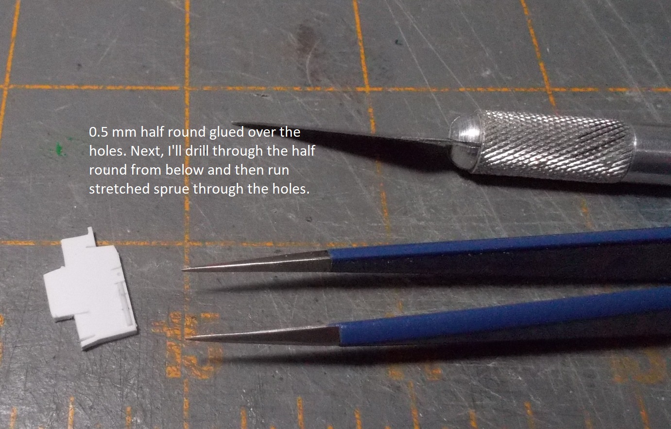

Nope, not a surgeon. (I'm an engineer actually.) The small parts are a challenge for sure, but I always try to plan to work on bigger base plates etc. so that I can handle what I'm making. It's only at the end when I cut a completed small part from the thin sheet I'm creating it on that there is any chance of it getting lost or being hard to handle. I don't know if I mentioned using a knife to pick up small parts, but it works very well and doesn't leave a scar when done. Here's an older pic of my FM Y wing build to show what I mean. It's really not so bad, and the liquid cement gives time for fine tuning of position.

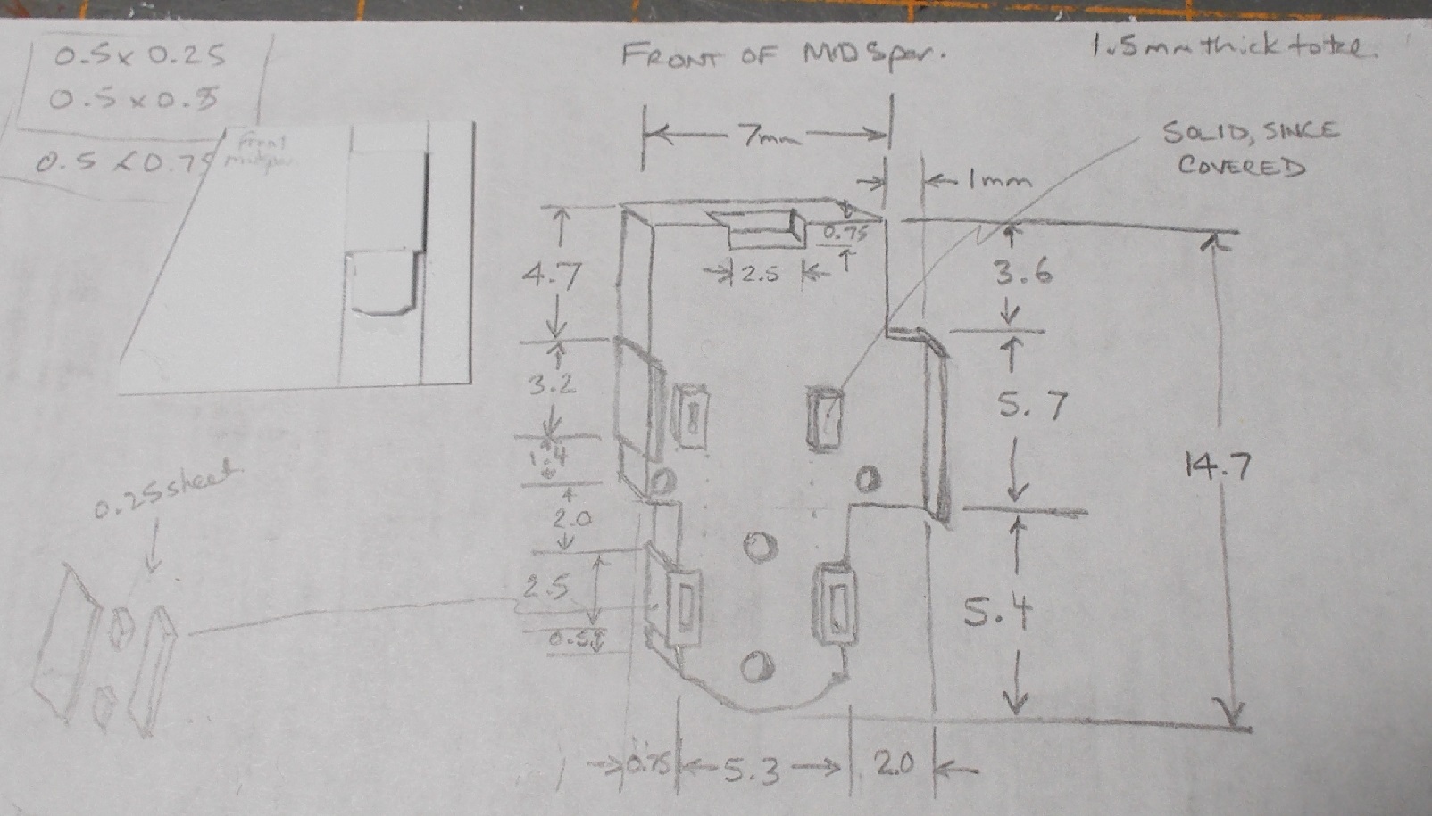

I've been puttering away on the remaining mid spar details as usual. A lot of the time required is me waiting for the glue of various intermediate steps to fully cure so that the components can be handled. Generally, I study my references and make myself some scale sketches to work from. I have a good stash of styrene products and try to do the math on what thicknesses and cross sections of materials I can use to create the final shapes I need.
Anyway, more photos of tiny things that don't quite add up to finished parts yet, but maybe some bomber fans will see where I'm going...

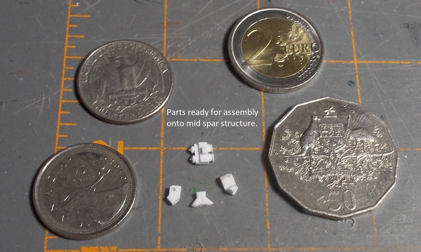

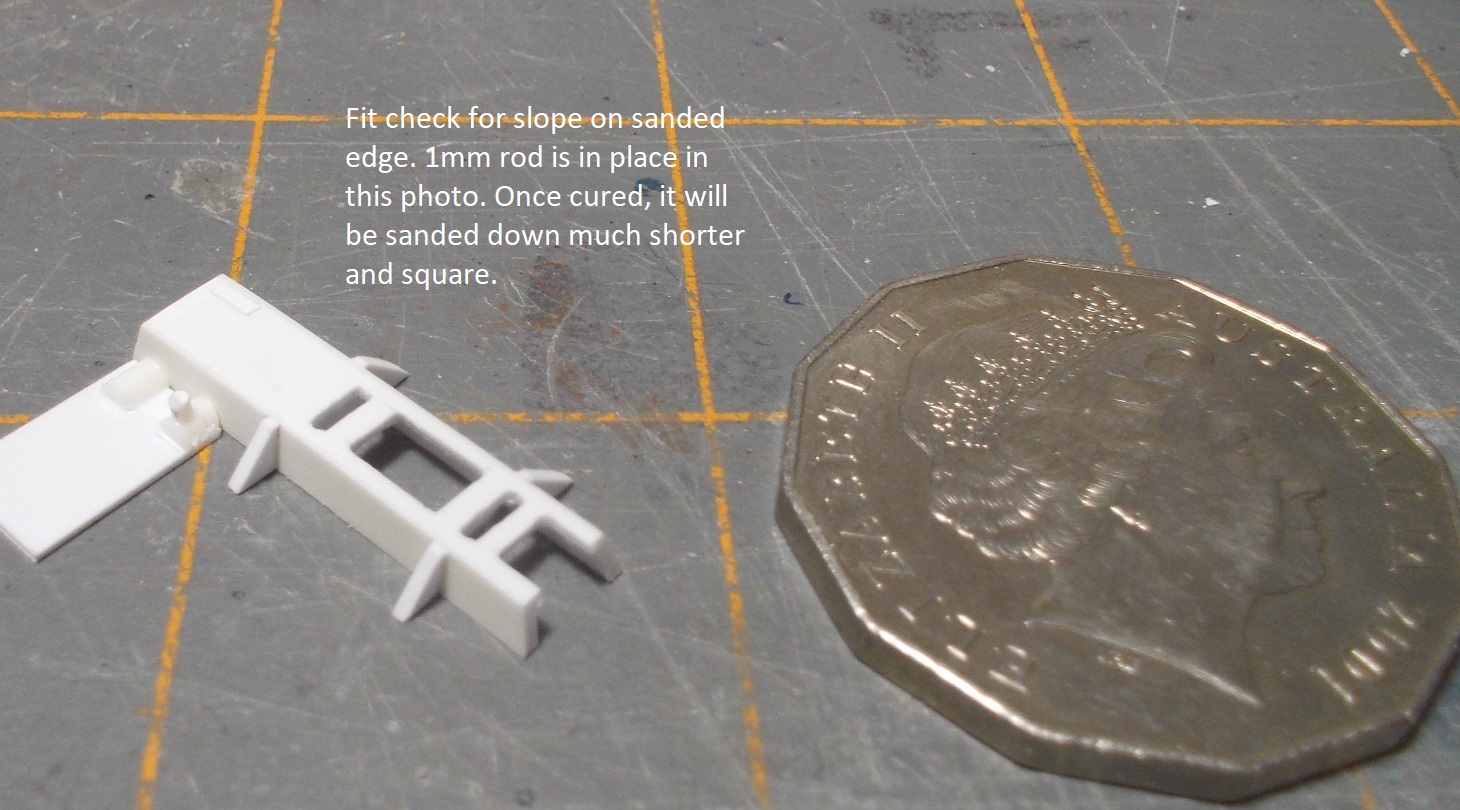

Last update of the weekend. Can you tell it rained all day today? Just for Ged, another money shot. Just for Hunk a Junk, an American quarter was found.
I'm pretty much done the building of parts for the mid spar. There are a few small bits I'll add during the final assembly stage since they're fragile, but otherwise, all the parts are made now. Though I'm happy with how it's come out, I'm also glad to be moving on to another part of the ship!

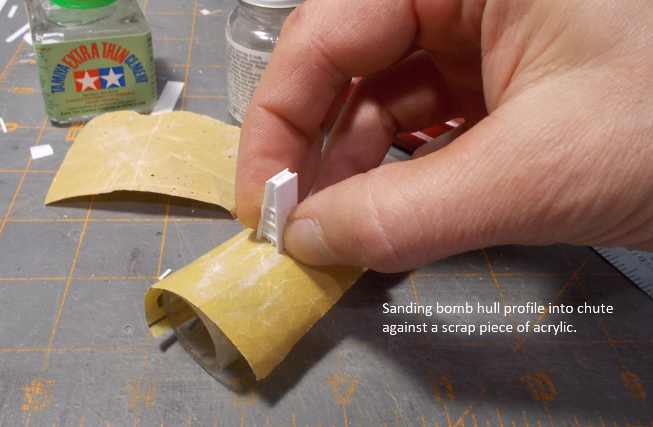

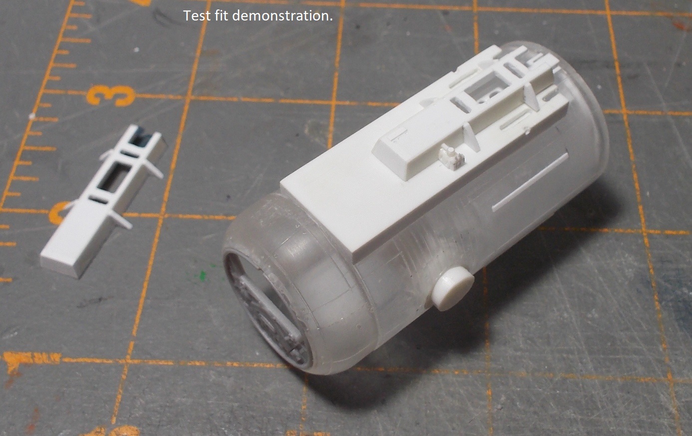

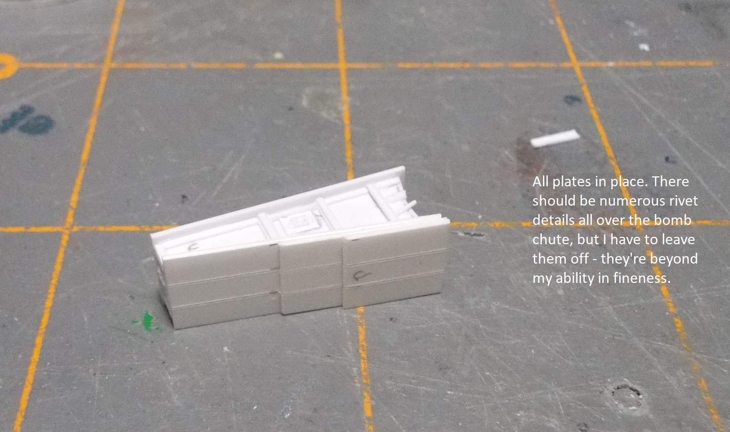

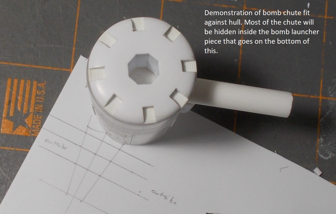

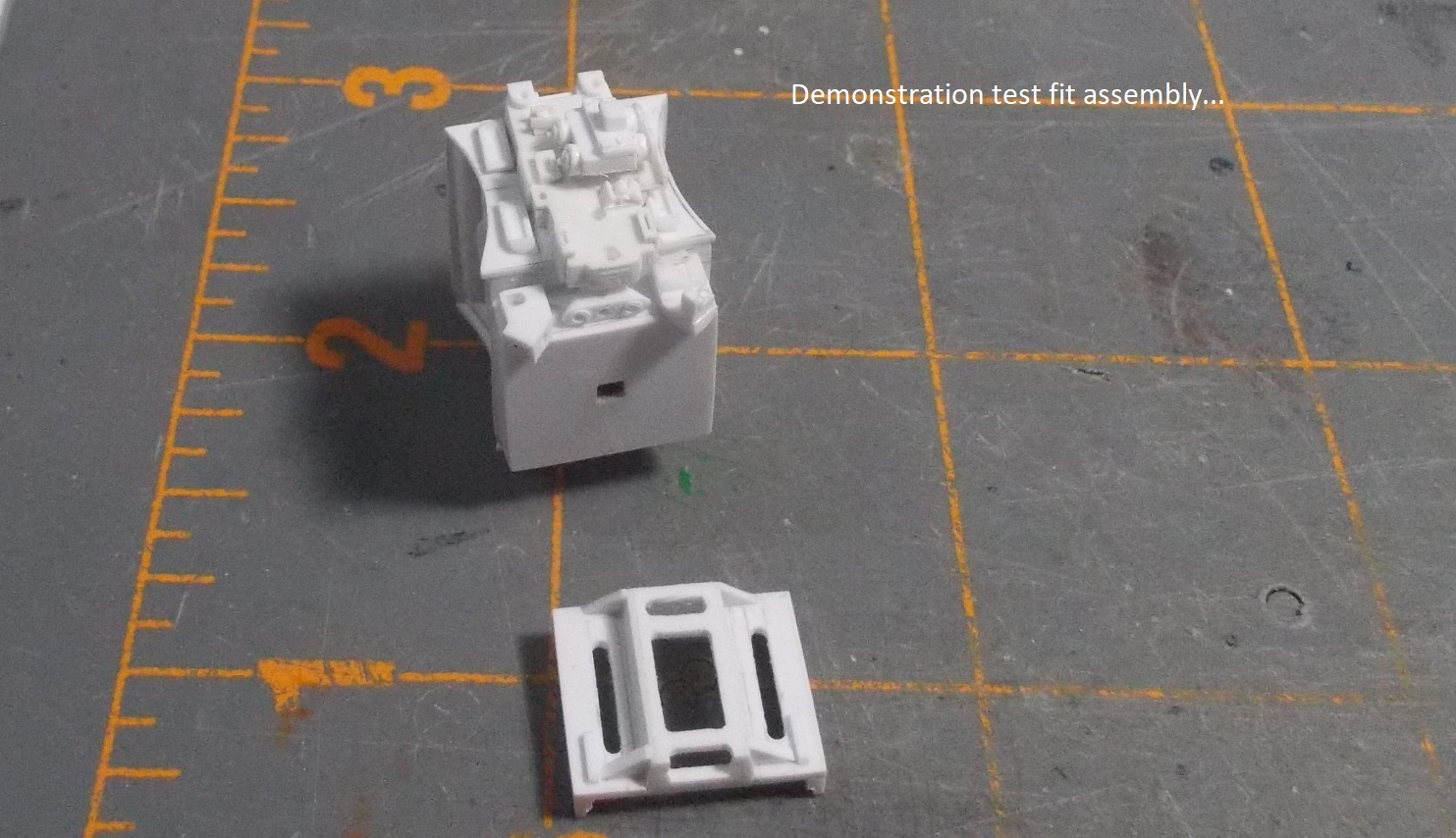

Back at home, I got working a bit on the bomb chute. As with the rest of the build, it's the same type of thing - scale drawings from references and then careful building of layers and detail.
