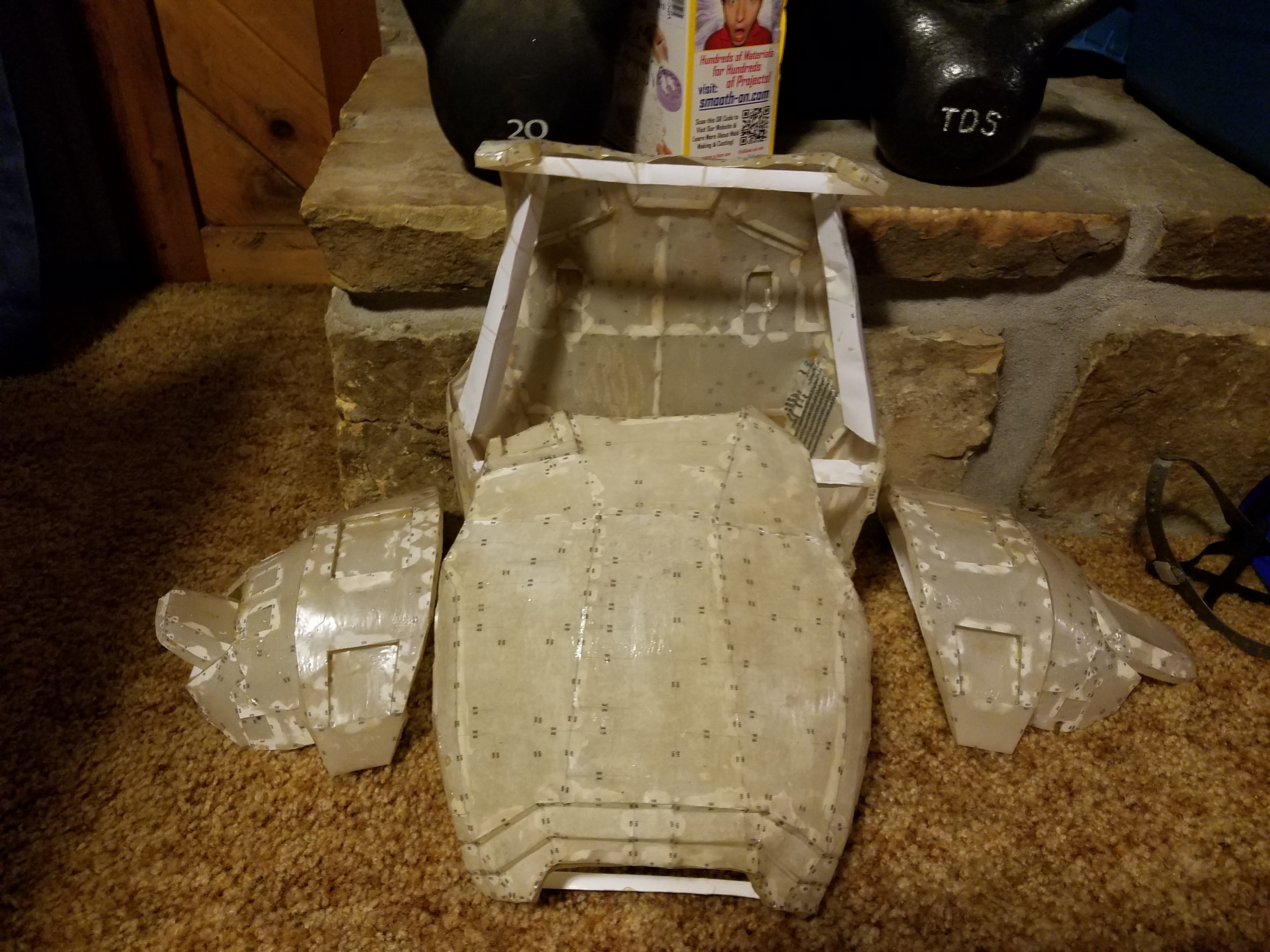

Update: I've got the basics on my kid-scaled costume well on the way. Here's my vest

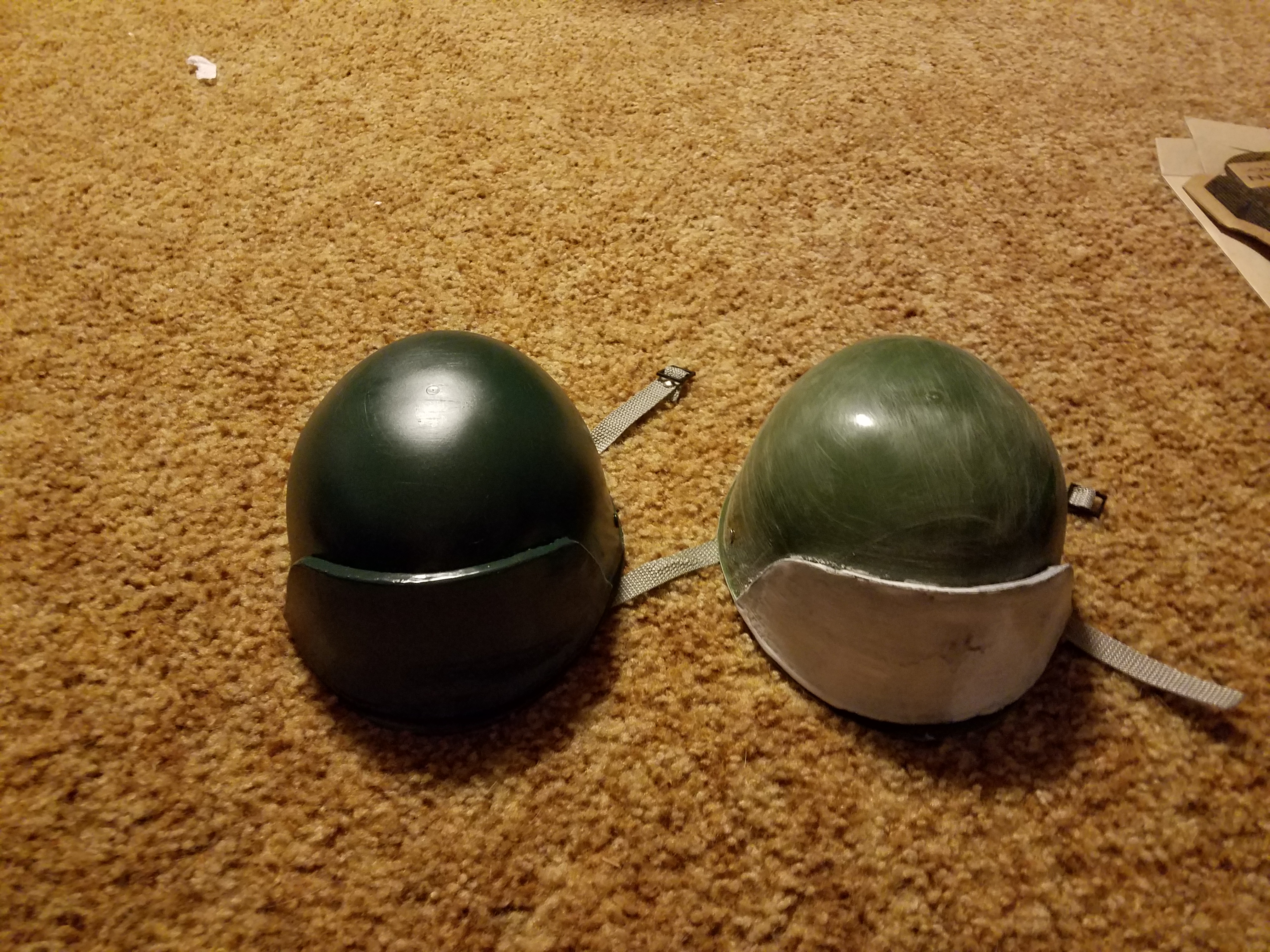

Helmets: (I used some cheap Wal-Mart costume helmets for the kids)

The resined pep models seen above have been slushed (huge mess but only a single evening's work) and the front and back vest plates are in the bondo process. I've also begun gluing the pep models for the adult sized vest I have to do next. I've been doing this around work for the last 7 days, but I have a long weekend coming up so I'm hoping to make some leaps forward. I'll try to post some more pics when I can.

I've cut nearly every foam piece I'll be needing, and I've begun glue coating in the most recent pieces, but all the others you can see I've coated with both glue and acrylic. It's not quite as sturdy as the few pieces I managed to successfully coat in the 65d, but it'll do. I'm hoping they don't pinch when I strap them on b/c the coating tends to crack when it bends just a little too much. The green pieces you can see are the ones that have already gotten the base coat of hunter green for the camo. You can also see in the pics the 2 kids helmets (stacked) and the first adult helmet that have started the assembly process. I've painted the details on the kid-scaled helmet cameras (no pic yet) but I haven't gotten the adult ones printed yet.
The kid scaled armored vest is well on it's way on the bondo process (the pieces here are just awaiting primer) and the adult set has only 2 pieces left to assemble the pep on. I can't slush or resin the adult set until my friend drags his butt across town so I can verify the fit before it's set and I can't alter it. There was some trouble getting the front and rear vest pieces for the kid set to line up, for some reason they didn't come out 1-1 on the pep models. I didn't catch it until it was too late, but it's workable, the shoulder guards will cover the difference and I can pad them underneath so they're not too uncomfortable b/c they don't line up properly. I'm going to triple-check the final fit on the bigger set.
