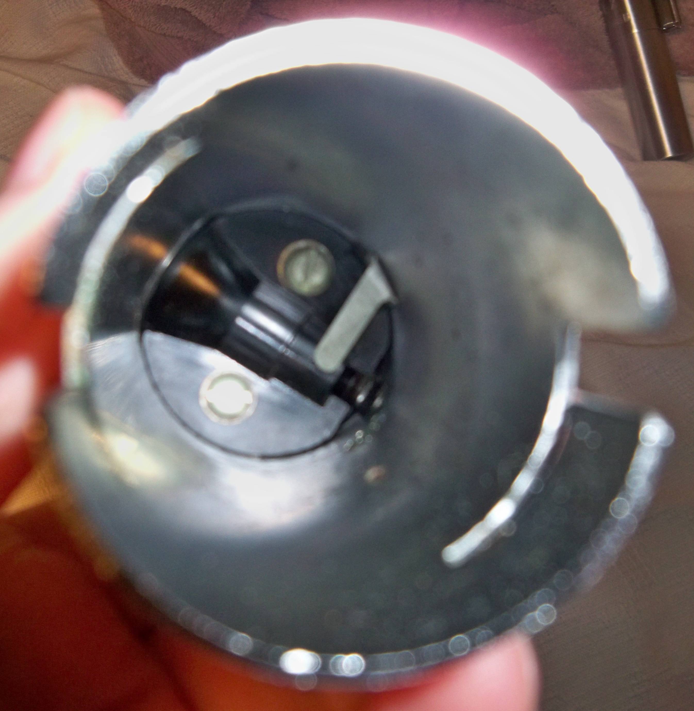

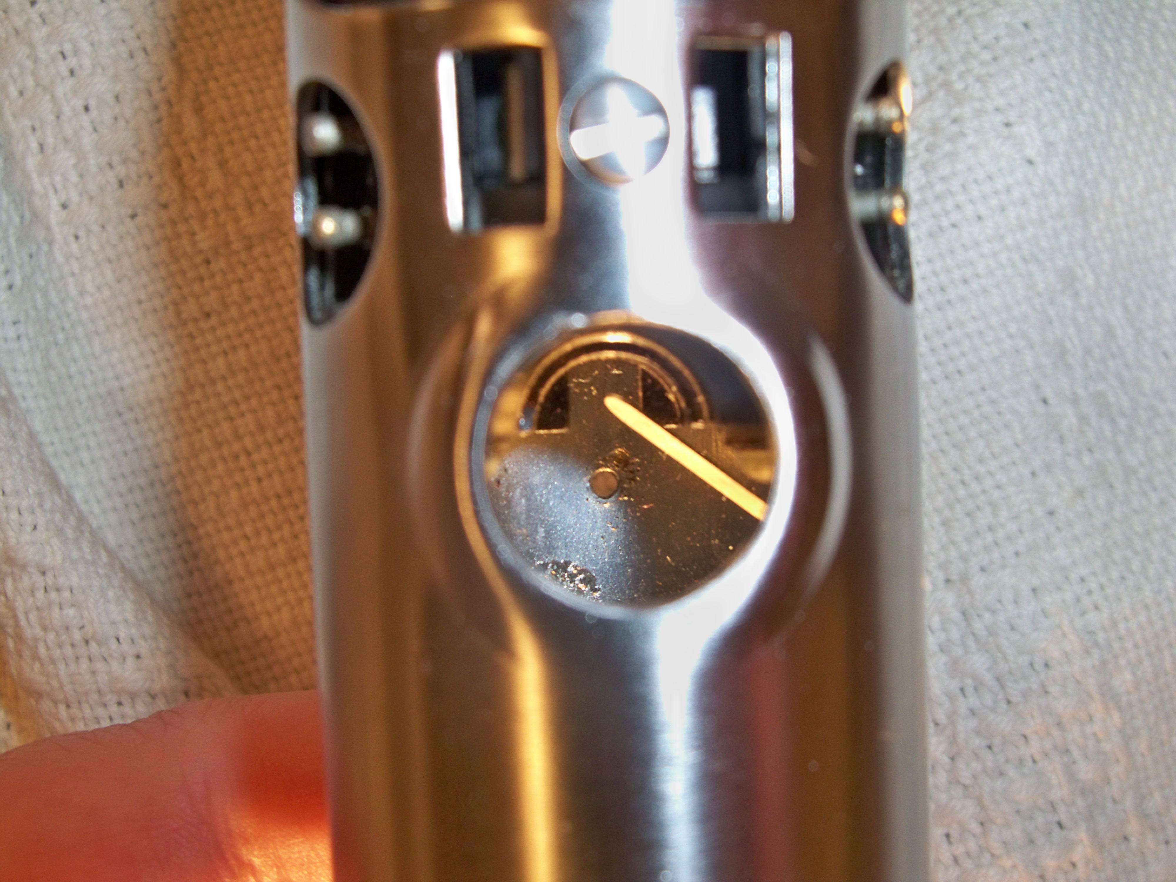

One of the things I noticed was the... black plastic thingy (sorry for not remembering the exact term for it)... below the bulb clamp was elevated higher than on other Graflex flashes. I don't know if it's a factory mistake or one of the previous owners tried to take this apart and incompetently put it back together. I also noticed that it's missing pins underneath where the button would normally be. Lastly, I think the internal mechanics might be broken. I've also included pictures of the button and glass eye, too.

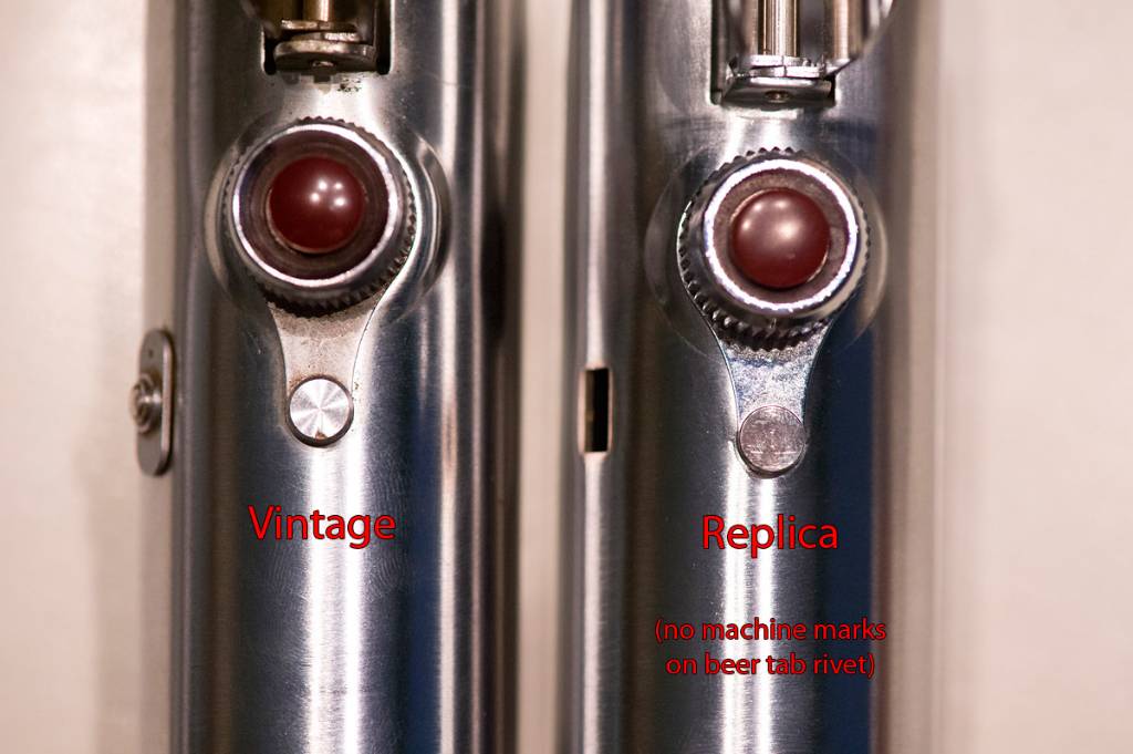

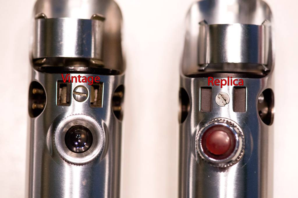

CHalcyon82 Sir I am happy to let you know you have my friend a very beautiful original graflex top. I've attached an image to this response so you can save it for future references if needed there's a couple that will help you identify a fake from an original. You can see that your screw is not flat at all and the black part has a tiny lip under it a fake one doesn't have the lip under it. Hope this helps out!

Hi there ... as you can see from the posted pictures above ... you could unscrew the set screw and then push back the black bakelite part a bit until it sits flush with the metal edge. It does seem someone tried to remove the guts and perhaps has tampered with the bunny ears rivet too ... push it in as far as it goes and then try to hammer on it lightly on the other side to create a lip so it can't pop out. As for the glass eye ... put the glass back in the cap holder with the lens facing outwards then push the spring against the flat glass side and place it back inside the tube ... the spring should keep the glass in :)

Thanks for the assist! I'm glad to know it's legit.

Also, thanks Sym! I know you're an expert on these matters so I'm glad you joined in. Unfortunately I picked a bad time to have this arrive because my home is a mess and I couldn't even begin to tell you where any screwdrivers are so fixing the bakelite (I thought it was called something like that!) will have to wait. As for the guts, between my first post and now, I was able to come across one of my complete Graflex lightsabers in this mess and there's definitely a difference between the two. I initially wasn't sure if there was something missing or there might have been some variant design in play here but it looks like there's a chunk of the bottom portion of the guts missing. That part that should've helped hold in the glass eye securely. Because that's what's preventing your suggestion from being successful. Every time I've tried that, the spring falls out and so follows the glass eye.

Hey CHalcyon82 ! It looks vintage to me too, but it also appears to me that you're missing the inner half of the pointer bulb holder (the black bakelight part, battery side).
