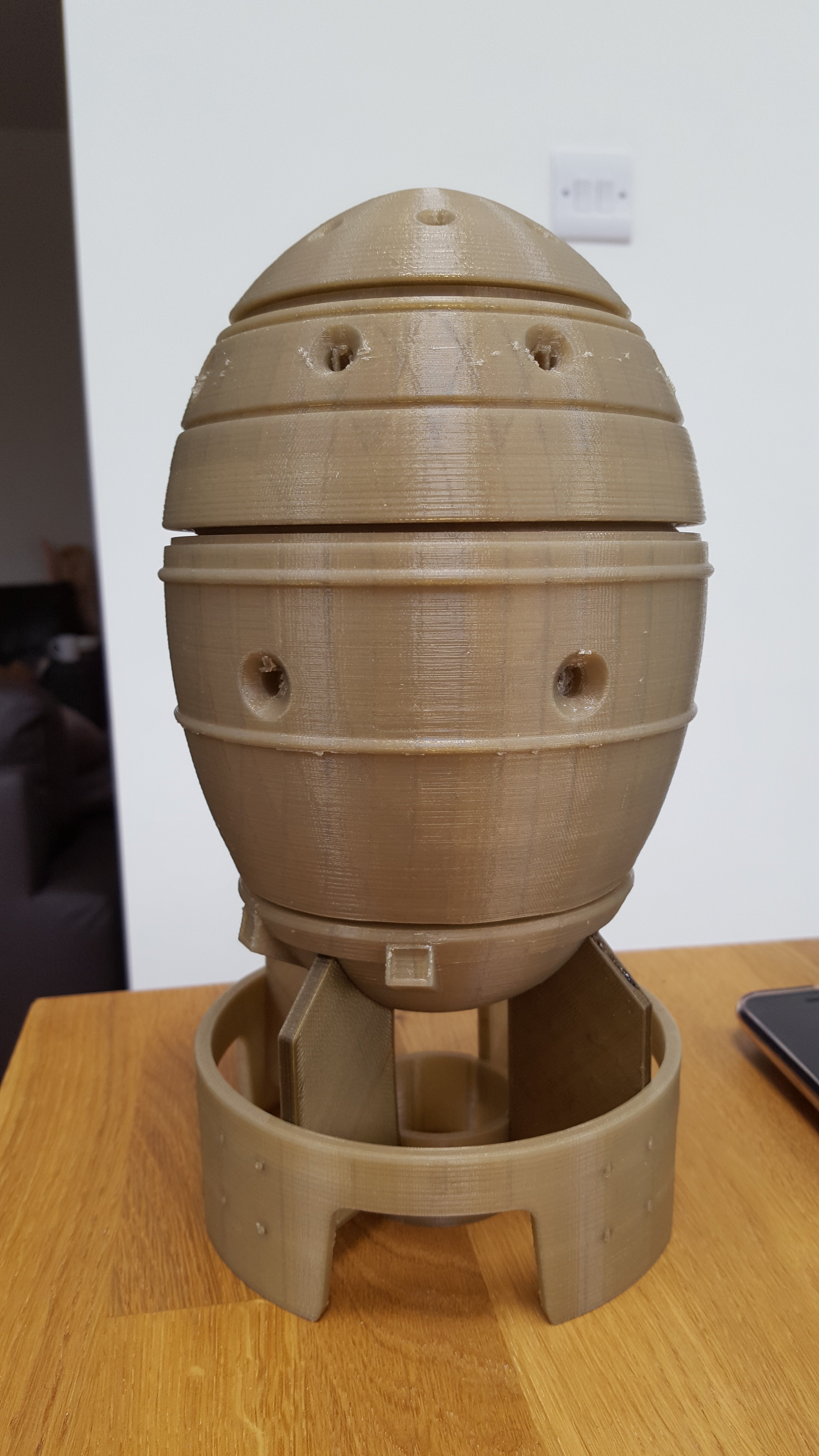

First off, printed the model
It is an excellent model, it printed very well with no problems at all, it came out really clean.

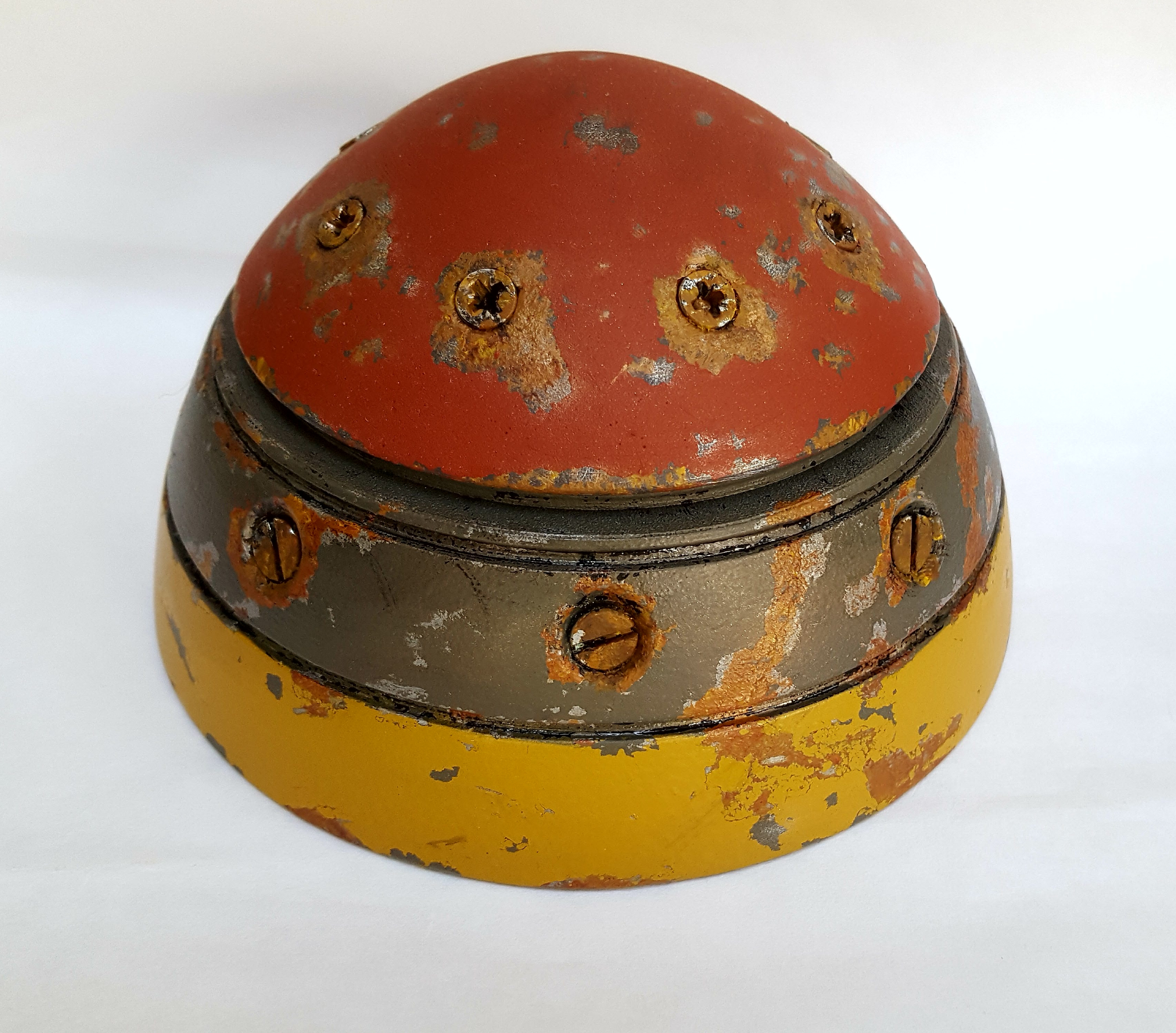

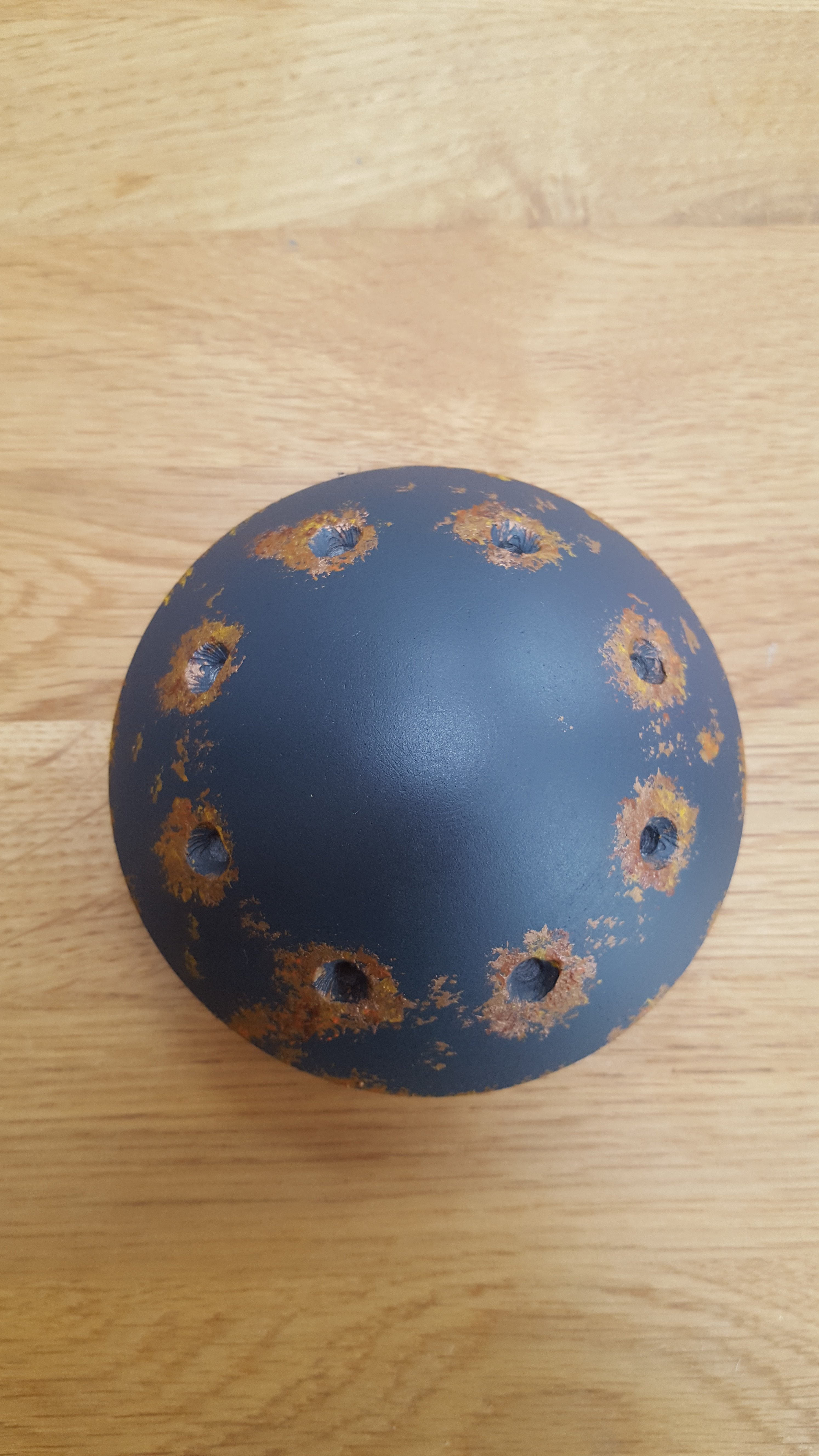

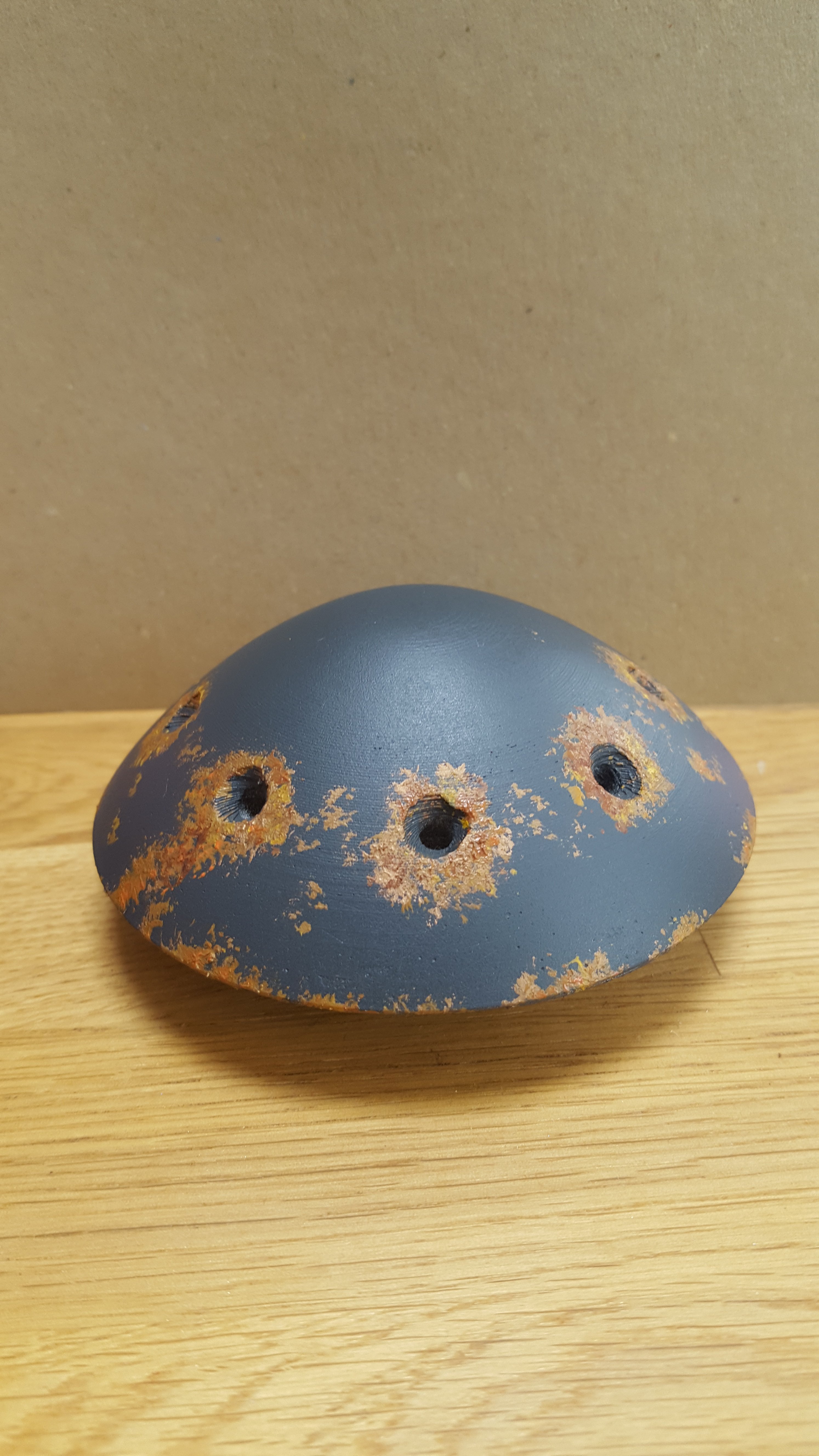

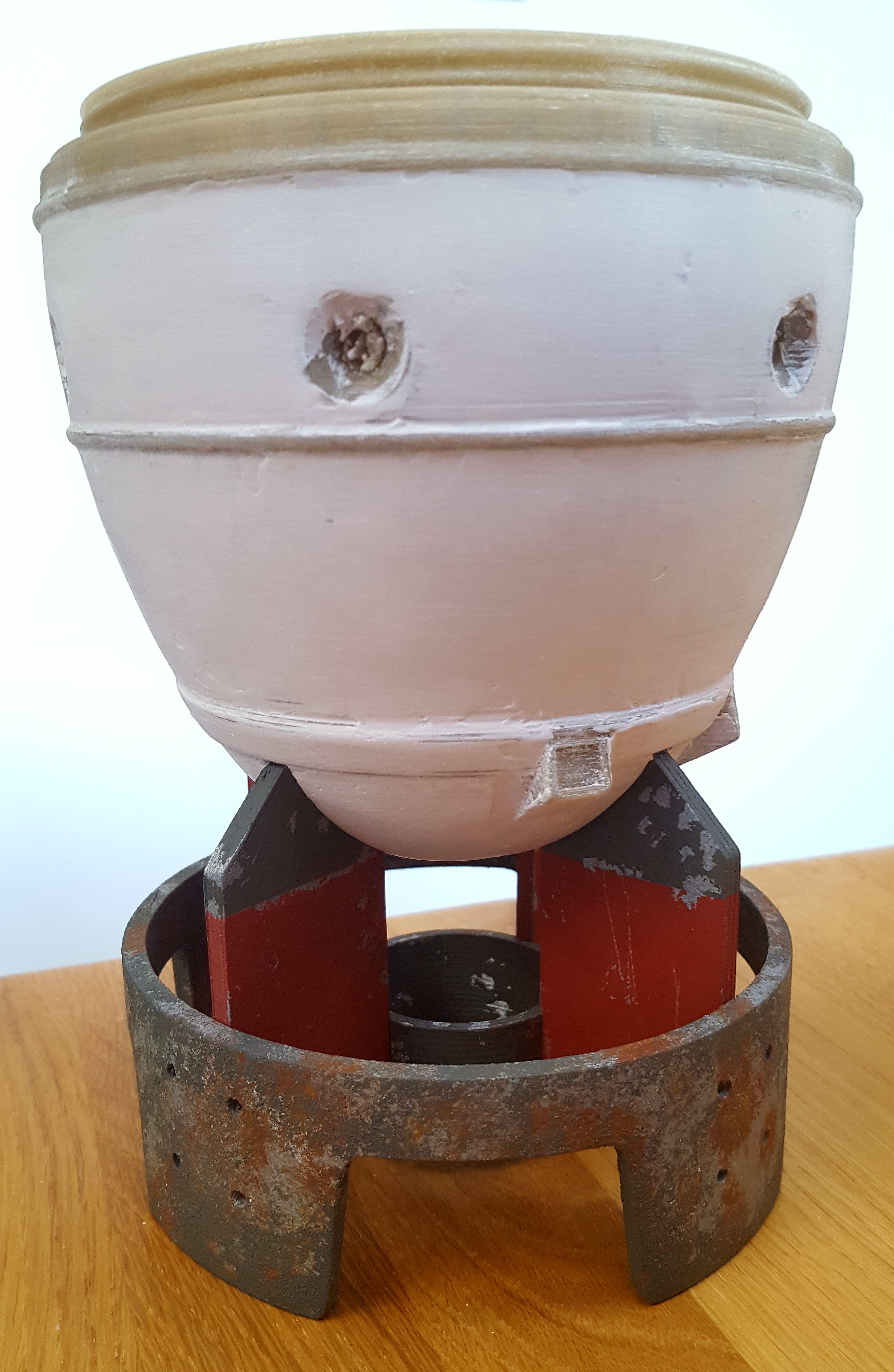

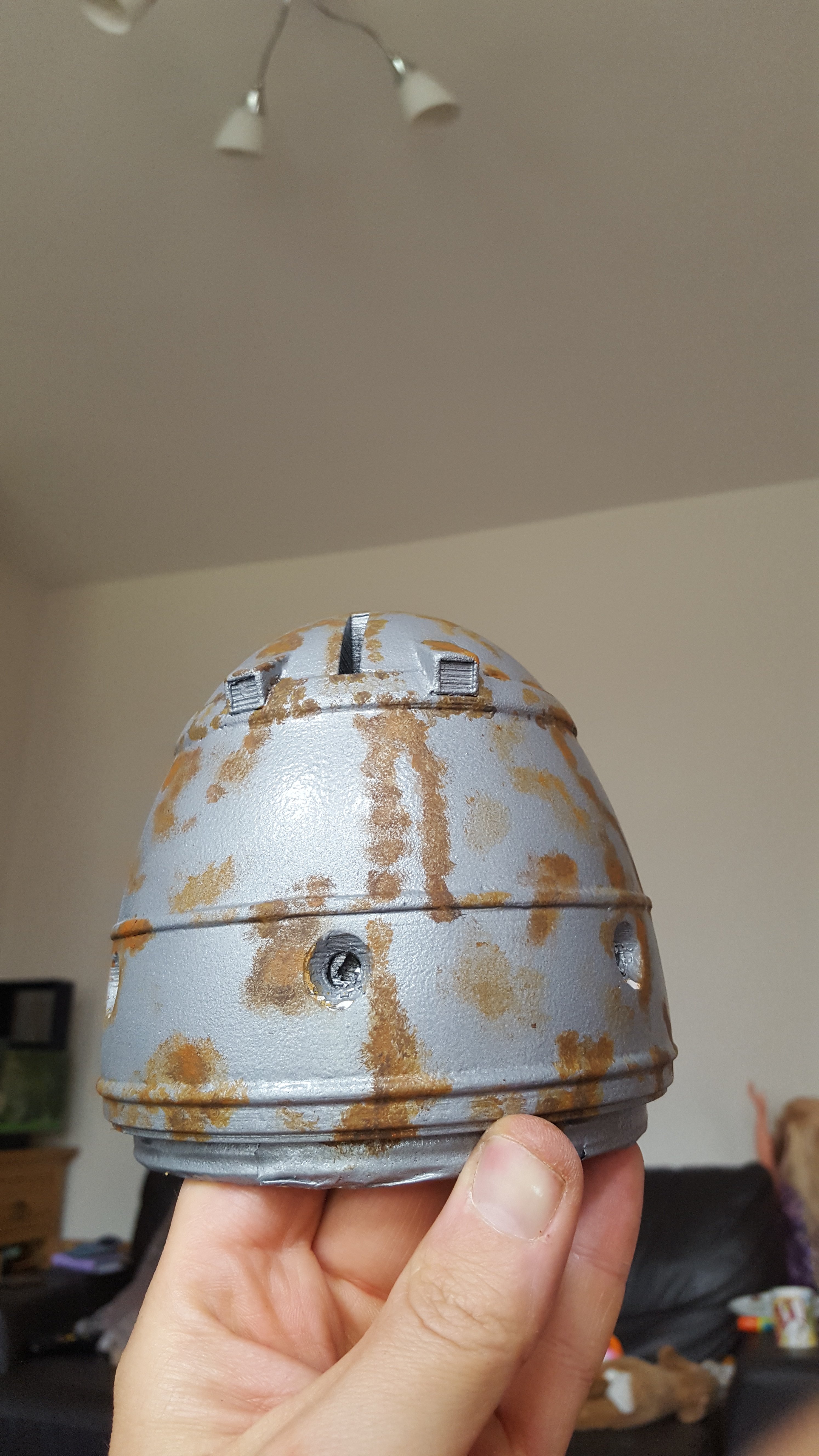

I started at the top with the nose cone. I used Halfords knifing putty to fill it. It goes on well and is really easy to sand. I gave it a couple of passes and then hit it with primer. I painted in some rust with acrylic paint. Part of why I agreed to the job was to have a go at some heavy weathering. Most of what I do is only light or clean.
I used vaseline to dab around the rust areas as a mask. I'm using Halfords camo green for the main colour, so I didn't want the other colours to be too bright, and as I already had some, I used red primer for nose colour.

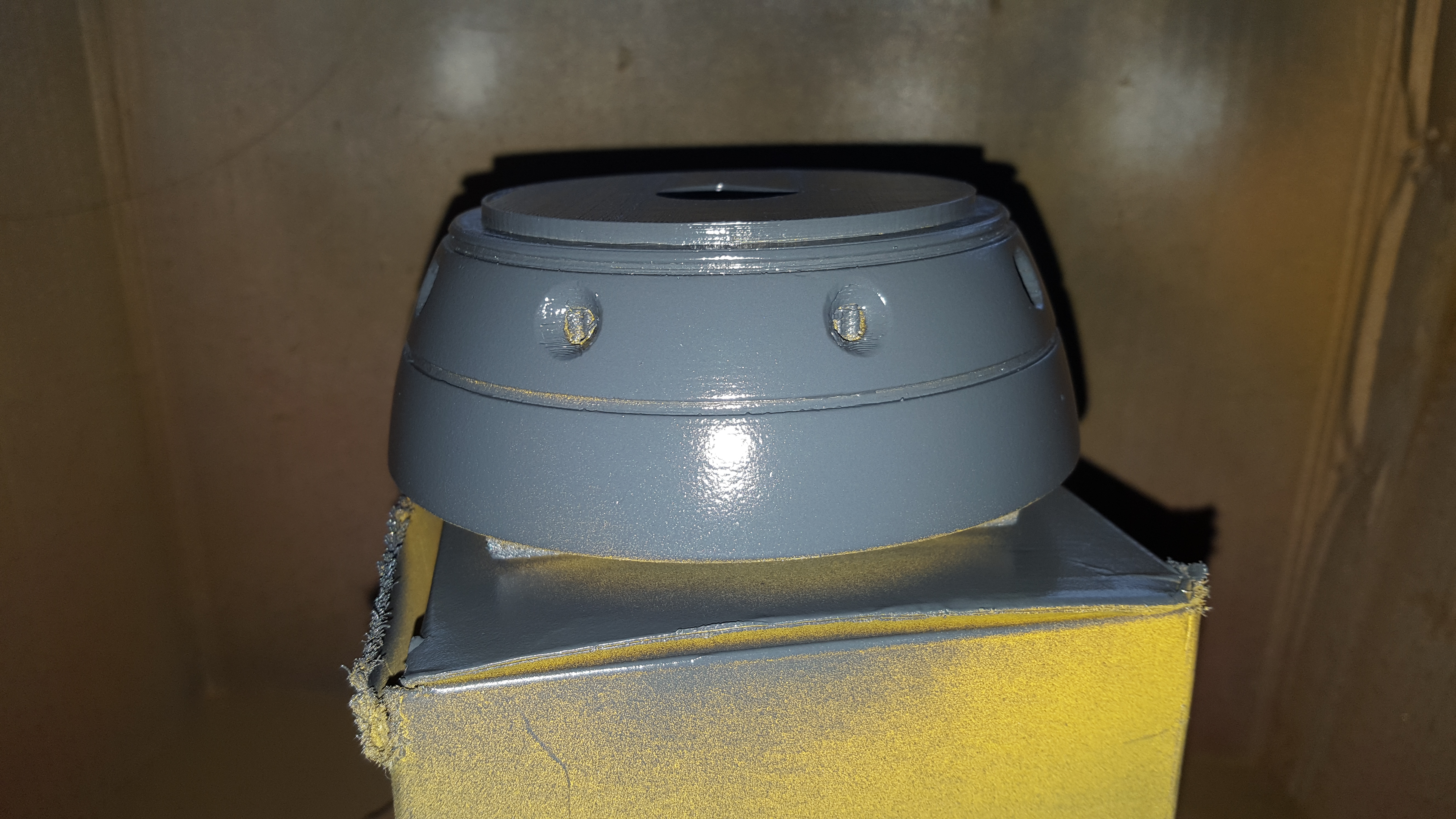

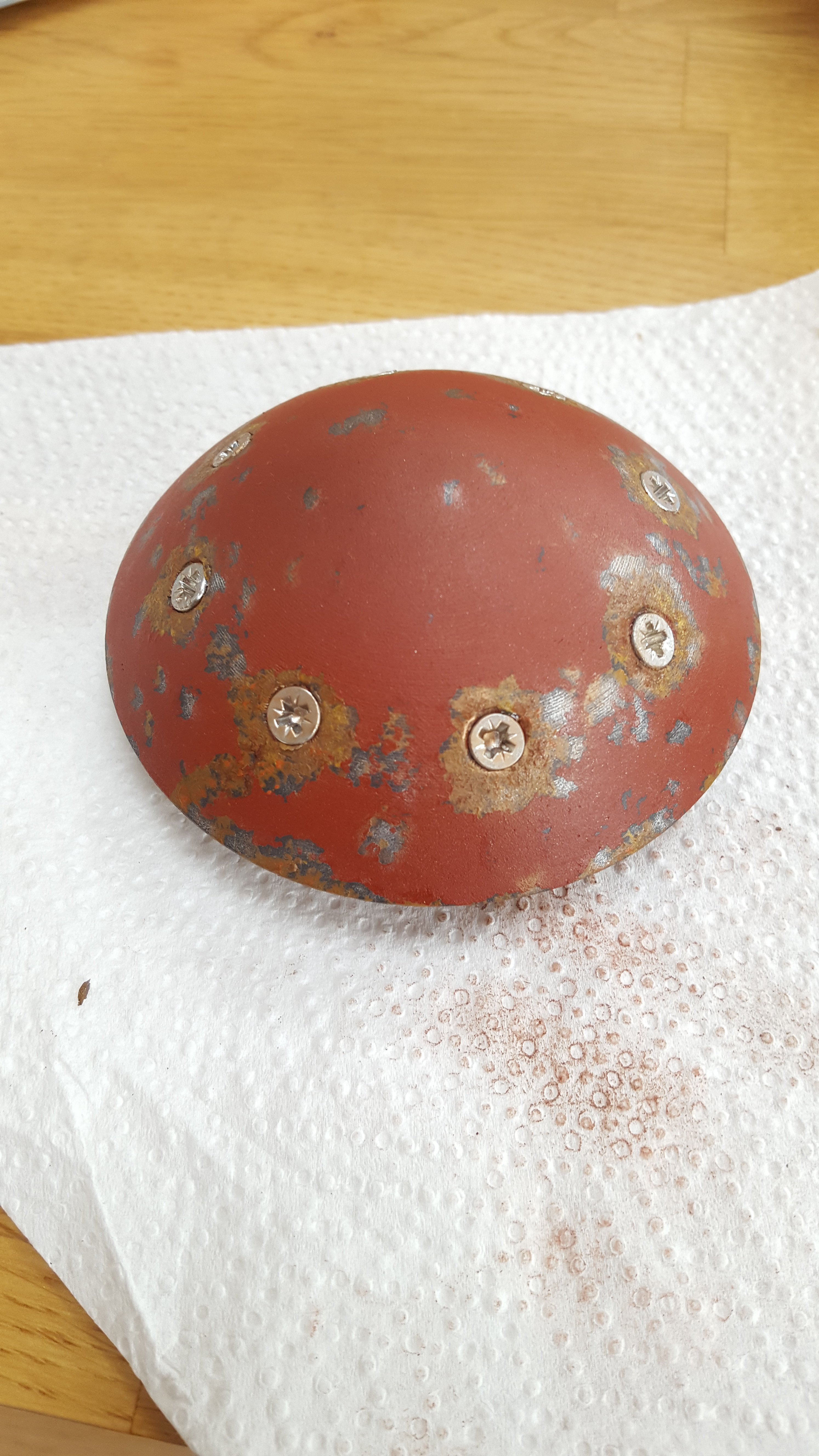

Still working from the top down, the next piece is the lid of the container. Same process as before. This time I gave it a coat of silver hammer finish before adding the rust and top coats, wipe off the vaseline when done. I used the filler primer I had for the yellow as again it is quite flat and doesn't stand out too much from the green. Then glued it to the nose cone. I use power flex gel Loctite, its solid.

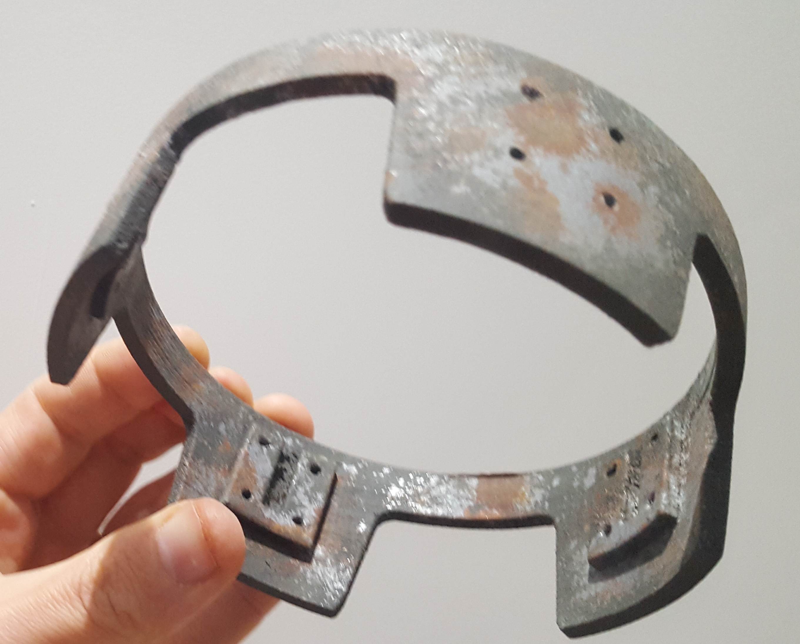

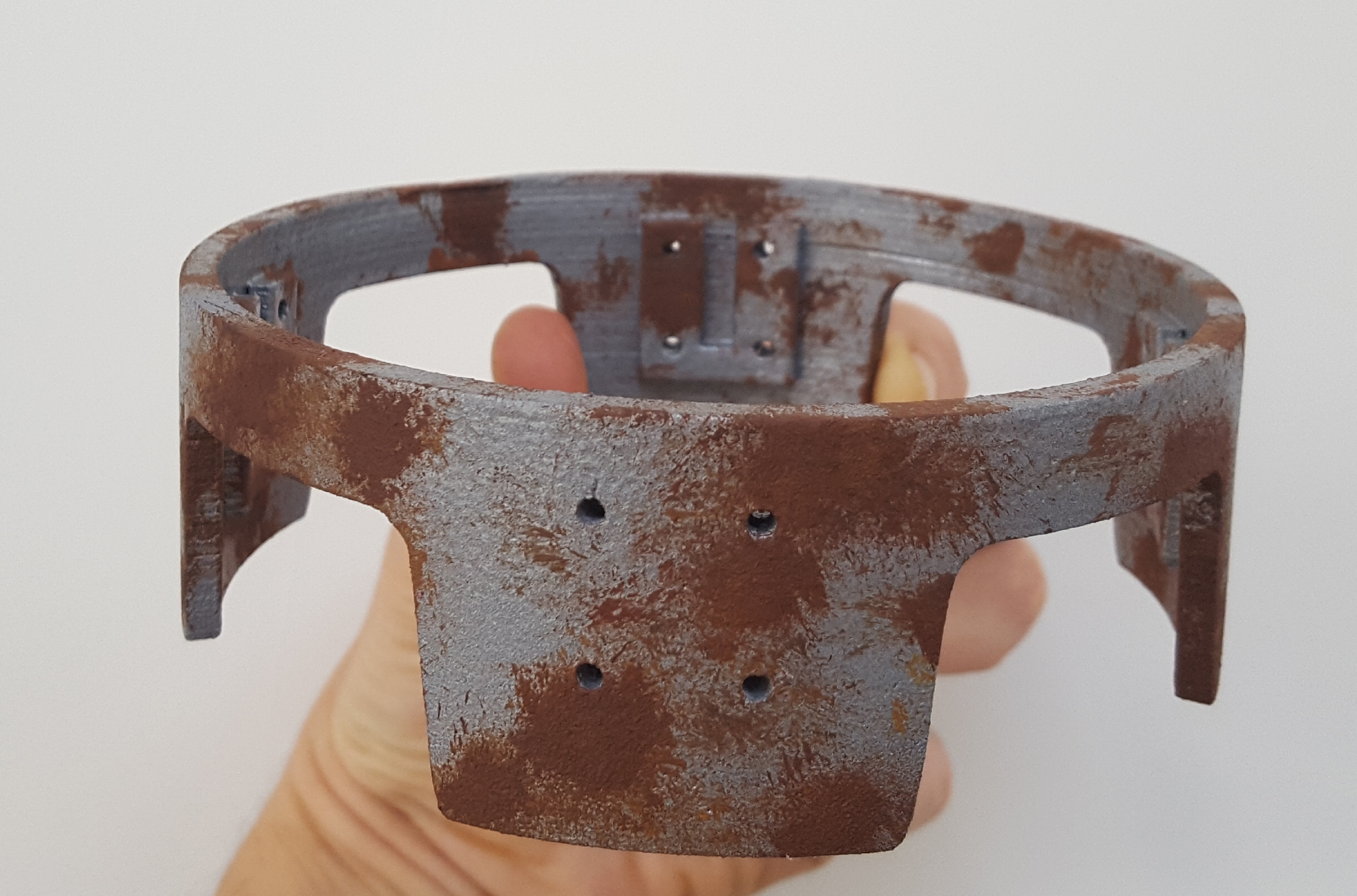

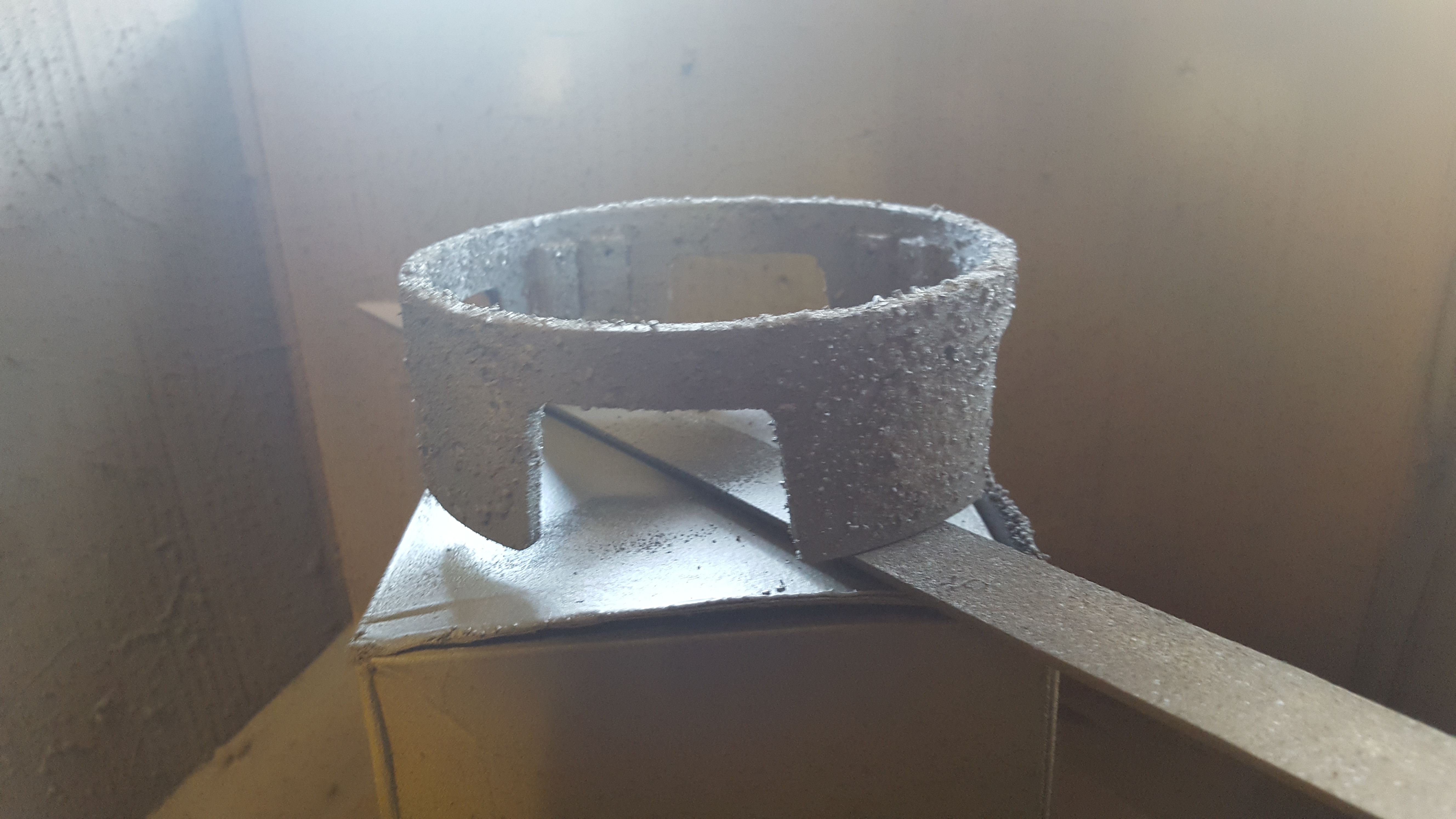

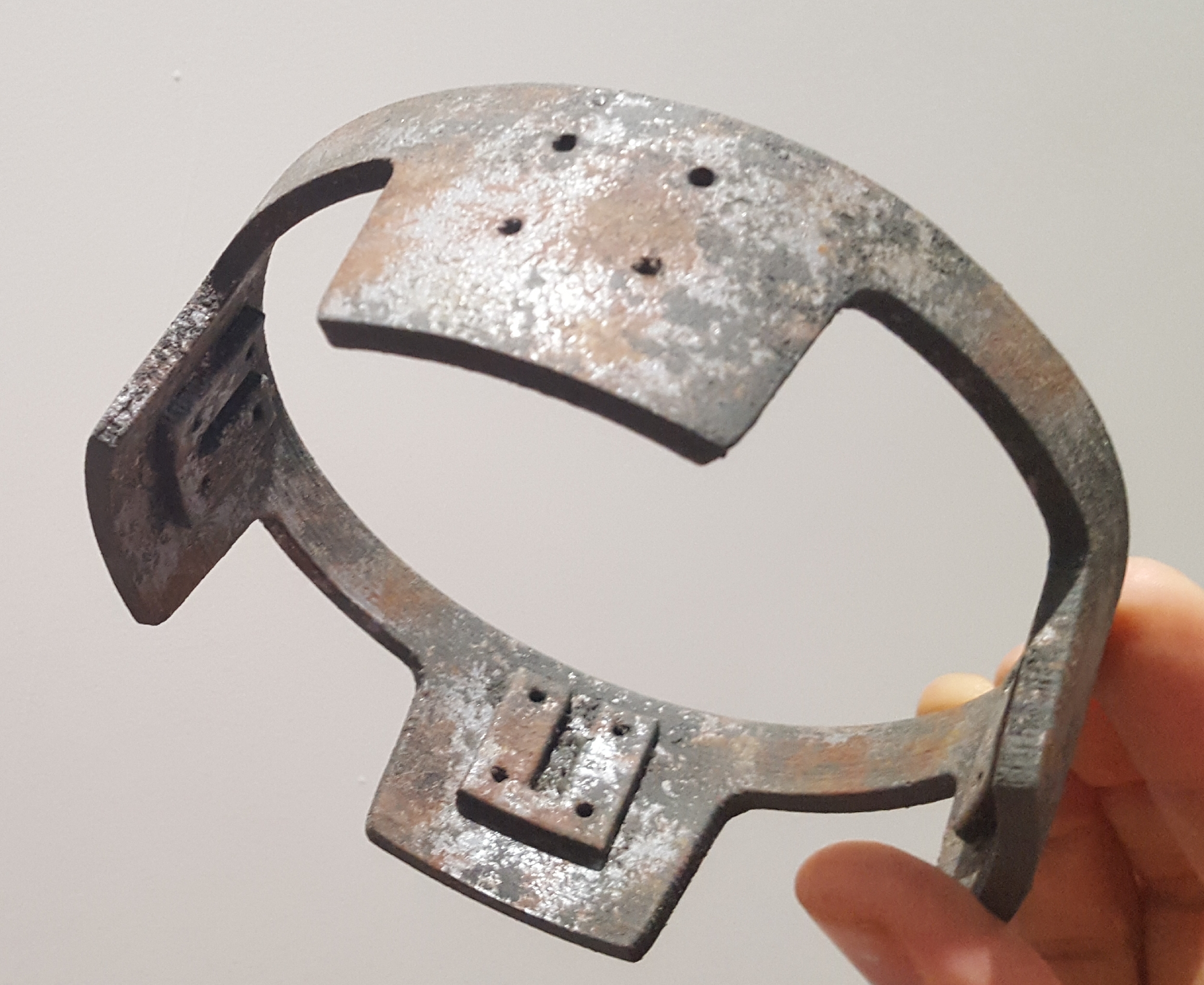

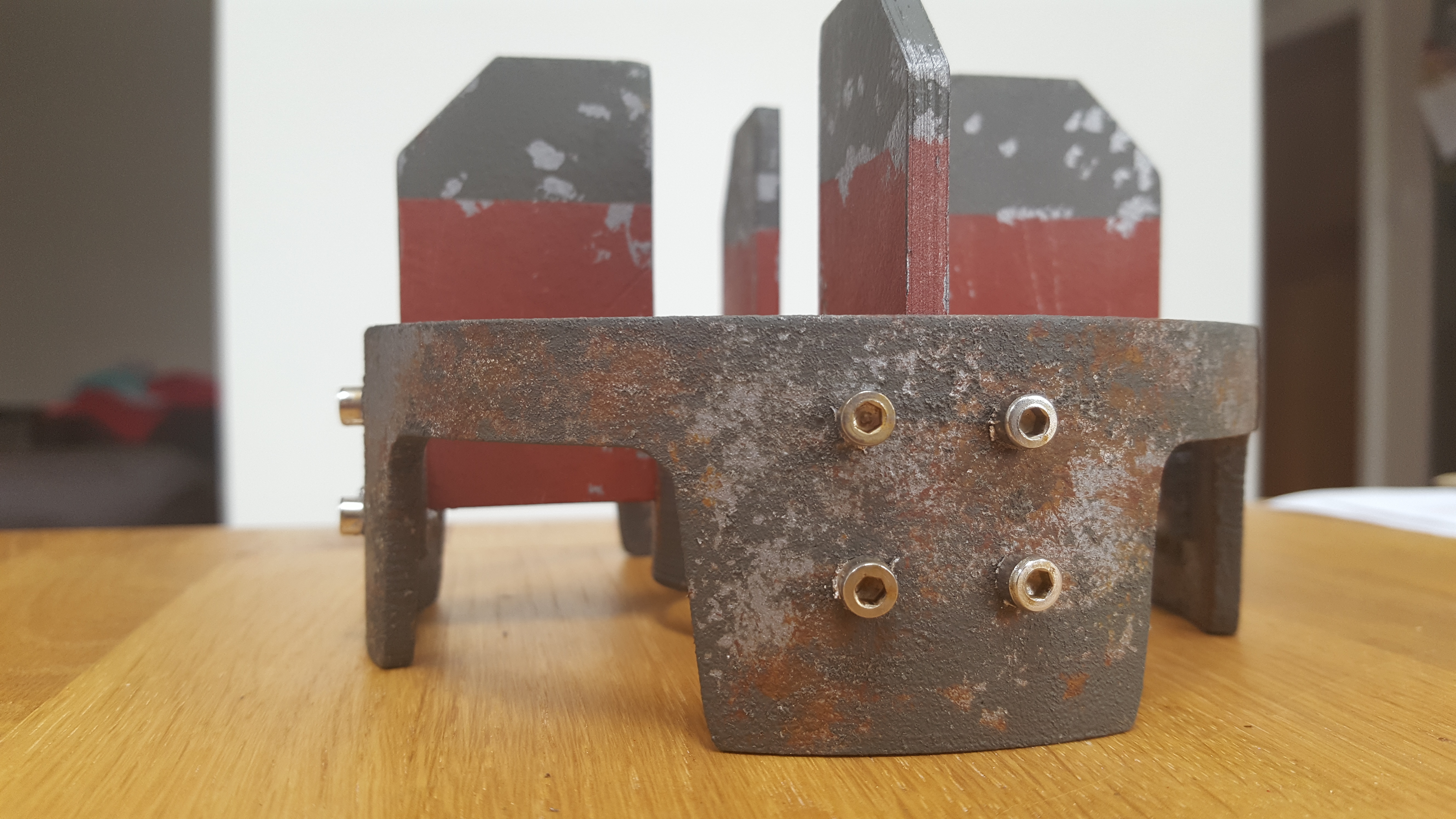

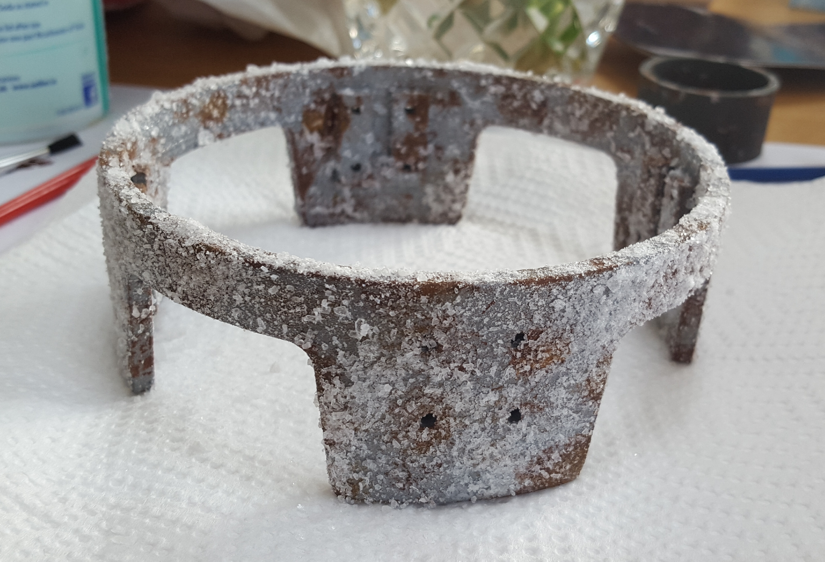

Then decided to go at the fins and tail ring. I wanted to try a different technique on this, so sanded/filled etc, coat of silver and rust.

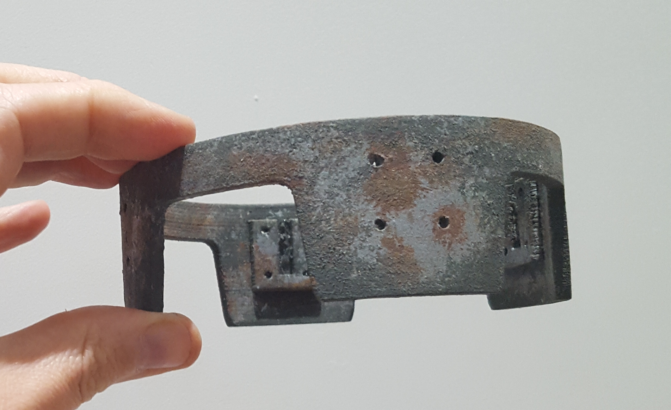

Then gave it a light spray with plain water and chucked a load of rock salt it.
Let it dry a few hours and then hit it with the green.
Let that dry then wiped and lightly brushed off the salt. Was praying that it didn't come out a godawful mess.
It did ok! It leaves a lot of texture on the part too, it feels a lot more authentic.
The fins and centre ring are done too, but not a whole lot to look at there really.
I used real screws on the part and have some nice little bolts that will go in that tail ring. I'm currently leaving those bolts and some for body outside to try and get some natural rust on them.

With the salt, I crushed up a load to try and get more variance in the pattern, but where it was quite fine it just seemed to land and stick in clumps masking off more than I really wanted. I won't bother crushing it again, I'll just sprinkle it as is. I took the tail in today to show my friend and he is happy with it, I had offered to do another pass on it, but he's happy and it is going to sit on his shelf not mine so it's all good.

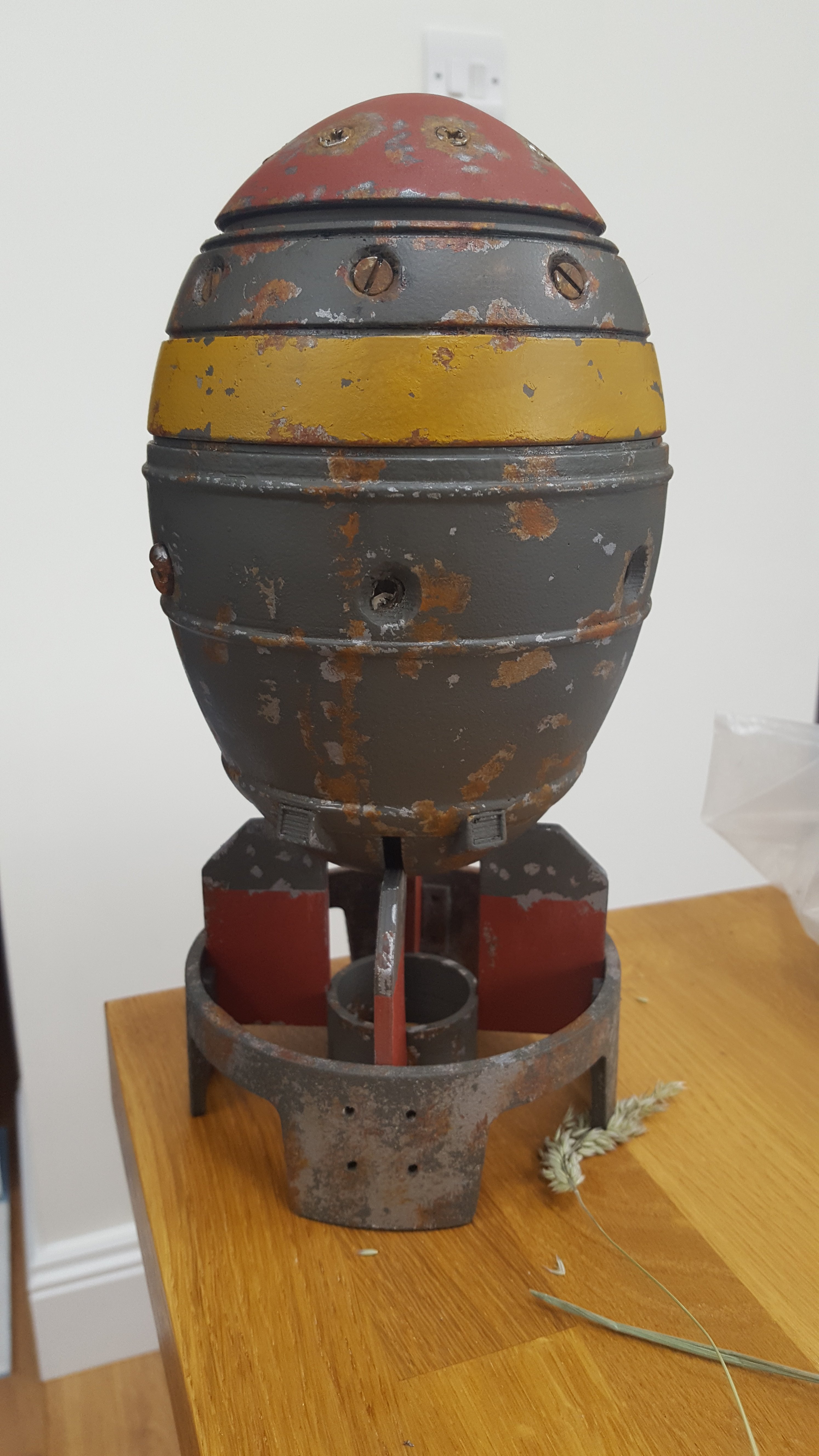

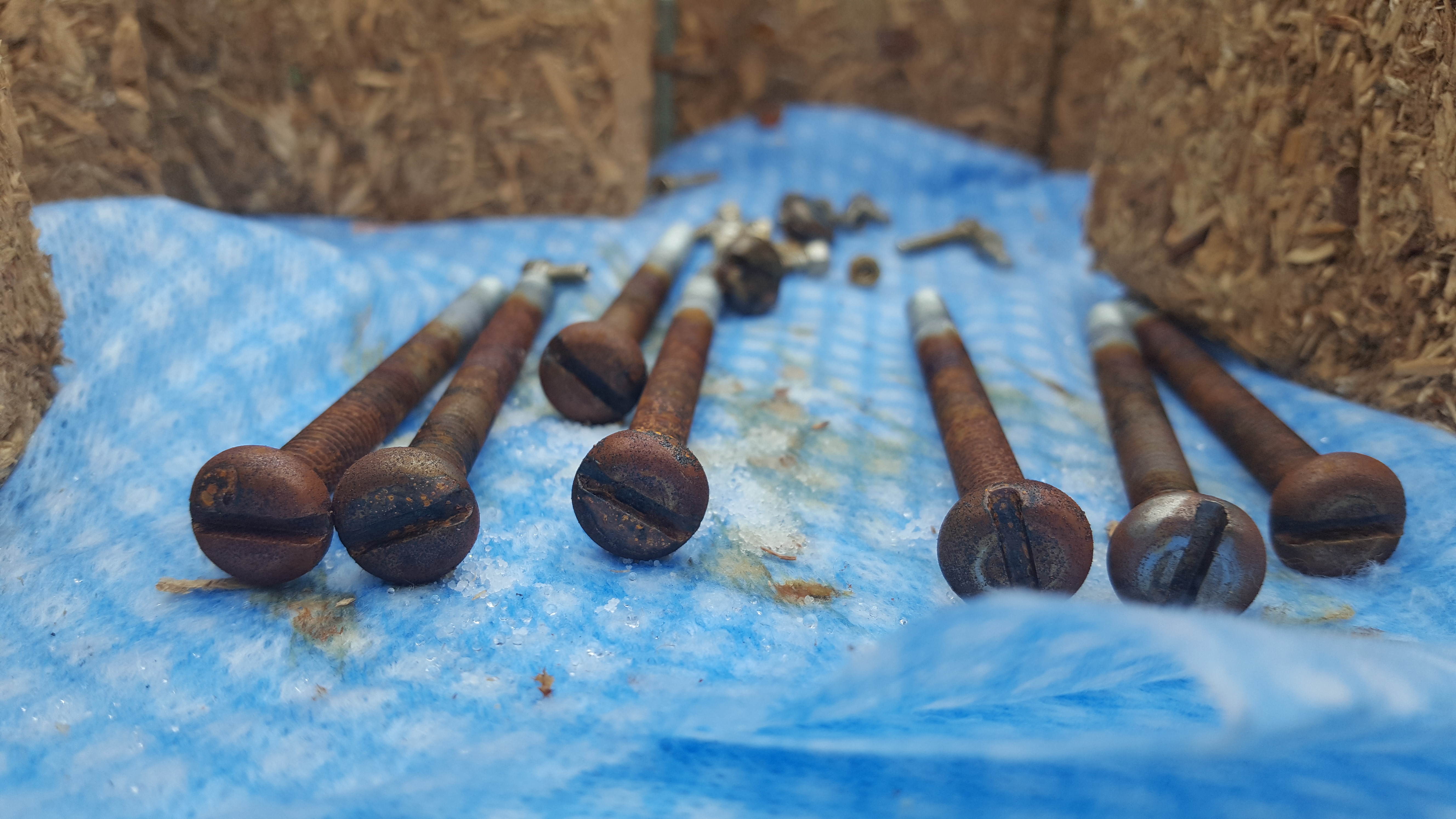

I got the bolts for the main body rusting away nicely in the garden.
I'll be cutting the threads down quite significantly, they're very long, but the heads are a good size.
I put them in a jar of salt water with a dash of vinegar and bleach and left them overnight. Then gave them a quick rinse and put out in the garden.
That pic is after just 2 days being out, from them being completely pristine silver.
PowerHobo's model does include bolts that you can 3D print, I have chosen to use real bolts and screws as I think using real bits where possible does help to sell the illusion a little bit.

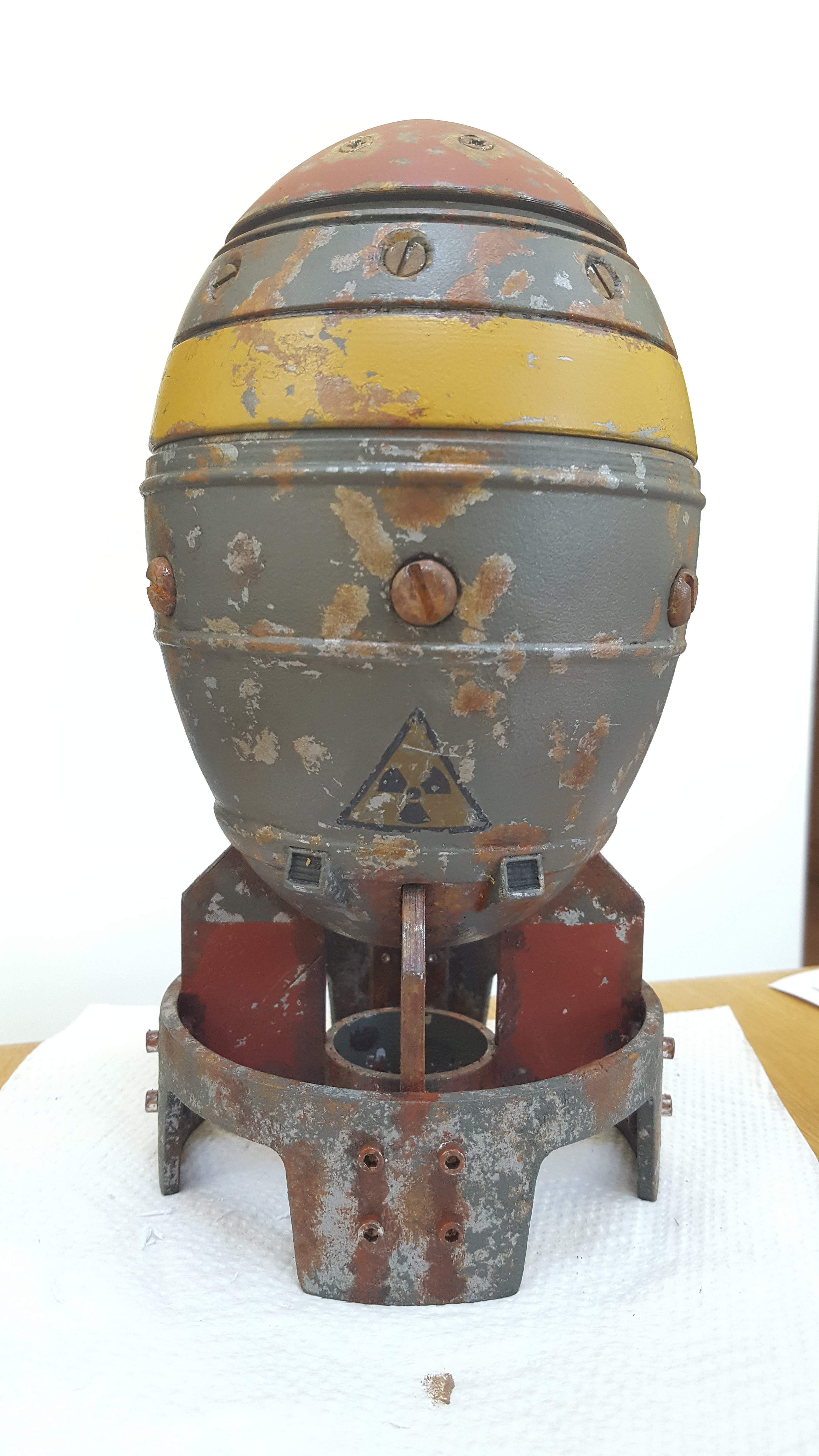

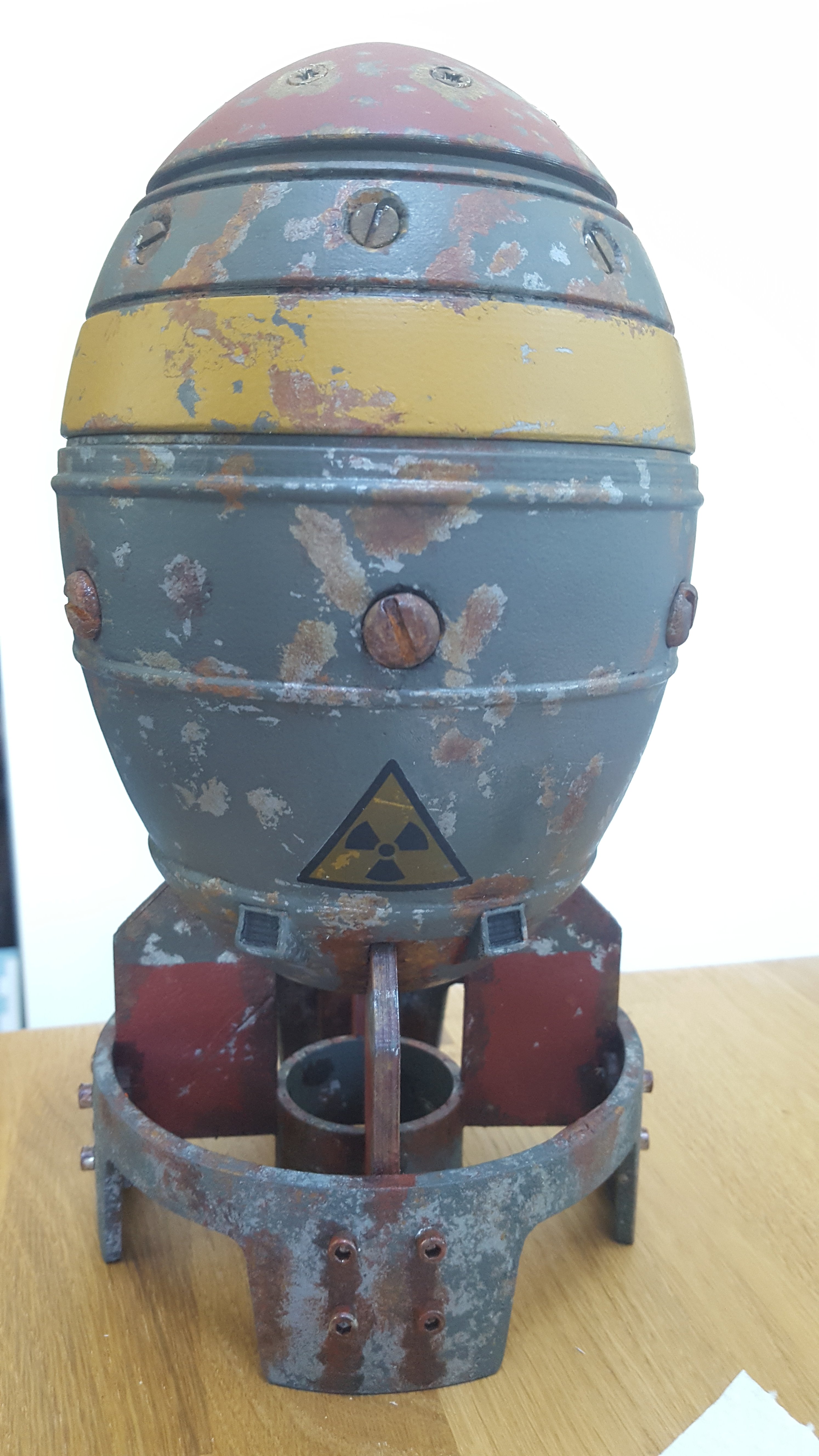

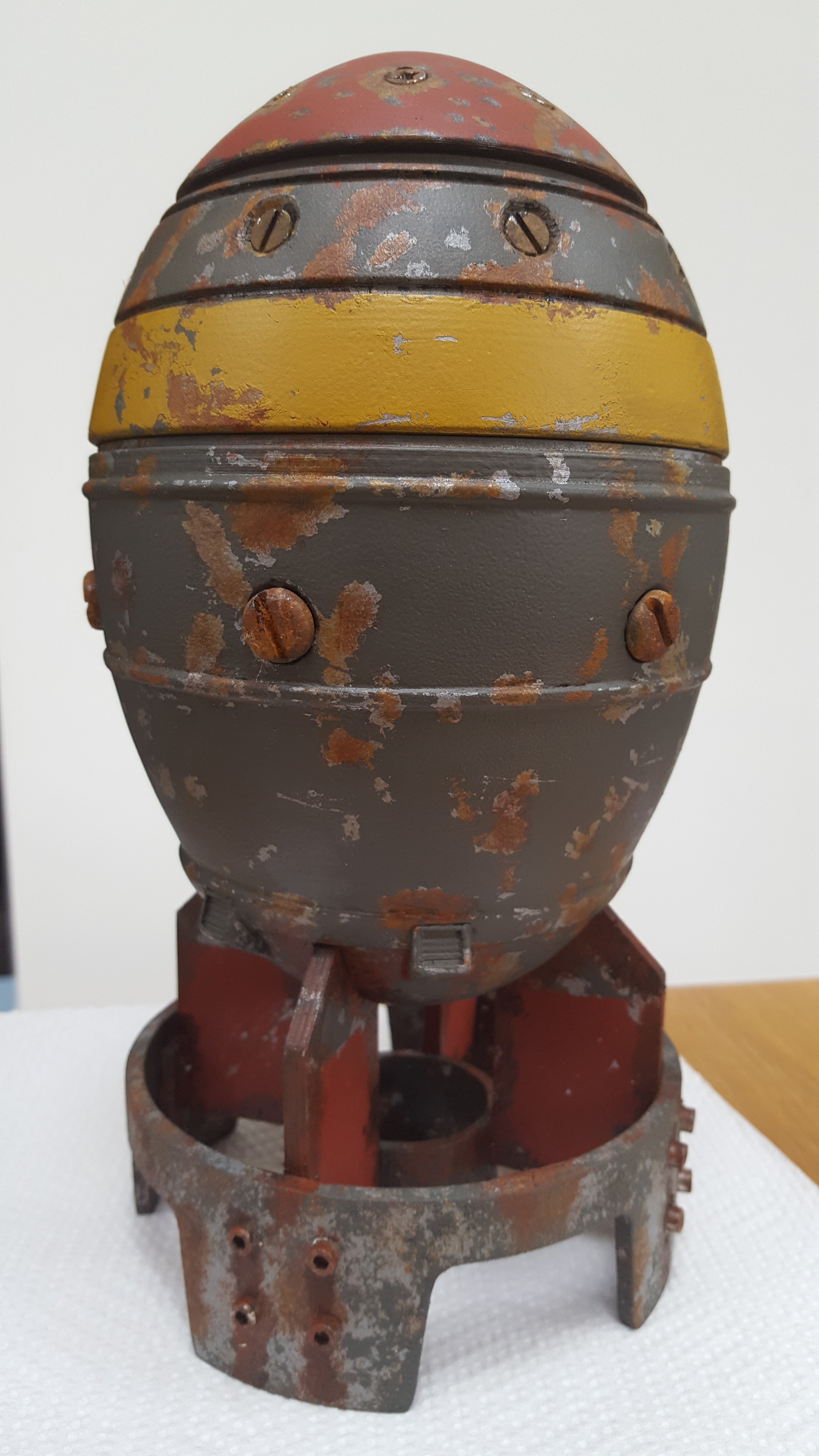

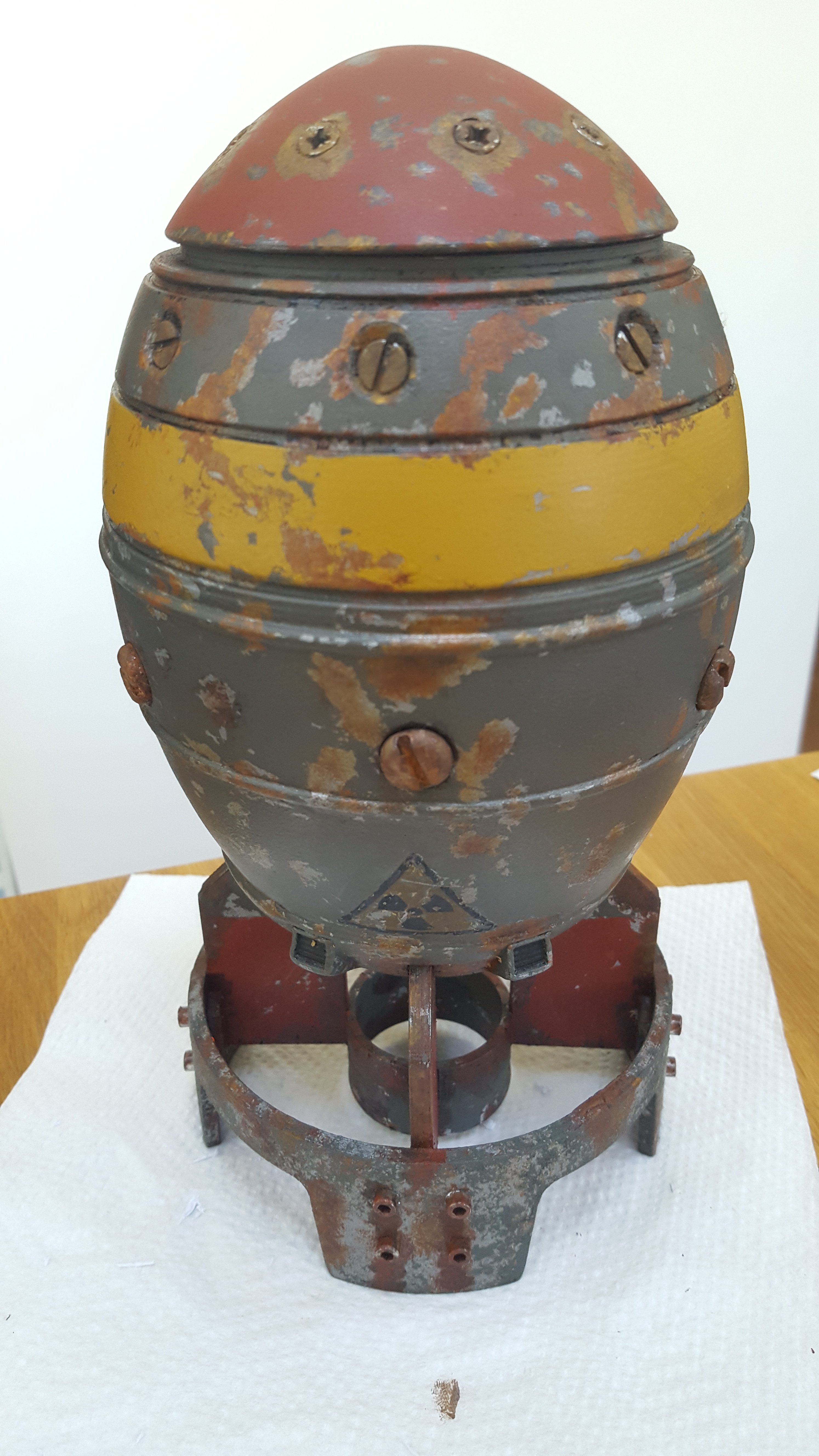

Finished this bad boy today.
I painted the main body with the silver hammered finish paint and added rust with acrylics.
I used the vaseline masking method, I wanted it to match the top and nose cone. If I was starting over I might use the salt method more.
Put the bolts in the tail ring. they just didn't want to rust up, so I painted them later.
I used this stuff, picked up on special offer, to rust the tail bolts
I cut down the big bolts for the main body and glued them in
And no nuke would be complete without a radioactive sticker
Weathered that in a bit, and job's a goodun

I handed it over yesterday, he's very pleased with it and has pride of place in his lounge.
Only problem now is, the other lads into gaming are all looking at me with big puppy dog eyes.
