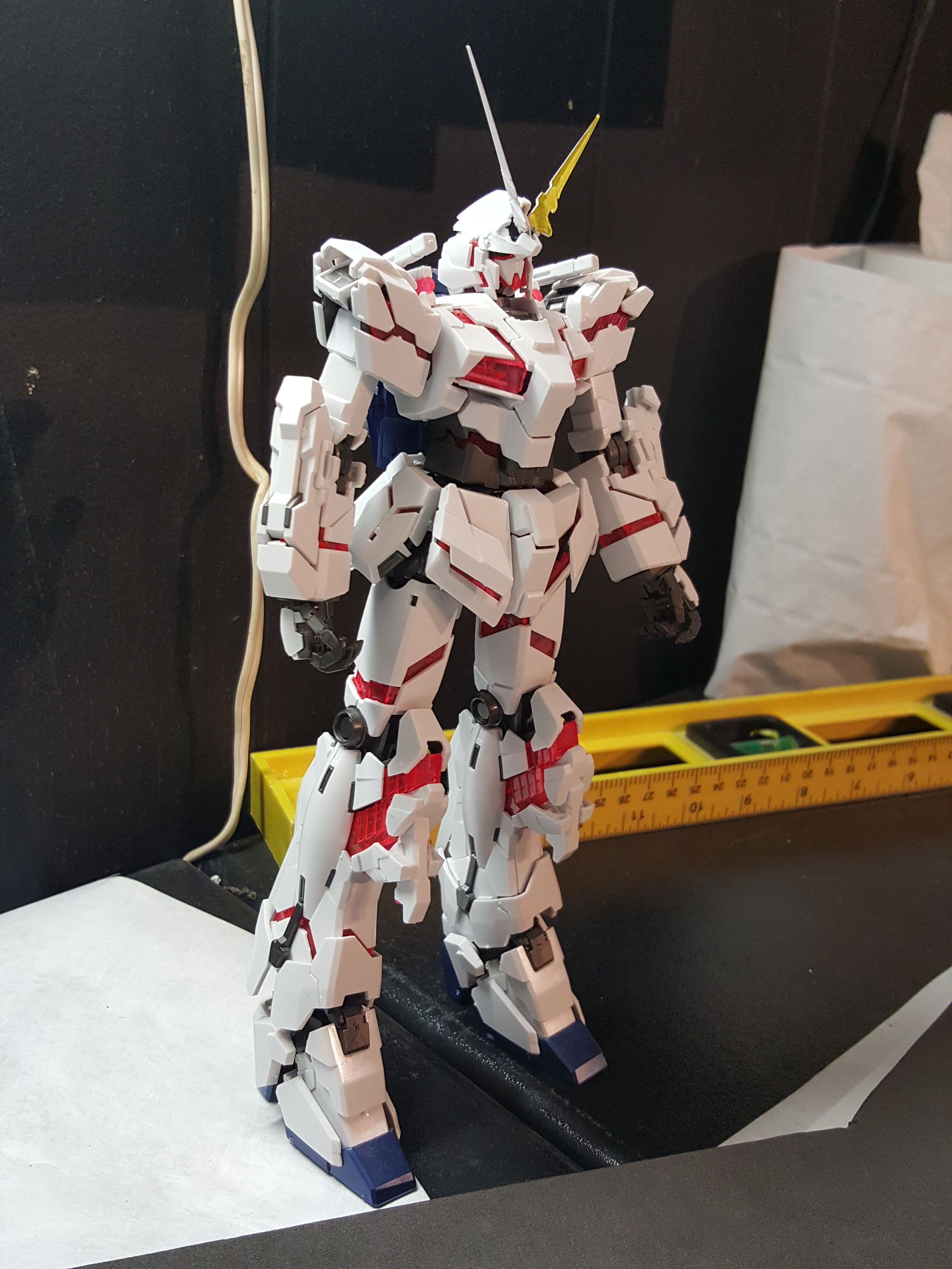

The rest are all free hand and fabrications model at a 6" model kit that was purchase when visiting Japan 2 years ago at Akihabara district in Tokyo.
20170522_203649.jpg so many little parts, clip, snap, joined, Japanese products are extremely detailed.

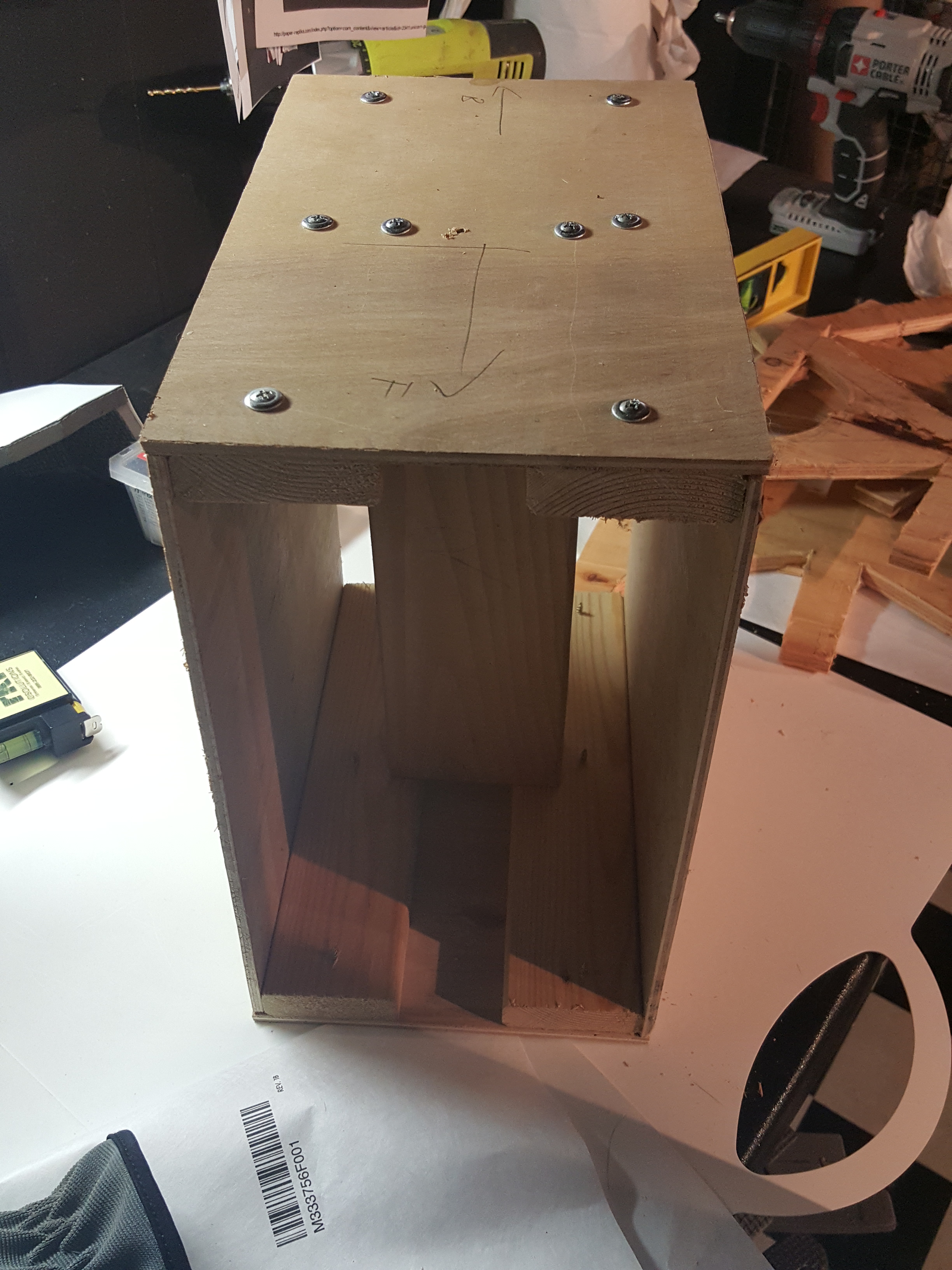

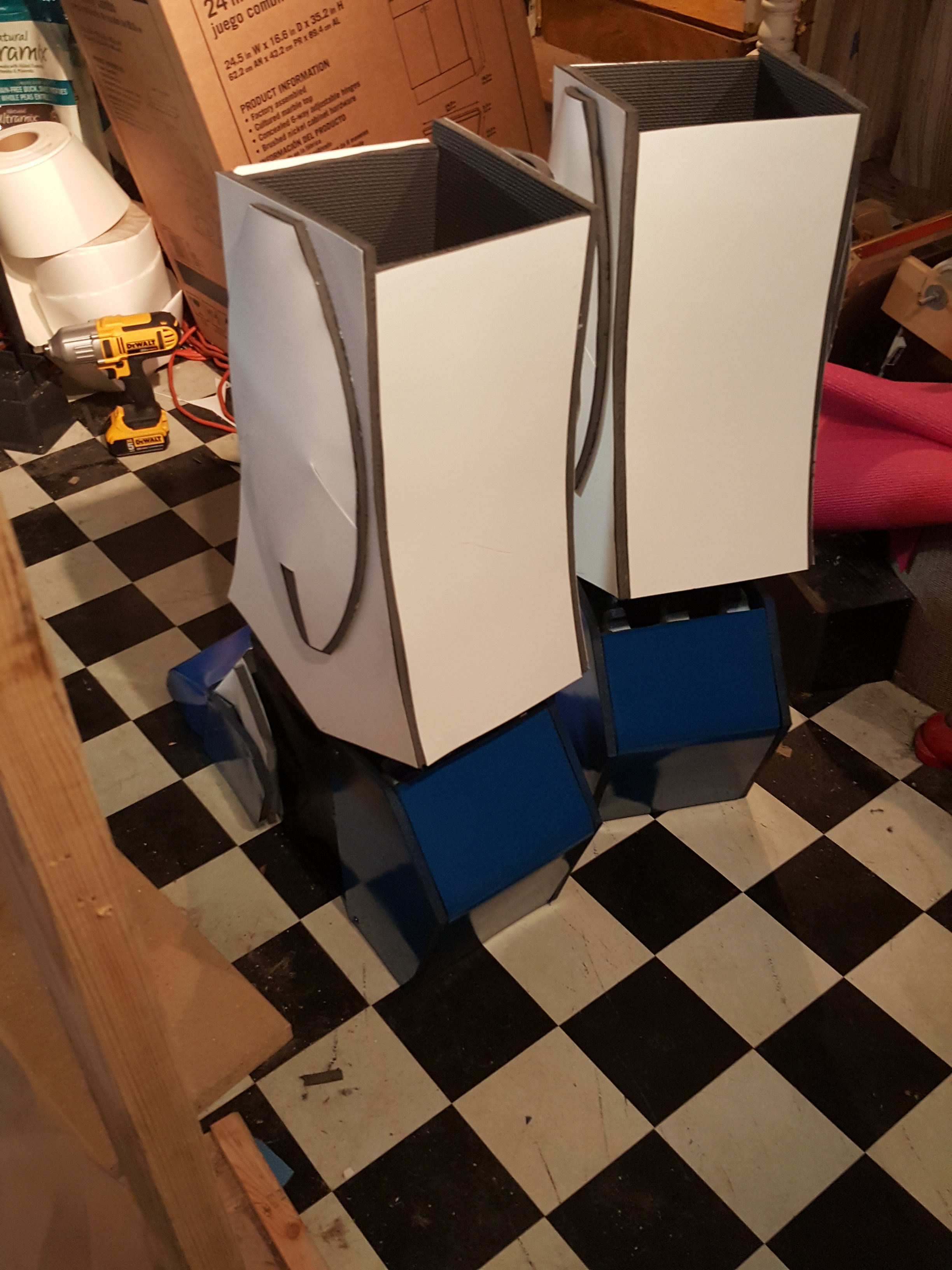

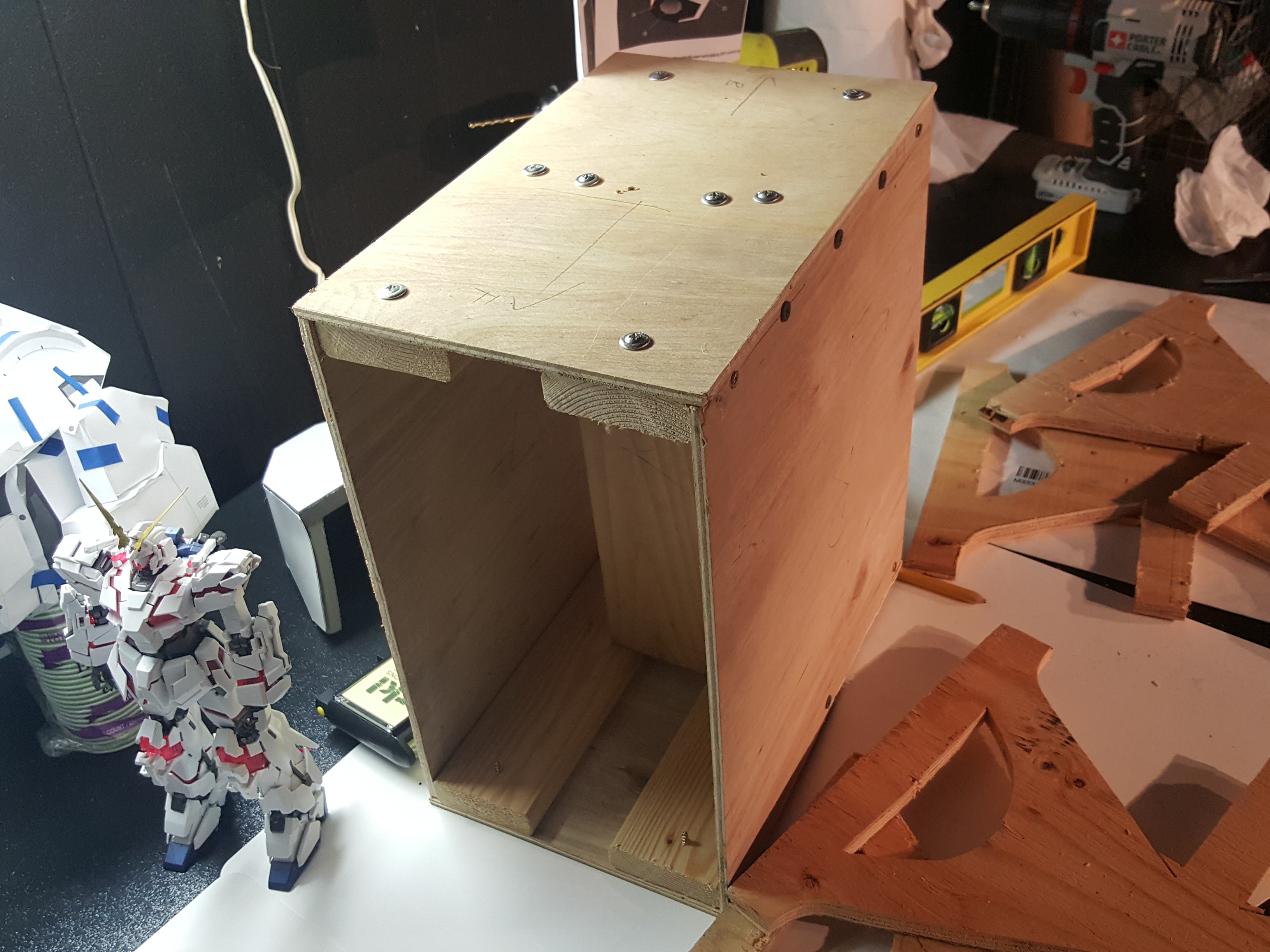

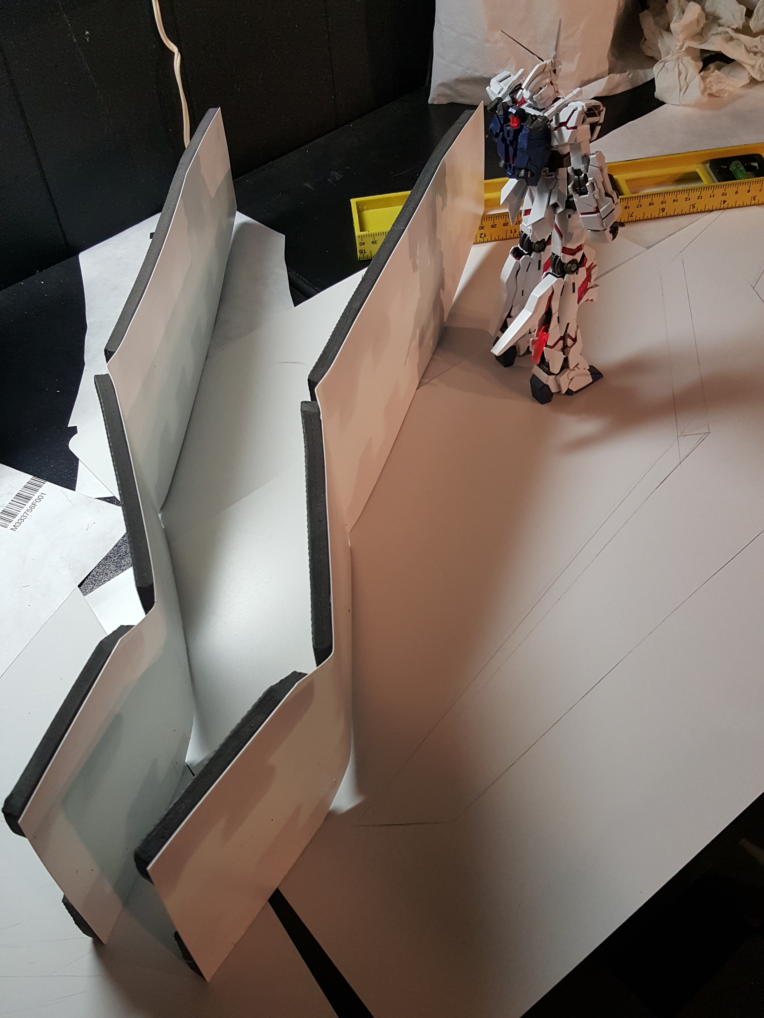

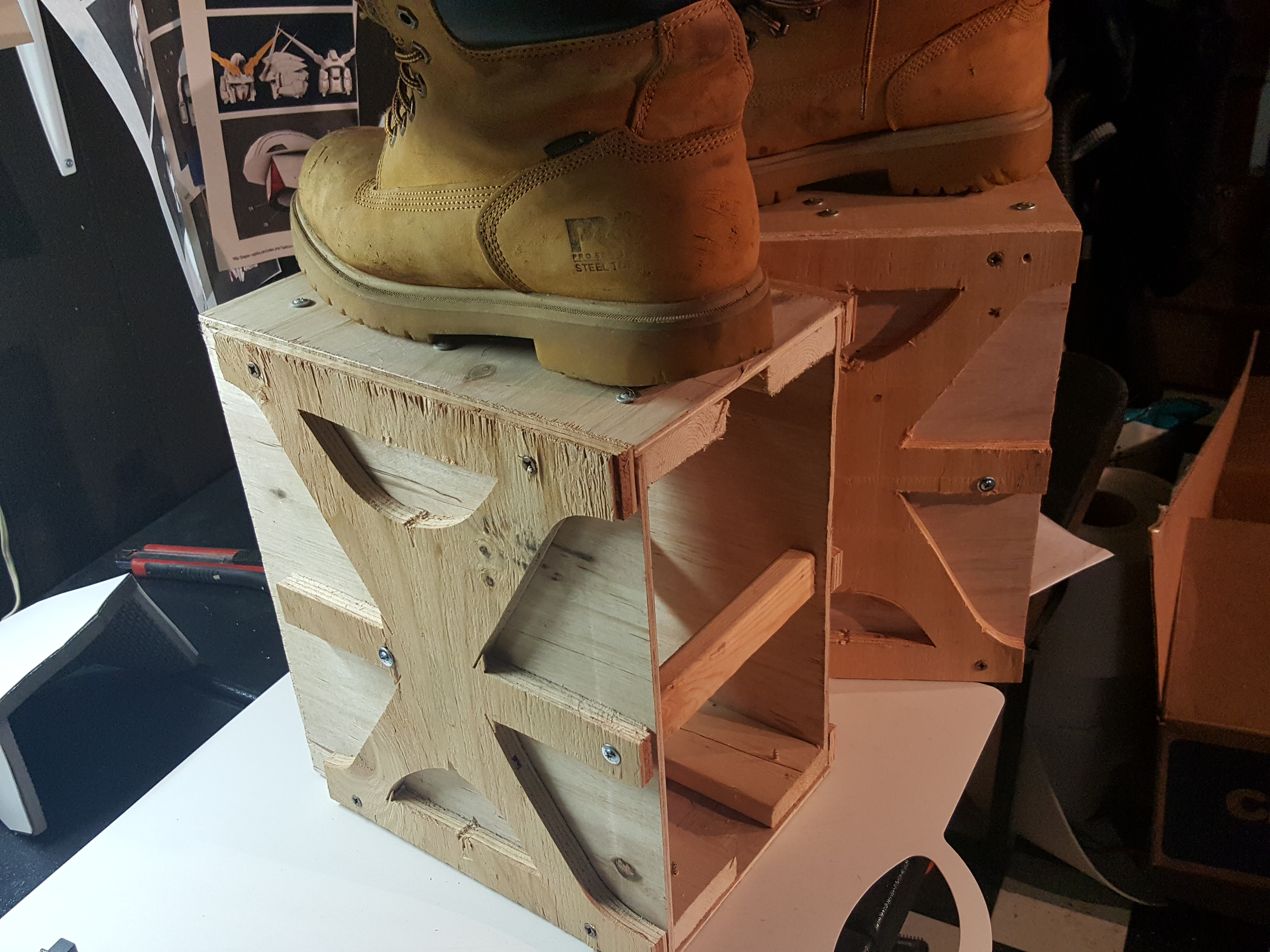

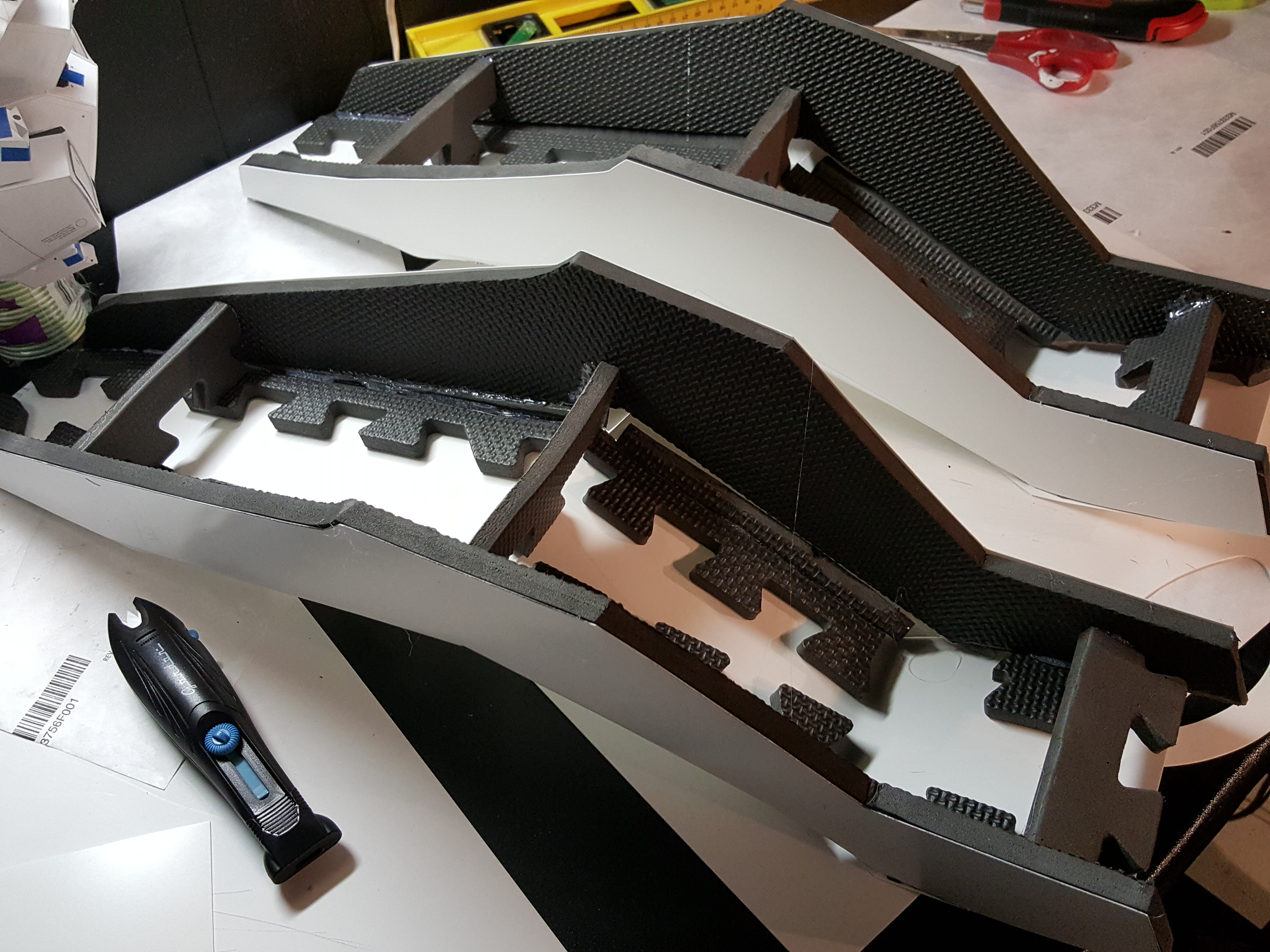

Starting build at the feet, because standing with confident supporting a heavy suit is somewhat important.

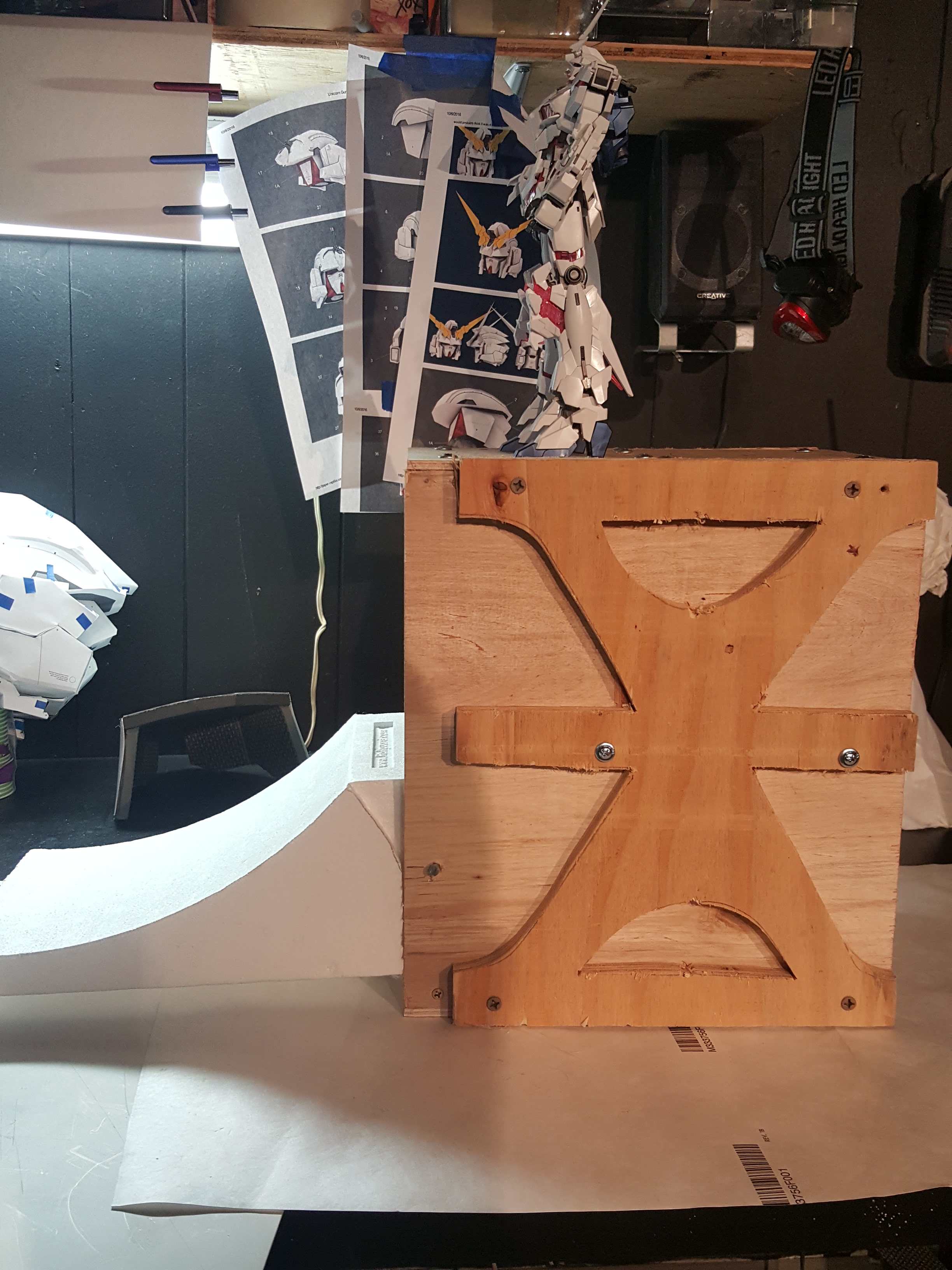

1.jpg Adopted this concept from XRobots UK, from his previous IronMan Hulkbuster build, utilizing wood panels.

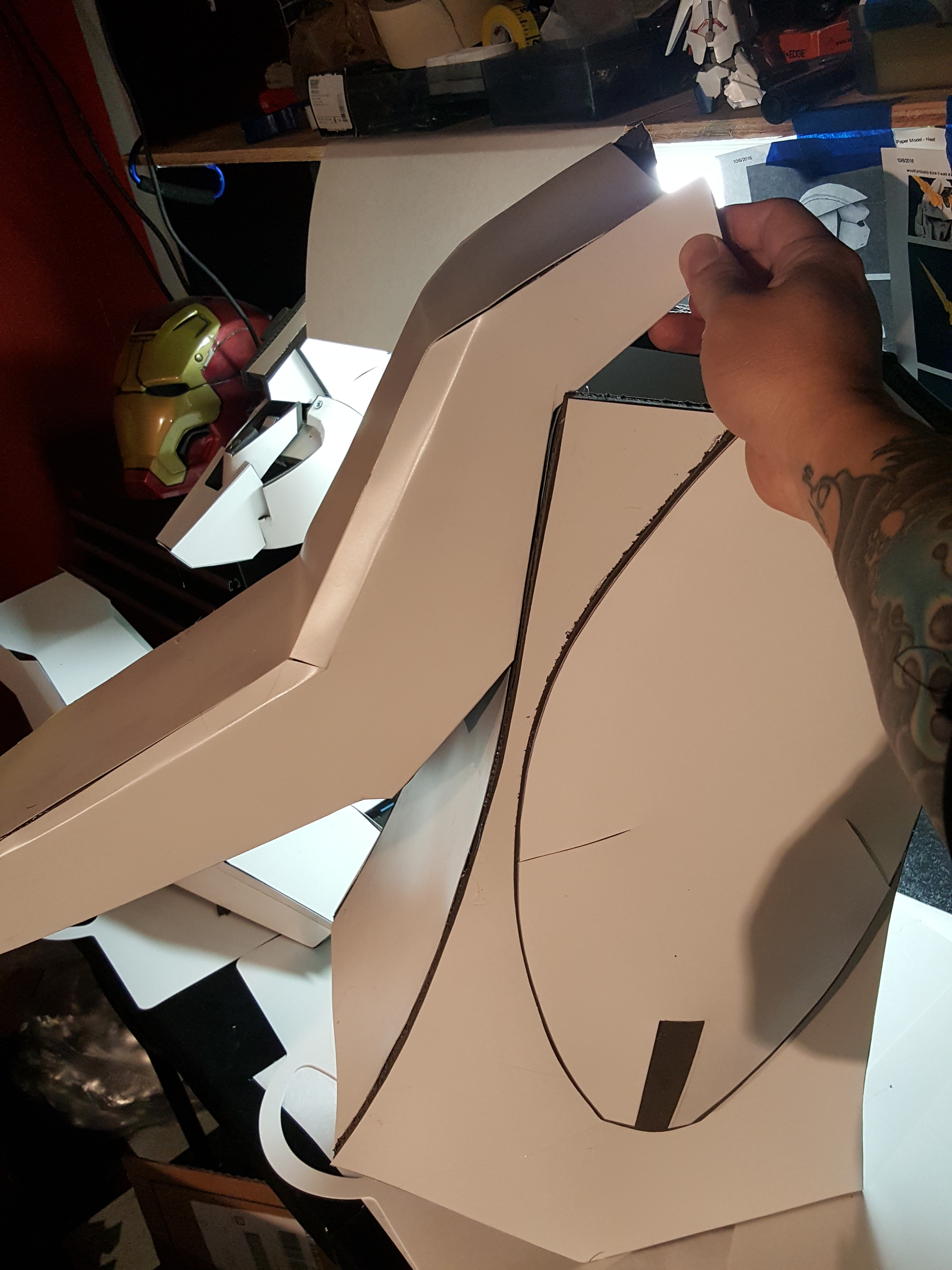

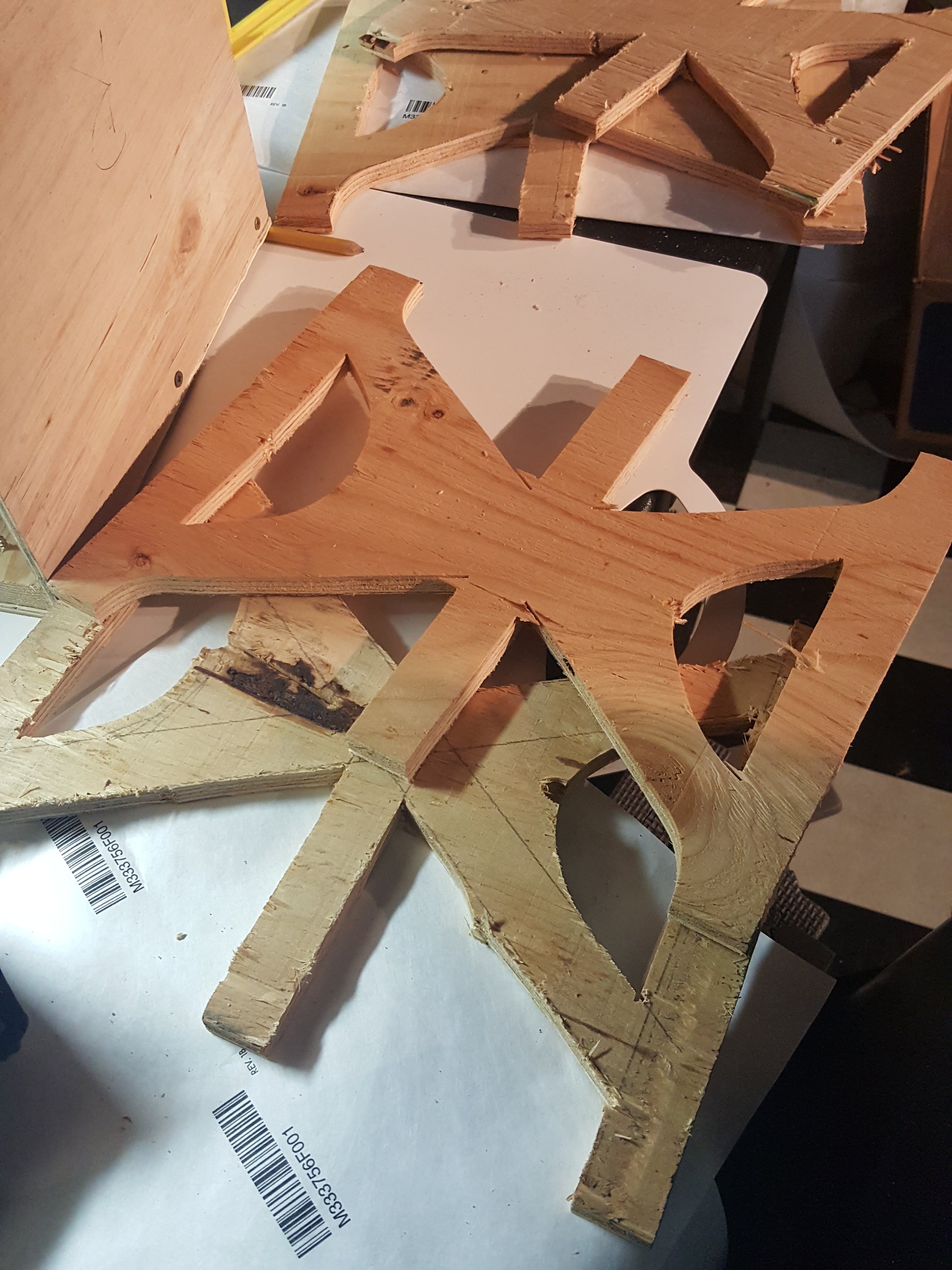

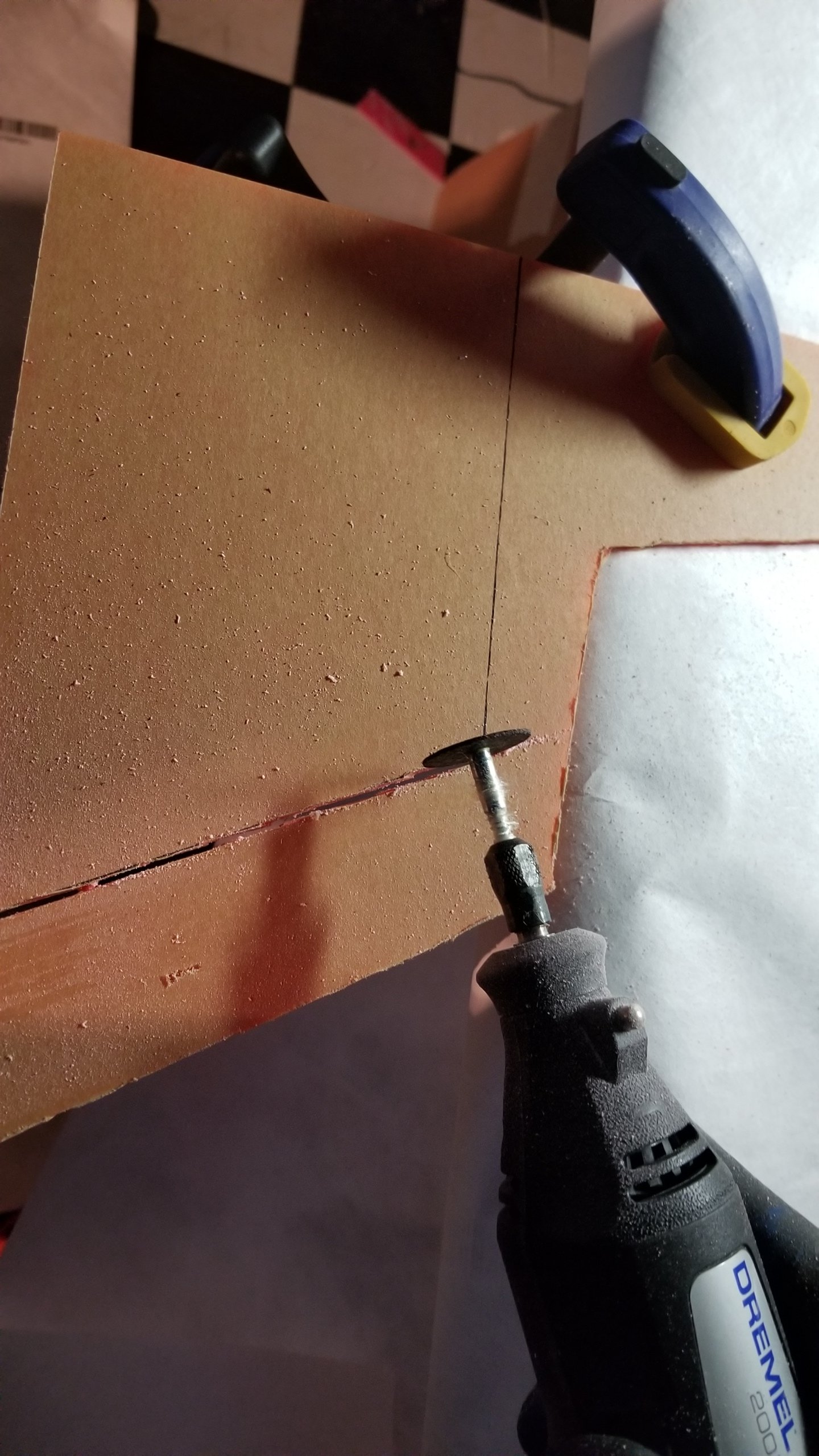

2.jpg 3.jpg Jig Saw additional side support to make it more sturdy

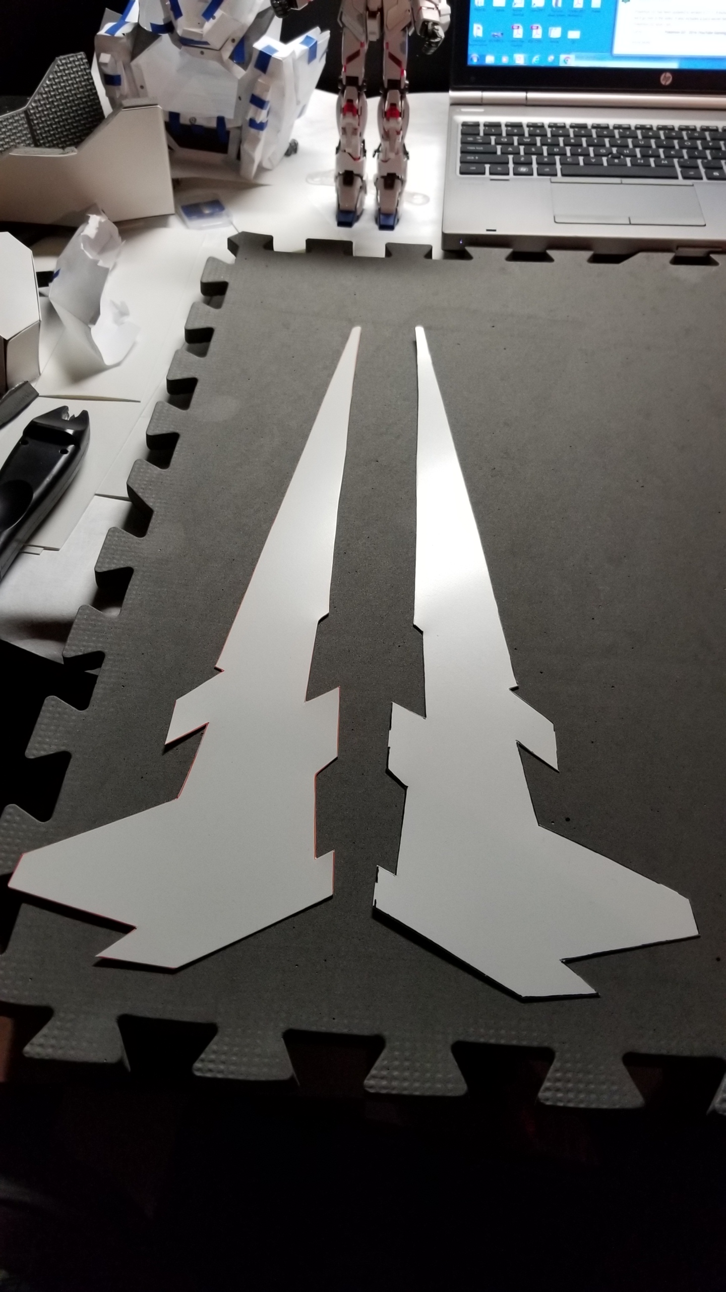

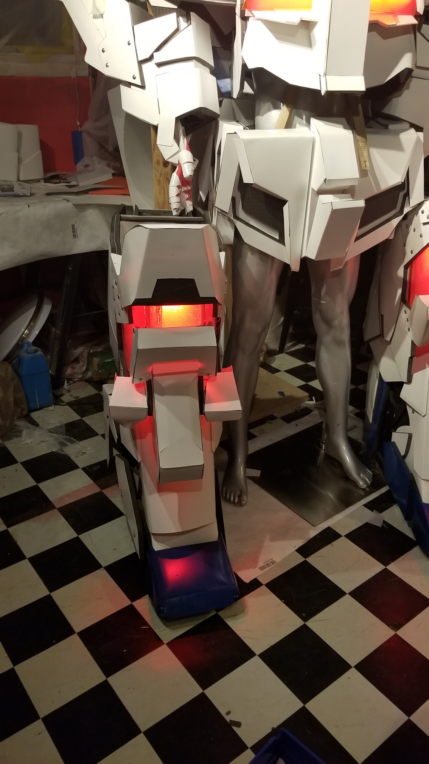

4.jpg Looks just about right, about 10" height increase
5.jpg Added front feet sections with left over foam thus keeping weight ration light.
6.jpg Added a pivot joint to allow front section to flexo up while walking.
a7.jpg Looks walk able.

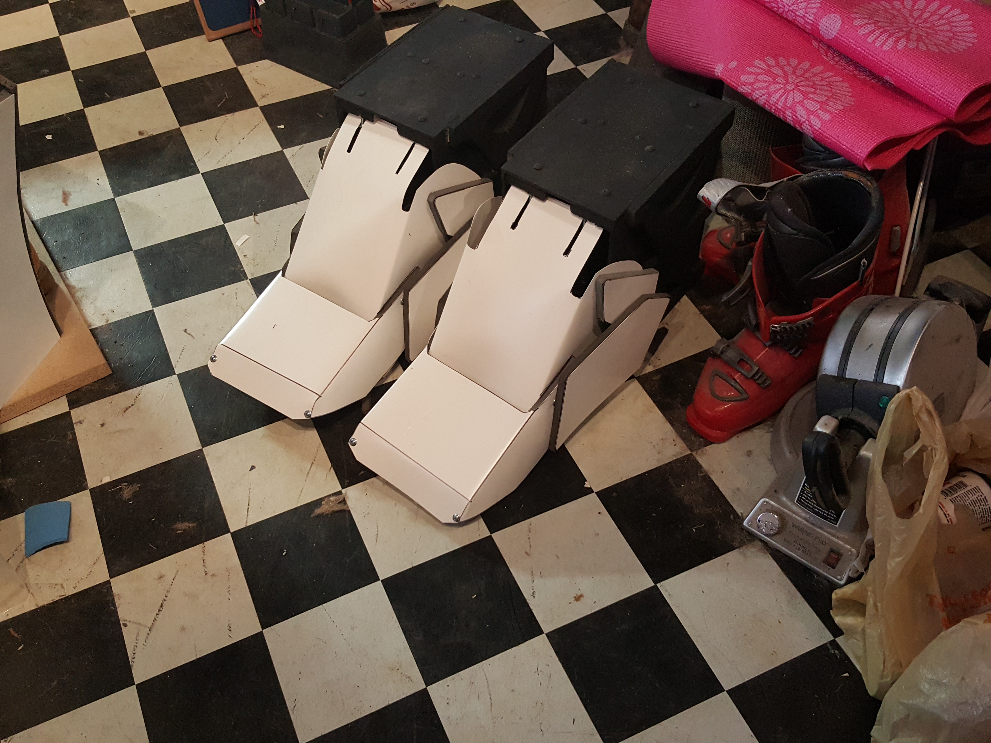

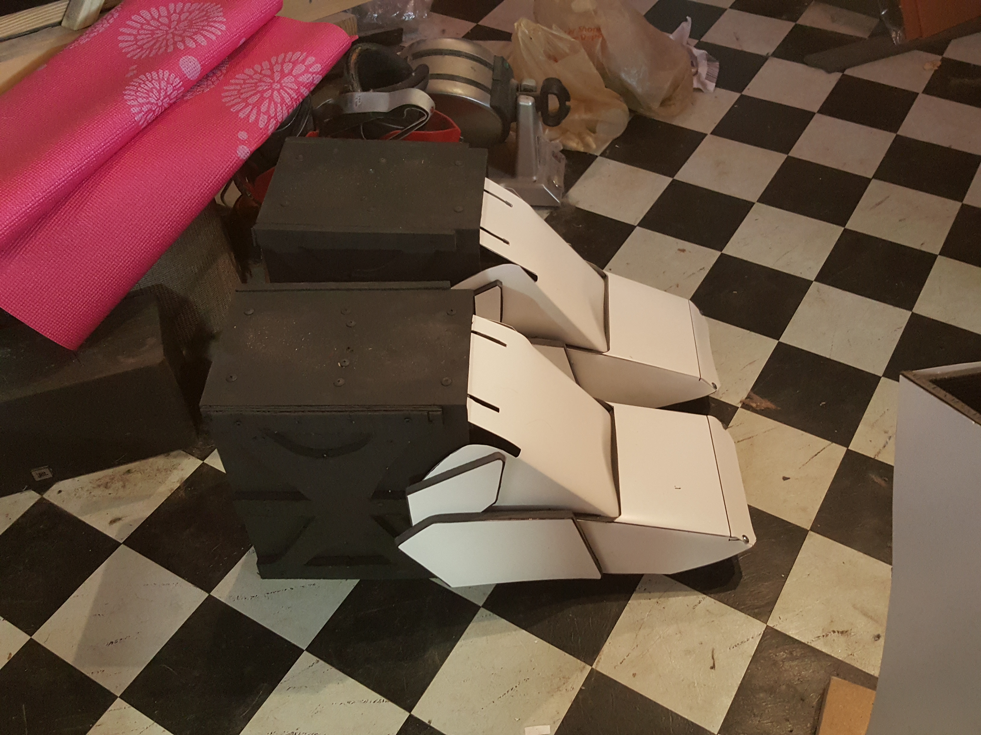

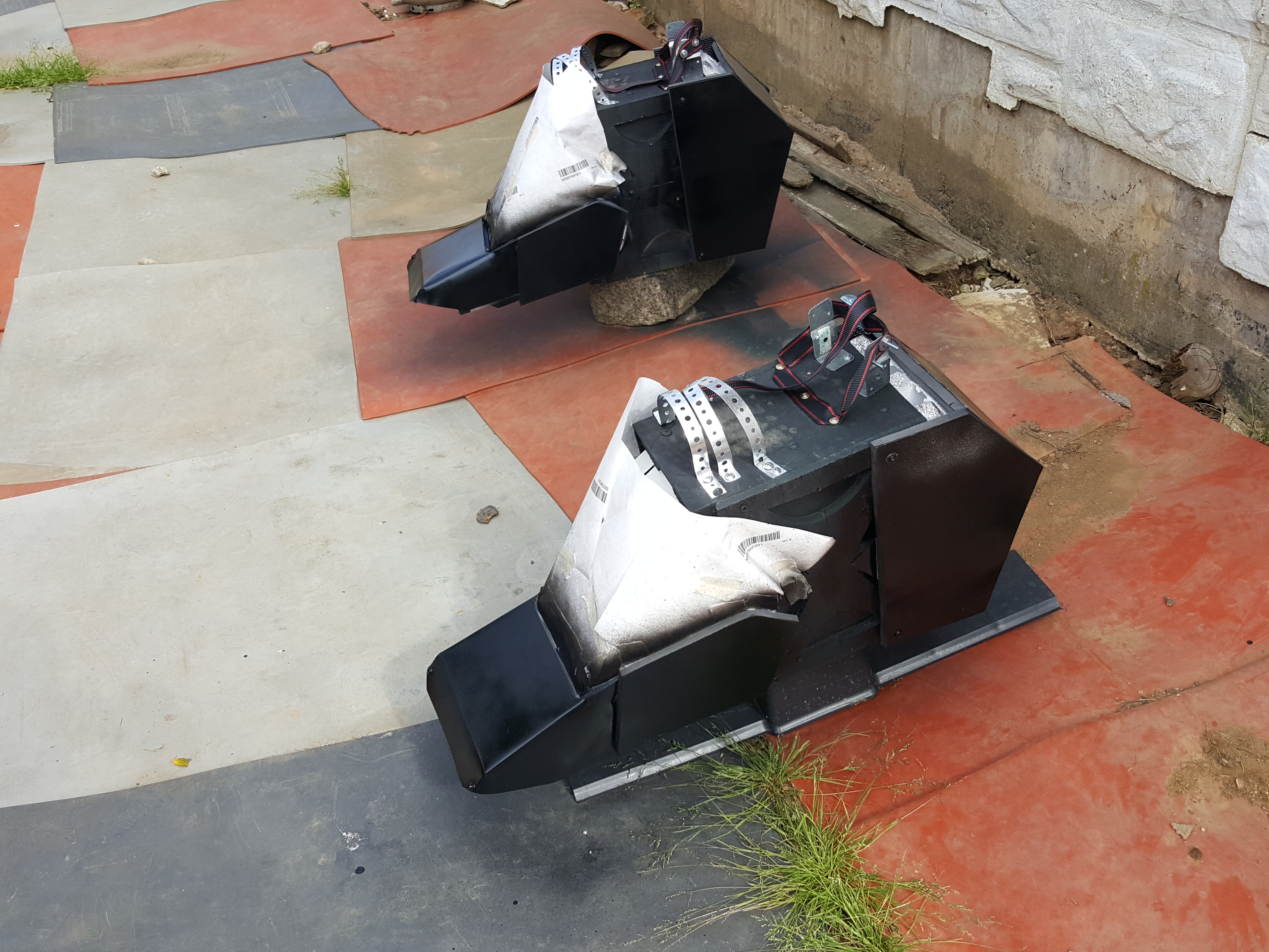

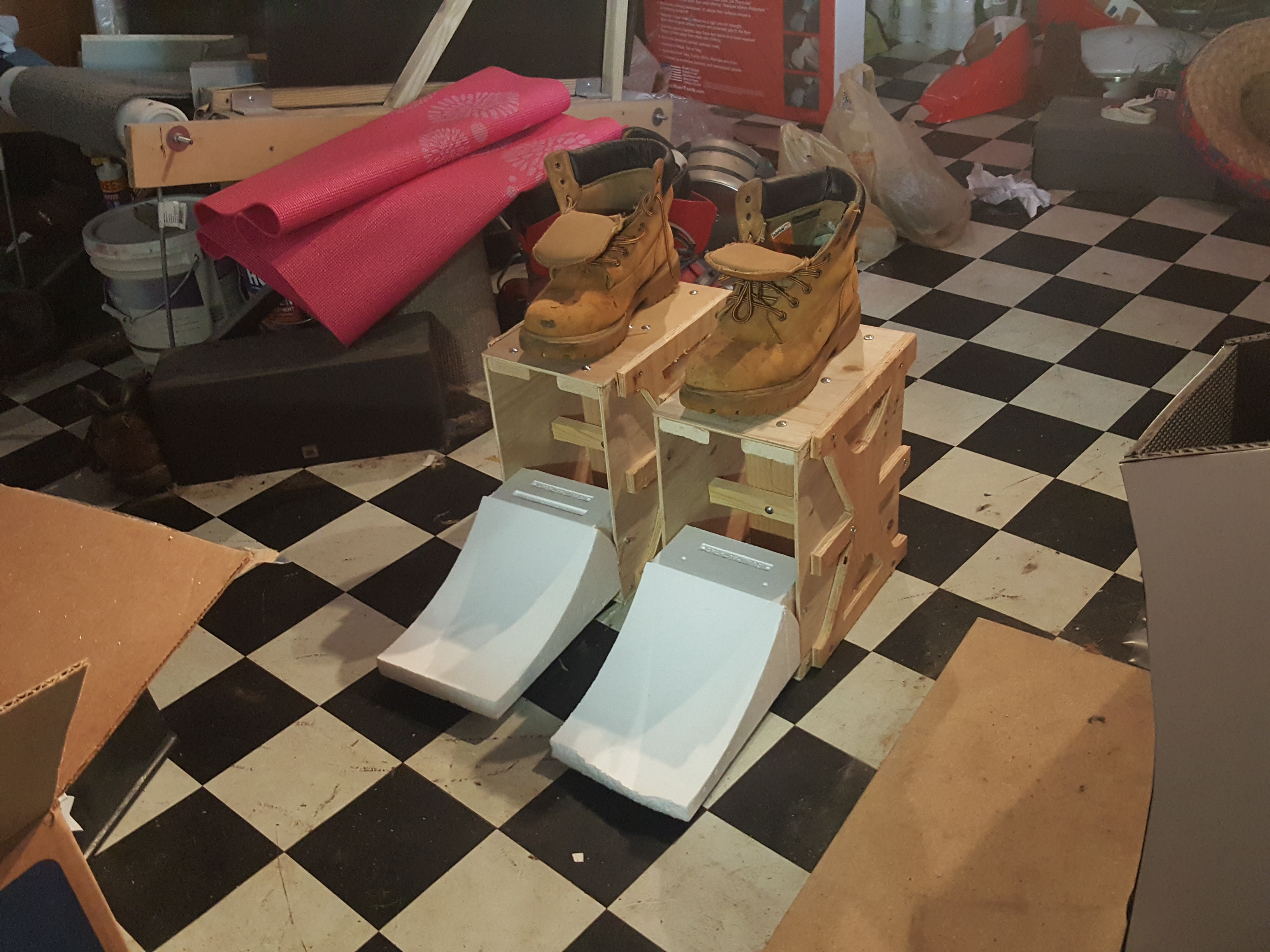

20170507_111838.jpg 20170507_111912.jpg Painted the base black to visually conceal appearance, foam/HDPE shaped the front feet.

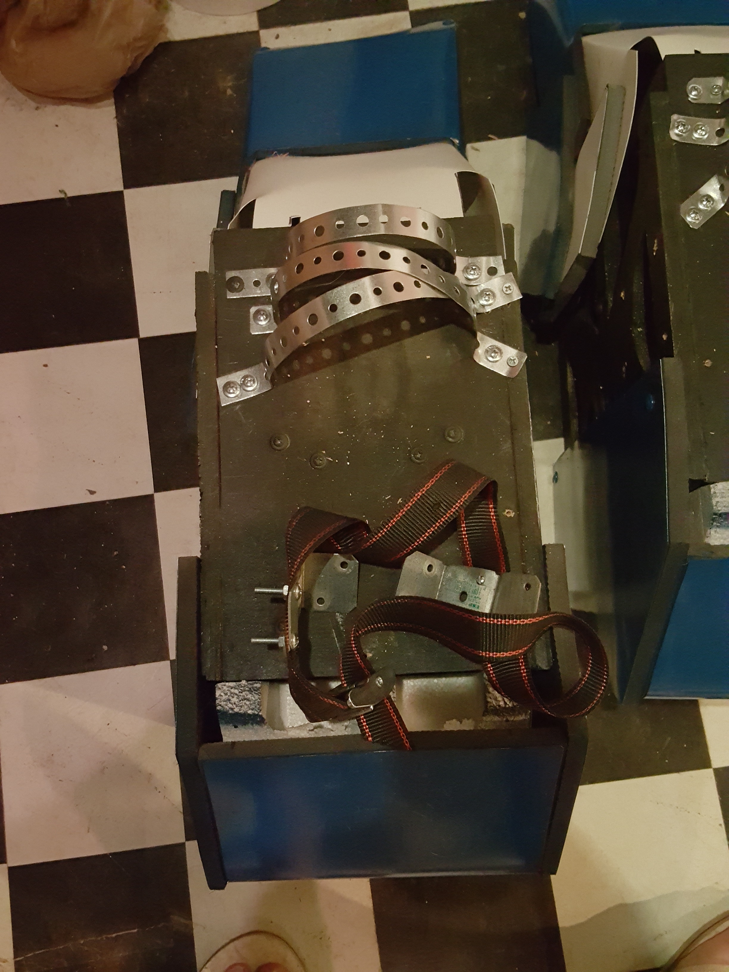

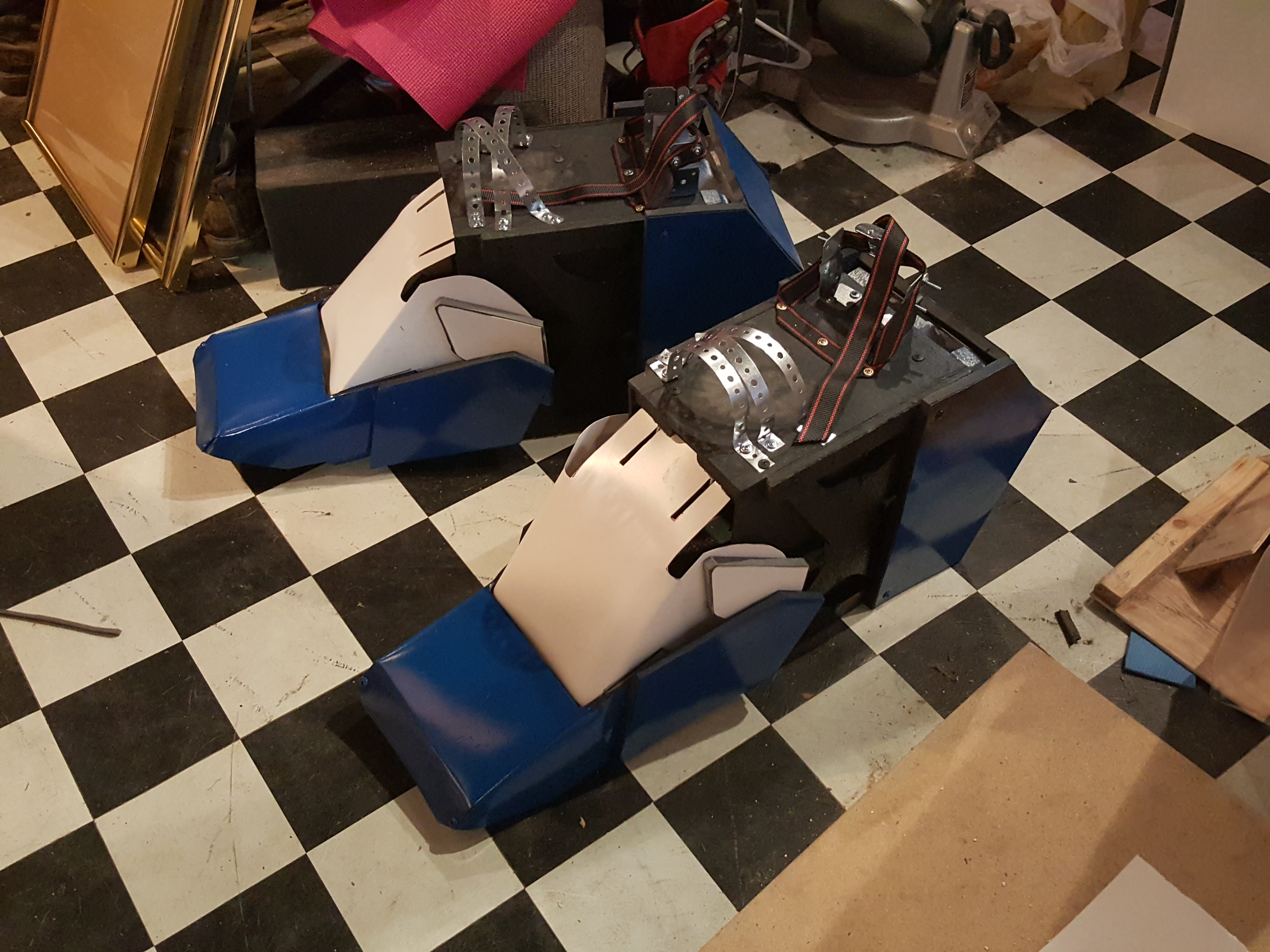

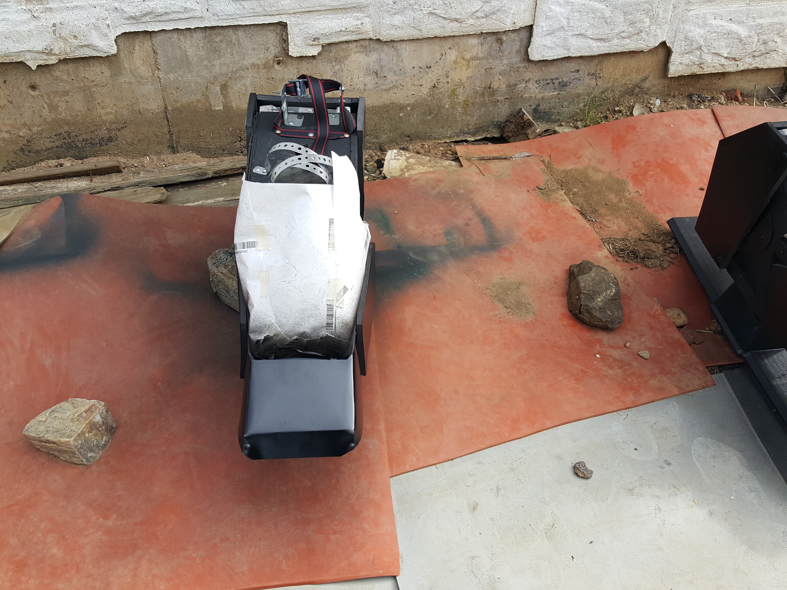

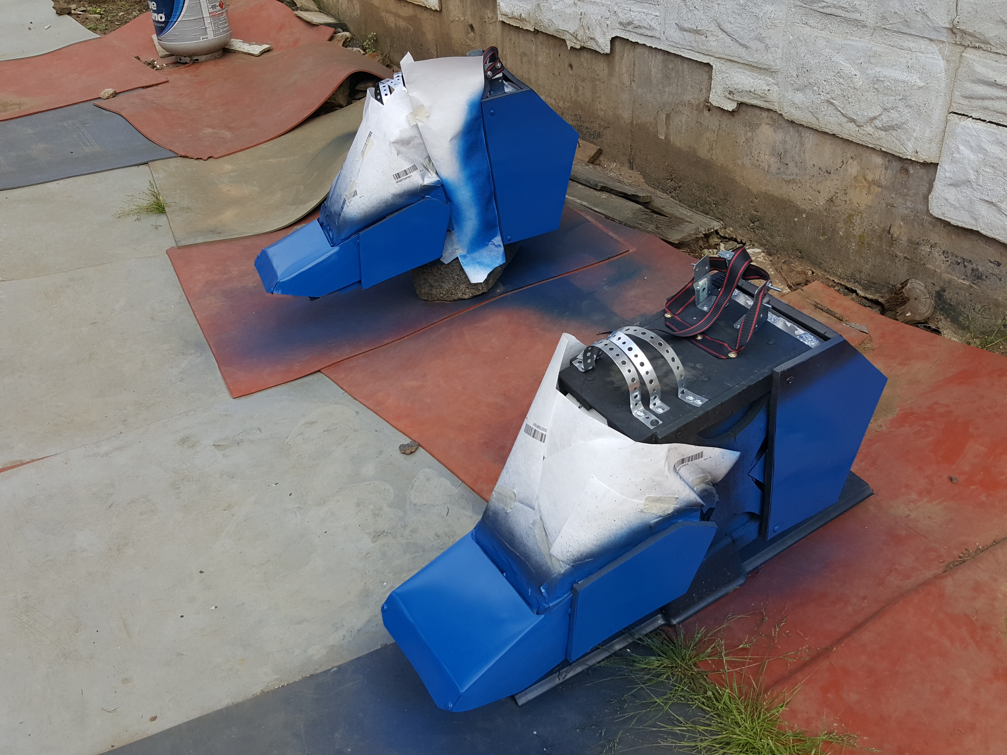

20170521_164252.jpg 20170521_164304.jpg Fabricated boot brace/straps for quick step in. First coat of primer black
20170521_165456.jpg 20170521_165504.jpg Second coat of safety blue to match the model figurine.
20170524_194614.jpg paint finally dried, glad this build doesn't involve massive amount of painting

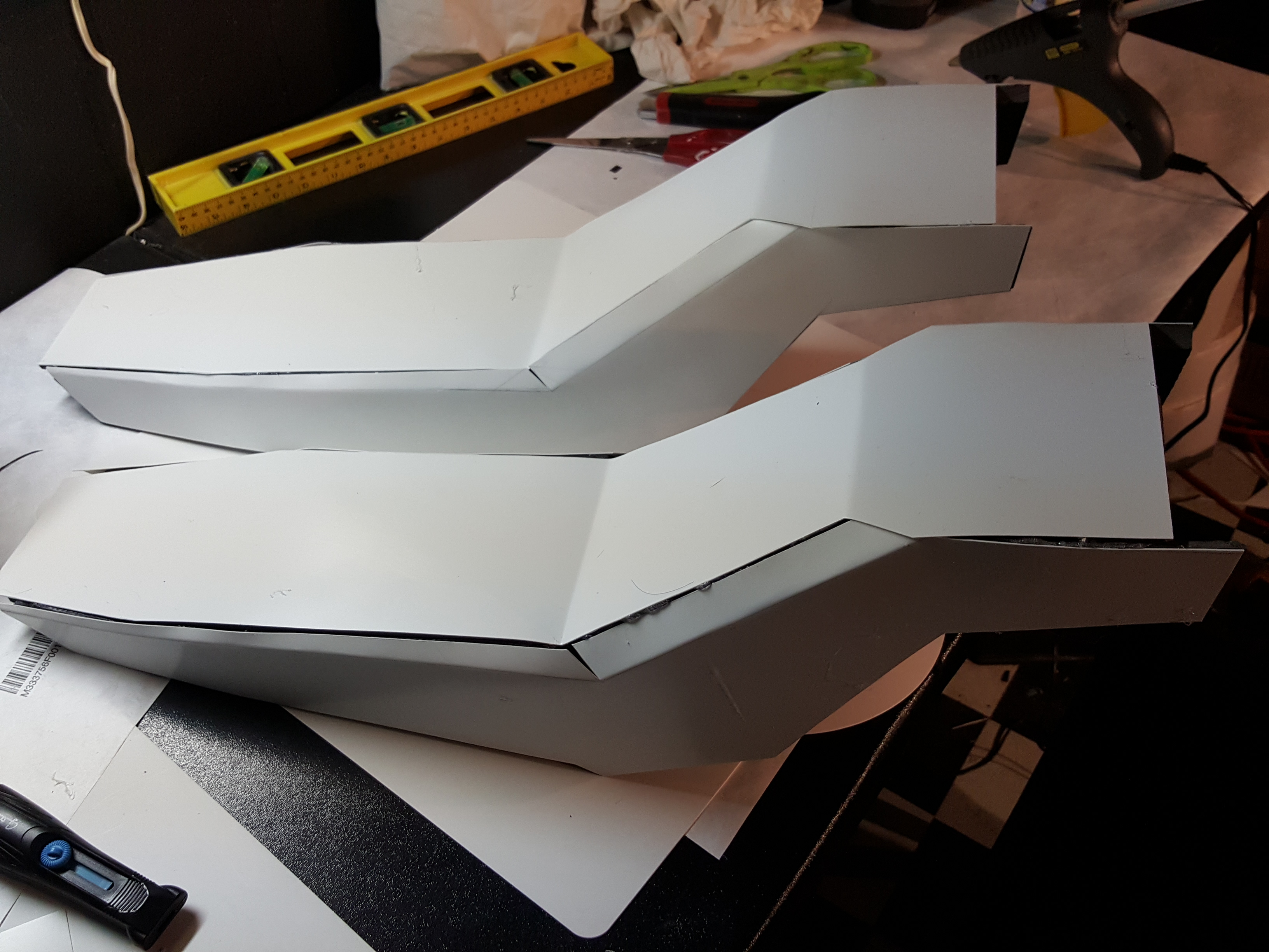

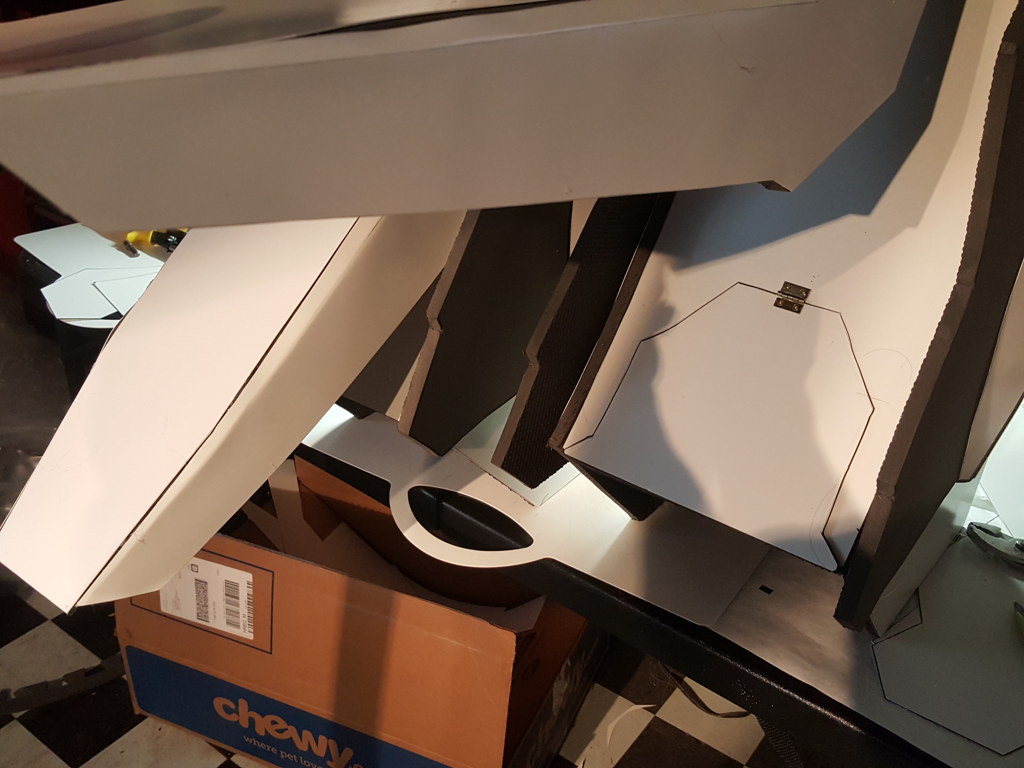

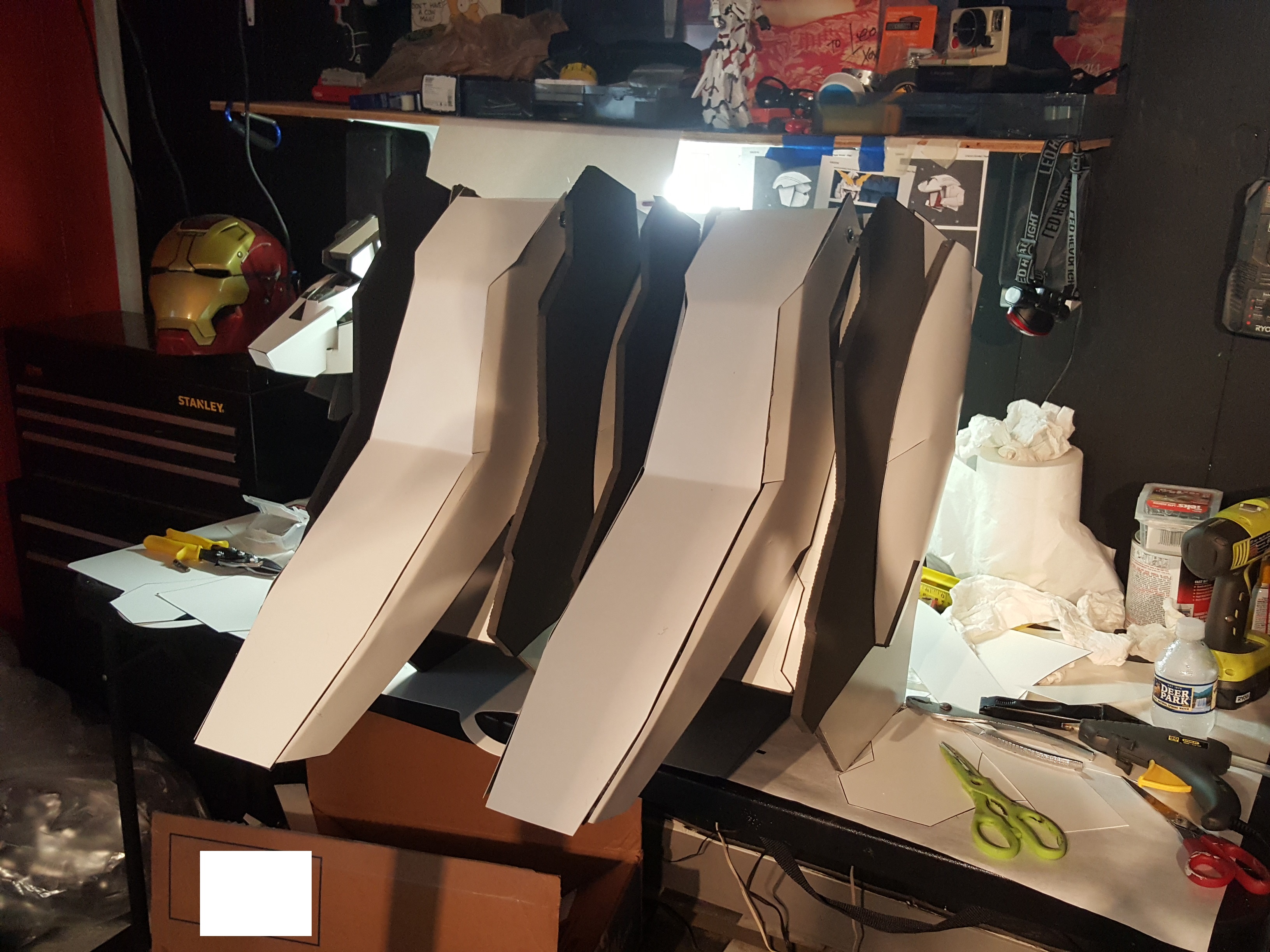

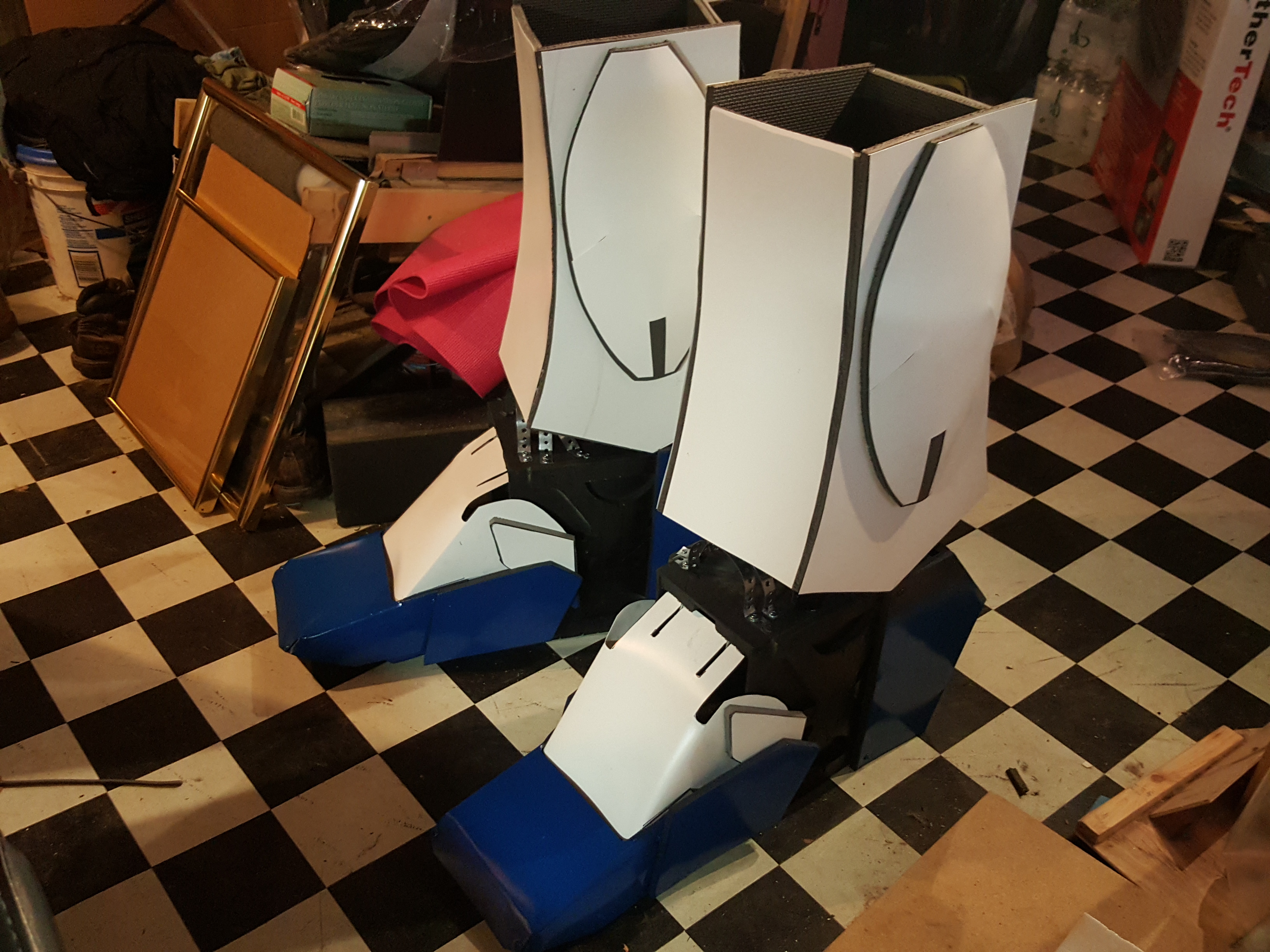

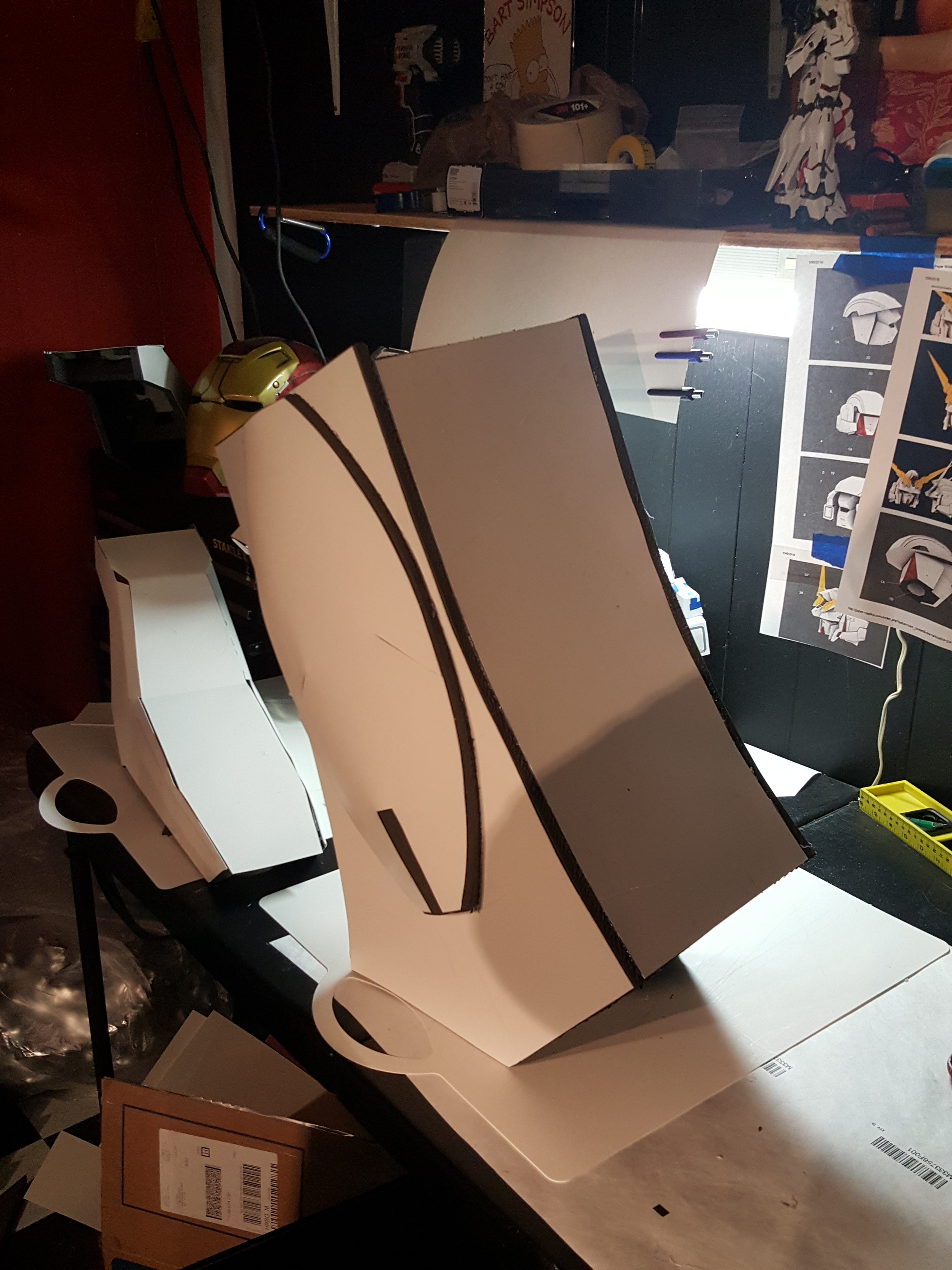

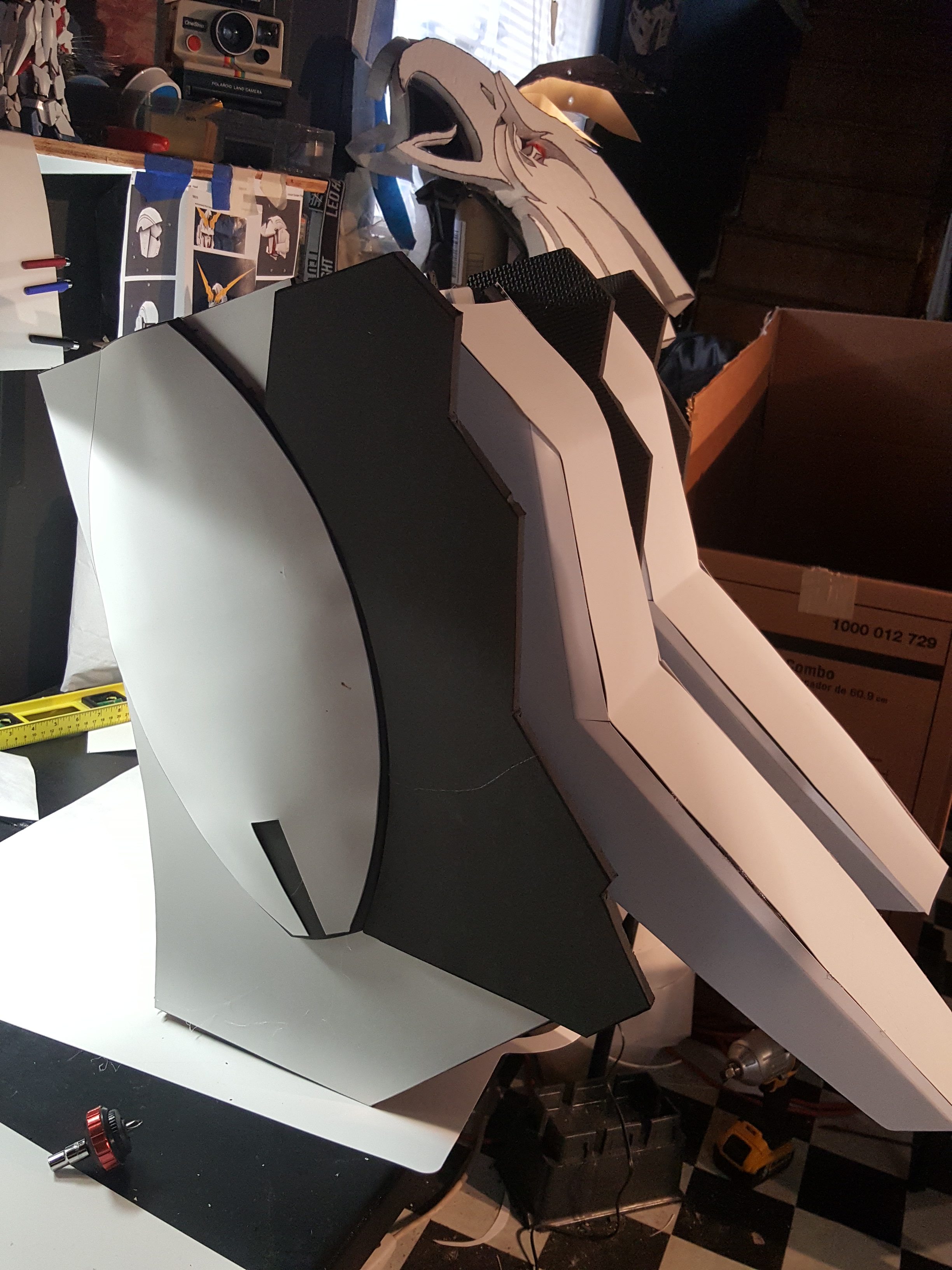

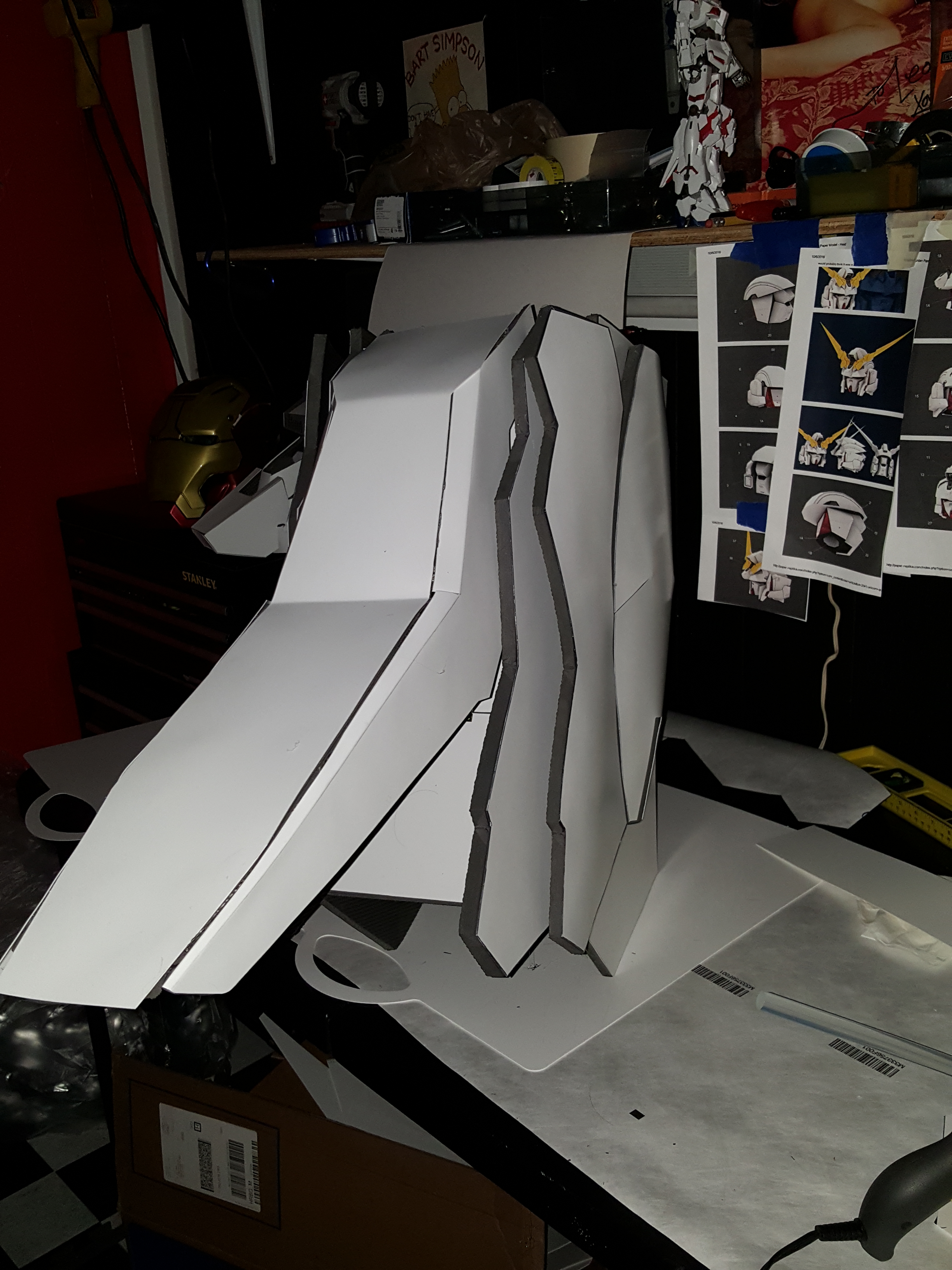

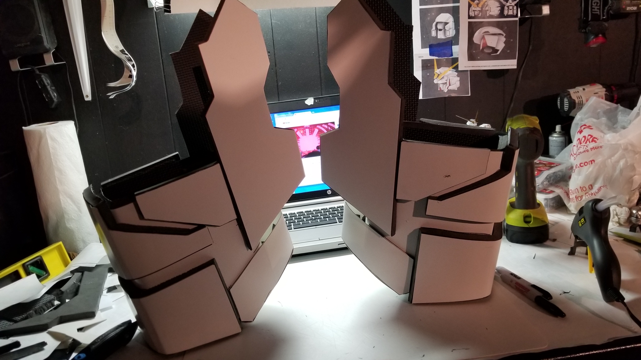

20161022_165531.jpg 20170524_194635.jpg 20170524_194647.jpg lower leg section
20170524_194737.jpg 20170524_194753.jpg quick mock test
20170522_194022.jpg 20170522_194043.jpg 20170522_203540.jpg 20170522_203551.jpg 20170523_214437.jpg 20170523_214449.jpg 20170523_214501.jpg Lower leg rear thruster flaps

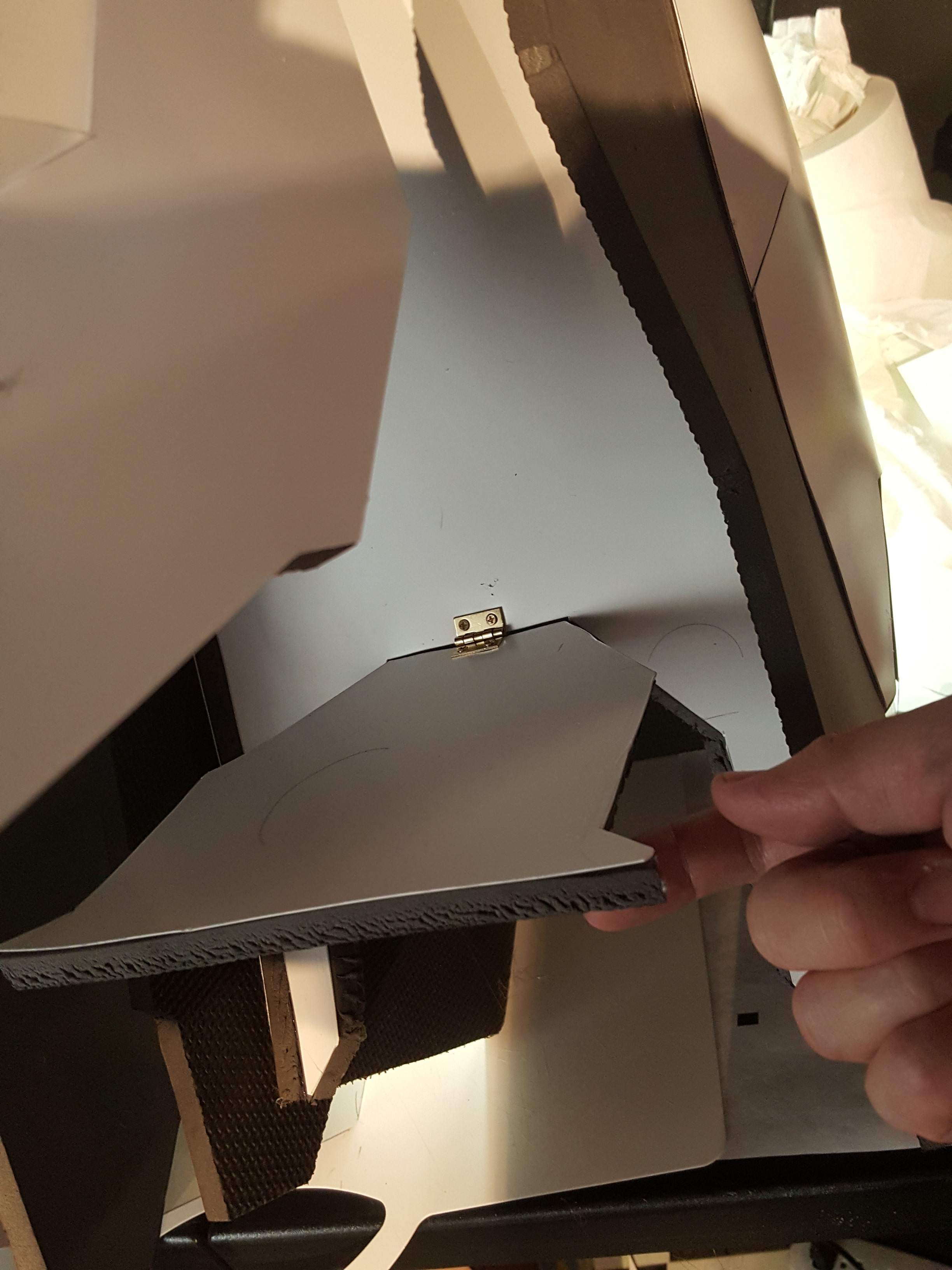

20170524_210533.jpg Mock up of position prior to hinge install
20170527_181030.jpg 20170527_181039.jpg 20170527_181053.jpg 20170527_181205.jpgHinge access door for strapping of boots

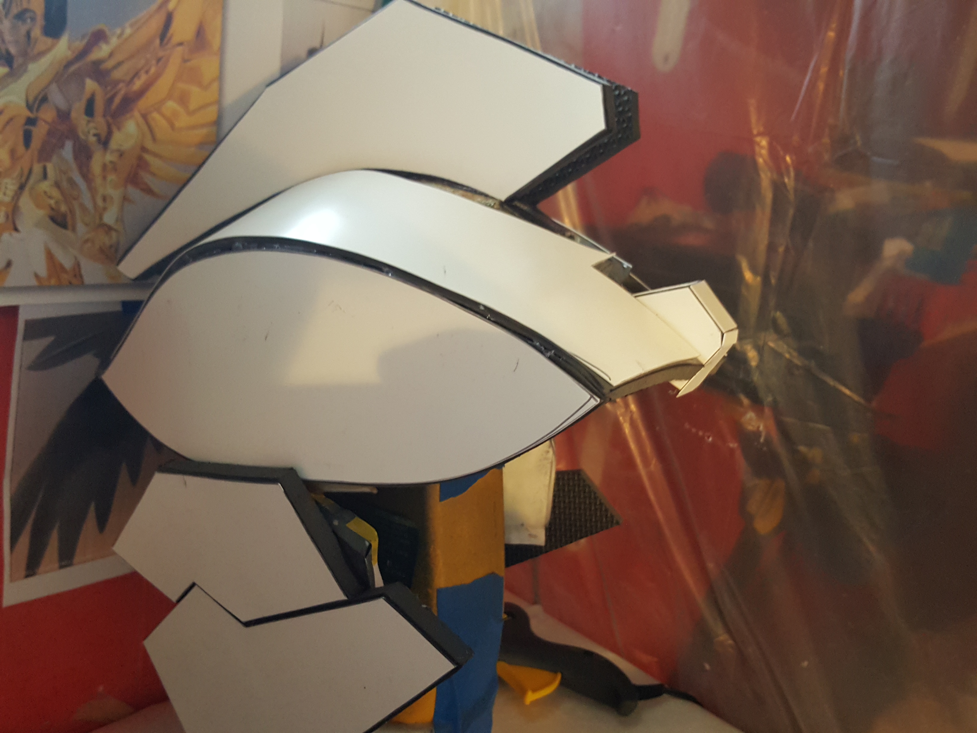

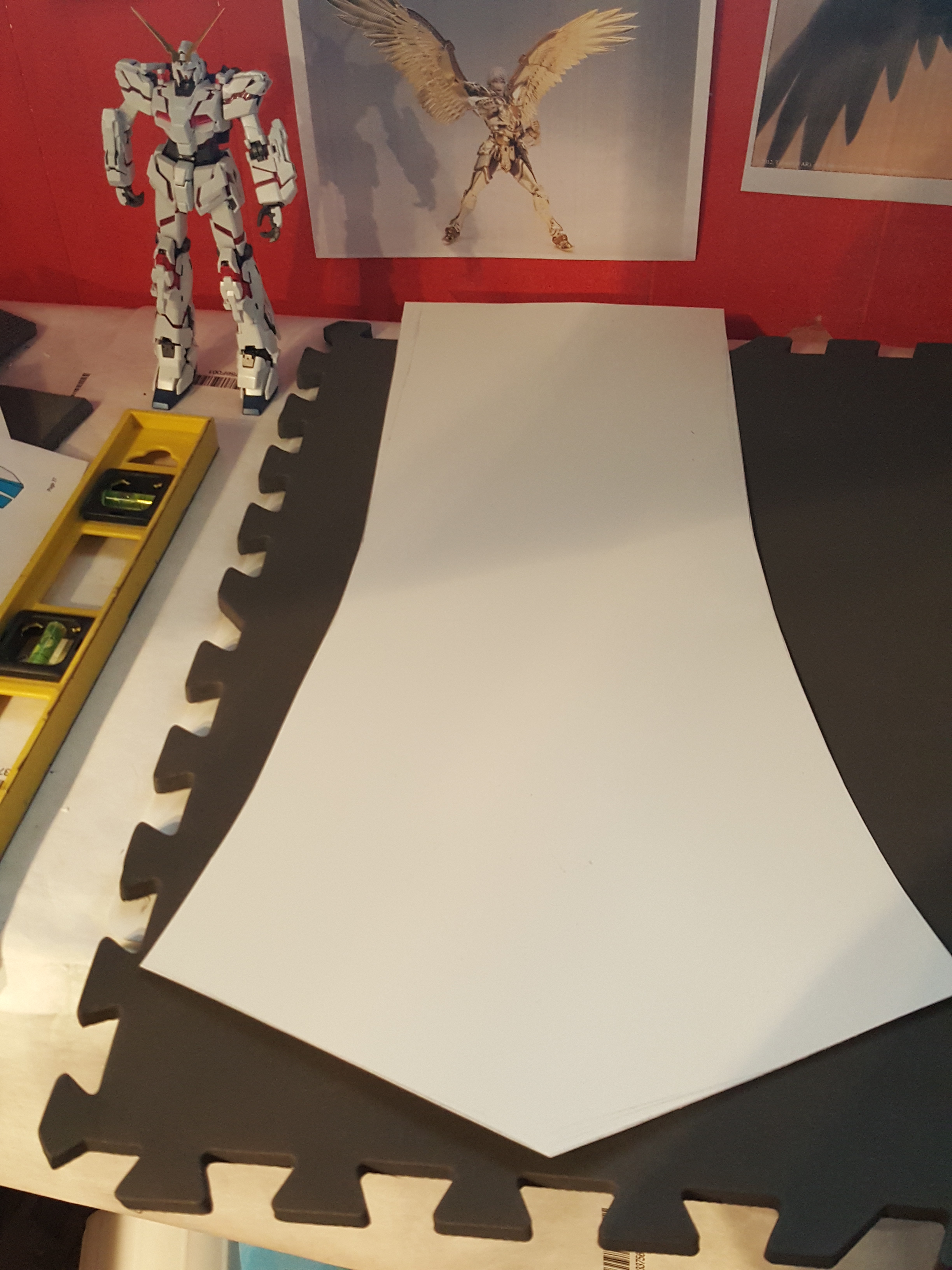

20170530_214115.jpg 20170530_214123.jpg added basic skin detail, more will be added once entire frame is constructed. The details will be custom and will deviate from original model kit, this will have a different twist visually.

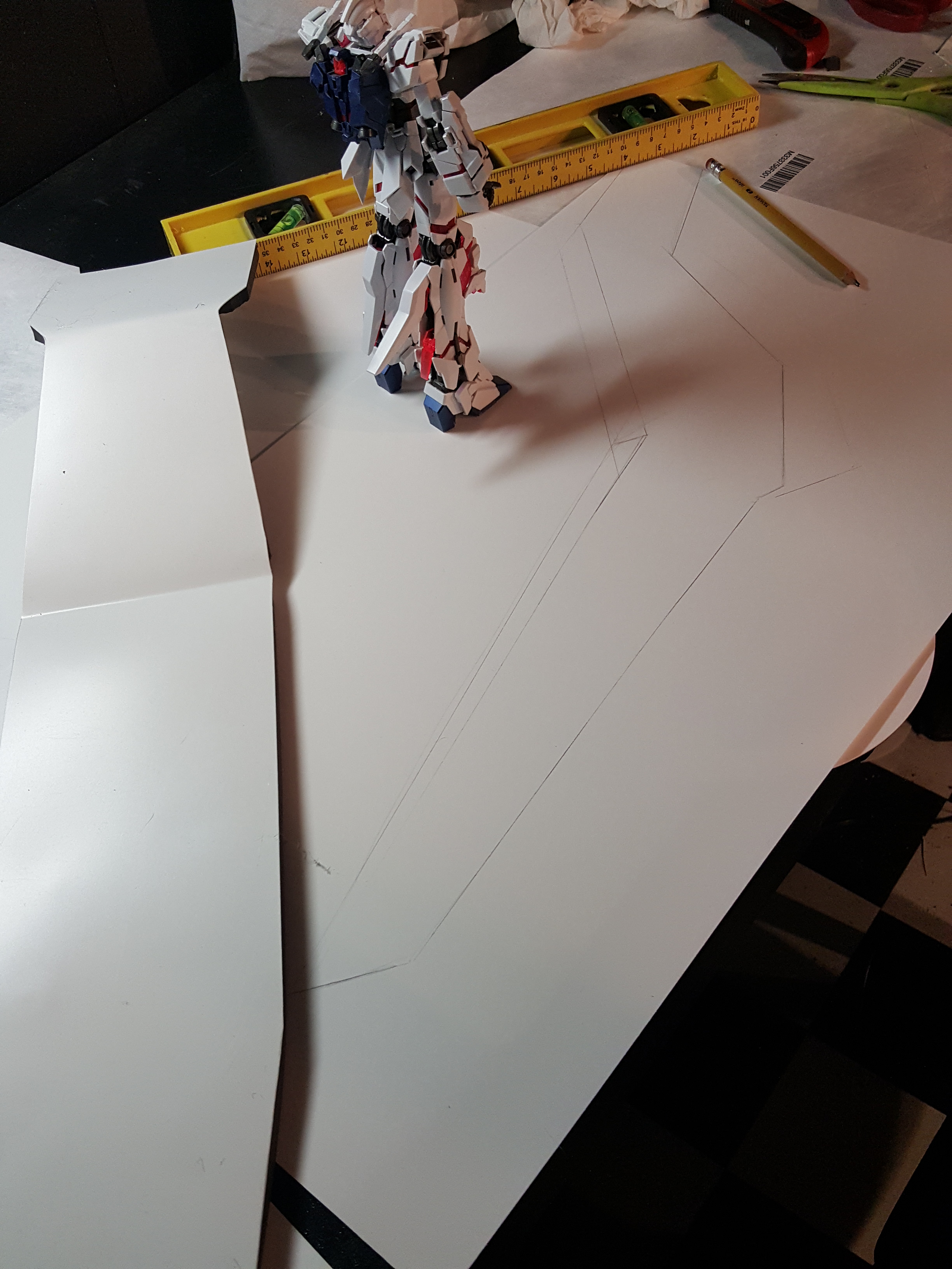

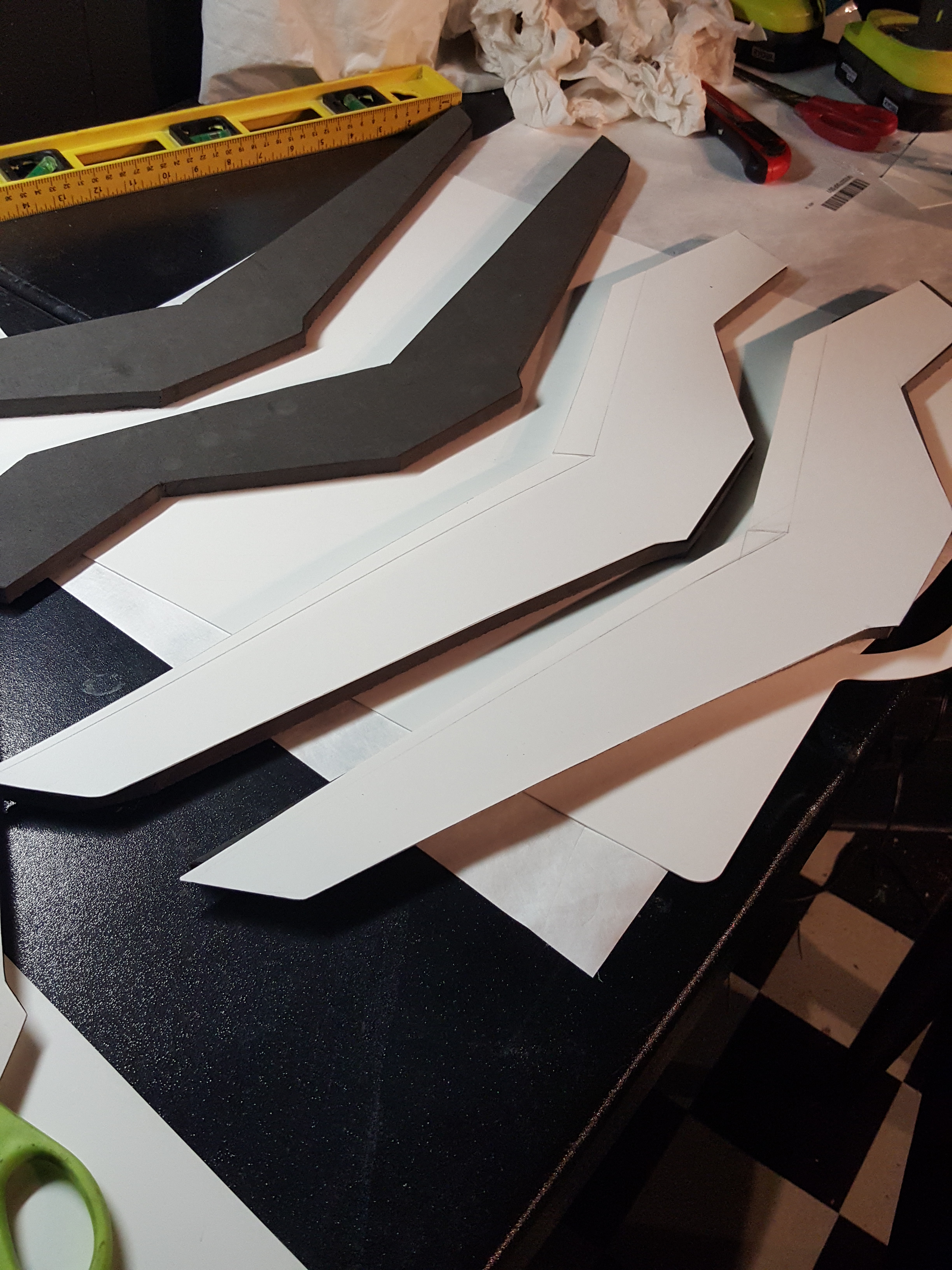

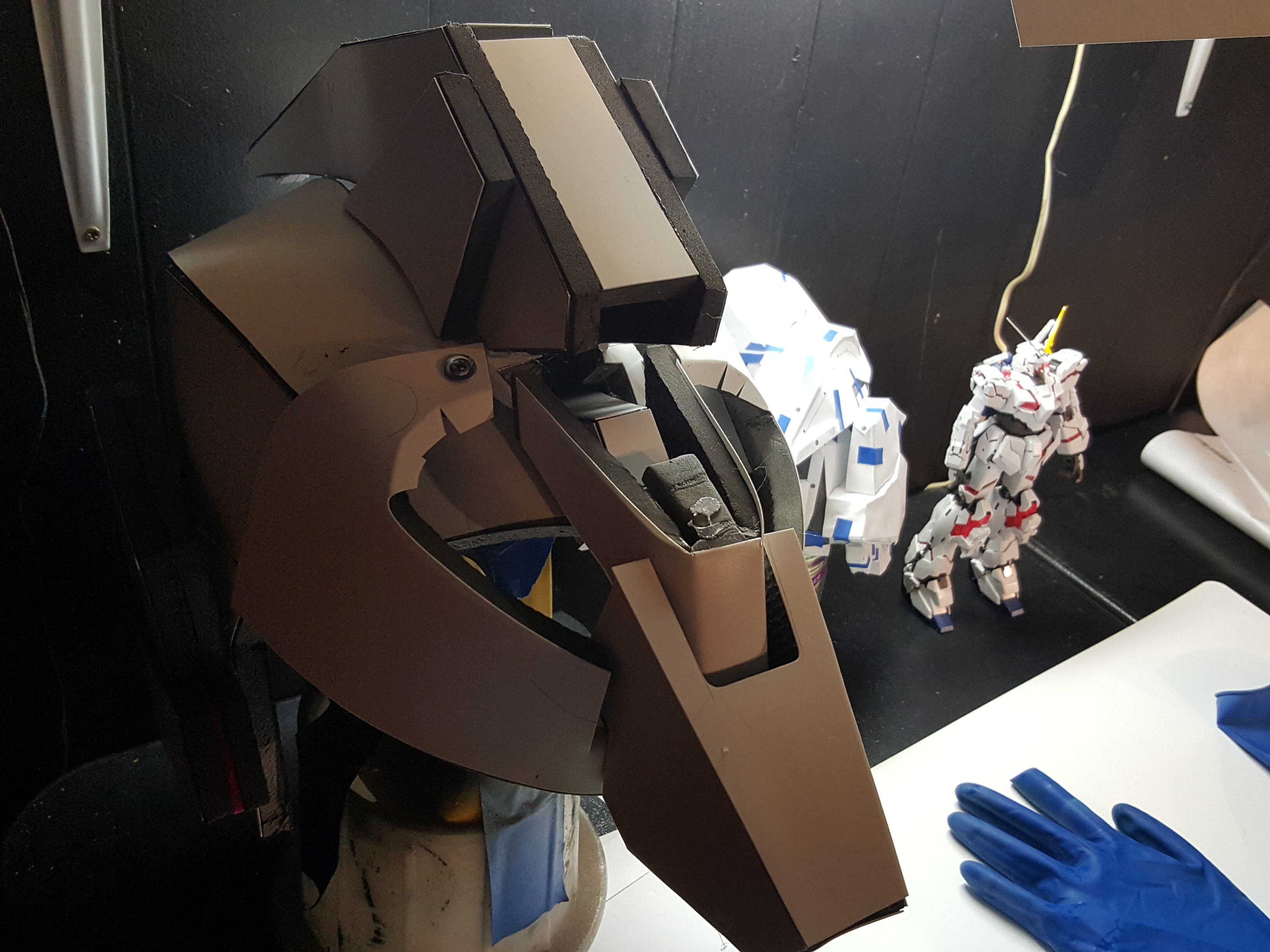

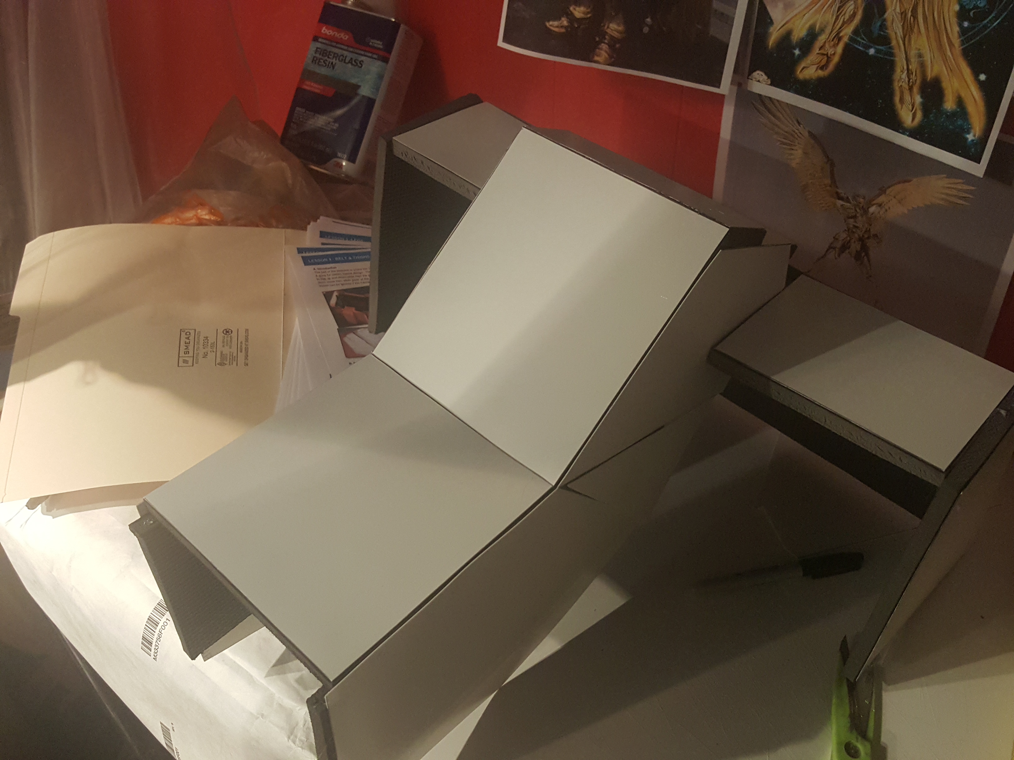

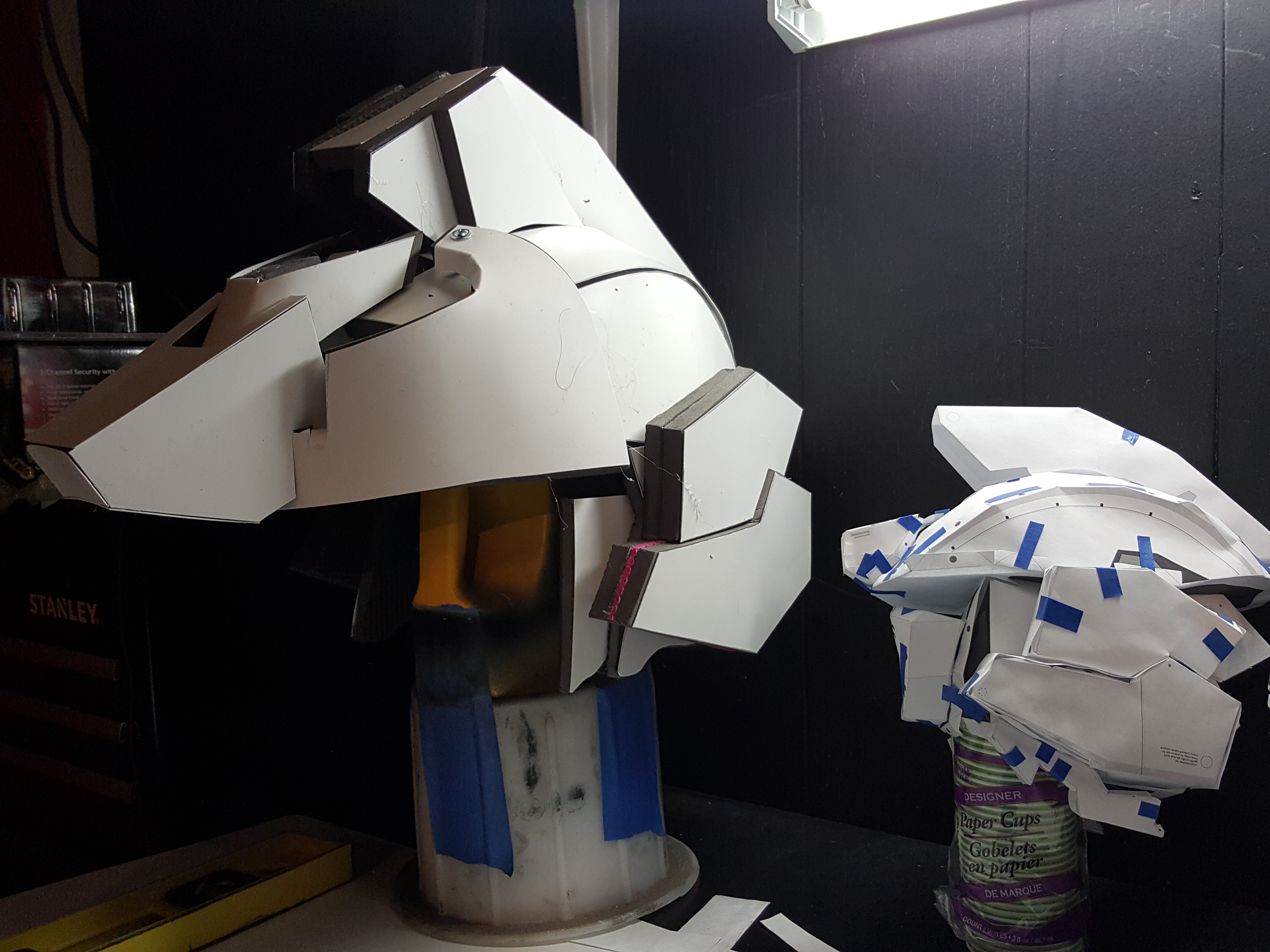

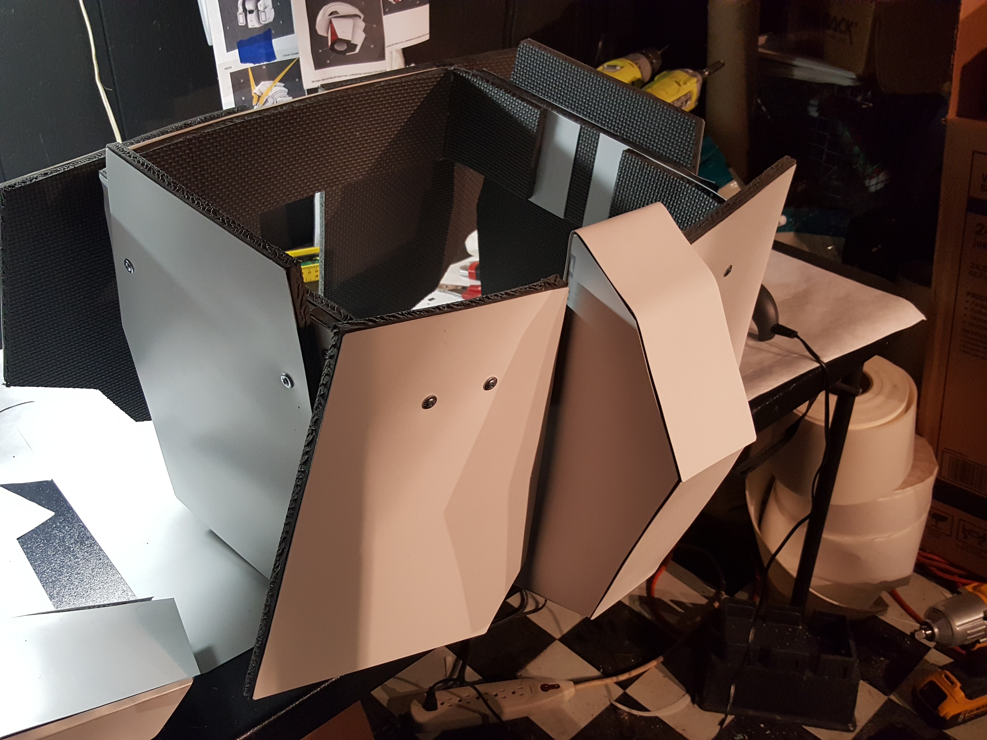

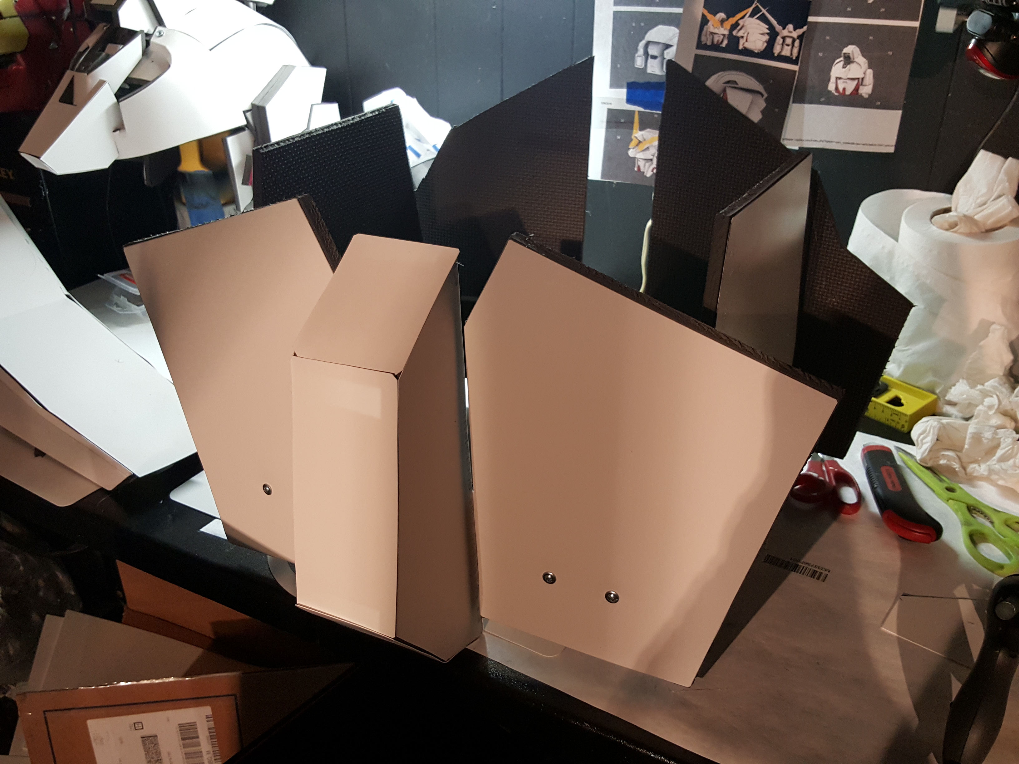

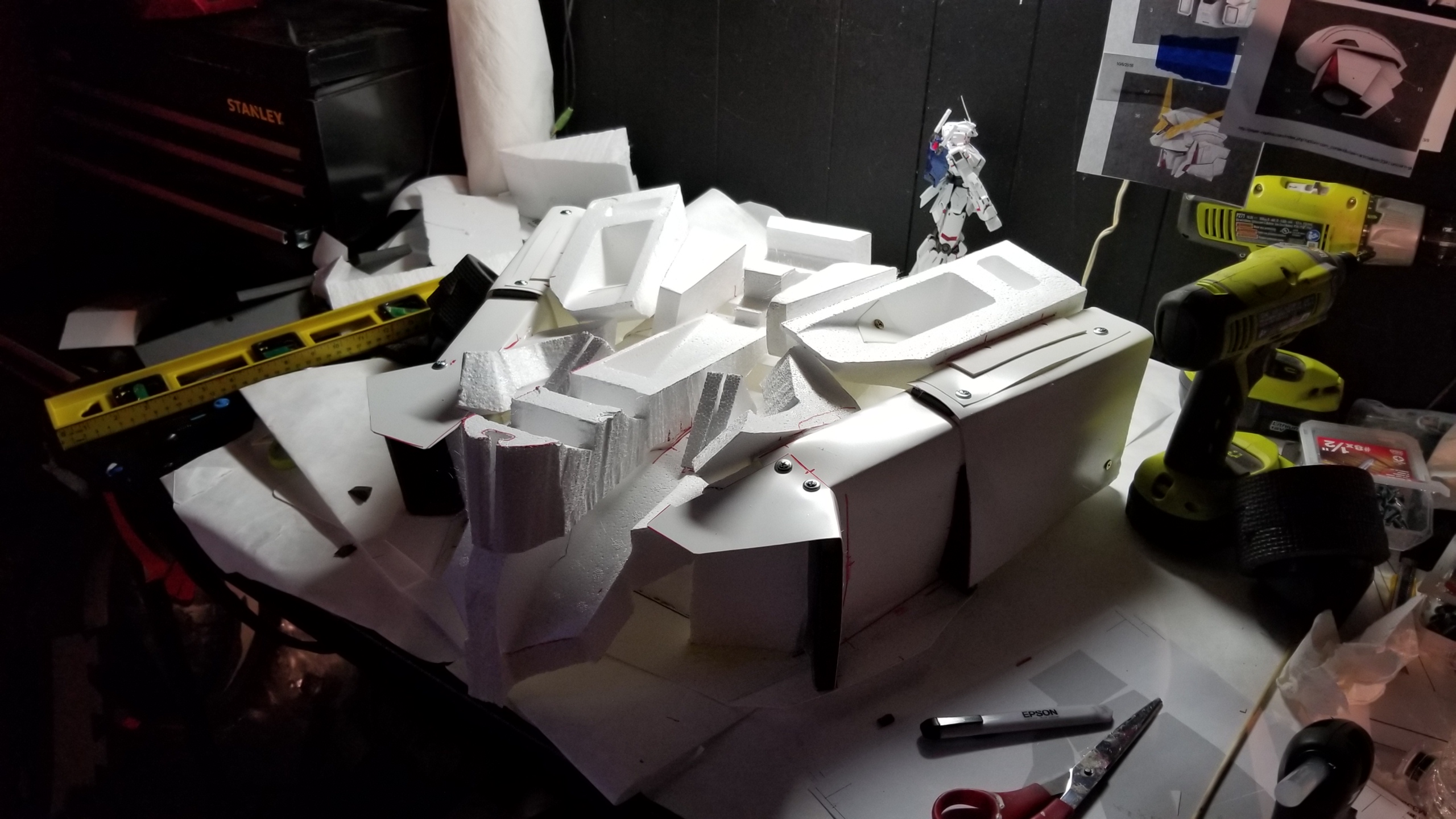

20161020_161600.jpg 20170108_174647.jpg 20170108_174633.jpg Getting builder's block with no desire of furthering the leg so just going to dive into random sections of the suit...such as the helmet and stop half way.

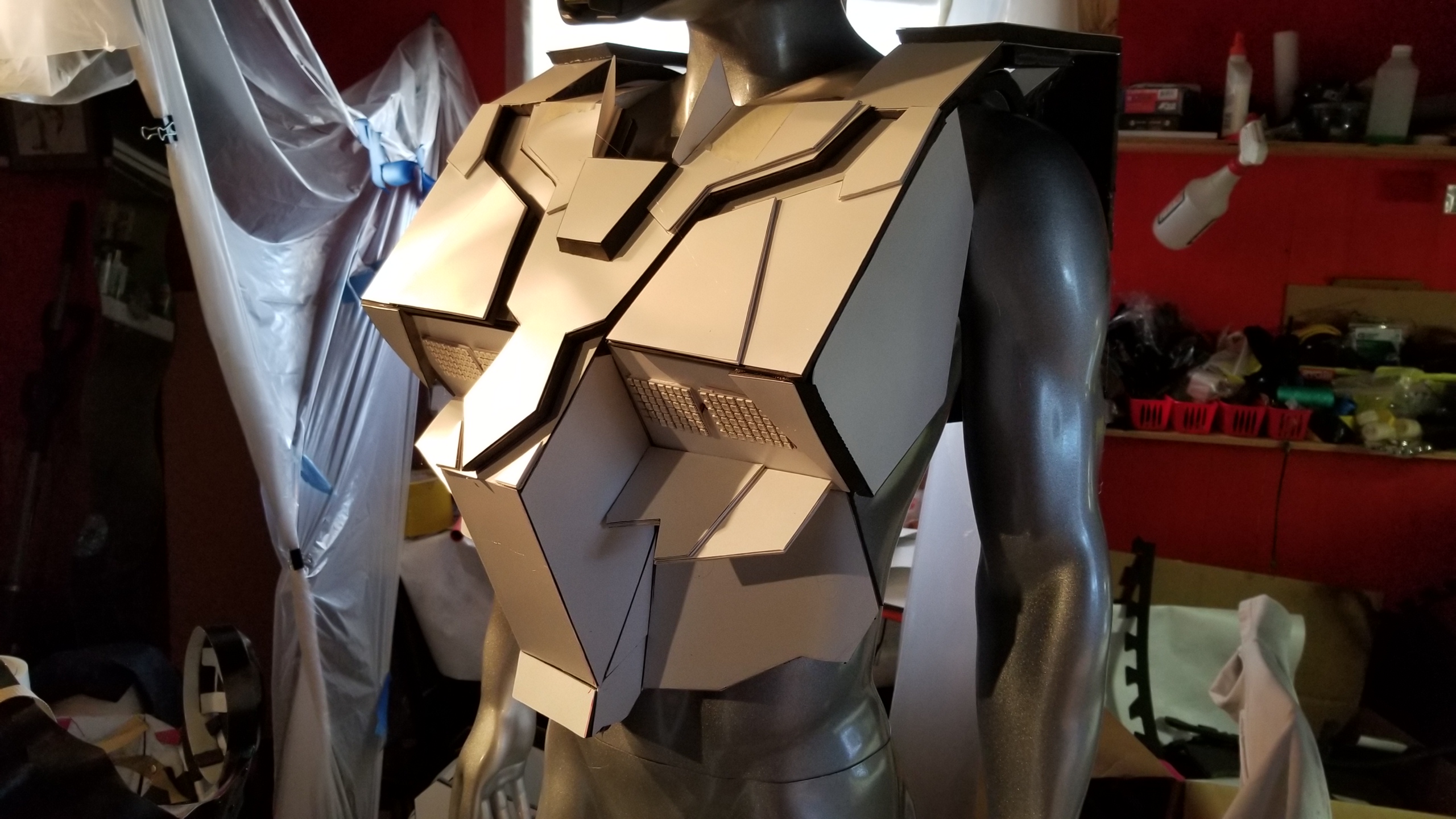

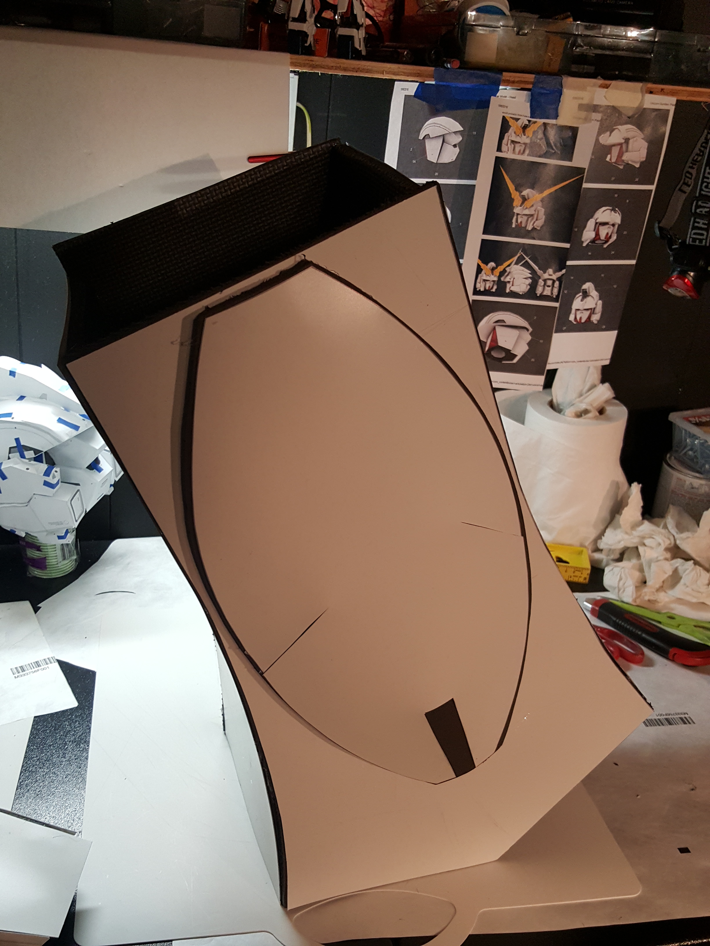

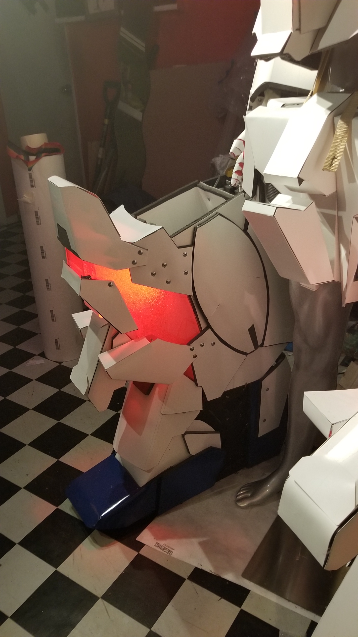

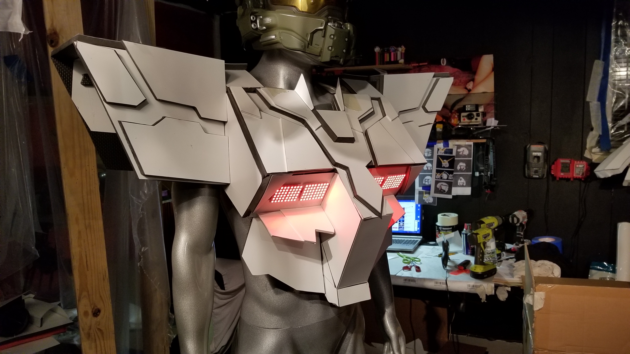

20161021_215116.jpg 20161022_085214.jpg The front chest...stopped halfway as well

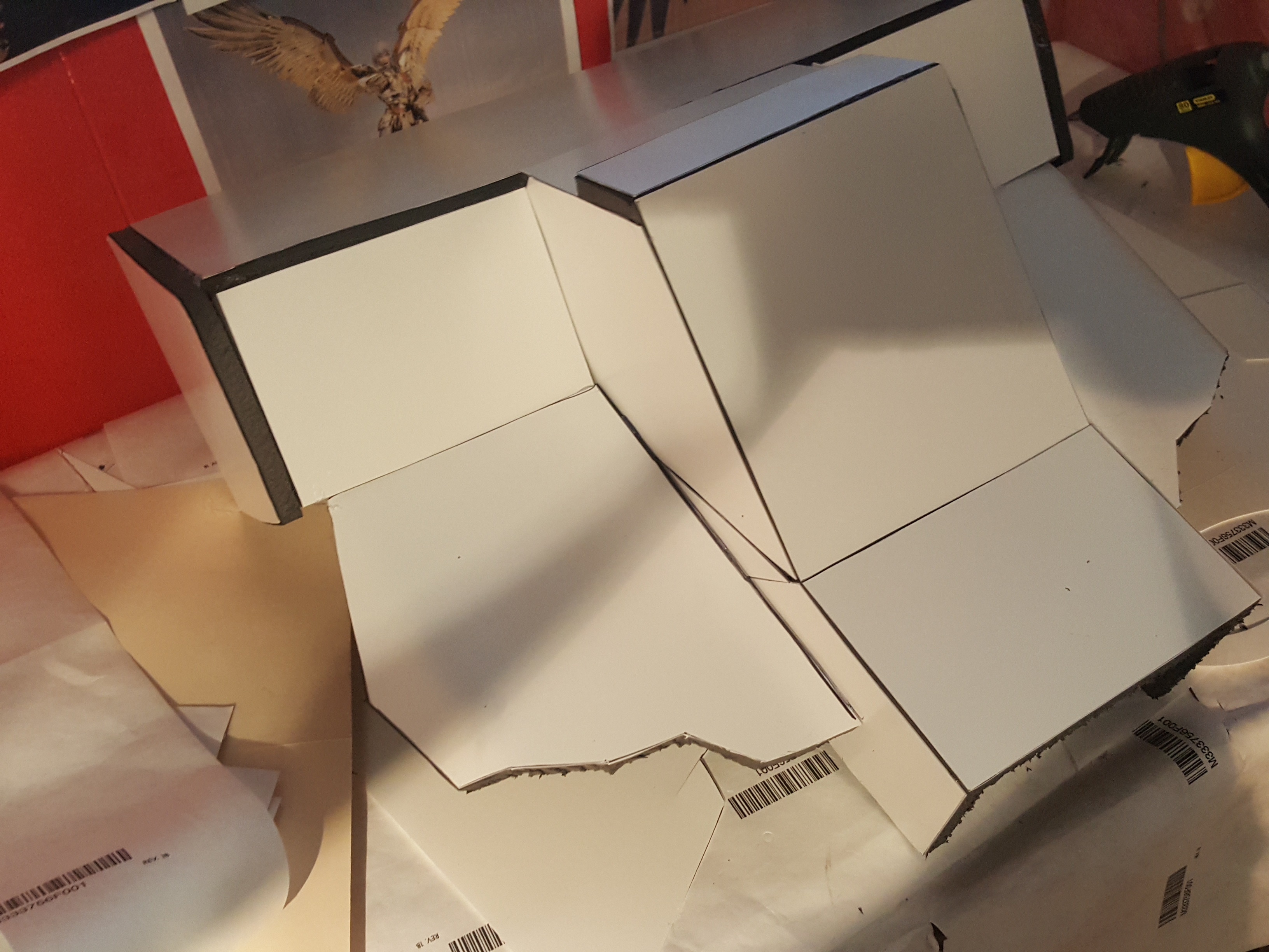

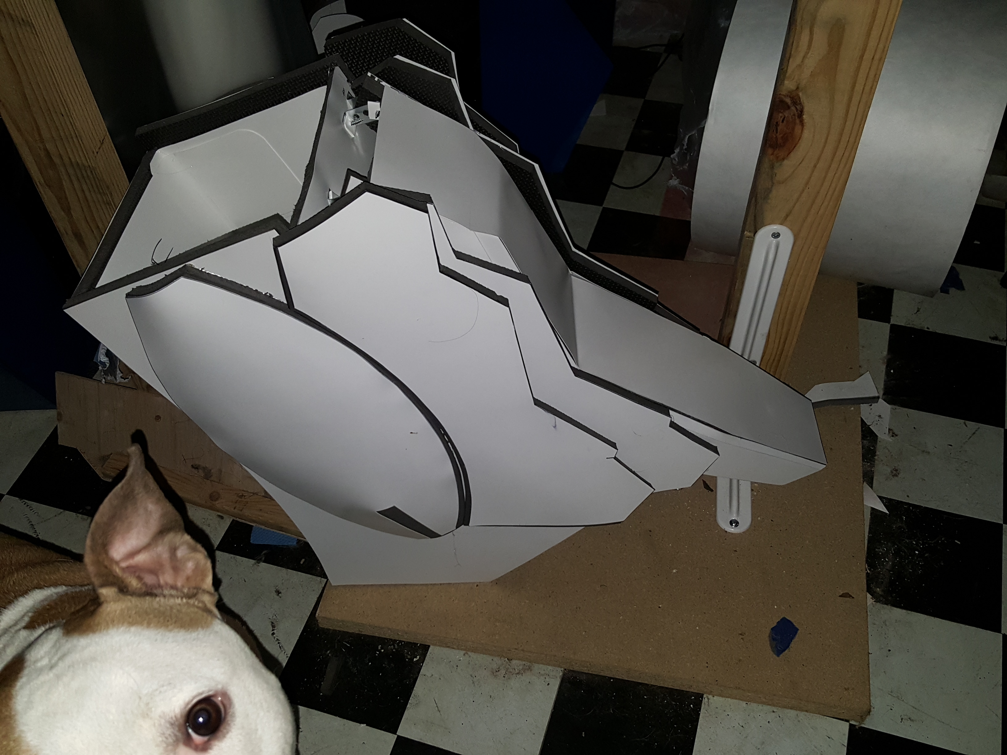

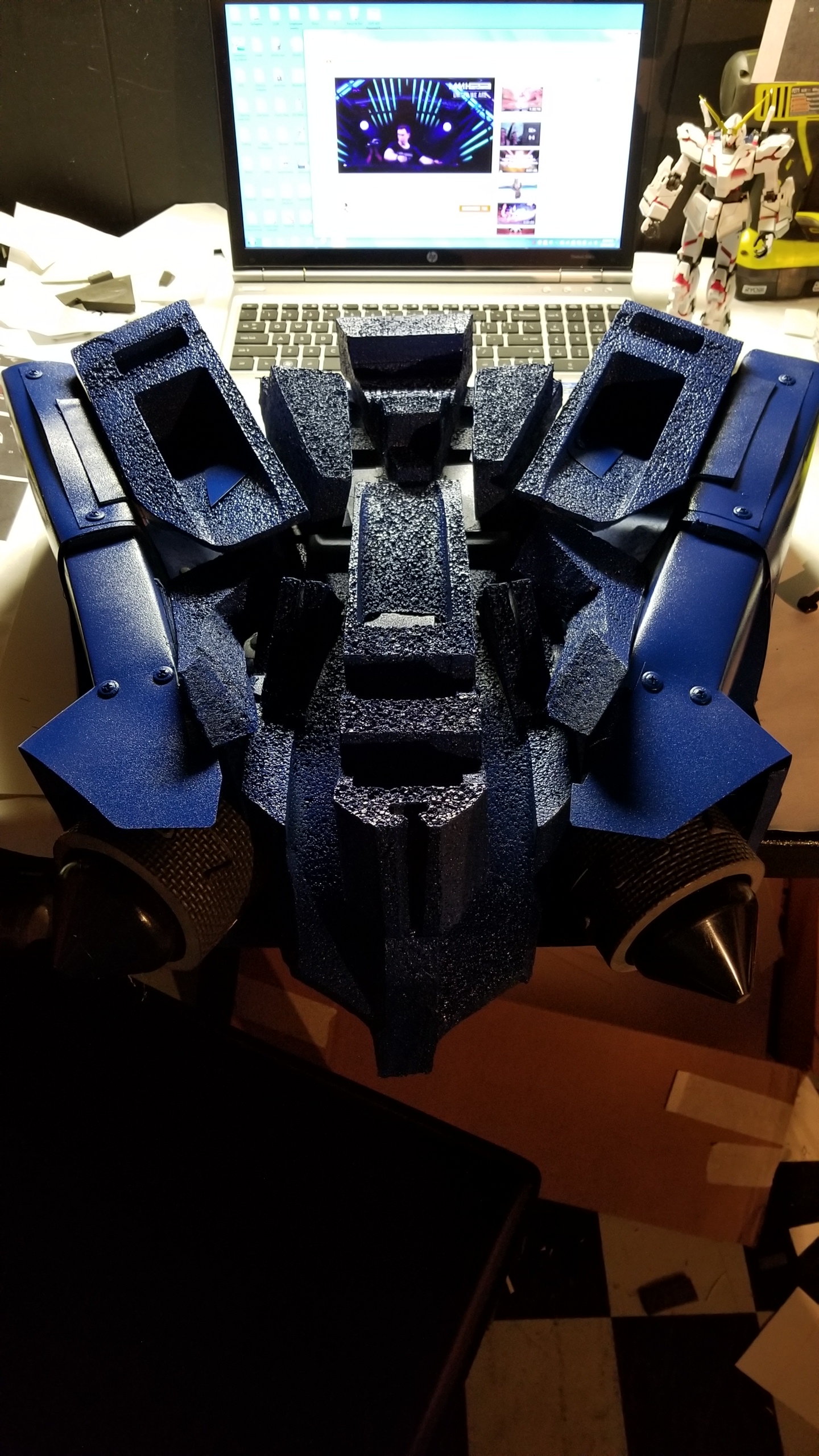

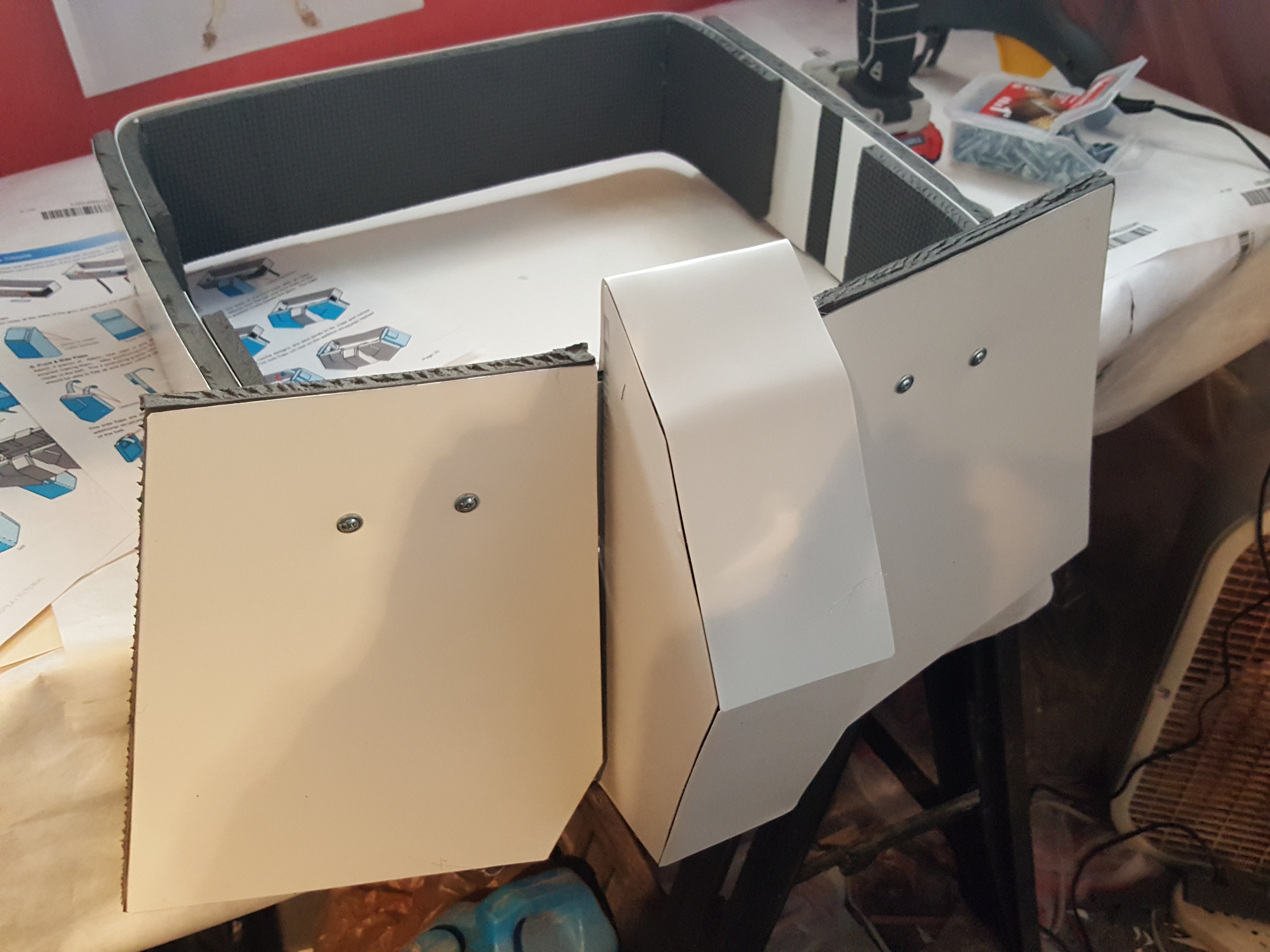

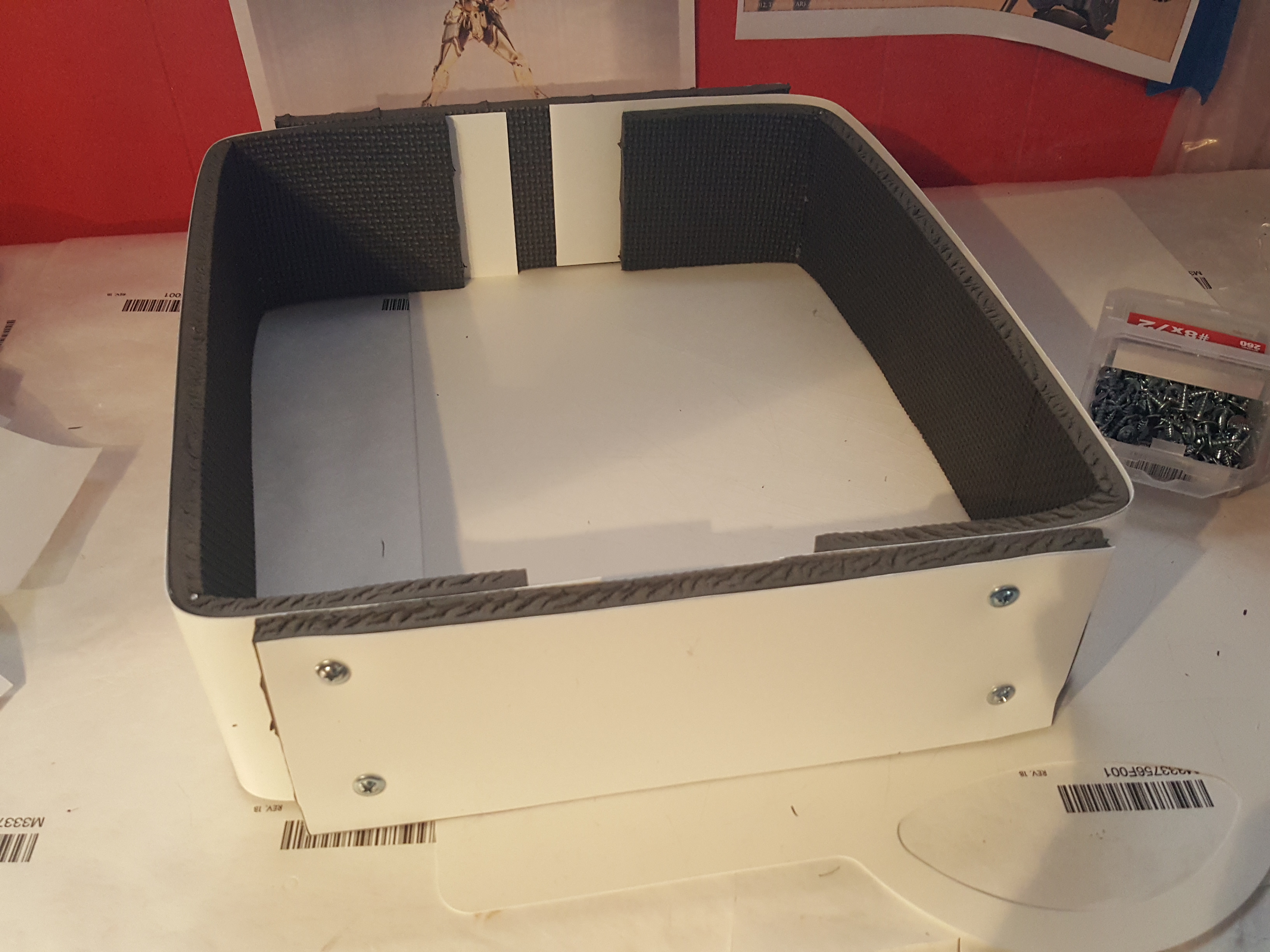

20161022_115409.jpg 20161022_161201.jpg 20170524_194818.jpg 20170524_194849.jpg lower torso

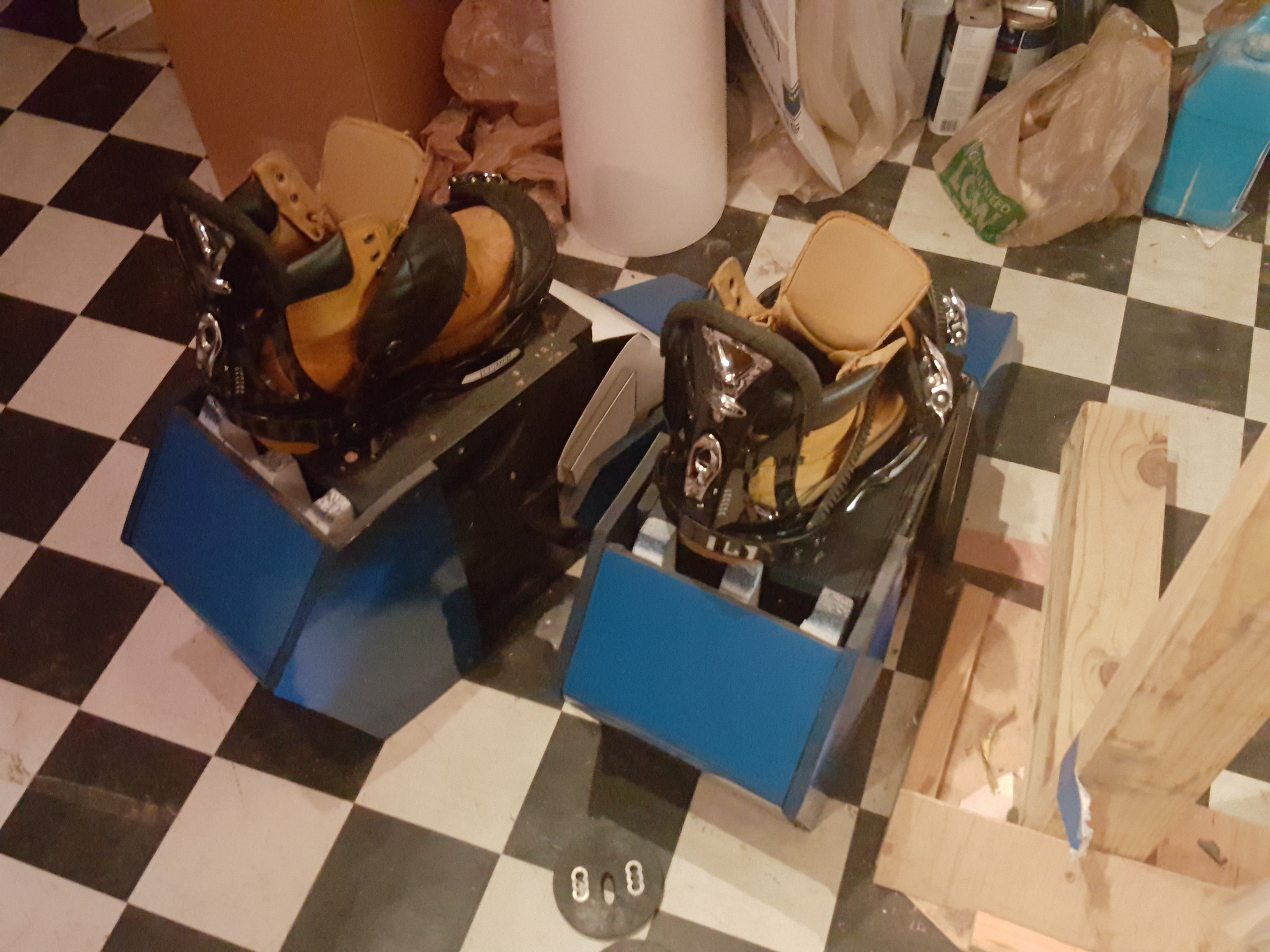

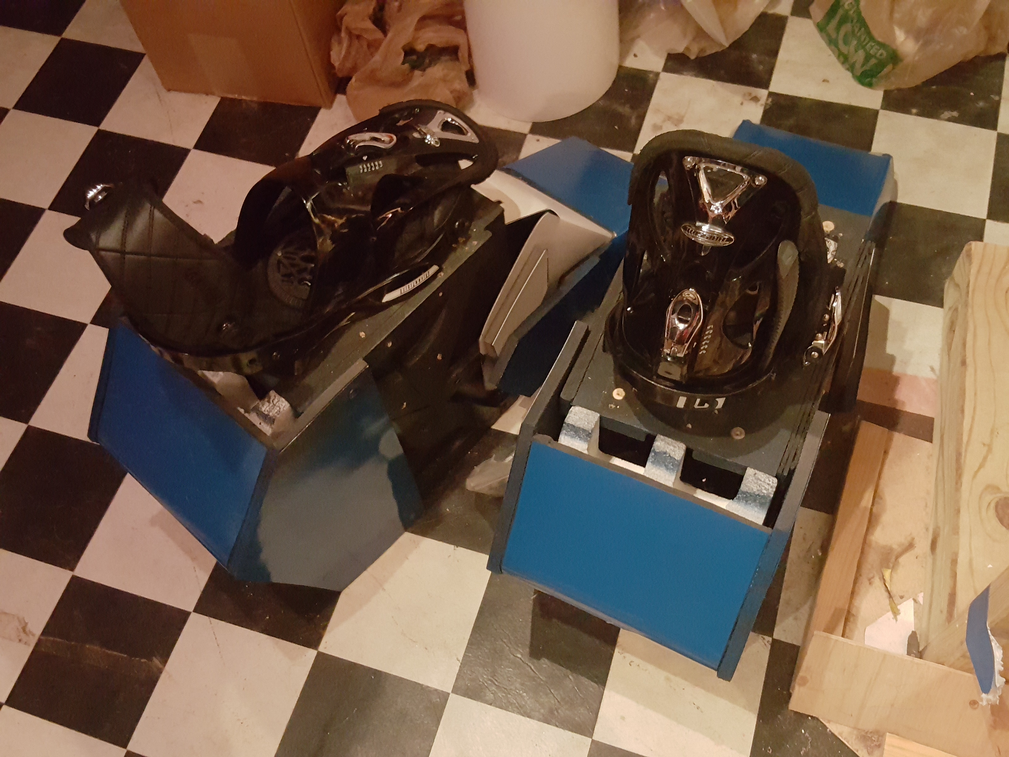

20170612_211254.jpg deviated from original shoe mount concept, instead opt for ---> 20170612_212325.jpg Burton snowboard bindings
20170615_212727.jpg sacrifice my burton's mission bindings for a more secure mounting/unmounting while retaining original foot wear

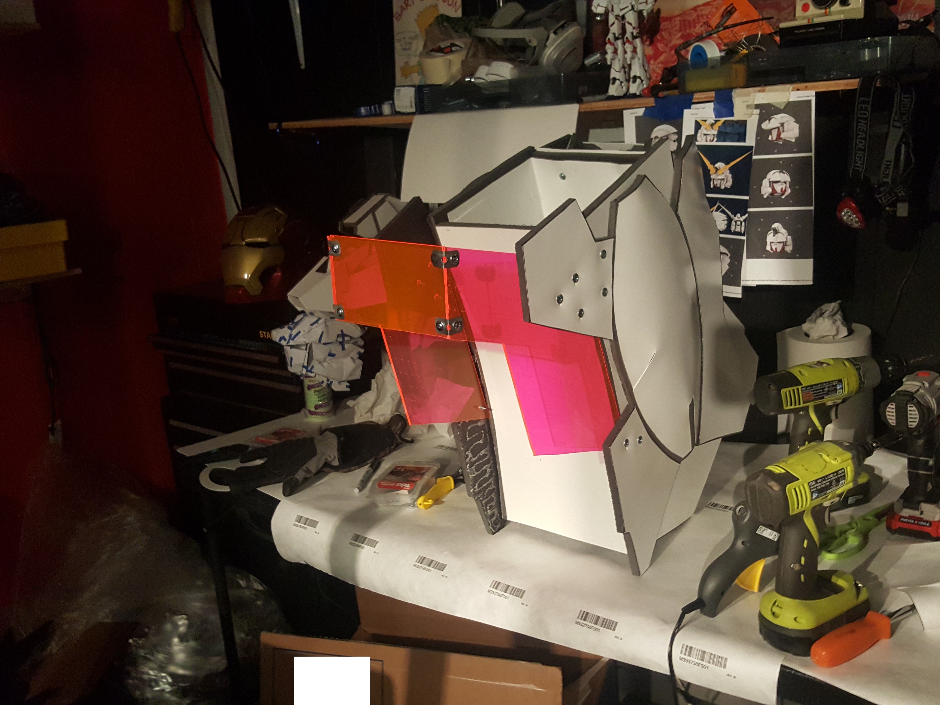

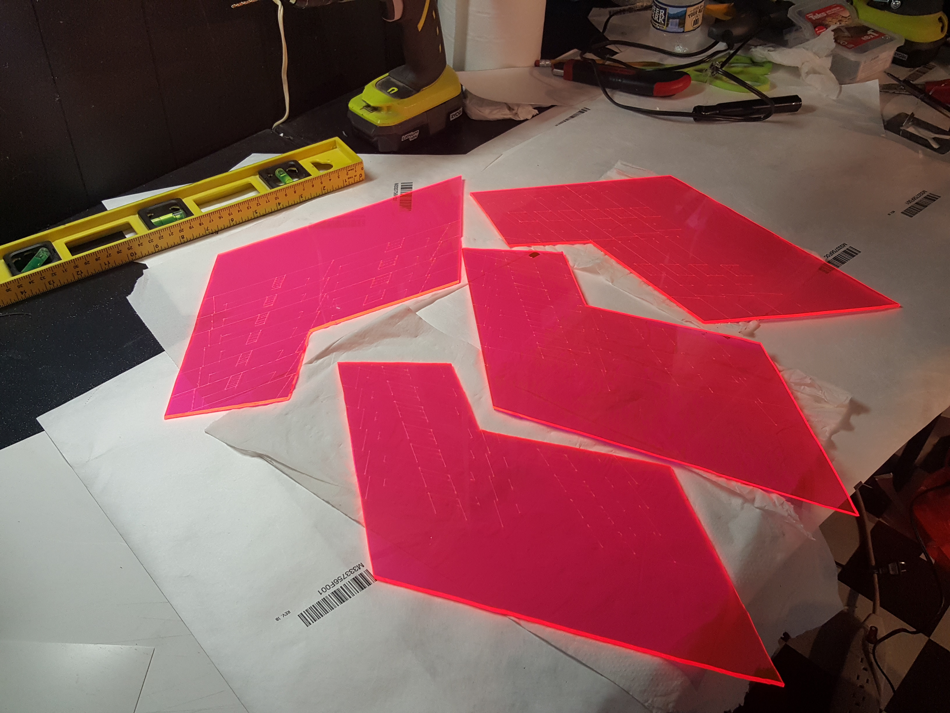

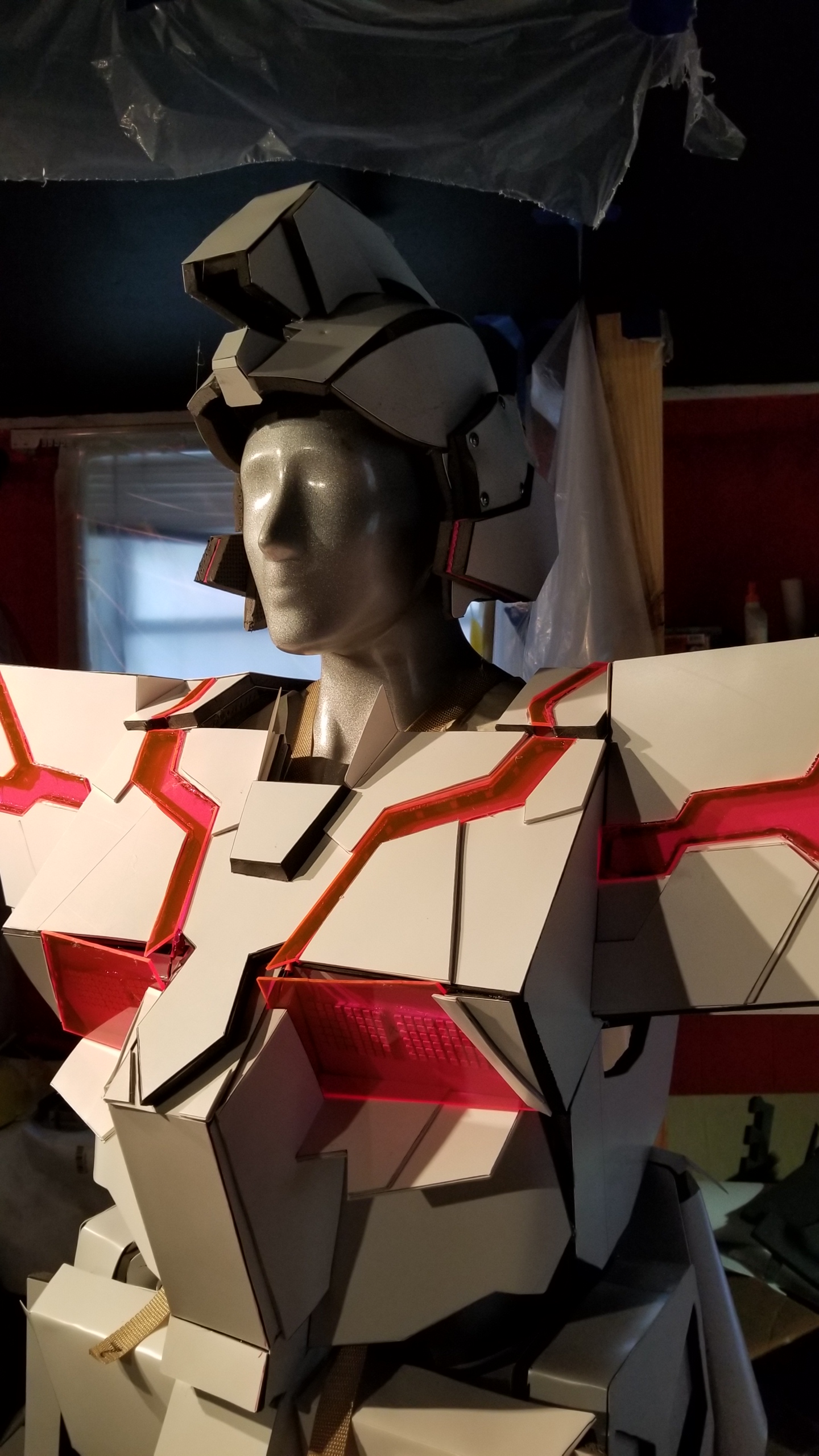

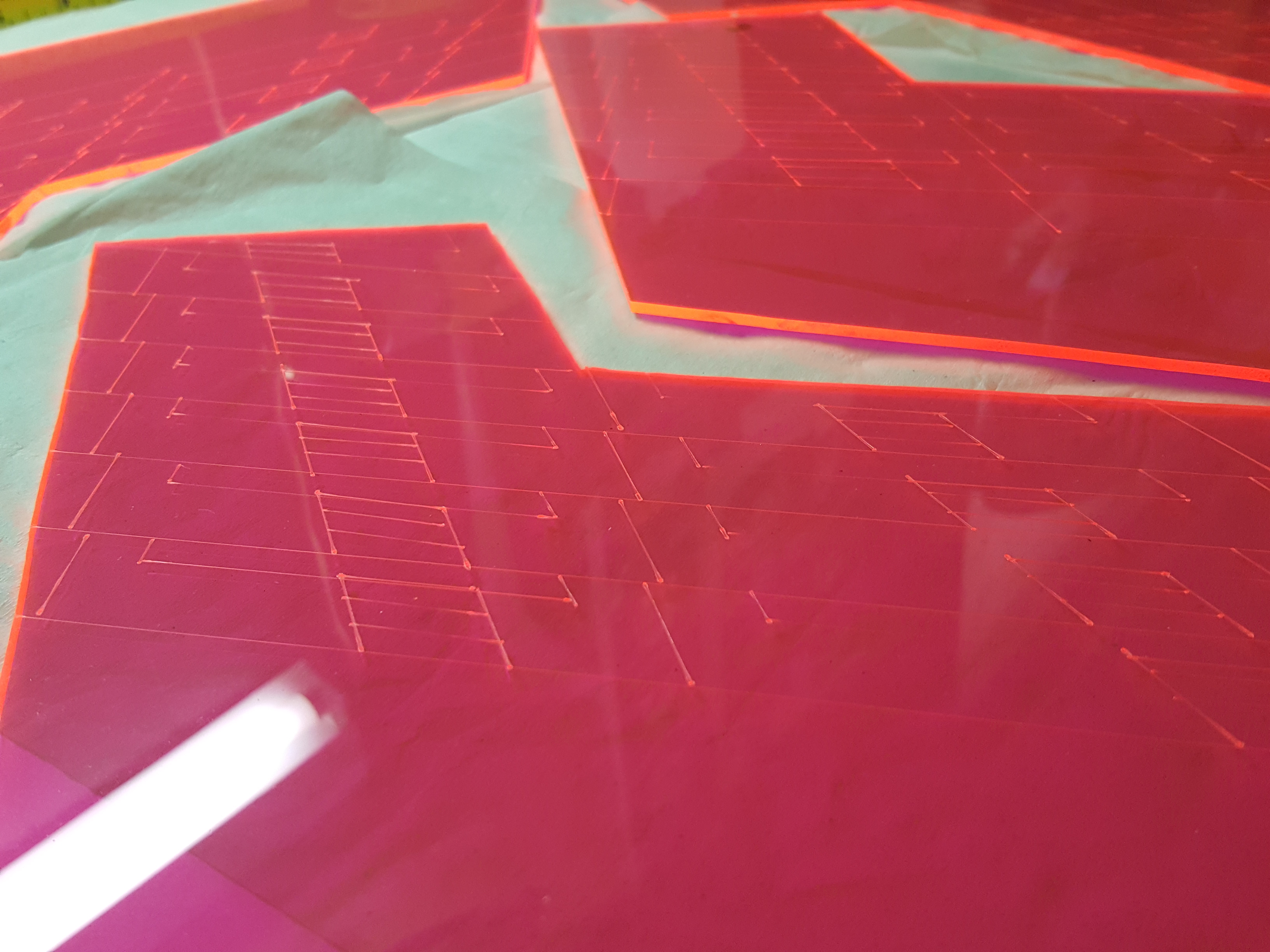

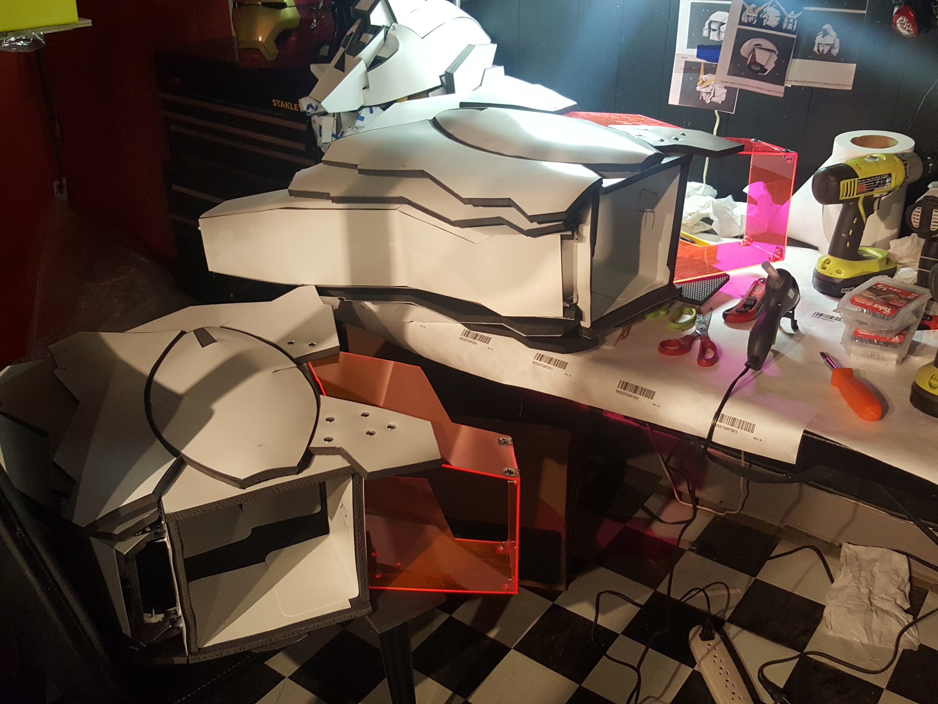

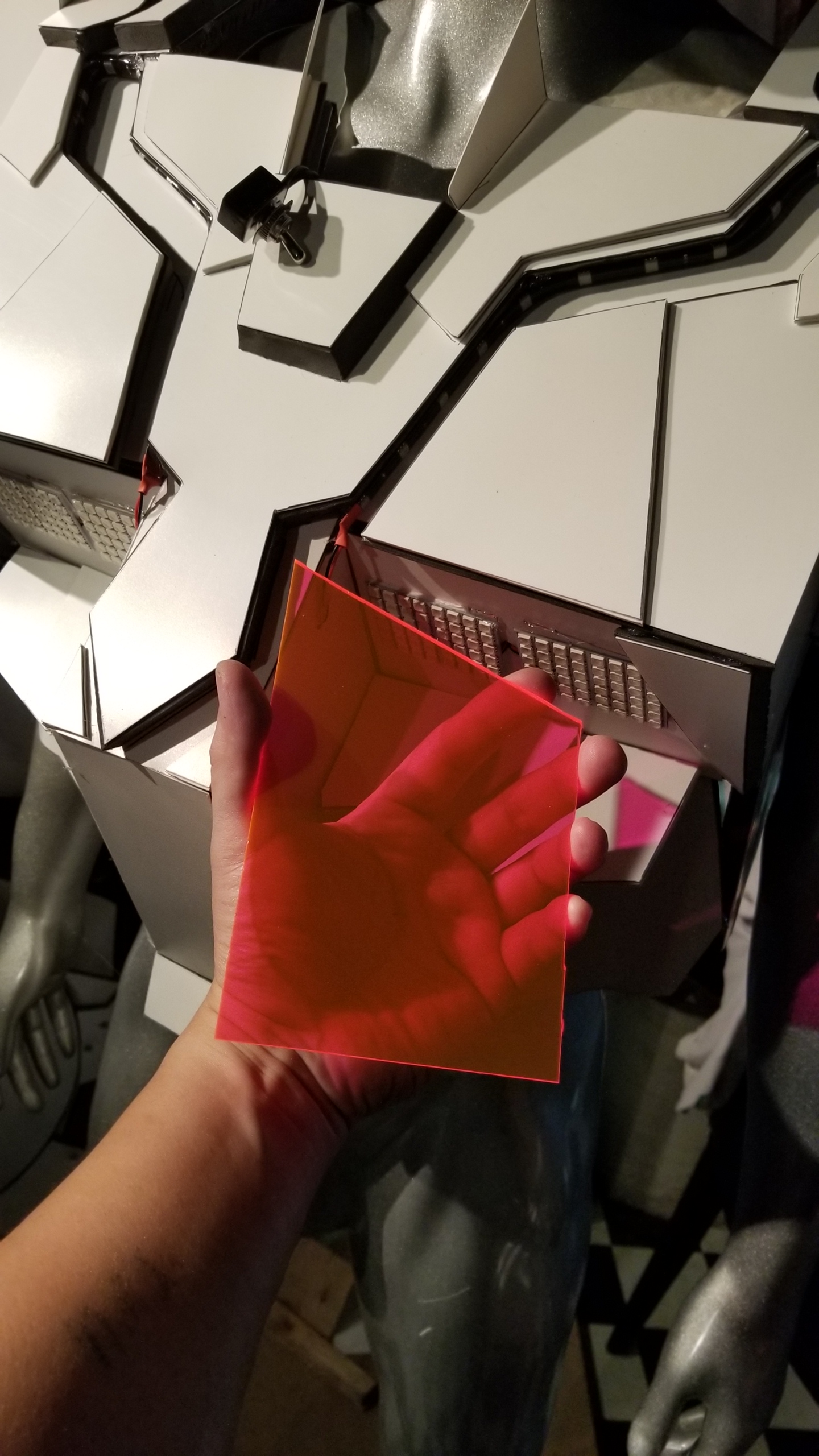

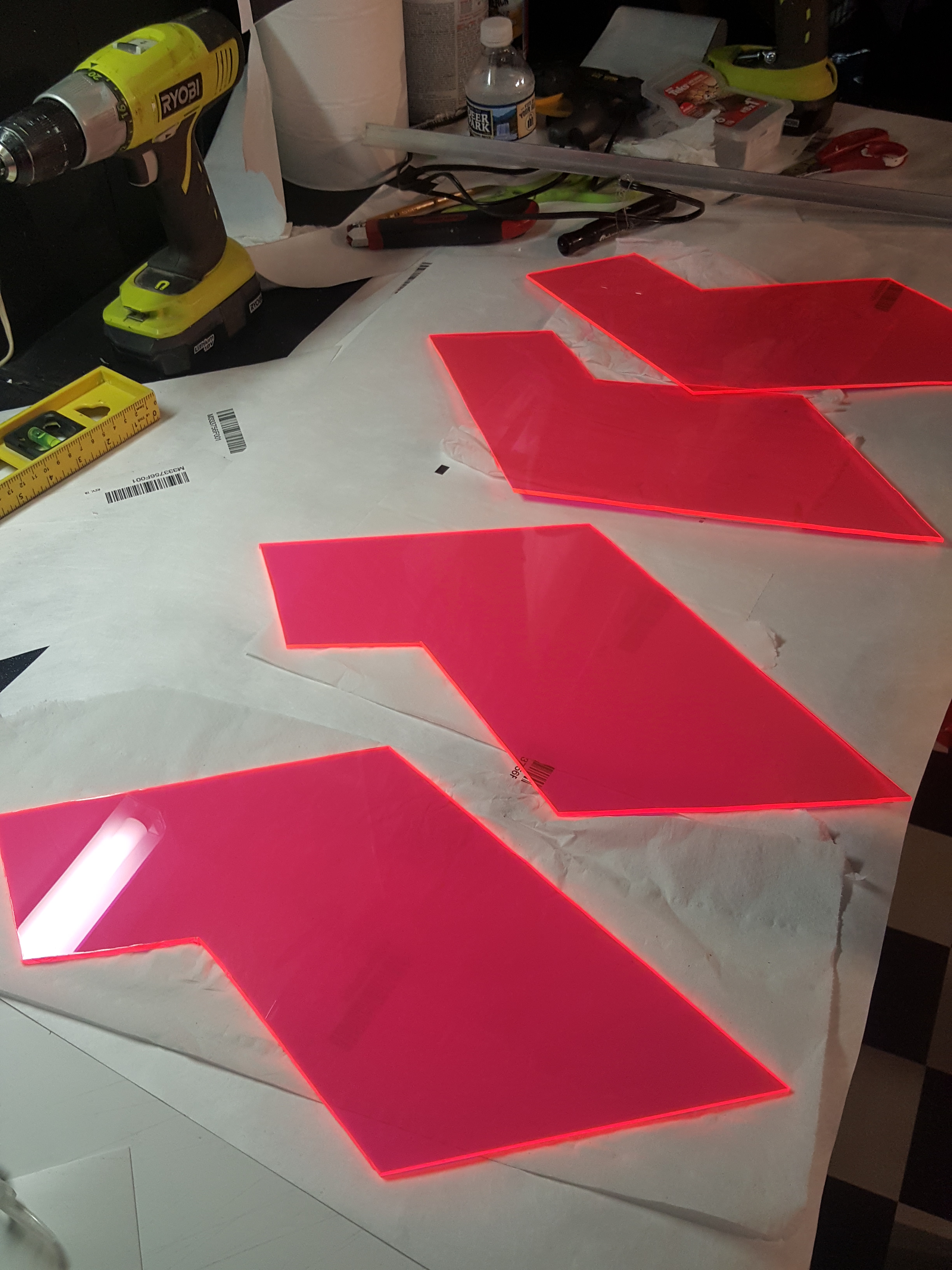

20170609_160957.jpg 20170609_174436.jpg Fluorescent pink plexi glass finally arrived.

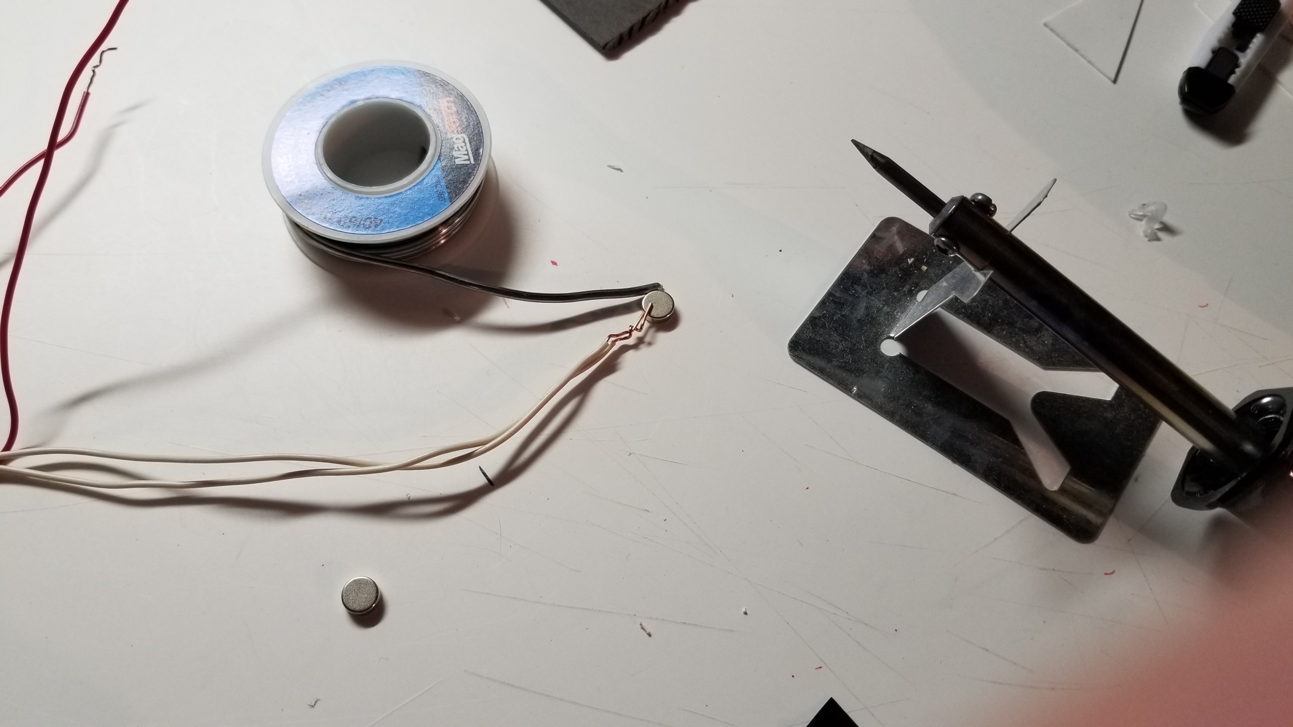

20170609_184021.jpg 20170609_184026.jpg Added line details with soldering iron.
That acrylic looks gorgeous, love the linework. I've wanted to do a Gundam suit for a long time, but have always been worried about being too uncomfortable wearing one from either height or lack of mobility. Your build looks like it's off to a great start though!
Thank you Armatus Cosplay, i am still a newb in all this. Mobility is always that annoying issue, i tend to find a corner and stand there to sweat it out for the duration.

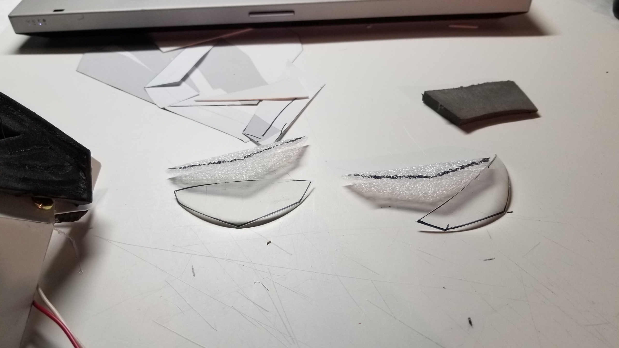

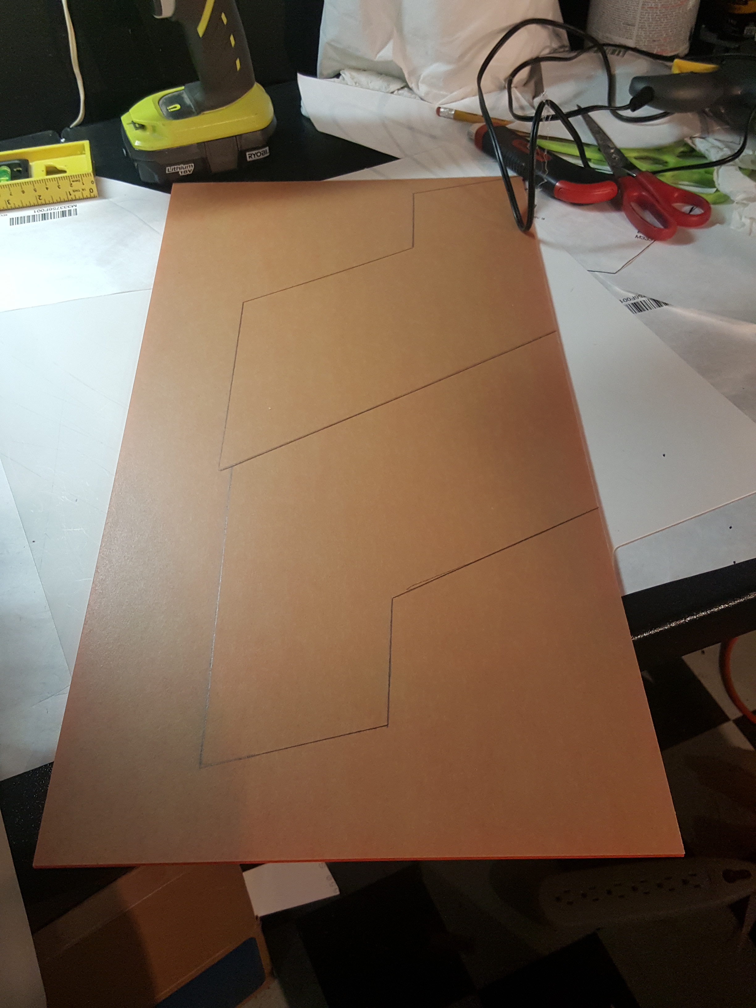

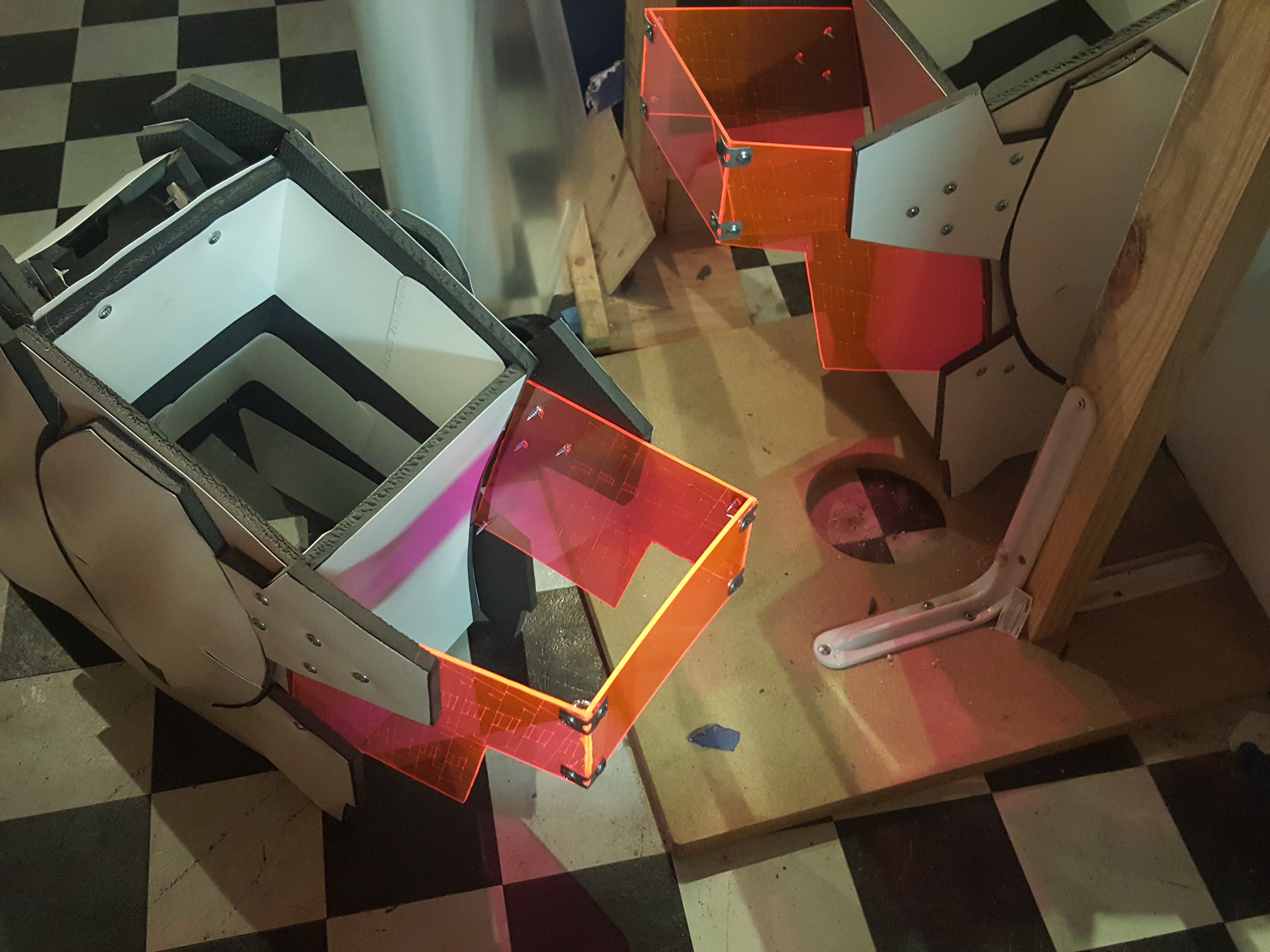

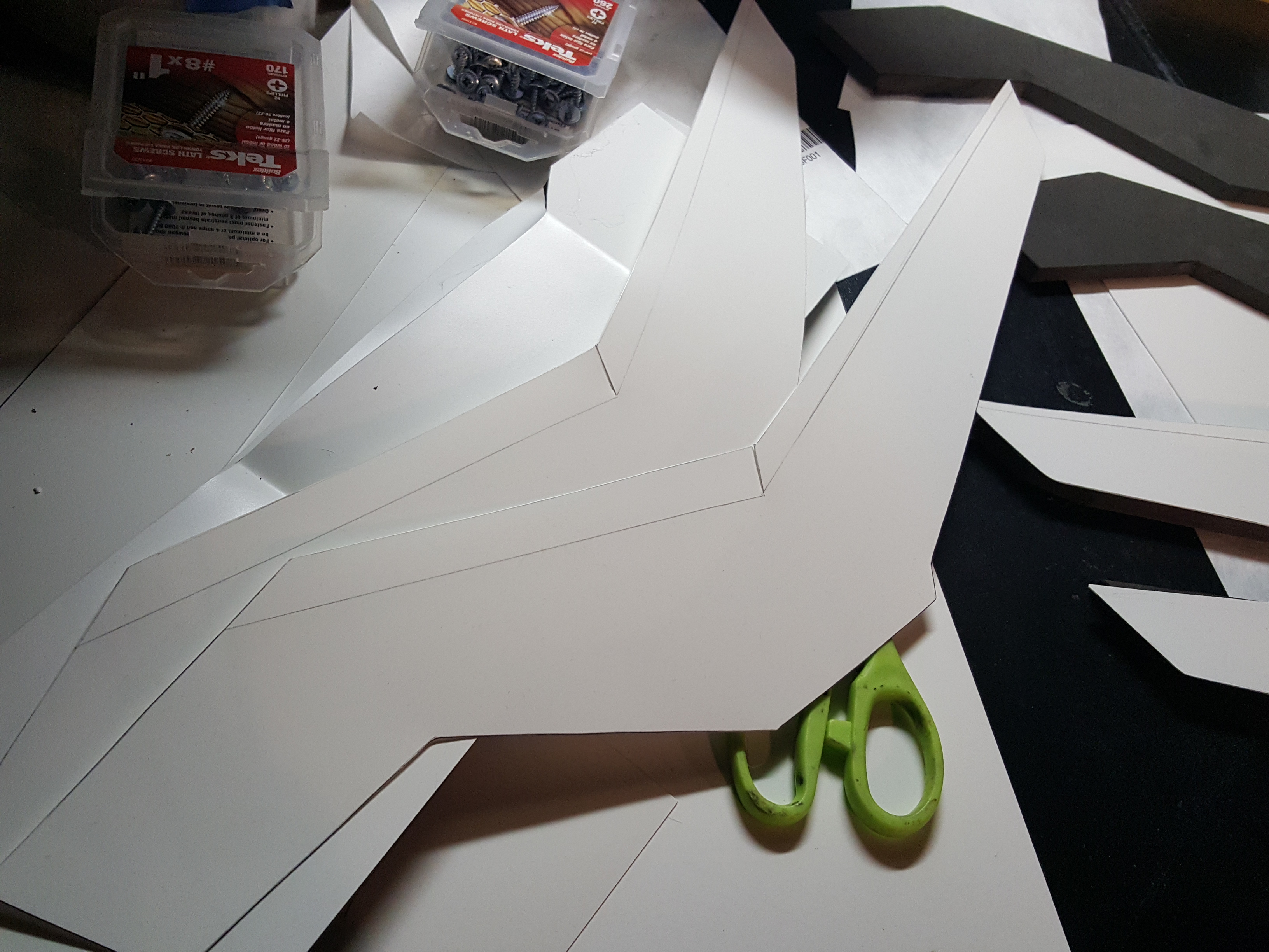

20171007_185513.jpg 20171007_180141.jpg 20171007_223333.jpg Template and dremo out florescent plexi glass
20171009_111317.jpg plexi assembled
20171008_011512.jpg 20171008_011522.jpg Light test

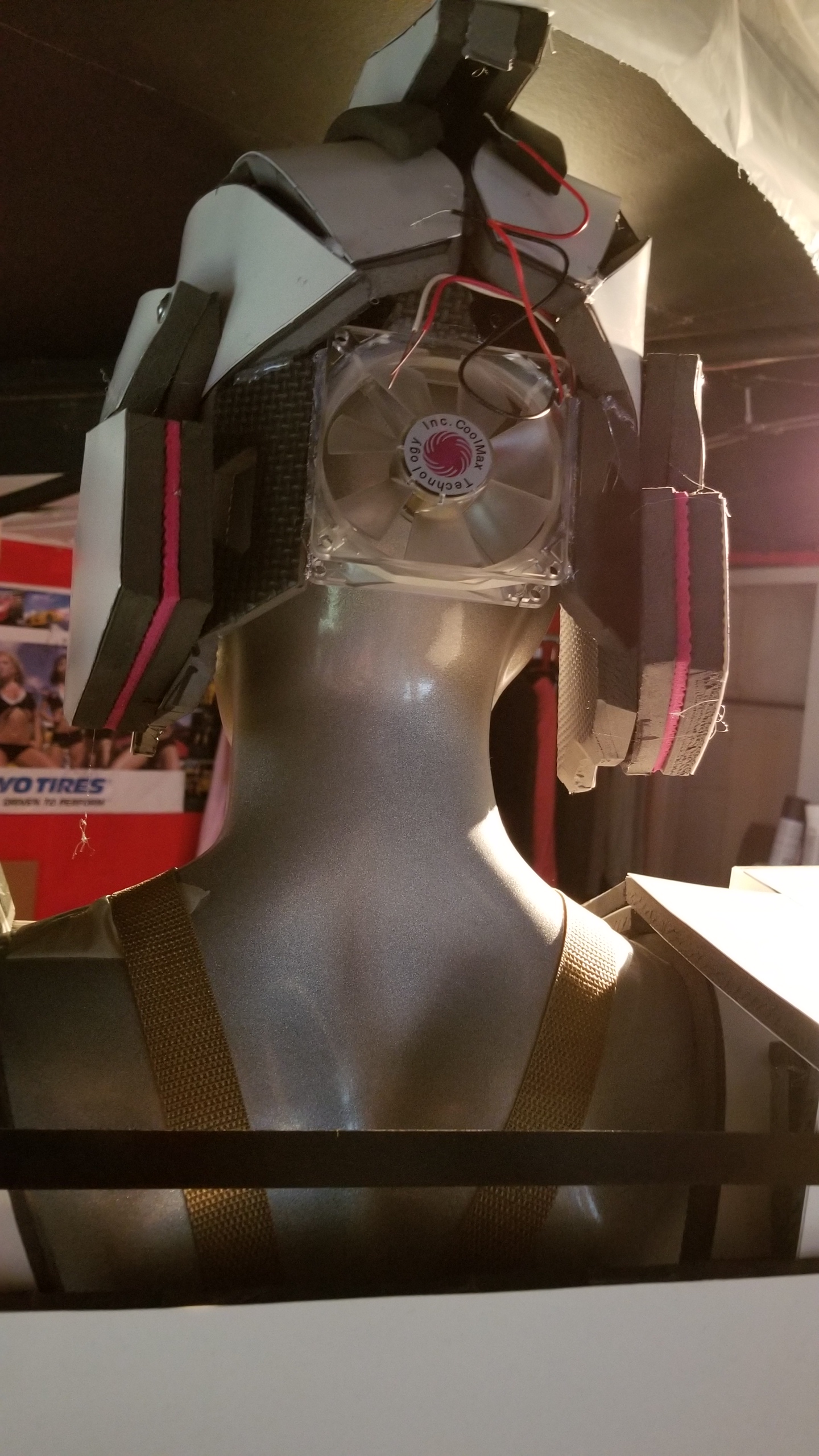

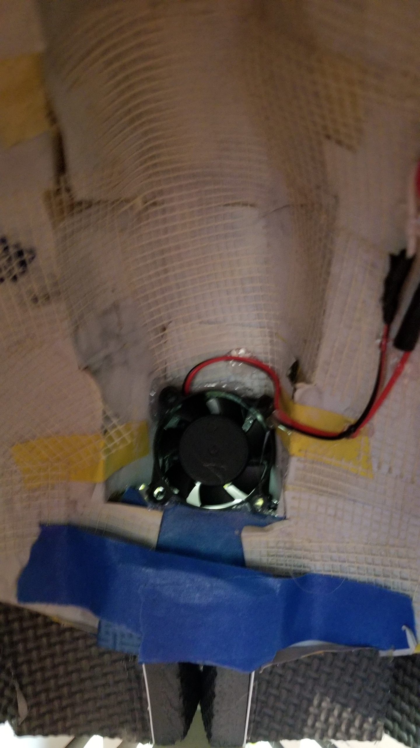

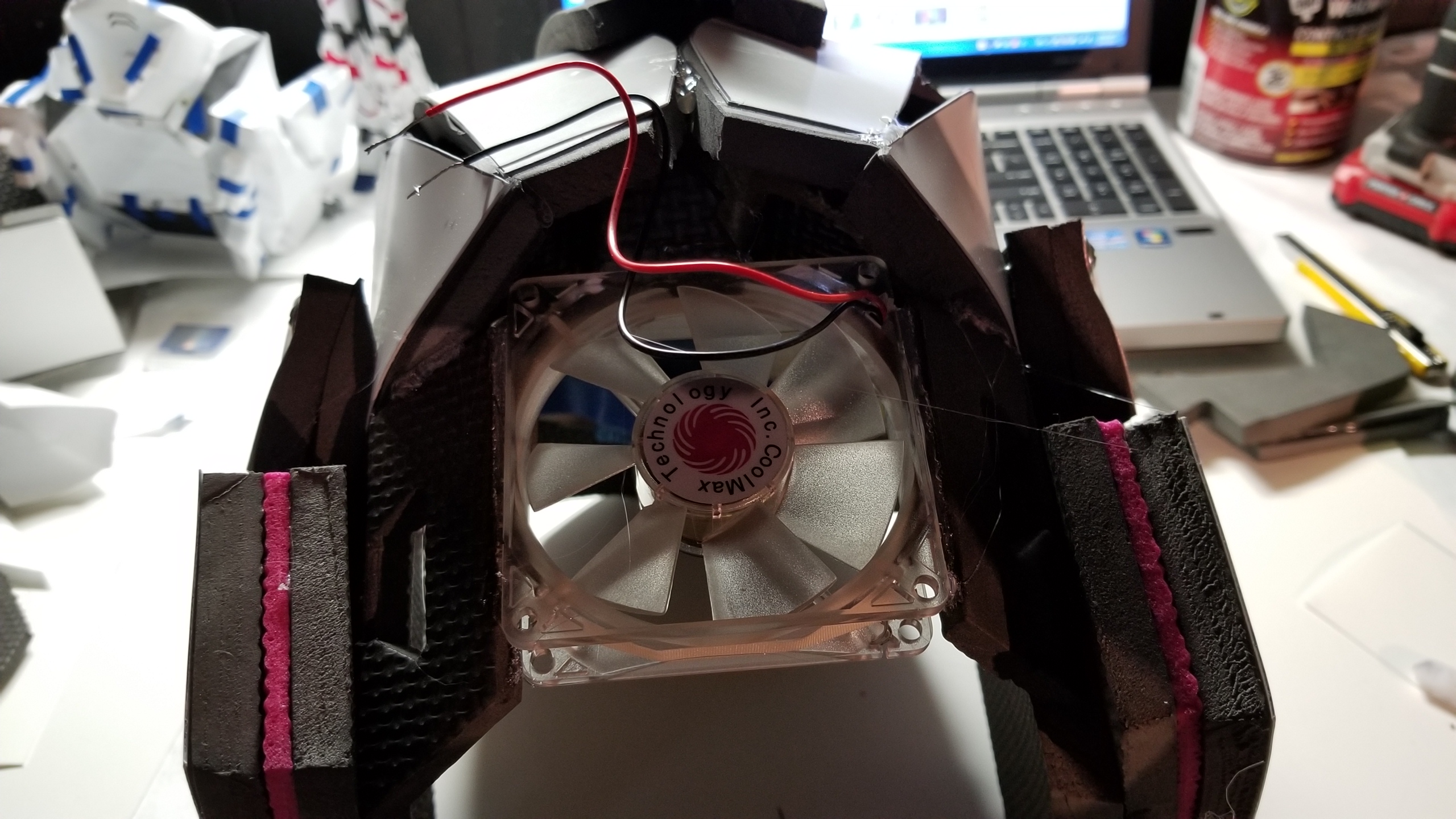

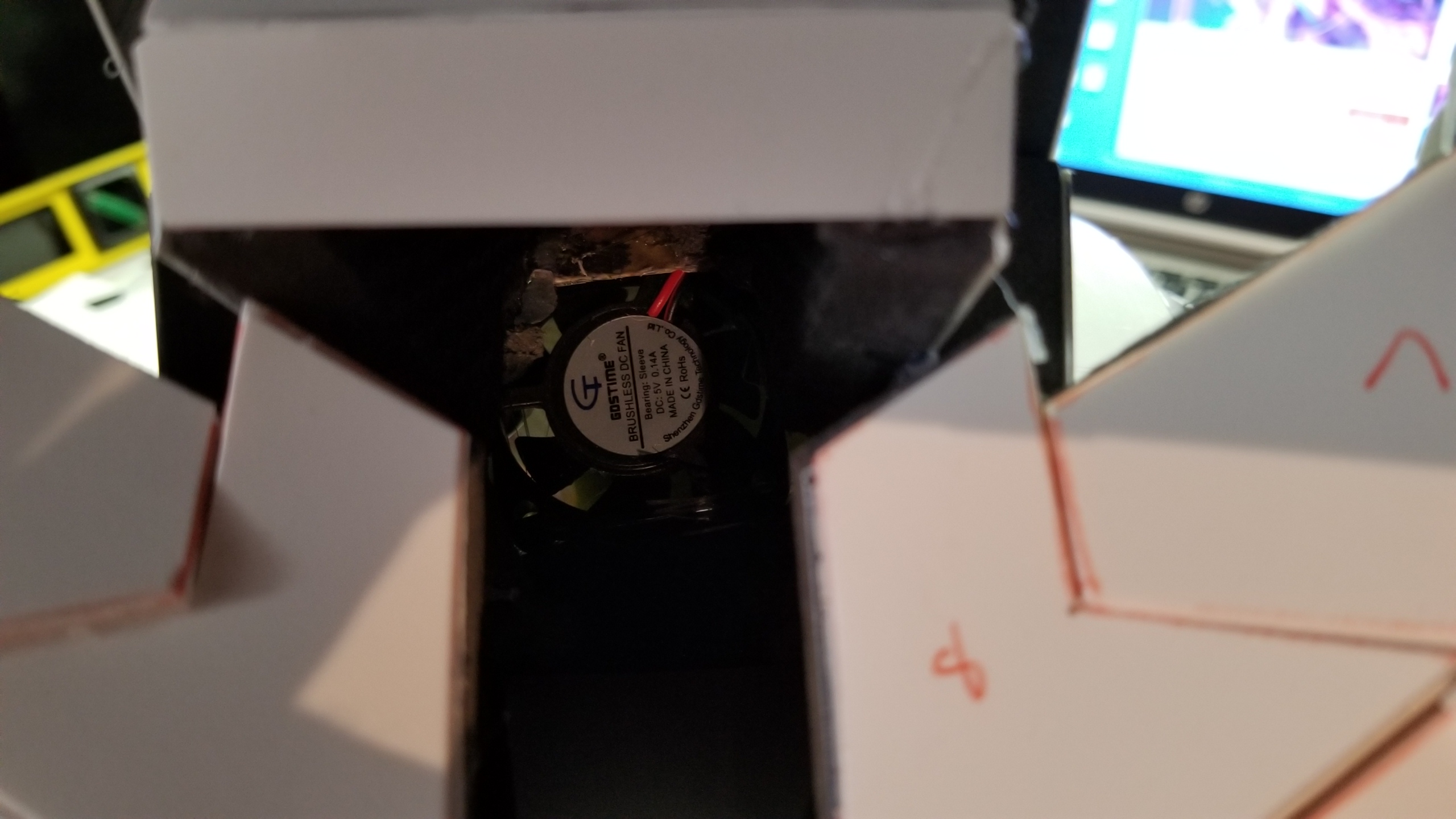

20171009_105448.jpg 20171009_111309.jpg prior to continuing helmet, cooling the head is a must, this super huge led fan should suffice.

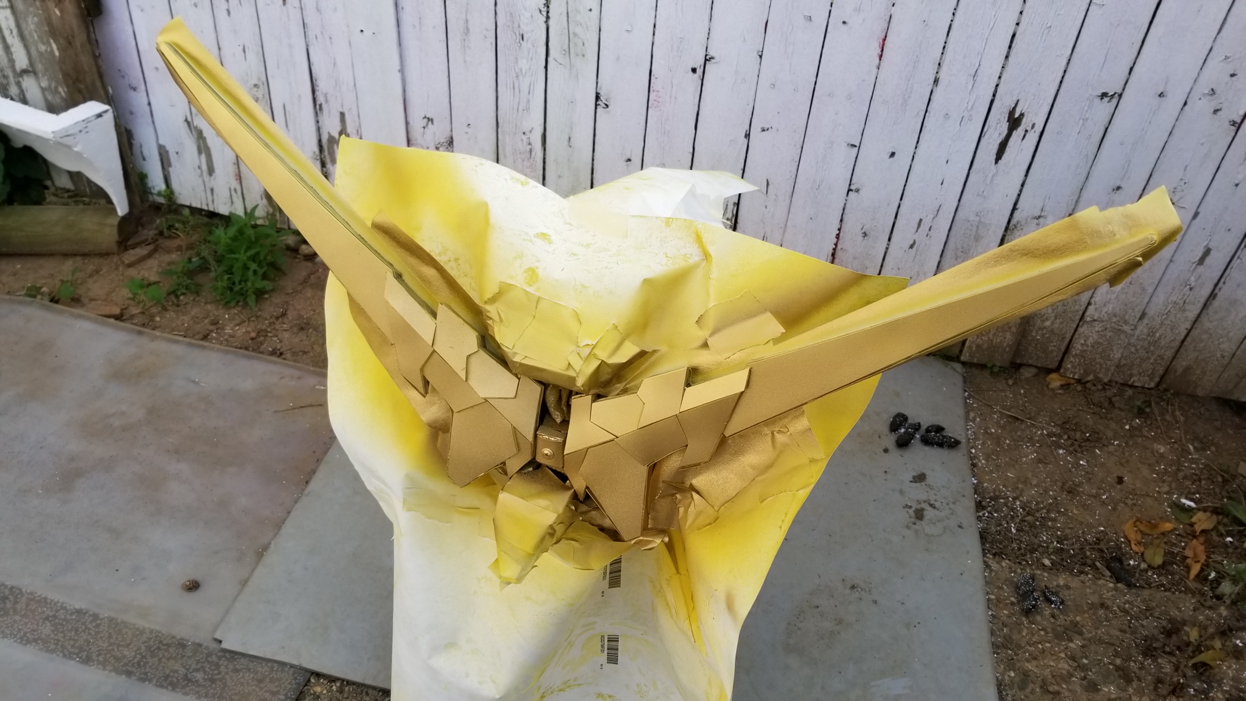

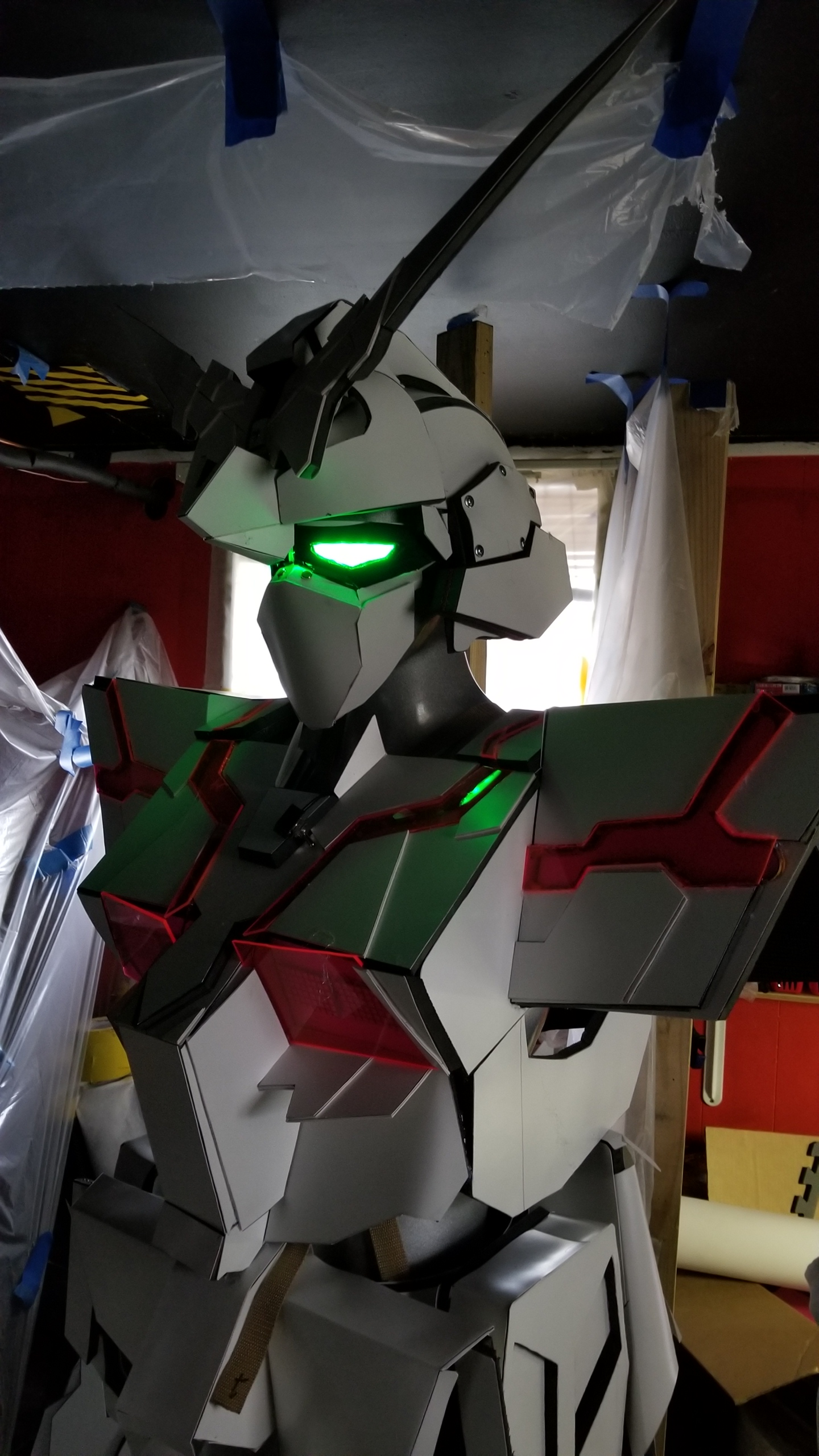

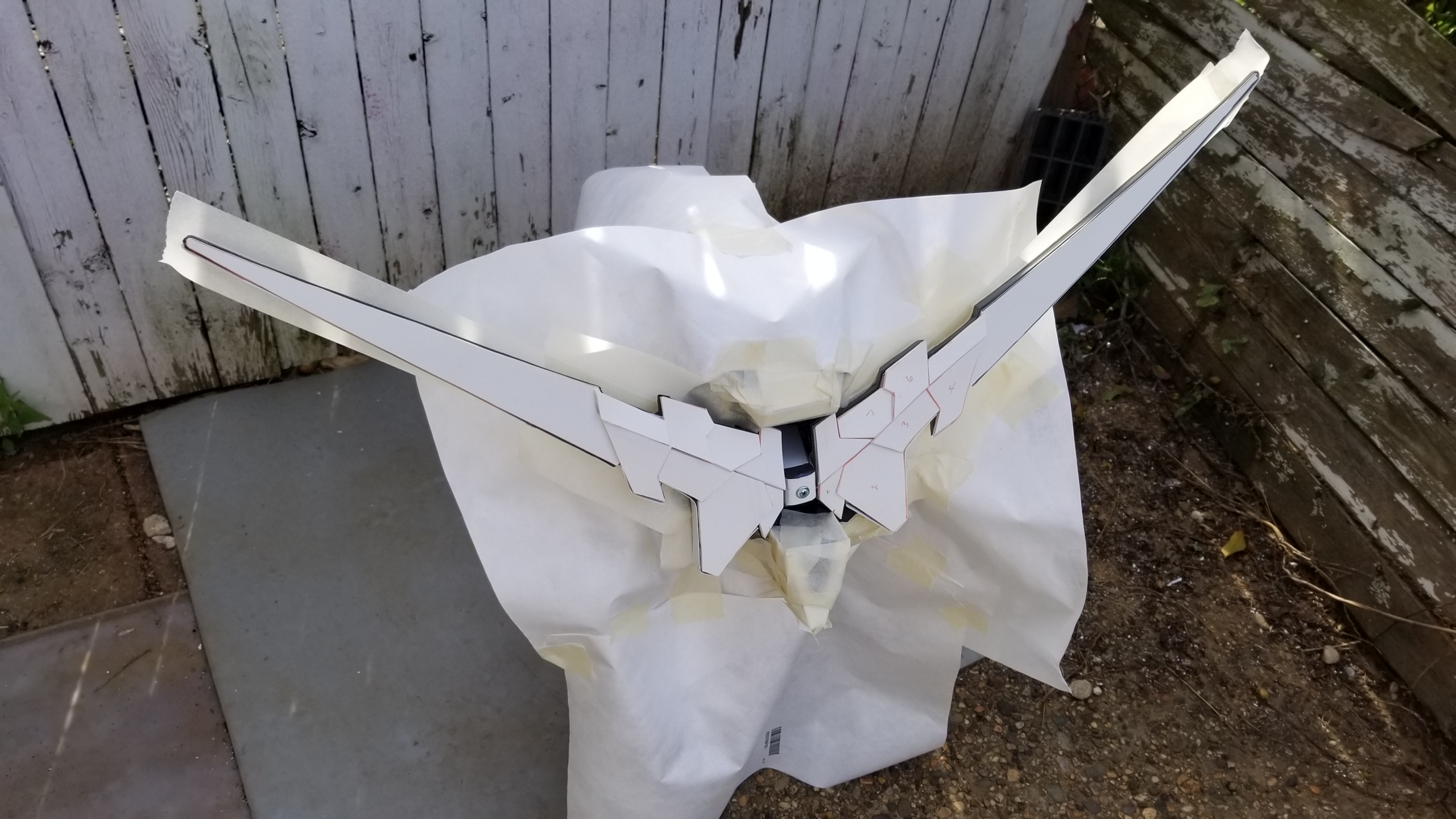

20171009_182058.jpg 20171009_201645.jpg 20171009_211726.jpg Unicorn horns, still debating if i should opt for gold plastic wrap or just gold spray paint.....
20171010_165715.jpg Horns attached
20171010_170321.jpg 20171010_170422.jpg Revisited the inner helmet, installed an exhaust fan to dissapate hot air.

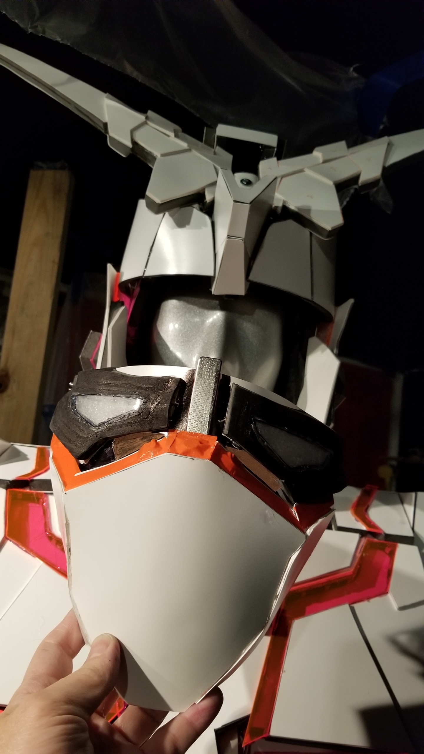

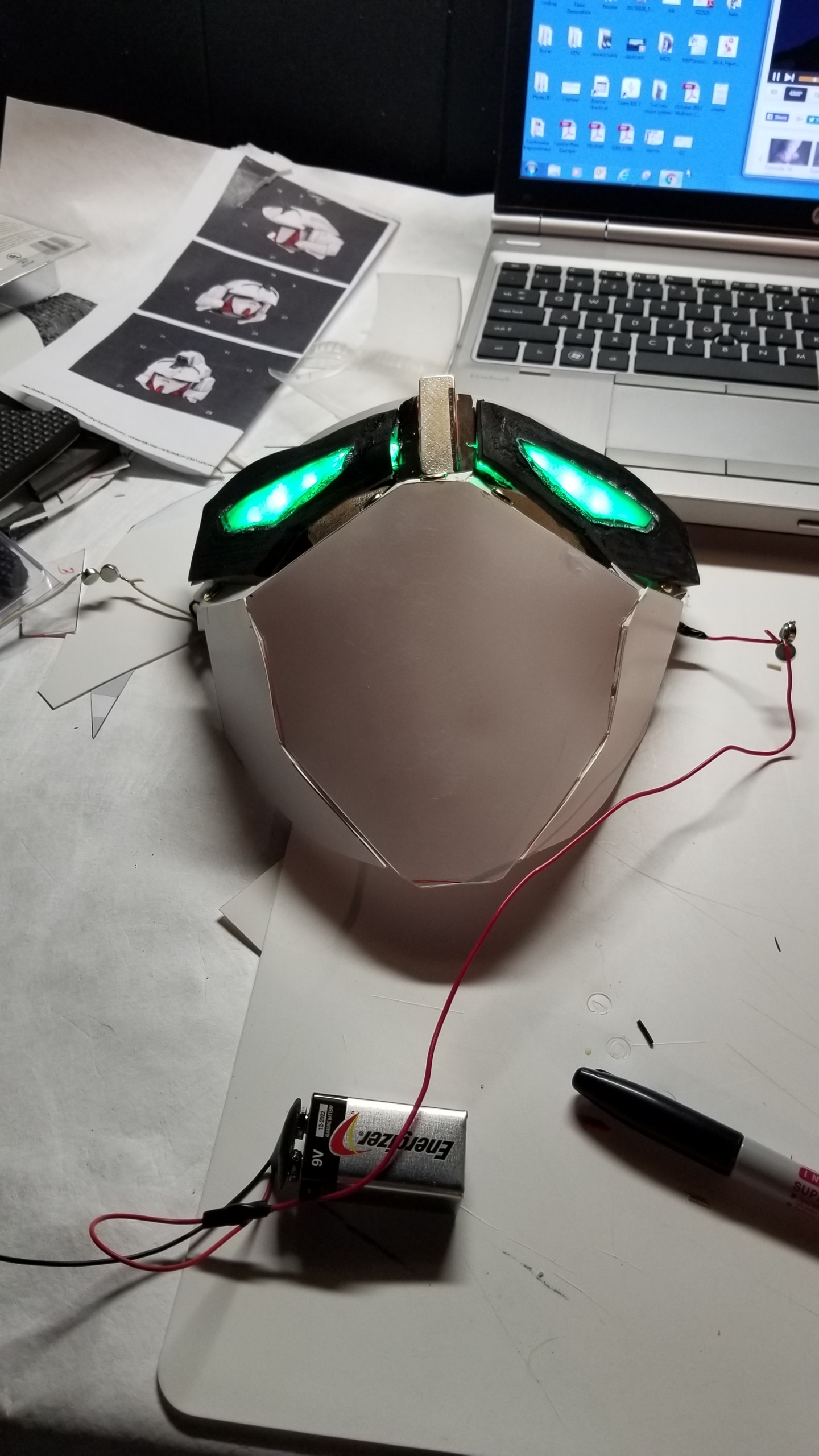

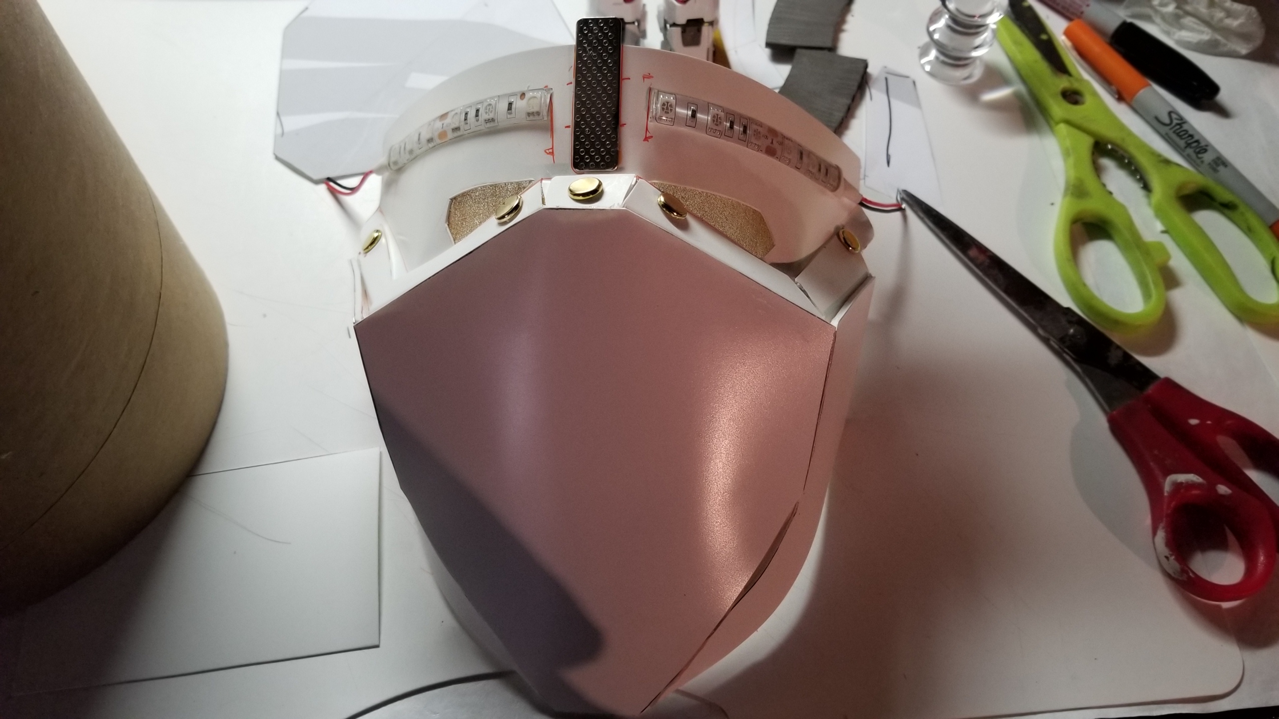

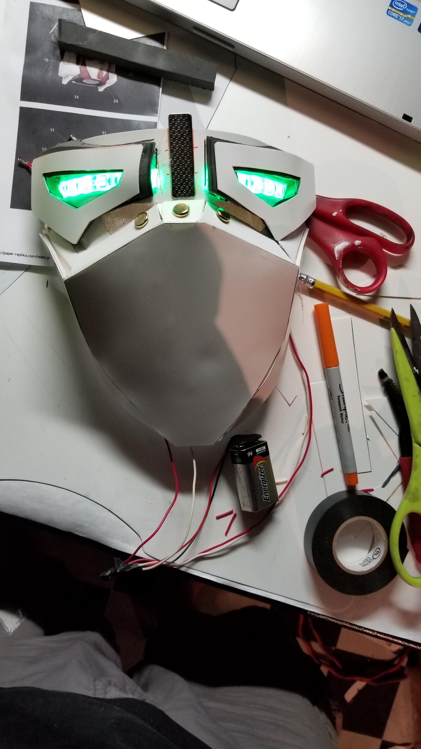

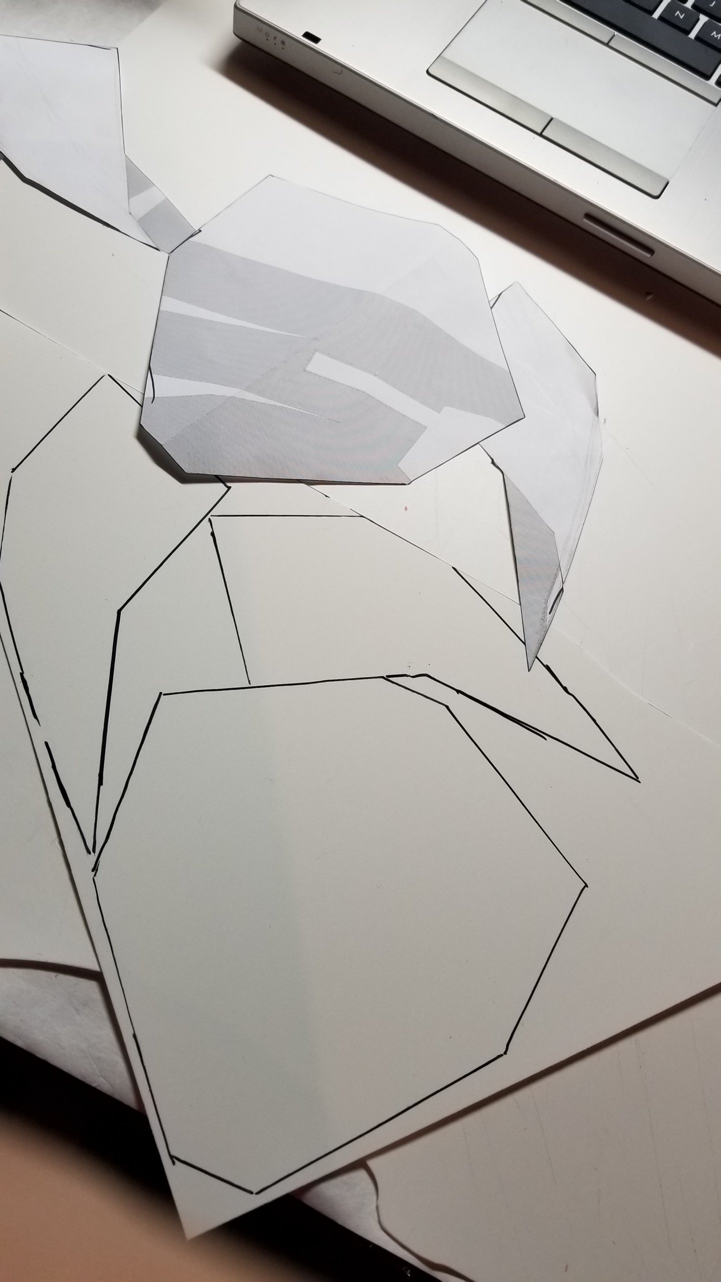

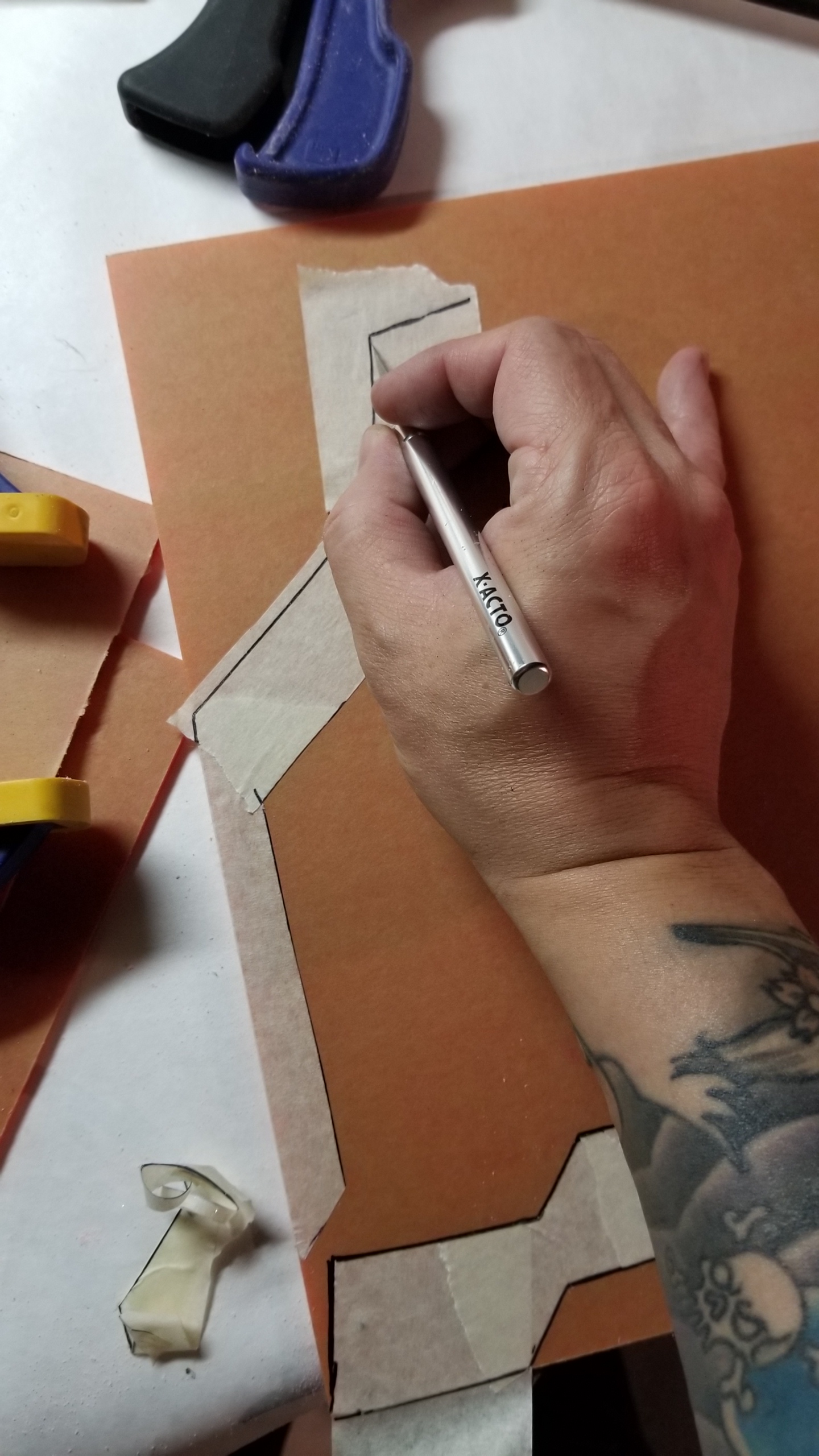

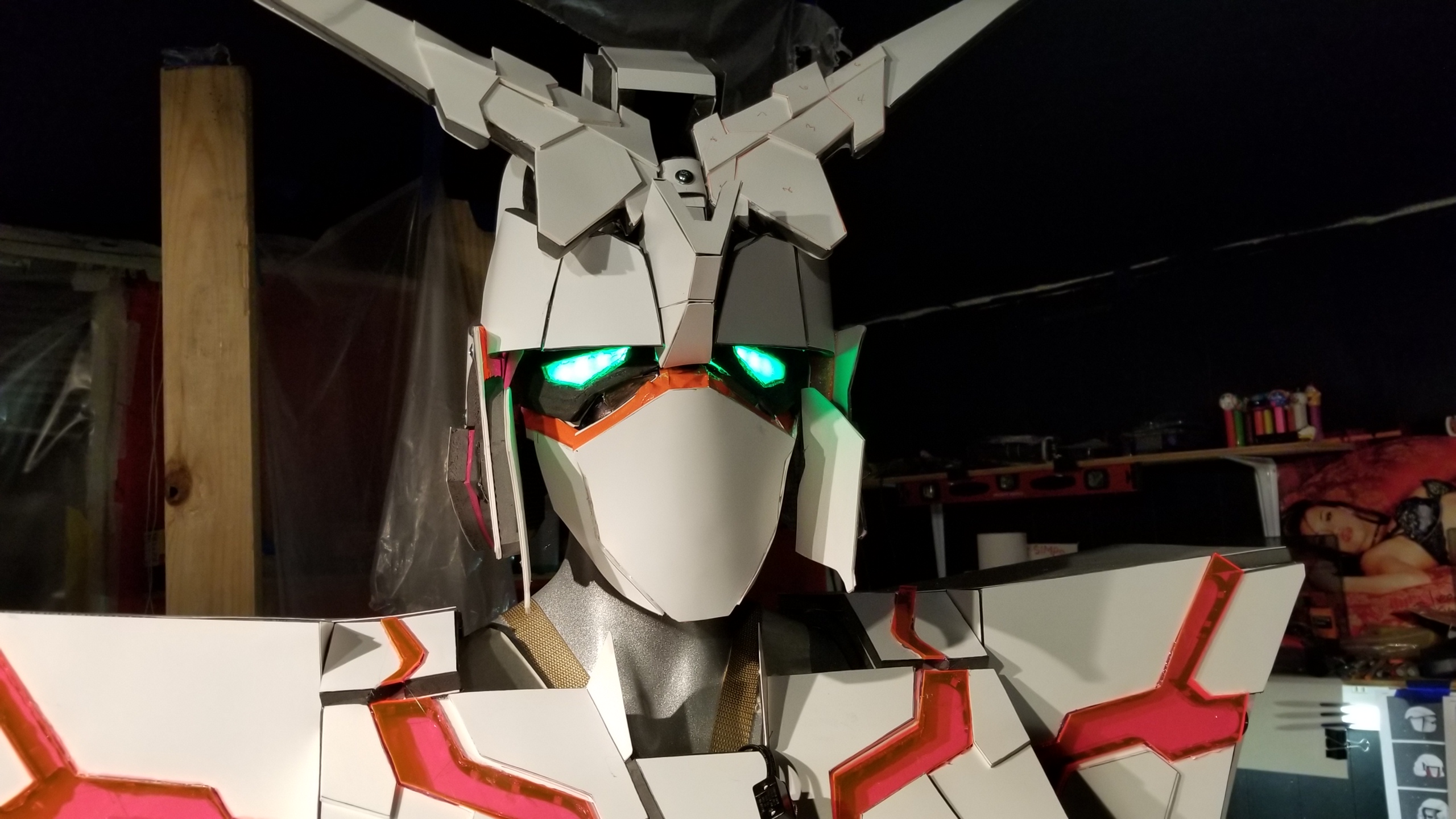

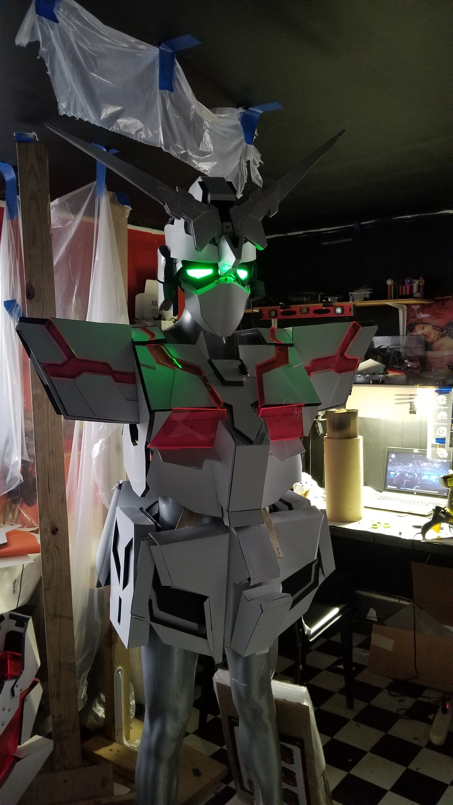

20171010_205010.jpg 20171010_210740.jpg 20171011_163914.jpg Free hand template front mouth shield, installed green OLED

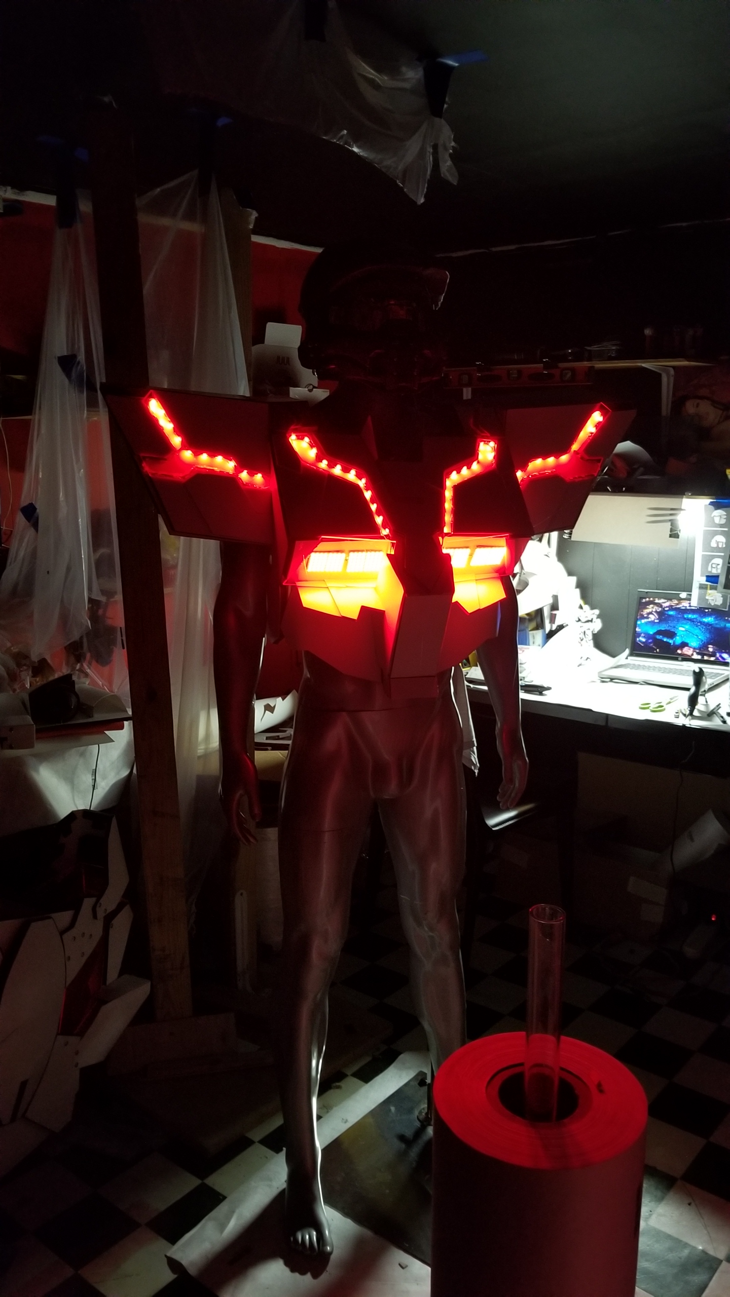

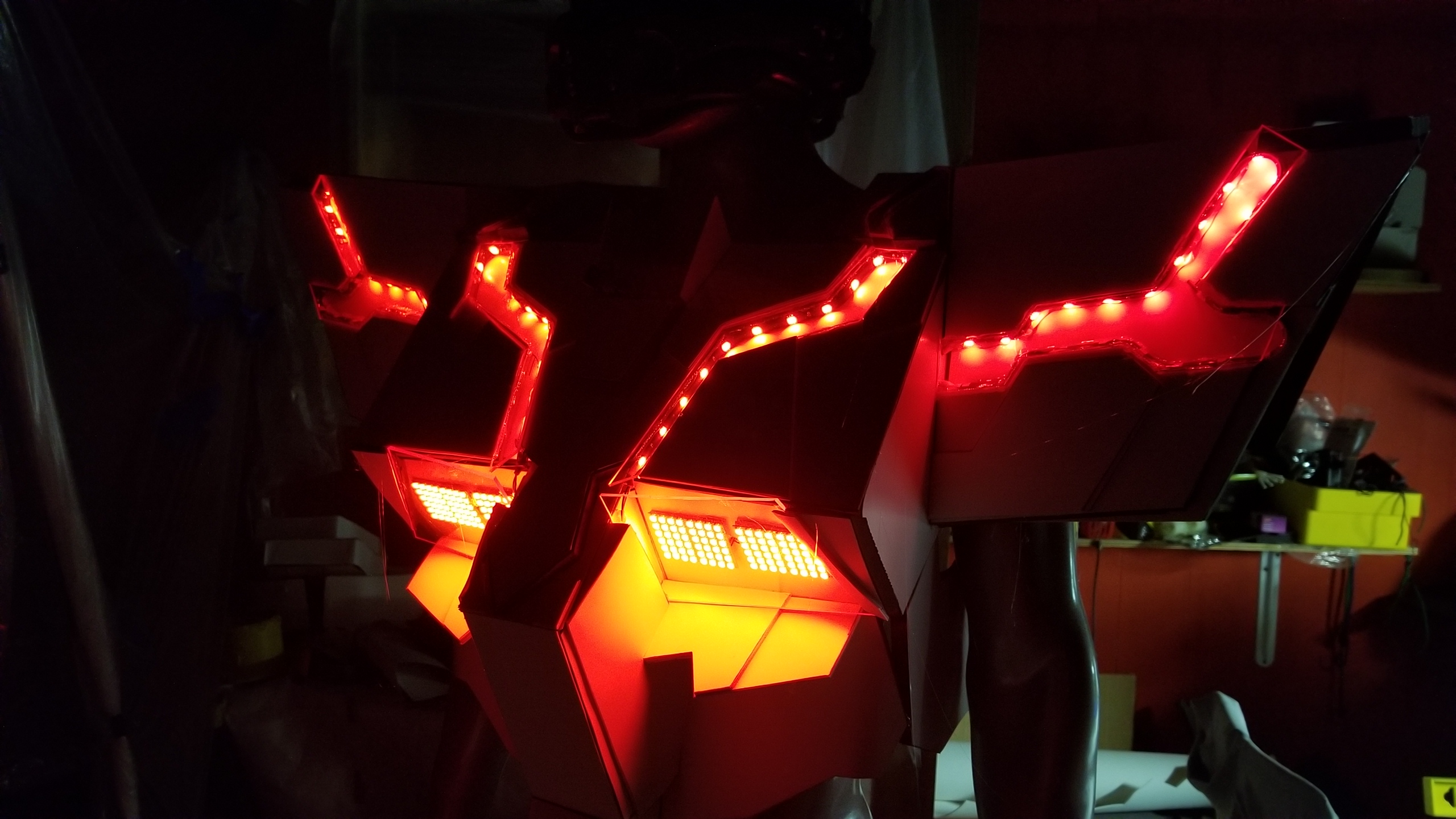

20171011_174307.jpg test light ups,

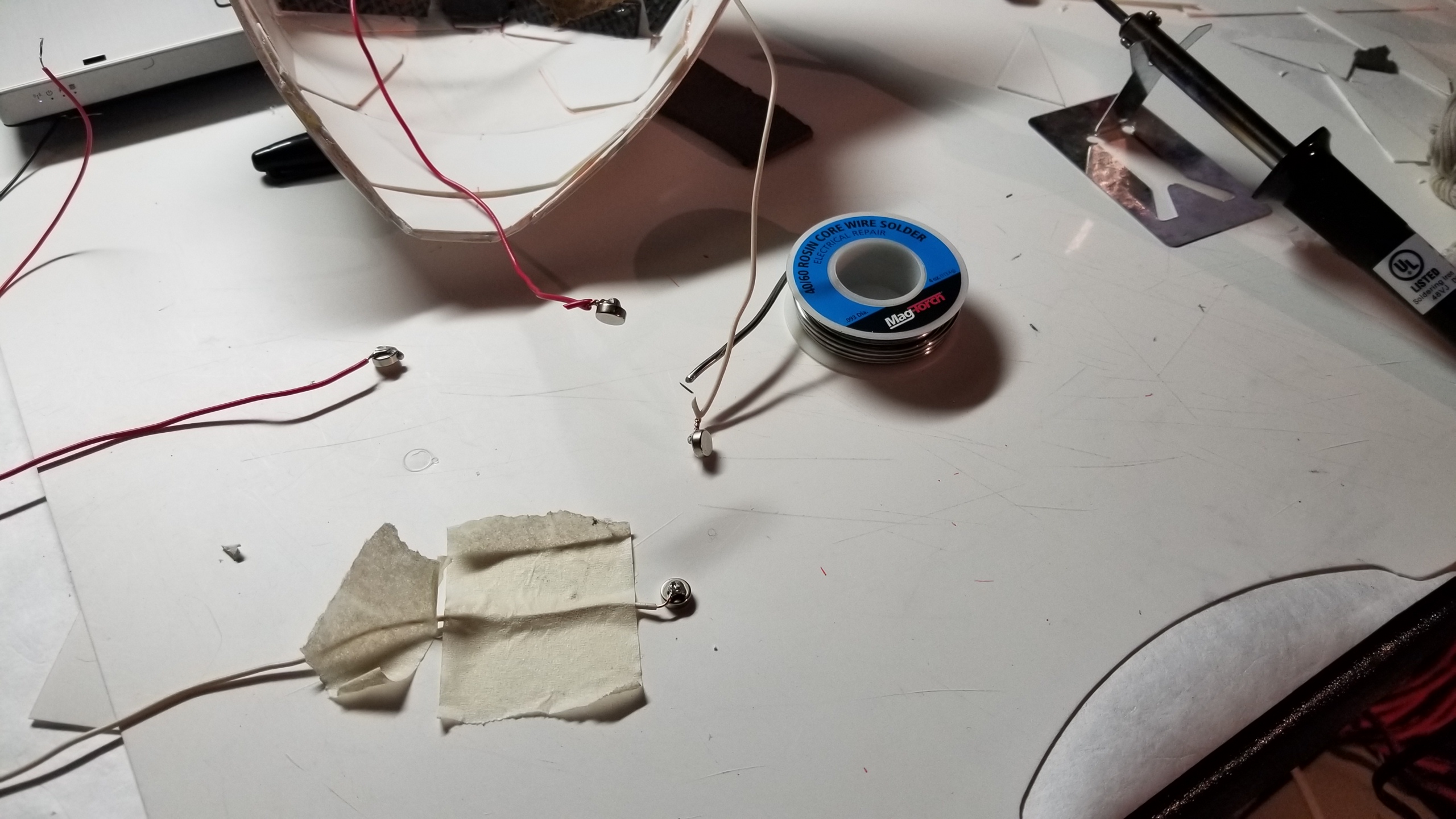

20171012_113335.jpg 20171012_131711.jpg20171012_141843.jpg Installed magnetic electrical connection
20171012_193541.jpg 20171012_152300.jpg 20171012_152319.jpg 20171012_193653.jpg
20171012_193823.jpg Additional light test

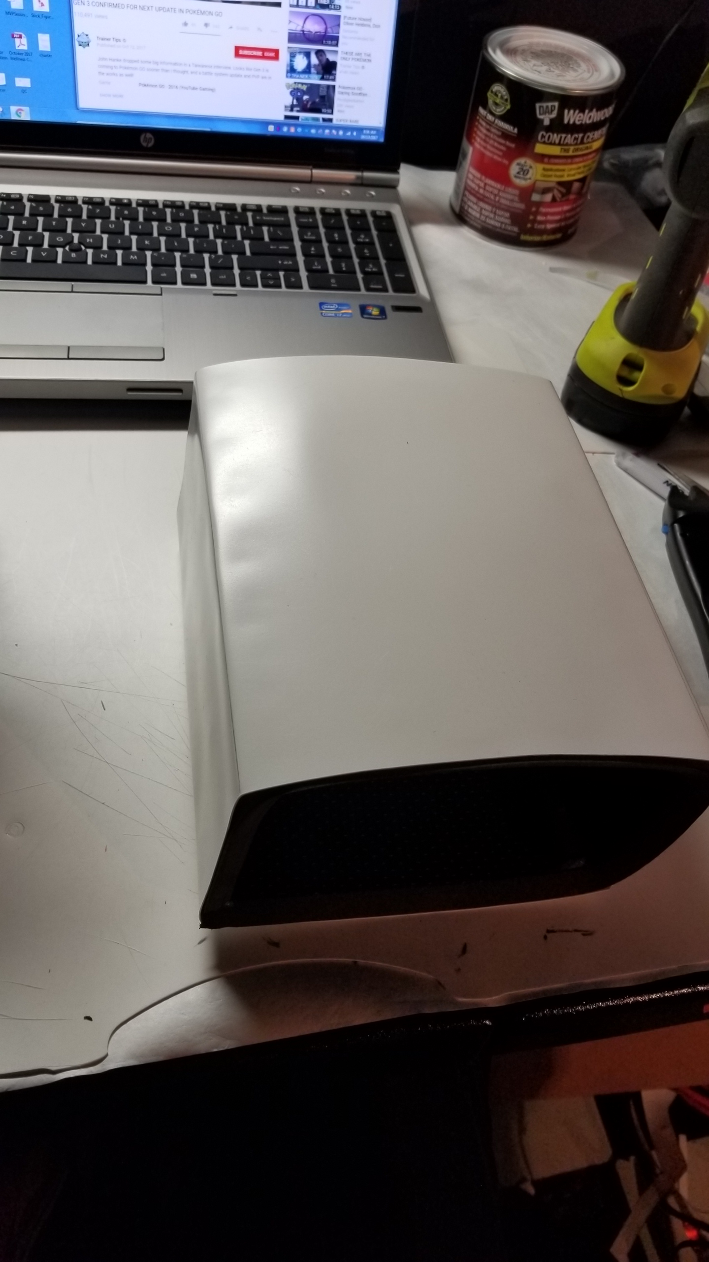

20171012_113327.jpg Almost forgot, picked up this bad boy for $10 @ homedepot, great for defusing led lights, tested on the green eyes with positive results, will installed onto the rest of red panels going forward.

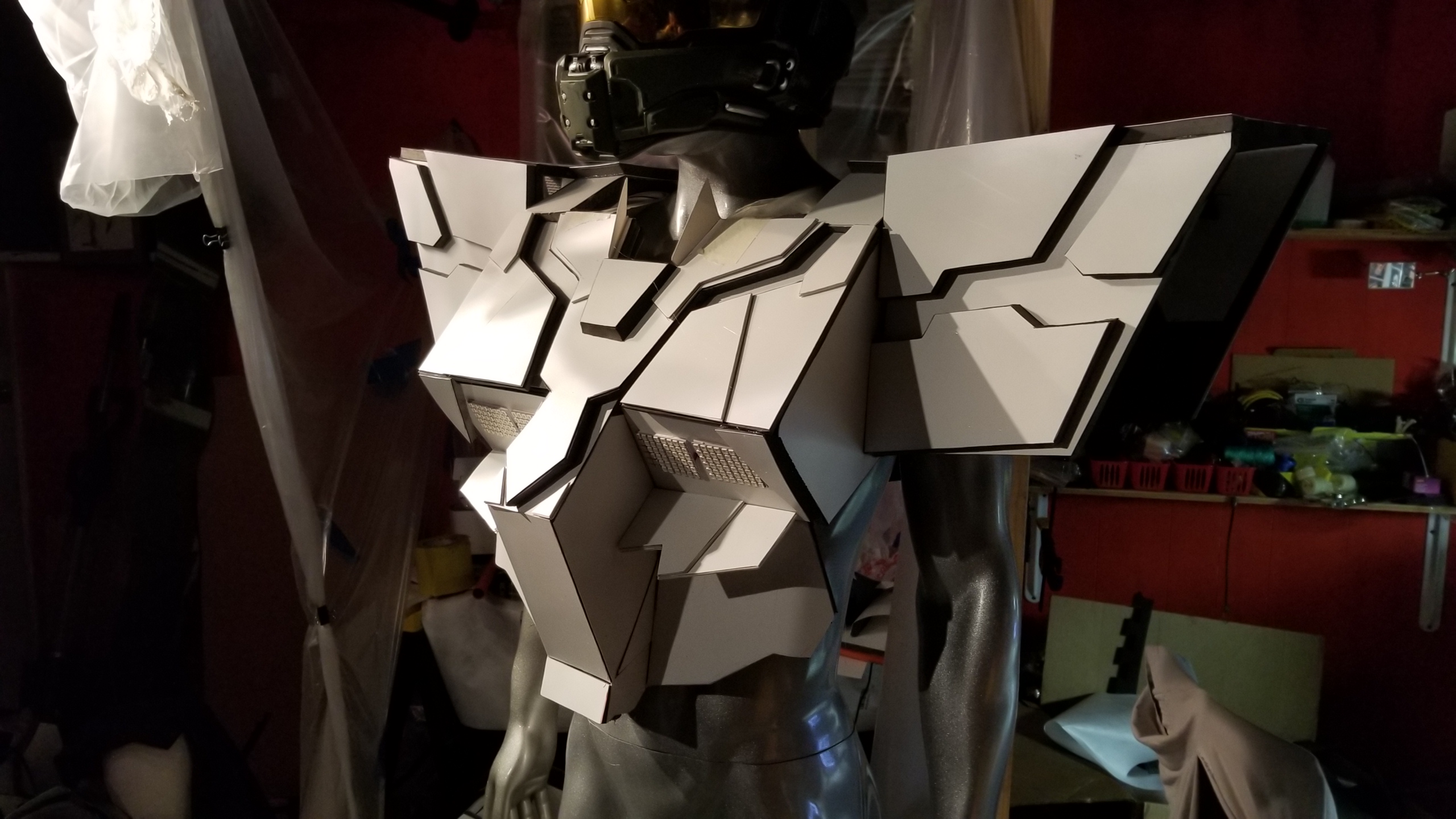

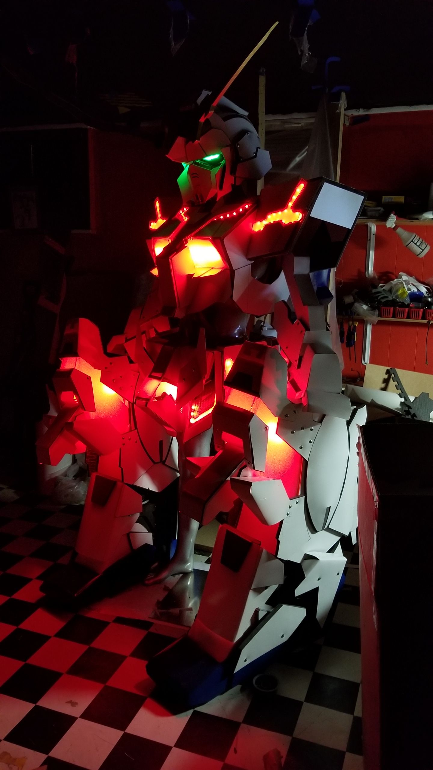

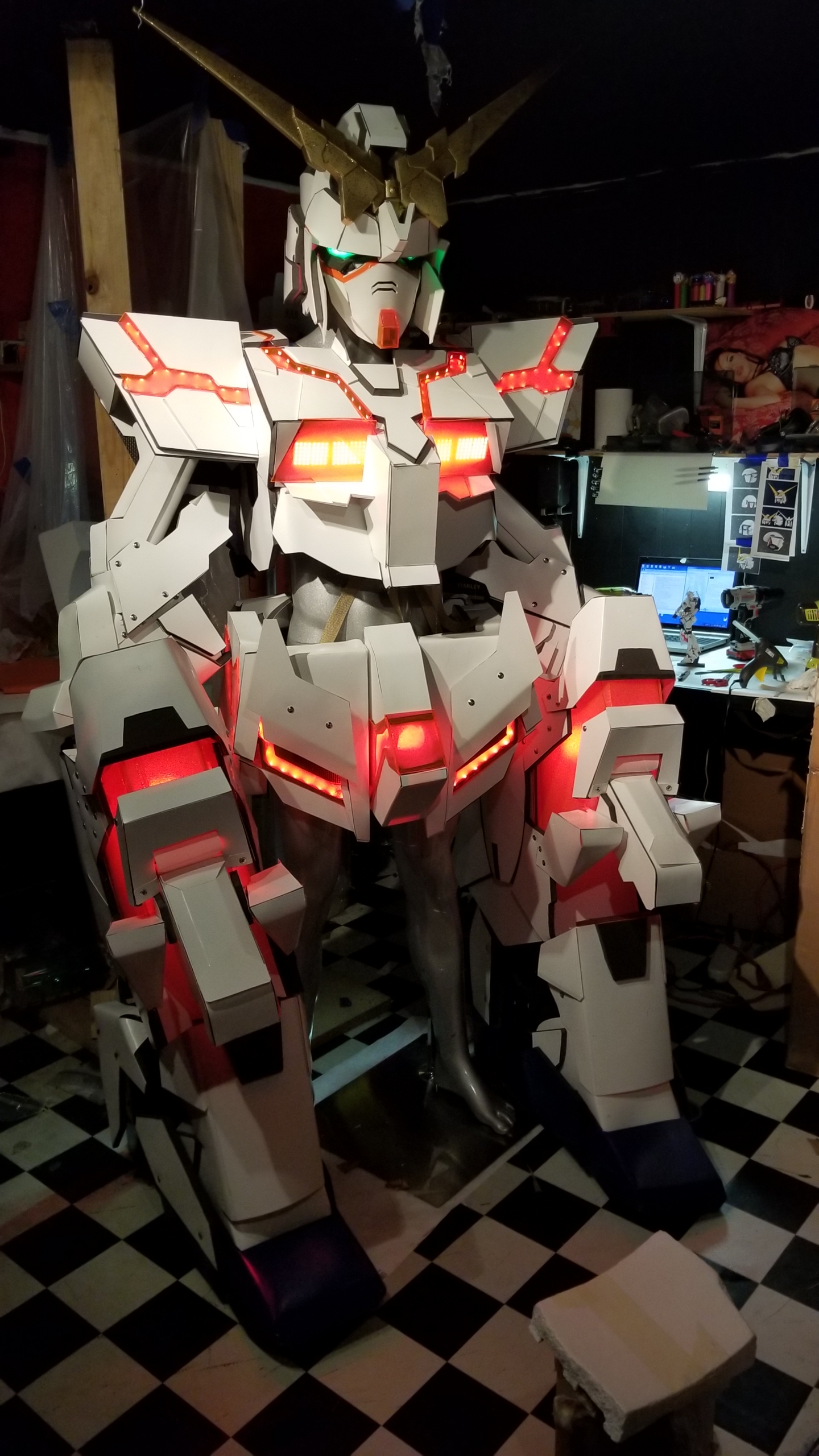

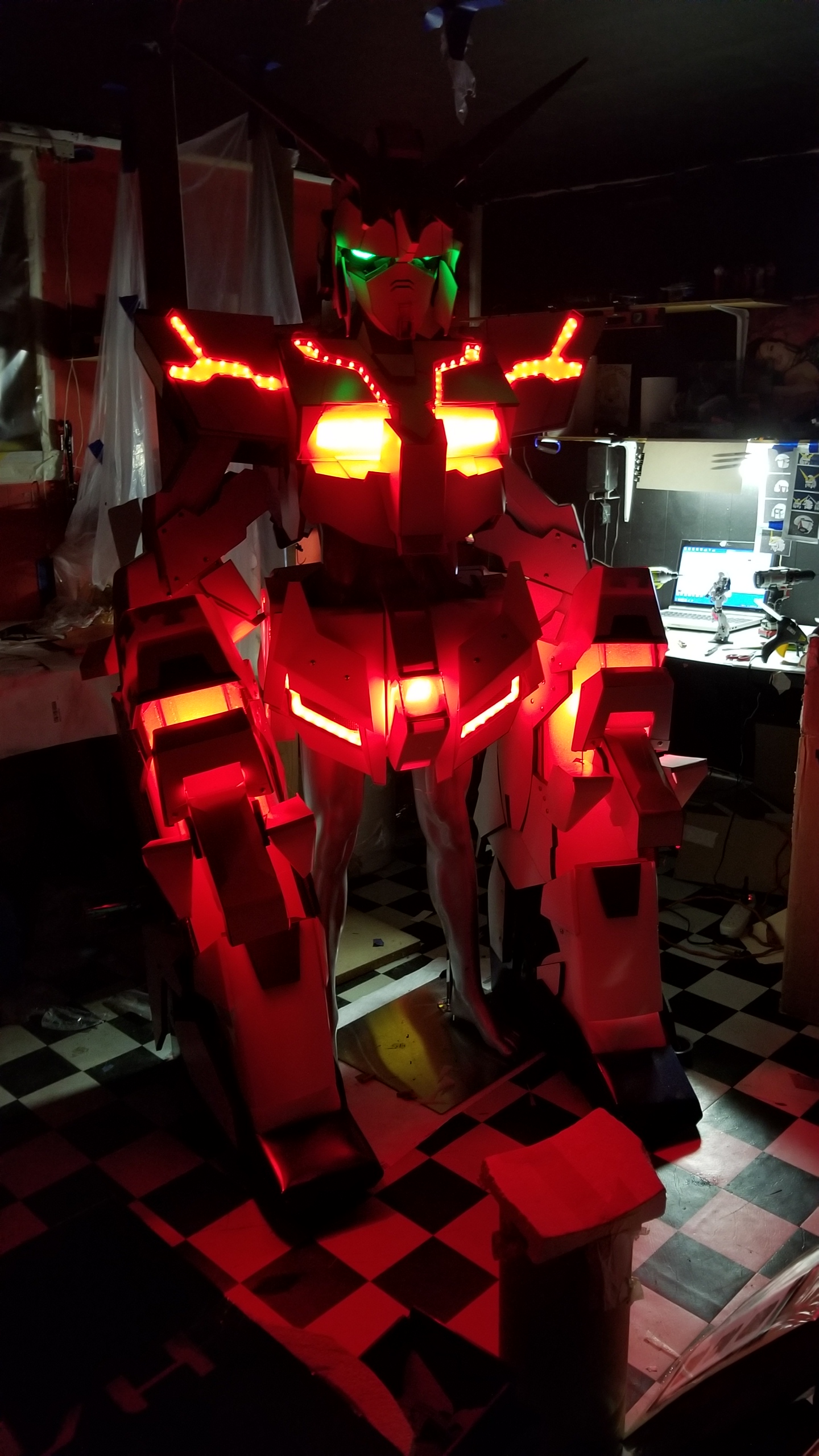

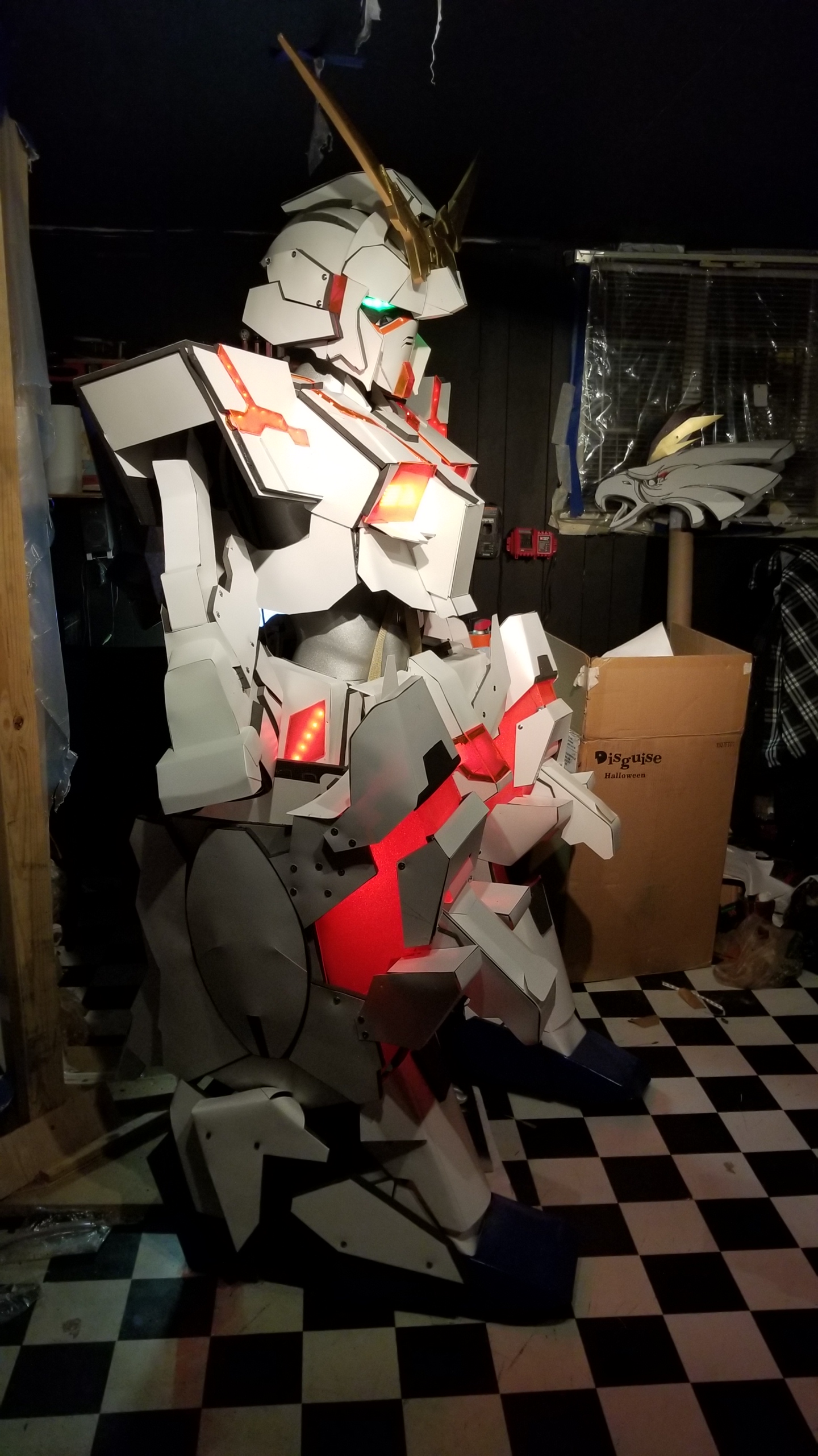

Here's the rest of the somewhat finished build, enjoy

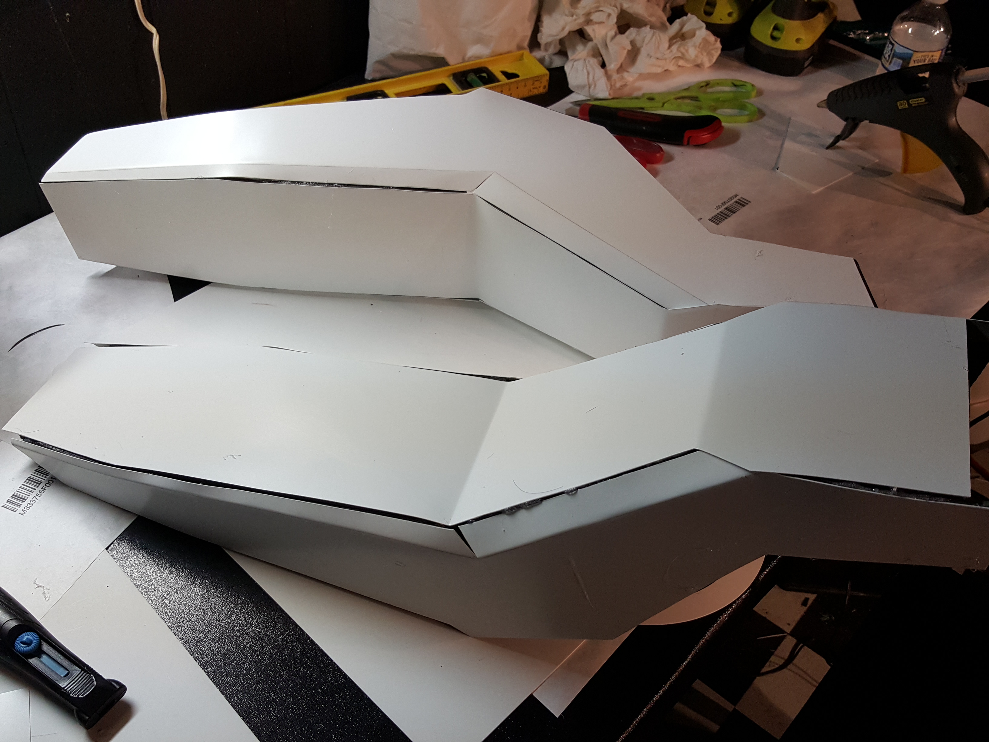

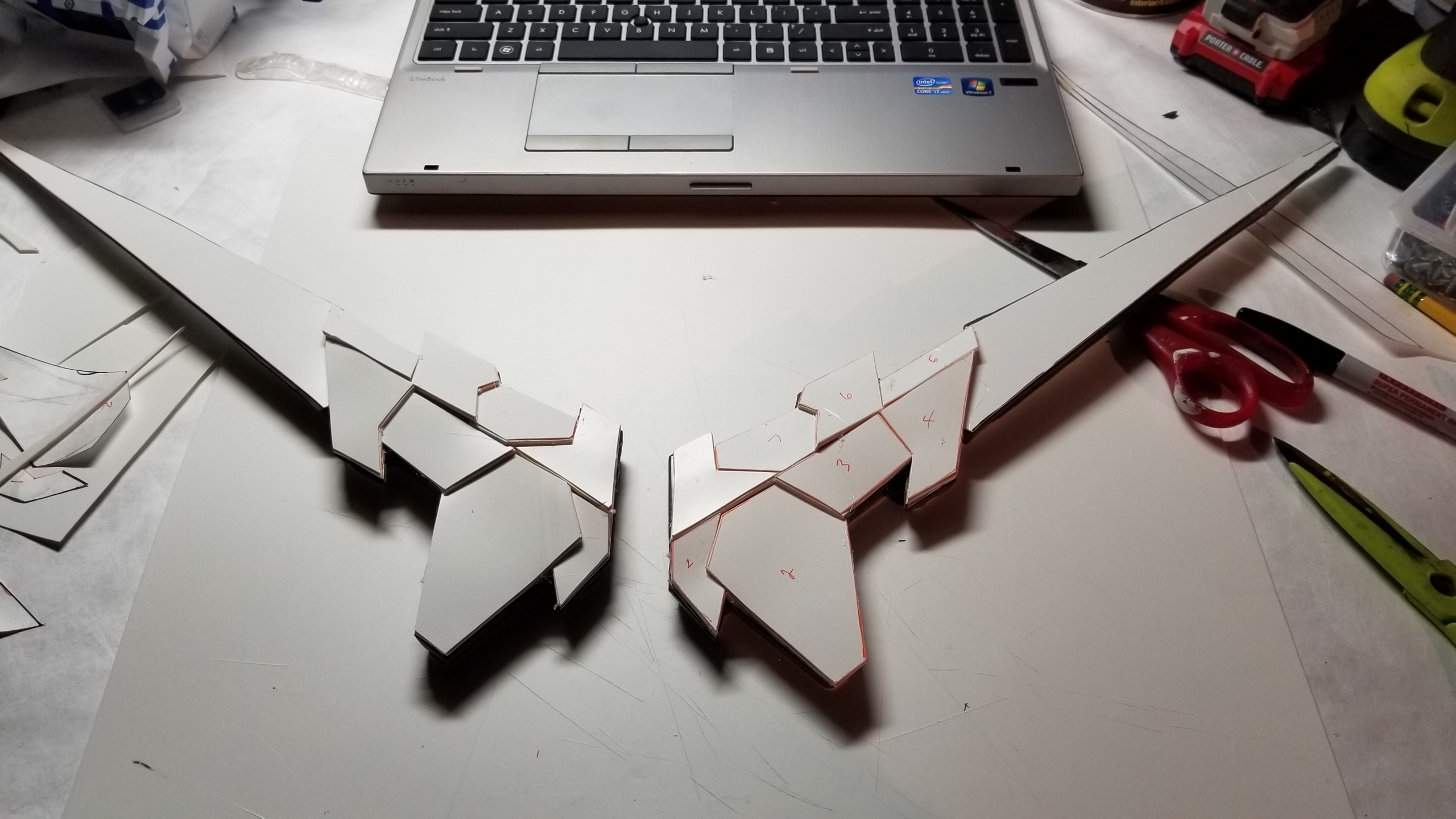

20171013_162608.jpg 20171013_095010.jpg 20171013_162625.jpg 20171013_200748.jpg 20171016_210623.jpg Forearm section

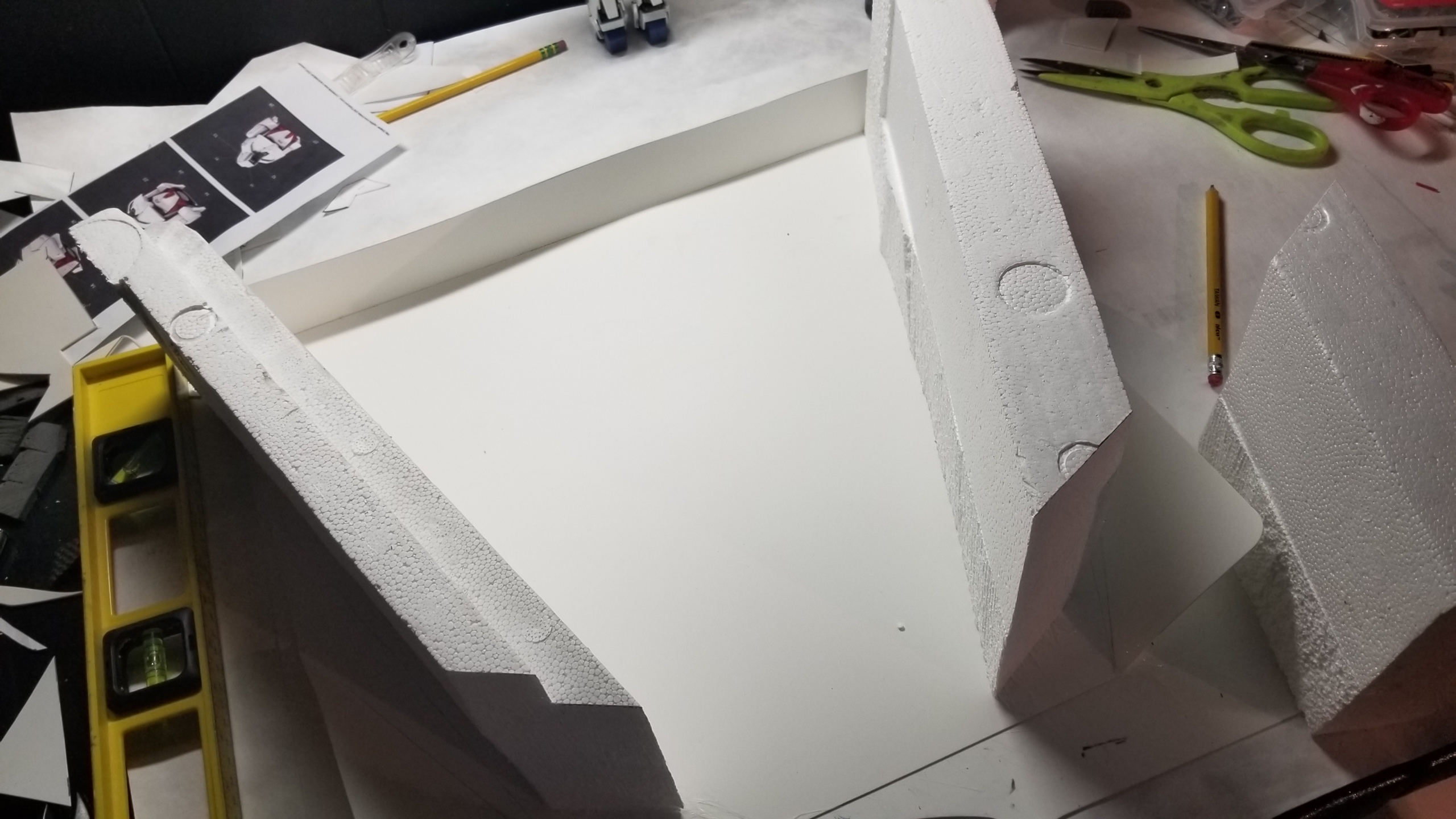

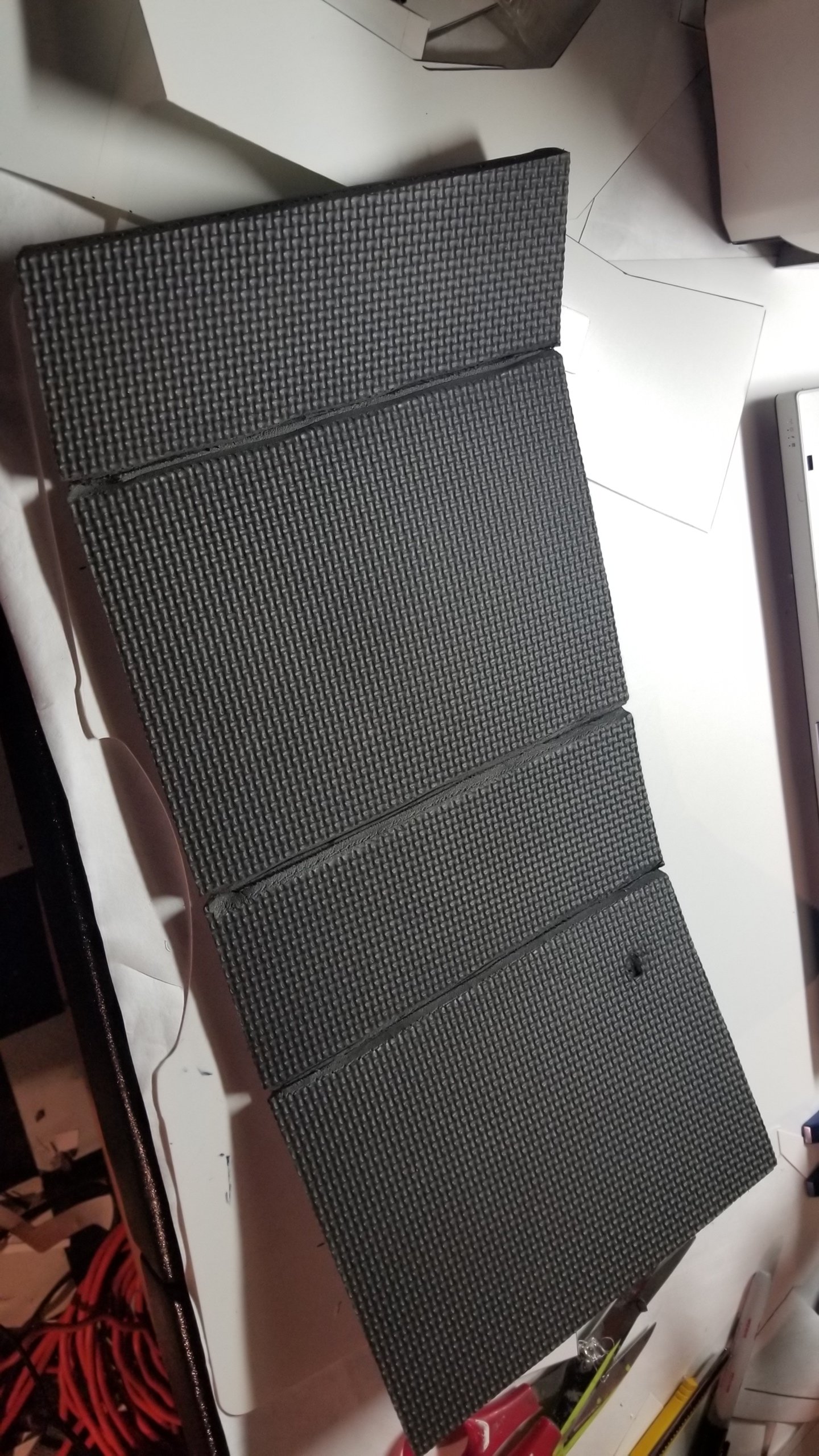

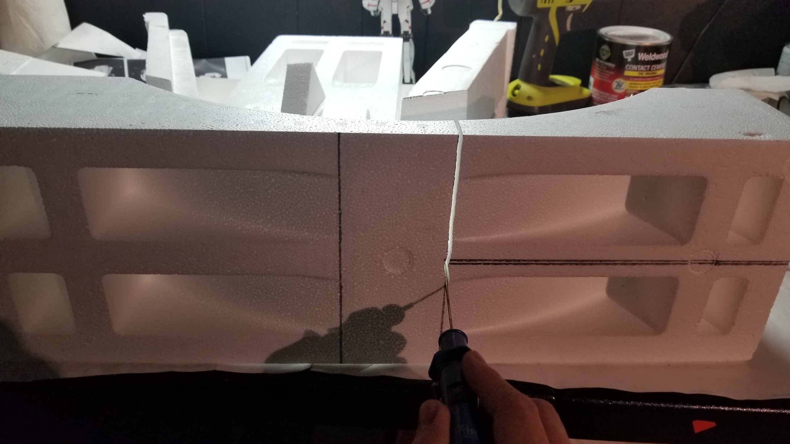

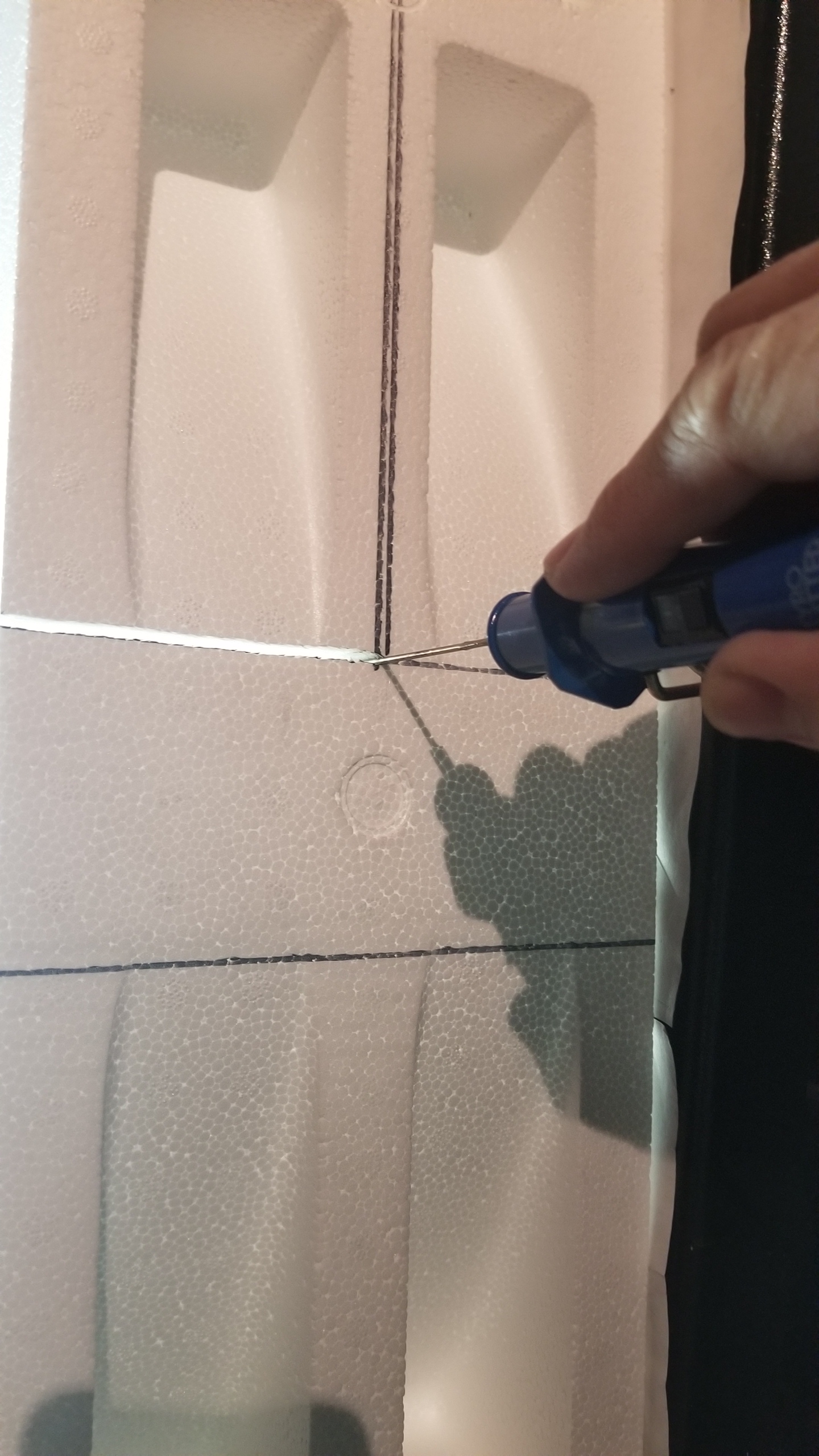

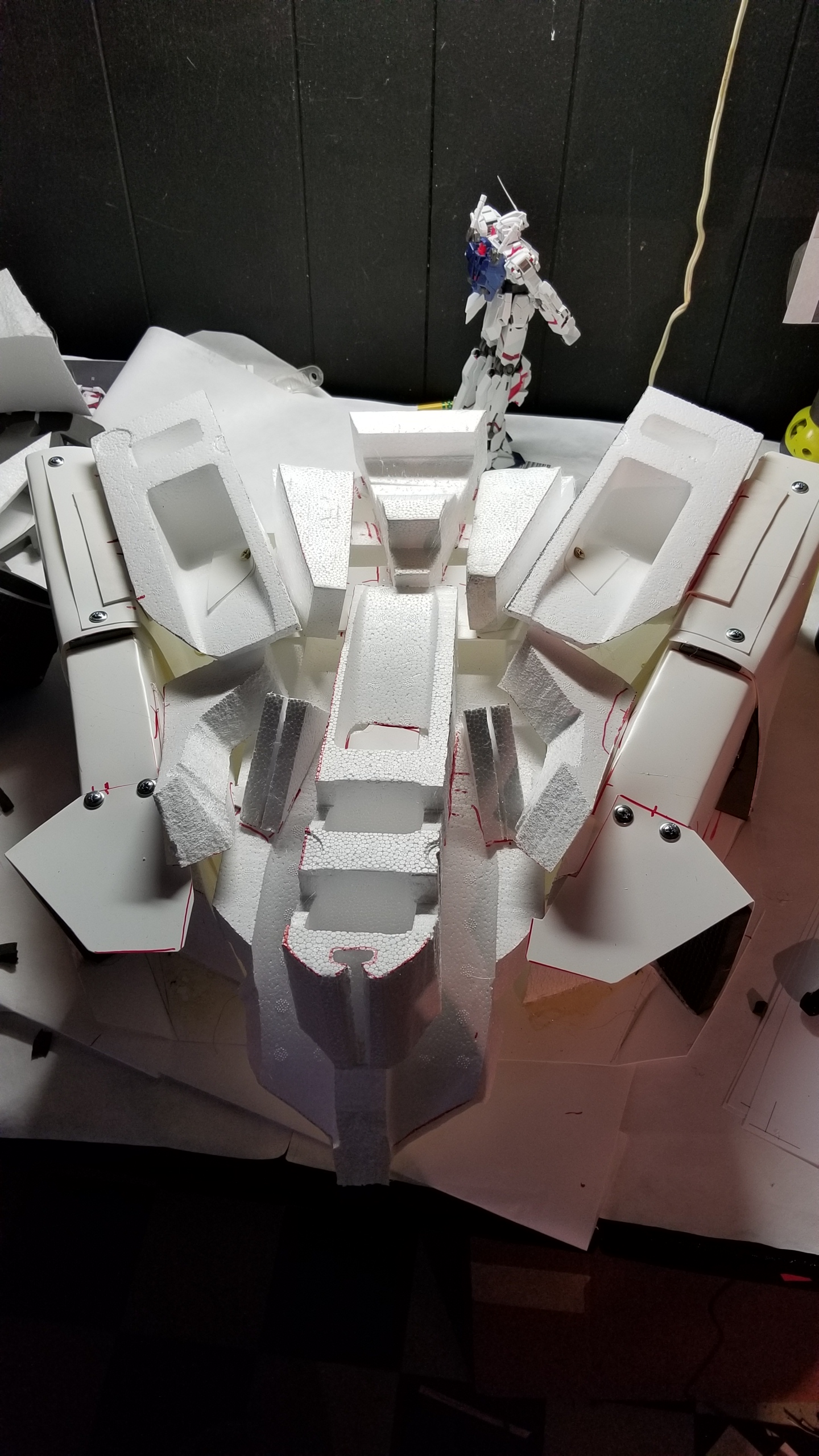

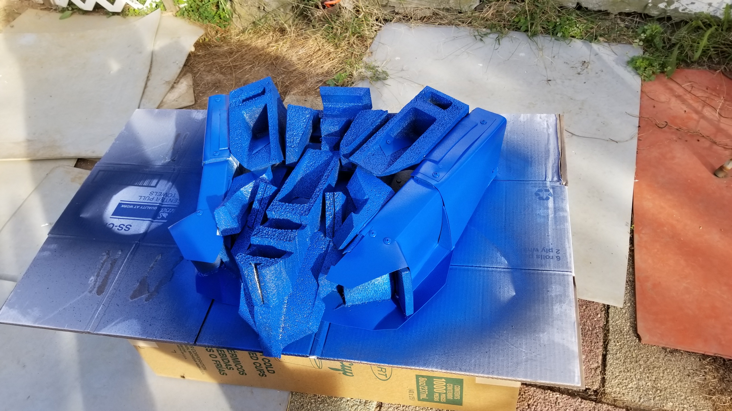

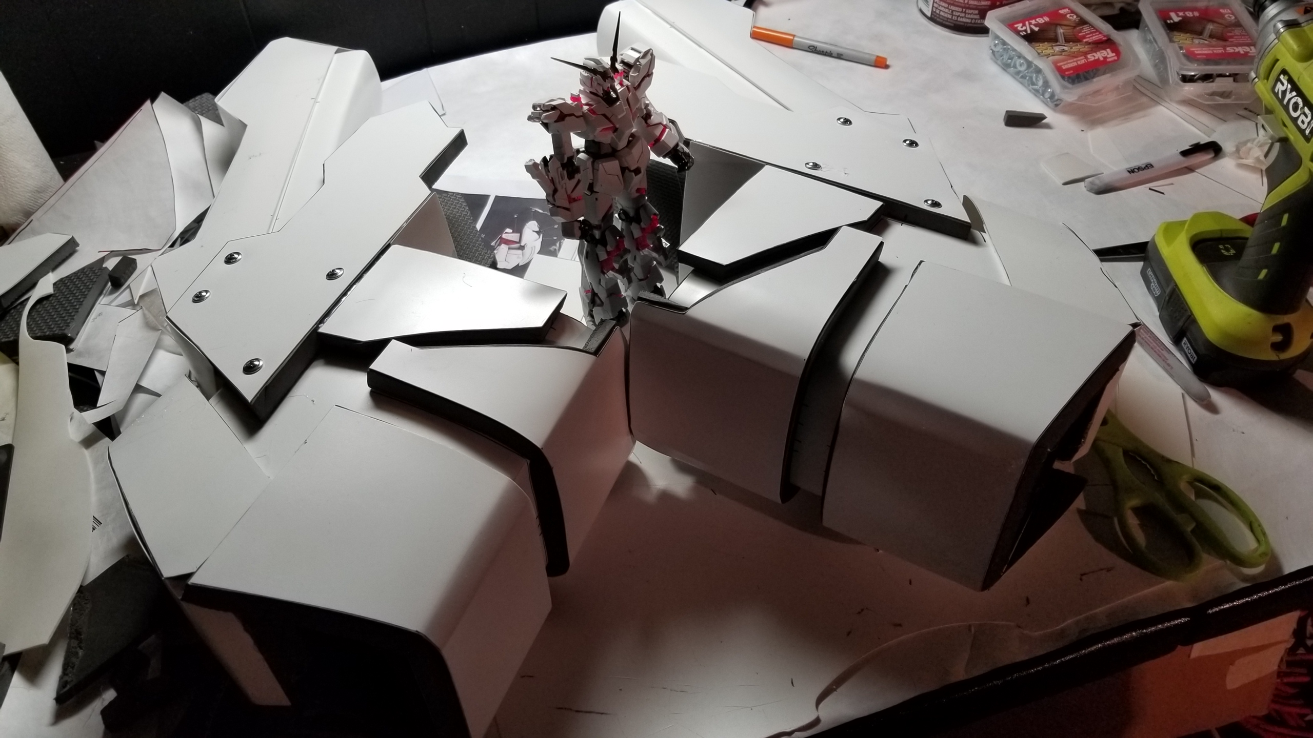

20171018_201021.jpg 20171018_201030.jpg 20171018_194727.jpg 20171021_120451.jpg 20171021_120457.jpg Recycle old foam that was laying around the house, with the help of styro cutter tool, shaping it was a breeze.

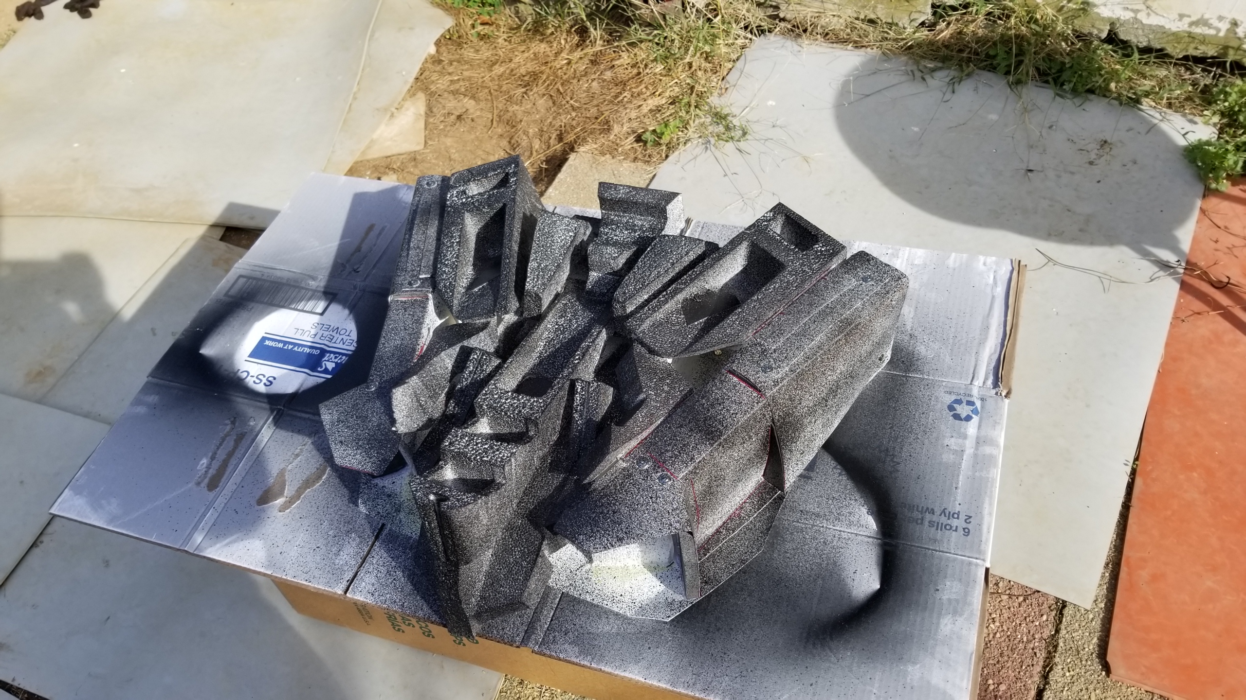

20171021_142859.jpg 20171021_160518.jpg Plasti and Paint

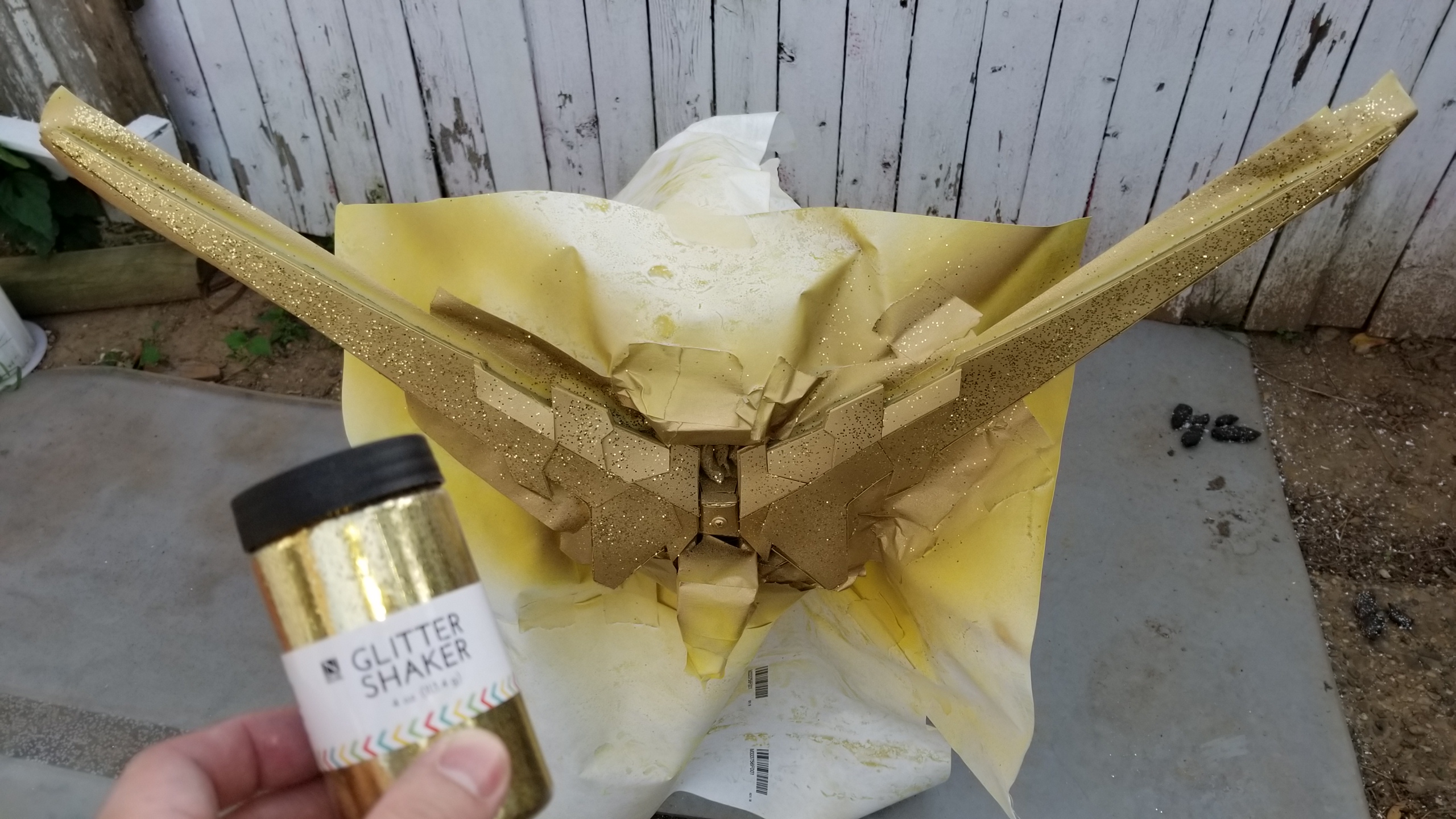

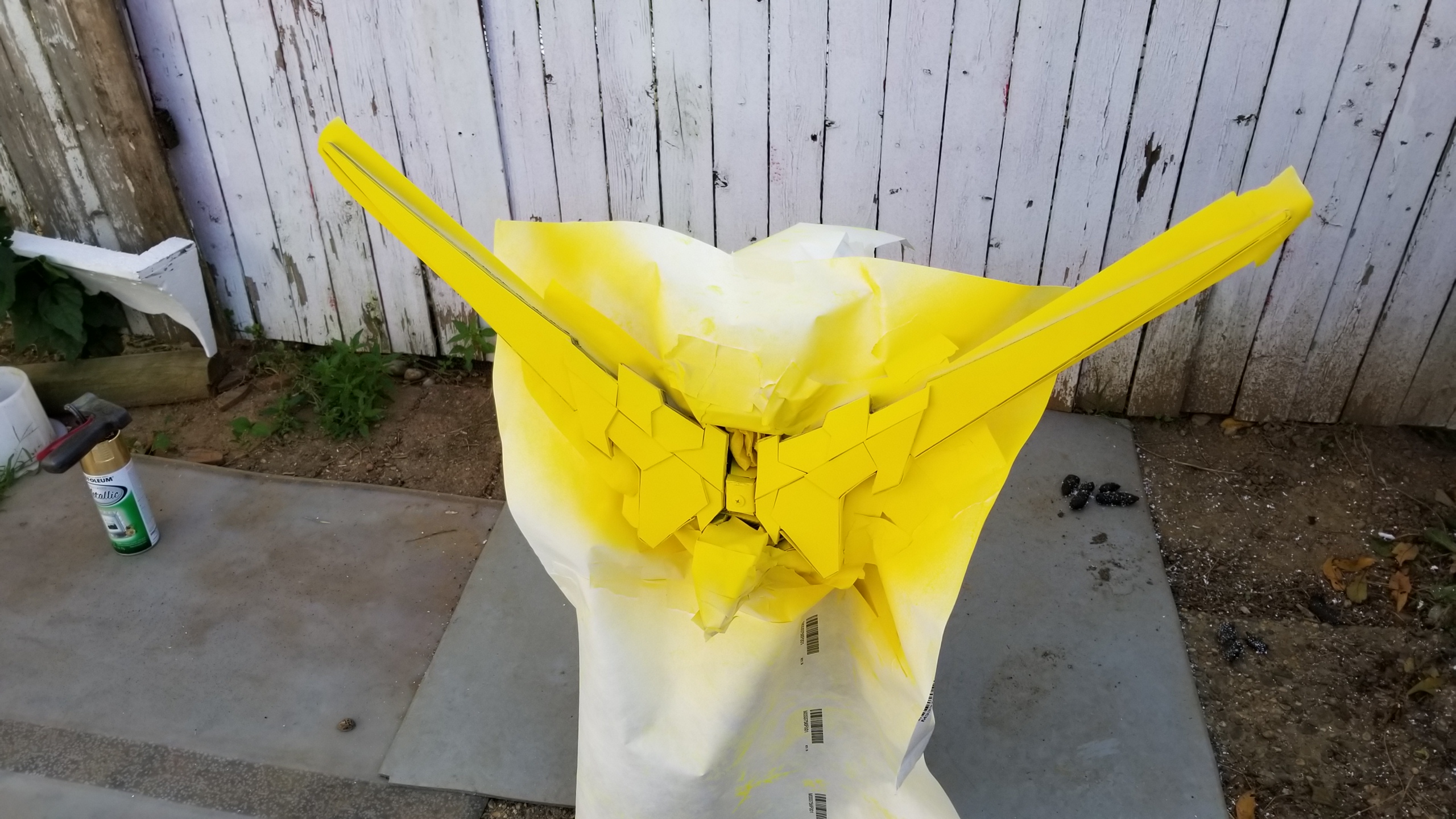

20171021_142853.jpg 20171021_160532.jpg 20171021_163726.jpg 20171021_164829.jpg Horn paint with a touch of glitter

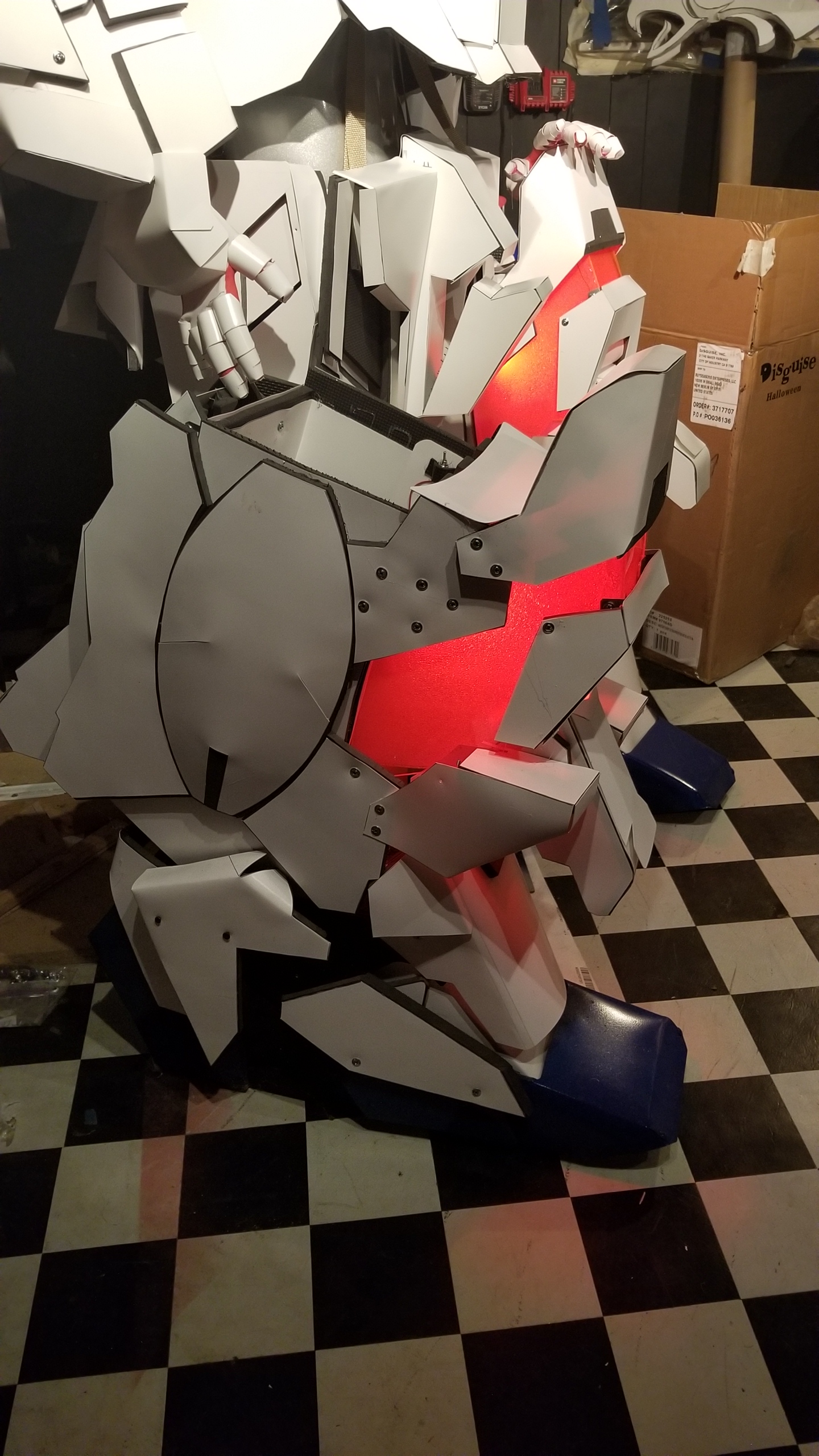

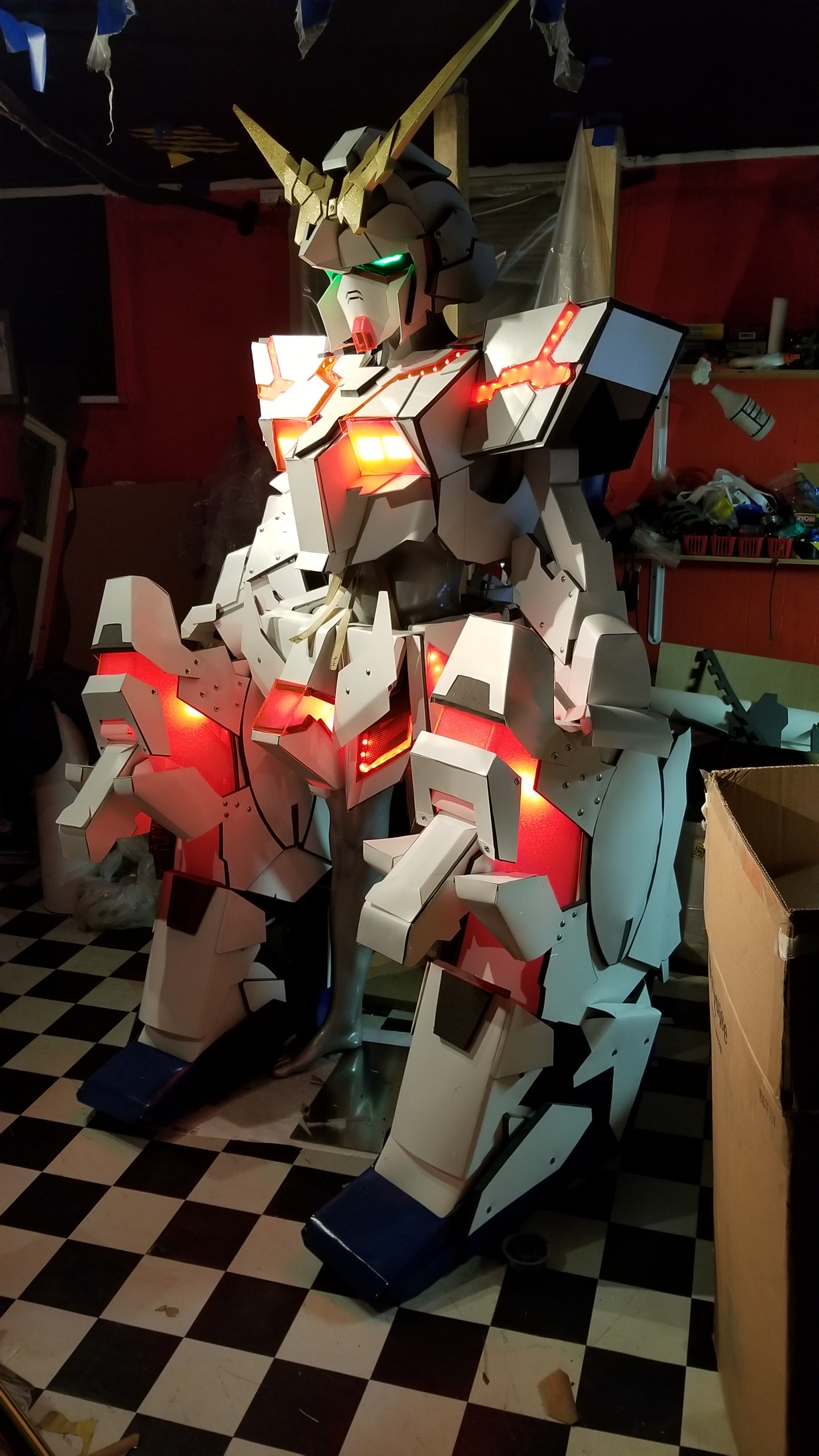

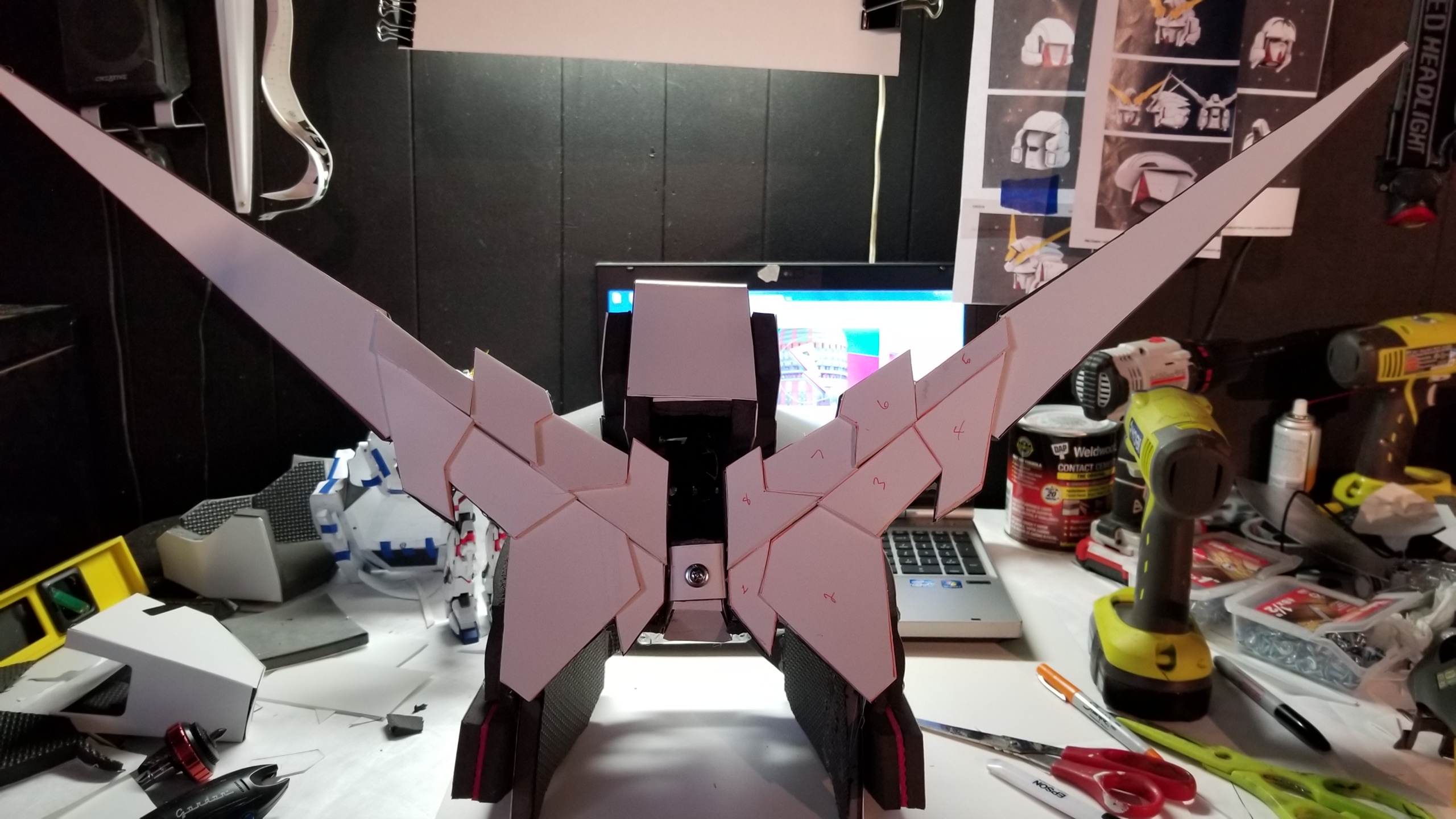

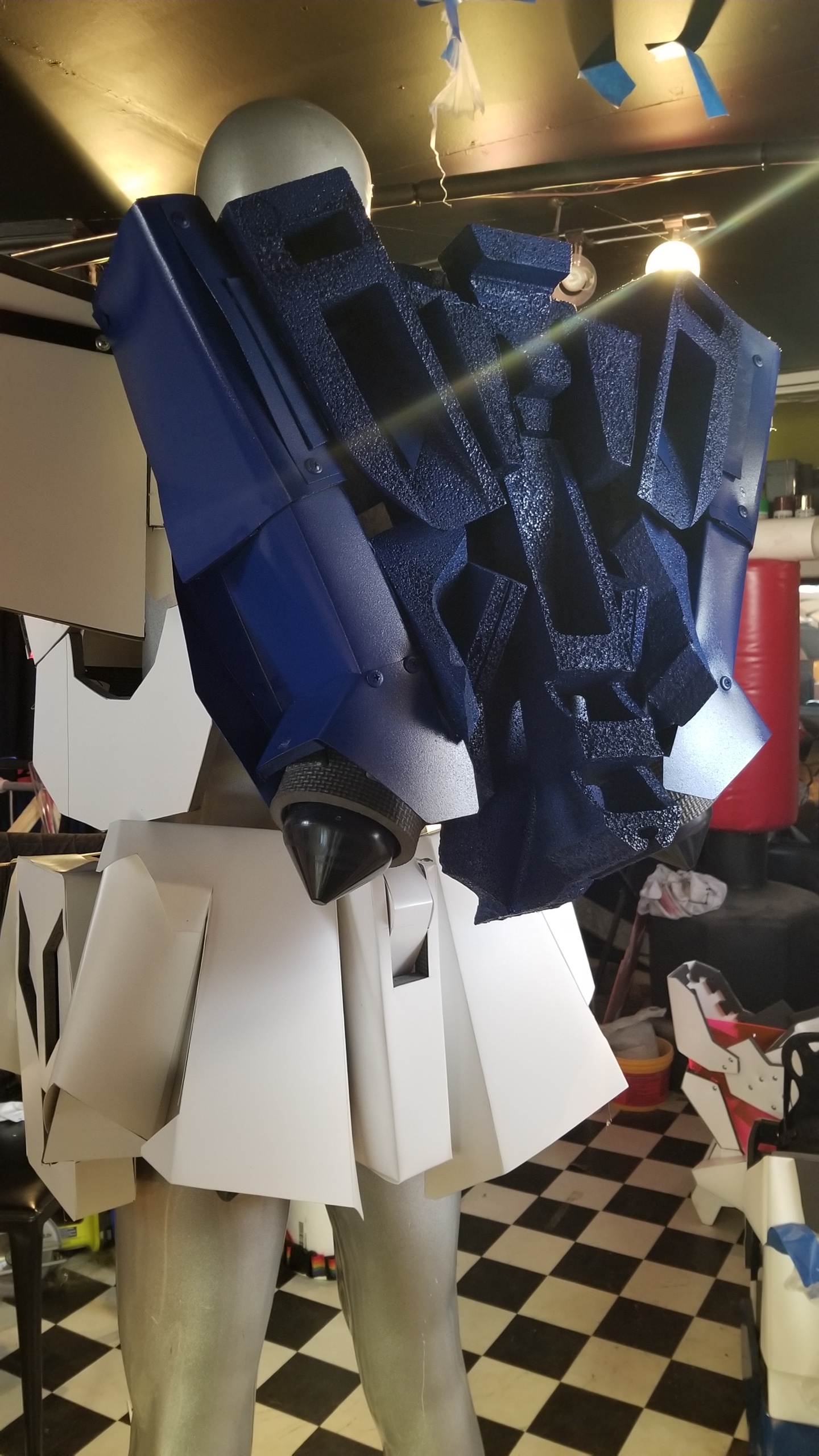

20171021_180331.jpg 20171022_141231.jpg Booster pack installed

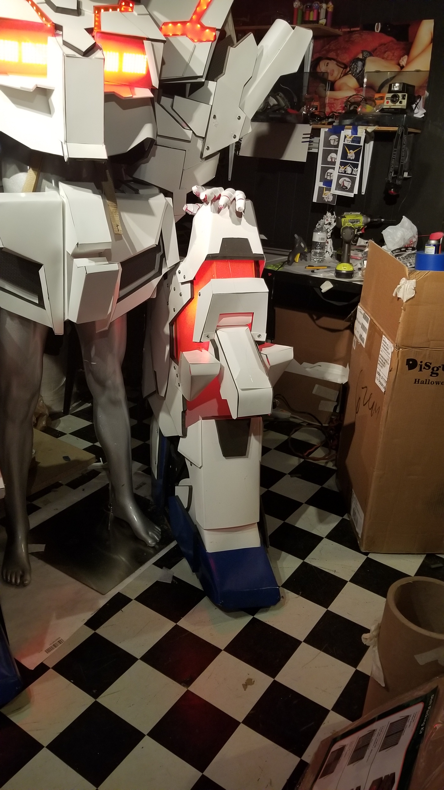

Final mock up, but pretty sure i will add more details in the future before i put it on ebay, just need more time in the day.
20171022_184556.jpg 20171022_184605.jpg 20171022_184608.jpg 20171022_184616.jpg 20171024_212847.jpg 20171024_212903.jpg
