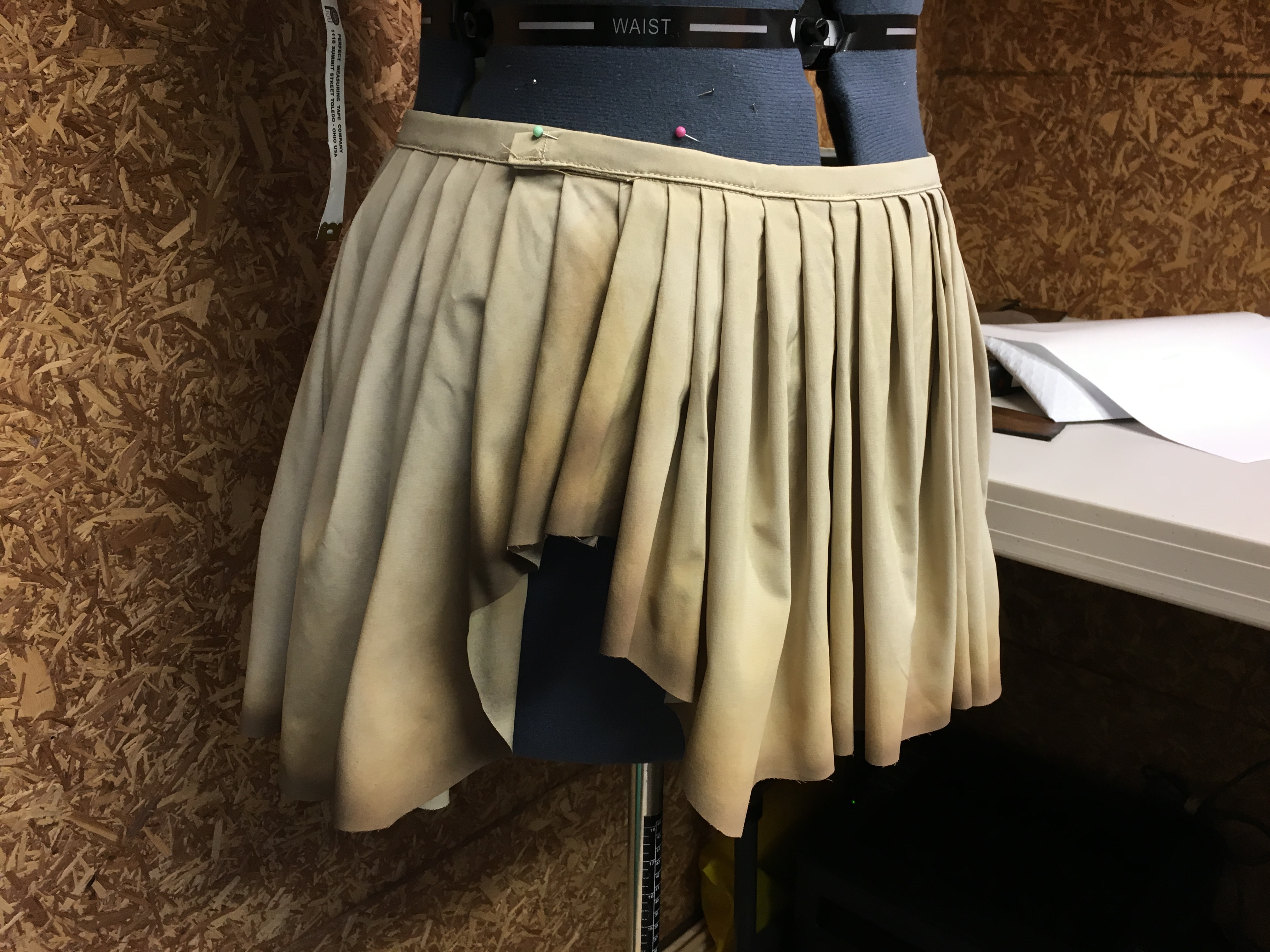

So, I decided not to change my skirt material after all (I like this fabric way too much and I haven't had any success finding a good microsuede or leather lining). Since my last post, I dyed the skirt, shortened the length, widened the slit, and distressed with an airbrush. I am super happy with the results!
As you should be. It looks really nice. What colors did you use for your distressed look? Did you use acrylic paints?
