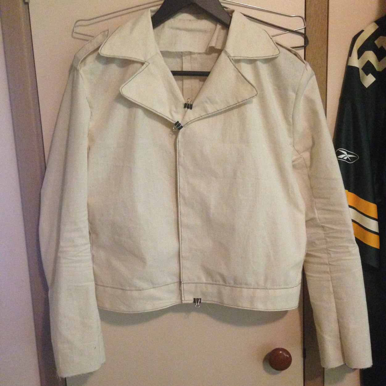

well I said 'a little ways off', but I've hit a little bit of a waiting period for Kylo while I wait for some stuff to arrive, so I've printed up the full size pattern for the jacket, drawn them all out on calico and cut them up.
It's going to be another hot day tomorrow, so I'm going to spend it inside in the air con with the sewing machine, should be fun.
right, so this afternoon I started sewing up the calico test jacket
Sewing a lapel collar for the first time was pretty daunting. Assembly wise, it was the most complicated thing I've yet attempted. Once I hit the end of the process I had this jumble of calico, and I had no idea if it would turn out right.
...but it did. More or less. The neck is sitting a bit funny (and thus pulling the whole collar up a little) because I haven't trimmed all the seam allowances up yet but early returns are encouraging. Now I've got to put the sleeves on, sew up the sides, do the lining and do a bit of topstitching.
I'm getting a feeling I'll have to up the pattern size by about 10% when I'm done, but I'll reserve judgement till it's all together.
Good News: The pattern essentially works:
Bad News: as I suspected, it was about 10% too small overall.
It's not too bad though. I'm happy with the overall shape it has, it just needs to be bigger. These are the fixes I'll be aiming for in V4.
- make the torso about 2-3 inches longer
- make the sleeves wider in the upper arm (I couldn't even get my t-shirt sleeves into this one...lol)
- make the arm holes bigger.
- lengthen the sleeves by an inch or so
- rework the patterns for the collar and the facings so they sit nicer.
- just make it bigger overall. This version is more in line with the size of a shirt as opposed to a jacket. Rookie error, but this is why we make test ones.
