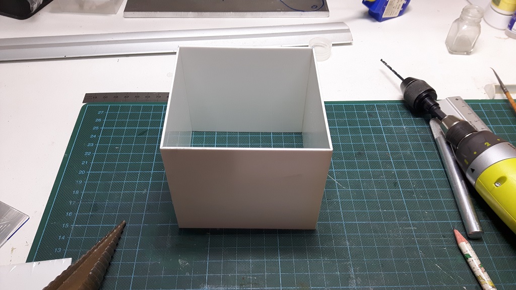

Started building a 10 x 10 x 9 cm cube

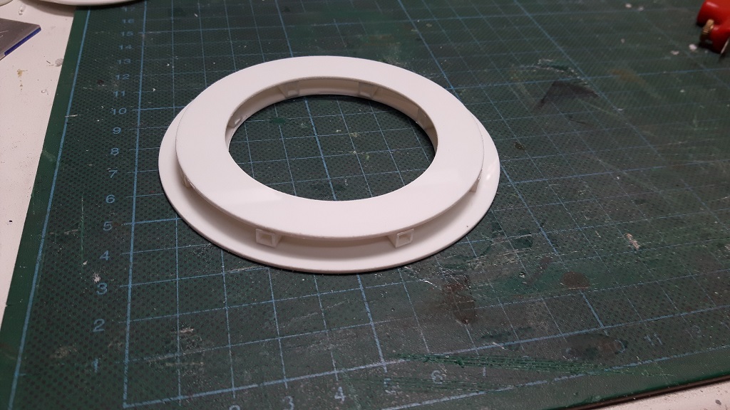

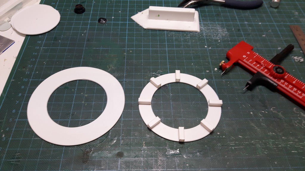

I decided to make the bottom plate doublelayerd, to be able to have access to the inside (if i decide later to add light or whatever). This is the inner layer that will have a big access area.

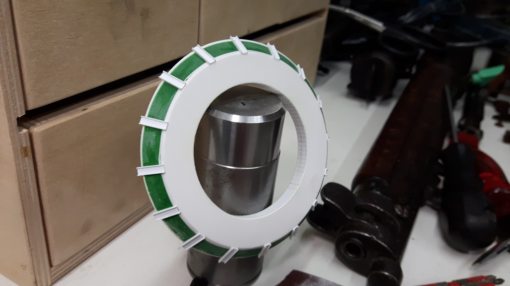

Today the green 2 part "Aves Apoxie" was hardened. I really like that stuff cause it sands pretty close to styrene, so if you sand a "apoxied" area you don´t have the problem that many other have, different takeaway on the styrene compared to the used filling stuff.
First i´ve put it on the lathe to give it a few fast passes, not really spent any time on adjusting, just put it on the chuck and here we go. Due to the used universe look at SW you don´t want it look to "new/clean".
Next part was adding some details, please refer to the pics at the beginning of this thread. Evergreen offers premade strips and sheets in a lot of variations, for modelkit building and architects concept buildings.

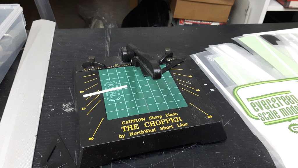

For cutting the strips i use this handy tool. It enables to cut angles, and ensures all cut pieces are the same length (not very important here as i planned to sand both ends when the glue has set). But it eases things up and also speeds working up when doing repeating work.
Glued them to the piece, and hang it away for the glue to set.

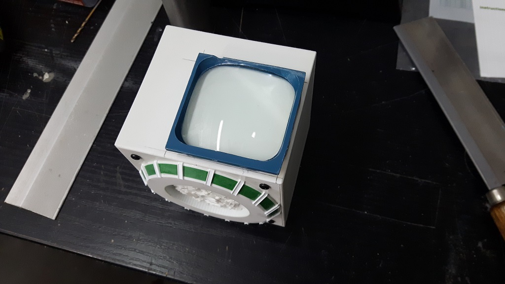

Here you see it attached to the bottom. I also cut one of my lenses that were also used for the Treadwells eyes, here it will be used as a tiny monitor.

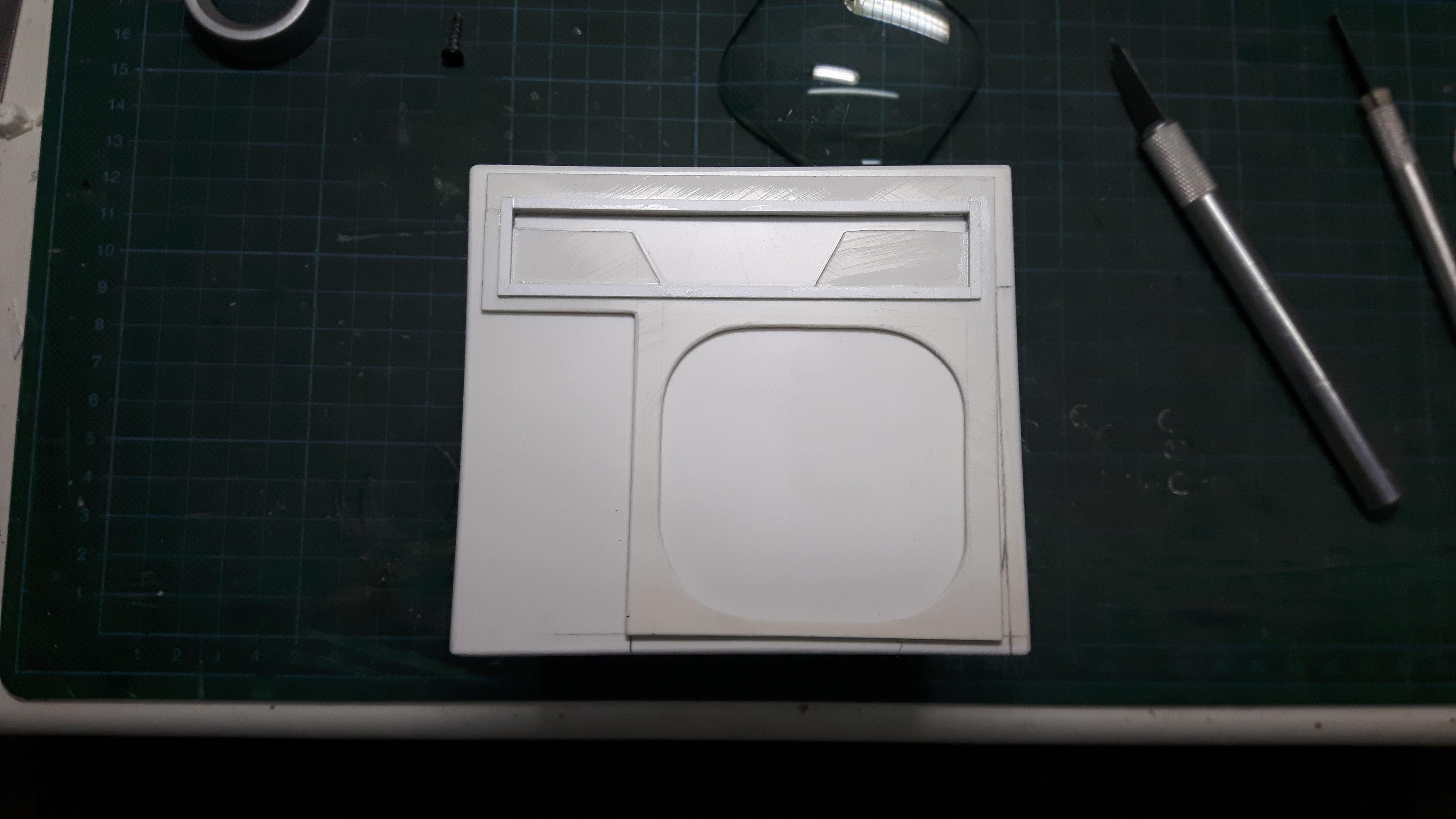

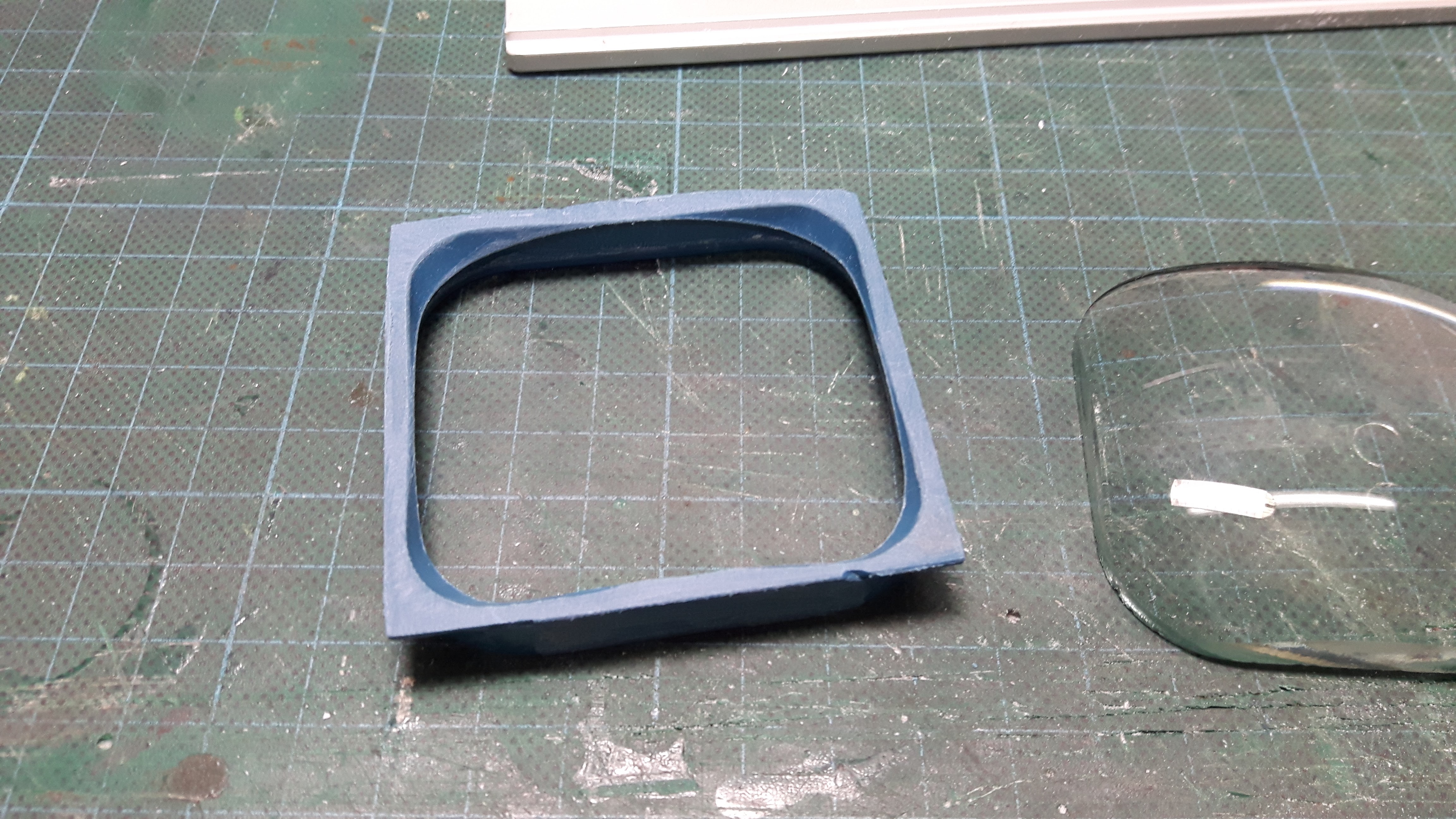

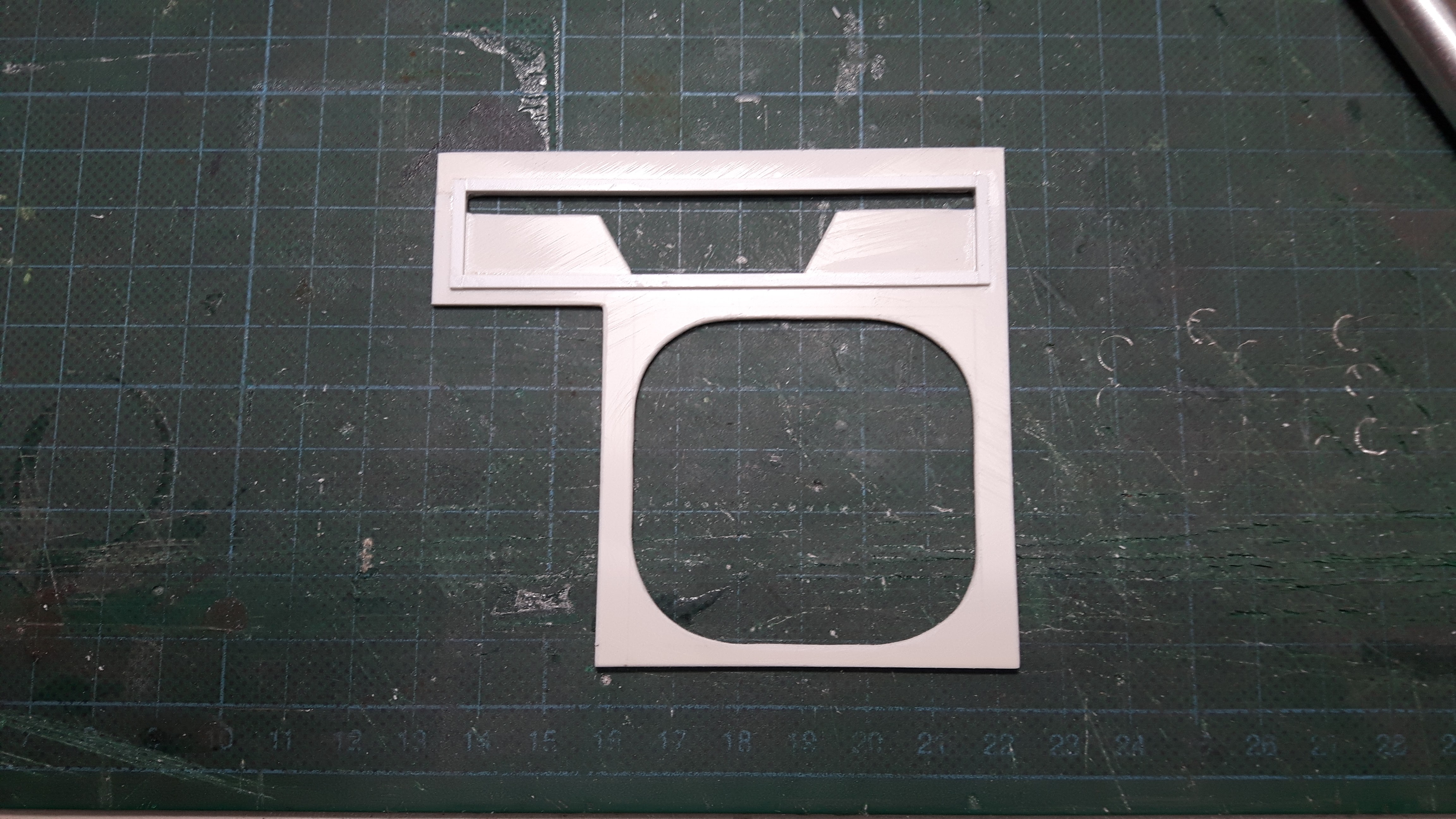

First i took the lens out of it´s frame - it´s very thick and rounded on the front, you will soon see why i couldn´t use it as it was.

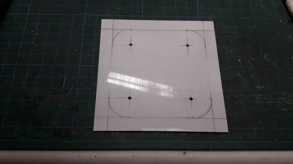

Made the doubled frontpanel. All is made from 1,5mm ps sheet by drilling, cutting, sanding, .....

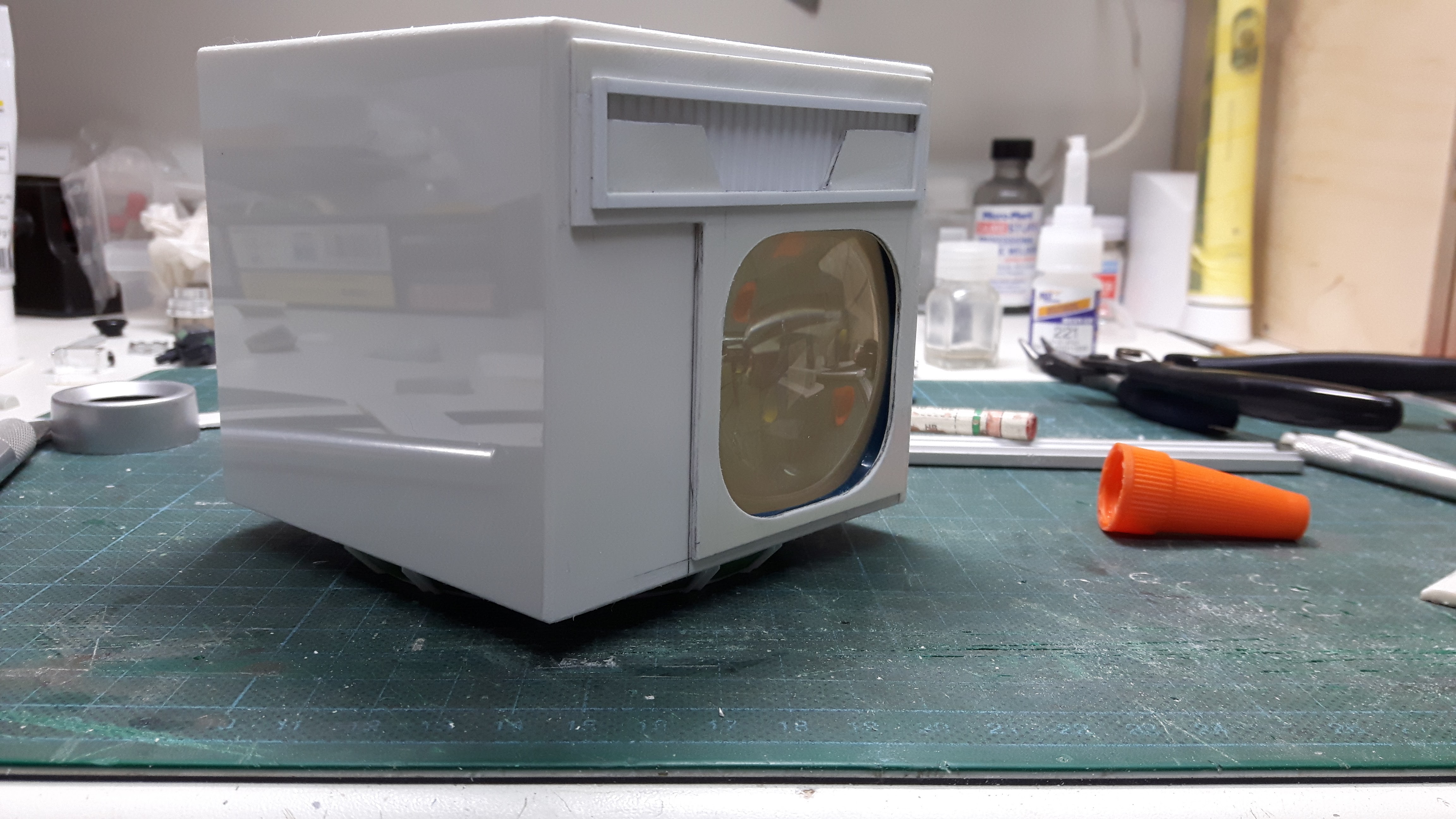

Put it on the cube to mark where the cutouts need to be.

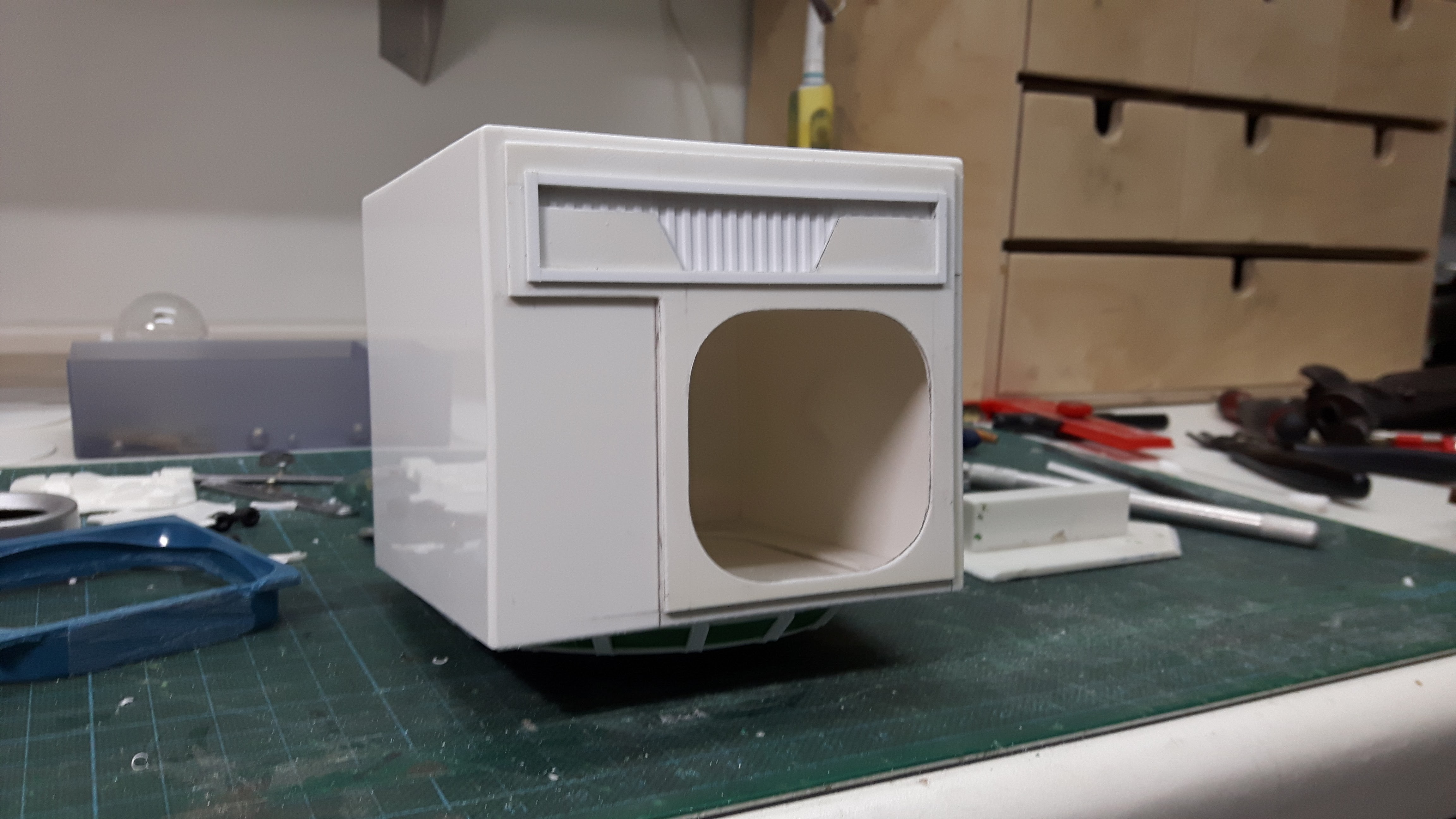

After making the cutouts into the cube i glued the frontpanel on, then i made the vocoder strip (again with premade sheets from Evergreen).Vocoder strip and lens are made to be installed through the big opening from the underside, that eases painting without messing lens and strip.
Due to the extrem rounded front of the lens it sticked out far to much the way i planned, so it had to look for another way.Decided to use it´s original frame, just needed to sand it down 1-2mm.
Looks not that bad anymore, i think.

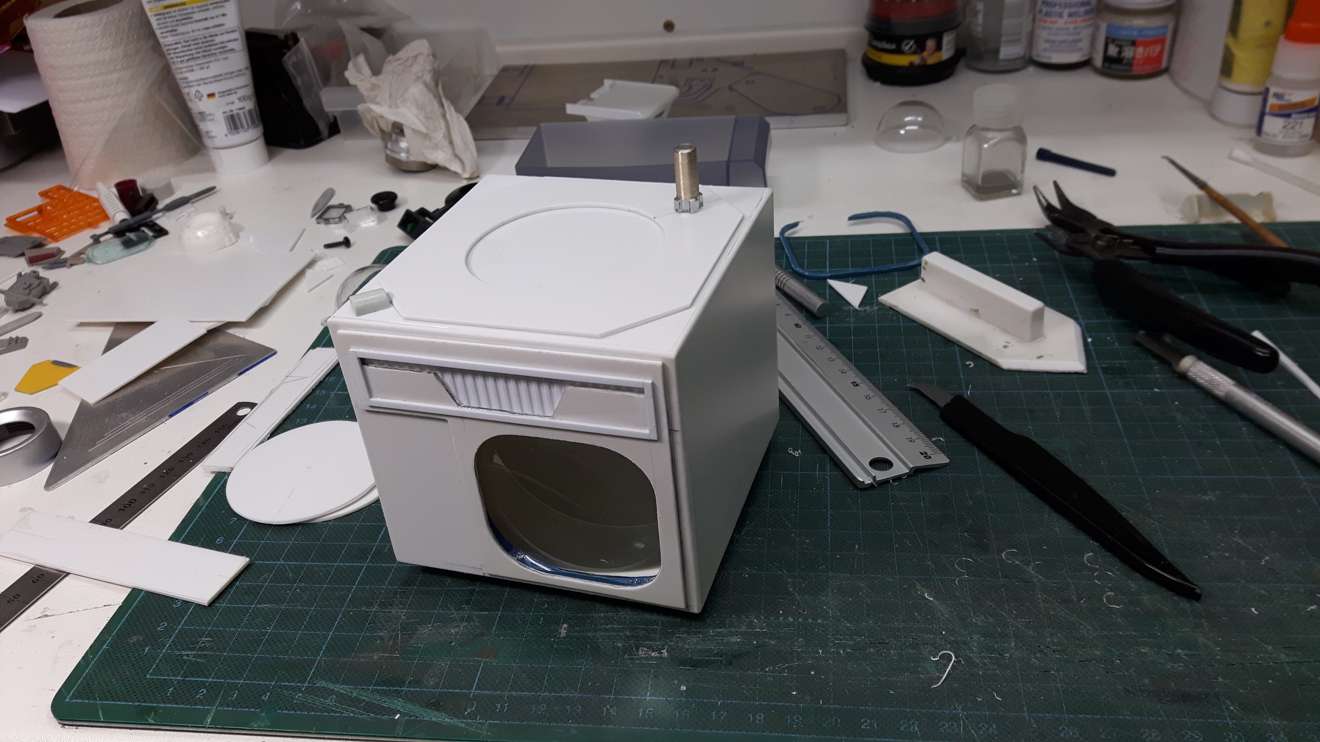

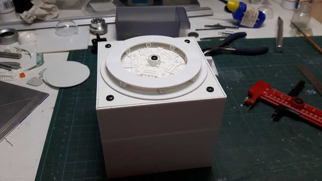

Started designing the top-plate

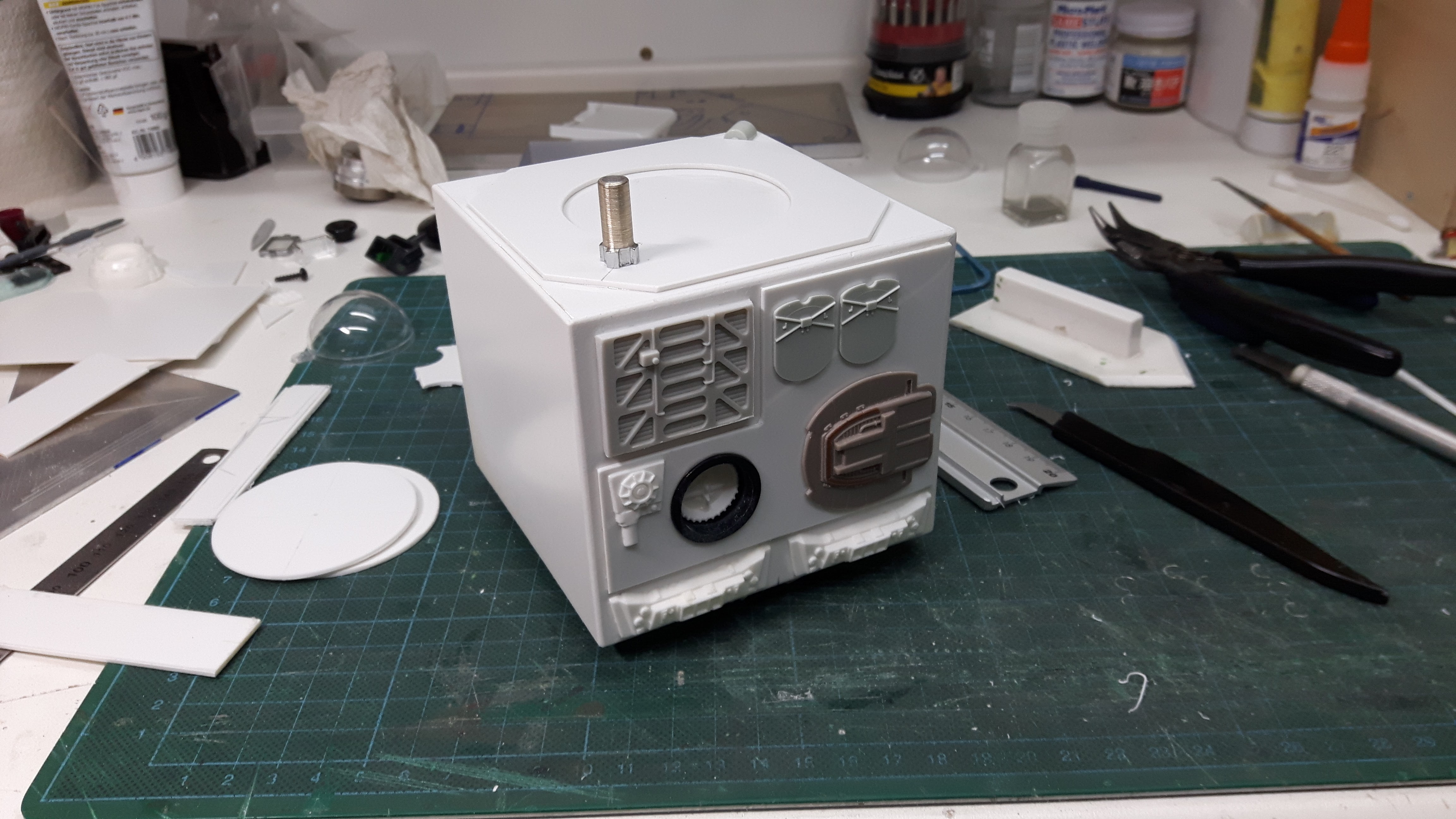

And also detailed the rear
Kit bashing is always a little bit tricky, it´s overdone very fast. It looks so different when glued on, but it blends in when primered

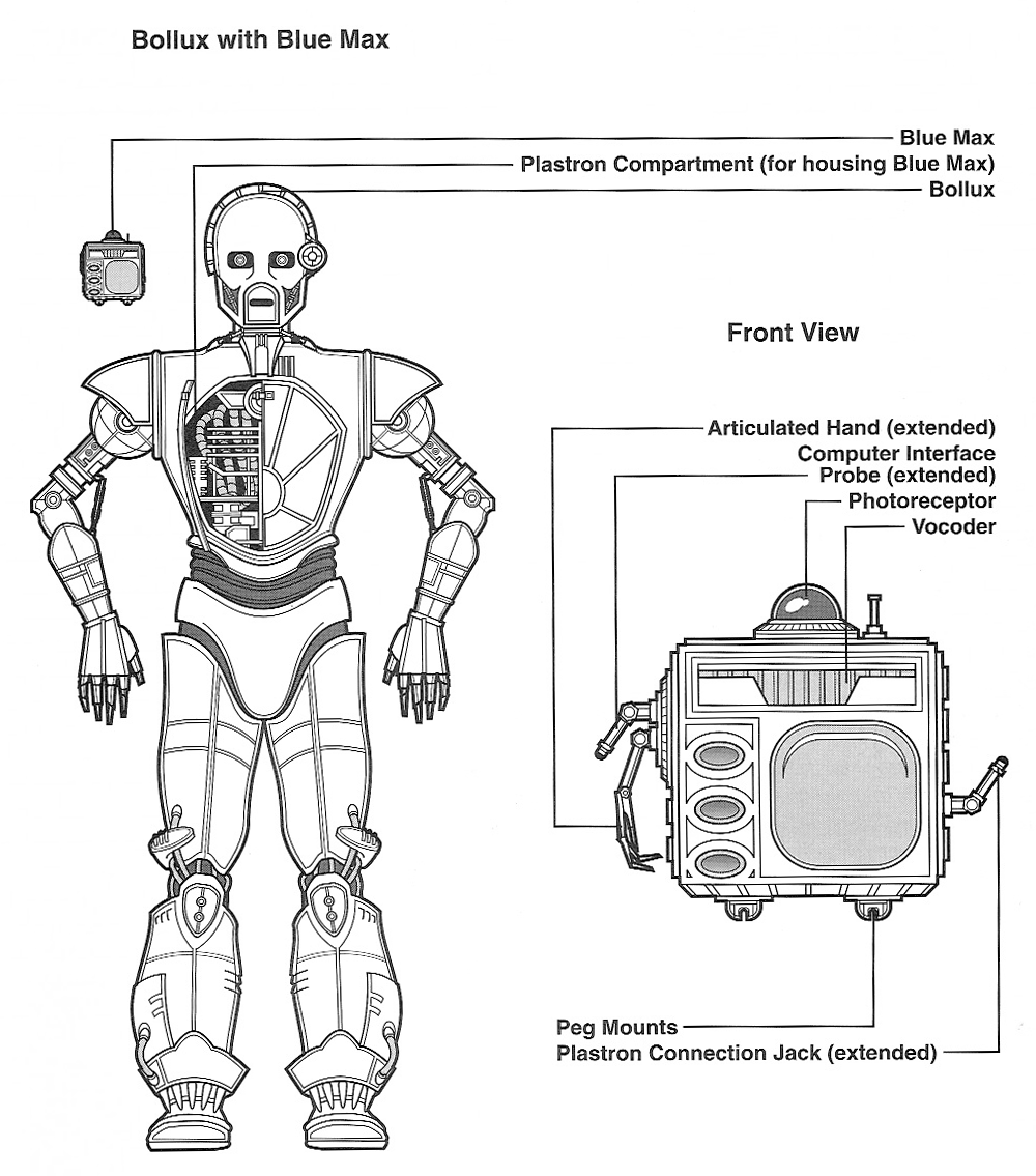

Had a bit more of a search around for reference, but the Han Solo at Star's End comic only shows Blue Max as a plain cube, and the "Han Solo and the Corporate Sector Sourcebook" from West End Games only has a picture of Bollux, not Max. I did find this pic in my copy of The Essential Guide to Droids that does not appear to be online:
This picture shows him with 3 hands, rather than just one (in the picture on the page opposite!), so I suppose both versions would be correct.
Interestingly, both the West End Games book and the Essential Guide to Characters have Blue Max down as being 40cm, but the Essential Guide to Droids has the much more manageable hand sized version.
I believe to remember that in the text he had only one tiny arm/ hand. Additional a computer arm, not sure if there was a third and what function i might have had.
I know. Hard to see that fitting inside Bollux chest.
