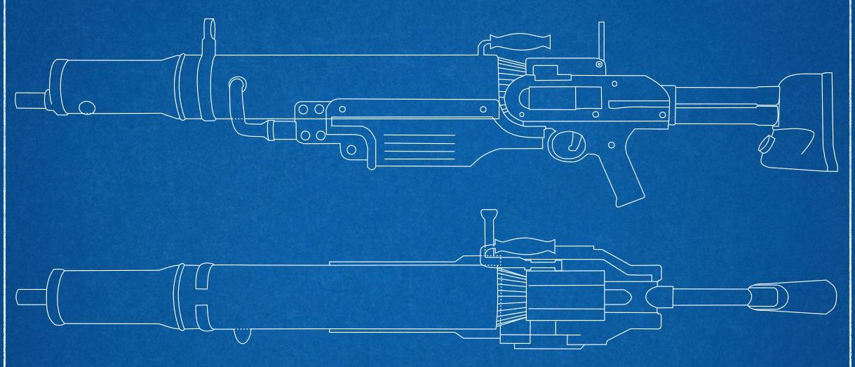

This would by the result of the outline approach. Image needs to be scaled for final result, but the ratios are correct.
I left out one or two details, mostly the barrel "nobs" and the magazine.

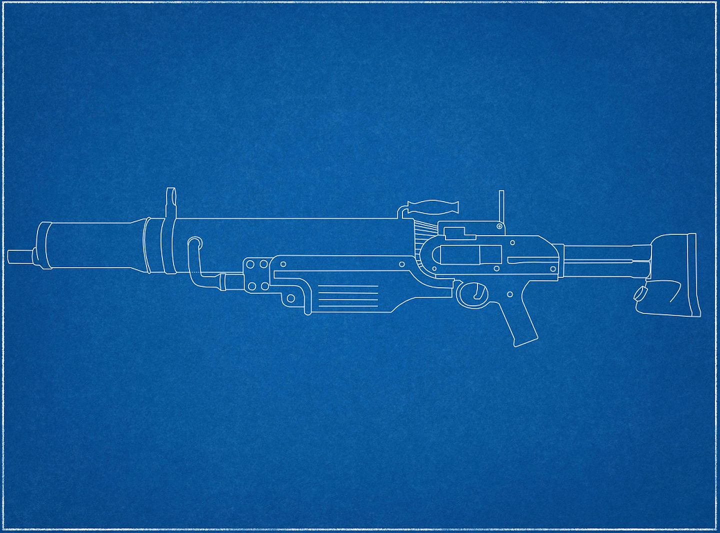

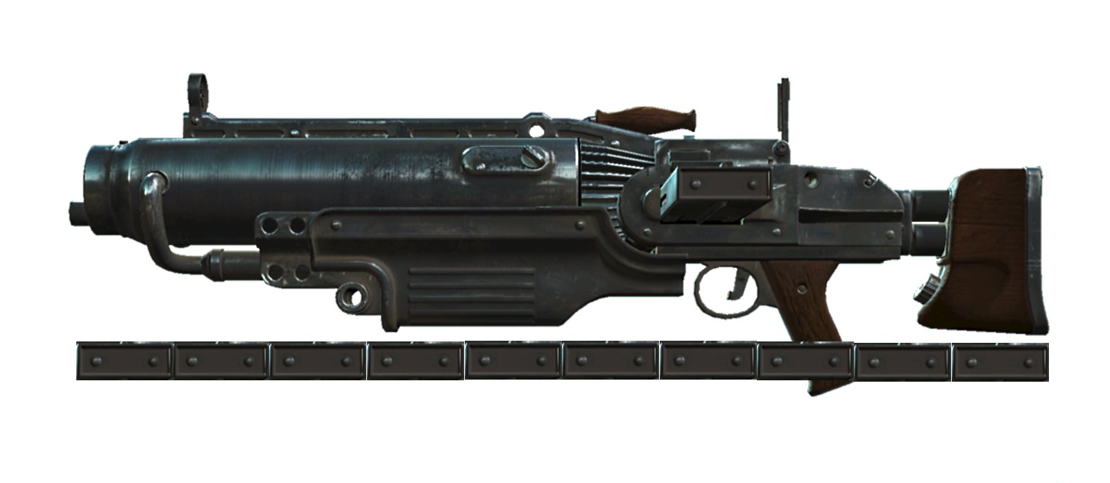

Given that the assault rifle uses 5.56 rounds and they are 57.40 mm long, so we could expect the magazine is 60mm or a little bit more, AR 15 magazines seem to be 60.452mm wide so taking the shortest version of the assault rifle and counting how many times the mag can fit next to it. we get this:
10 magazines long, which gives us roughly 605mm which is roughly 23.81"
