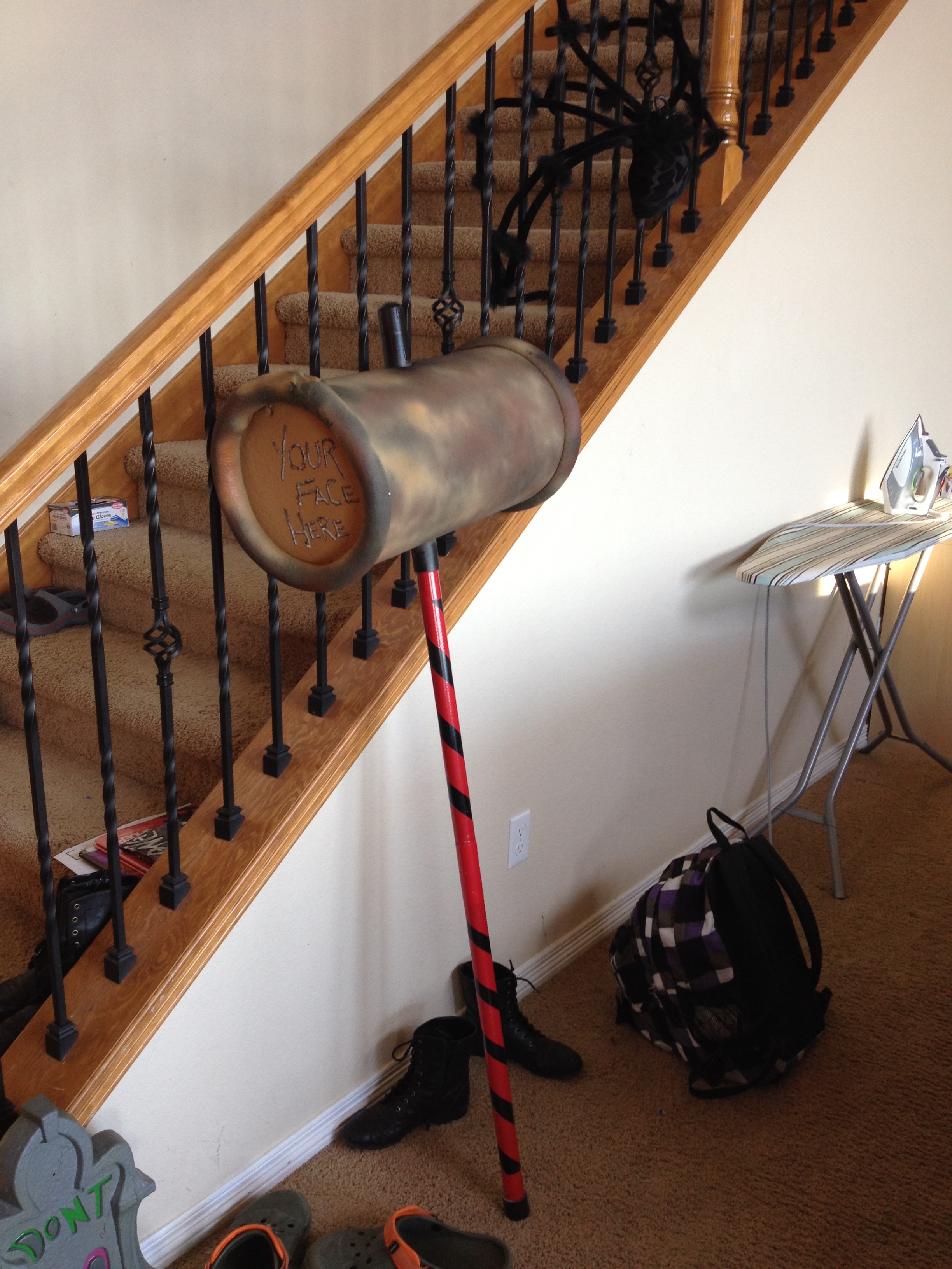

I made mine out of concrete pouring tubing (12" diameter) cut down to a 19" length and a shower curtain rod for the handle.
The handle, I covered with ducktape. The mallet itself is spray painted black and the ends are painted canvas and hot glued on.

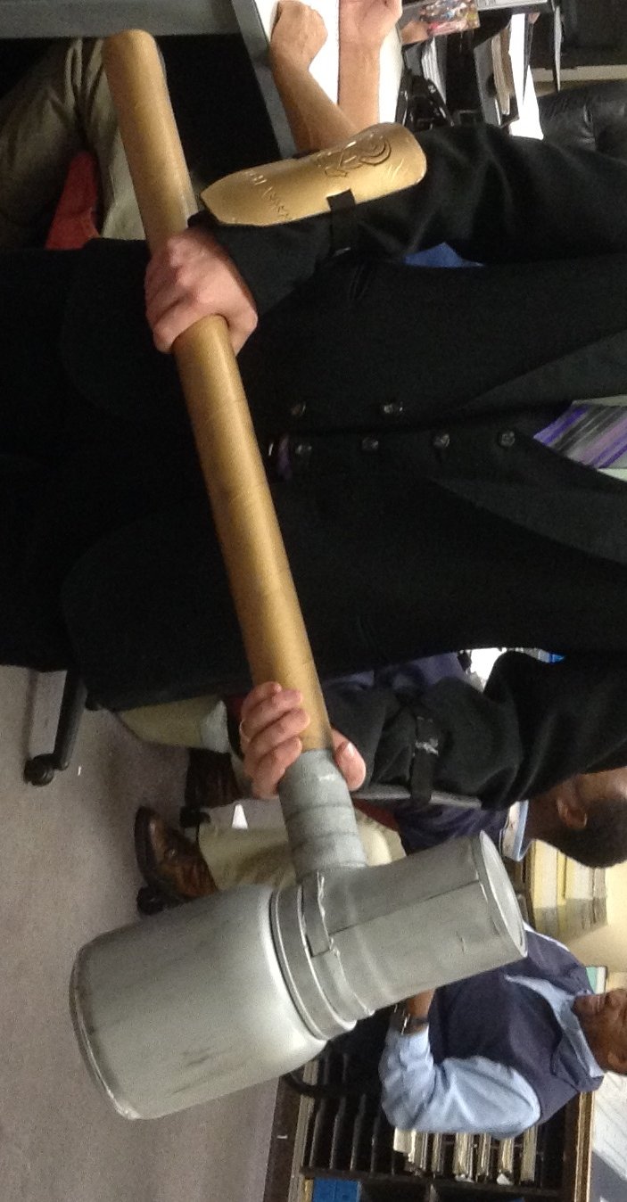

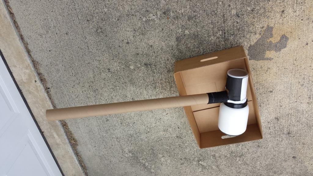

I kinda threw something together real quick for a big hammer for my Joki and my wife's Harley knock off. I used a large bottle that was for powdered protein mix and another that was used for Panko bread crumbs. bolted in the middle (with a actually bold :) and used a tube from a large plotter for the handle. I also wrapped some nylon strap around the joined hammer head pieces and the pole to strengthen it. A little foam, and some plas-dip to seal everything then, then primer, paint, and matte clear coat and a I have a cheap easy large hammer that I can use to work on computers :).
