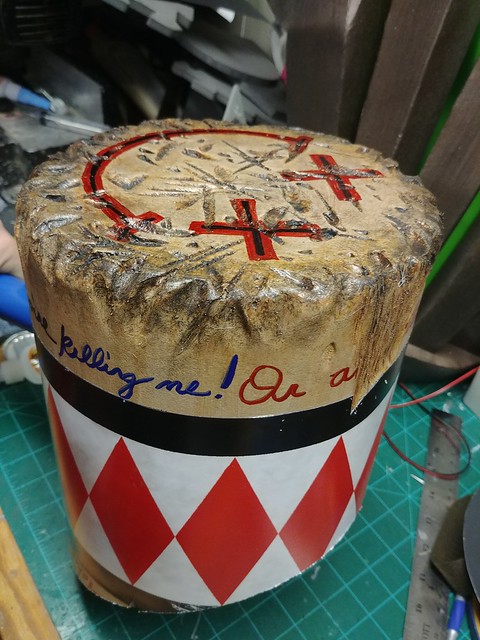

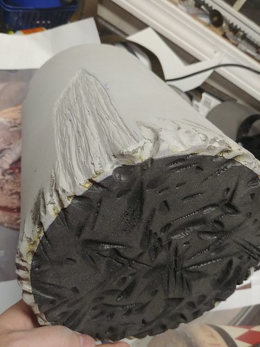

This started out as Foam... that I battle-damaged with my dremel and wood-burning tool.

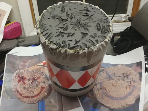

Because of the quick build required for this, I cheated and printed out the diamond pattern for my foam prop. Here is how the test fit of that printout looked before painting the mallet.

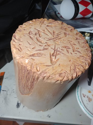

Then it was time to seal the foam with Plasti-dip.

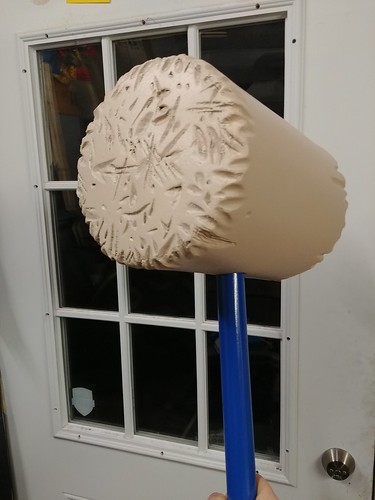

...followed by 4 progressively darker coats of tan/brown/black paint to give it wood grain look.
I followed this up with getting the writing done and adding the smiley face!

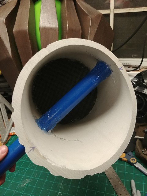

oh my goodness i have been looking EVERYWHERE for the dimensions of this prop. I KNEW the one i made was too big :confused: thank you so much for sharing! If you don't mind my asking how what paper/ink did you use to print the diamonds? I painted mine but I love the finish on yours! Also, how did you insert the handle so cleanly? Beautiful work btw! I'm hoping to remake mine with the screen accurate handle soon!

I had access to an over-sized printer (since the mallet I built was much bigger than the 5" diameter real prop. But if you print the pattern off on 11x17 tabloid paper you should be able to get the diamond pattern section to go all the way around the mallet head.
The handle, I just carefully cut the hole with an exacto knife and then glued the handle into place. HOWEVER, I cheated. Since we needed the mallet to look like it was smashed through the poster case, I had the end of my mallet cut open. So, it was SUPER easy to glue it into place!
