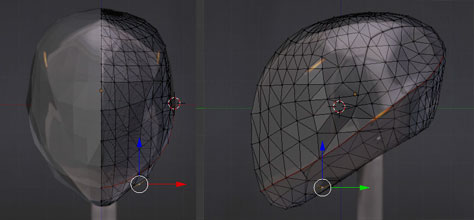

Pics of today's try at an unfold/build of a mkVIII helmet.
(I've removed this wip pdo. You'll find the final *.pdo file few posts below...)
Can anyone tell me whose model it seams to be, so I can add name and credit ?
Edit : ok, found. Thank you guys.
