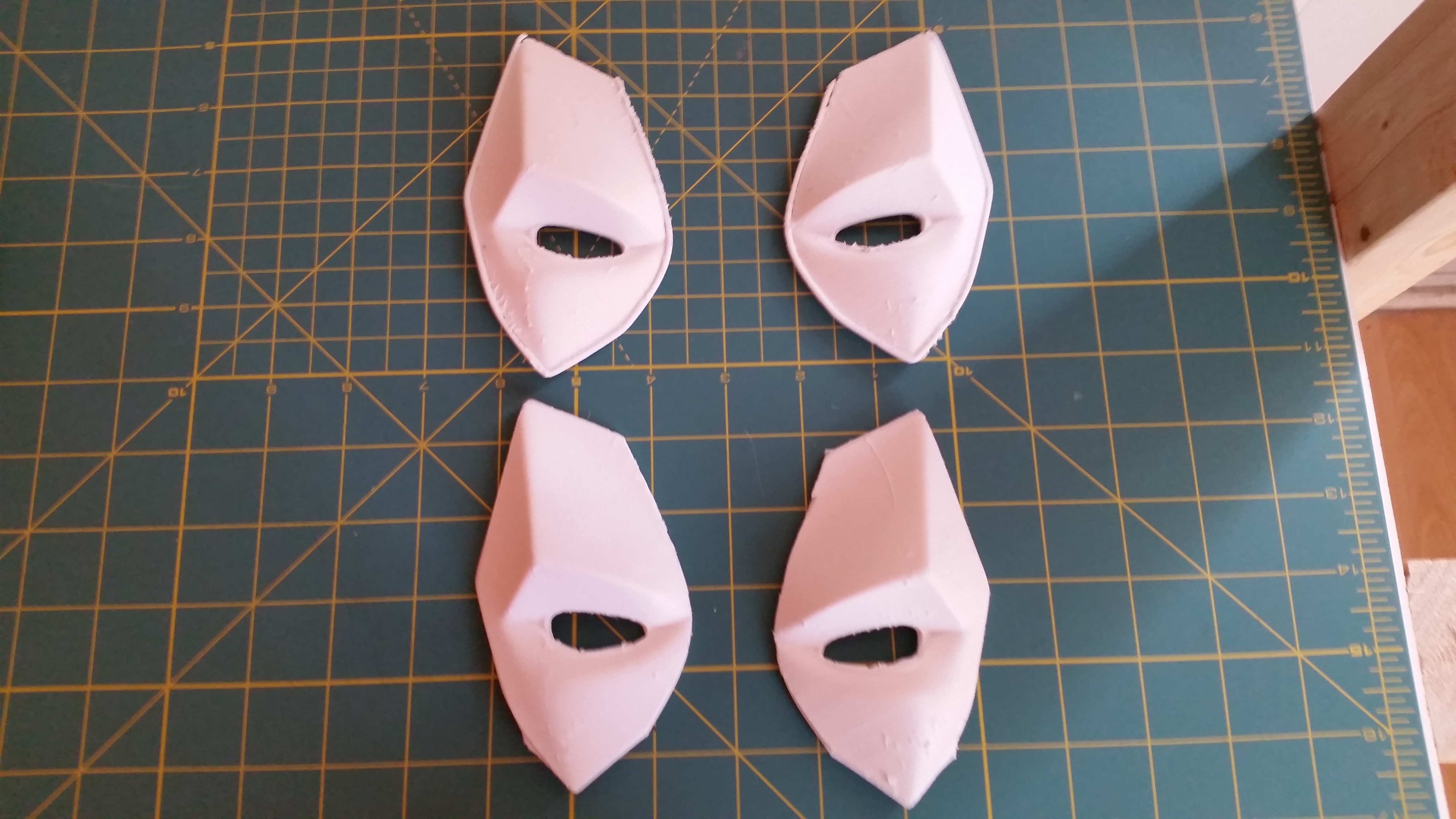

I have had 3d printed the model Kenlandrum has made available on his forum for the eye pieces. The guy I dealt with had a hard time getting the edges right. I will have to figure out a way to make the edge and glue them on.

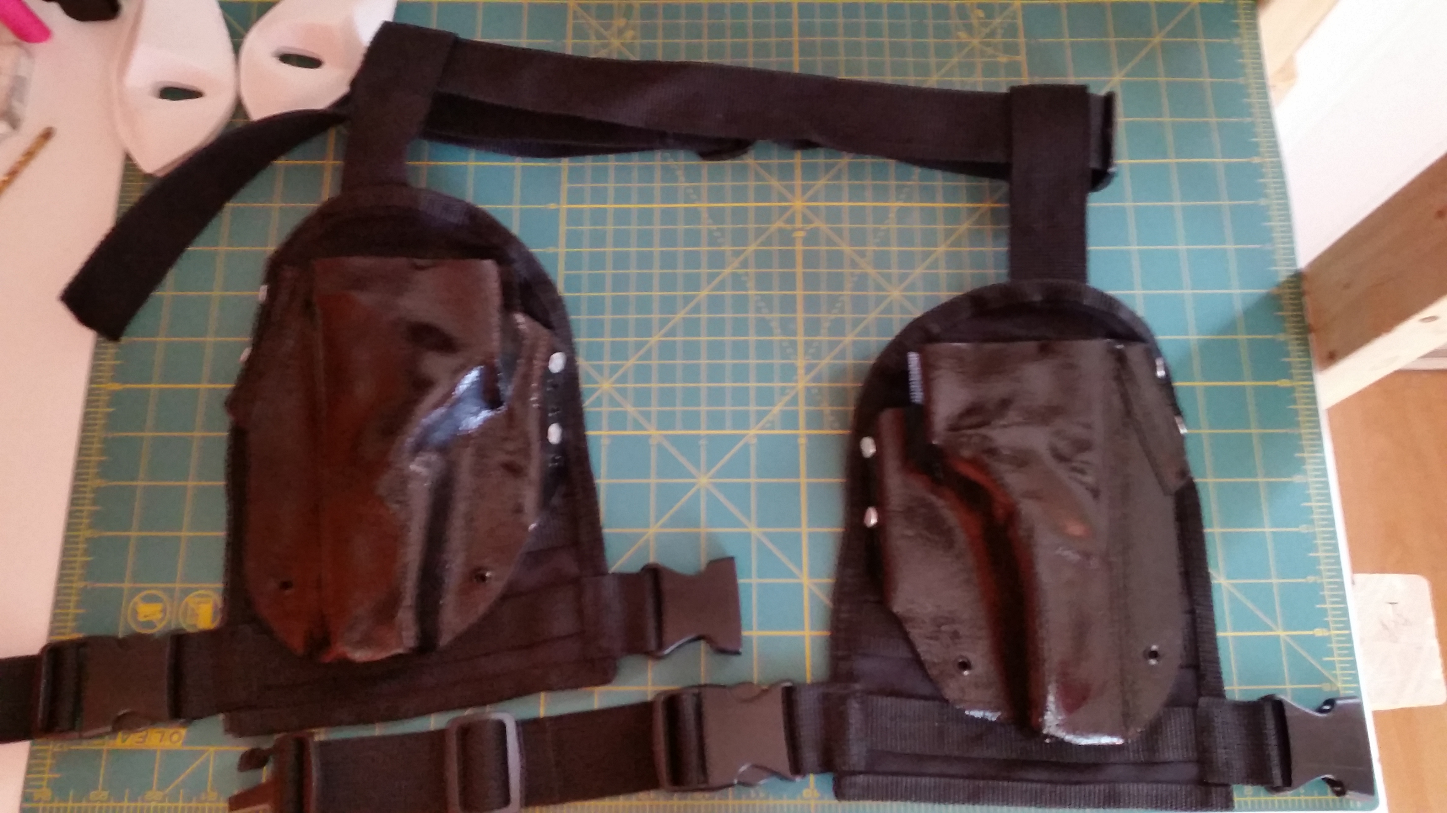

Holdsters
I'm trying to make as much of the pieces myself as I can. The holdsters were handcrafted.
Here is the finished product
The plastic parts were made from wonderflex, painted and then attached to the fabric with chigaco screws. I used a desert eagle I had printed and assembled to get the exact shape. I did a stress test to see if I could backflip without it falling out and it works amazingly well. No flying gun so far.

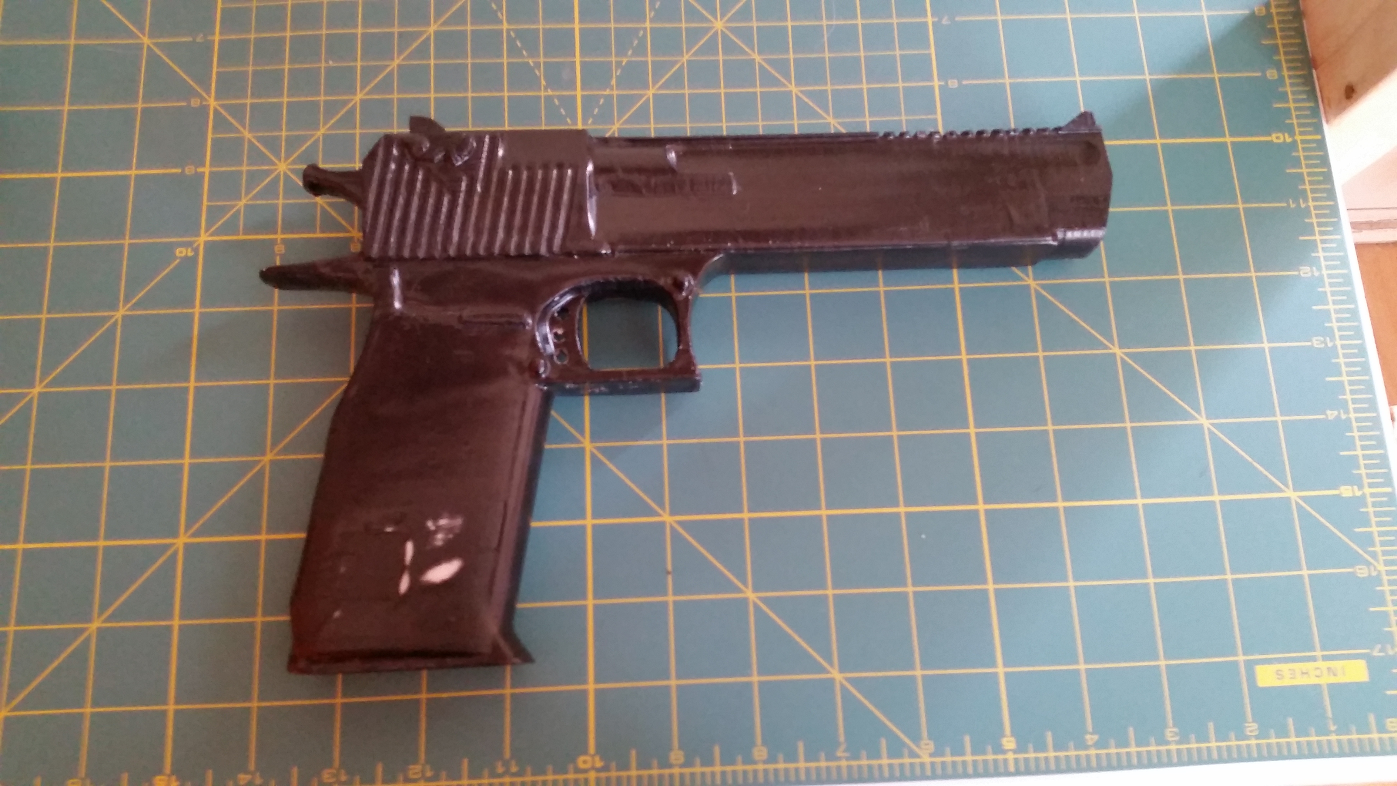

Gun
Here is the Desert eagle I had 3D printed.
The gun came in 5 pieces, that I had to sand and glue together, With bondo, I worked the seams and then applied XTC-3D to give it a smooth finish. The results is not great. I lost a lots of the details like the writing on the sides of the gun. I'll have to find a way to engrave it with a dremel. There are some spots that need work as well before I can mold it and cast it to make the two I will need. Tial and error since it was the first piece I had 3d printed and worked with.

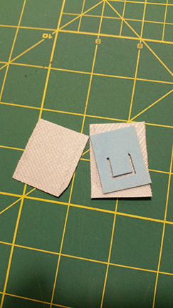

The pockets for the belt have been sewn so I attacked the little flap for each.
Started by making the templates from foamie and cutting them.

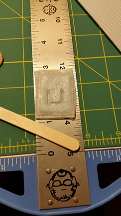

I then cut two pieces of wonderflex that I warmed up using a heat gun and sanwiched the foamie.
With a popsicle stick, I pressed the wonderflex into the whole to give it that dent they all have and trimmed the excess with scissors and a knife, I cut some of them too close to the edge, so the wonderflex would not stick anymore. Crazy Glue fixed all of that.
The problem now it that I find them to be too thick. I'm thinking of sculpting a new one out of clay and then molding new ones. I can make sure they are all the same that way and finally get to play with the smooth-on products I bought.
