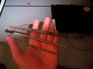

here are a few nails i grabbed from my garage... I'm going to be using the middle one... for now... lol
