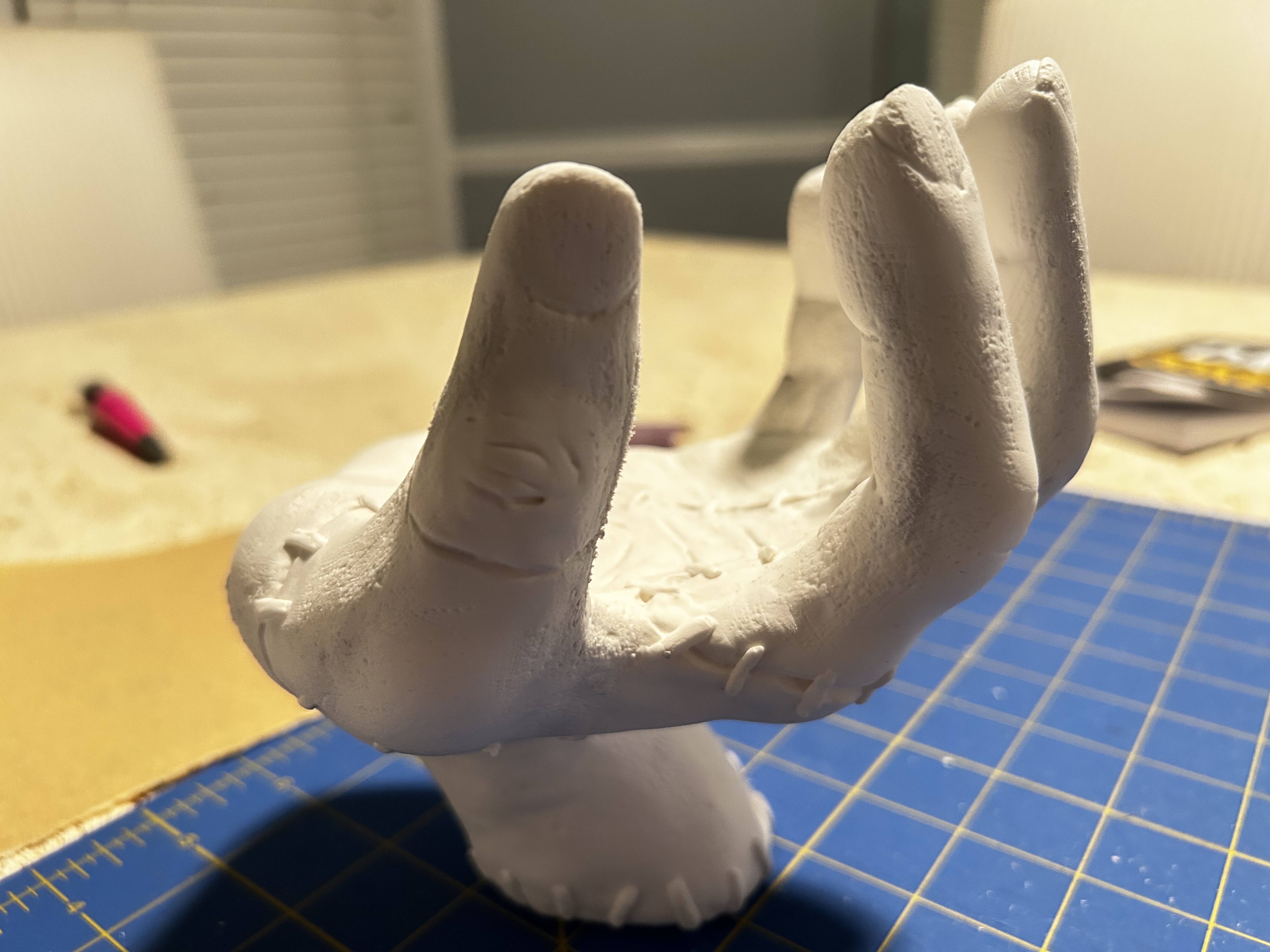

Was thinking it’d be fun to make a coaster using Wednesday’s Thing as the main piece.
Let’s start with a piece of EVA.
Time to put in a wire armature.
Made a wrist/support and attached to the hand.
More to come.
Started sculpting the finger pads and the back of the wrist
I think I’m going to have to reshape/shave the thumb, but everything else is starting to look good to me.

Initial sculpt on Thing is getting close. Fingers and palm done. Stitches complete. Wrist is started and needs one more session. Then I’ll start working on the base and cleanup.

Also thank you for asking about my take on foam clay - I love working with it too! It’s versatile, somewhat stubborn and often has a real mind of its own (like Hand?) Kinda feels alive, right? The ability to work + sand the product through the curing stages is amazing, and this is evident in your latest pics. I see he’s also quite the contortionist ;); probably his newly acquired stitches!
