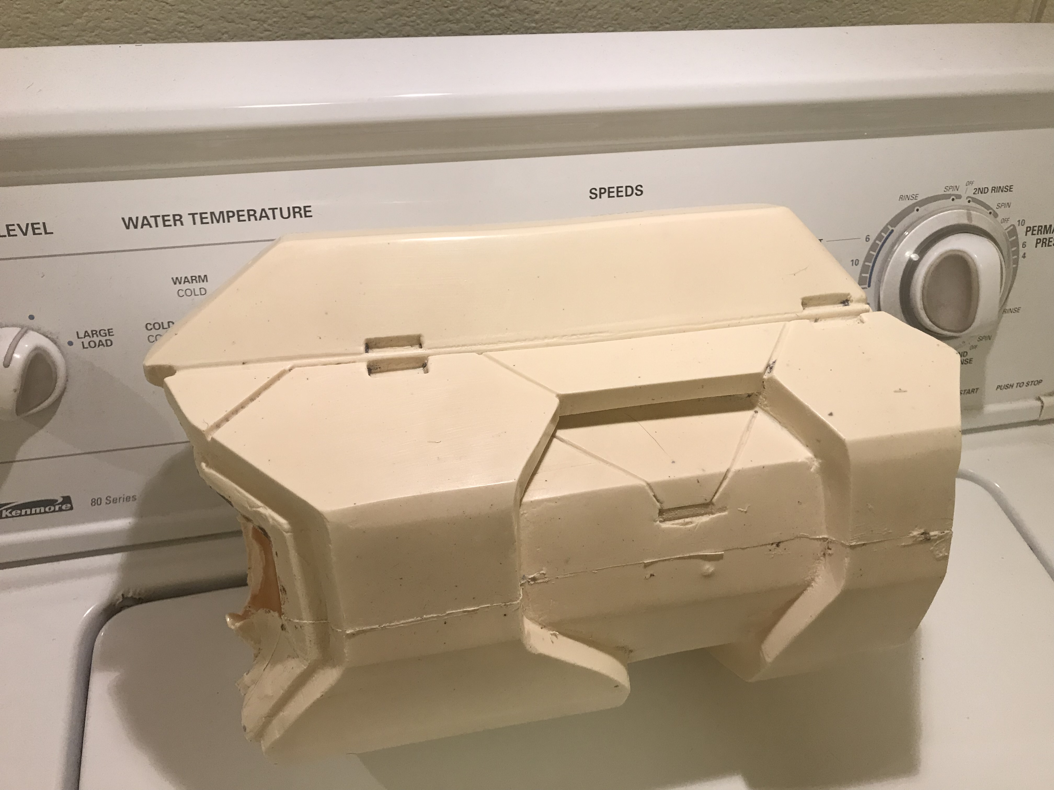

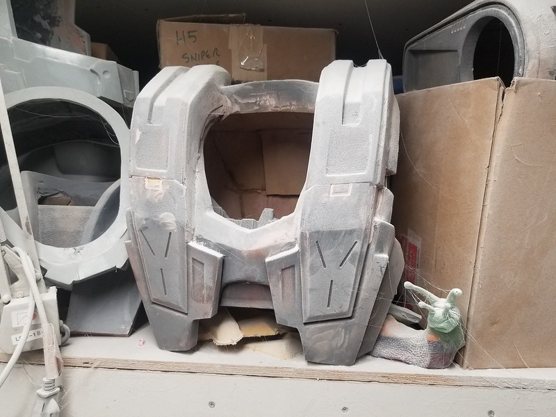

We each have a few more pieces to mold and cast. Here's my biggest piece collecting dust at the moment:
Then it's just a matter of trimming, painting, and rigging.
One of these days...

That chest piece looks awesome! Is that urethane? Almost looks like it has a fi-glass appearance to it. Do you mind if I flick you a PM? Got a project I’m contemplating and I know it’s a huge undertaking but want to do it right & just wanted to run something by you.

That chest is the CNC carved wooden form that I still need to finish smoothing and polishing so I can mold it and cast it in fiberglass. For now it's just collecting dust while I await the moment when I have time and money to work on it again.
Feel free to send me a PM if you have questions or want to run a project by me.

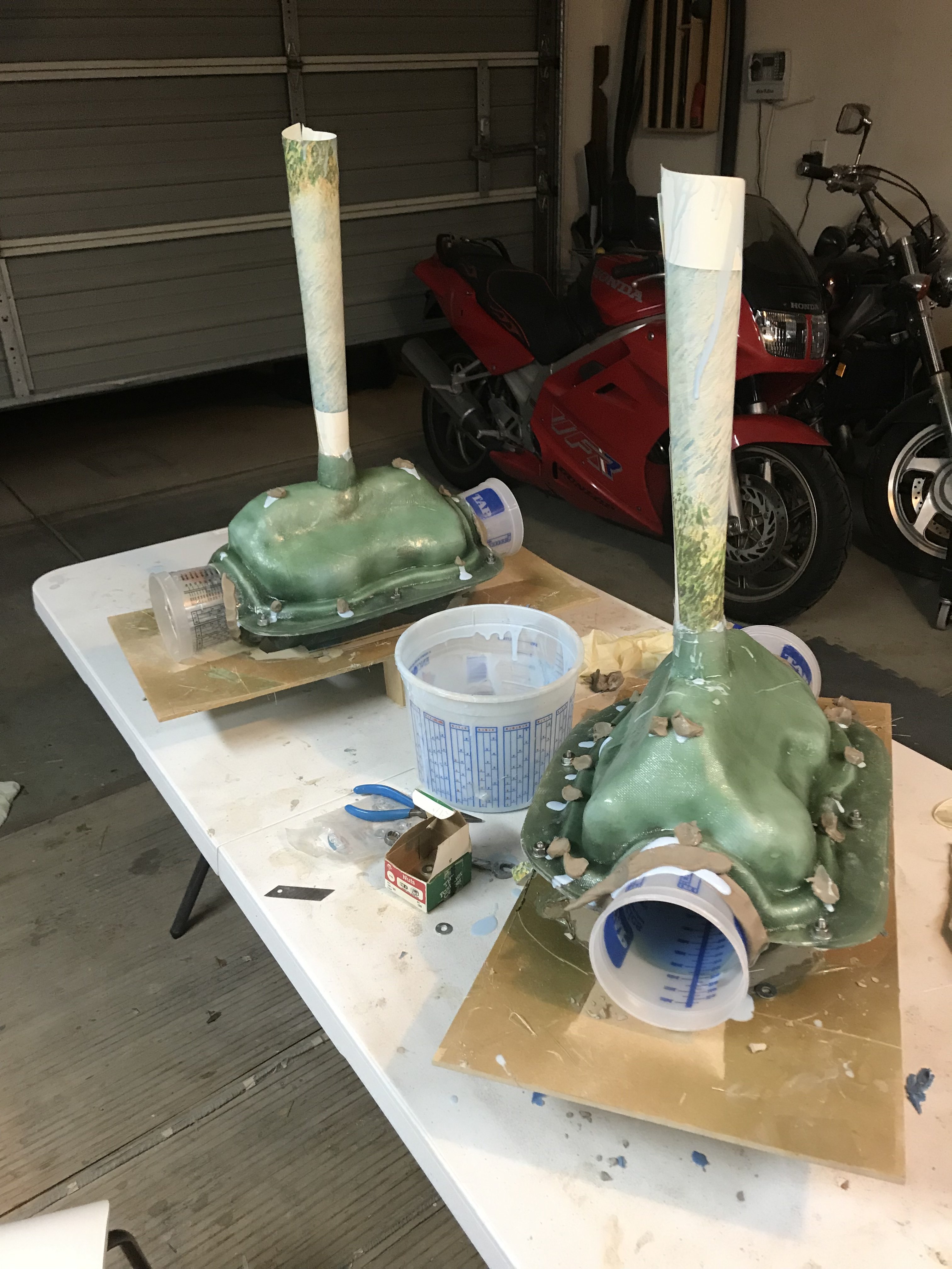

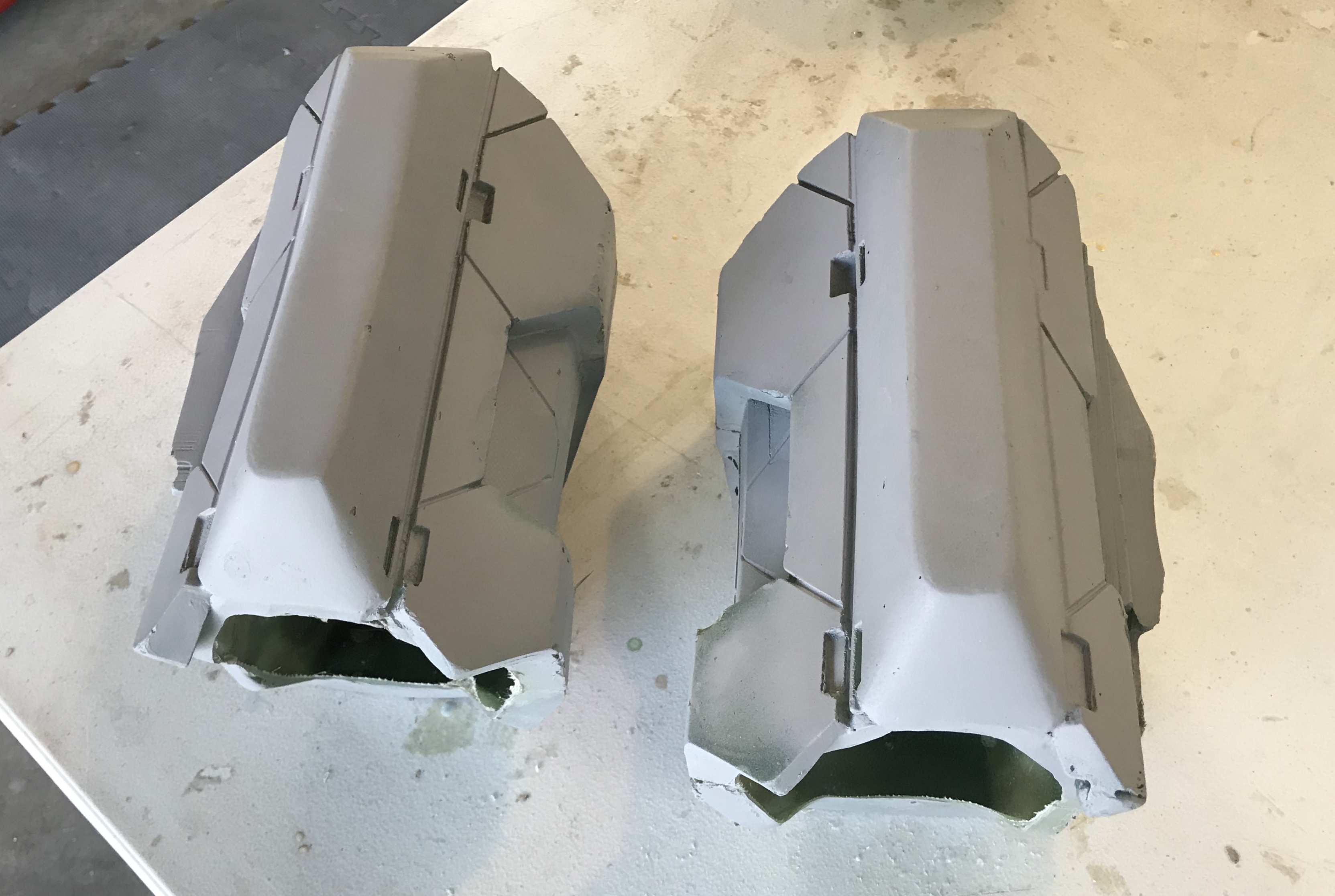

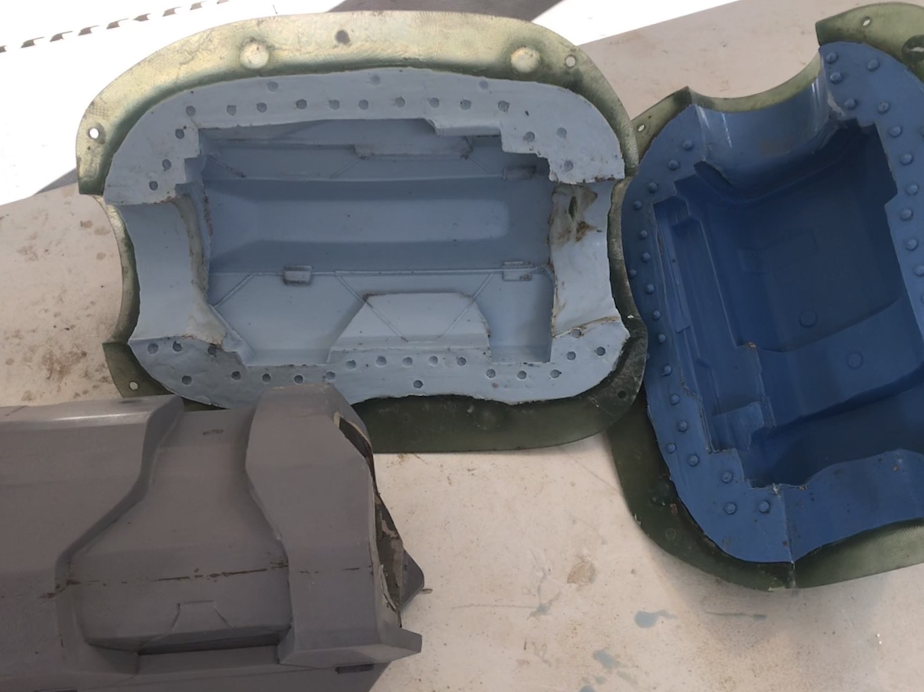

I have recently finished the gauntlet molds, and except for the chest/back, we have most of the parts to start assembling this beast.

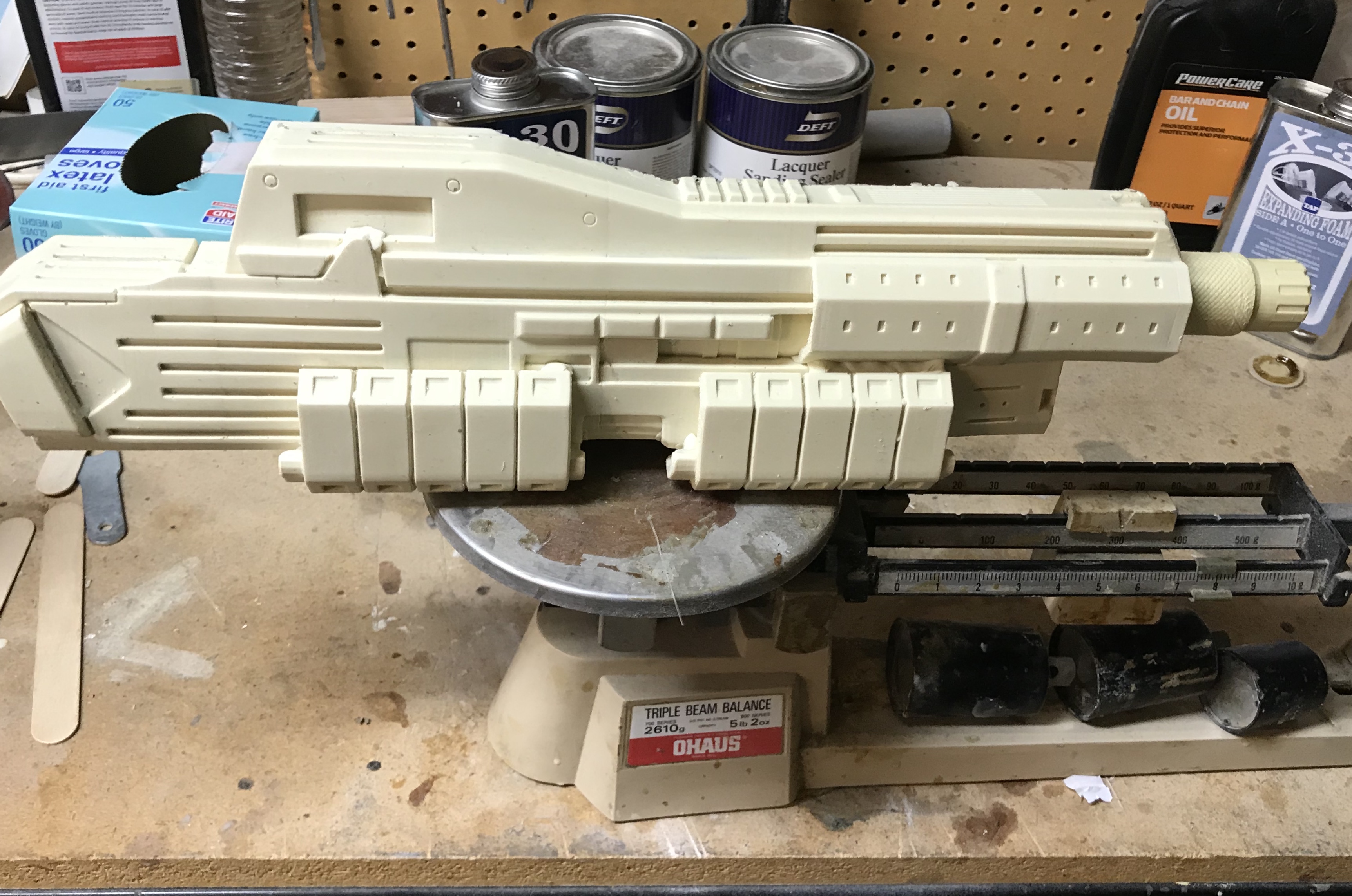

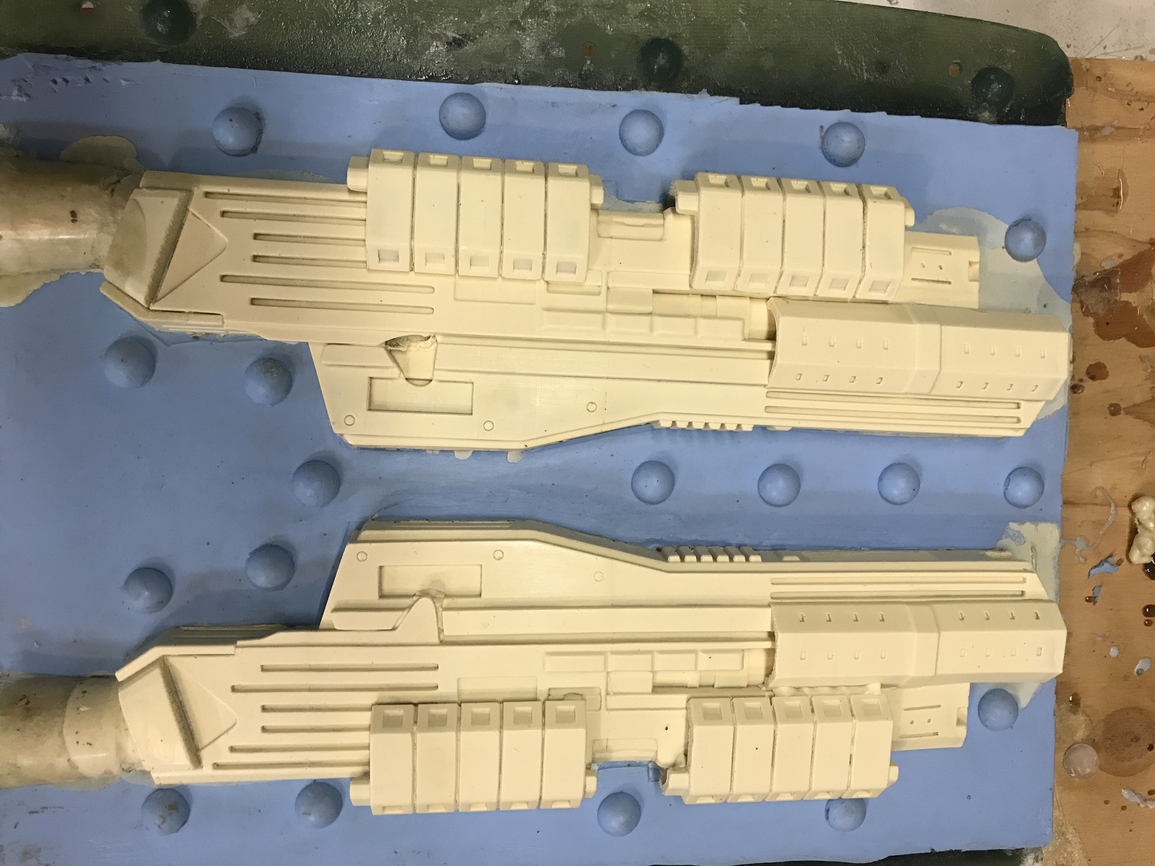

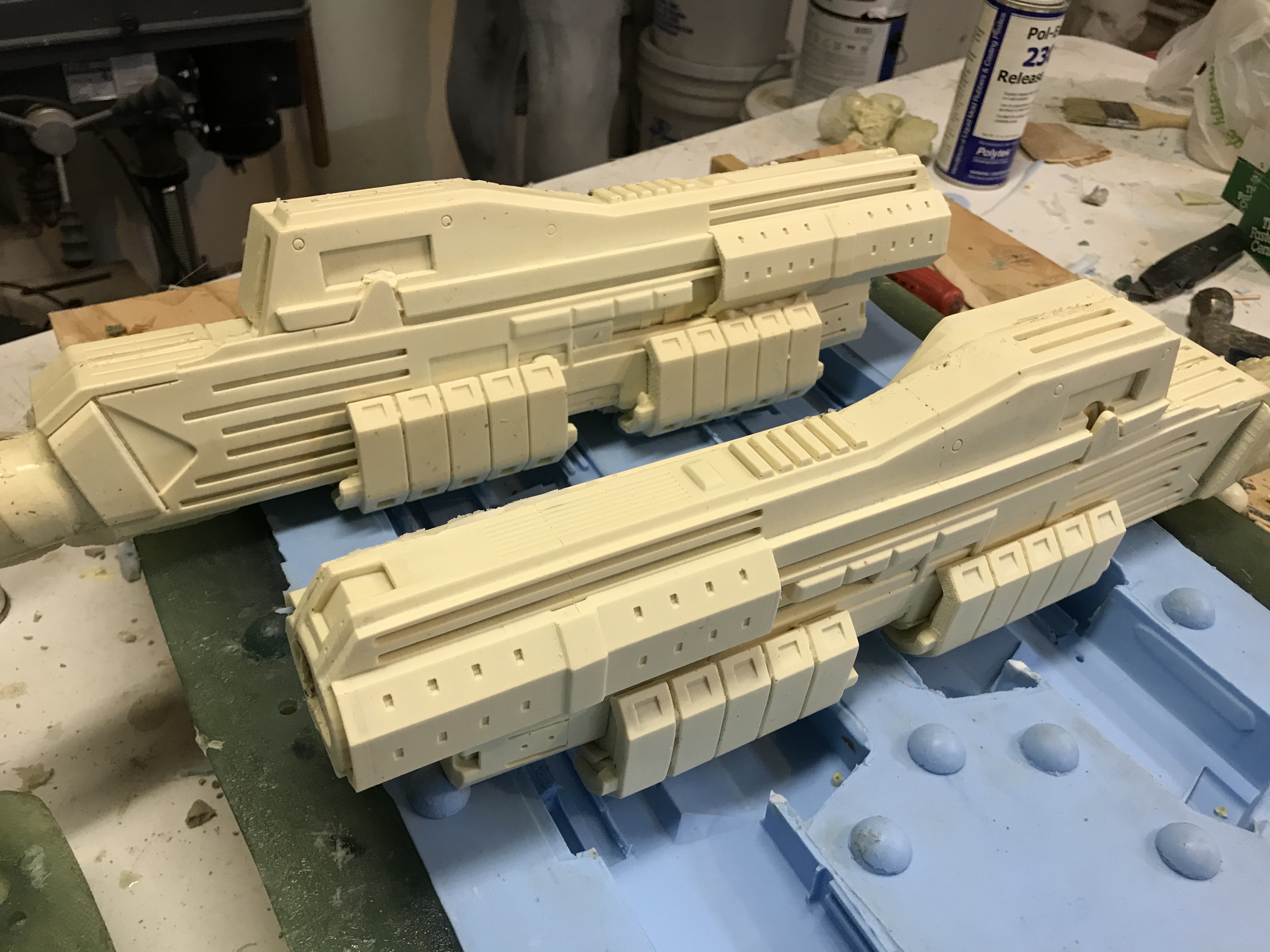

Update to this thread: I have just finished the mold for the arm guns. This proved to be a tricky mold to make. There is small detail and many undercuts.
My usual method of making a silicone mold would not work for me this time around. The last of the 5 gallon bucket of RTV had sat in the garage for a California summer, and was partially cured.
this meant a brush-up mold rather than pouring in one shot into a case. In addition to that, there was some doubt that my first layer of RTV would cure. I used the last of some old catalyst and I let it sit longer than usual before opening. The RTV is a little soft, but it cured.
I had to run to TAP plastics for some expanding foam but I think the result is something I am happy with.
weighing in at 308g, this is a 2lb foam-filled resin roto cast part. It picks up all the detail and there are no voids in the casting, so I can call this solid!

Amazing work guys! So, how much would this weigh if you put it together from the original material you used on the CNC?
