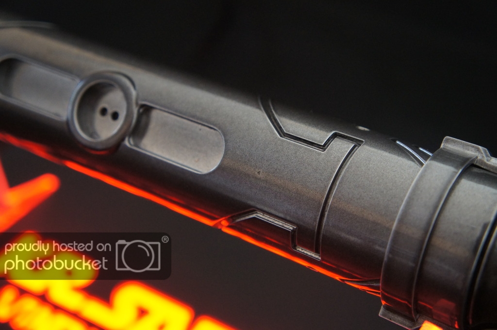

This was a heck of a project and a year in the making! I finished it off a few weeks ago.
More information of the log can be seen on my FB page. (www.facebook.com/krsabers).
This saber has been a production from start to finish and so many hours were put into it!
I just want to give a shoutout to Darth Ryo of GOTH 3Designs for the custom chassis! 'vous mon frère!'. Also DarkLyte stands for the sweet stand!

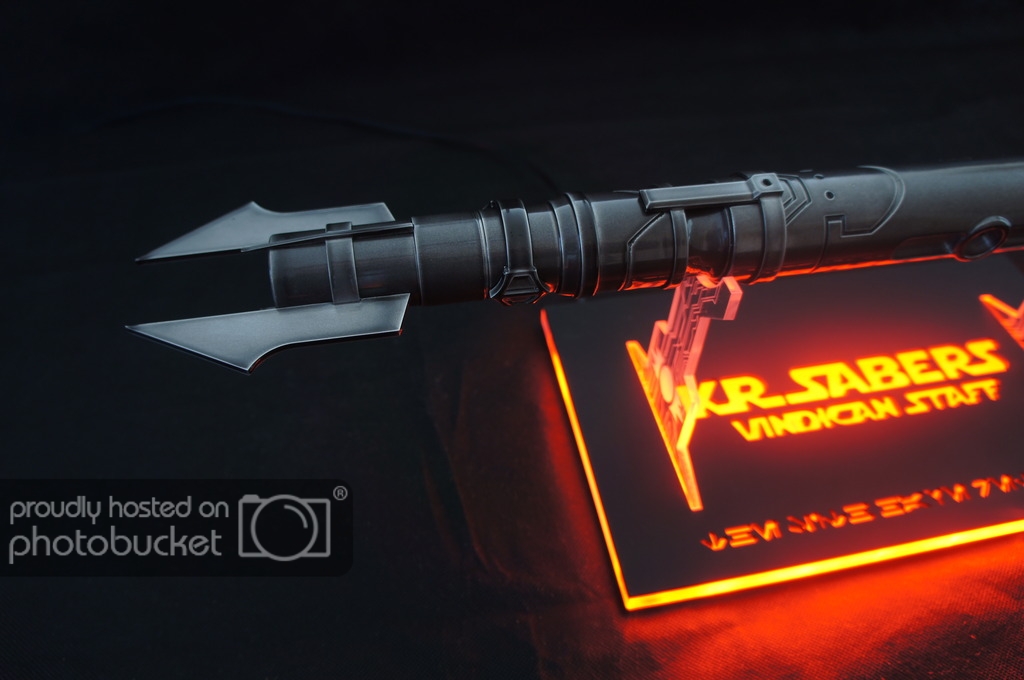

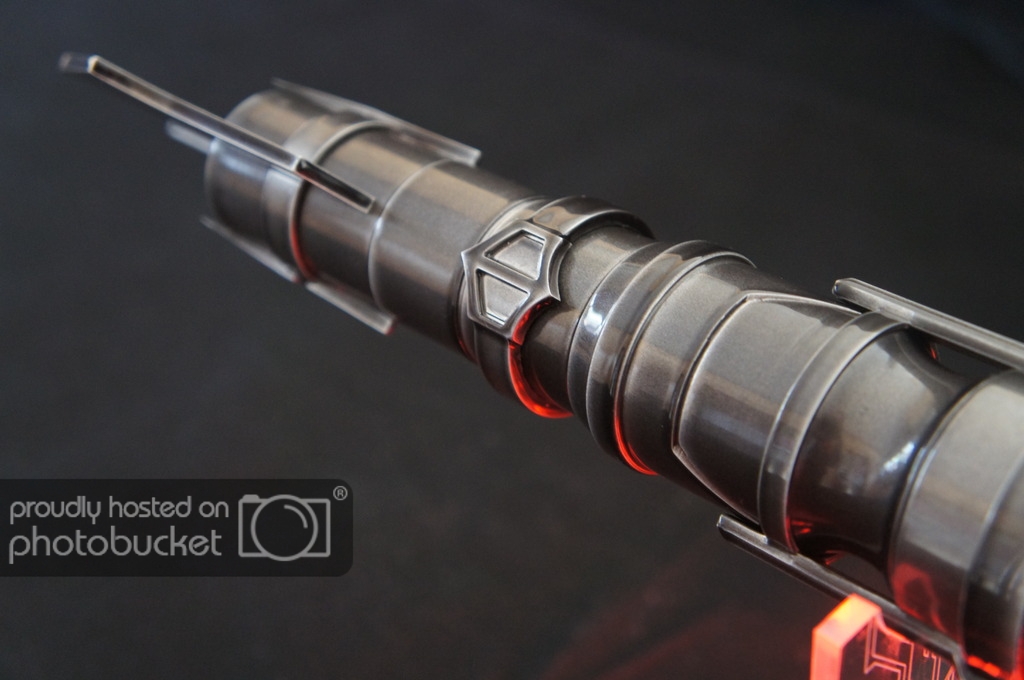

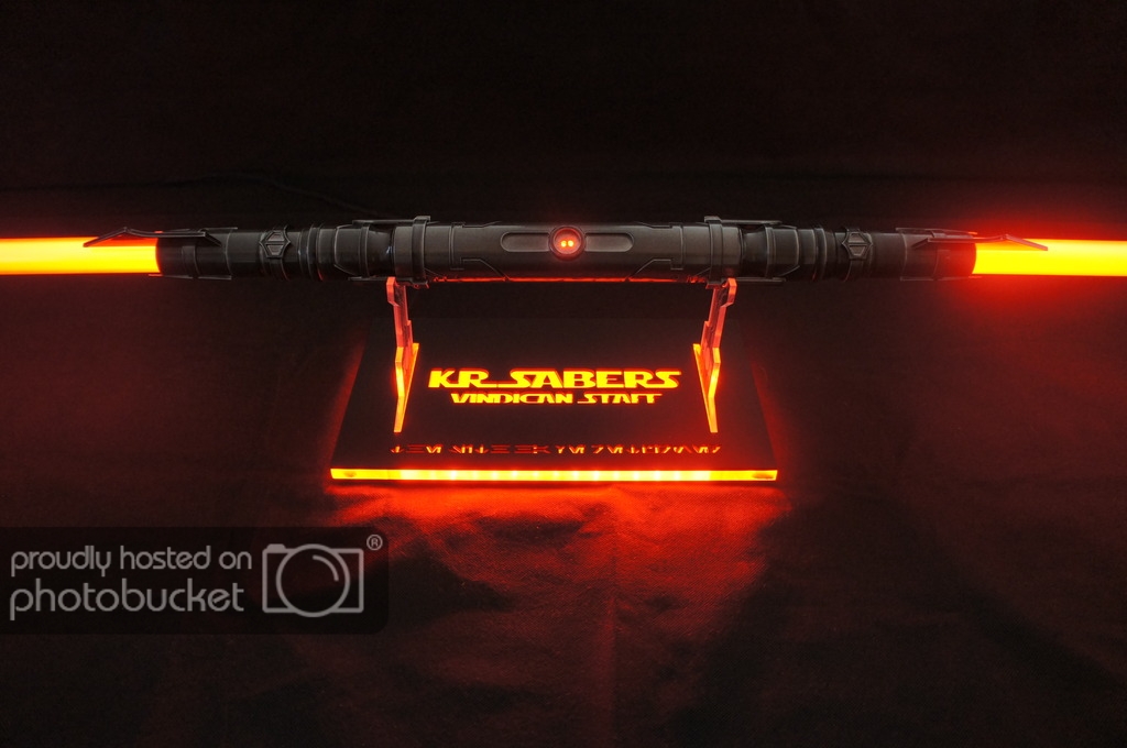

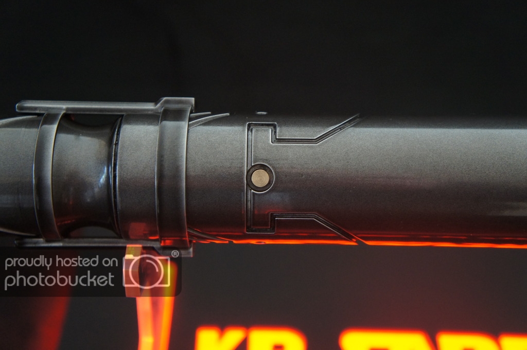

Checkout the specs and picture below guys! I'll stop blabbing on!

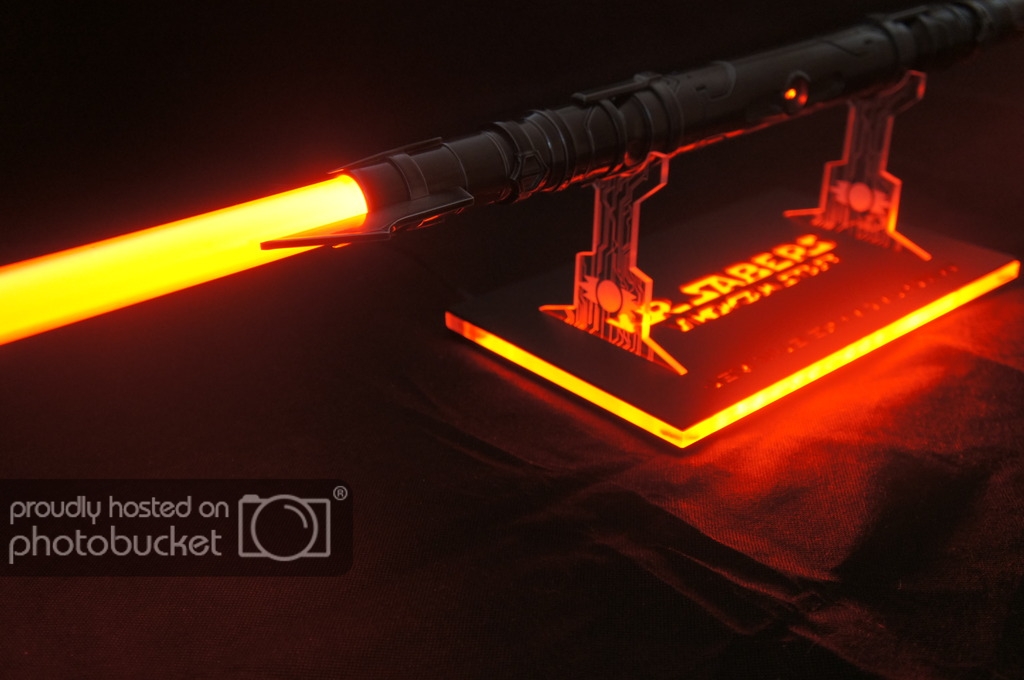

Specs:

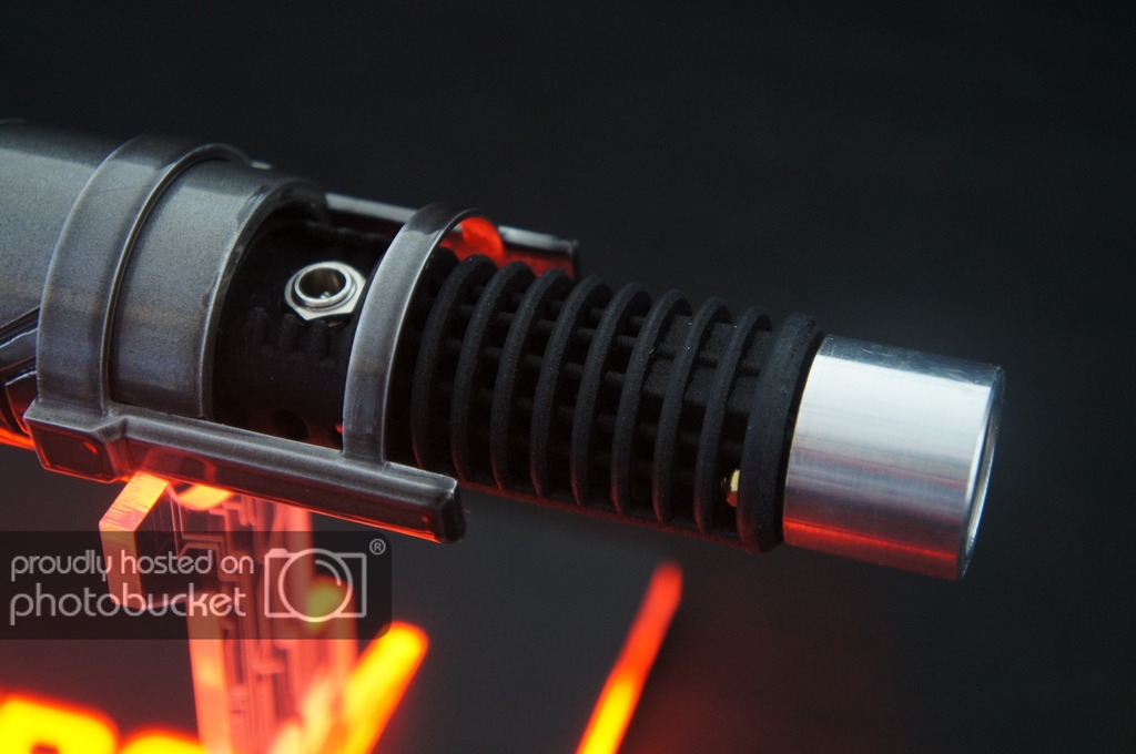

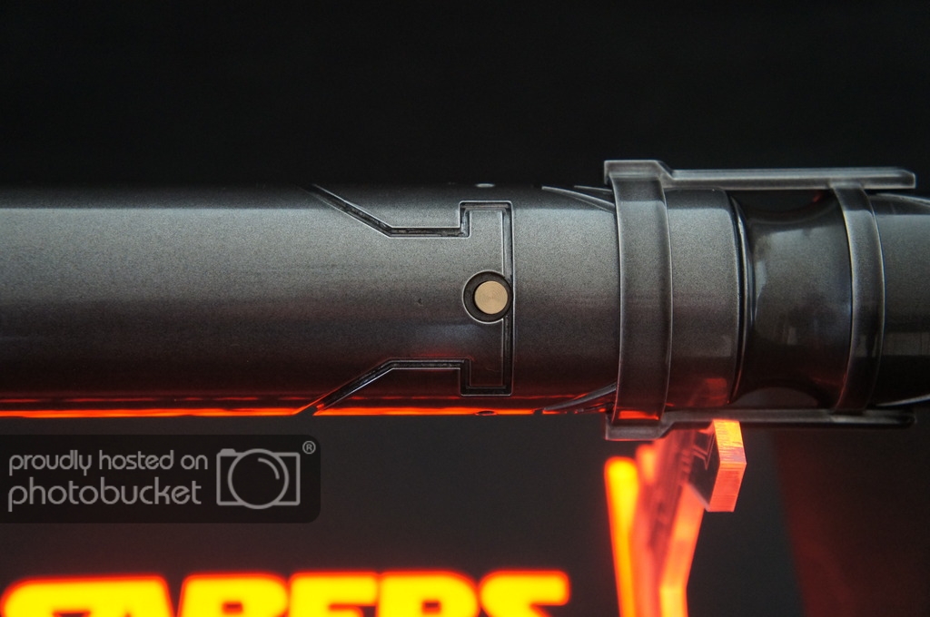

Fully Custom KR Sabers CNC Machined hilt. 6061 Aluminium. Powdercoated For A Durable Finish

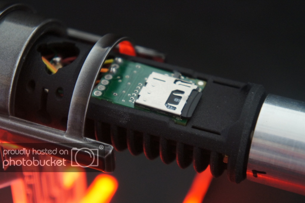

Dual Nano Biscotte v2.0
White Flash on Clash W/ PeX

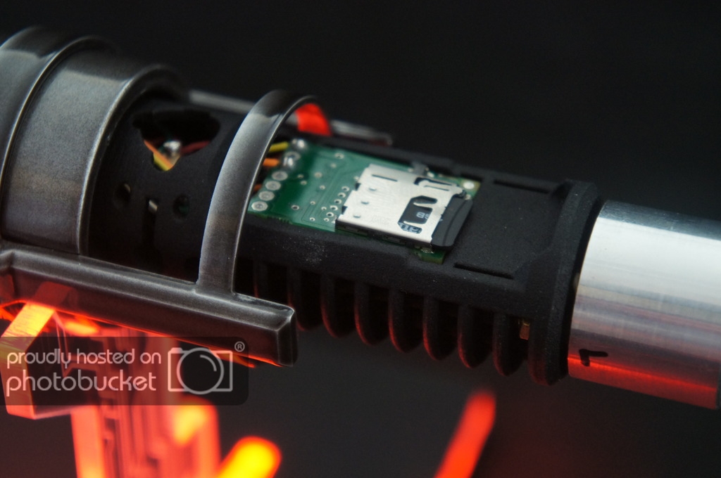

Fully Custom 3D Printed Removable Chassis System Courtesy of GOTH 3Designs
Magnetic Removable Brass Switch Hats
Dual Tri Cree RRW
Dual 3mm Accent LED's Ignition Triggered
Dual 18650 3.7v Li-Ion Pack
Dual 20mm TCSS Speaker
Hidden Sound Venting
Dual 2.1 Recharge Port with 'Twist' Kill Key System

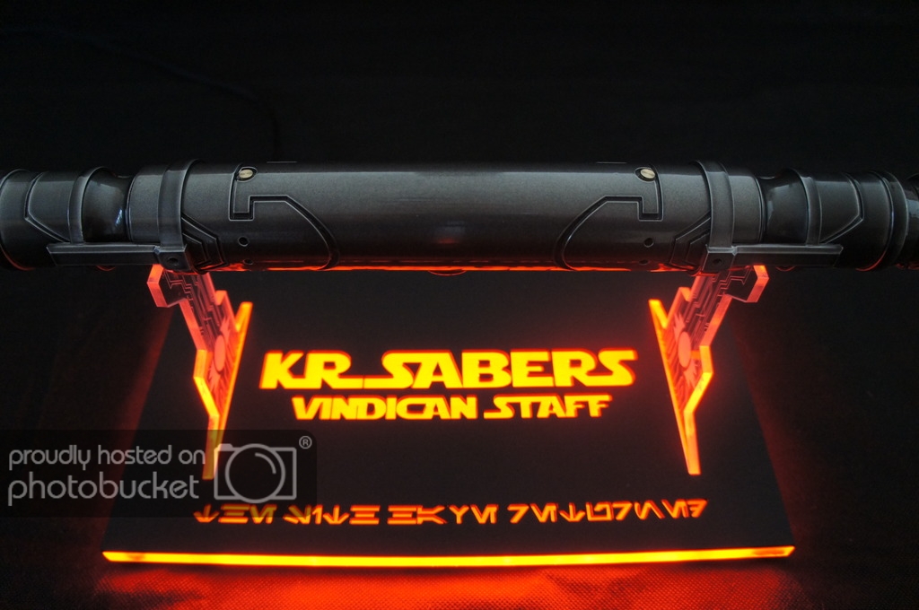

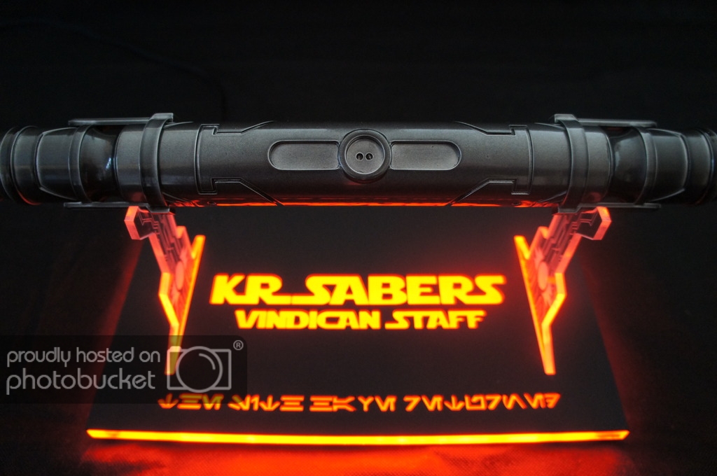

Fully Custom Stand Courtesy of DarkLyte Stands. Aurebesh 'The Sith Have Returned'
Korriban & Revenge Sound Fonts Loaded
