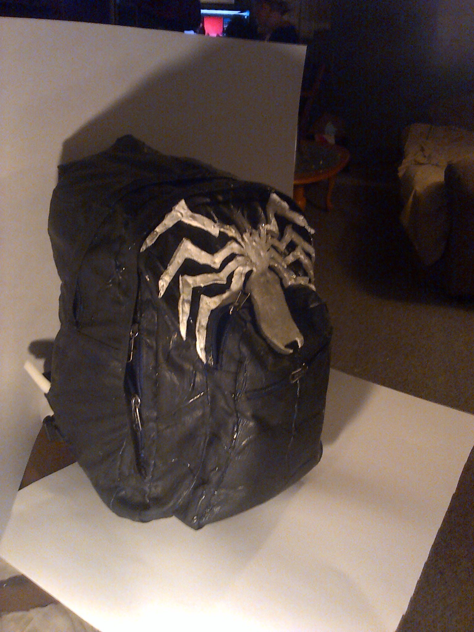

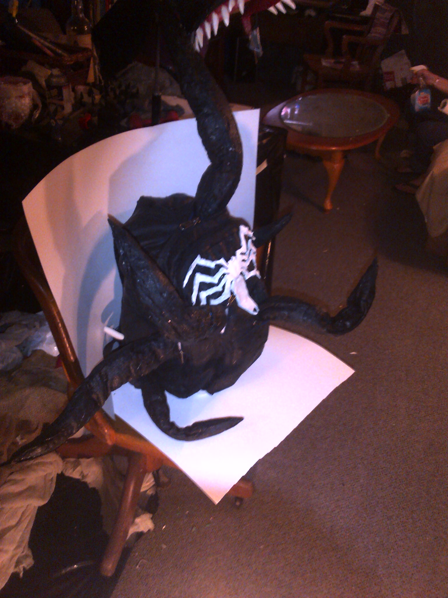

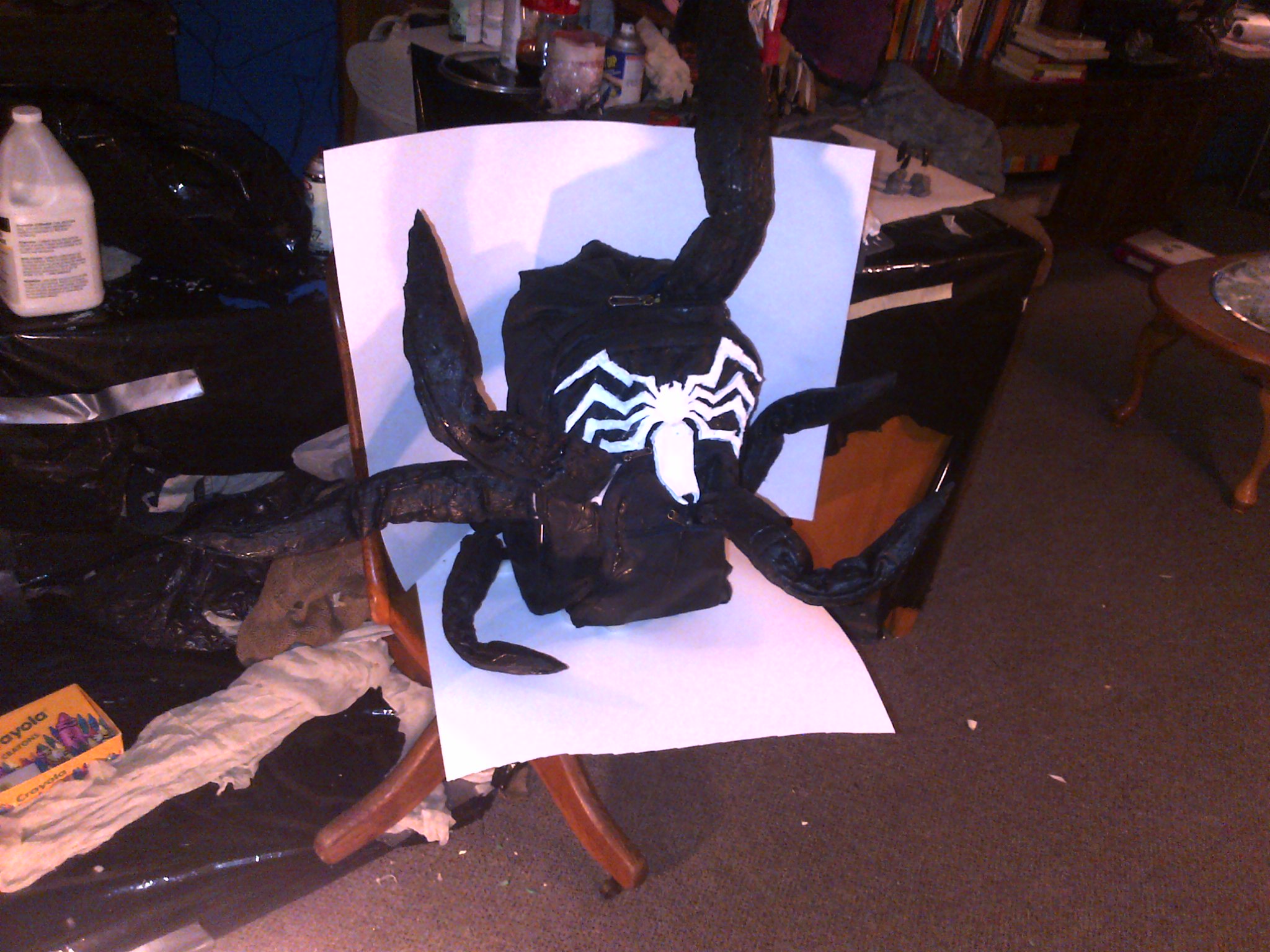

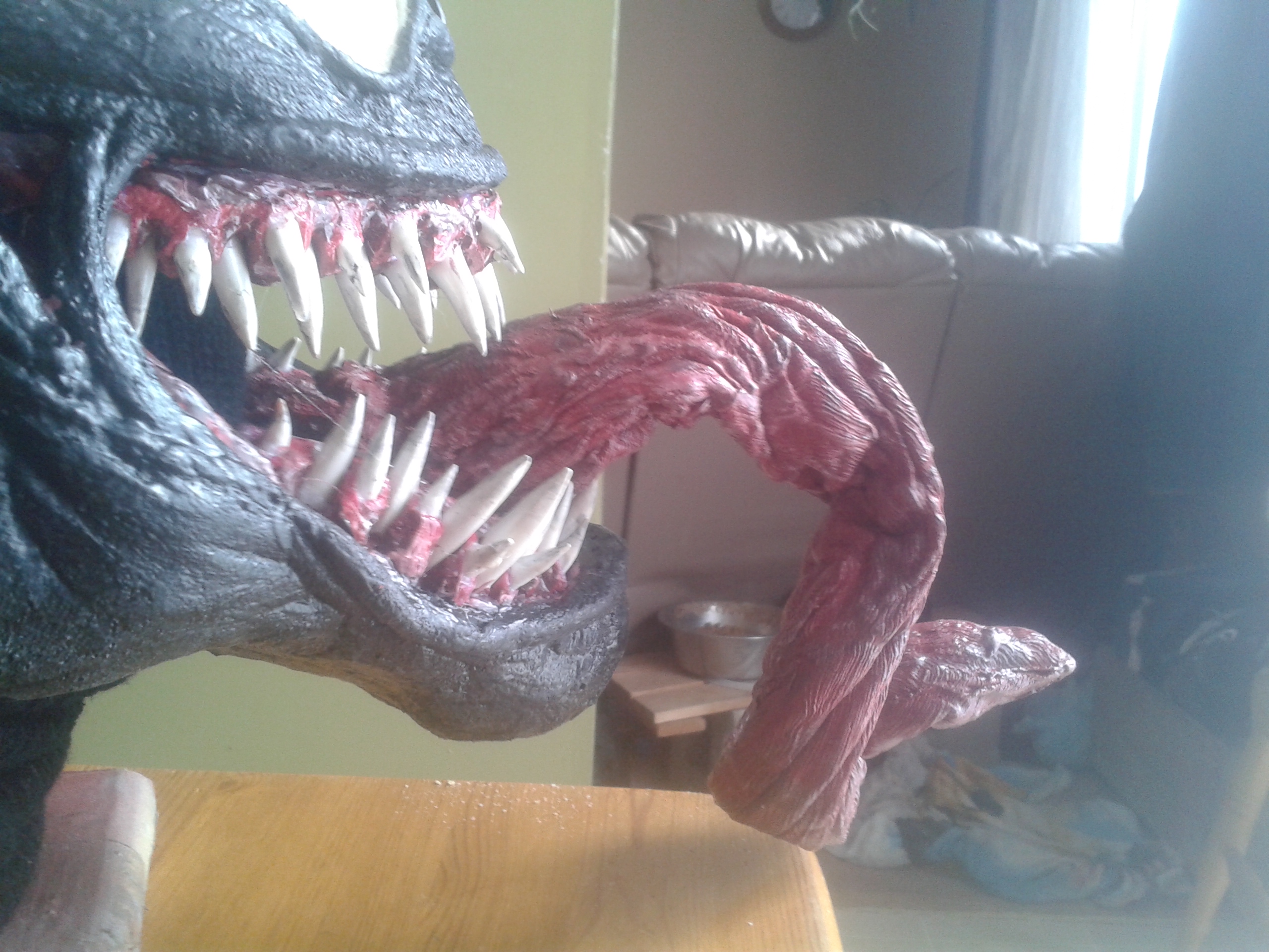

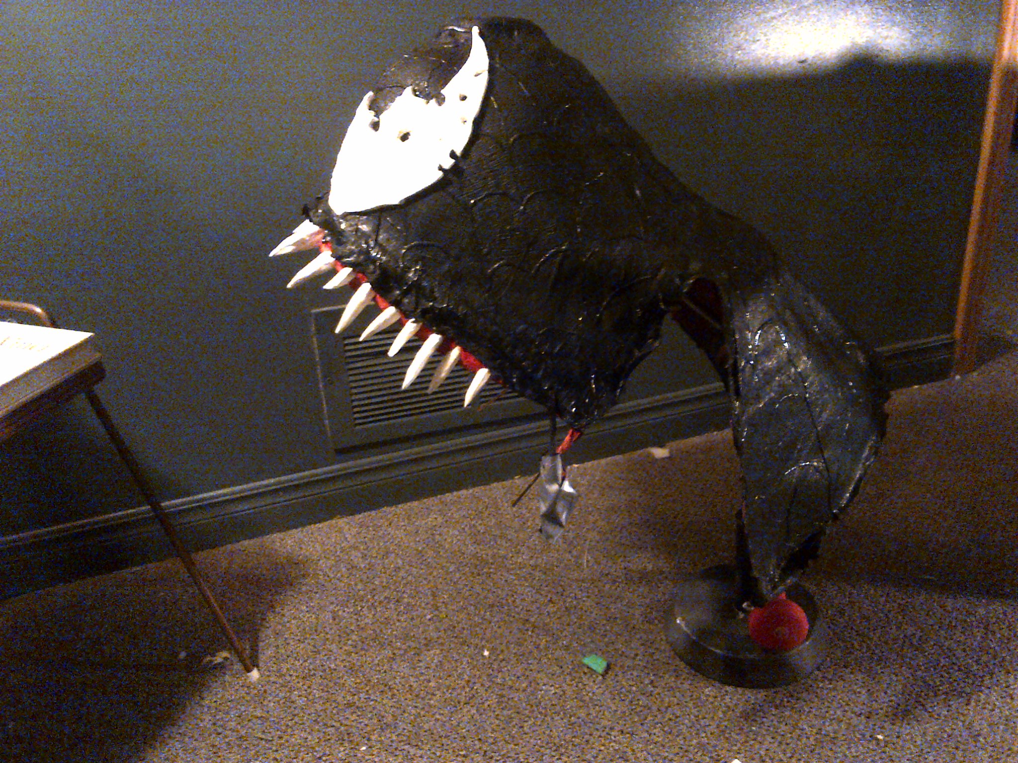

custom backsac, Venomized....
latexed the exterior added webbing, fabricated tendrils that come out of bag and are fully poseable

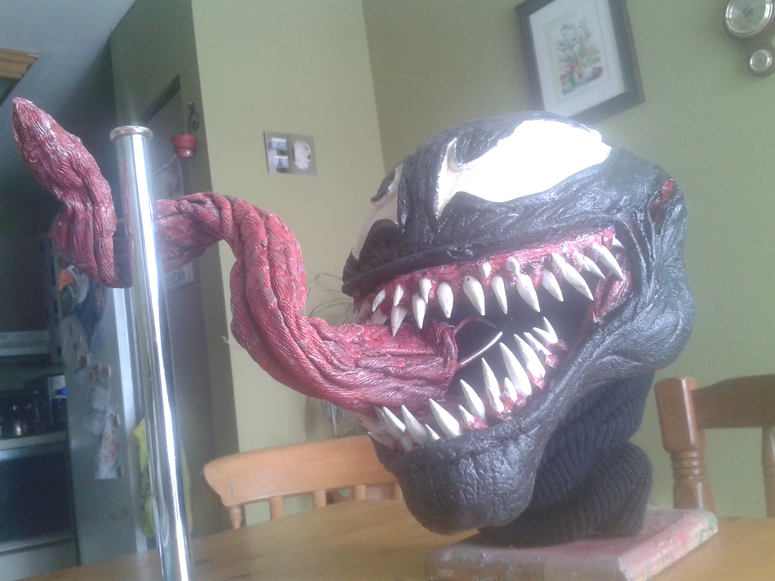

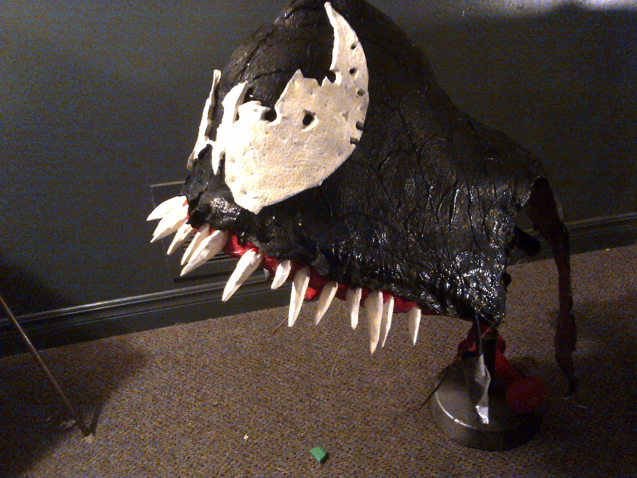

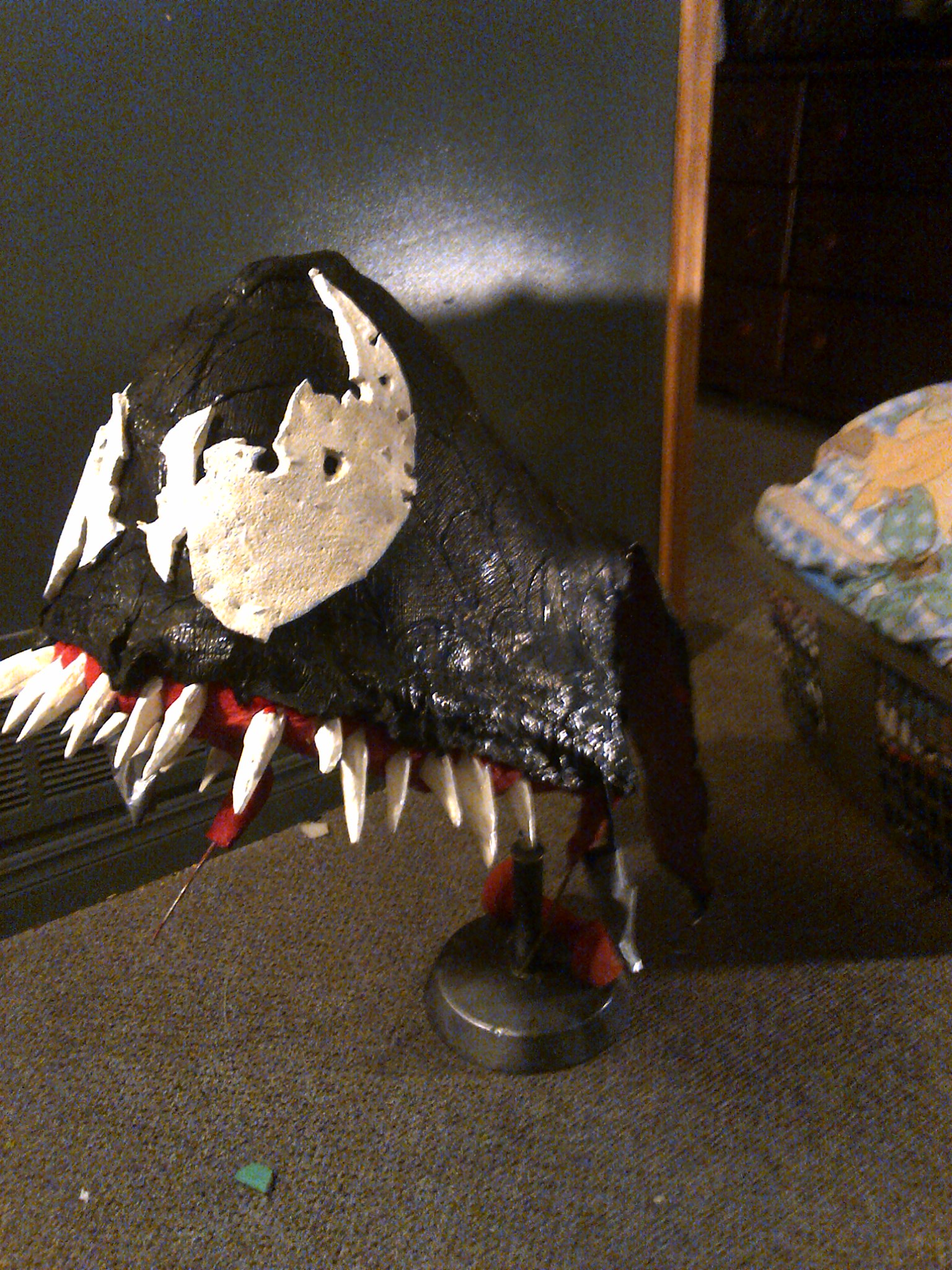

made a venom hood which i may attach with snaps or permanently..? not sure yet.
the hood is poseable and can be made to snarl , close..or bite when you pull draw strings.

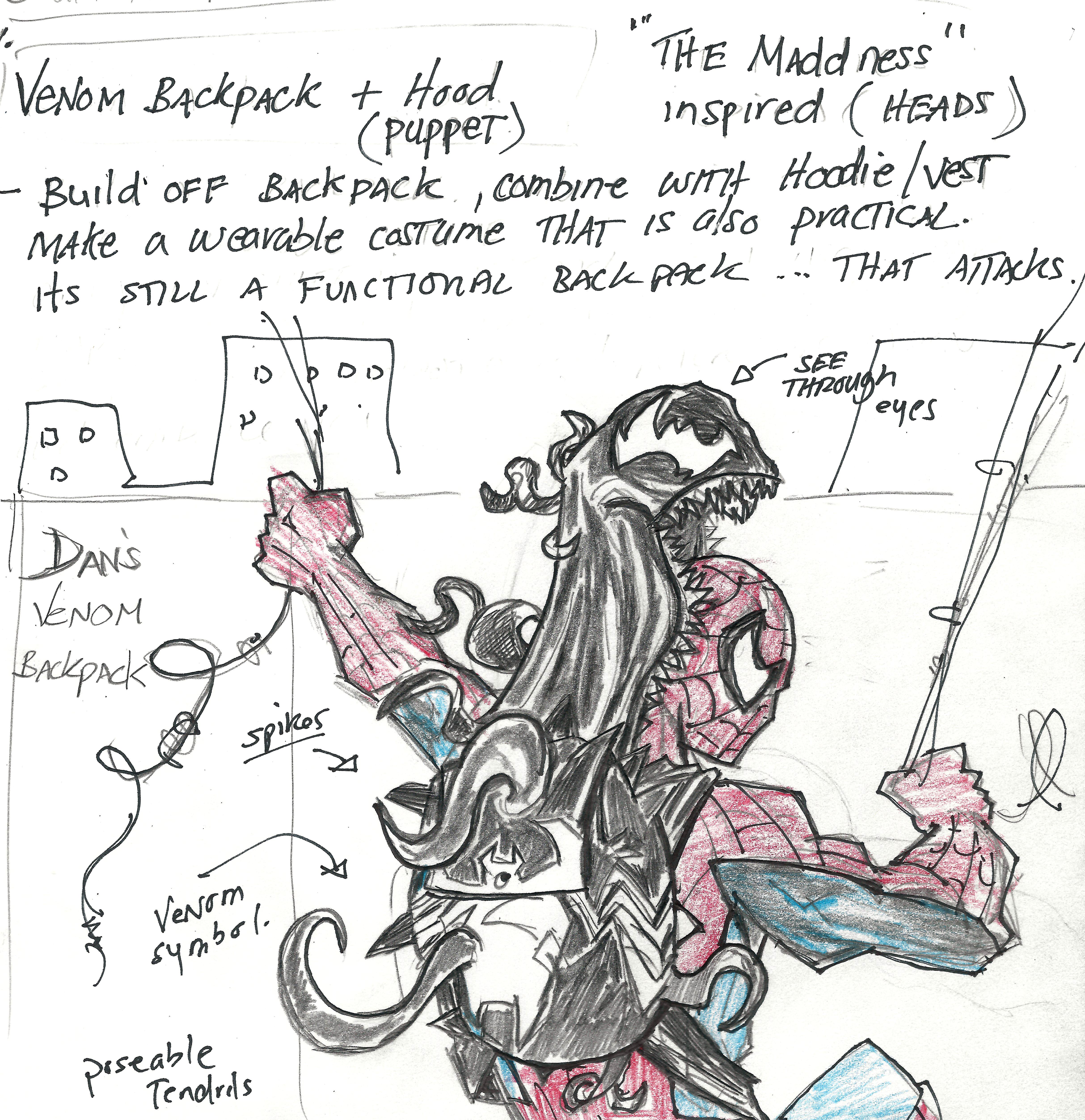

the idea from a sketch i did a while back of a cool wearable prop/costume. the client you decided to go with it will be in a spiderman suit with this sac and a hand puppet im constructing now of a carnage symbiote ..so spidey is havin a bad day..but looking cool doing itView attachment 5ioFbXcl.jpg Perth South-20140920-01524.jpgPerth South-20140920-01529.jpgPerth South-20140920-01530.jpgPerth South-20140920-01531.jpgPerth South-20140920-01538.jpgPerth South-20140920-01539.jpgPerth South-20140920-01542.jpgView attachment carnage puppet sk1.3.jpgPerth South-20140920-01535.jpgPerth South-20140920-01545.jpgPerth South-20140920-01547.jpgPerth South-20140920-01537.jpg

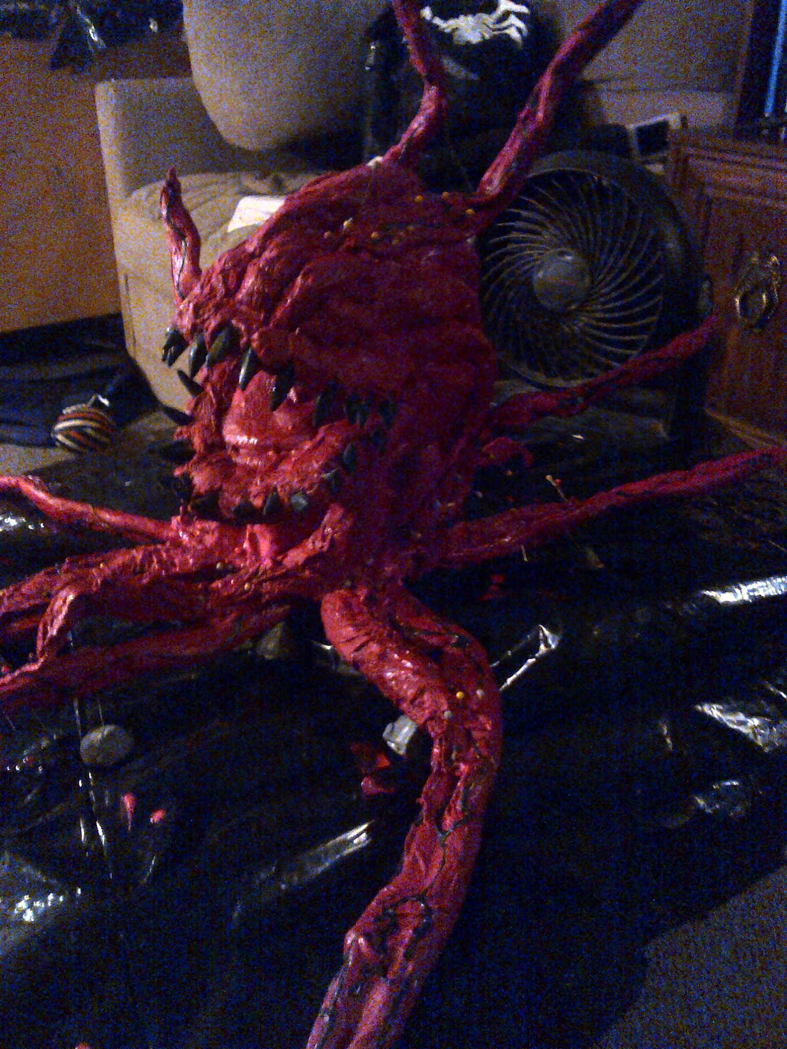

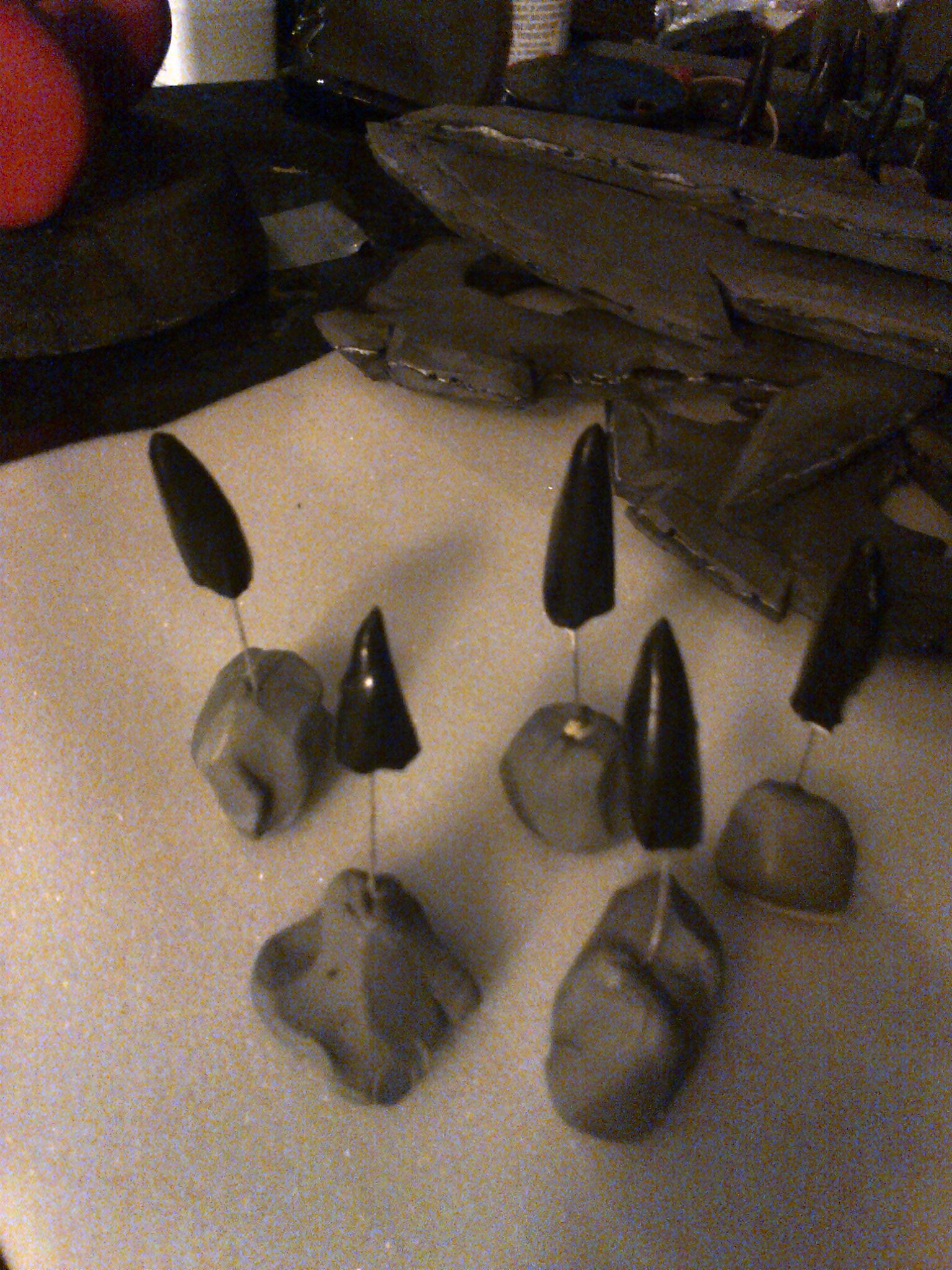

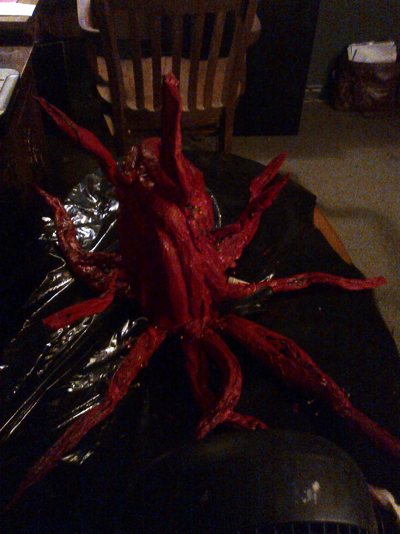

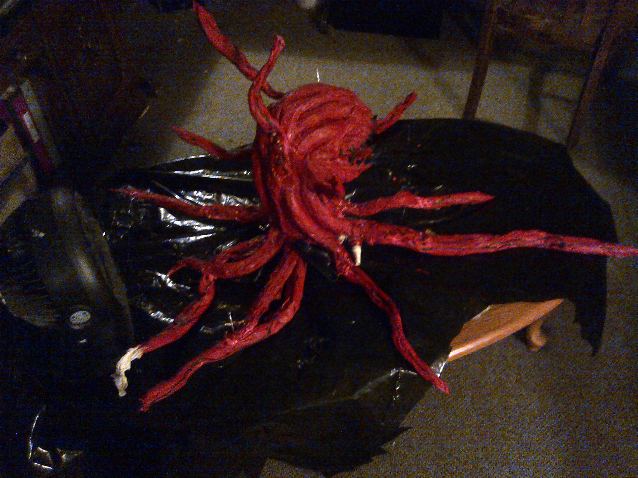

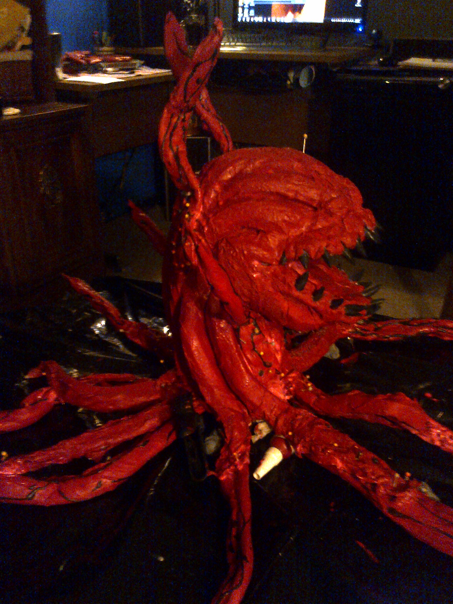

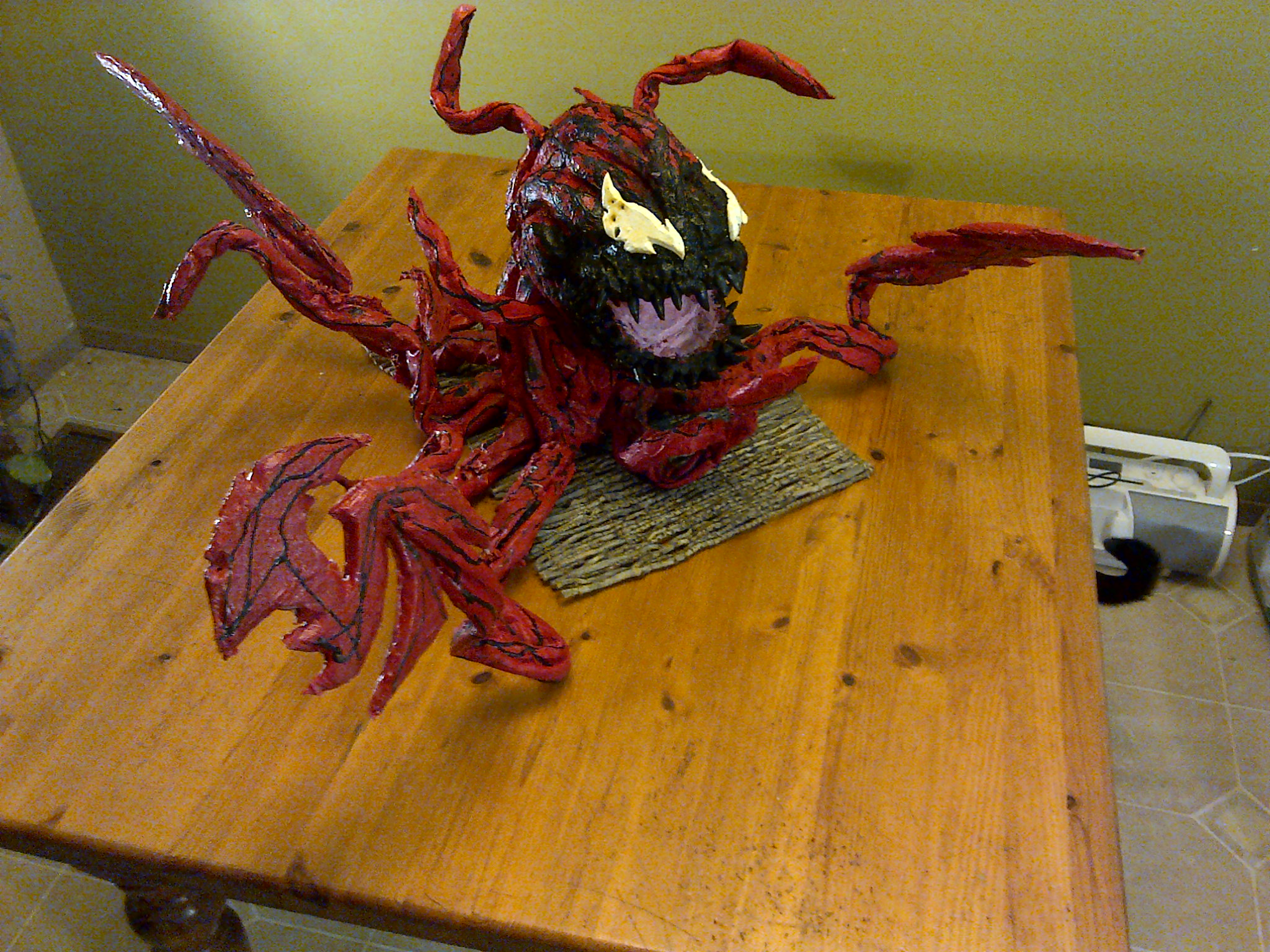

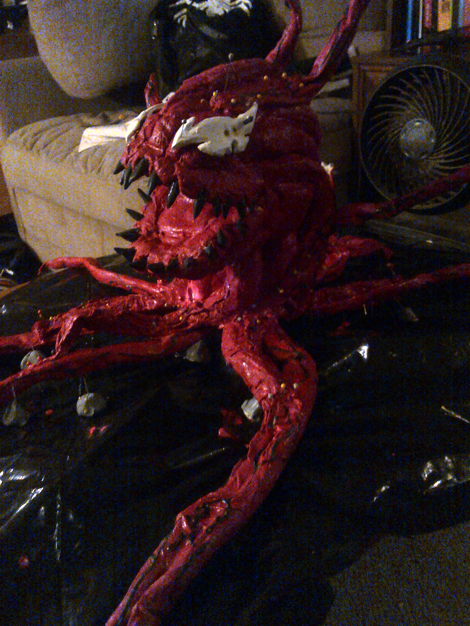

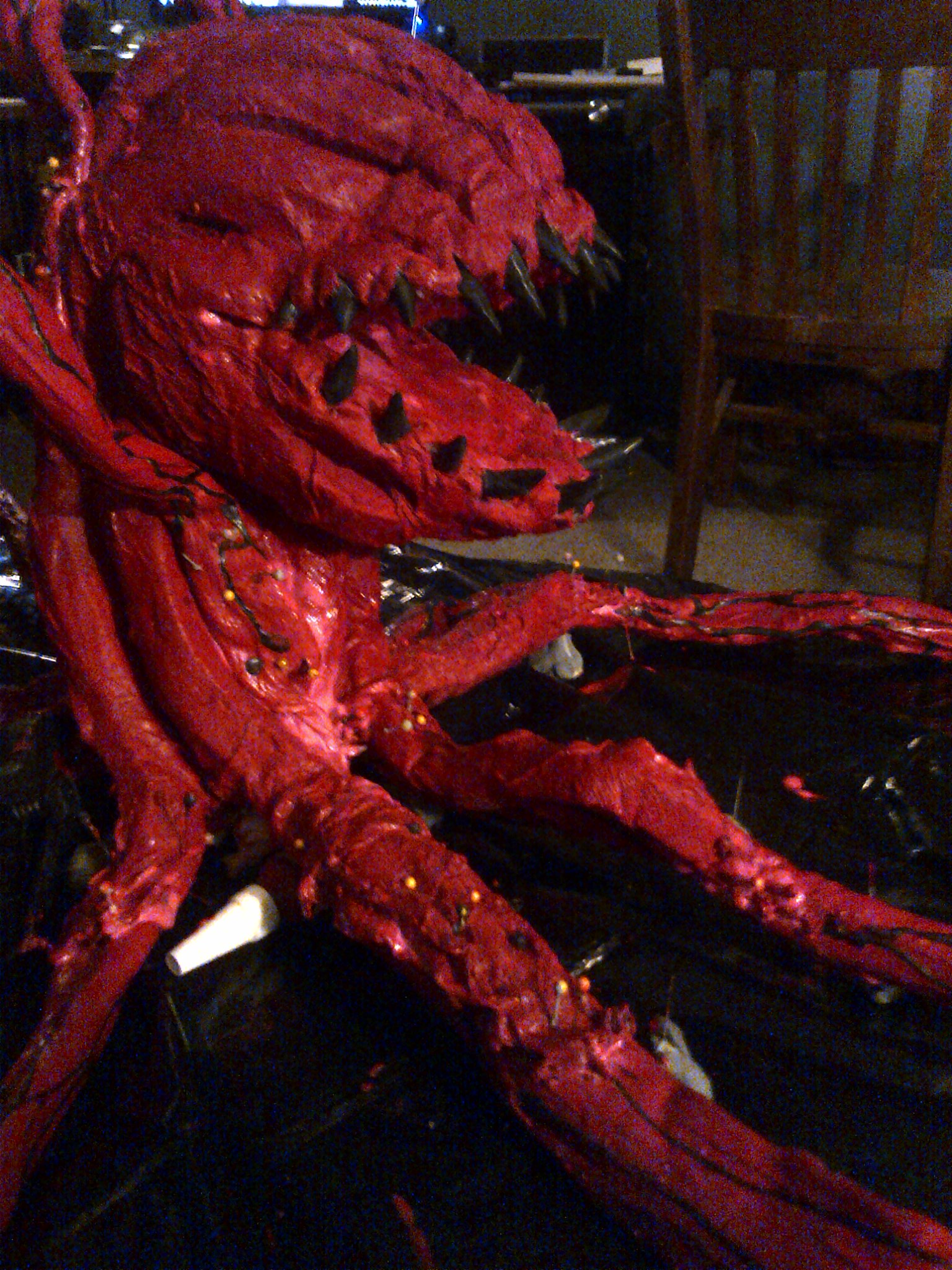

heres the carnage sybiote so far
interweaving tendrils, poseable .

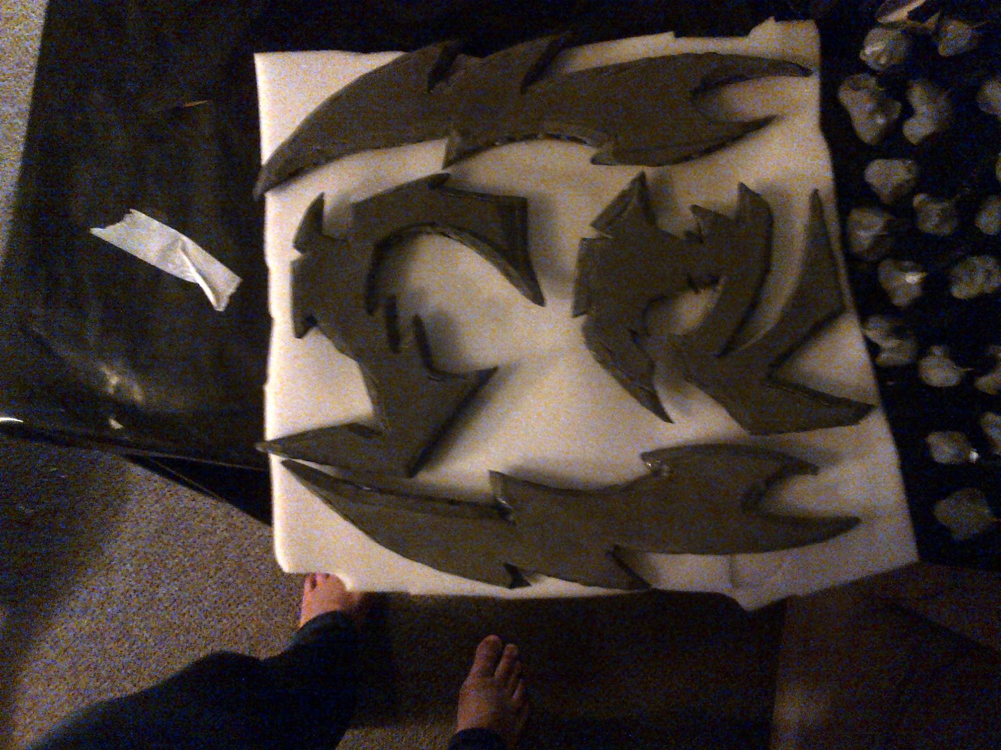

its drying in theses pics . i have to attach weapons and eyes as well finish paint,.
about 80 percent done, came out cool and is creepy as hell
oh its a puppet too. Stratford-20140923-01592.jpgStratford-20140923-01586.jpgStratford-20140923-01582.jpgStratford-20140923-01591.jpgStratford-20140923-01593.jpgStratford-20140923-01583.jpgStratford-20140923-01598.jpg

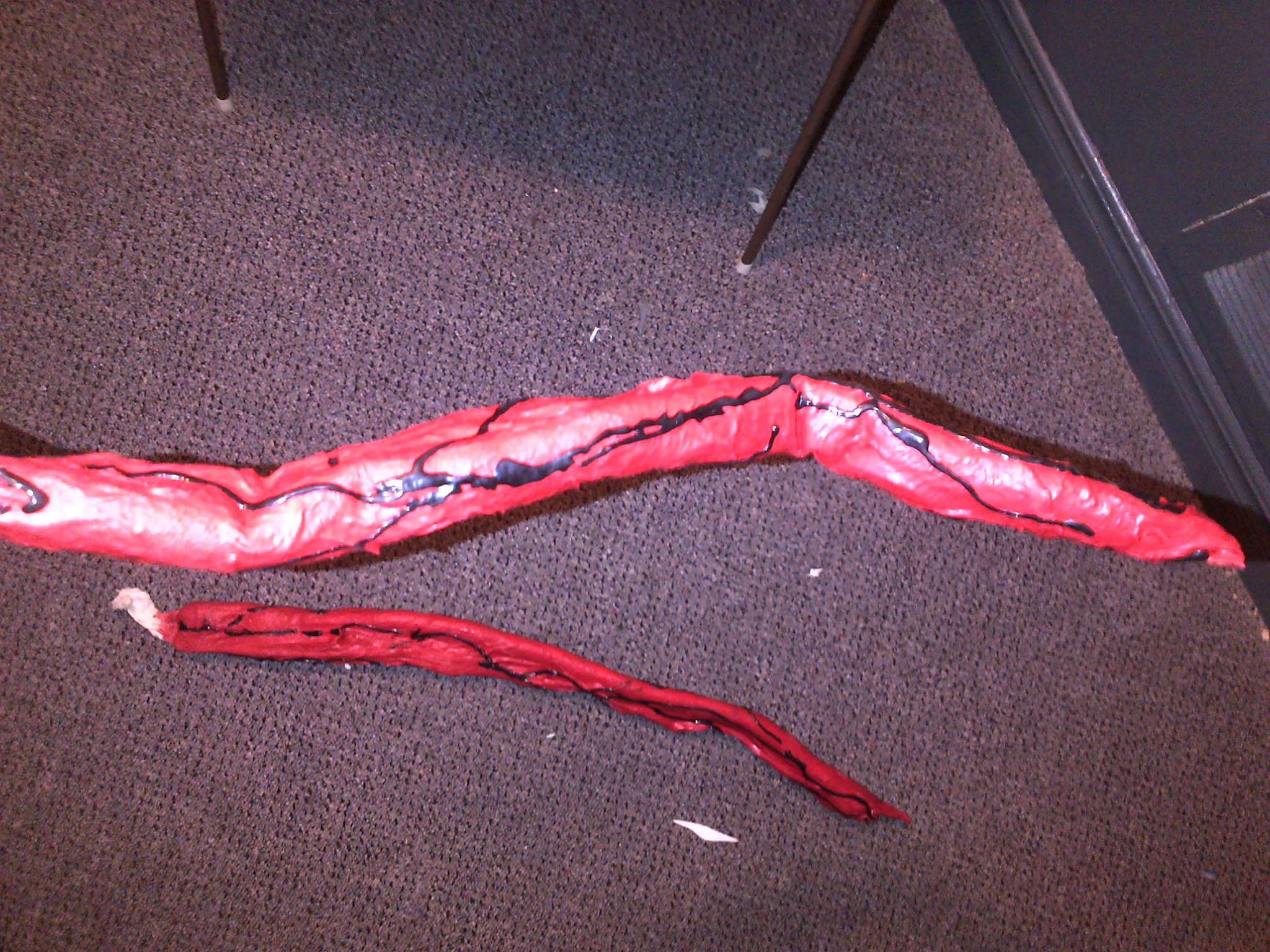

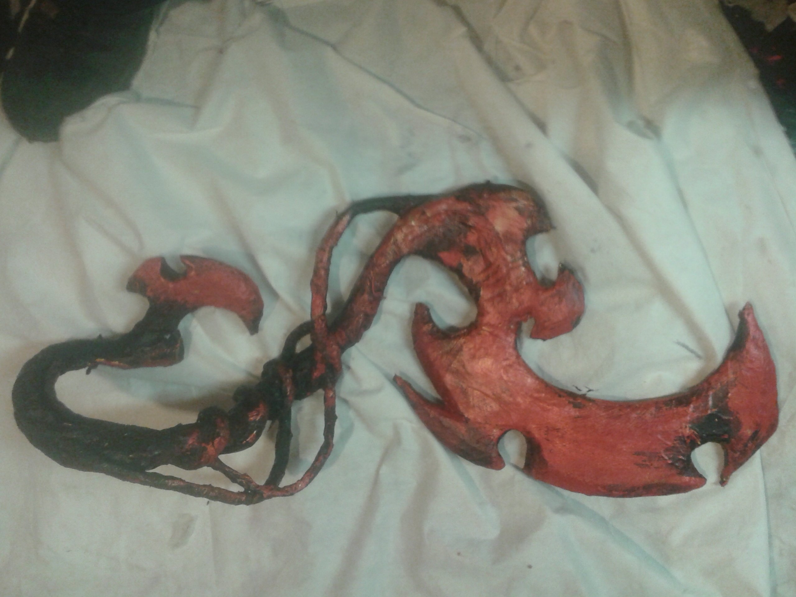

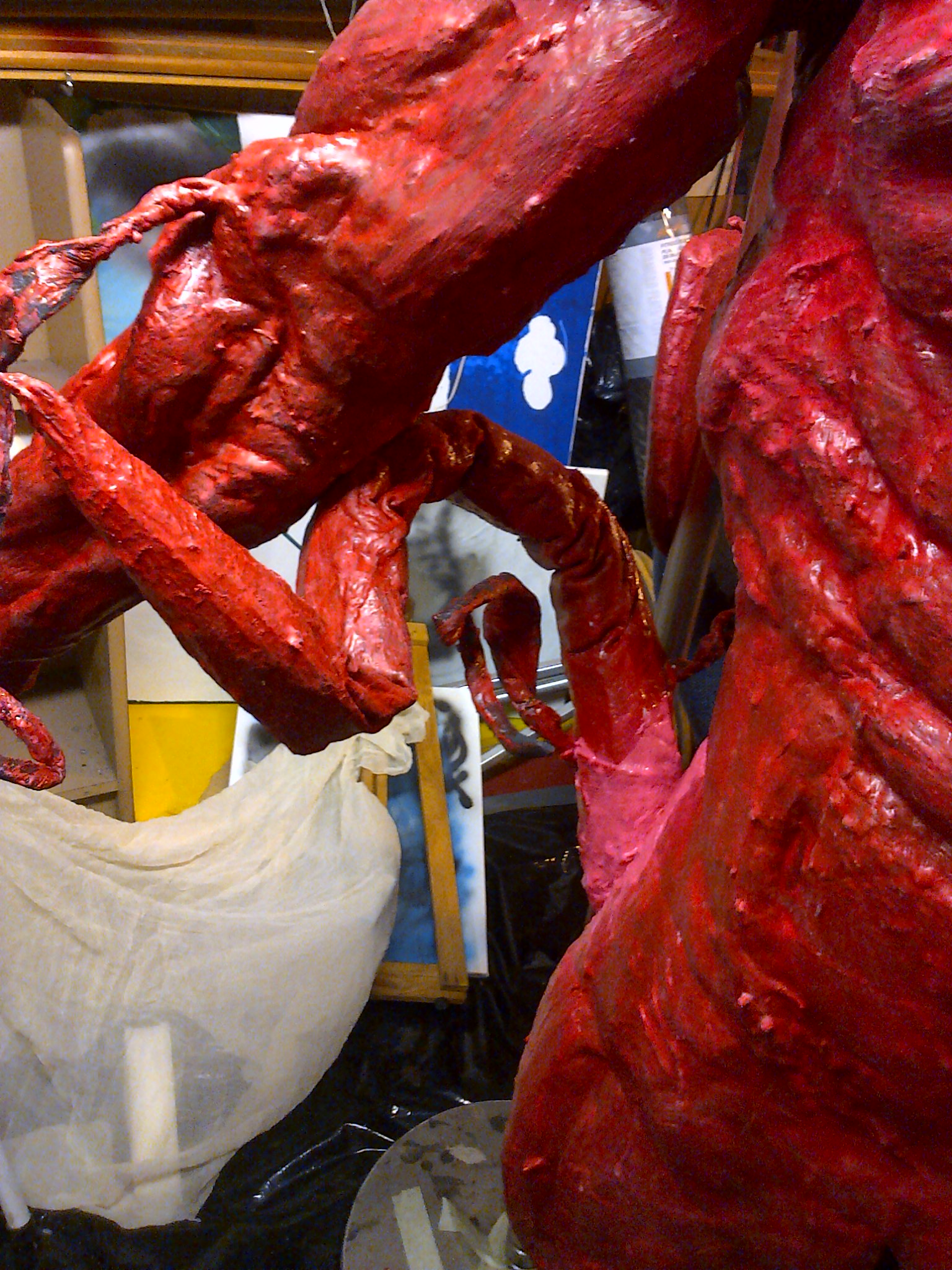

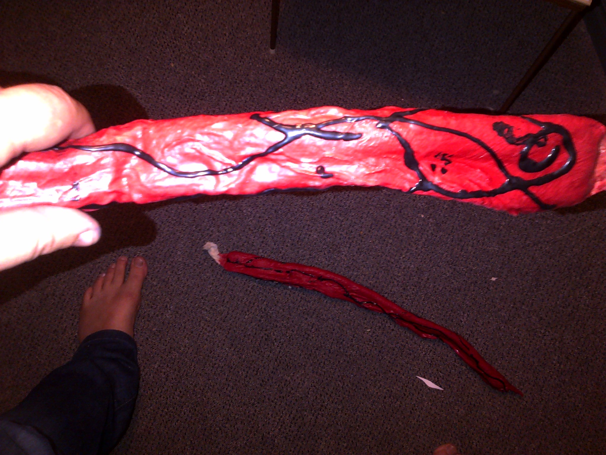

How did you make the tendrils? Those are both really cool!
i used armature wire, but a wire coat hanger will work just not as poseable. then i put fabric sleeve on it then inserted in a strip of foam. i sculpted foam tendril then spray glued fabric then a latex skin and paint.
heres some examples of this technique ive used so far20131209_141656.jpg20140227_094948.jpg20140227_100514.jpgStratford-20141030-01770.jpgStratford-20140924-01600.jpg
