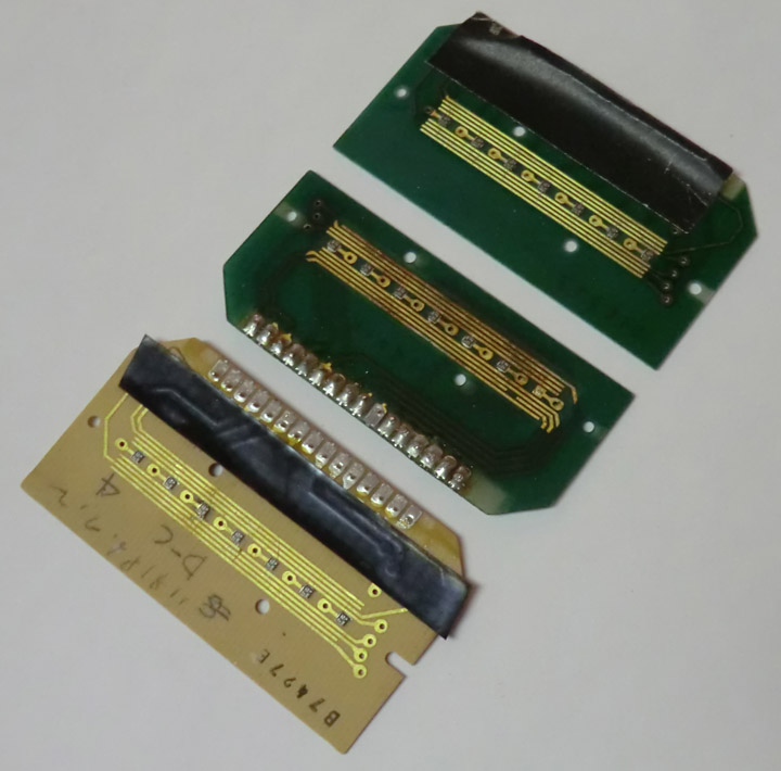

I was curious, so I busted out my last four Ti20s and wanted to see what color base cards I had
You can see there are three distinct colors here... I don't have a blue unfortunately.
Shine a light through and you'll know if you have a blue one or not. I thought one of mine was green until I did this due to the solder mask and it being pressed against the other calc parts.
The first close up is the one I would question.
Yeah, Scott the first is exactly what mine looked like when installed. The solder mask goes right up to the bubblestrip, so it wasn't until it was off when I finally went "oh, cool." And I'd had that particular calc for two years already...

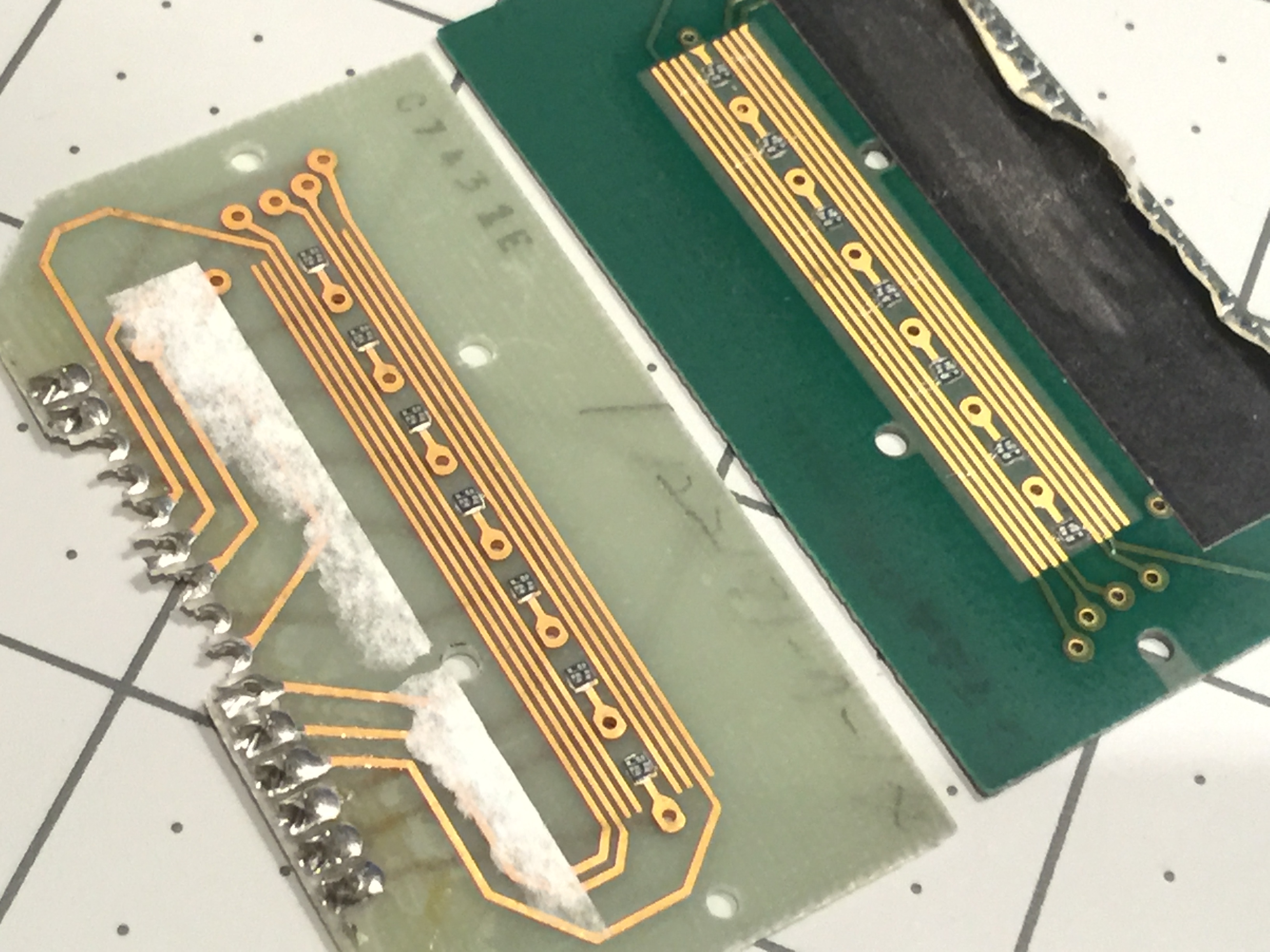

Here are mine. One is the same TI-20 as Scott posted above, so I got em all out and shined a light through the backs of each board to see if I had a blue one too. They're all green.
(Also, all are non-frosted with flat bubble edges.)
The solder mask on the board in my Exactra 20 had not been applied correctly, not covering the bottom of the blue circuit board substrate.
I think also that it looks as if solder-mask wasn't supposed to have been applied around the bubble strip's rightmost rivet. It could be easier to look there than through the bubbles to find the true colour of the board substrate.
