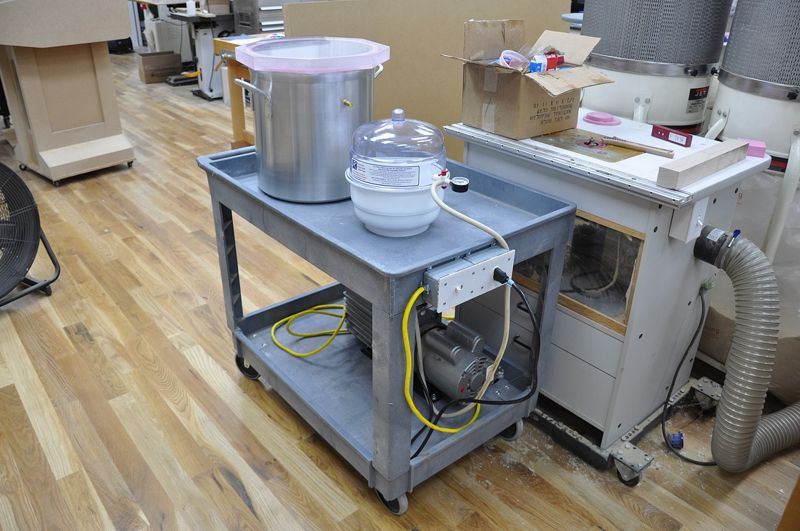

This is my vacuum rig cart. It has the small vacuum chamber I got from my local smooth-on dealer, but it only does about 16oz at a time due to the massive expansion when degassing. The large one is a thick cooking stock pot with a thick piece of acrylic on it that I cut a groove in and filled with mold rubber. Then I just drilled and tapped a hole for a brass fitting to hook stick the vacuum hose on. The pot is sized to comfortably hold a 5 gallon plastic paint bucket.

you have all the toys philip, nice set up.:thumbsup
