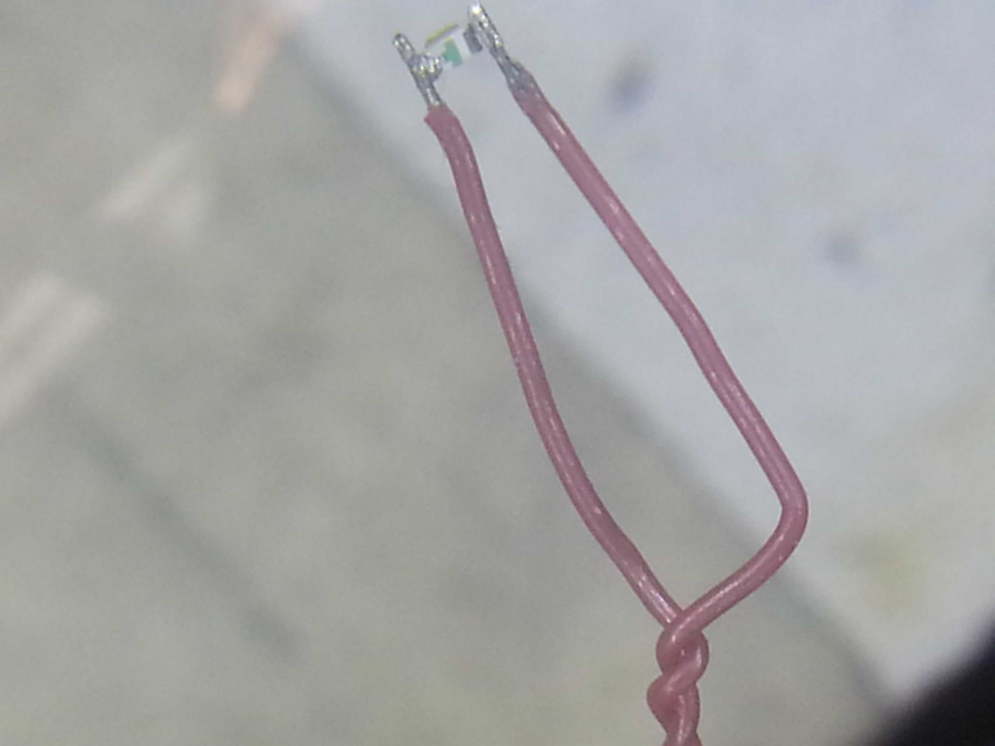

Orbital Drydock, which kind of wire (and which diameter) did you end up using? Can you share a picture of it? It's hard to translate the exact names from English for me. Is the connection durable enough for mounting it into the model? And most important: How did you manage to kill 5 of them? It seems as I was lucky, didn't kill one, it even survived a flip onto the hot soldering iron and resting there for a second or two... If you can tell me what to avoid, it would surely help for further experiments ;)
I used 30ga wrapping wire. They are very fragile, but I think they can be mounted if you're careful, though it will be tricky. After soldering I pinch the wire & twist it, to help relive stress on the solder joints. My biggest problem was that the pads on the led pop off easily if the wire is moved around too much after soldering, twisting the wire helped there, killed 2 with that issue. Lost 1 to solder overheating, & 2 jumped out of the packaging & were gone forever.

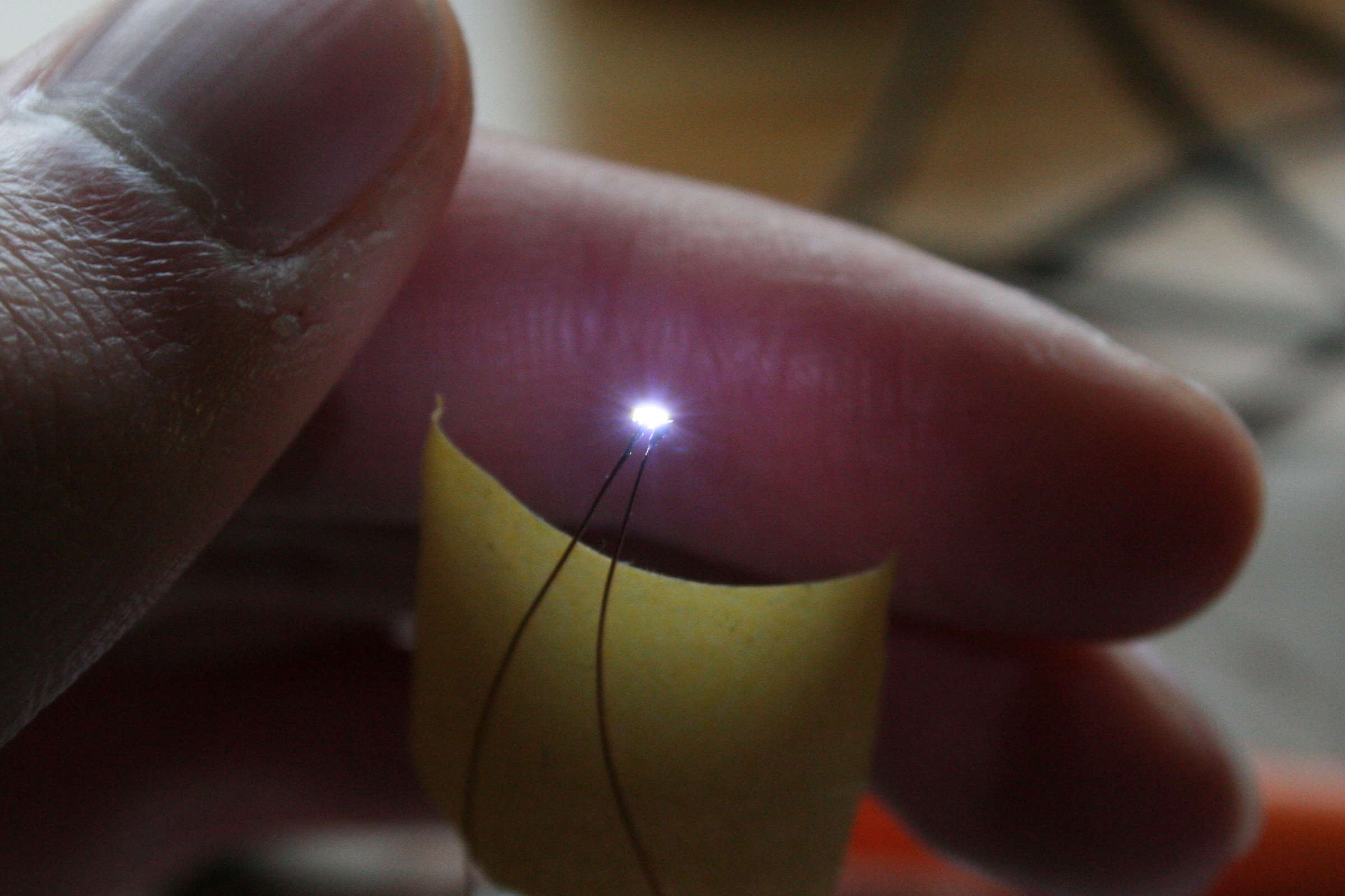

Orbital Drydock, thank you very much! Your last post gave me a lot of optimism and I bought two kinds of thinner wire. I was just successful with enameled copper wire (0.2mm diameter). It went very fast too, can't complain. I think this will be the solution. As the joints are very fragile, though, I will enclose the wires from both sides with plastic sheet right after they come through the surface of the model to give them stability, and afterwards I will solder a thicker wire to the ends (I don't trust the enamel isolation too much). Here are pictures to proof it:

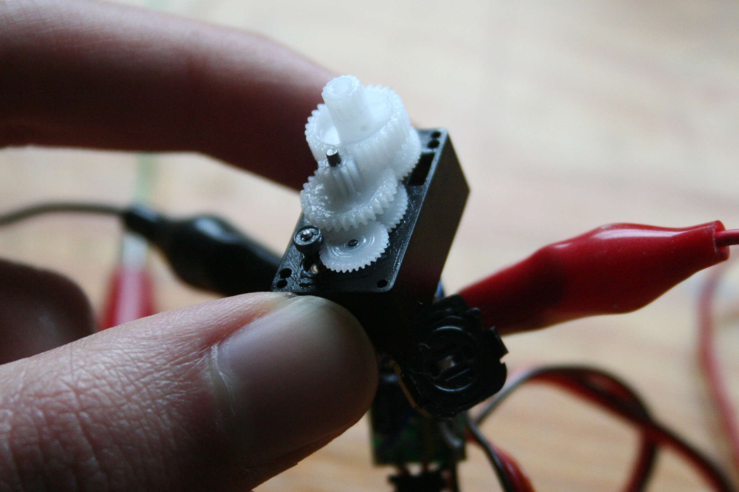

Yesterday I realized that I didn't care about the Bussard collector's rotors yet and got a bit panic. I searched some online shops for electro motors but found them either too pricy or too large and too heavy for this small model (and the weak pylons). But I had the idea to modify RC servo motors for them. I bought three a while back for something entirely different, but never used them. So I now opened one up to see what is inside. After carefully removing the potentiometer from the shaft and plugging the motor's pins to a railway transformer I found the axis spinning with just the right speed:
I measured the current to 0.17 A @ 2.5 V and 0.3 A @ 4.5 V. I don't know yet with how much voltage I will end up for them, but if I need a resistor to limit it, I will have to buy new ones, as all I have at home are for 1/4W only and the current is pretty high here.
So what I'm planning is to permanently remove the electronics of the servo except the motor itself and also cut away the stopper in the housing (which limits the angle of the shaft). Then I need to find something which can be used as a longer axis and connect it to the yet-to-build rotors, and fix all this inside the model. The good news is that it's fairly easy to convert them, they fit inside the nacelles and are lightweight, and the best, they were very cheap ;-)

EDIT: I just found that after removing the electronics, the current drops to 0.04 A @ 2.5 V
View attachment 188971View attachment 188972

clancampbell, thank you for the suggestion! The solder I use has an integrated layer of flux, so I never came to this idea. I will try it when I solder the remaining 30+ LEDs ;-) But the thinner wire already makes it very easy.

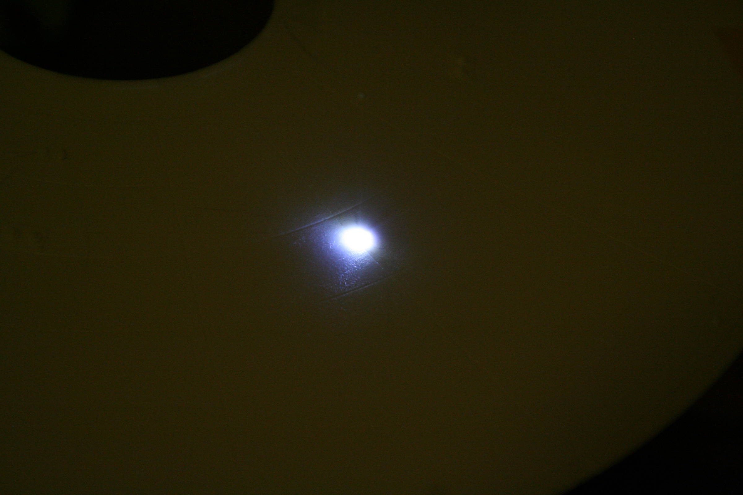

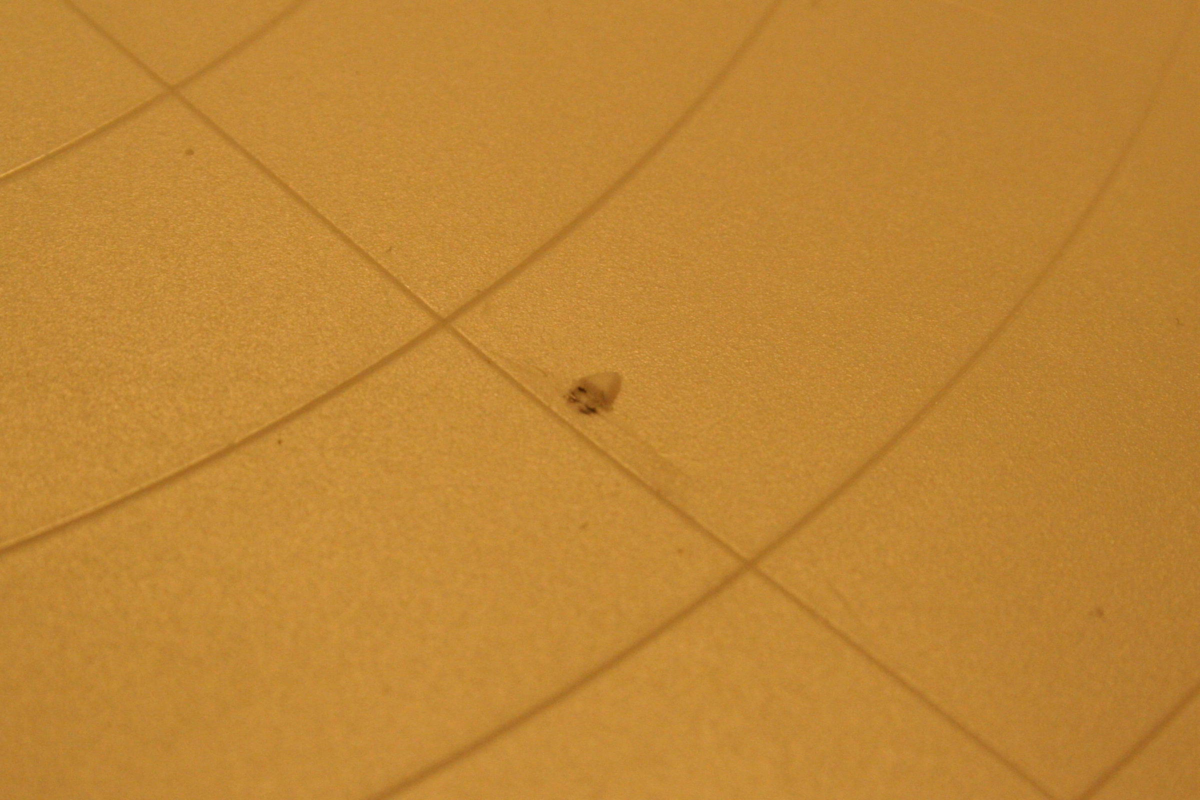

Hi,

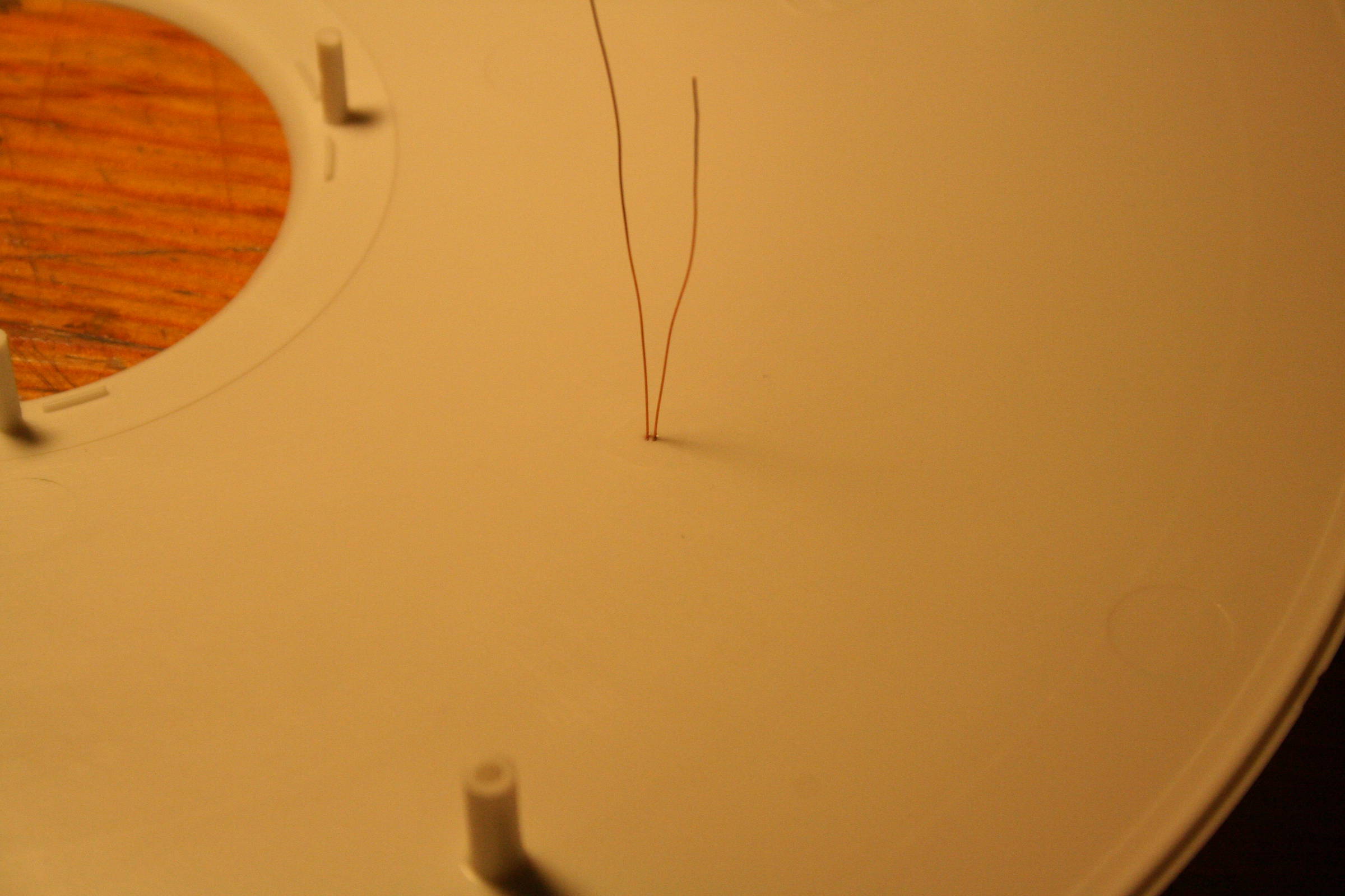

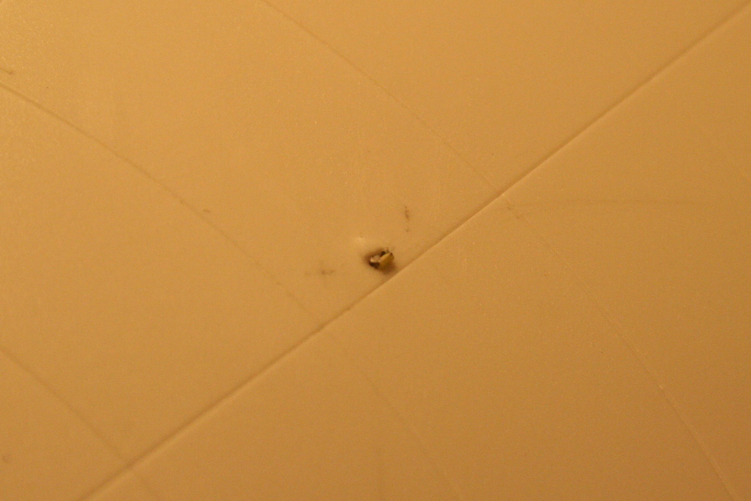

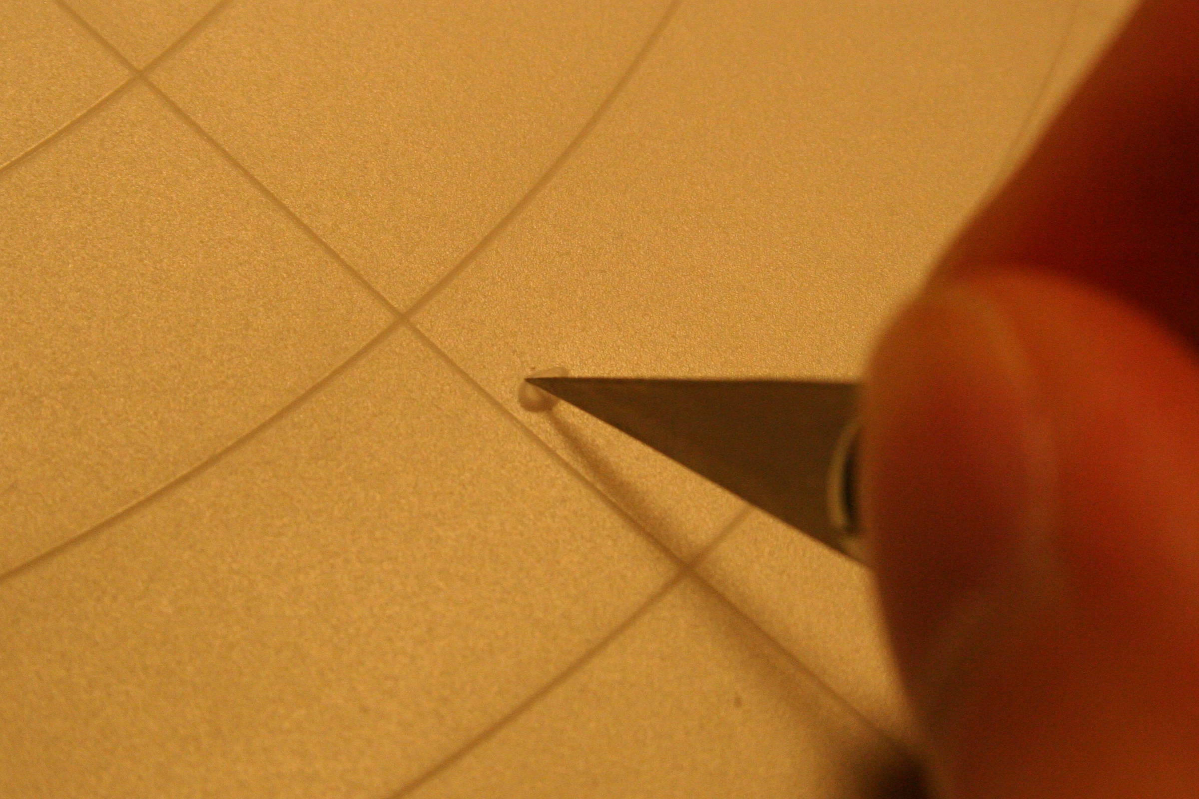

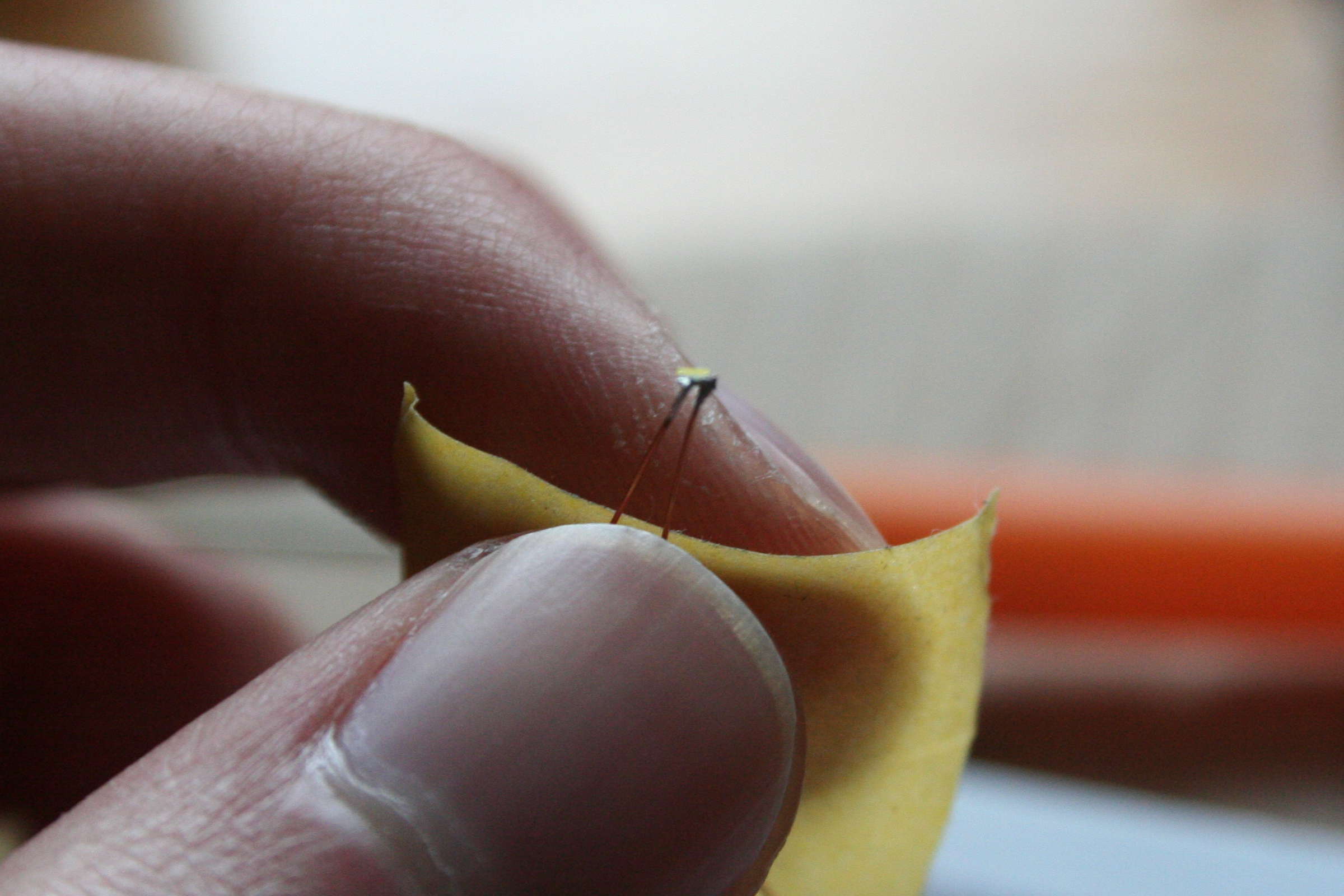

a short update: Ive been able to solder some more LEDs this weekend (only 10 left now), and I've built in the first of them into the upper saucer part. Here are step-by-step-pictures:
First the forward half of the light port is cut off from the part:
Then holes for the wires are drilled in front of the remaining part of the light port:
The wires of the LED are pushed through the holes until the LED sits on top of the plastic:
Here is how it looks turned on:
The look isn't exactly as on the CGI model. I won't step back now and do the interior lighting method but try my best to achieve a good result with the LEDs. It still needs to be puttied and sanded, and I'll try to make its front a bit more rounded. I hope to change the light geometry a bit this way. But the color remains a bit too blueish.
BTW, for all who are trying this: After soldering the wires to the LED, I sealed them with a thick coat of CA glue. This helps to strengthen the mechanical connection a lot, otherwise I wouldn't be able to handle them.
Cheers,
Thorsten
