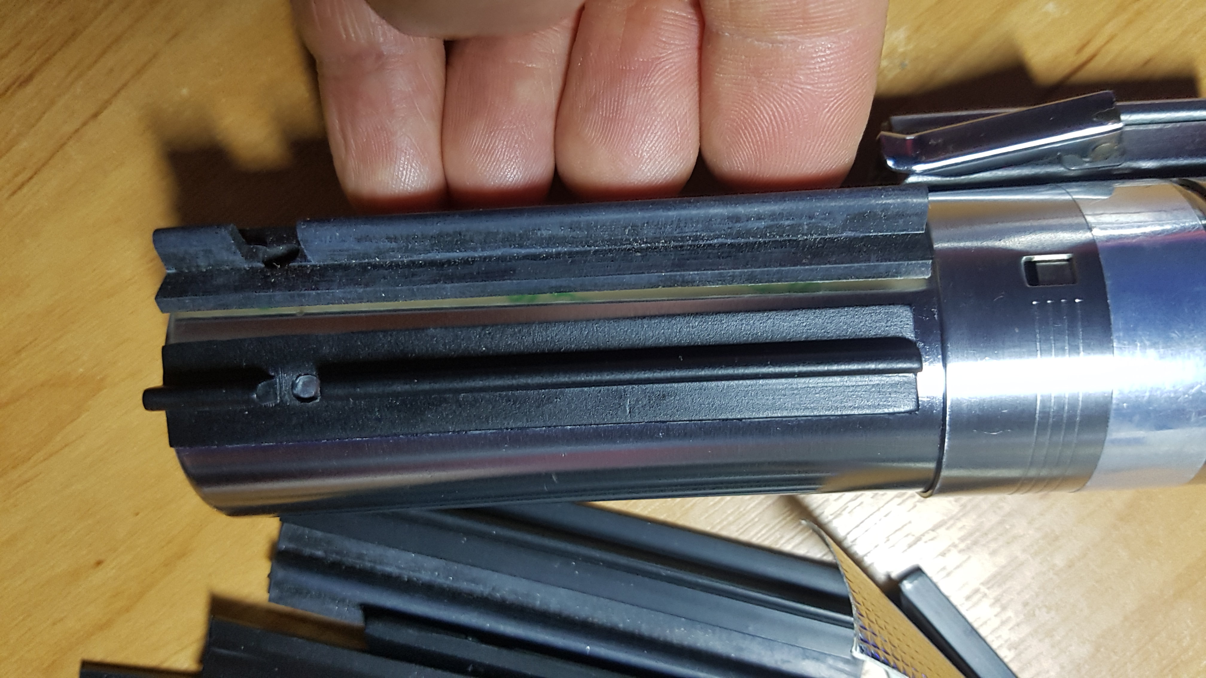

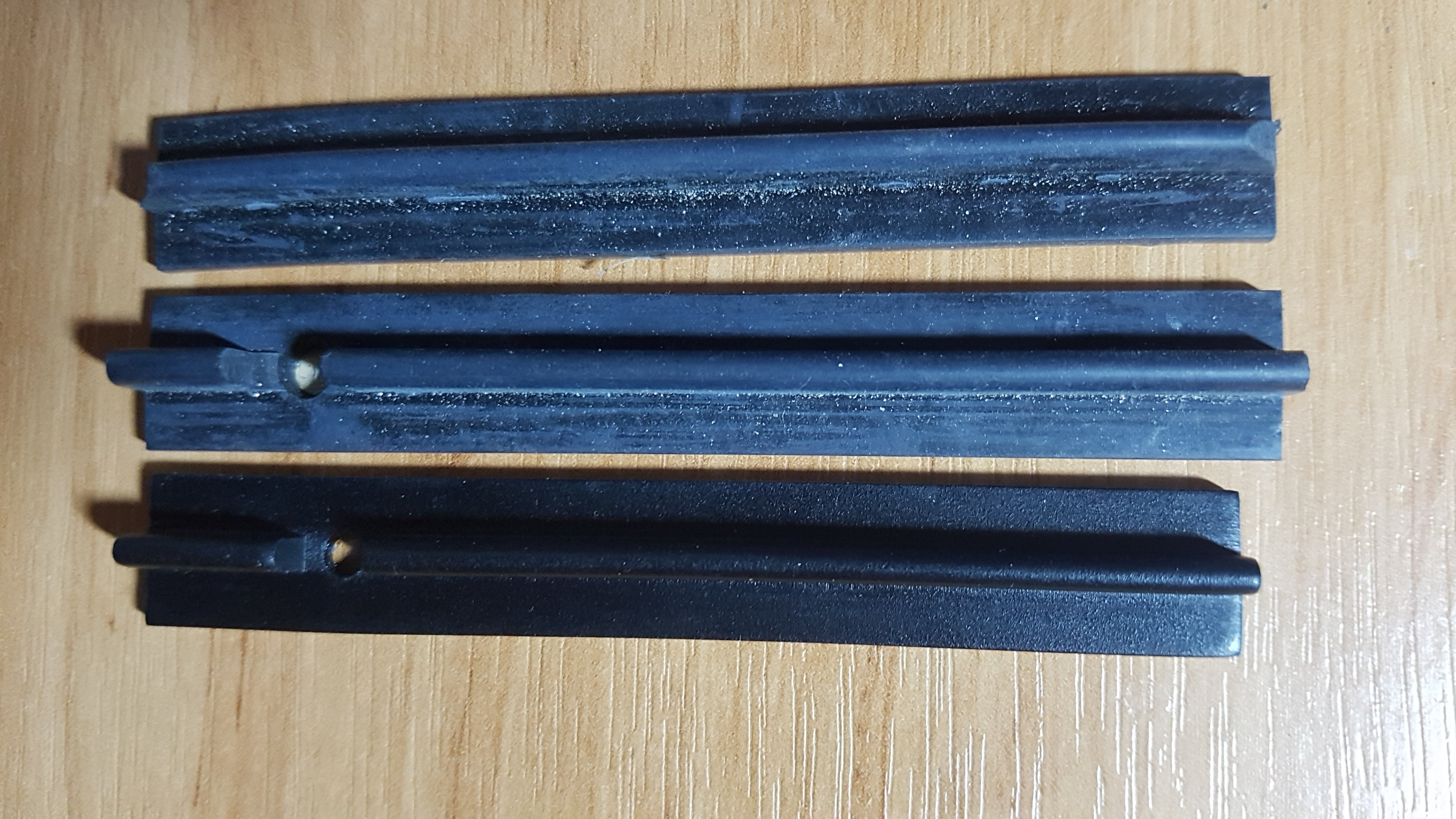

OK, so I have solved the issue of the new resin grips being too short. I bought the ones recommended at the top of this thread but with the square cut outs and they were definitely too short. I have since got hold of a couple of other variations from different sources (both being a soft-ish rubber) and these are both the correct length!
Now, I am a novice but I need to ask if anyone else has had this specific problem and what grips I should now go for? I really liked these hard, cut out versions but they are simply too short against a genuine Graflex!
Any input most welcome!

Should I be going with 90mm grips and if so what do members think is the best set to go for?
I'm in the same position and wondering how to go forward. I figure the next thing I'll do is gather photos of the Graflex, work out measurements, and see about 3D modeling and printing my own set of grips if they don't match Roy's.
