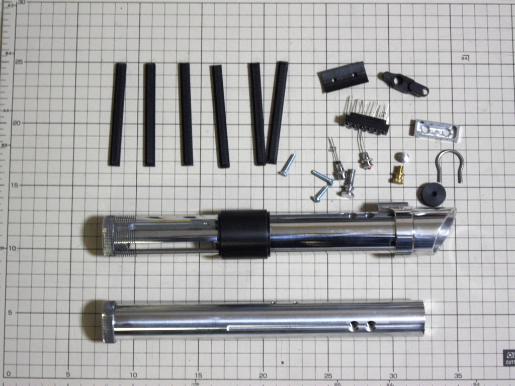

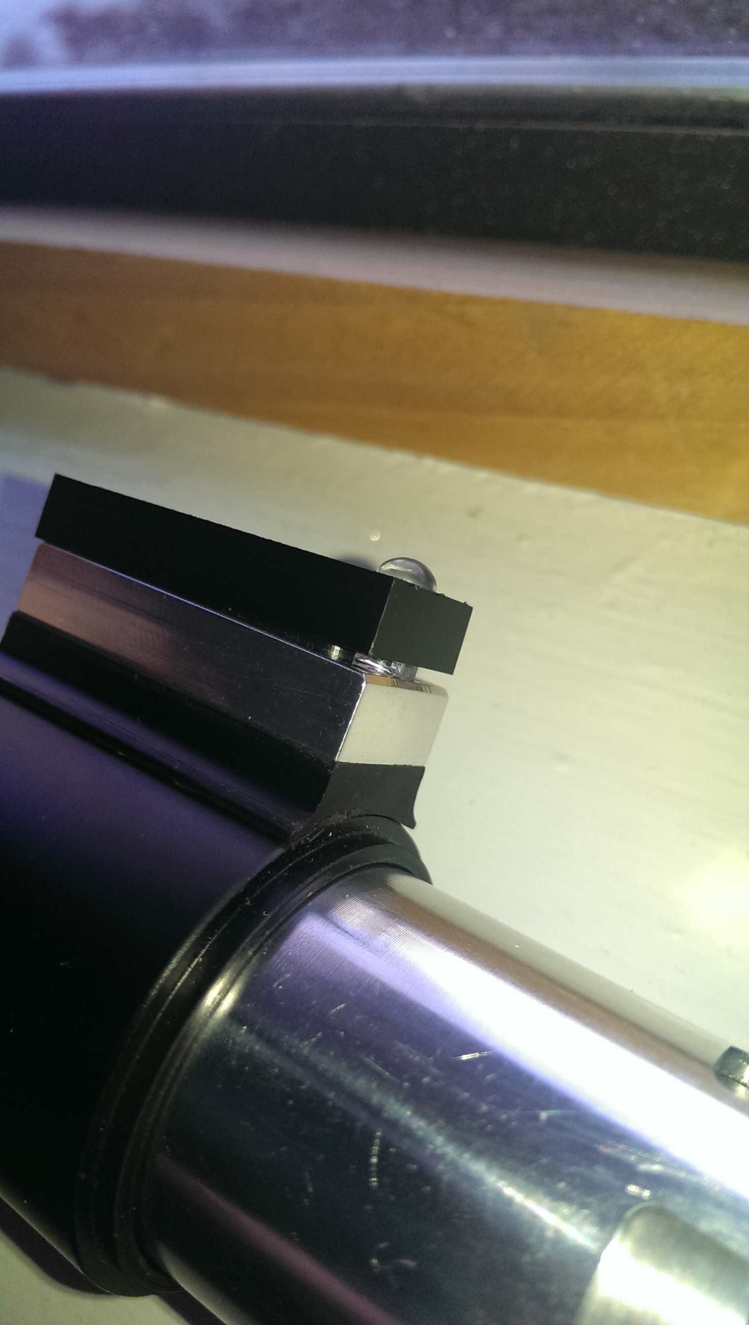

After a year of my waiting, my saber finally arrived yesterday! Aside from a few very minor physical blemishes and the fact that I'm having trouble getting the control box top to close, I'm very glad that I did wait. You've made quite a saber Trid, I thank you and wish you well.

Some blemishes,not removable on the clamp without strong sanding and polishing,but it doesn't matter,because the deal is now done.

I made the control box tops very tight since they couldn't be screwed down. I didn't want anyone dueling and having it fly off. If it's a little too tight, just hit the sides with some 400 grit sandpaper. I do not have any extra grips. The Delrin is so ridiculously expensive, I ordered just enough for each saber, and a few extras in case any broke while being milled, which a few did.
It's not the box so much as the LEDs: the bottoms of the two on either end prevent it from closing
I'd have to sand/file the bottoms off the LEDs completely in order to get the box to fit.

You may have to sand only an edge, not the whole bottom.
They should also be able to be turned slightly.
I've put together two of these and had no problems.
Oh, yeah! That. Yeah, I mentioned that in my assembly tutorial video. Yeah, you need to sand or file the lips down on the LEDs on each end. They did that on the screenused saber too. Sorry for the confusion.
